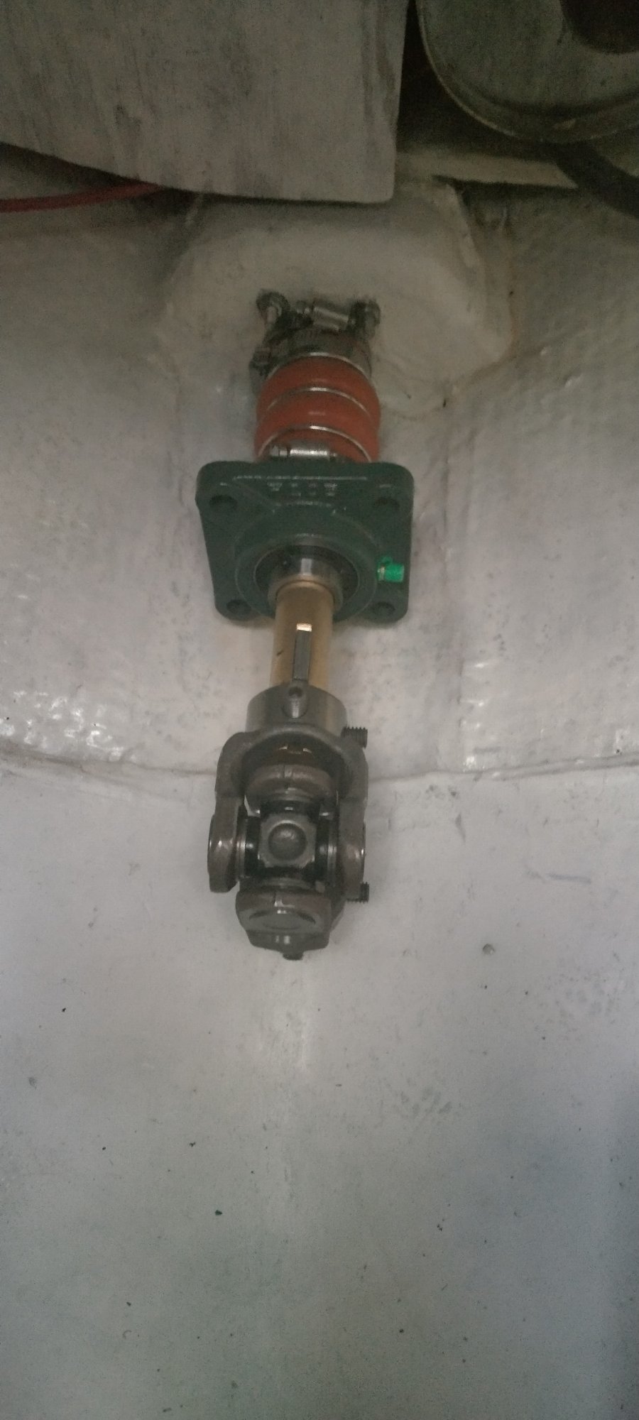

Actually Greg after I'm finished with this setup the shaft from the u-joint back to the prop will be easy to change out. The only struggle will be removing the prop. Then undo the set screws on the u-joint and the thrust bearing and it should slide right on out. Of course that's just a hypothesis. I have been inaccurate a couple times in my life. I've got so much heart and soul into this vessel I may never be able to get rid of it. but I do need to find a blue water boat for... well, blue water.

Oh right…I forgot you are using the u-joint set up…so you will be cutting the shaft.
Does the u-joint accept a shaft key? You can’t rely on just set screws to hold the shaft.

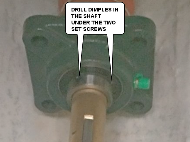

Can I suggest that you heavily dimple the shaft under the two set screws ?
Why does the shaft look yellow ? I was under the impression it was SS or am I behind by a dozen or so previous posts ?
Feb 16, 2023
127
Hunter 27 cherubini 832 Lake Travis
Yes I will definitely be drilling dimples for all the set screws. Yes you must be a little bit behind Ralph. I've had the brass shaft all along.
