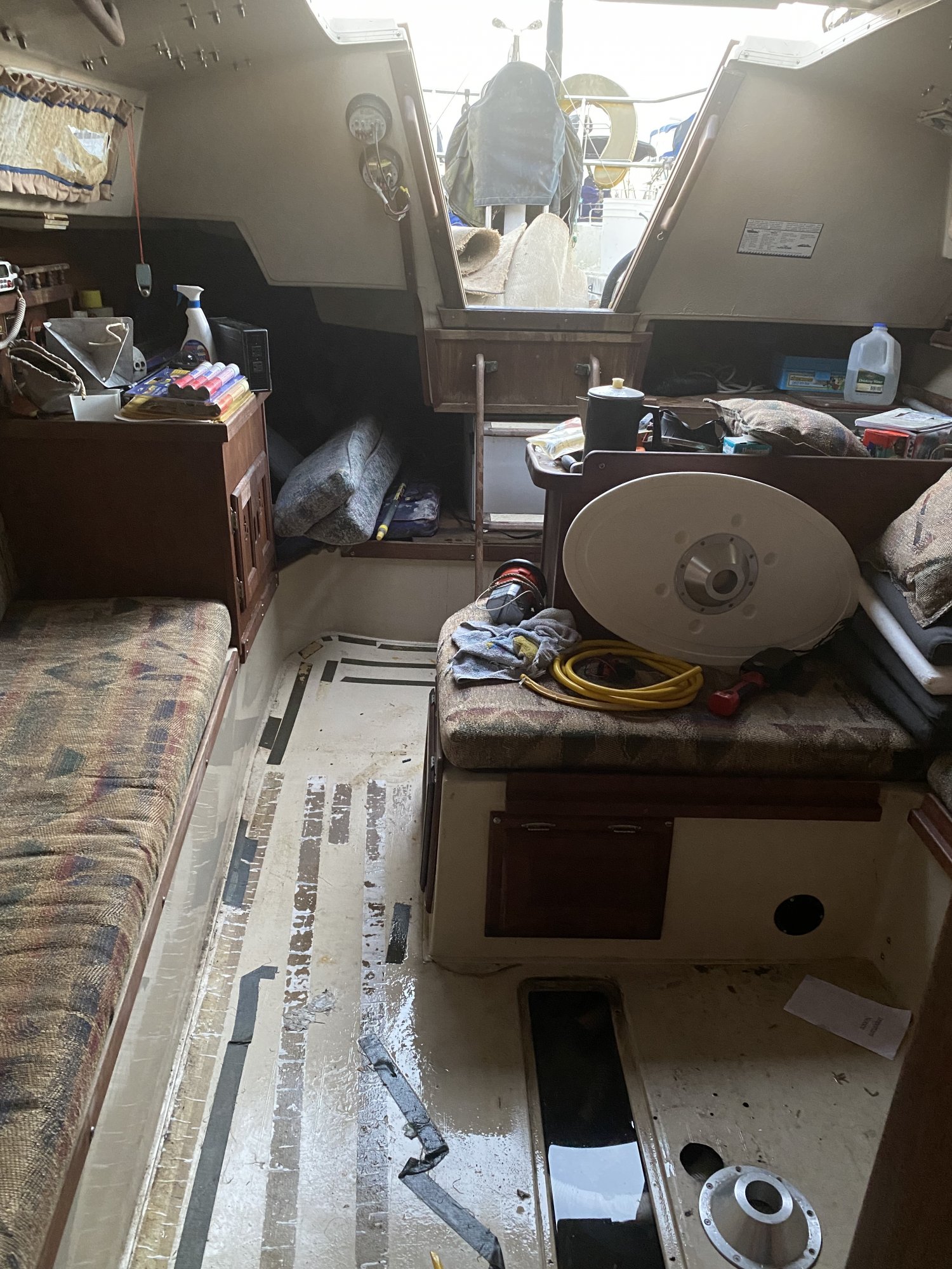

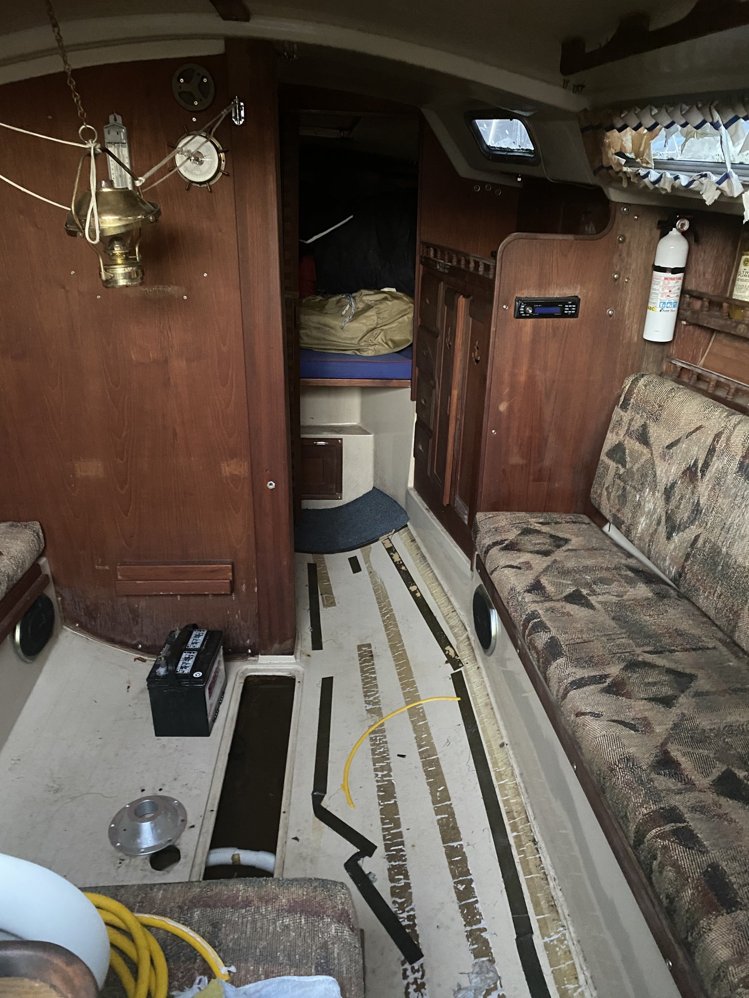

I got a few pics of the interior when I was out cleaning her up today. Yes there is water in my bilge, I did bail some out to get it off the floor and only in the bilge. It’s fresh water either from some leaking chain plates (found 2 that were wet) or from windows leaking, I found at least one of them. I have plenty of work to do, but that honestly is my favorite part, I love making old junk new again. I get way more satisfaction that just buying shiny. So the curtains are rotted, I need to make some new ones, the cushions are actually ok, and I have a bit of mold removal still to do. Oh and the lines on the deck were from the tape that used to hold the carpet in place. It was house carpet that was oddly overlapped and cut from many different pieces. I plan on making some patterns and cutting all weather carpet into “logical” pieces that will allow bilge access and what have you.

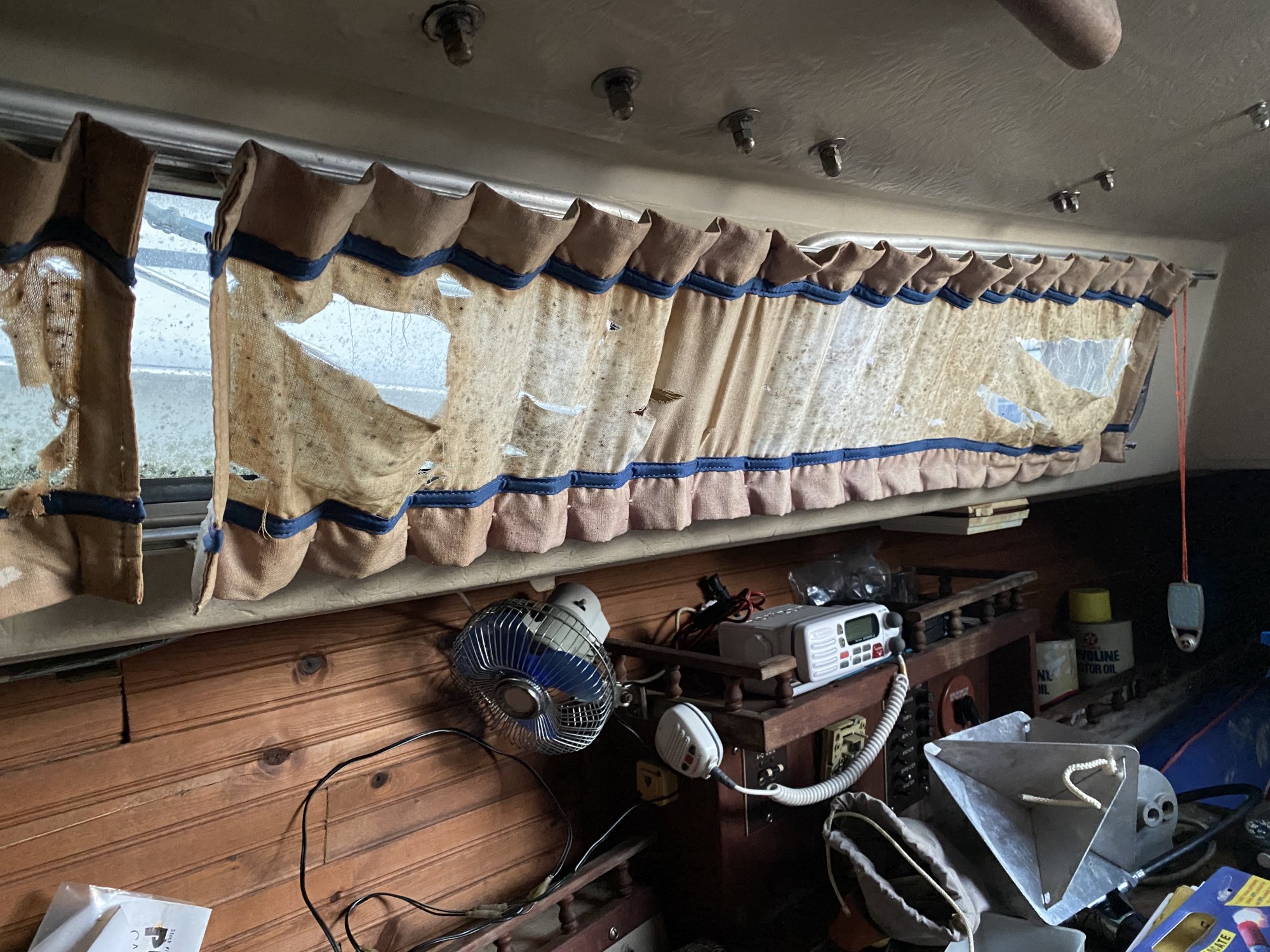

I think I need to learn how to sew… lol. This is the 3rd boat I currently own that needs sewing services. Well the first one has all the sewing done now, but my Bayliner Capri is all rotted and so are some of the pieces of this boat. At least there is a quality radio on board… I have a newer Standard Horizon radio with GPS and all that, but the one here is not bad. I don’t know if it works yet, I have not put power to the boat. I don’t like where the house batteries live, but I have not found a better location yet I need new ones of those too.
If you are interested in doing your own sewing you need to check out the Sailrite.com website. They have everything you would ever need and offer excellent instructional videos.
Funny you should mention that, I am actually working on learning to sew. My Mom is going to teach me and I have been watching plenty of videos. My first project is going to be making new curtains.

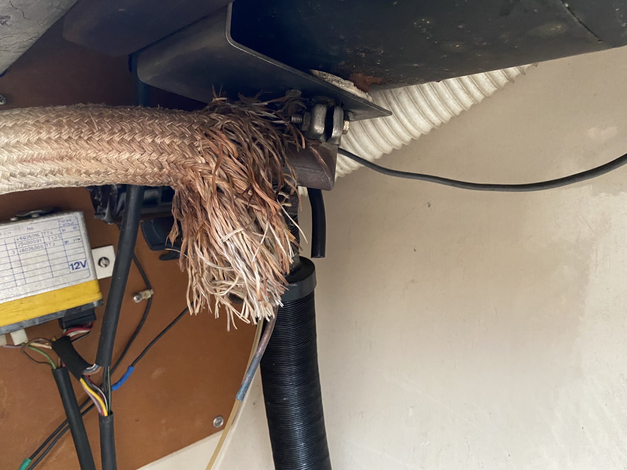

next up there is a pipe of some sort with what looks like asbestos around it (due to the year of the boat it very well could be), I didn’t get a chance to get inside to see where it goes all together.

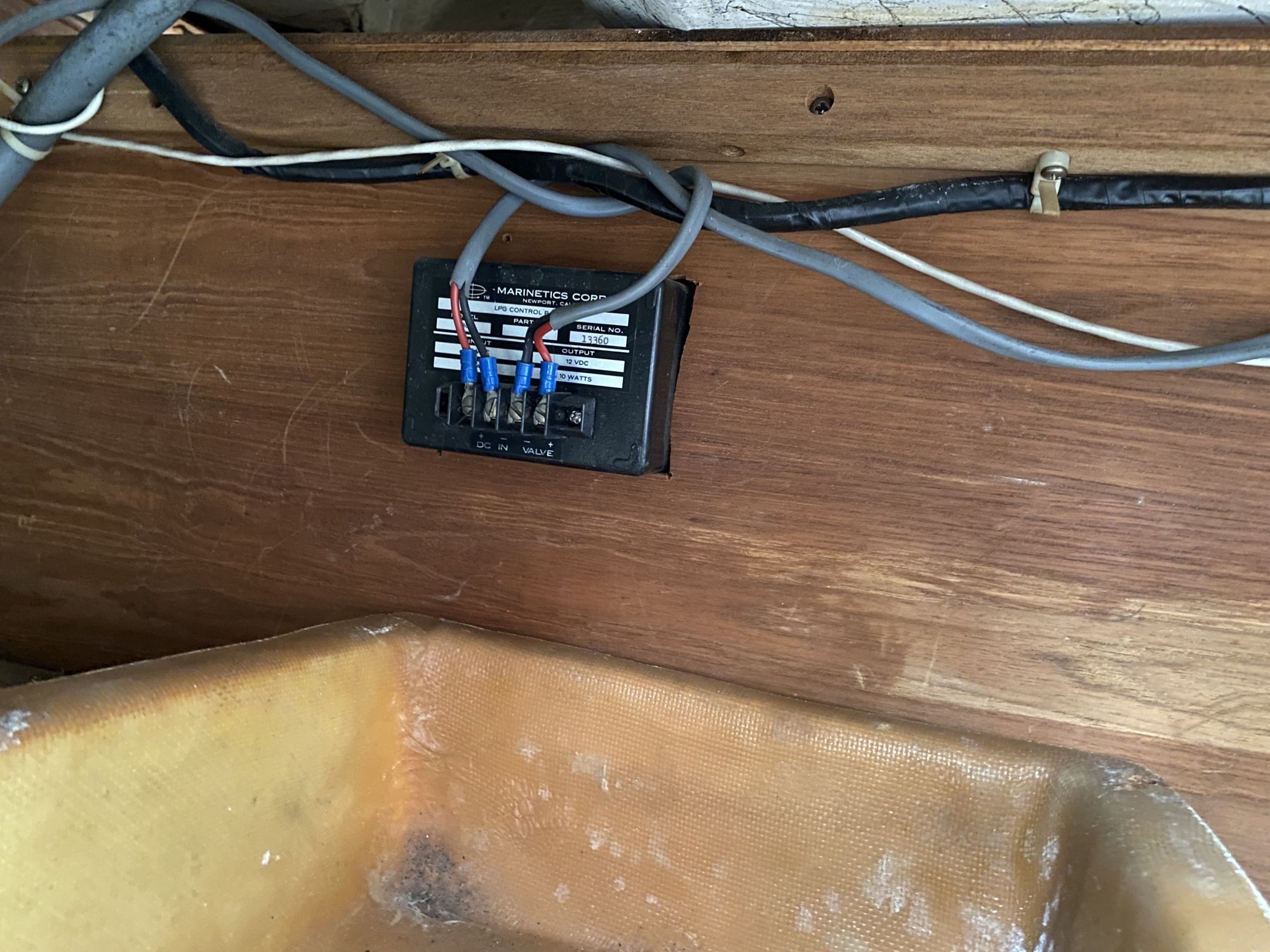

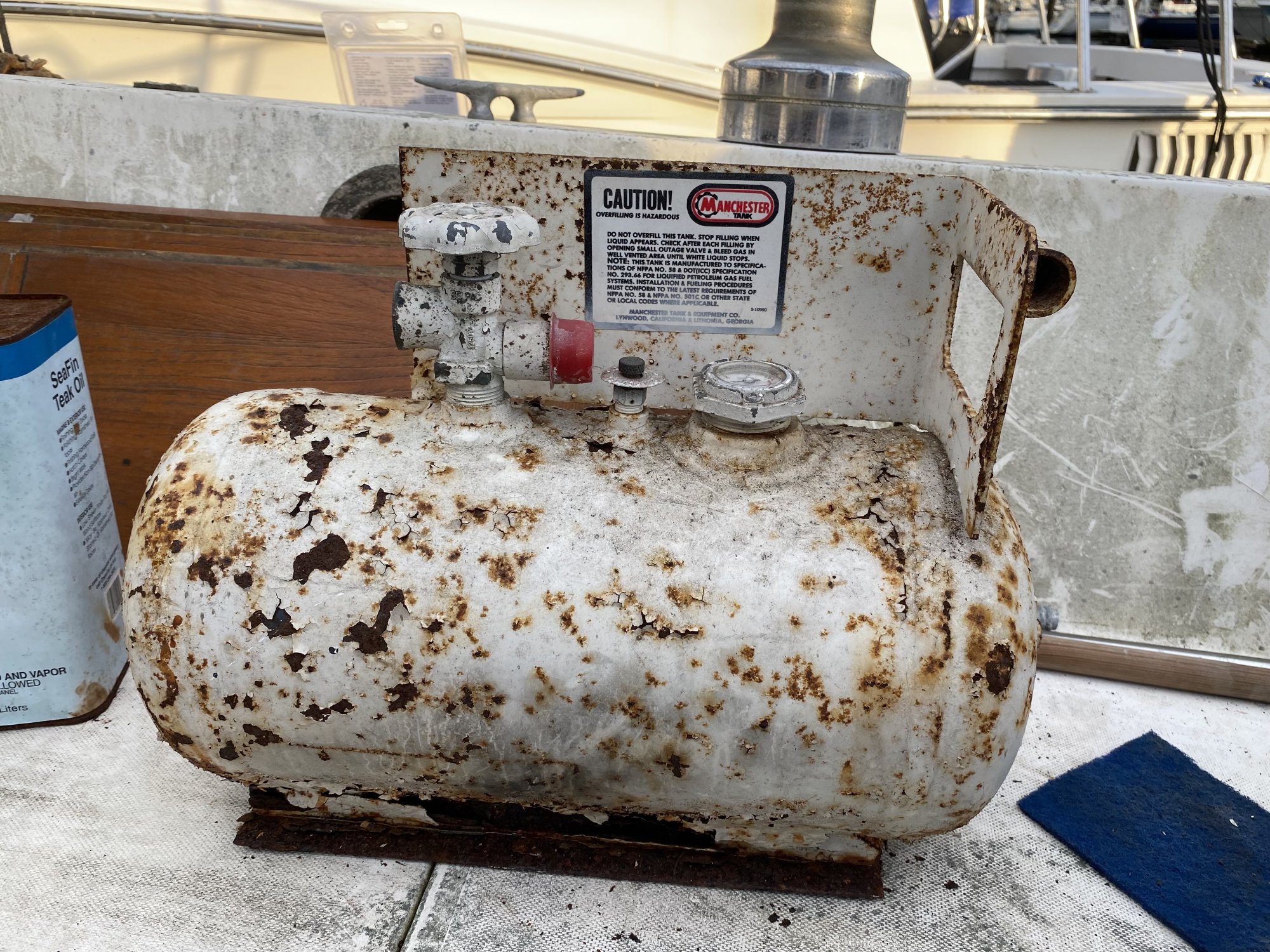

this is the back of my propane solenoid, any thoughts on it?
Need some propane? No? You sure? I got about a 1/4 tank still…

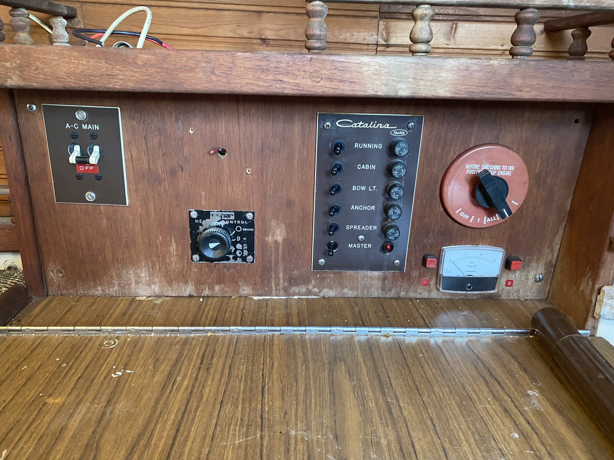

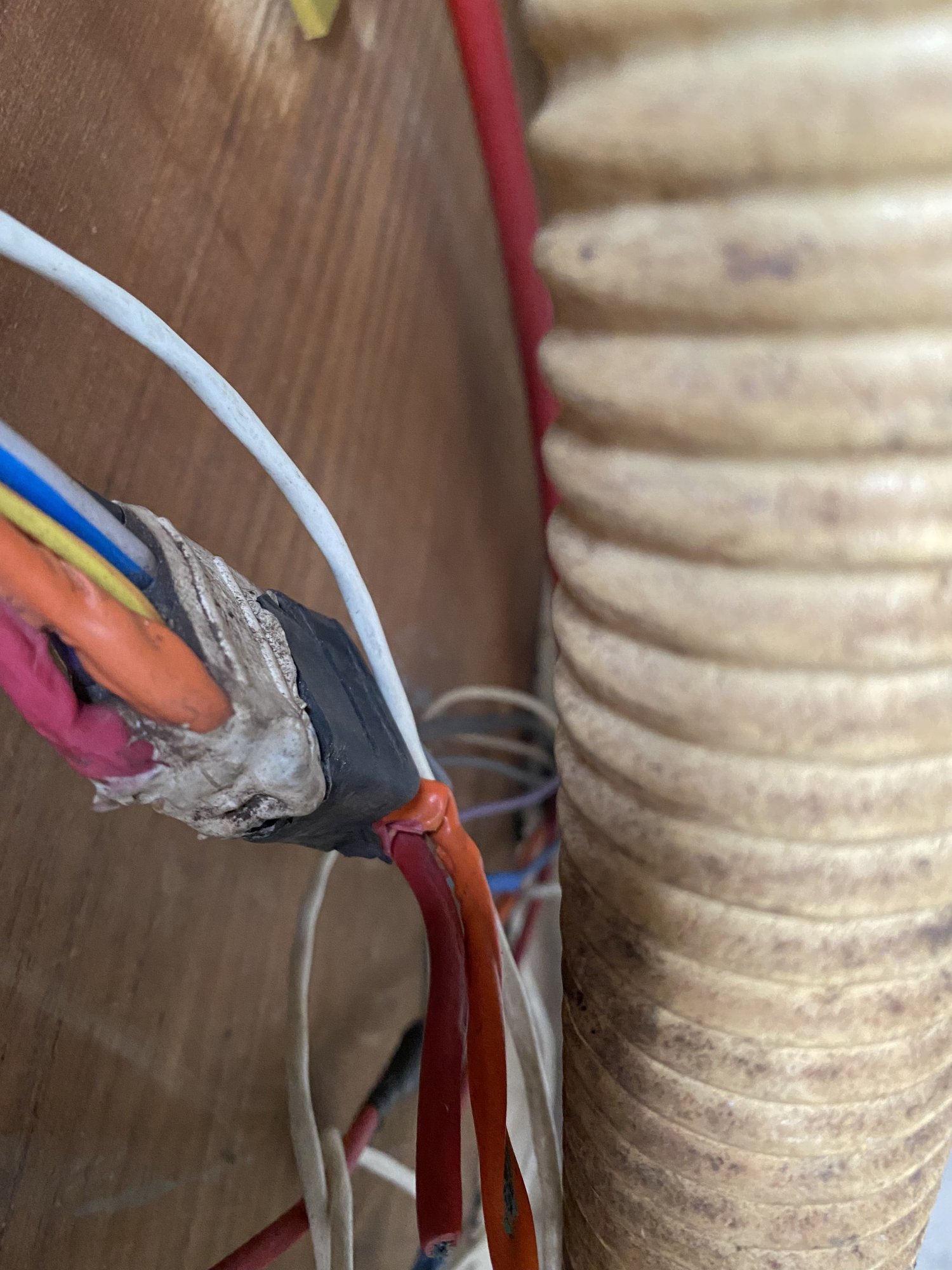

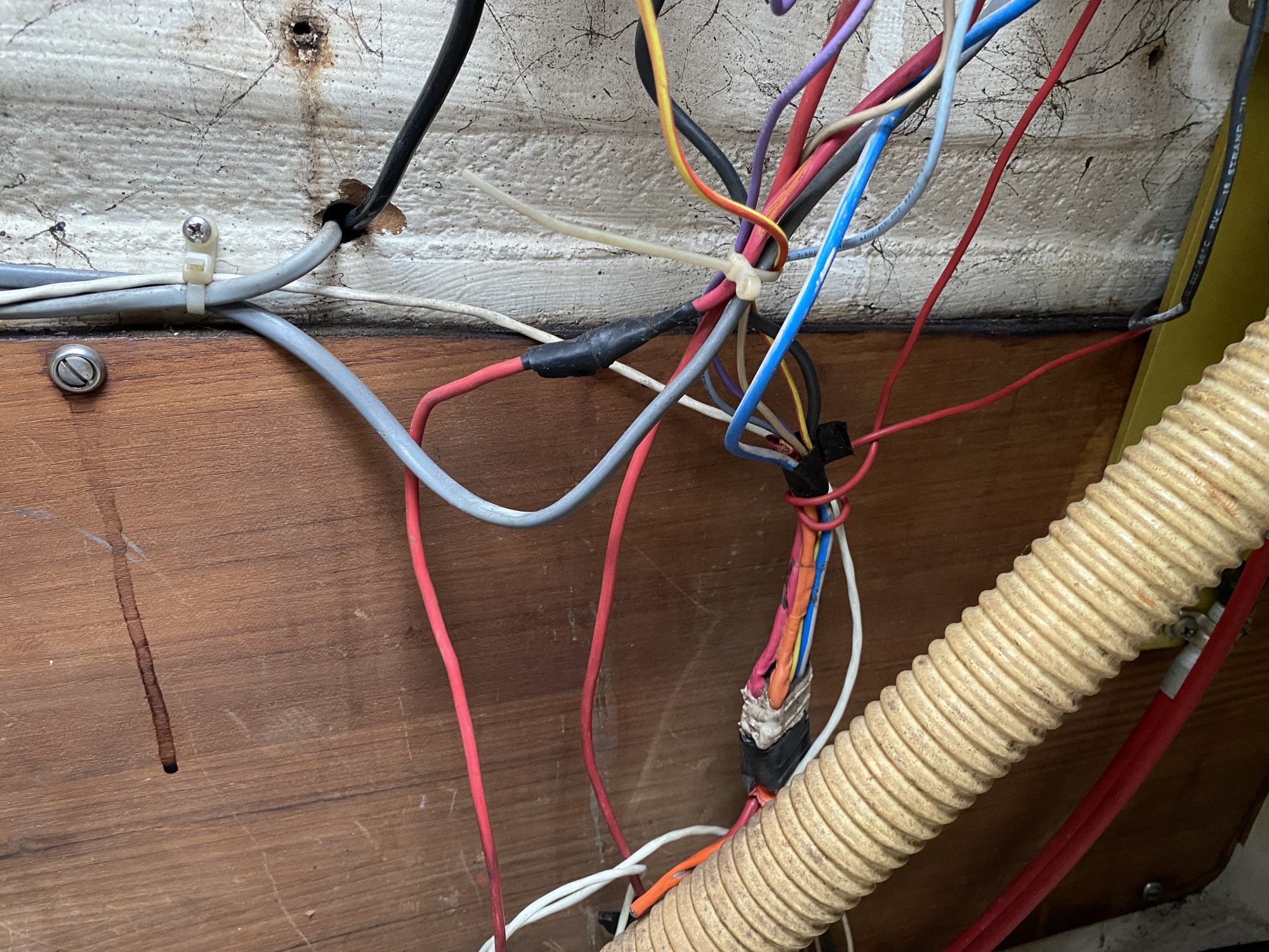

And lastly here is the back side of my very messed up engine control panel. Yes I even have the 5 amp melted plug that looks like it was about to go up in smoke and or flames. The previous owner seems to have gotten really lucky with all the sparky fire starters onboard this boat.
Like the high quality twisted together wiring job? Looks good huh? I found wiring like this all over the boat. Oh how glad I am I know electrical!
And for your viewing pleasure a close up of the plug.

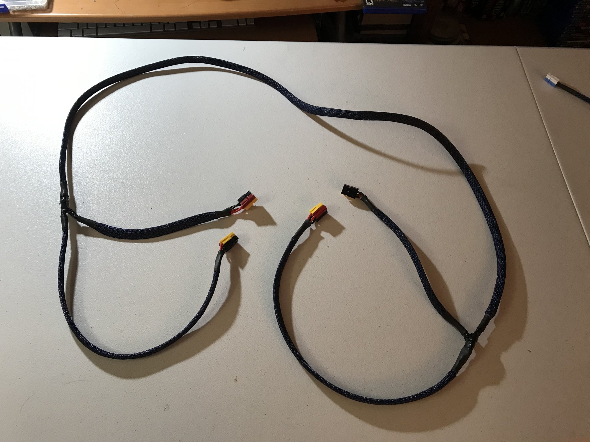

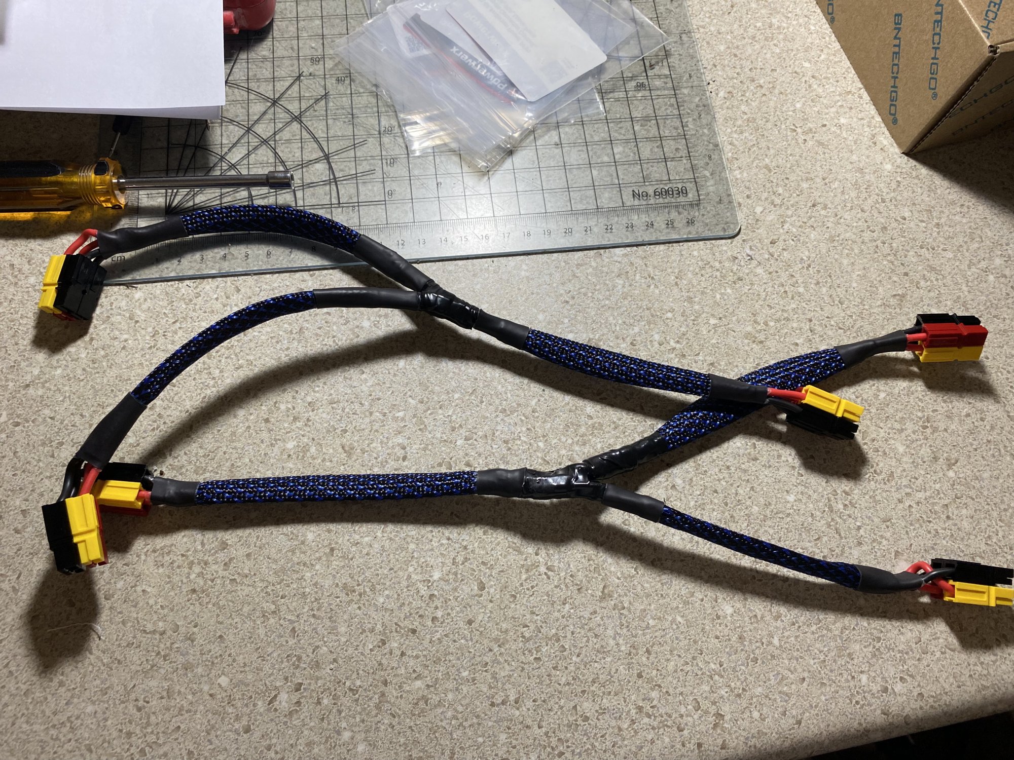

So I wanted your all‘s thoughts on using Anderson Power Poles for the rebuilding of the panel and engine harness. I use these for model railroading and I am good at creating wiring harnesses with them. They come in 15, 30, and 45 amp versions that all use a common outer shell of various colors. They link together to form a solid plug, and the contractor is silver coated brass for the 15 and 30 amp, and nickel coated copper for the 45 amp. The only drawback I can see is the fact that these are not waterproof. The ends could be filled easily enough, but it will not stop water all together. Then again the factory plugs didn’t prevent water intrusion either.
The pic below is one of the harnesses I made for my trains. I would be building a similar style harness with the chaff shield around the wires.
[/QUOTE]
Looks like you’re going to need a new tank & valve. Tanks need to be inspected, pressure tested & recertified every 10 years; I don’t that tank is going to pass muster. Test the operation of the solenoid and/or replace. Also replace all rubber goods and leak test.

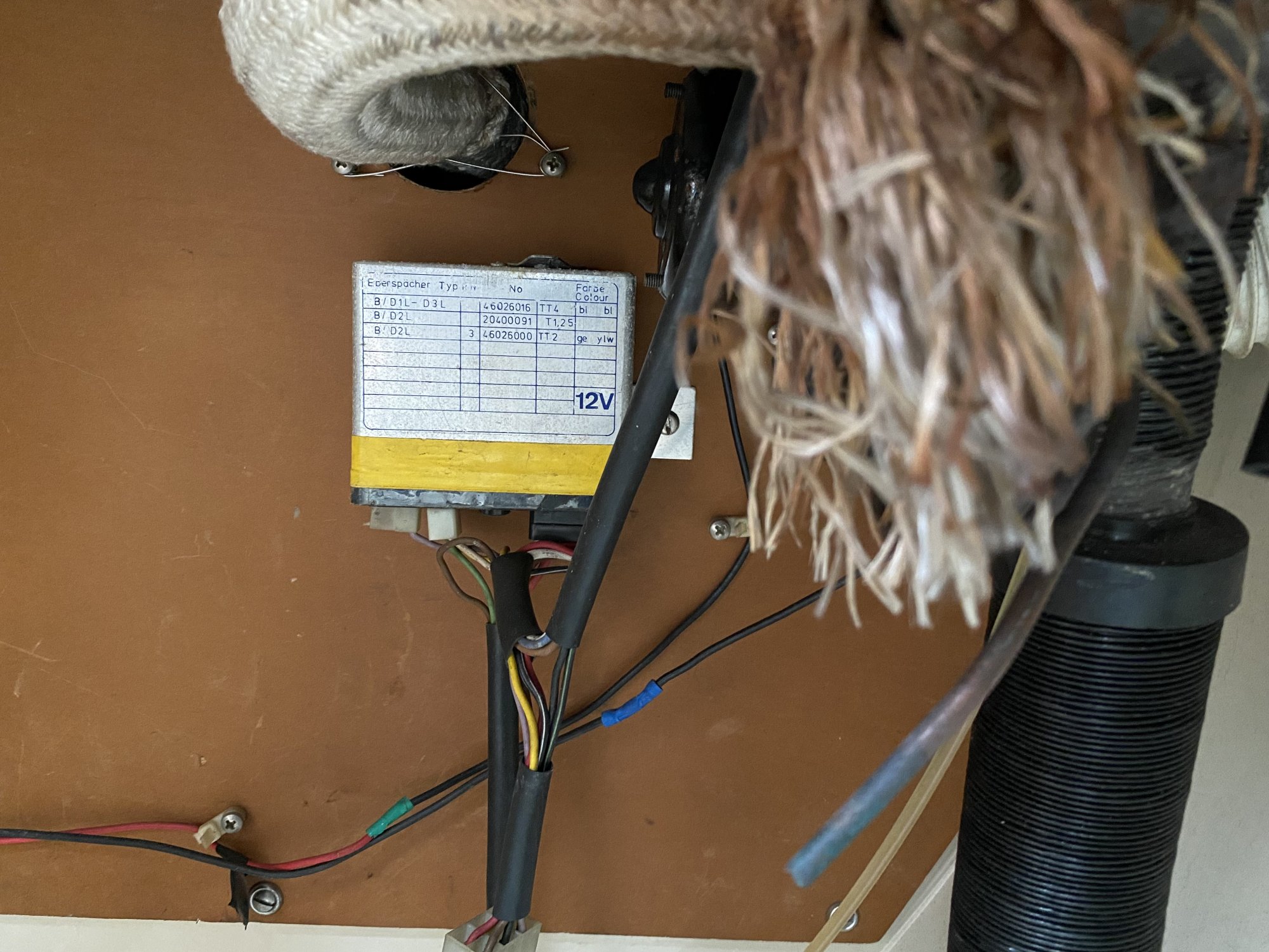

This photo appears to be the remnants of an Espar diesel heater…does that wrapped pipe exit the boat somewhere? It looks like the exhaust pipe from the heater. Where does that black hose go? It looks like the hot air duct. And thr wired box says Espar on it…I expect some sort of control Box for the heater.
Greg
So that wrapped pipe goes into the rear lazzerette and I didn’t trace it after that, it’s not visible just from opening it up in there. There was a thermostat like you would see in a house on my chart table, but it was broken and I cut it off and tossed it, there is also some dial control that says Espar that I didn’t know what it was on my chart table. Most of the paint is gone so…. The hole above it was where the thermostat used to go.
Yea, I know the tank is toast. I’m not even sure of the year on it, I can’t find a year stamped into it anywhere… if they even stamped them back when this one was made. I was always planning on replacing my propane hose, I just didn’t know is the switch is of a quality manufacture, and the factory solenoid as well. Yes most definitely they will be tested. And or replaced.
One good thing, those propane system parts should be readily available from Catalina or online chandleries. Nigel Calder has an excellent chapter in his book regarding ABYC compliant propane systems....good reference source.
The knob below the hole says Espar Heater Control…
I suspect the wrapped pipe exits the boat somewhere on the transom e or the side of the hull by the lazzarette.
