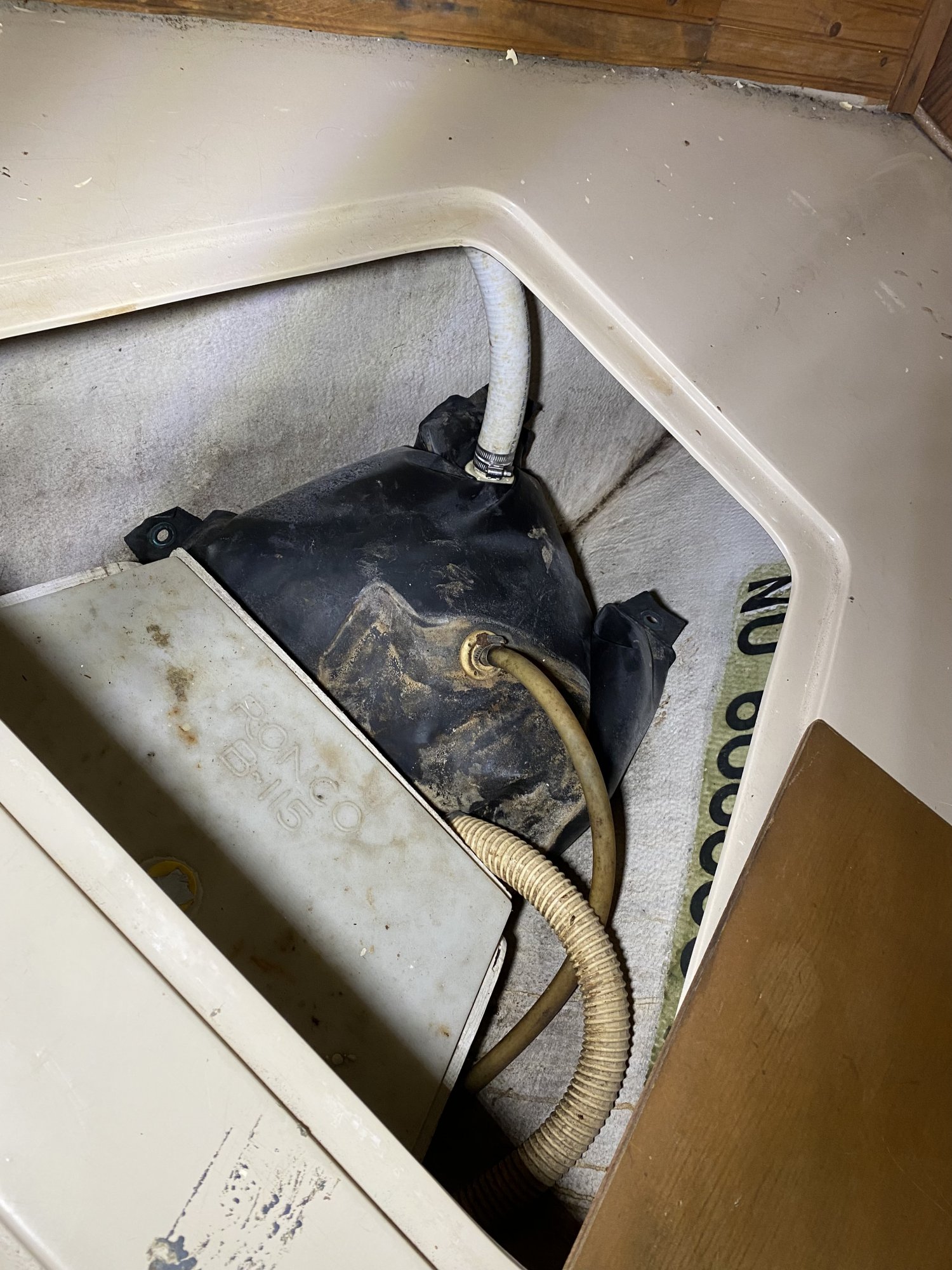

Just out of curiosity… where is the waste tank supposed to be located, and what is is supposed to be? Mine is a bladder up under the Vee berth and it doesnt look healthy.
Dec 2, 1997
9,010
- - LIttle Rock
Never mind where it's supposed to be...boat builders rarely put them in the best place. In your case, i agree completely that the bladder has to go! However, depending on where the toilet is located (distance from the tank), the v-berth is a great place for a holding tank on most sailboats.
There's also a Ronco plastic tank mold #115...a 25 gal. tank. Ronco tanks are TOP quality thick walled tanks...have supplied Catalina's OEM water and holding tanks for decades. It's a bit small for a water tank, leading me to wonder why the bladder is there. Did a PO crack a tank fitting on the Ronco tank by over-tightening it? Or wanted additional holding capacity?
First thing I'd do is get rid of the bladder, then clean everything up and carefully inspect the Ronco tank for a crack or leak. You're gonna need new hoses anyway, so remove it and water test it. If it turns out to be sound, I'd definitely keep it. If not replace it with the identical mold--which you can get directly from Ronco for a lot less than Catalina's price!
I'll be glad to help you with your tank, toilet and plumbing...What's the make-model-approx age of the toilet?
