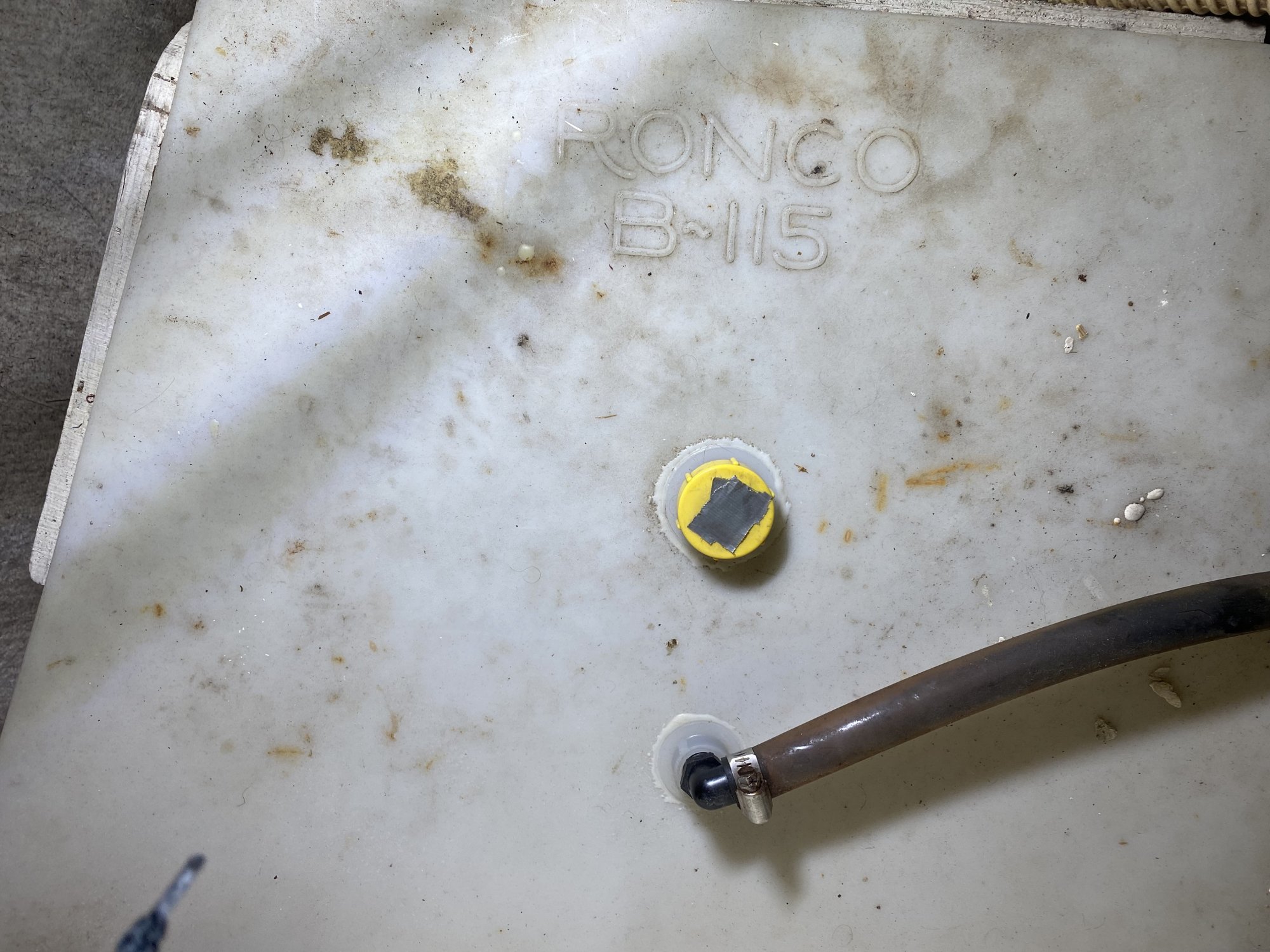

The tank in your photo would be an excellent choice and is in a great location. It's clearly marked including mold # in your photo in post #59. If it's still sound, I'd keep it...if not, replace it with the identical tank.
The Ronco Plastic catalog is here Ronco Plastics marine Tanks You'll find the drawing for that tank in it. Not only do they make top quality tanks for a very reasonable price, they also install fittings in the sizes and locations specified by the customer when they make the tank.

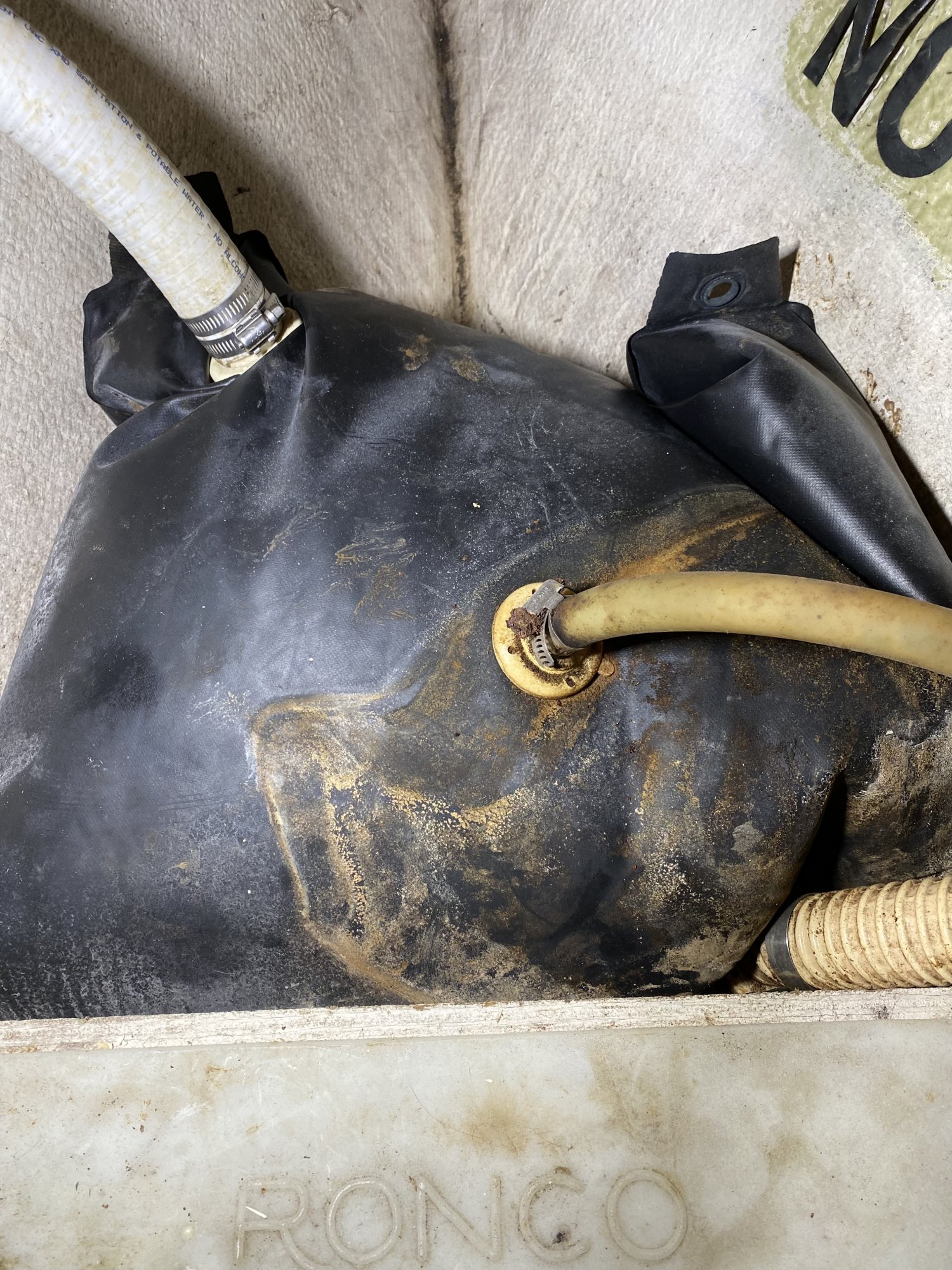

Ok so I need to find out if my boat even came with a black water tank to begin with. I found the valves, they can be accessed from a door in the head or from through the opening in the V berth. The white tank is indeed a water tank, it seems in good condition and there is no funny smells from it, but there is a bit of water left in it from 15 years ago.
I may be able to get to the boat later this week to check the port settee for a tank or signs of a tank. I know my starboard settee has a water tank in it.
@Peggie Hall HeadMistress , I checked out the tank number you gave me, and it looks like it would be the tank under the Vee, I would like to put the new tank under the settee as the factory would have done… if I need a tank that is. Do you know which number that is?
You shouldn't have had to search for that mold number...it's clearly marked on the tank in your photo.
I suggest you ask Catalina for the mold # of the tank that fits in a settee on an '81 C-30. It's important that you give them the year 'cuz boat builders do make slight (and sometimes not-so-slight) changes in the hull designs of the same models over the years. What fits in the settee of the current C-30 may not fit in your boat. Don't order it from them...you'll pay a lot less if you order it directly from Ronco. Plus...because there's never been a holding tank in that location, depending on the location of the deck pumpout fitting and vent thru-hull, we may need to spec the fittings in locations that are different from where Catalina puts them.
It seems like this is an "Educated guess".
the only way to be sure is to examine the sizes of the hoses entering and exiting the tank. If at the end of last use the previous owner did a good cleaning job because they knew the boat was being set aside for a while the appearance could fool an inspector. The hose connections will tell the true story.
There are inlet hoses that connect to the deck. They should be labeled. A key clue as to where the hose is intended to go.

a formerly clear hose going out to the port side, a yellow cap with a crack in it (hence the duct tape) and the fill hose that goes to the deck. No vent hose.
The formerly clear hose is most likely the vent line. It should be replaced with sanitation hose. You can use flex PVC #148 (the cheapest) for that.

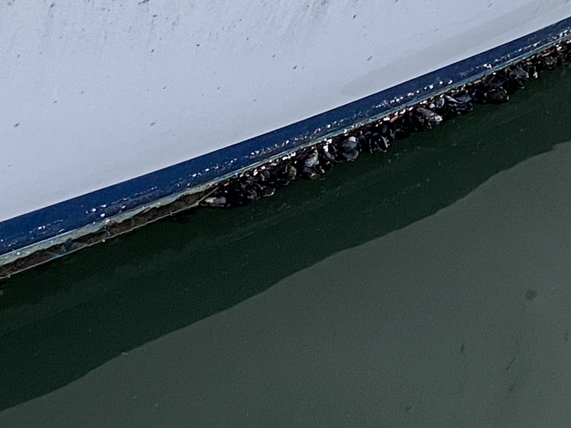

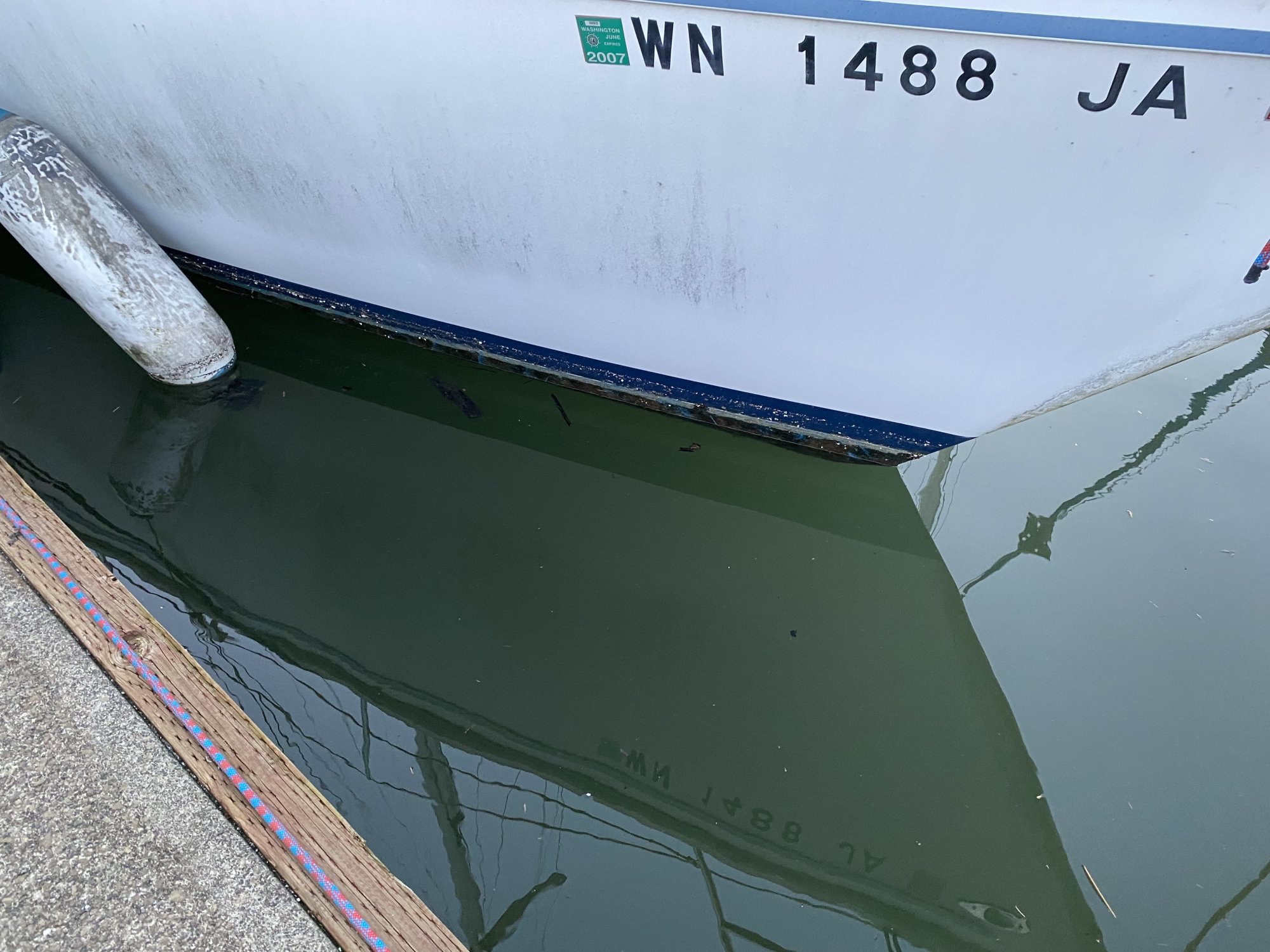

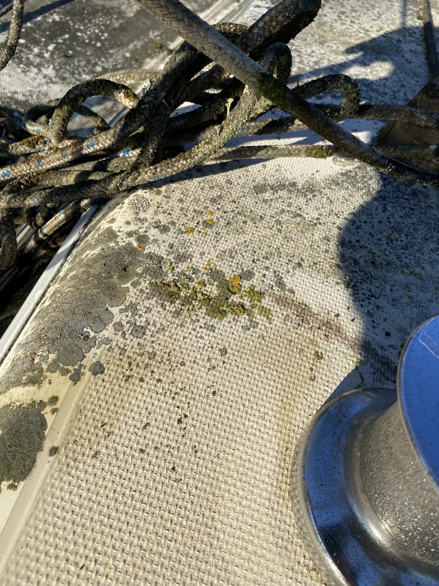

I got more cleaned up inside and out on Luna. First off I took a scraper to the hull and got it looking much better. I was able to also scrape the rudder a bit and clean off one side at least.
Just to compare how thick the marine growth is on the other side. Starboard side was the same.

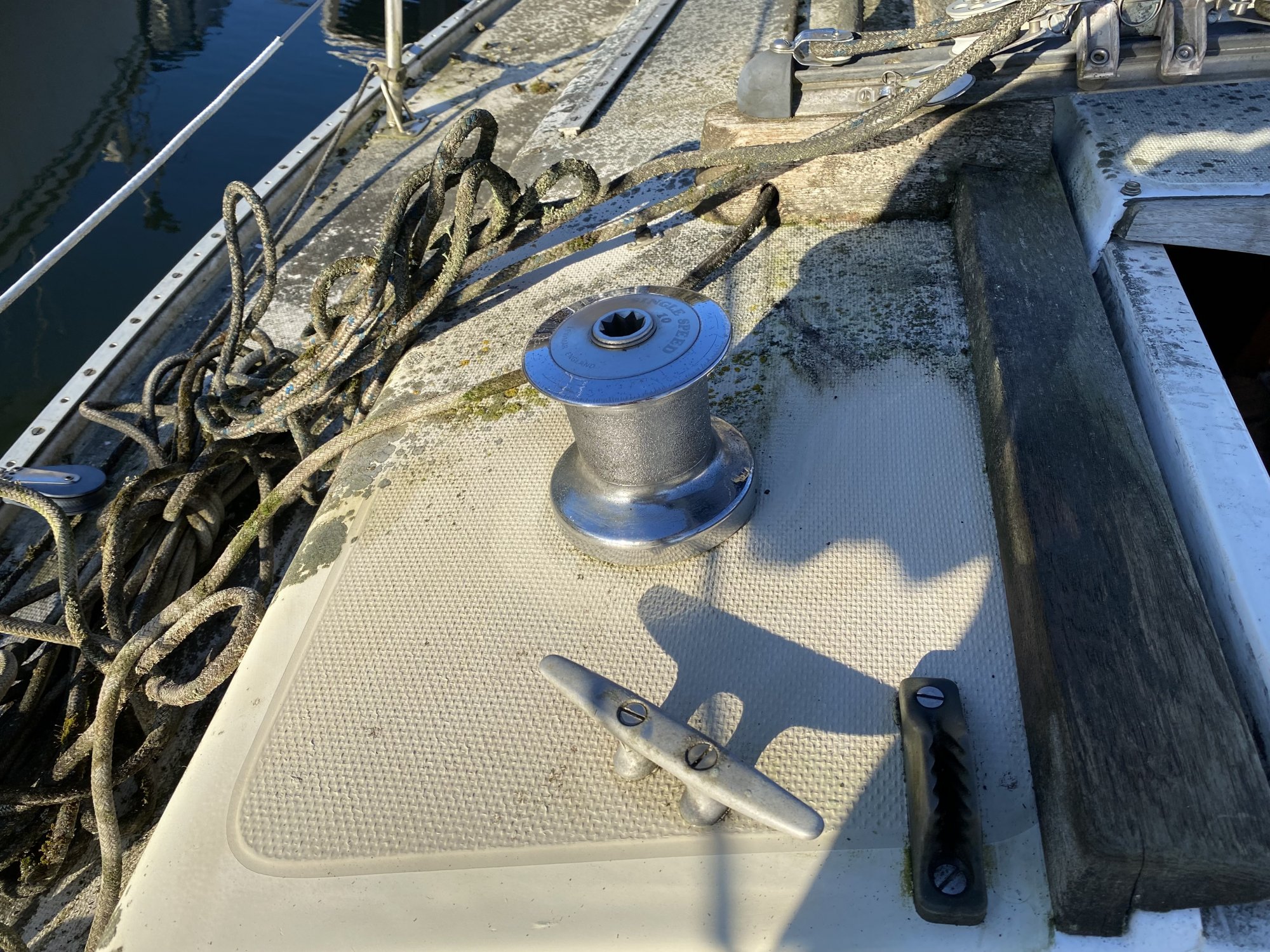

I did a test scrub to one of the worst areas of the hull where the traveler lines are stored, it came out pretty good. I discovered I have the beige non skid areas, I always thought I was just solid white all the way through.
Here is the before…
And the after… this is a scrub brush with Simple Green and about 30 seconds or so of scrubbing.

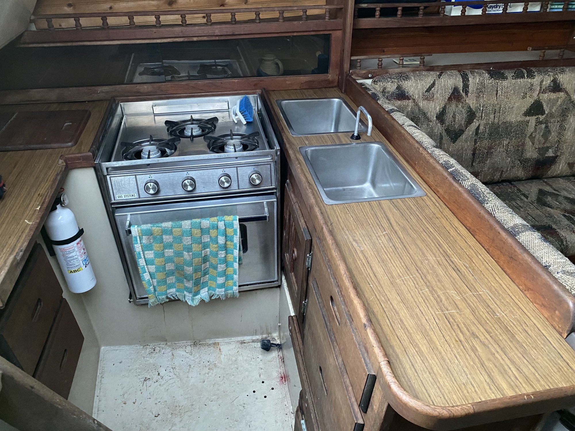

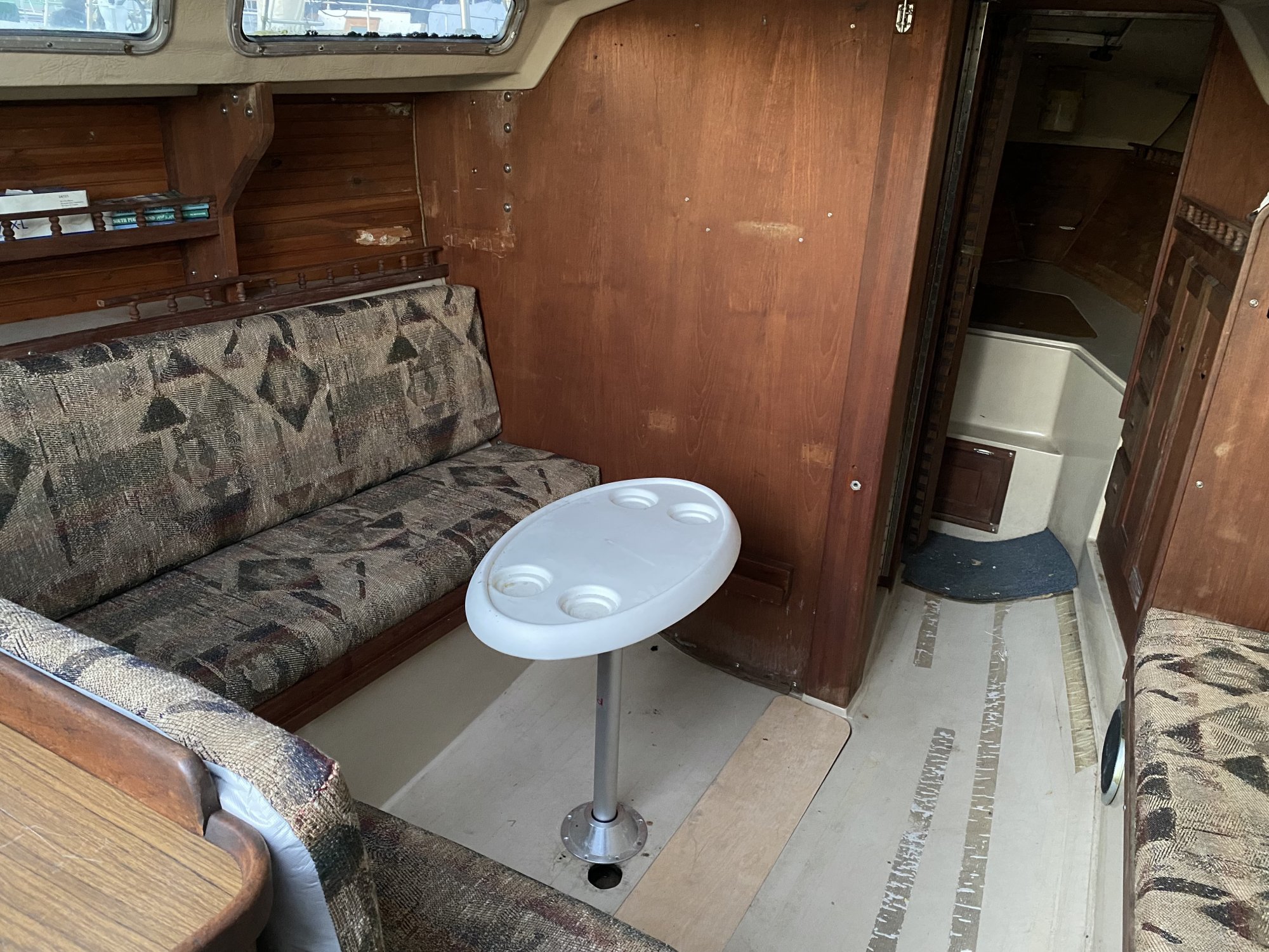

Then I tackled the interior. I’m not going to bore you with all the details, but the interior is now presentable (minus the floors… they still need a good scrub!)
And my galley countertops are now clean. I plan on redoing the counter tops in white Formica, I’m not a huge fan of the 70’s era wood grain everywhere… my house is already done like that.

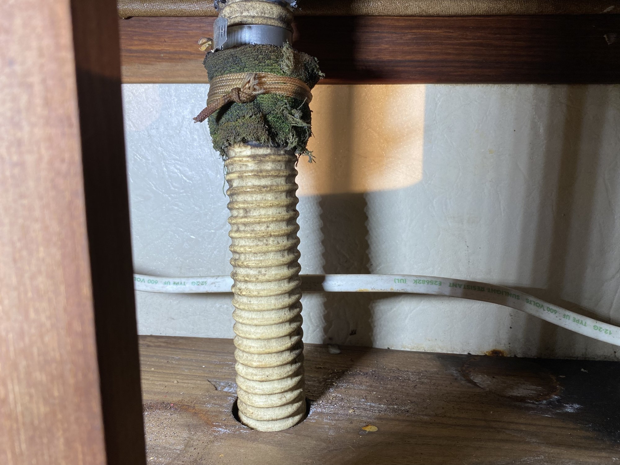

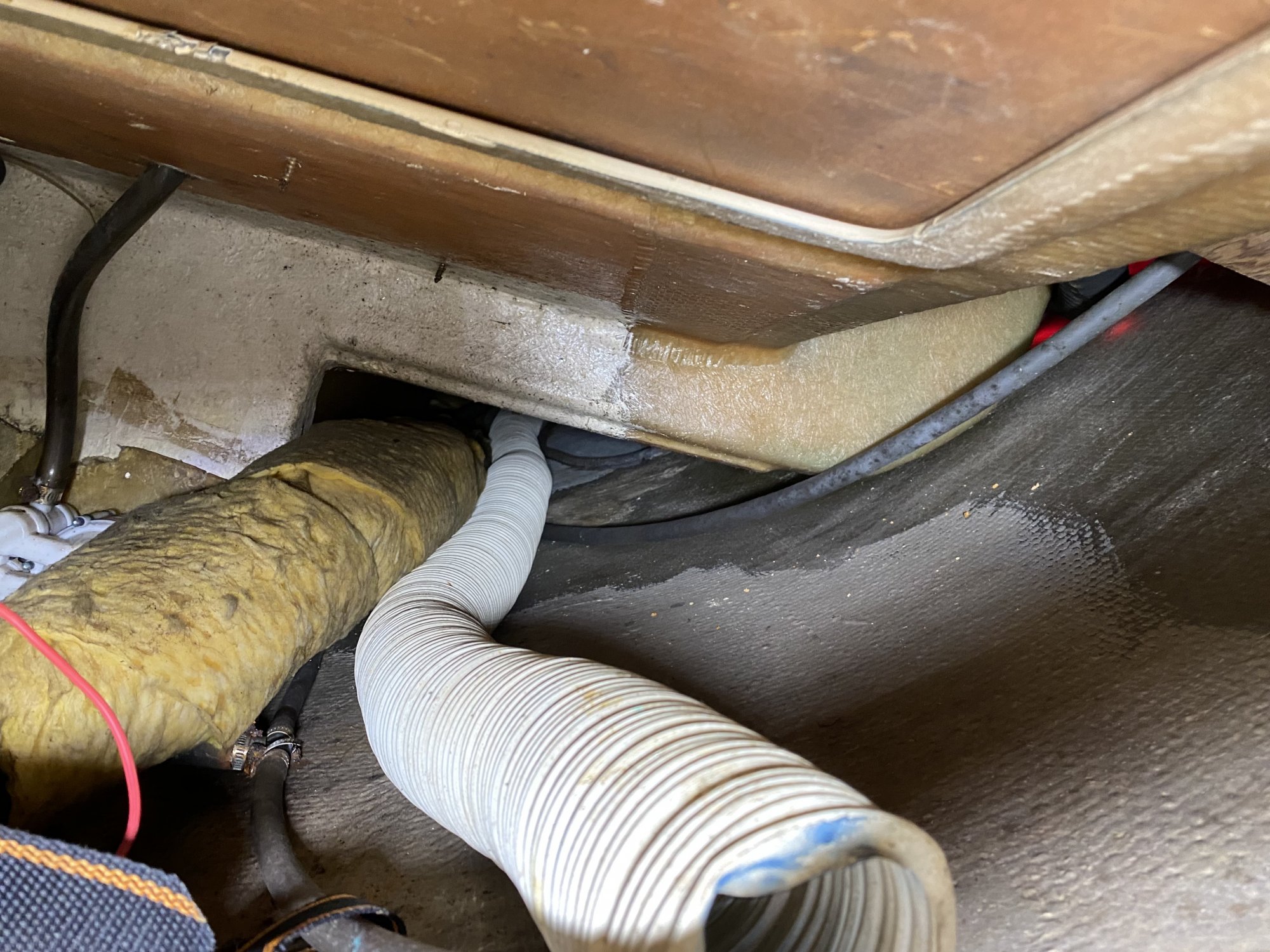

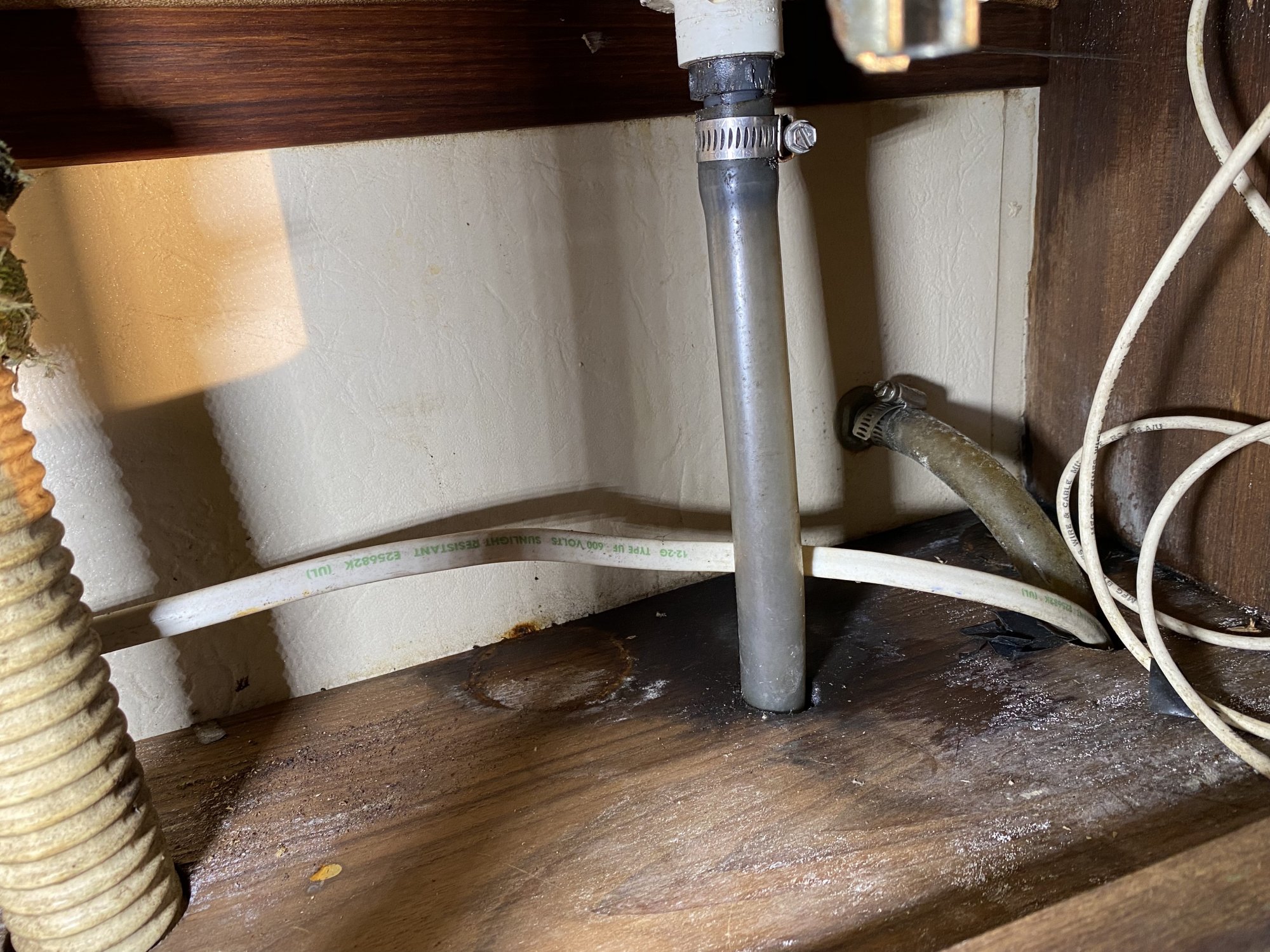

Hi Peggie, I have been reading your book and have been learning quite a bit. We had talked about what hoses when to where so tonight I went hunting and found out some. The B-115 tank is fresh water, with the fill line in the top, an outlet at the bottom and the yellow cap is taped over a small vent hole.
You can see how badly discolored the inlet hose is, I’m not gonna drink from this any time soon.
Here is the other end of the fill hose, it leads right out to the fill port.
Now the crappy part…. I found where the hoses go to the black water bladder. The corrugated hose is the clean out, the yellow looking one is the vent and the nice looking white one goes to the toilet and the dump valves.
Nasty looking bladder
Hoses going through the hull.
Clean out going to the deck level.

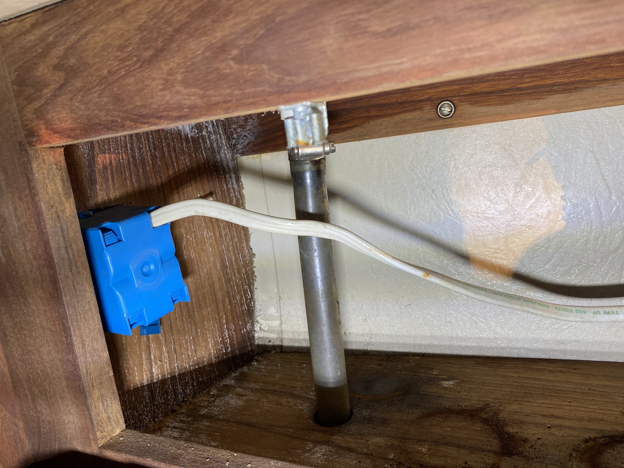

Vent hose exiting through the side of the hull. The vertical hose is the fill for the tank under the settee.

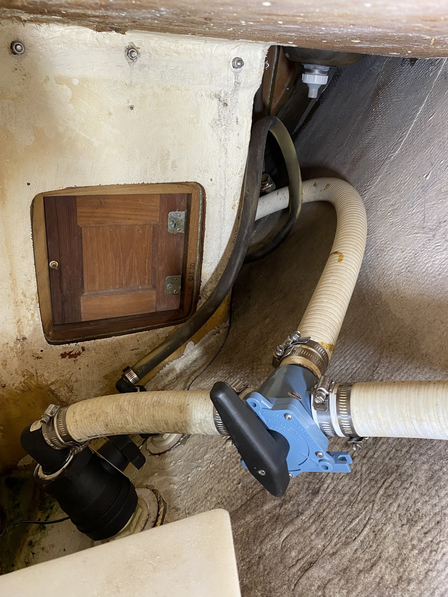

So here are the valves under the head cabinet. I’m guessing the small hose is the grey water overboard, and yes I know my sink has no hose attached right now.

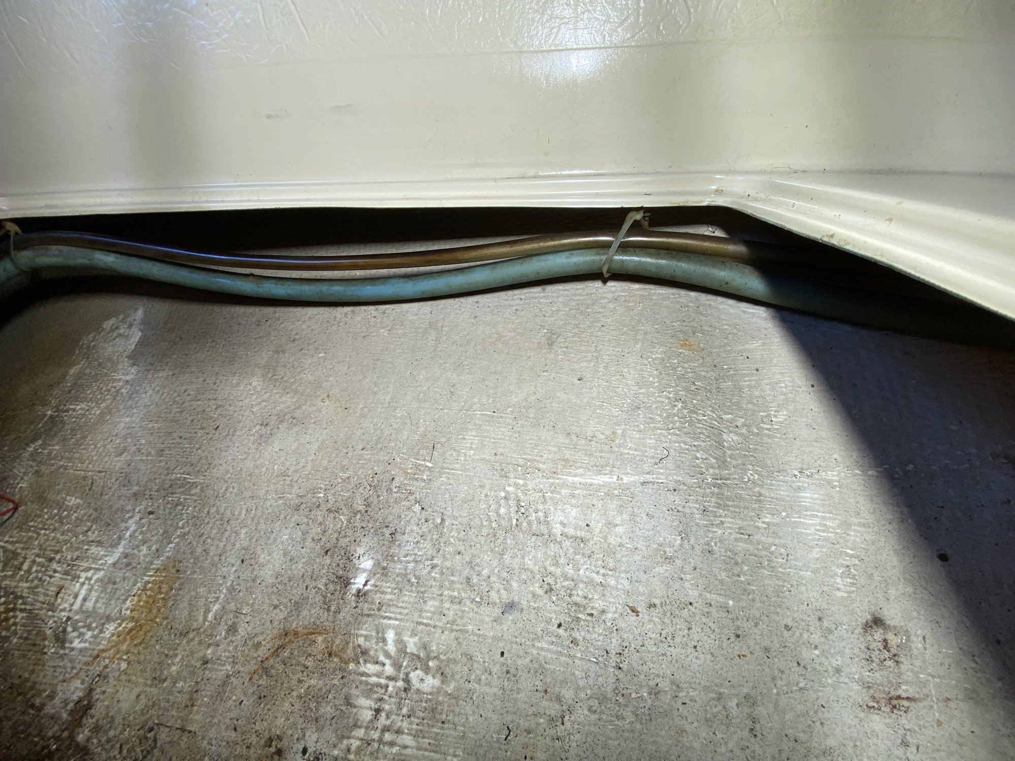

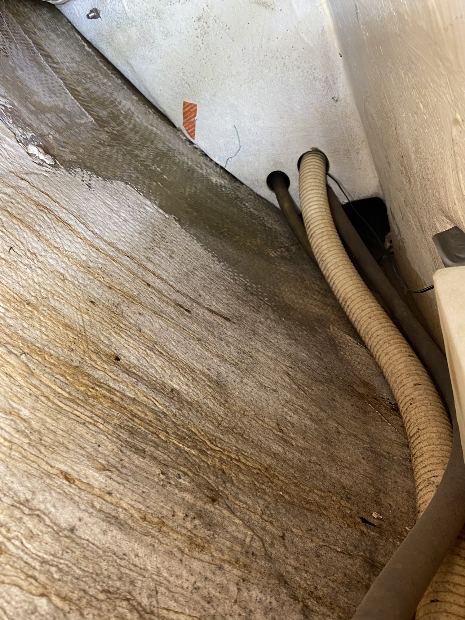

and lastly here are hoses going through the port settee (never had a tank under it) and the last pic is looking aft under the galley.
you can just make out the foot pump, and a few of the water lines going to the sink… again they are old and discolored and will be replaced.
