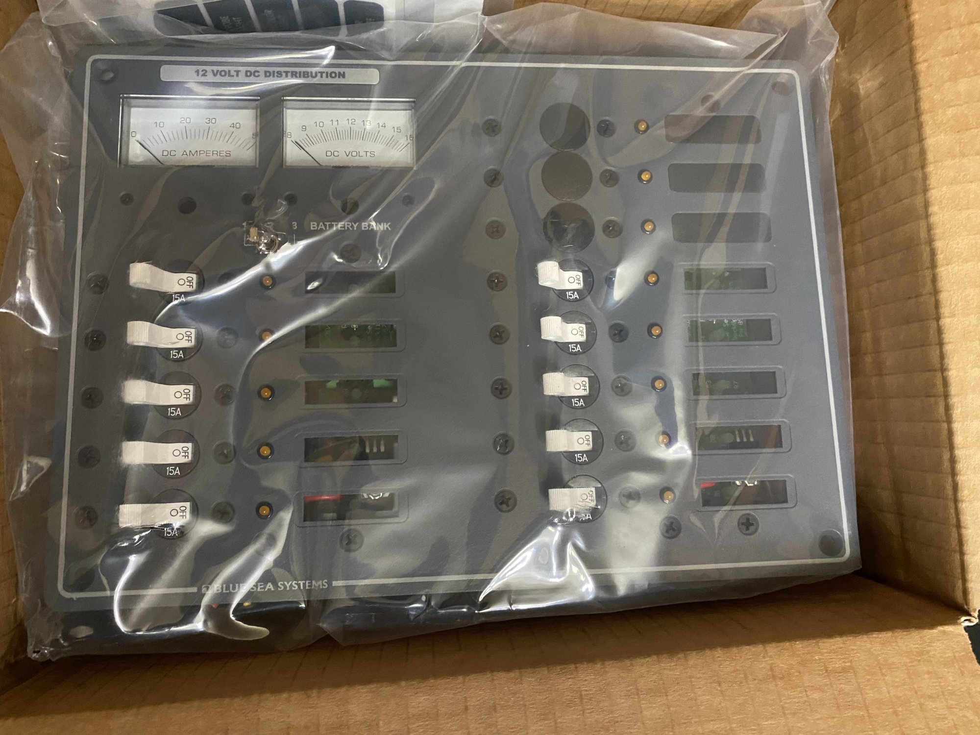

So I dropped a fat stack (as my kids would say) on the boat today. I bought new electric panels. An AC 3 circuit and a 13 POS DC panel that has slots for more switches as needed. I don’t at the moment need 13 circuits but this allows for future updates without making it look like a hack job.

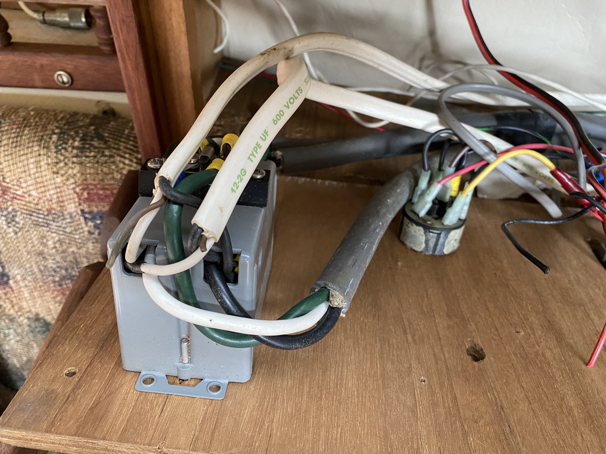

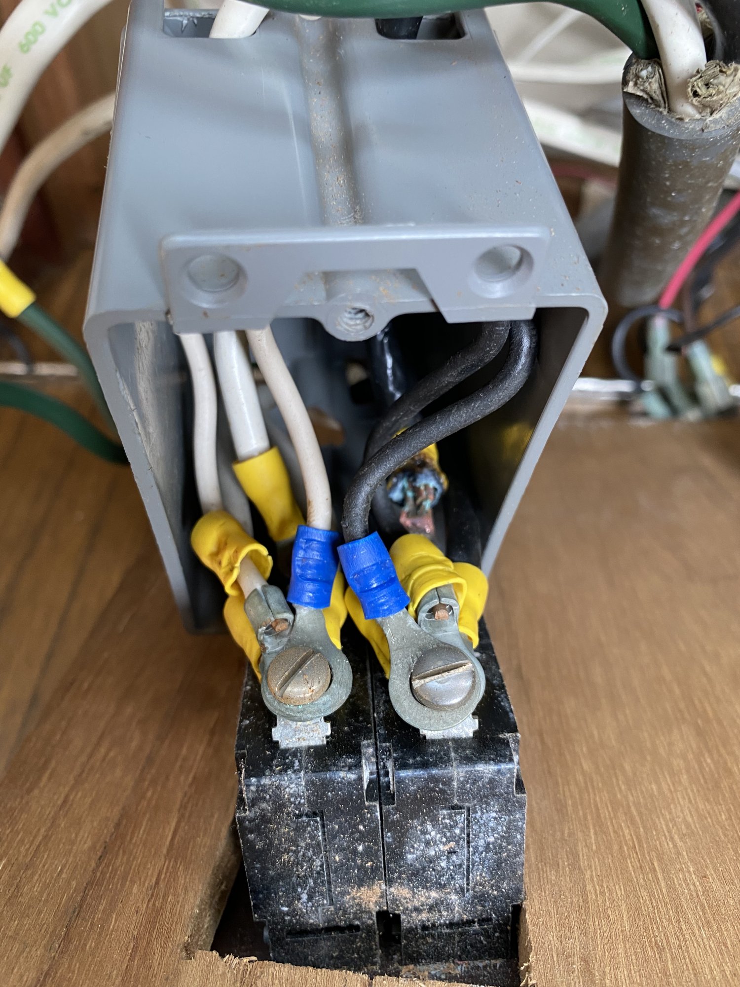

Now for the “shocking” news. This boat is really lucky to be still on the water. Not only did the battery charger catch fire at one point but it looks as if the AC breaker caught fire, or at least got really hot. This is the mess I found when I opened up my panel tonight.

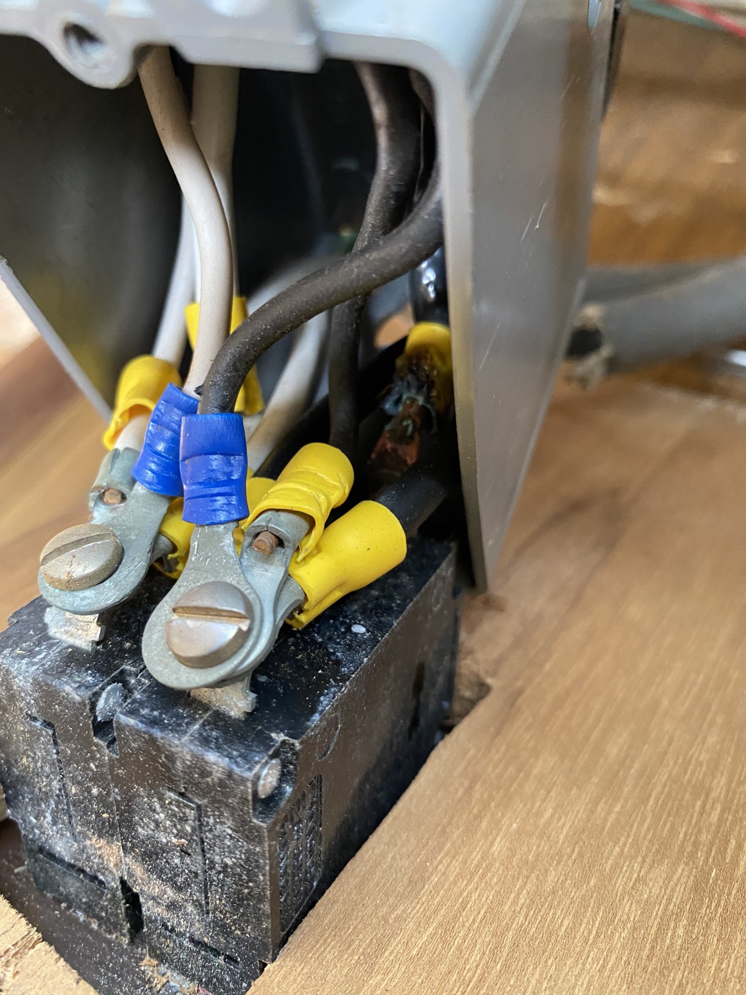

Here is the mess of wires going into the A/C breaker.
here is the mess of wires attached to the out terminals.

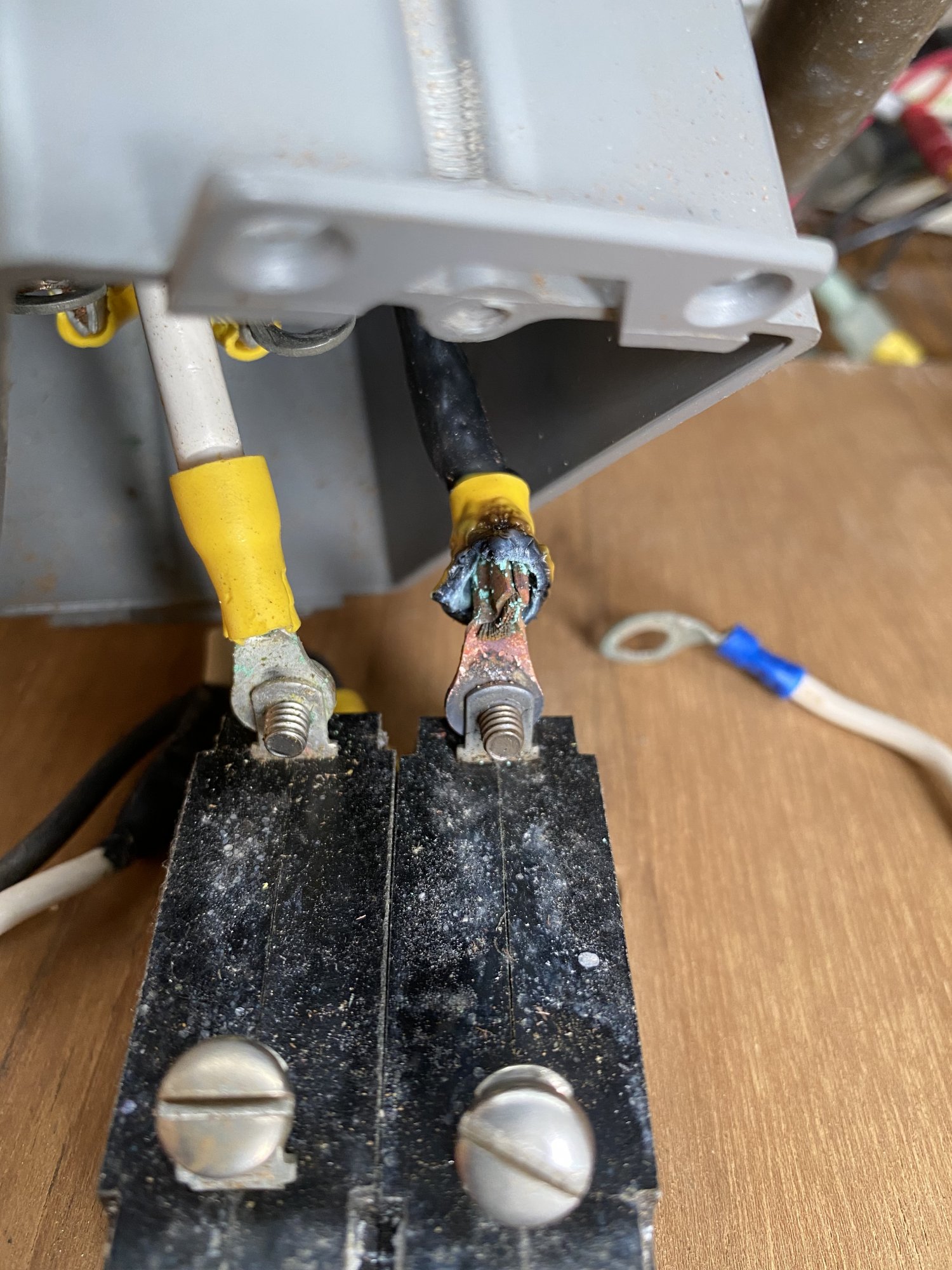

And looky here, the line input is charged and that copper terminal got nice and warm at some point.

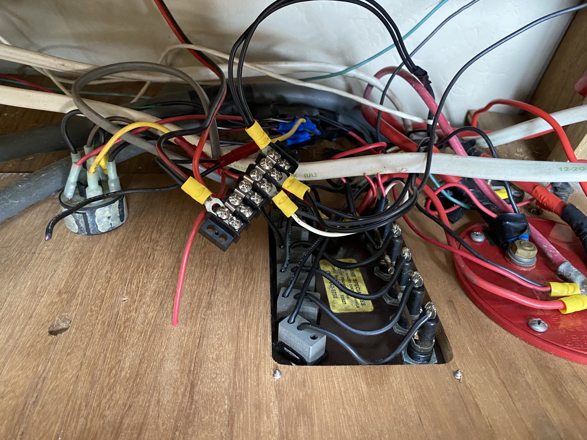

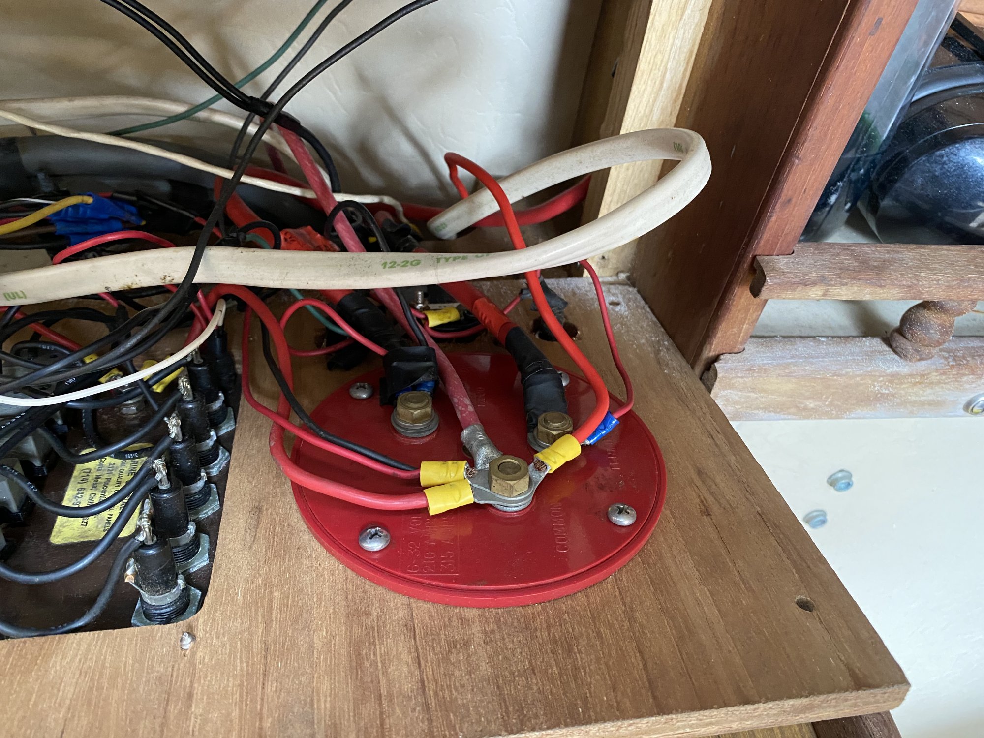

Here is the DC side of the mess. And yes that’s a terminal strip that is floating in space with a couple of jacked up spades.
And lastly my battery 12B/O switch. It doesn’t look so bad… but 2 of the terminals were only finger tight.
I pulled prolly about 5 or 6 lbs of wire out tonight, mostly Statue of Liberty colored.

My C-30's electrical looked very similar. I replaced all of it that I could, new panels like you're doing.
Those old Catalinas were unfortunately wired with untinned wire. Many a corroded connection resulted. The wiring embedded in the deck of mine (for the overhead lights) eventually went bad and I had to be creative with fixes.
That AC breaker looks like a disaster. I hate seeing that many wires stacked on a breaker.

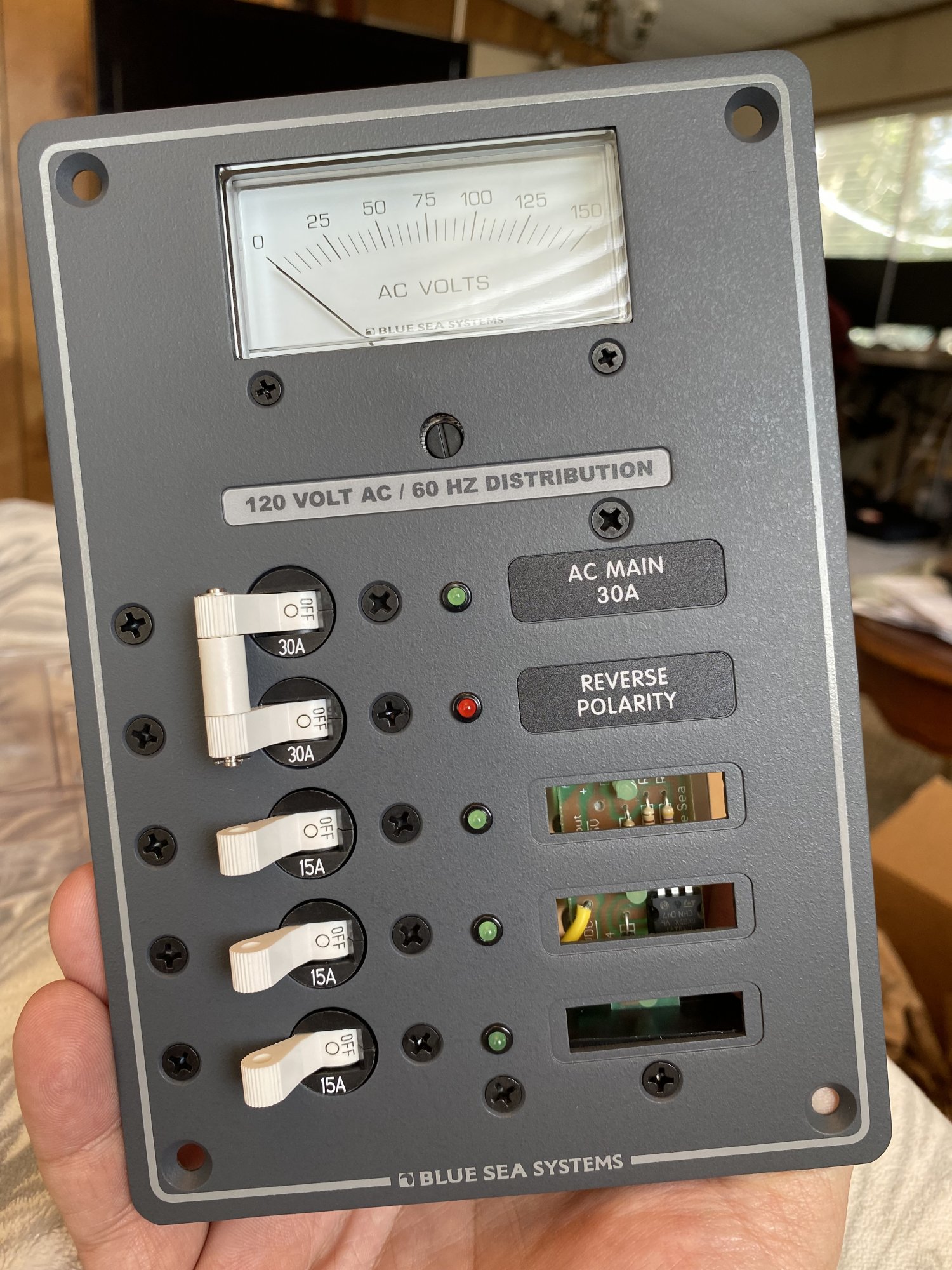

I have a solution to that disaster that just showed up in a brown box that was delivered from a brown box on wheels.

Very nice C Panel.
Just a thought before you install., you might consider the BlueSea
ELCI Main 30A Double Pole + 2 Positions
8101
  • One 30A AC ELCI Main Residual Current Circuit Breaker, leakage trip amperate - 30 mA
  • ELCI provides overcurrent and leakage protection per ABYC E-11 for whole boat shore power protection
  • Red " Reverse Polarity" LED
  • All circuit label positions are backlit
  • "ON" indicating LEDs
It was about $319 at Fisheries last winter.
The SBO Store shows..... Blue Sea Systems ELCI Main 30A Double Pole Circuit Breaker Panel - with 2 Circuit Breaker Positions and Voltmeter

The one I have provides all but the leak detection. I couldn’t find that one where I was looking. I try to purchase locally and Fisheries didn’t have it and it was back ordered for over 3 months already. I got this one from Fisheries and the DC from Seattle Marine Supply. SMS Didn’t have the AC panel i bought or the 8102 in stock either. Oh well. I think I will be good here. I have a fuse block and bus bars also on the way.

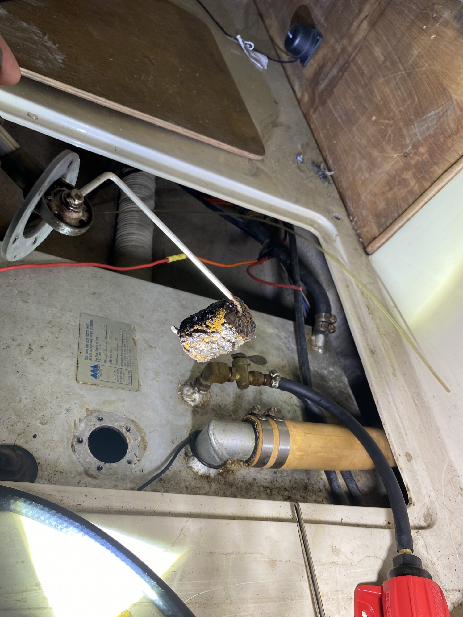

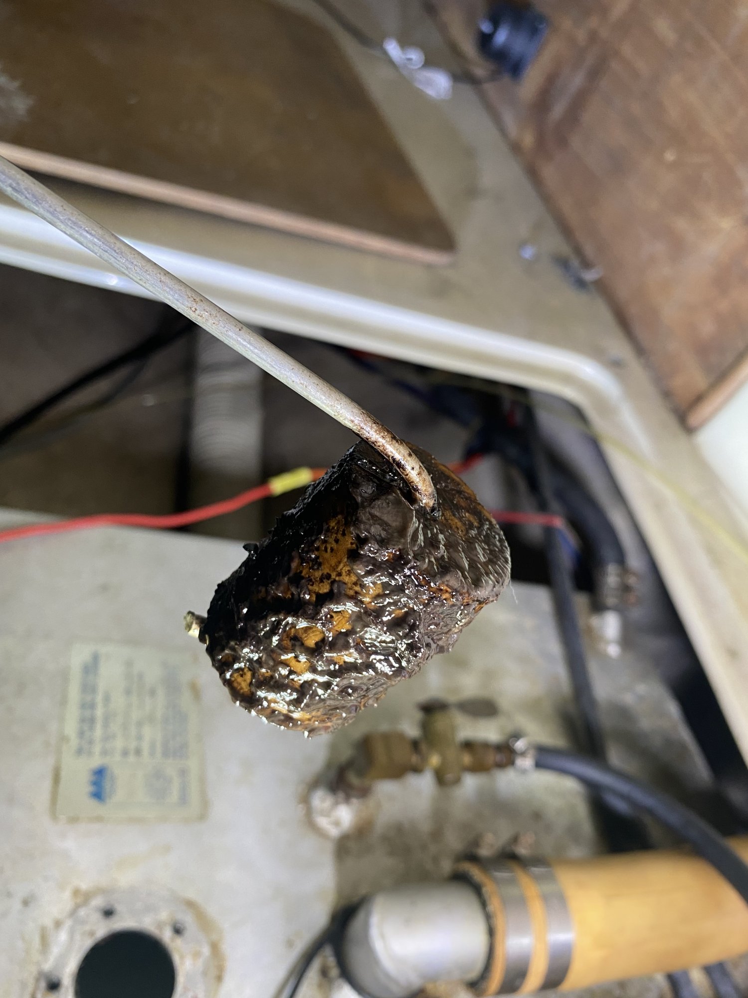

Next I pumped out the rest of the fuel I could, I got about 8 gallons or so out. My fuel gauge showed 1/2 tank but it was empty… I removed the gauge and found the bad… see pic below… but I somewhat expected this, which is why I didn’t want to use this fuel in my engine.
Now this fuel gauge looks like it was part of the boat originally, and it has a magnet that causes the needle on the gauge to turn but that needle only moved from full to half. I found if I flip the gauge around it will go from half to empty. i need to look into this more, or replace it with an electronic sending unit. And then there is the issue with the mess inside the tank…
