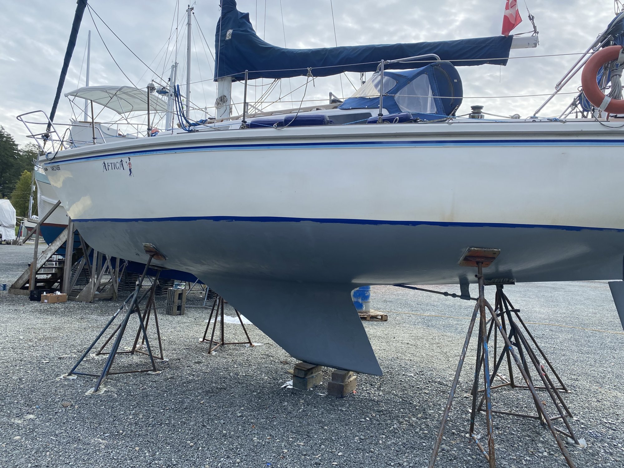

Hey everyone!
I think the odd encounter last week with my hull being sanded/ground unexpectedly paid off, many of the blisters have been removed and seemed dry enough, so Ive started painting the hull with a barrier coat! I think the hull may be painted fairly soon!
Since I have torqued the keel bolts (I have the smile) i got the back 4 torqued to spec, but the front three seem to not hold the torque (i can get it up to around 60-80lbs but the torque seems to drop when i stop) no cracking of the gelcoat but i do see a few drips of water coming out of the smile after torquing. Am I looking at another big project, or could I patch this up and wait until spring?

She looks beautiful!
There have been no reports of keels falling off C30's due the smile. Water seepage may occur however. I'm not 100% certain on that and if it's an issue to be concerned about
If you mean 'no reports', you might want to change the wording to *"very seldom" ... as there was a time in the 70's when they were using a plywood reinforcement in the the sump. Keel bolts when thru that and a thinner-than-optimal layup. The plywood rotted. Not sure if any keel totally fell off, but fixing them was time and money consuming.
An early -70's - Catalina 30 really needs an informed survey before a purchase. Carefully inspect that (very common) "shoebox" type of hull/deck joint also. Out of a large production run there was a report in the early 80's of one (but only one) that sunk off of SF, in large seas due to that seam opening up when the hull was knocked on its side by the seas; all were rescued safely.
Perspective: many production boats have had areas of weakness that showed up one or more decades later. The 'trick' is to build 'em just strong enough but not one dollar stronger in a market where the mass builders were/are in a constant race to the bottom to maintain a thin profit margin.
* There was also the early-production O'Day 30 that totally lost its keel due to similar build problem, in Texas. Rare occurrences tho, considering how many sailboats were built to capitalize on the gas shortages in the 70's, and good surveyors know what to look for.
Opinion: finding an older sailboat worth restoring is actually easier than locating a good surveyor. Unfortunately. :(
The C30's, and if I'm not mistaken, other Catalinas, used wood until 86 or 87 when the Mark II came out
You are correct on both points.
The switch away from plywood in the keel stub did start around 87 give or take a year.
And I agree there are no reports of a Catalina 30 keel falling off due to failure of the keel stub.
O'day had issues with a later production 302 or 320 model where the fiberglass layup was made too thin and failed on a few boats that is well documented.
@aftica_1 Nice progress. Go sailing, enjoy the boat and keep an eye on the keel issue, specifically are the keel bolts sinking into the fiberglass at the bottom of the keel. It may need a repair later when you have the time and funds.
What I don't understand is the torque dropping. That implies that something is moving - it could be the bolt is breaking or the attachment is somehow not stable. Perhaps the hull is compressing or the keel attachment is sliding - neither are good things.
That is not a good sign and one I would definitely want to sort out.
