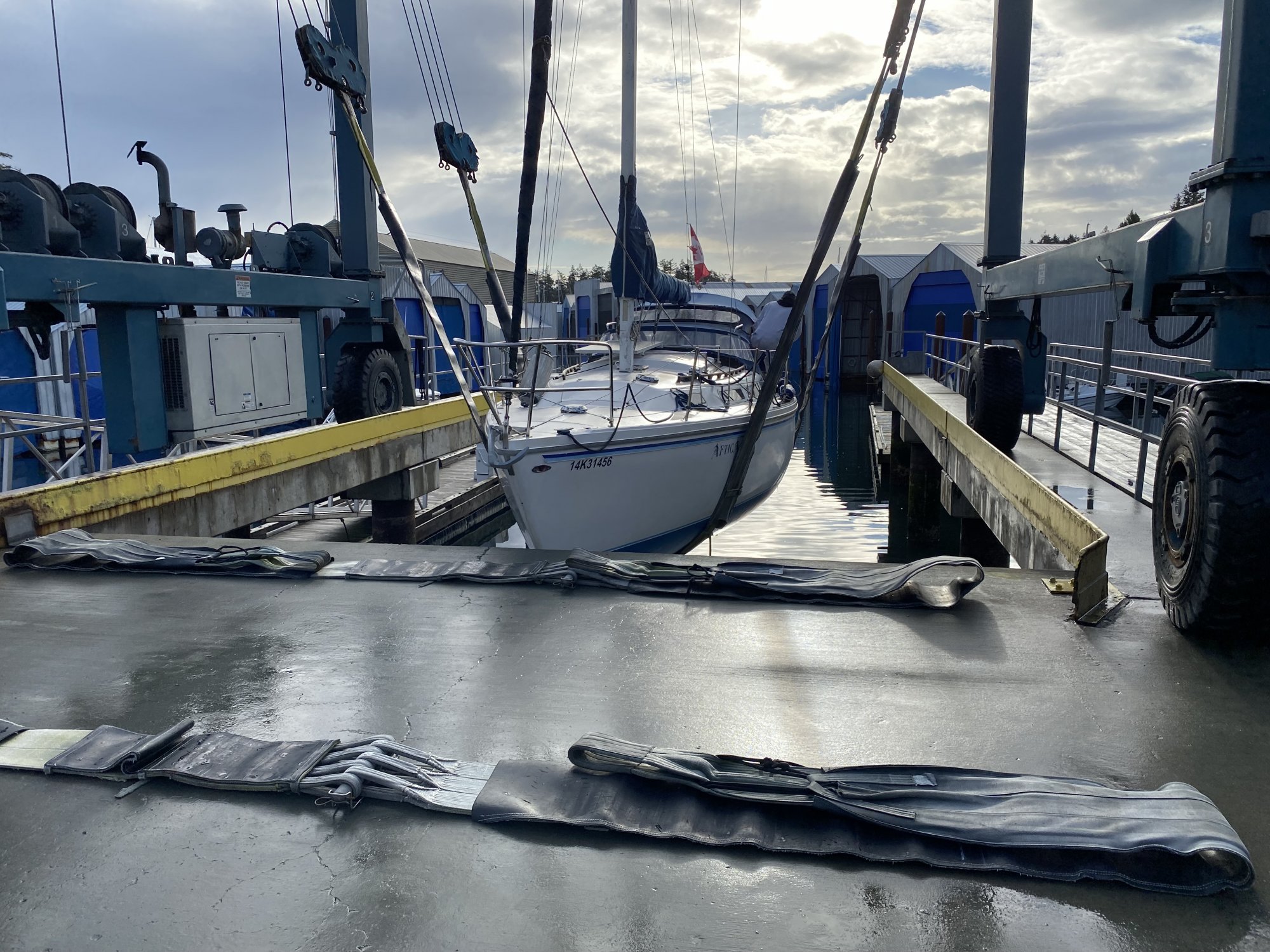

Hello everyone!
I know its been a while, I’ve been working on the boat from dawn to dusk the past week with no breaks but it is finally in the water and back at the marina!
Looks like I’ll be sailing very soon!
thank you to everyone in this thread who helped me through the challenges of the past 2 months. It was more than I anticipated, and I think what jssailem and Bigeasy said is 100% right, I just had to learn it the hard way.
I’ll keep up on the maintenance so it doesn’t get into this kind of state again, and working on the boat so long I have an idea of what needs to be looked at (and not being in a boatyard will help me afford these repairs).
At this point, as long as my seized waste disposal thru hull doesnt fall off before spring (thankfully its seized closed) and my battery charger doesn’t blow up my batteries, it should be smooth sailing for a little while!
