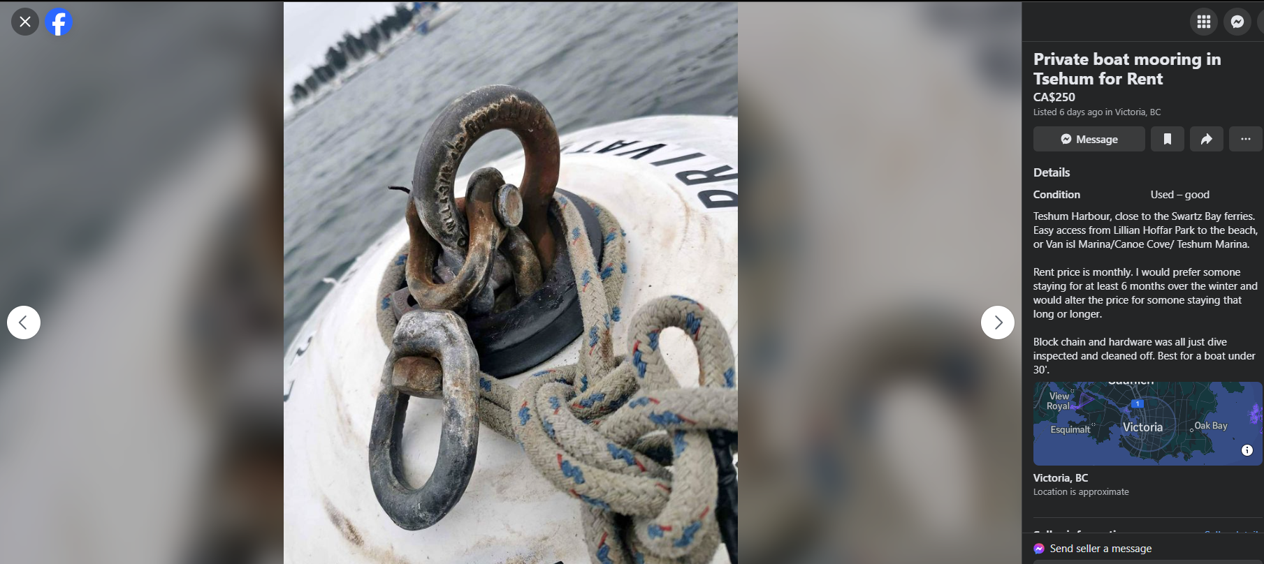

An option if you can't get insurance is to lease a mooring ball in Tsehum harbour.
Like this
Another option is to hire/find someone to help you get it back to Vancouver which I assume is where it eventually will be?

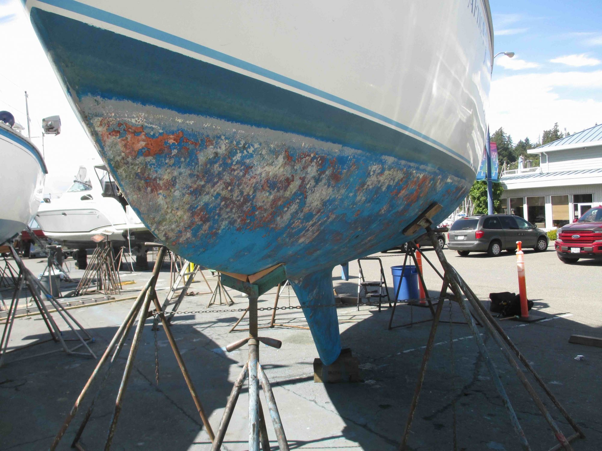

Here is how the hull looked before the blasting
However, now that I have to repair these blisters its going to take multiple weekends of trips over because there are many more steps involved now and I have to work during the week in Vancouver. It also looks like a lot of the initial steps are weather dependent.

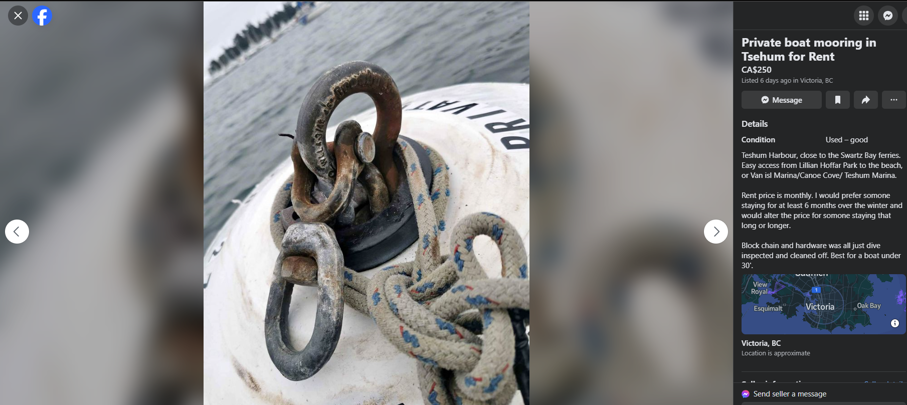

Like this
