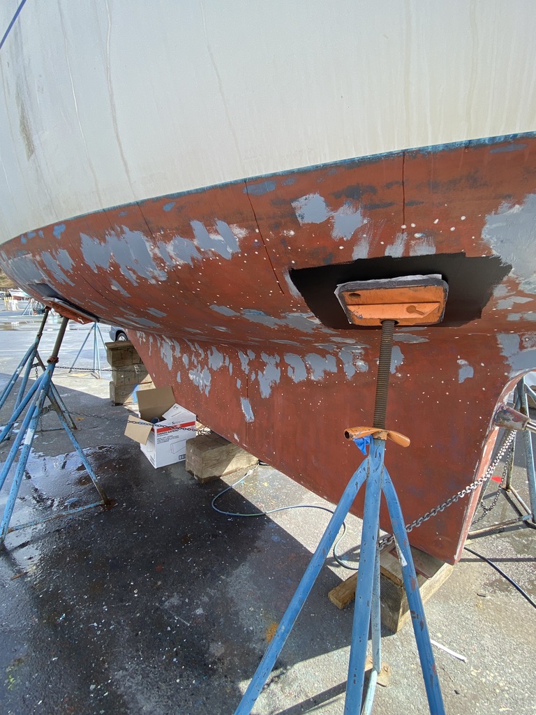

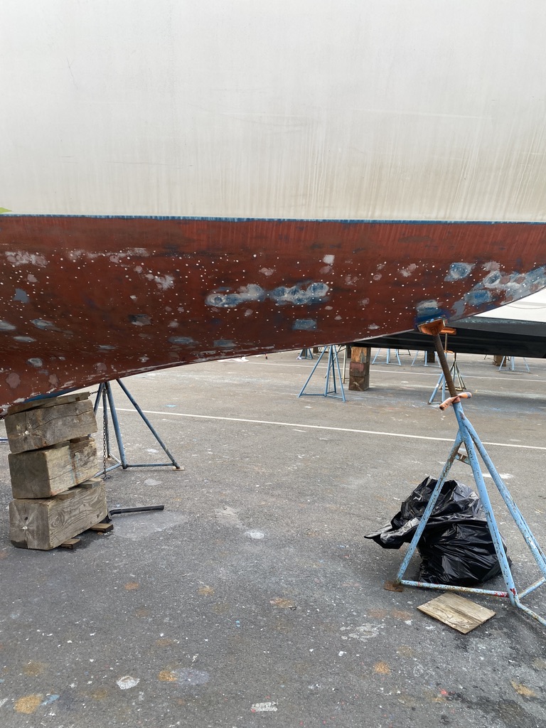

I'm sorry to see you in such a position.
I believe you said that the boat had been sandblasted, is that correct? If so, that could be part of your problem, if the blasting is through the gel-coat. It normally requires as much as 6 months to dry a bottom (especially in BC) before repairing the blisters. Perhaps, after you have found a suitable place to work on her or have her worked on, you can find someone who can use a vacuum covering to speed up the process.
I would suggest that you contact a reputable boat sales broker in your area and ask if they could suggest a good small boat subcontractor to help you do the job correctly, so that you do not make another mistake (like sandblasting a fiberglass boat, if that is actually what was done), and source labor and supplies.
If you have exposed fiberglass cloth below the waterline, I would not move her by water on her own bottom. There are boat movers who could do so by road, but that can be very expensive. It might be much more cost effective to hire a tug and barge, and a crane for a day, because you won't have to unstep and restep the mast that way. If you get creative and think outside the box, you might be able to get through this somewhat less expensively. Good luck.

The gelcoat is intact except for where the blisters were popped. its still all white on the bottom. On the painting, I was planning to do a barrier coat as well, but with that I also get conflicting results from - it will take a weekend, to it will take several weeks.
The bottom blast was my attempt to get it fixed properly (and was recommended as a way to "do it properly"). Do I really need to blast it again in a year to "do it properly"? and even then, what does that mean? Should I plan to sandblast every 2 years? Is doing it myself not "properly done"? What if I screw up? Does anything actually happen at all or will I sink in 10 minutes or less?
Even in this thread I am completely confused. If I follow the advice I got in real life, its not a proper job and I have to do it again, but a proper job isn't required because its a 40 year old boat? I'm just trying to put some paint on the bottom so I can take it out...

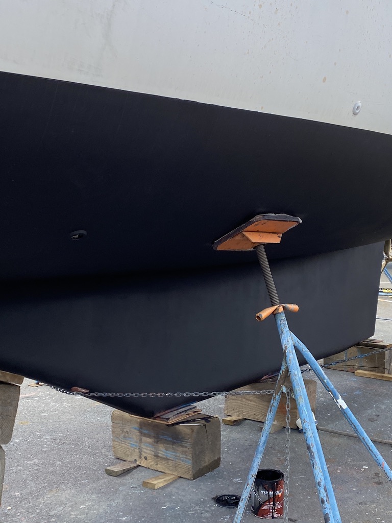

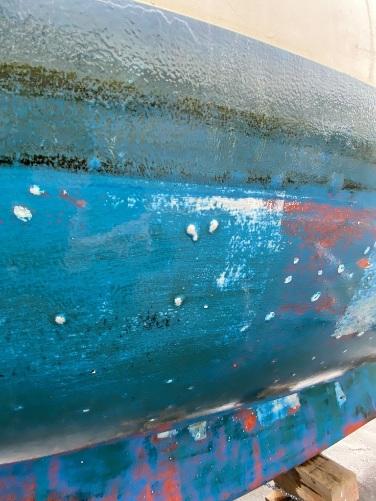

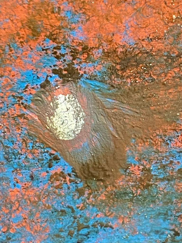

Here are some pictures.
Here are images at the 2023 haul out. The boat was last painted in 2017.
The hull was sanded with the big blisters opened up
Epoxy filling, then light grey epoxy barrier coat applied to all blistered areas.
Finally, what it looks like after the bottom paint has been applied. When the boat was lifted, additional paint was applied to the bottom of the keel. Then the boat was launched.
