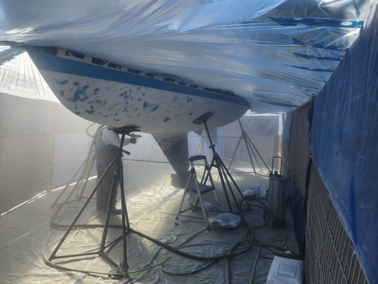

Hello Everyone,
Thank you for the kind words! I had to take a few days to collect myself.
The bottom was soda-blasted, not sand-blasted, and the only reason I did it was because no one wanted to paint my boat's bottom otherwise, but they seemed receptive if I either scraped the bottom myself, or got it soda-blasted. The gelcoat is still intact on the hull, minus a few areas where the blisters came off during the process.
Here is a photo showing the hull after soda-blasting (and the worst part with the blisters that did get removed). They are not deep, surface level, according to the soda blaster. He said 1-2 coats of fairing after letting it dry for a few days would be fine, then just paint over it. The rest of the blisters were not popped and he said there shouldn't be any issue with me just applying an epoxy barrier coat, antifoul, and just repairing the blisters over time, as they become a problem over the years.
Now that its soda-blasted, I am being told by the same people that the cost to fix the blisters and paint the bottom will be more than the value of my boat.
I honestly think I'm being taken for a ride. Please someone tell me if fairing the bottom and painting over my boat would 1) sink it due to the blisters underneath and 2) would actually cost over $20,000 to make it float in the water with paint.
That’s probably the approach I’d take. It’s a compromise between the ideal solution of grinding and filling everything, and the slapdash approach of just painting over it all. If the existing blisters worsen and the barrier coat fails you won’t have so much invested that fixing it properly is too much of a waste, and it gets you sailing relatively quickly and safely. A yard’s labor is expensive so I’d expect that to cost several boat bucks ($1000 each), but the $20,000+ estimate sounds more like the gold standard of grinding everything down, a long dry time, and rebuilding it all. The better option for a job like this could be DIY to save on the labor cost. My very rough guess (a dangerous thing with boat projects) is that it’d be possible to get the popped blisters faired and the whole hull barrier coated and painted in maybe 3 weekends, weather permitting.
IMHO, Yes you are being grossly overcharged. But I do not live or recreate where you are, so my experiences are of very little help. That quote sure does seem like three times too much, to me.
Do understand that "fairing" can mean a half day or a week of labor @ $130/hour. My experience has been that yards estimate "fairing" dependent on the customer's wishes. Often there are some areas to smooth with thickened resin, but not much over 2 or 3 square feet. And then it's a part of a day. Or, the whole boat bottom starts out looking like "the surface of the moon"... Yikes. I have seen that in the yard sometimes.
Usually, when getting a new bottom paint job bid, it's kind of a comparison between more raw time in the paint removal part vs time to fair and sand individual divots and areas where the previous paint was poorly adhered with too many layers.
Personal preference is to take it down to gel coat (or previous epoxy layer) with a vacuum sander and start over. That assumes that the previous paint was reasonably well adhered. Our current bottom paint is expected to last 8 to 10 years, so that does kind of amortize out the cost of the next boatyard bottom paint visit.
Oh, and you certainly did not ask, but try to remember that work done professionally costs the same per hour or per job whether the boat is an inexpensive (20K) older production boat or a newer (200K) vessel. That is why most us became DIY repairers so that we could afford to sail a larger boat. We had to find a solid fixer-upper, and its high end construction has served us well, over the years.
(We have owned the same boat since 1994, and have probably put several times the purchase price into it for maintenance and upgrades. Note that I use the word "put" and not the word "invested" ....! ) :)

Cleaning up the worst of the blisters should be 6-15 hrs max (unless you have thousands of them, which we can't judge from our screen....). You'll then need to sand, then barrier coat (interprotect 2000), witness coat and final bottom paint coat. So about 10-12 hrs of painting and prep.
So let's say 25 hours to be safe x $135 per hr is $3375. You then have another $1000 of paint and fairing compounds, plus another $200-$400 ish of supplies (rollers, tivek, goggles, tarps, etc...).
Now at most yards, sanding and painting is unskilled labour, should be around $75 ish per hour.
So $4800 ish at the top end, for labour and supplies (not including yard fees). For reference, in a cheaper yard (Texada), I was quoted $2500-$3500 for a similar job on a 28' sailboat.
I'm sure that for $20 000 it would look like new .... but that is probably not what you are going for? Talk to your contractor and explain that you just want it sealed, but you aren't looking for the perfect racing hull. Did you ask them to fair the bottom? That would be a really big job. I would just fix the worst / larger blisters and move on...
If you were to float it, sail across the straight and haul out 2 days later in Vancouver, your boat would be none the worst for wear.
Unfortunately, there is no relationship between the cost of repairs and the cost of the boat. In truthness (is that a word??), a really cheap boat can be a really expensive boat if it needs mechanical, hull and rigging repair.... Hopefully all these repairs were reflected in your survey and the price reflected the condition oof the boat. Now here's where it gets funny..... Let's say you bought it for $35 000, then spend $20 000. You probably still have a $35 000 to $40 000 boat.... replacing the mast on a 3 yeaar old 35 footer and a 20 year old 35 footer costs the same!
Keeping things in running order doesn't add that much to the value of the boat, but it allows us to keep enjoying and using our pride and joy. We just look at our annual maintenance bills as the cost of our vacations!

Thank you to everyone for your help.
I think its time for me to throw in the towel.
I bought the boat for $20,000, have spent nearly $10,000 trying to get this thing painted and with no help available I just can't continue. Its going to cost me another $10,000 to $15,000 to do it myself all costs factored in (just for bottom paint, I can't image what it will cost to replace my rigging if needed - $75,000-$150,000?). I was continuously told a bottom paint would only be about $3,000, and the continuous advice I've followed from sailors in real life has just brought me closer to bankruptcy without any progress.
If someone needs parts from a broken dream, the Catalina 30 will be in the scrapyard in Sidney soon.
