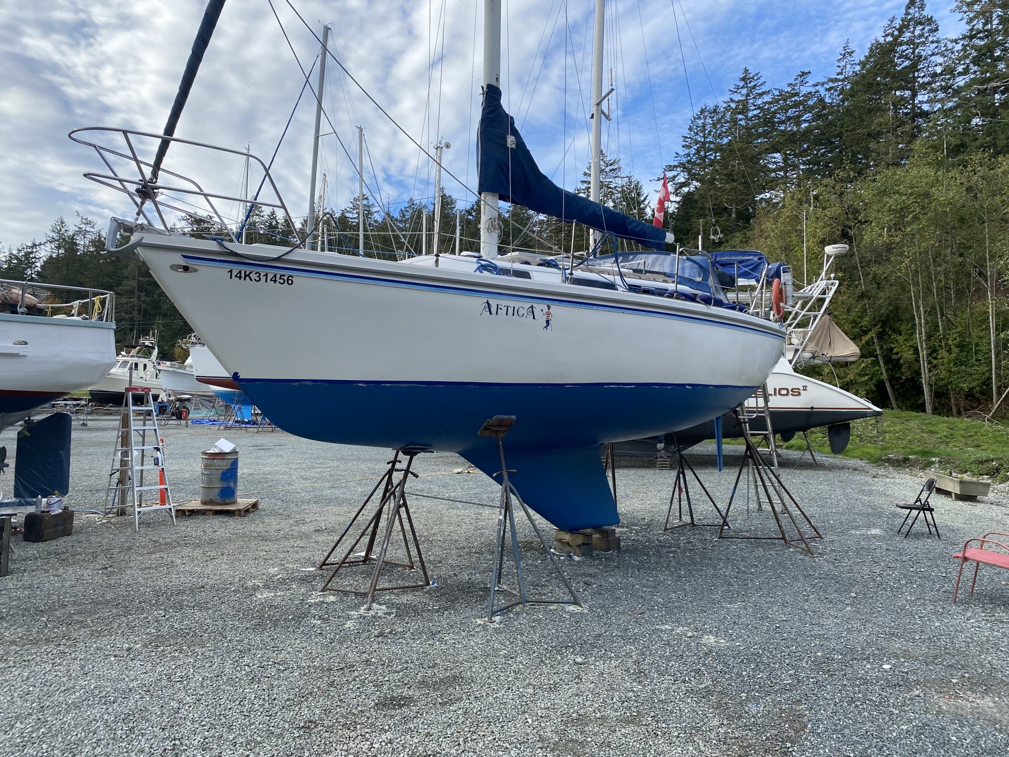

Here is the boat currently!

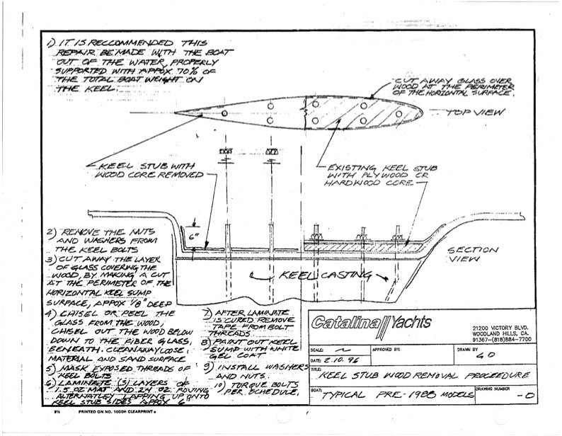

The C30's, and if I'm not mistaken, other Catalinas, used wood until 86 or 87 when the Mark II came out
I had an 87 MK-II and it definitely had wood in the stub. It was bone dry, but wood nonetheless.
I believe the change happened in 1988, though I can't say whether some of the '87 boats also had the all-glass stubs. But mine most definitely did not.
Nov 22, 2011
1,303
Ericson 26-2 San Pedro, CA
If you mean 'no reports', you might want to change the wording to *"very seldom" ... as there was a time in the 70's when they were using a plywood reinforcement in the the sump. Keel bolts when thru that and a thinner-than-optimal layup. The plywood rotted. Not sure if any keel totally fell off, but fixing them was time and money consuming
The switch to all-glass keel stubs occurred around 1988. I was very active on the Catalina 30 list for the 10 years I had my boat and there were no reports of keels having fallen off. The repair is messy but not especially expensive or difficult. Catalina issued instructions on how to do it.
I just checked to see if I have the repair instructions from Catalina saved on my hard drive, but I do not. These files were readily available through the C30 forum I was involved with at the time. I probably did not bother to save it because my boat had no issues with the keel stub. But I do recall seeing the document at one time, and that the fix involved simply chiseling out the wood and laying glass in its place. It was hardly rocket science but more of a messy annoyance, as I recall from the posts of a few members who found themselves having to do the modification. Thankfully Catalina got rid of the wood in '88 or so, eliminating that as a potential failure point in later boats.

Here is the Keel Stub Repair document from Catalina Yachts
If the sump remains wet while in the water & keel exhibits a big smile, seems that it would be prudent to drop keel while removing the plywood core & glassing the sump. Only positive is that with the advent of multi / oscillating tools, should make the job much easier with the variety of blades, scraper, & sanding attachments available.
