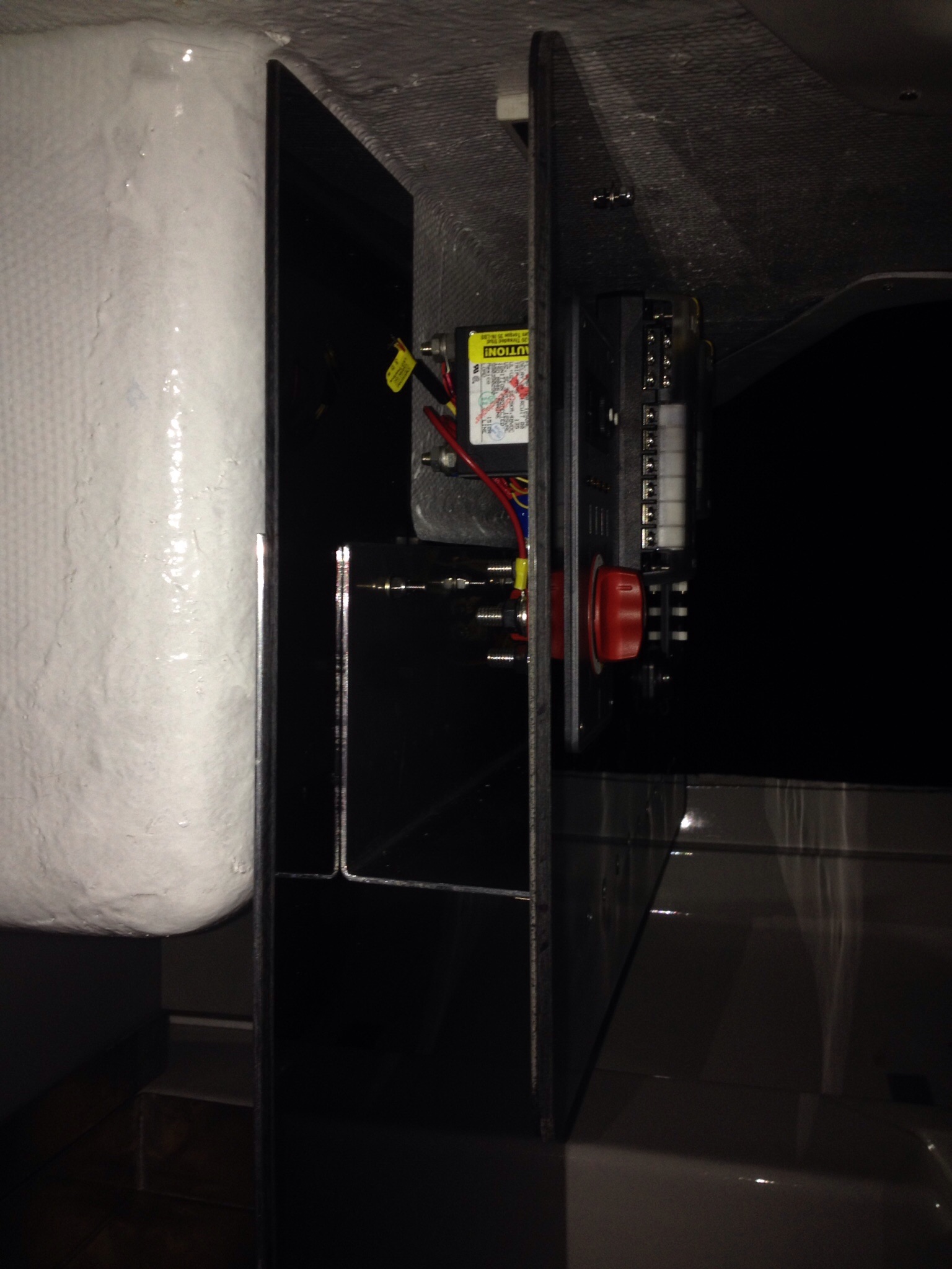

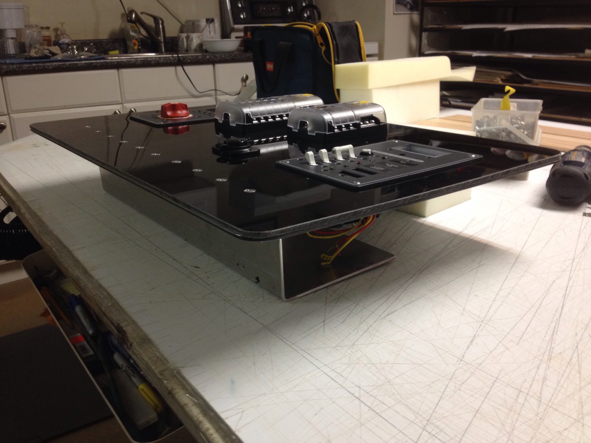

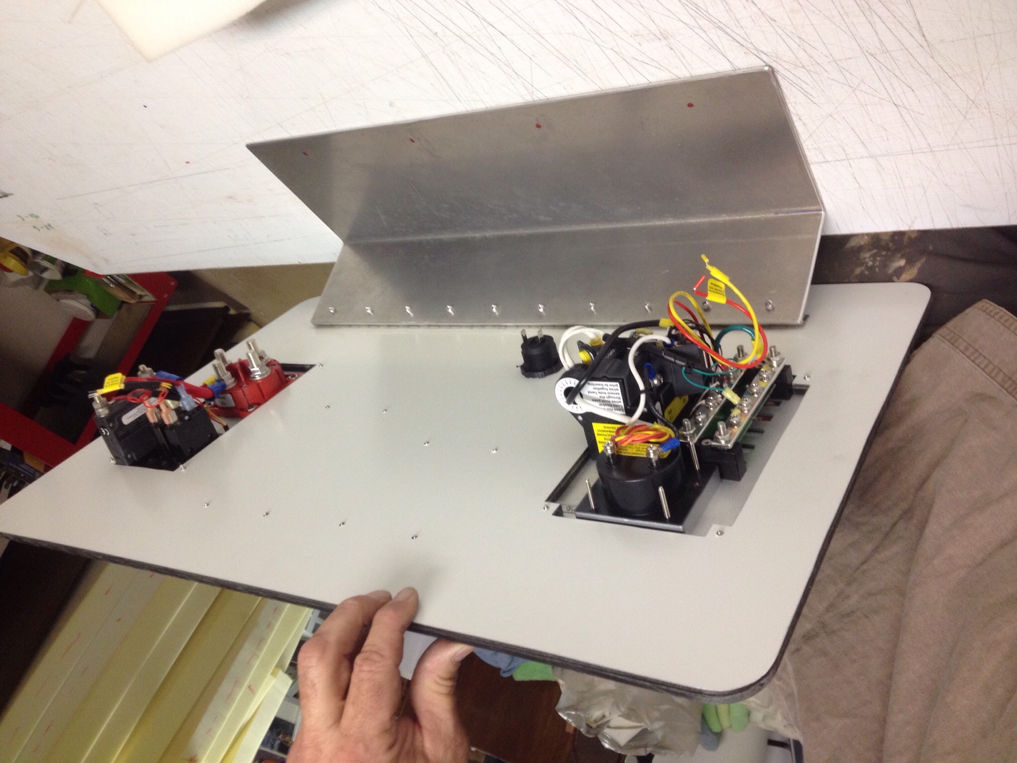

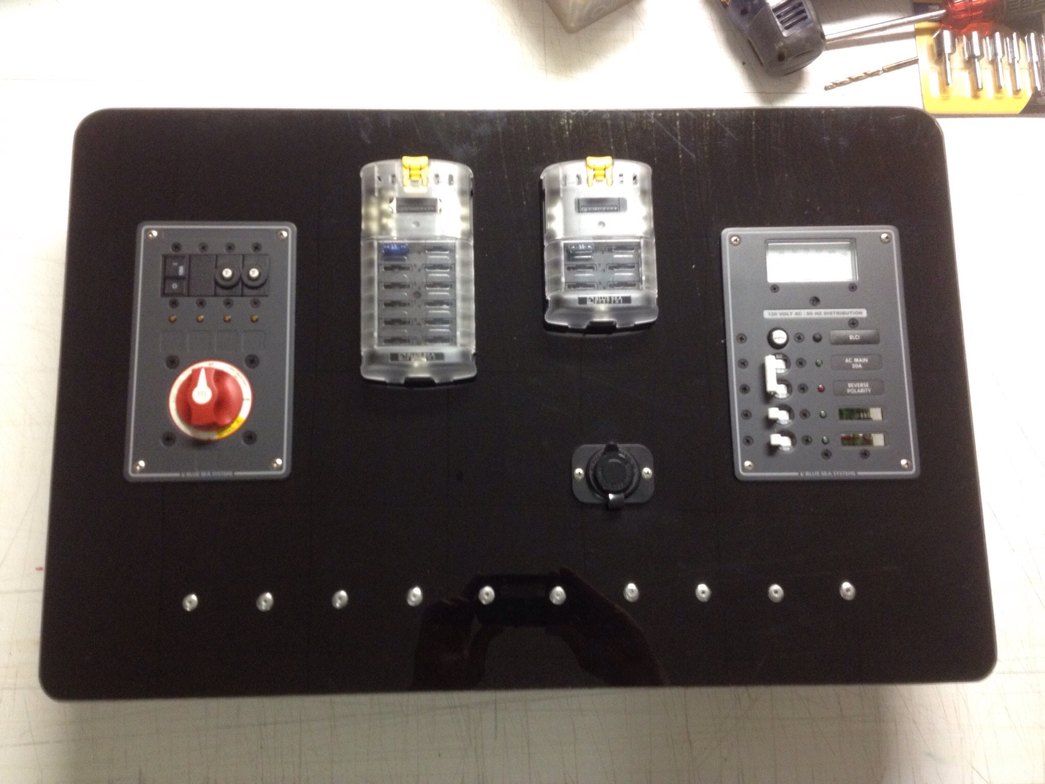

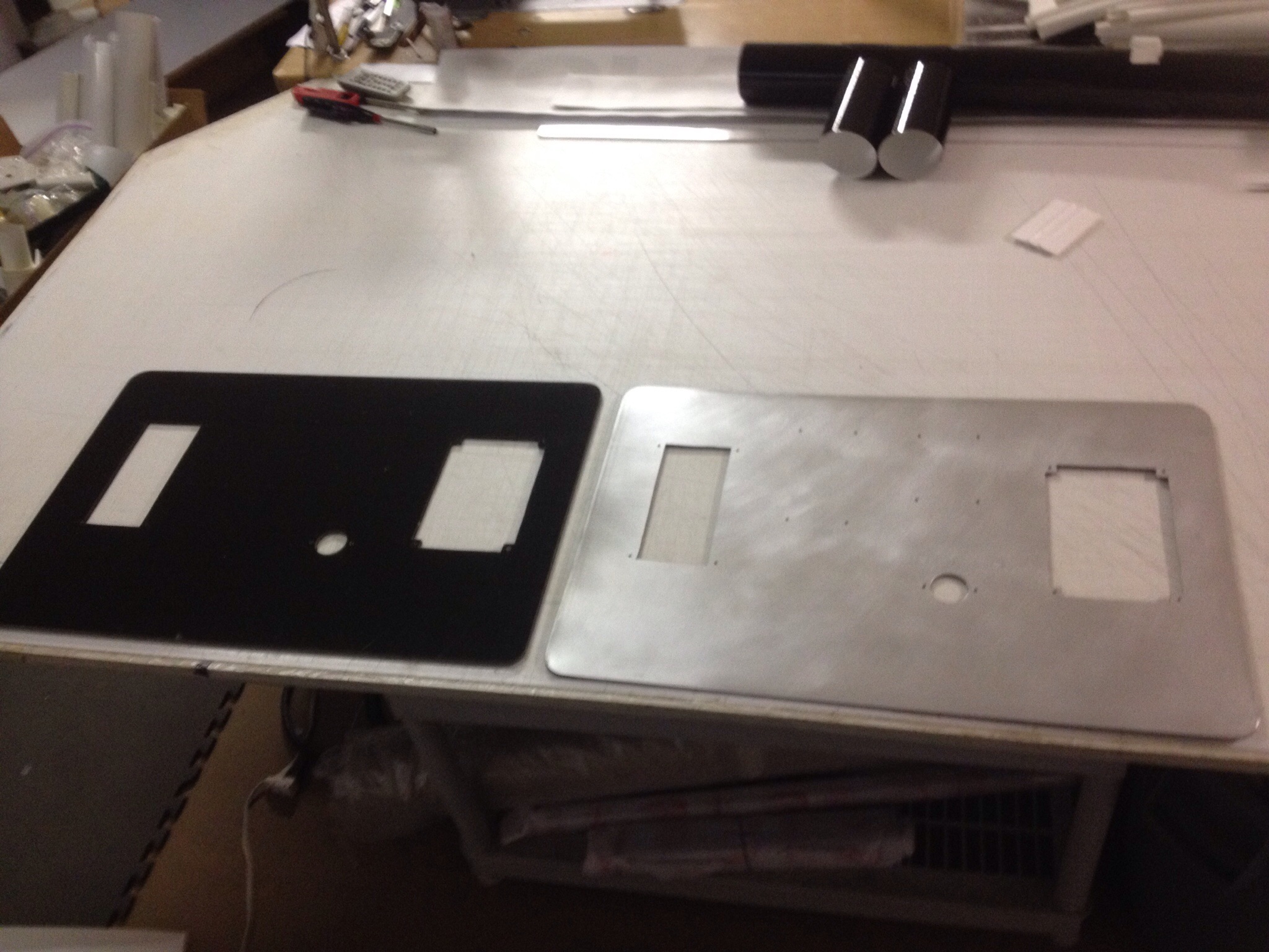

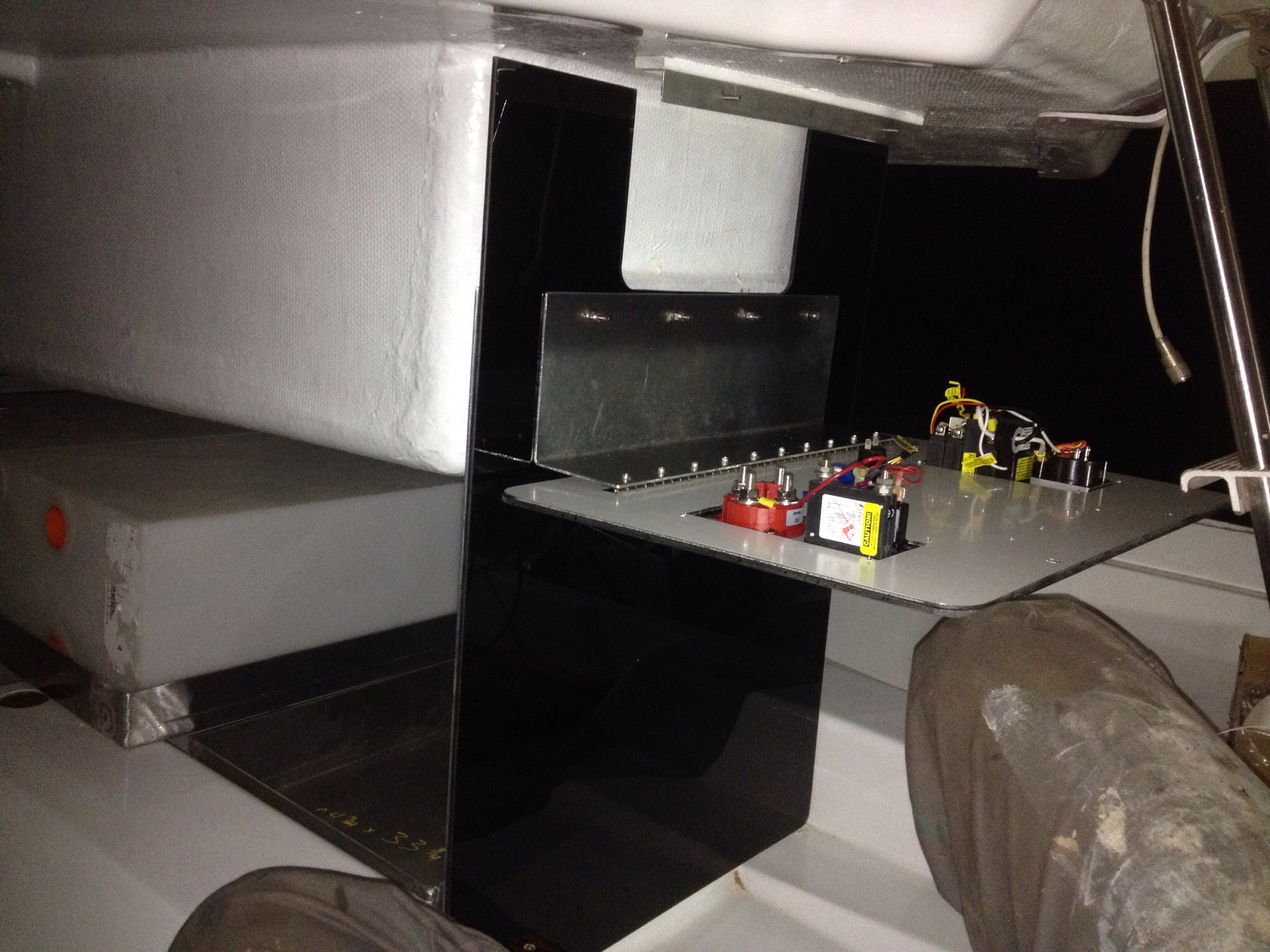

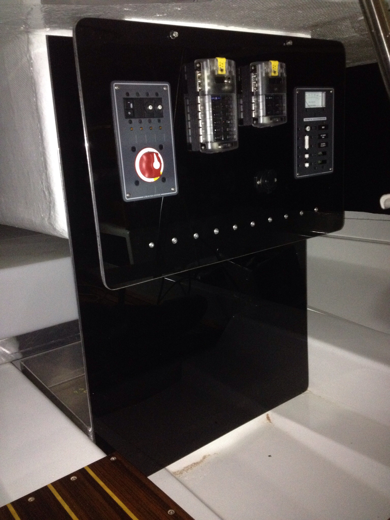

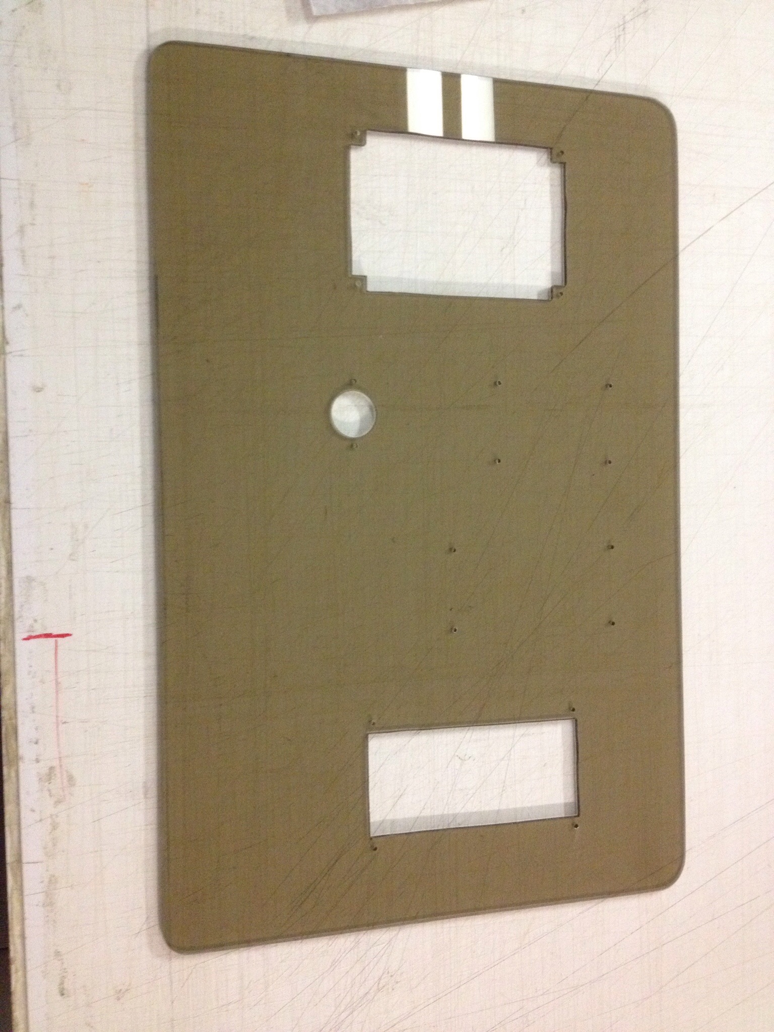

More electrical panel assembly.

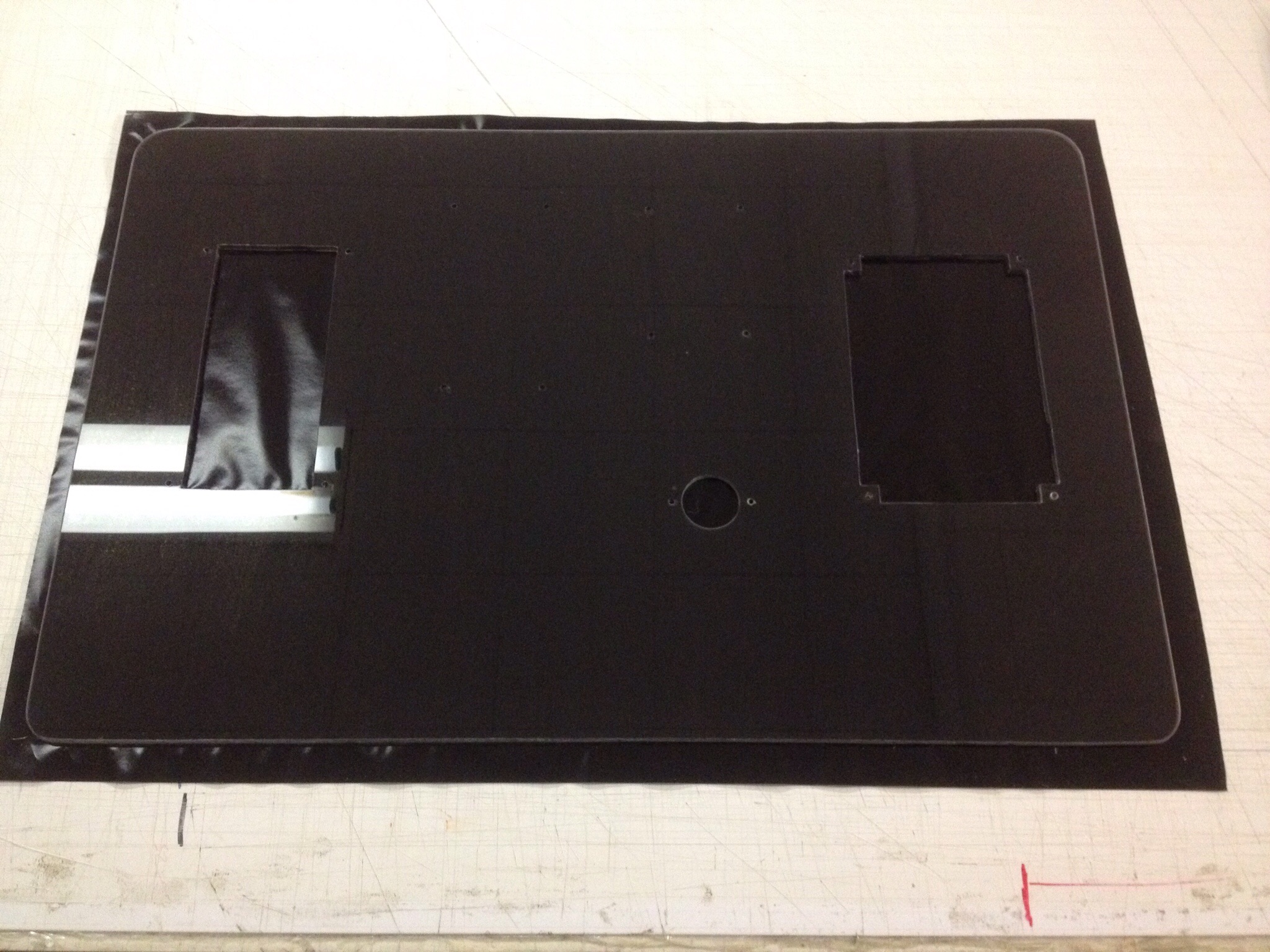

Lightly tinted polycarbonate (want it much darker!)

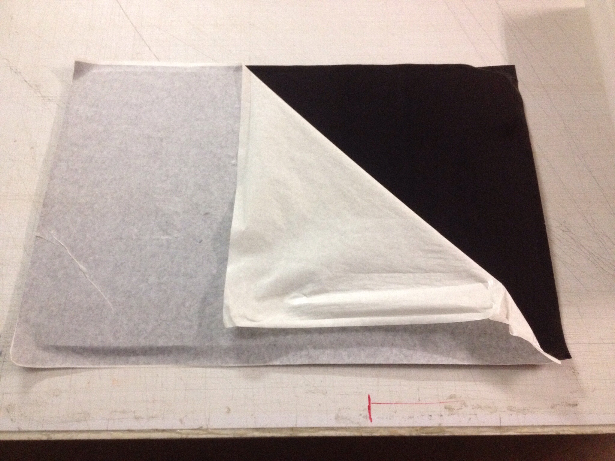

Applied thin high quality gloss black vinyl to both the panel and the cockpit support, between the poly & aluminum.

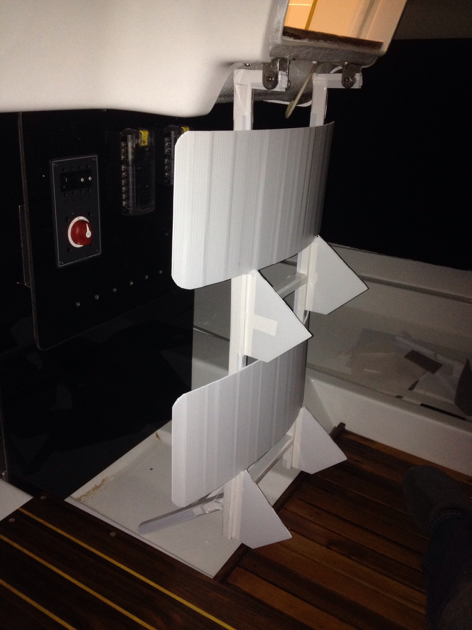

Feb 11, 2012
271
C&C Mega 30 Long Point, Lake Erie

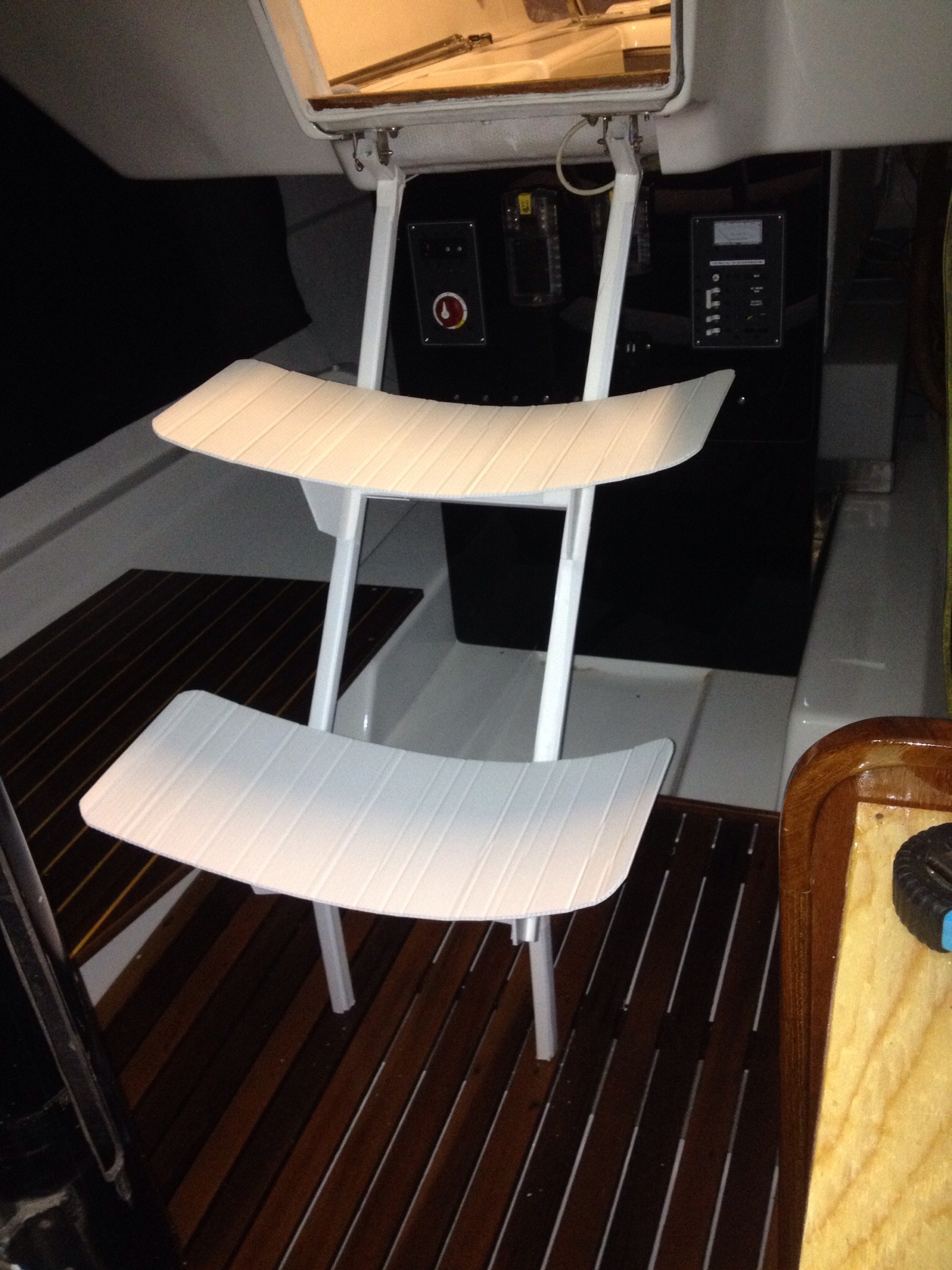

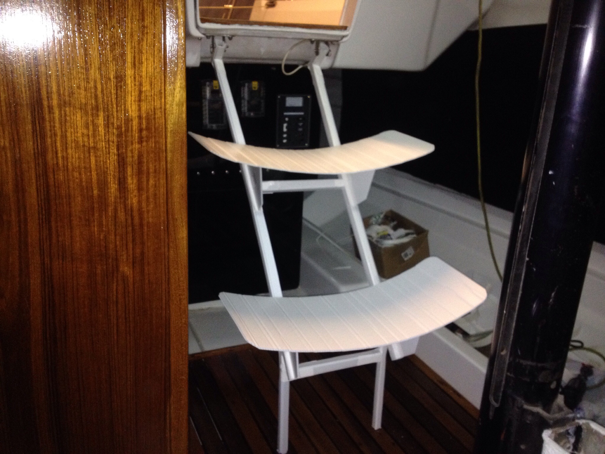

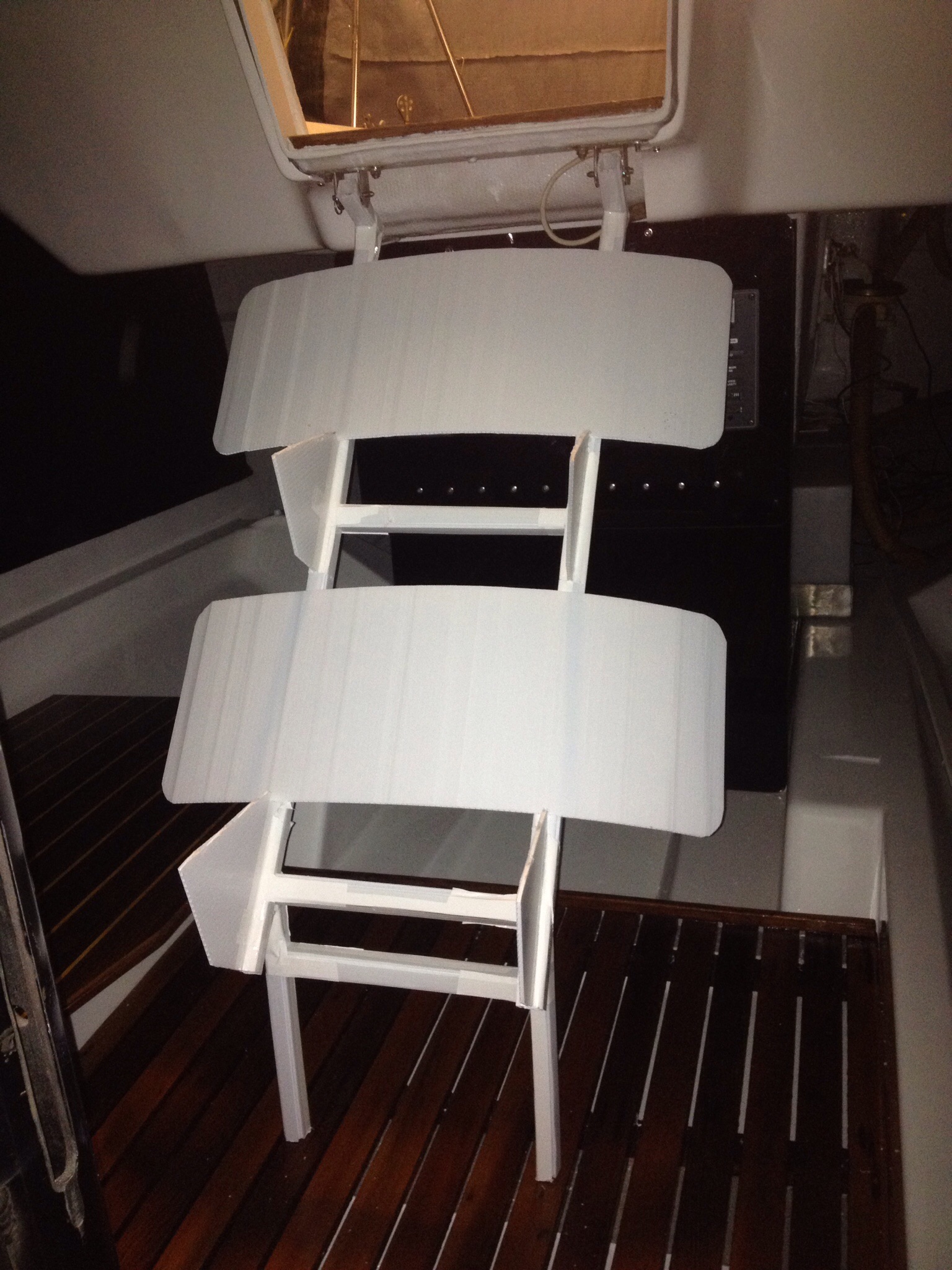

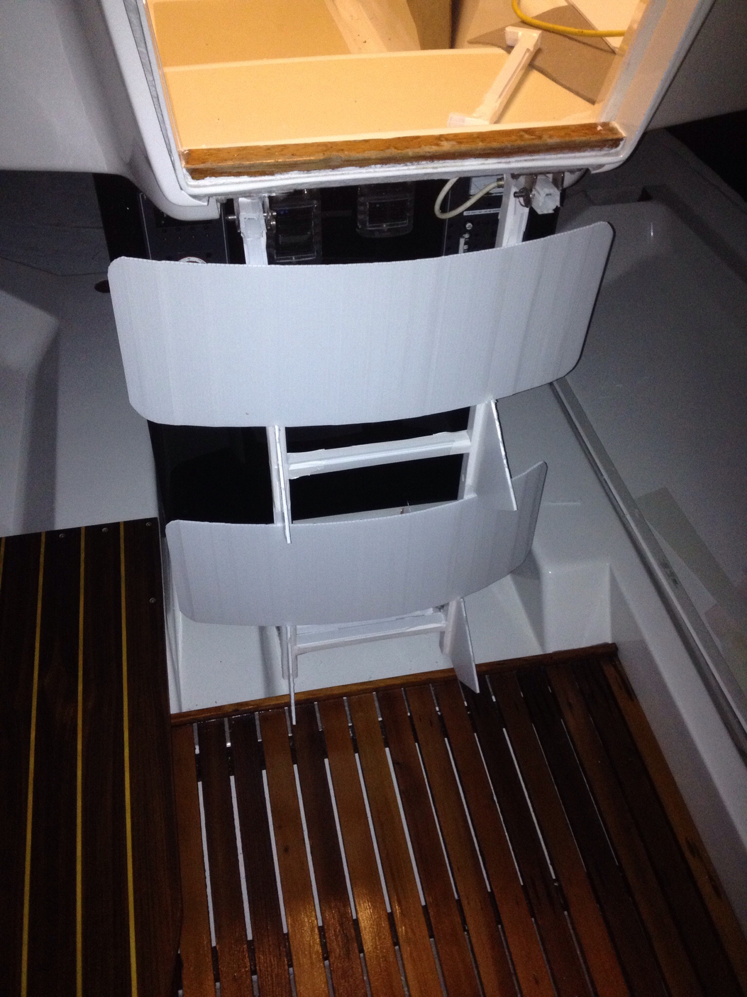

Mock up of the companionway steps.
Legs will hinge and fold up & behind.
Top is hinged to hang straight down.
Steps will hinge to fold away.
Entire staircase will also be able to swing straight up into companionway entrance, and be fastened out of the way.

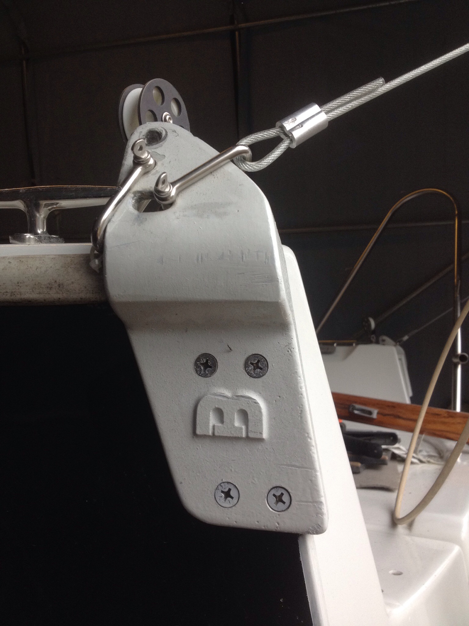

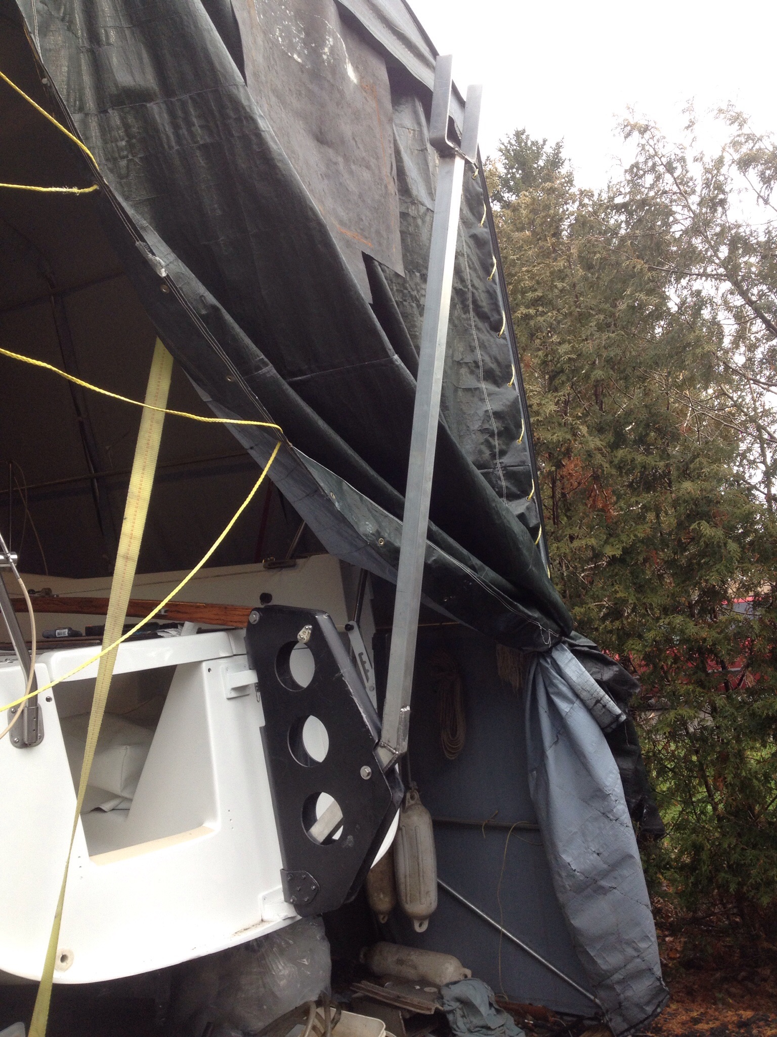

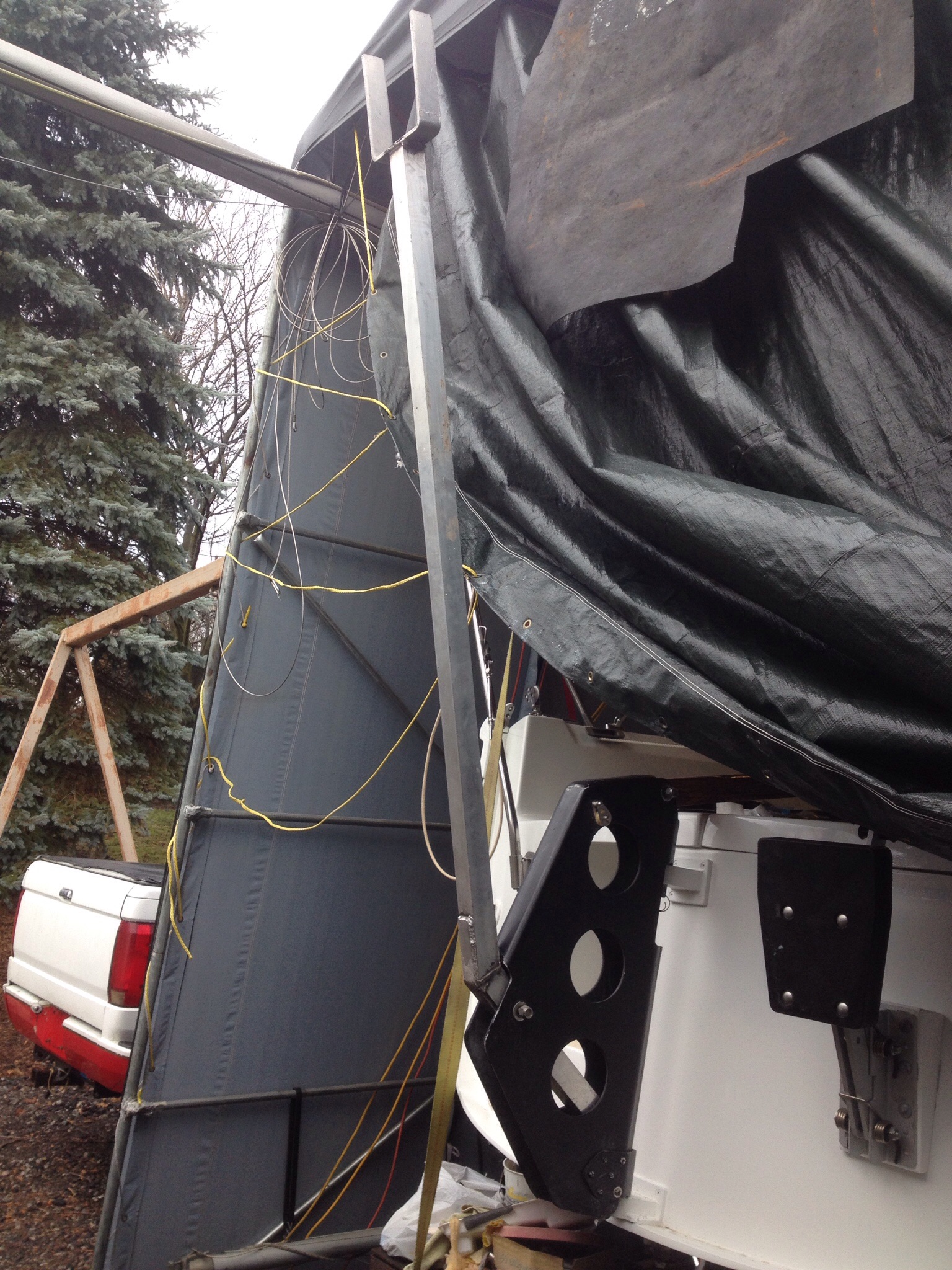

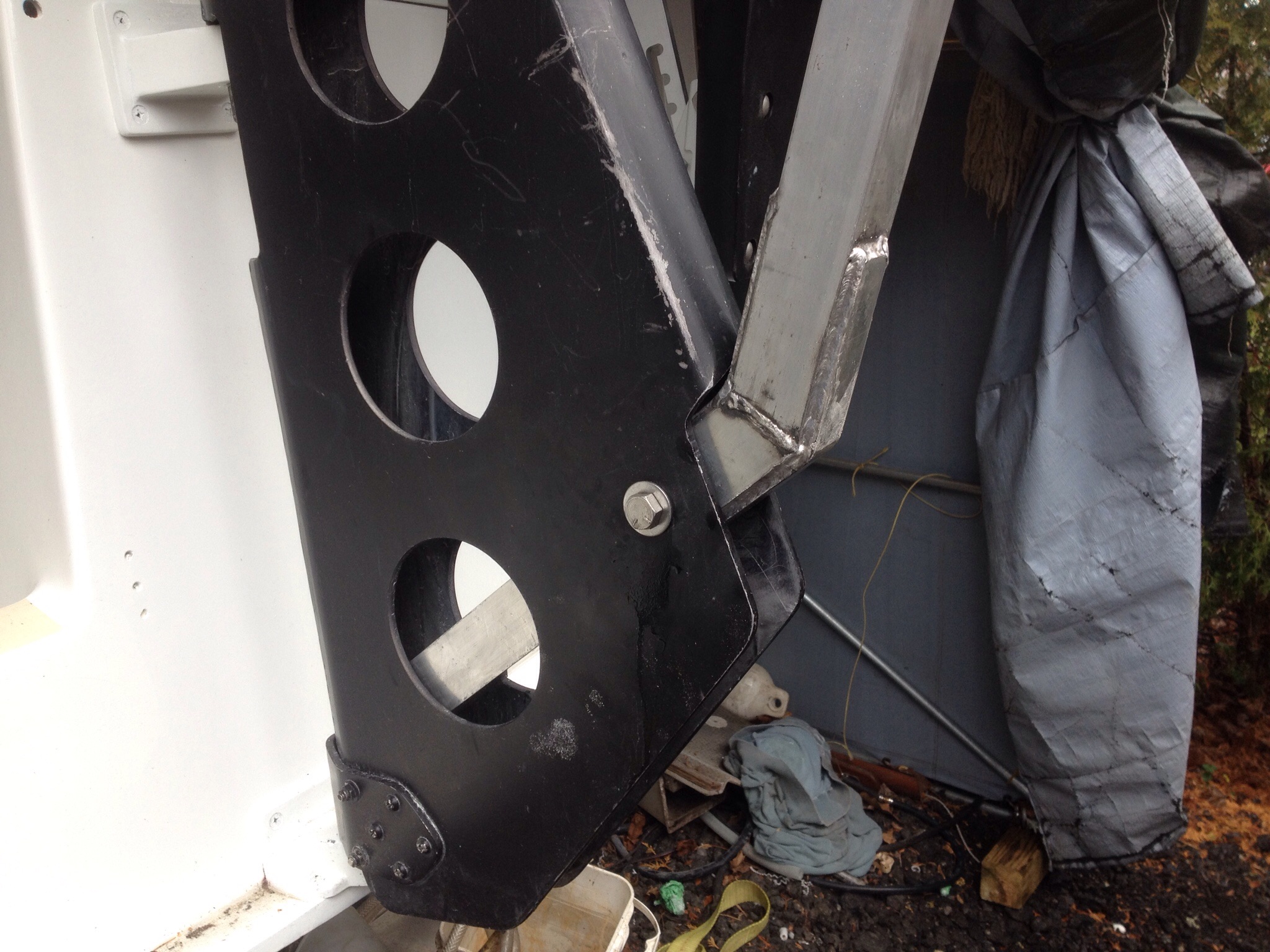

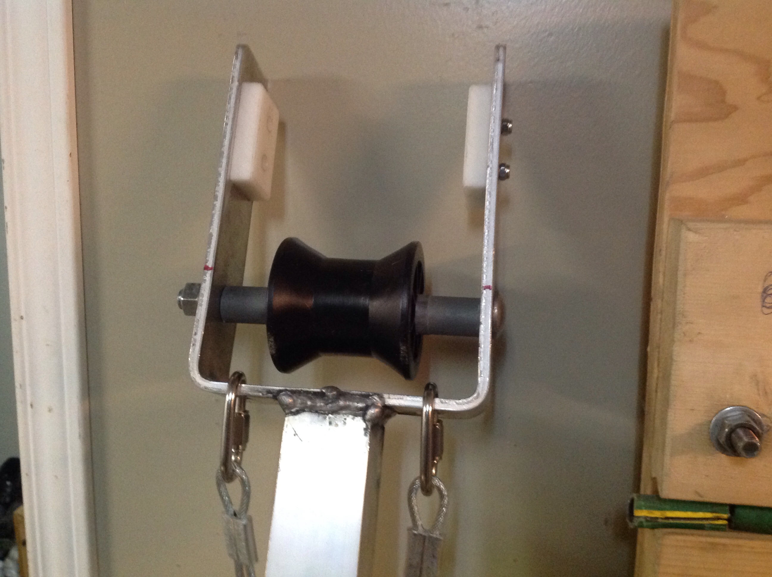

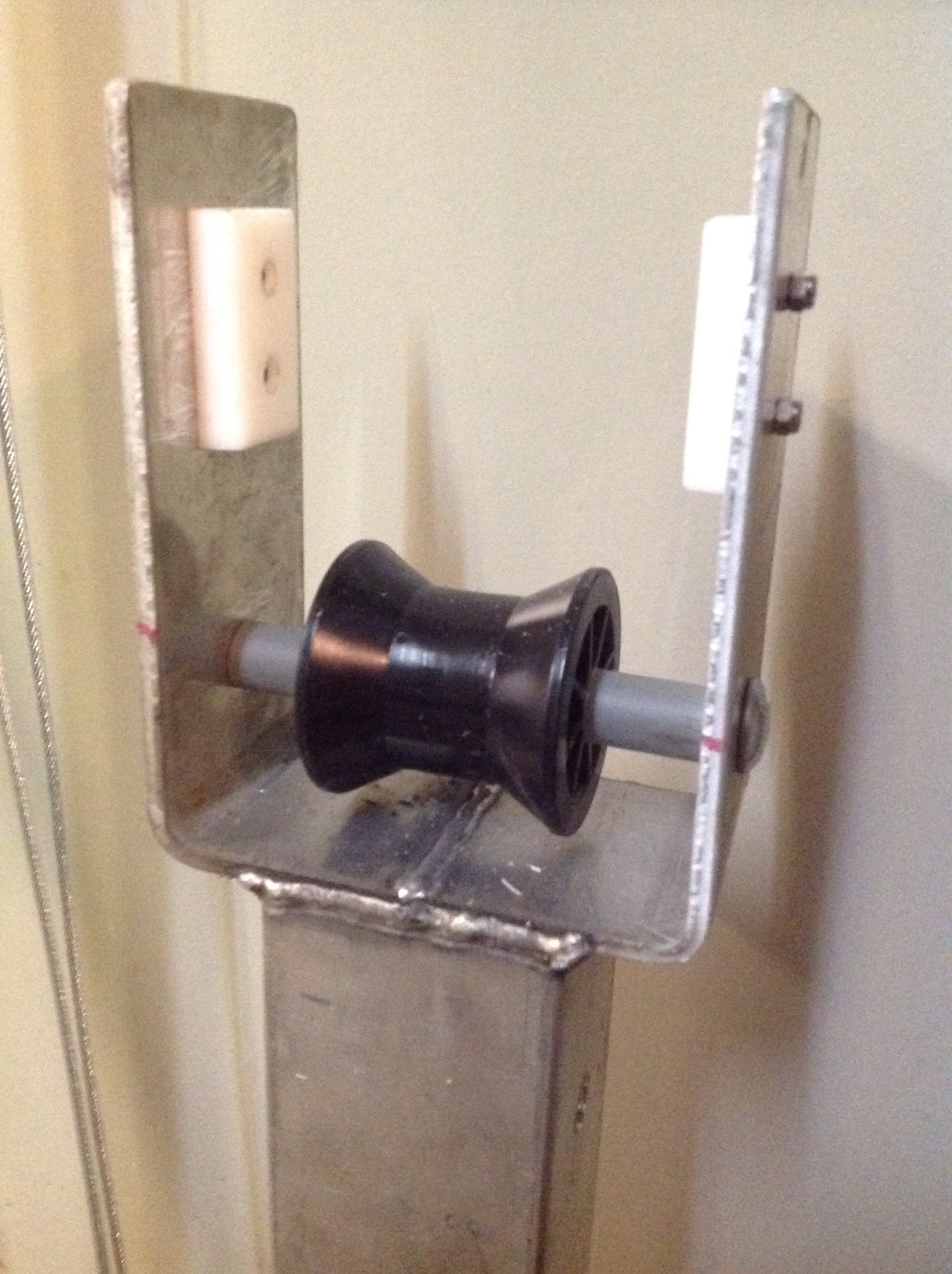

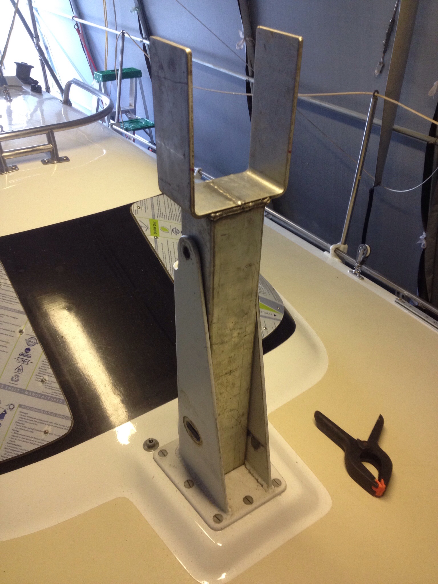

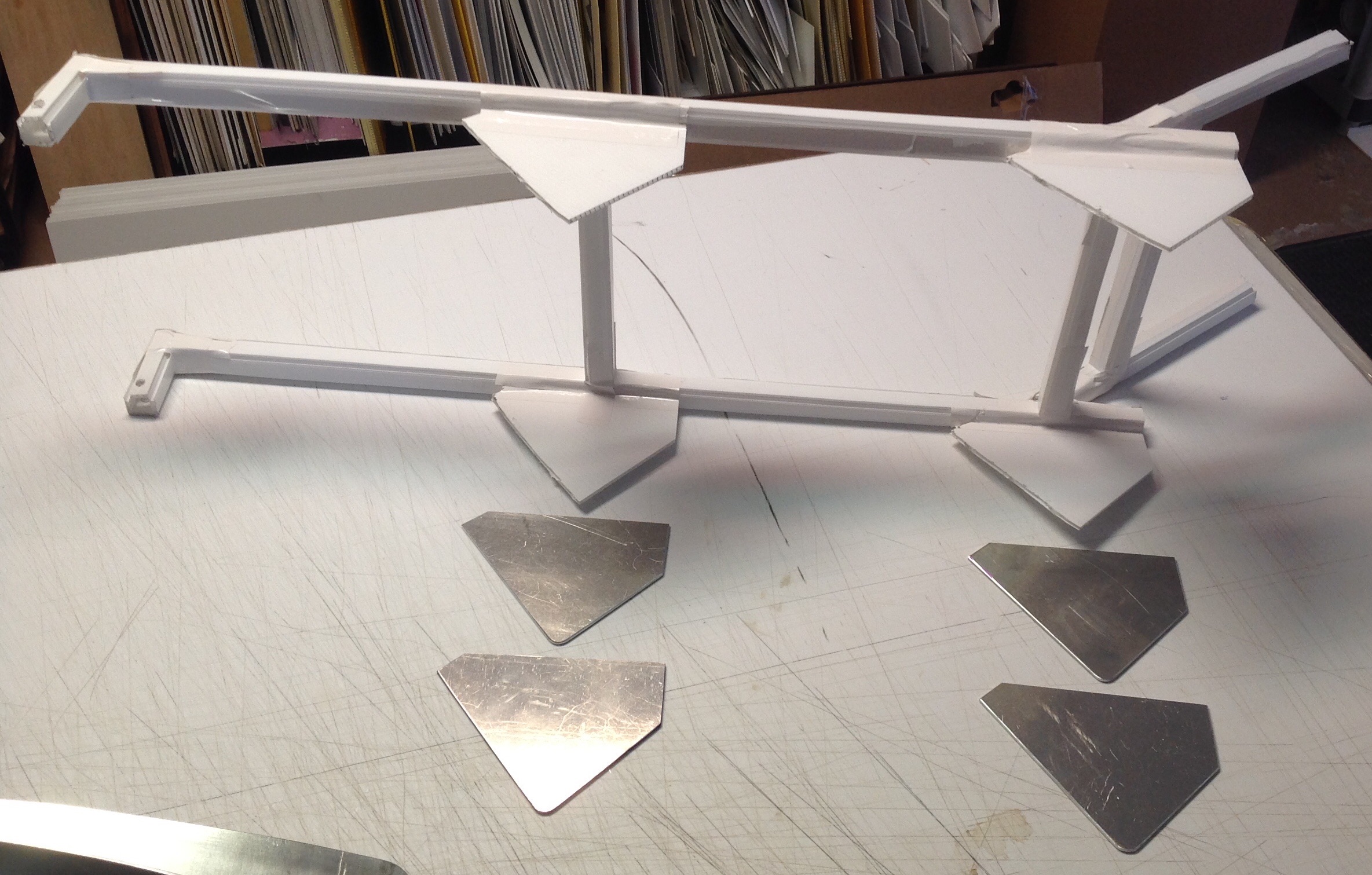

Trial fit for the mast tabernacle crutch (looks heavy duty, but only weighs about 3 lbs)...
and the aft mast crutch - incorporated into the tiller casing.
Rollers will be installed, and two SS cables 3/16" from the aft crutch roller to port & stbd backstay fittings, for added support.

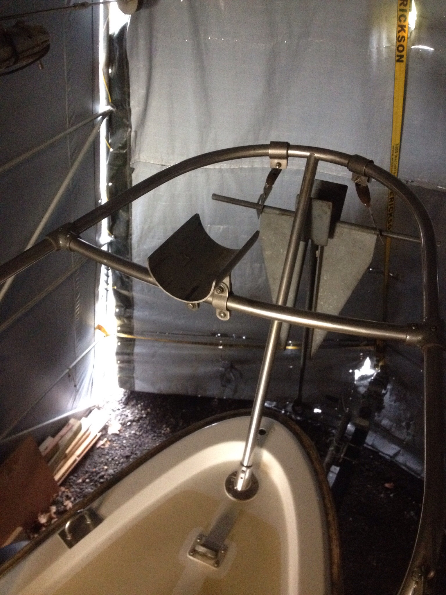

Lastly, the bow pulpit mast cradle.

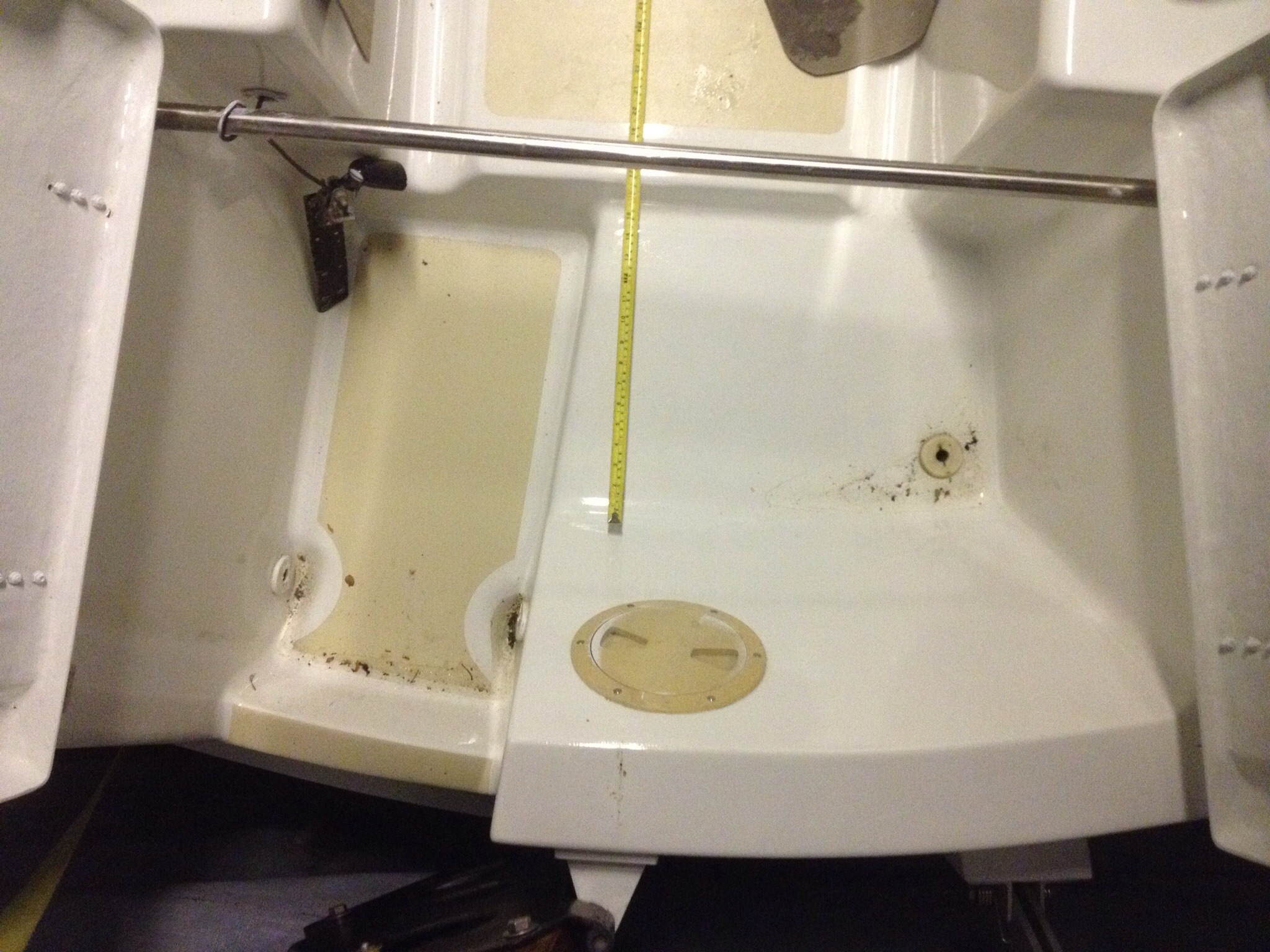

Oct 10, 2015
12

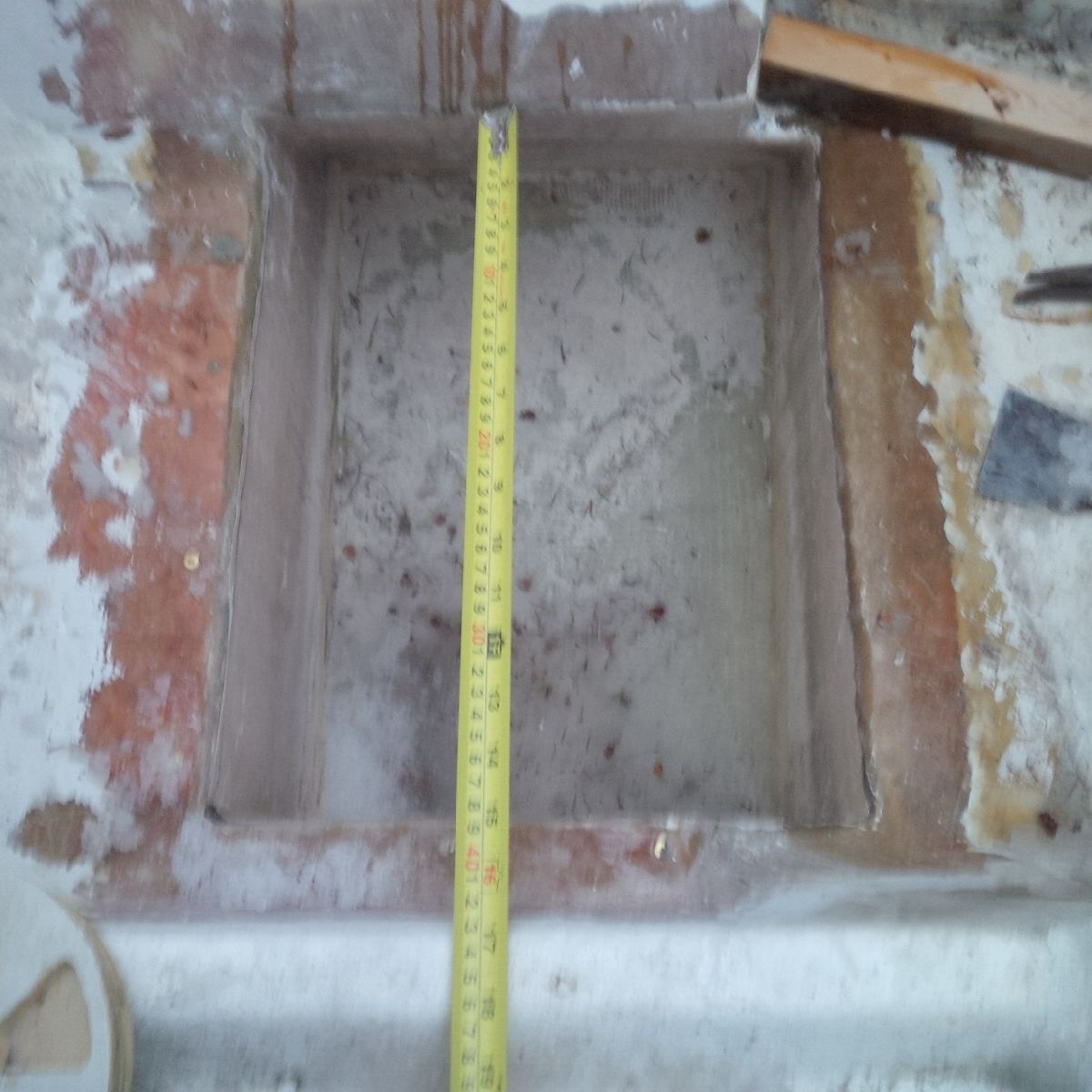

c & c mega 30 portstanley

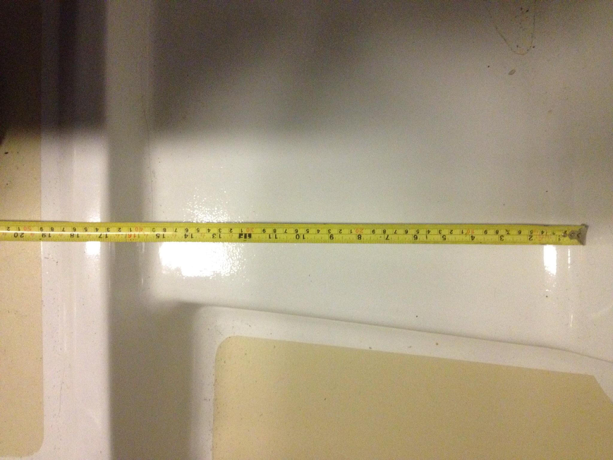

posted a picture looking at stern--we are trying to figure out if previous owner altered the entire back of boat. What you are seeing is a measurement from the divider on floor of cockpit- back to the interior of stern. Hoping you could make the same measurement on your boat and let me know-Mine is 16.75 inches.
Feb 11, 2012
271
That measurement is accurate.

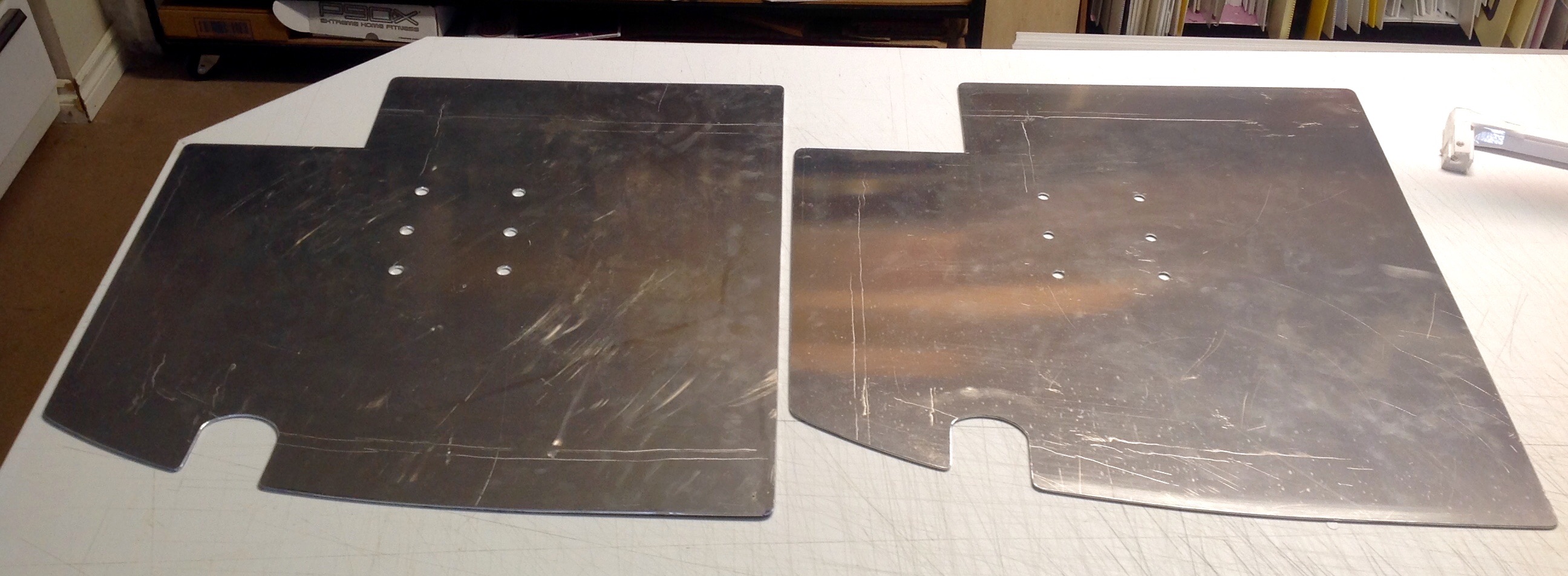

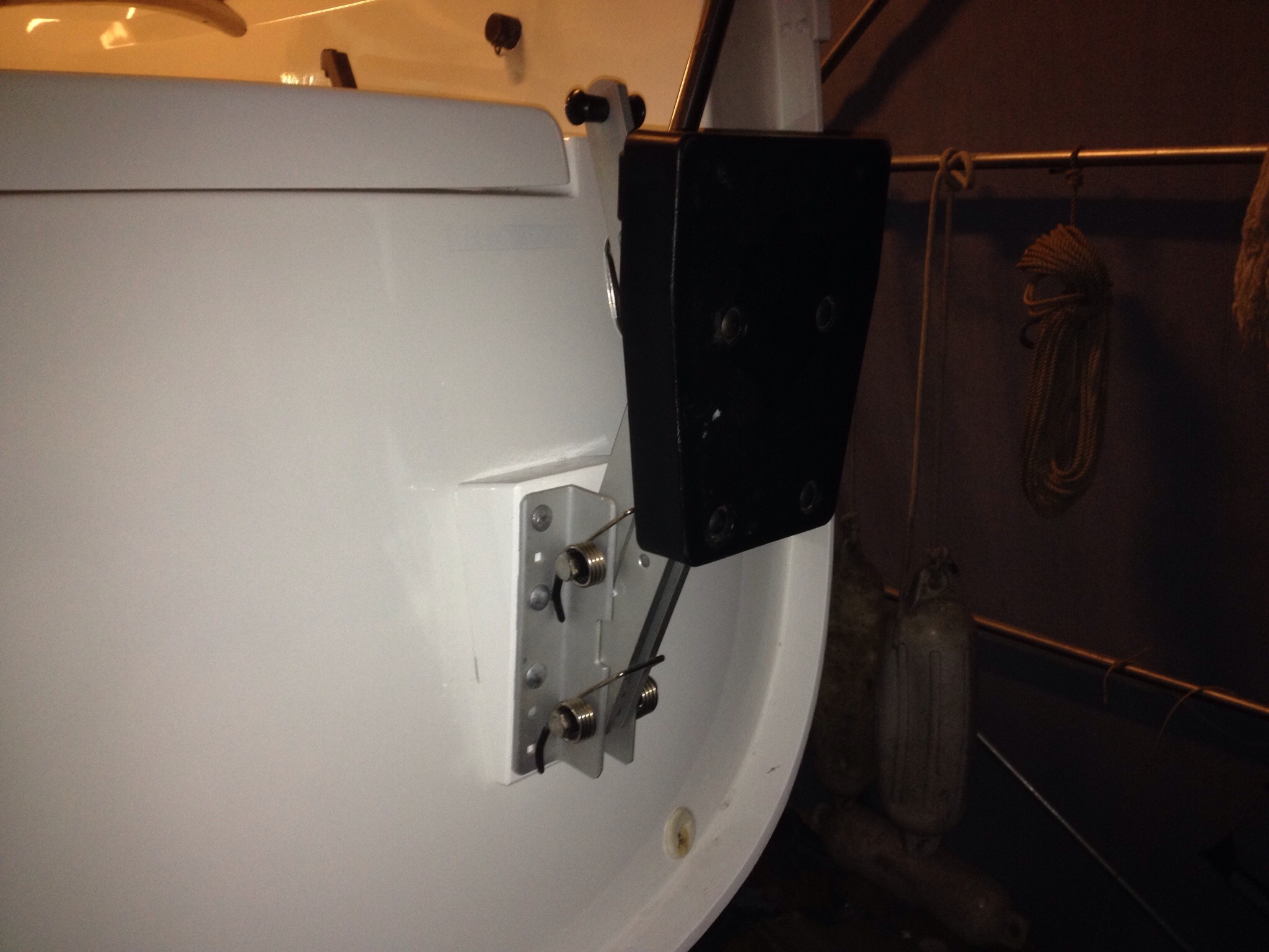

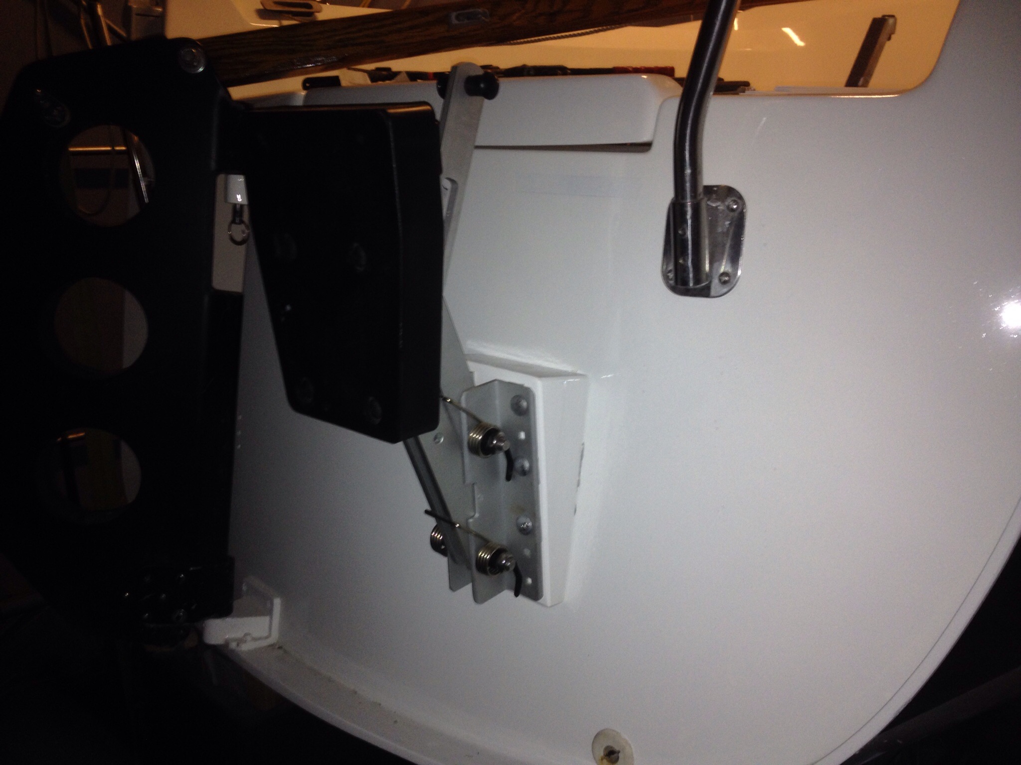

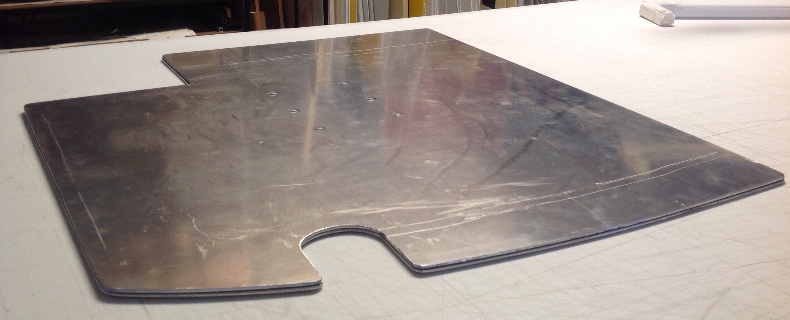

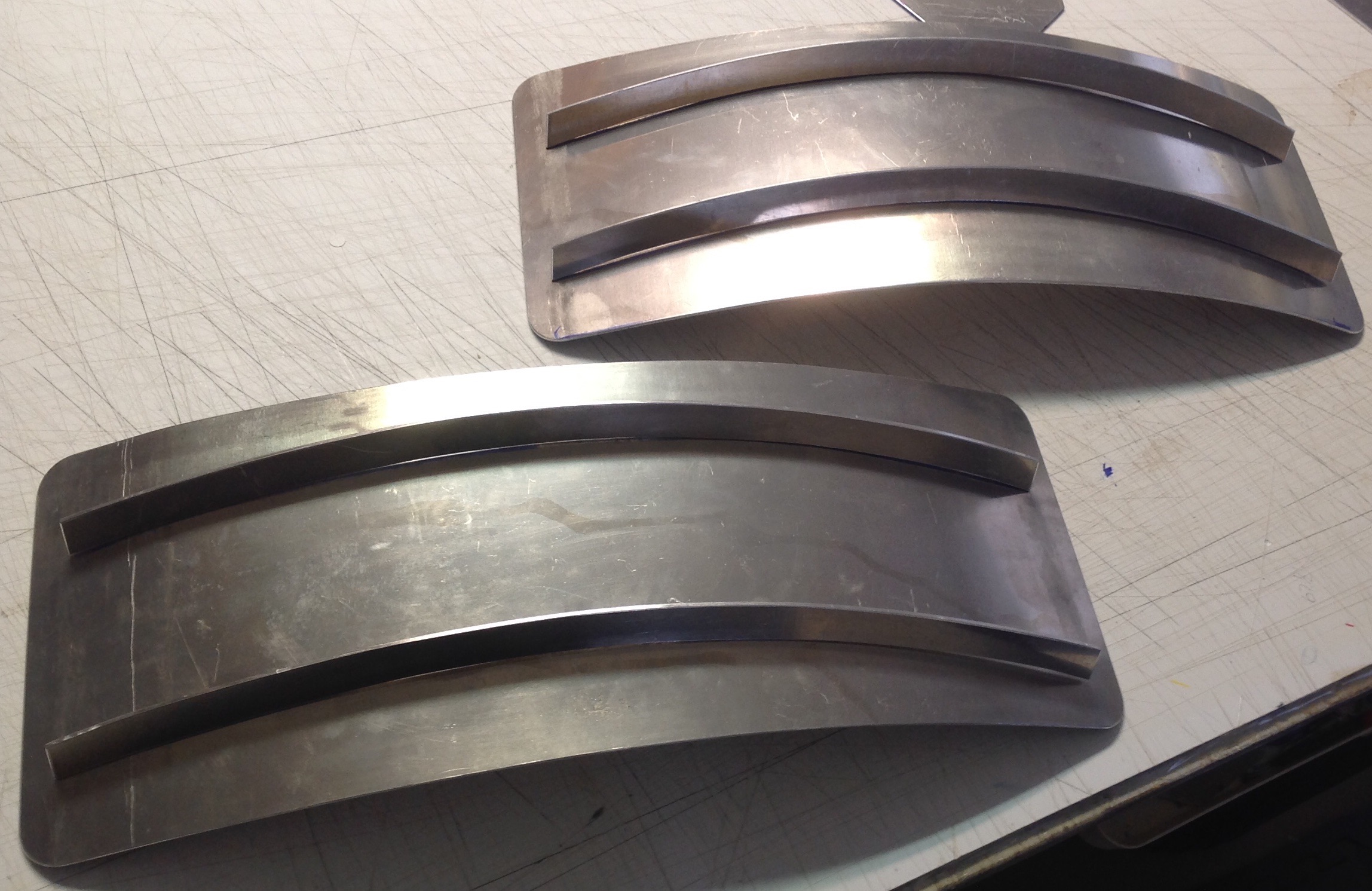

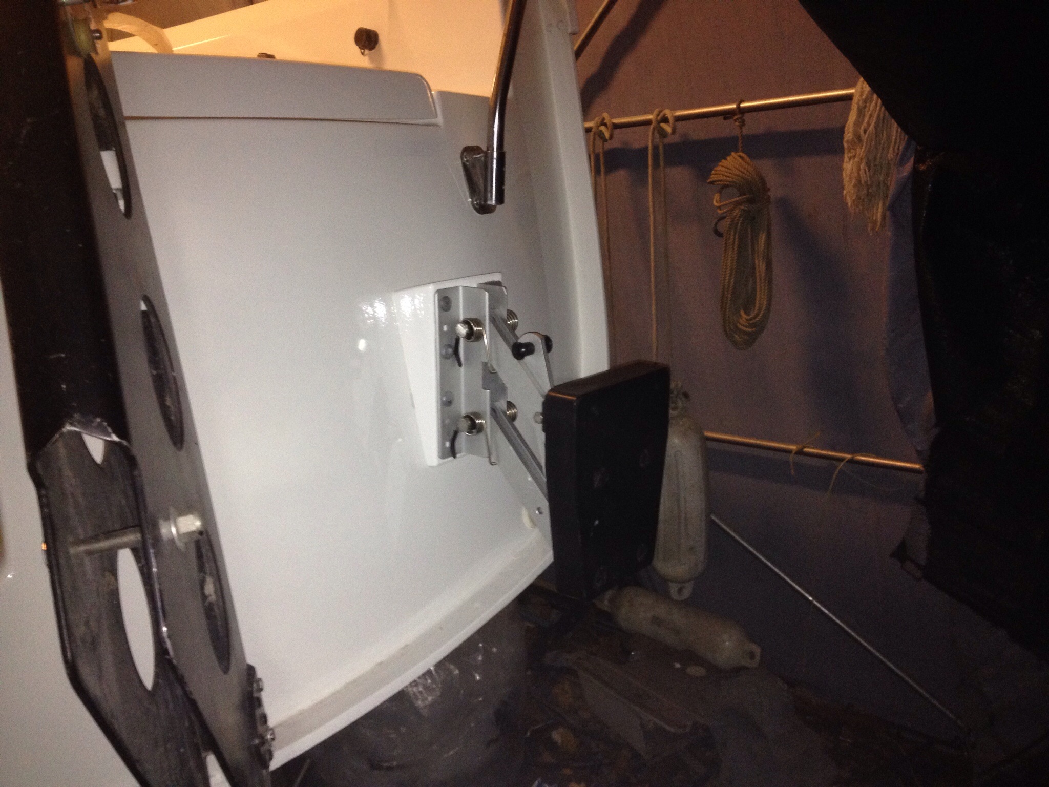

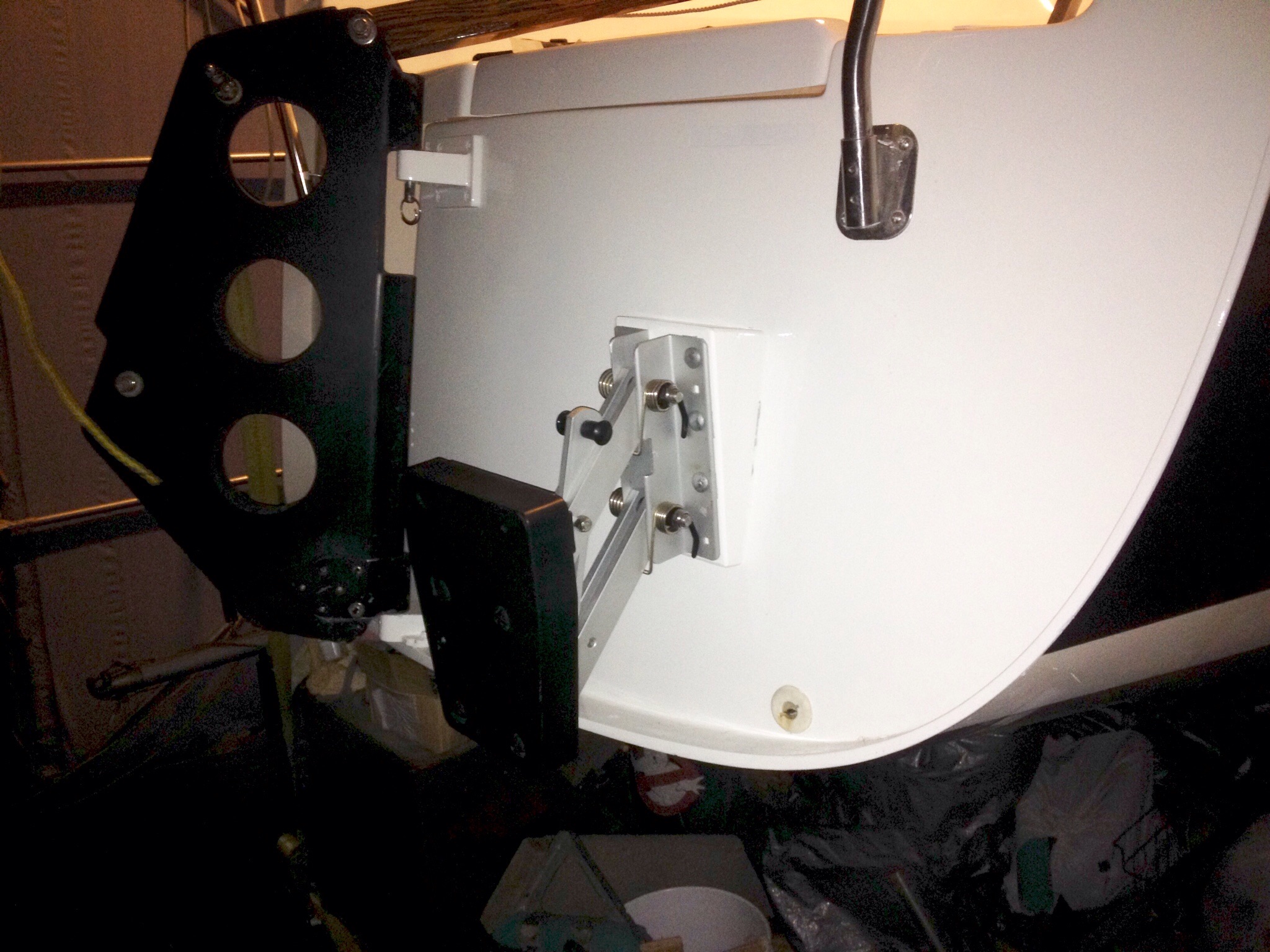

Two 3/16" aluminum backing plates for the outboard motor mount. Maximum coverage of available space inside the transom. The boat was not designed for the outboard to be mounted to starboard.
Feb 11, 2012
271

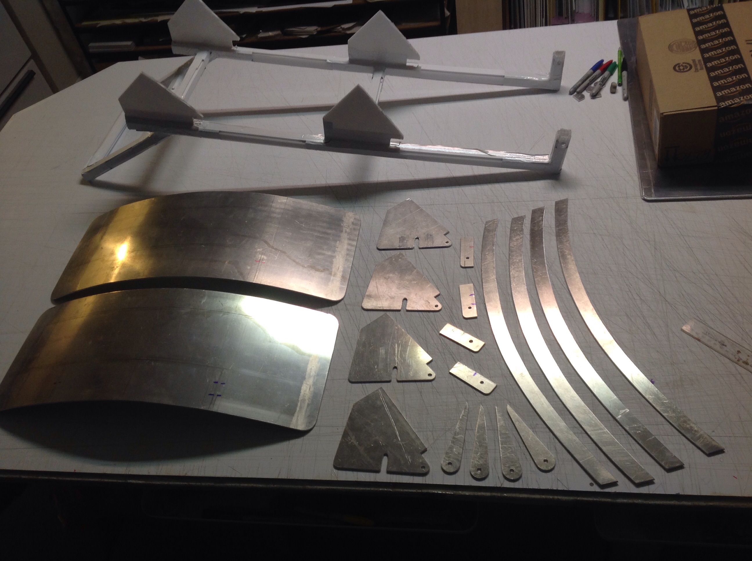

Cutting and filing the parts for the companionway staircase. Bent the steps and made the curved supports for them. Four aluminum tabs still to do for the step hinges then off to be welded.

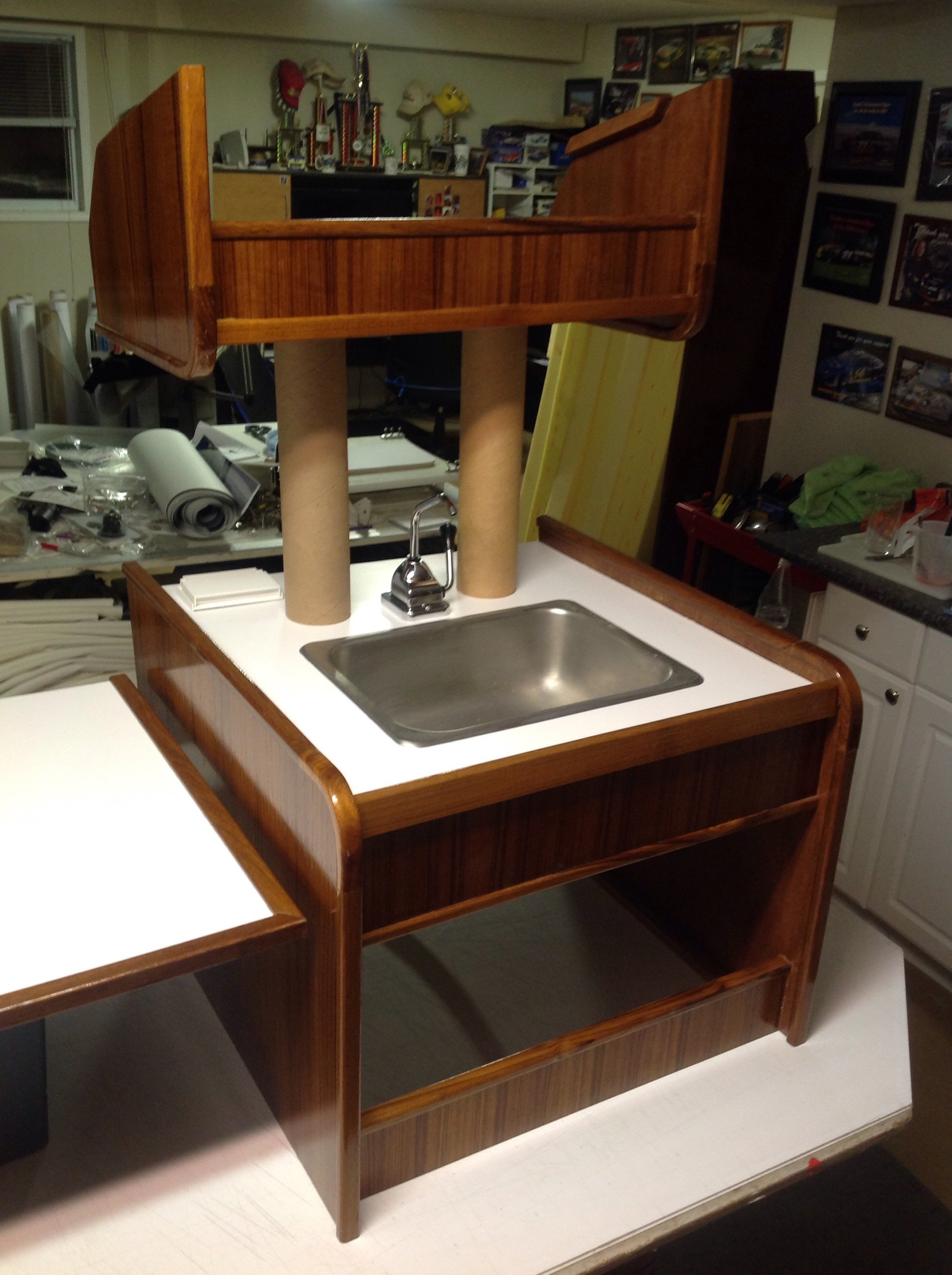

Feb 11, 2012
271

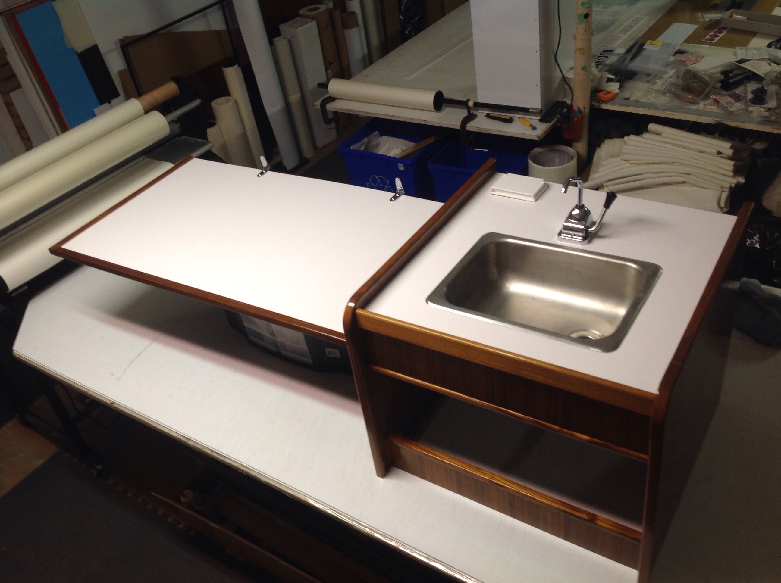

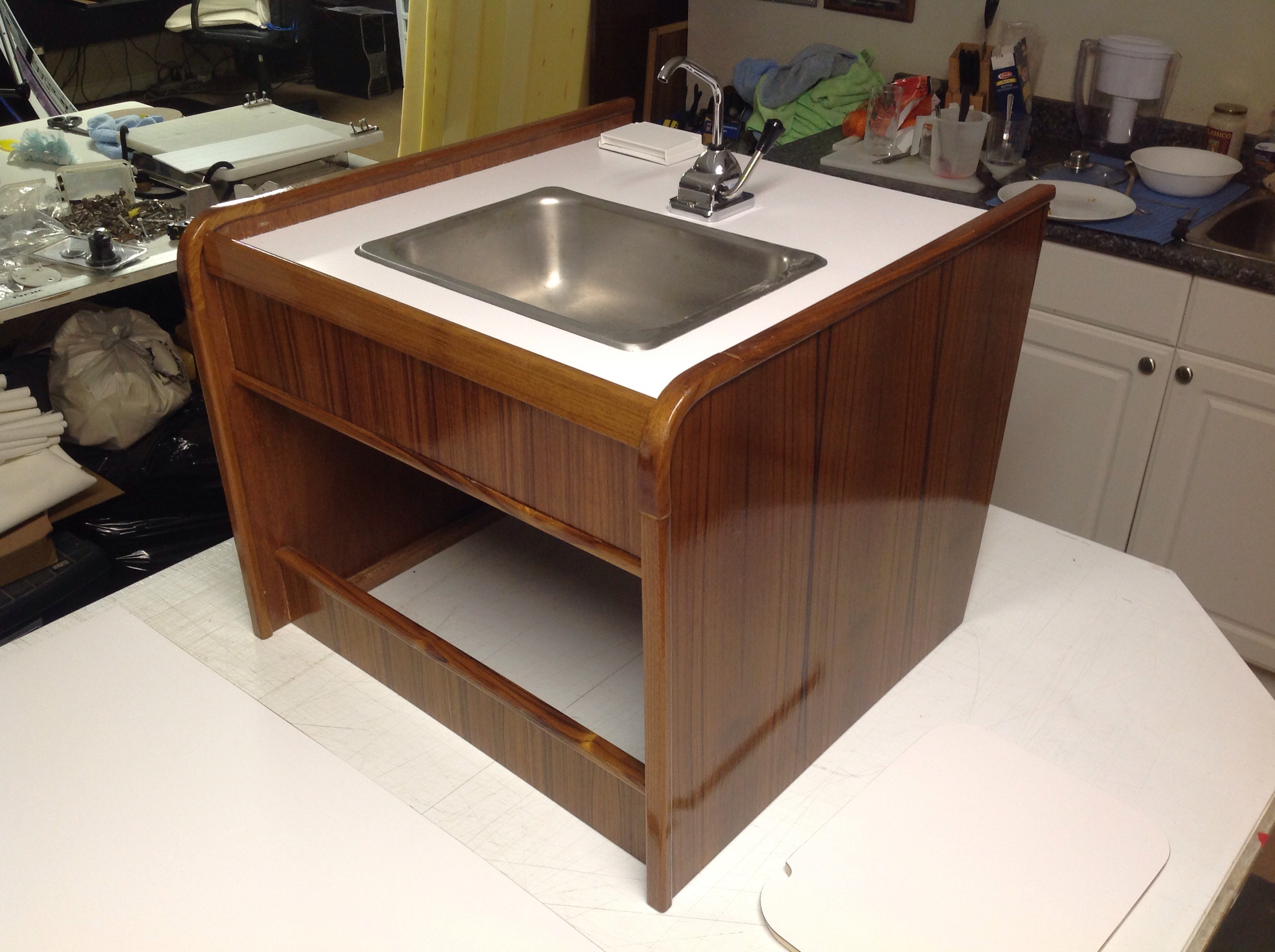

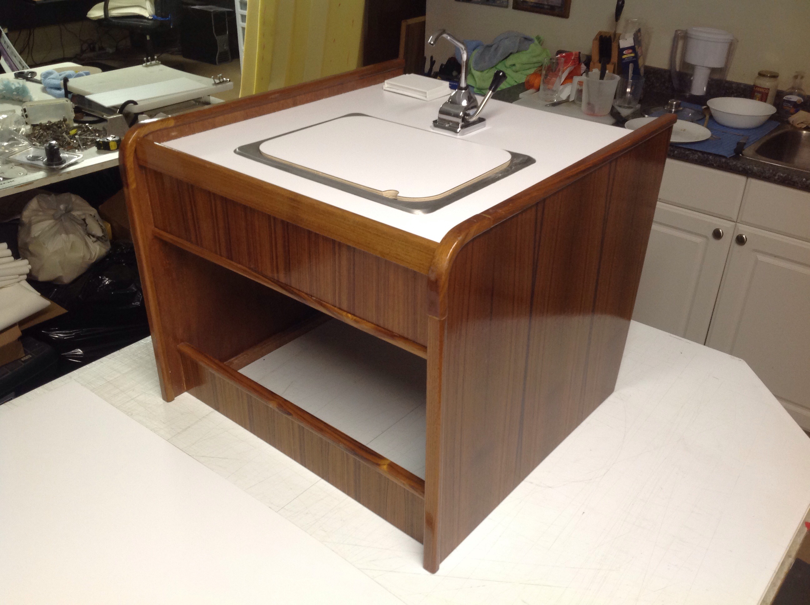

Finally got back to the teak cabinetry.
Installed the white counter top, sink, faucet, fiddle, and 110 volt outlet.
Also made use of the left over counter cut out for the sink.....little bit more filing needed, to have it sit lower.

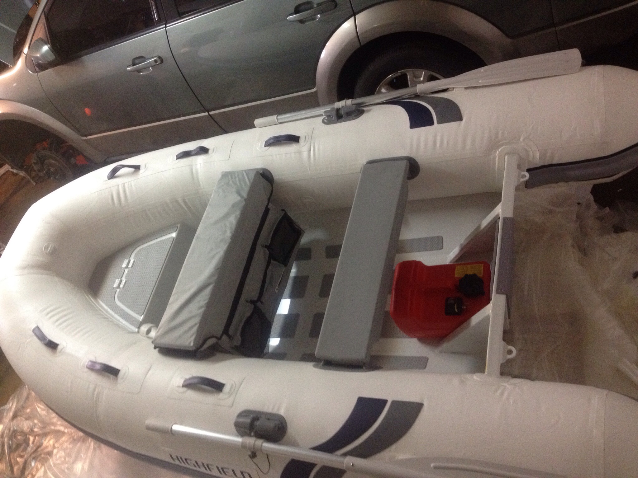

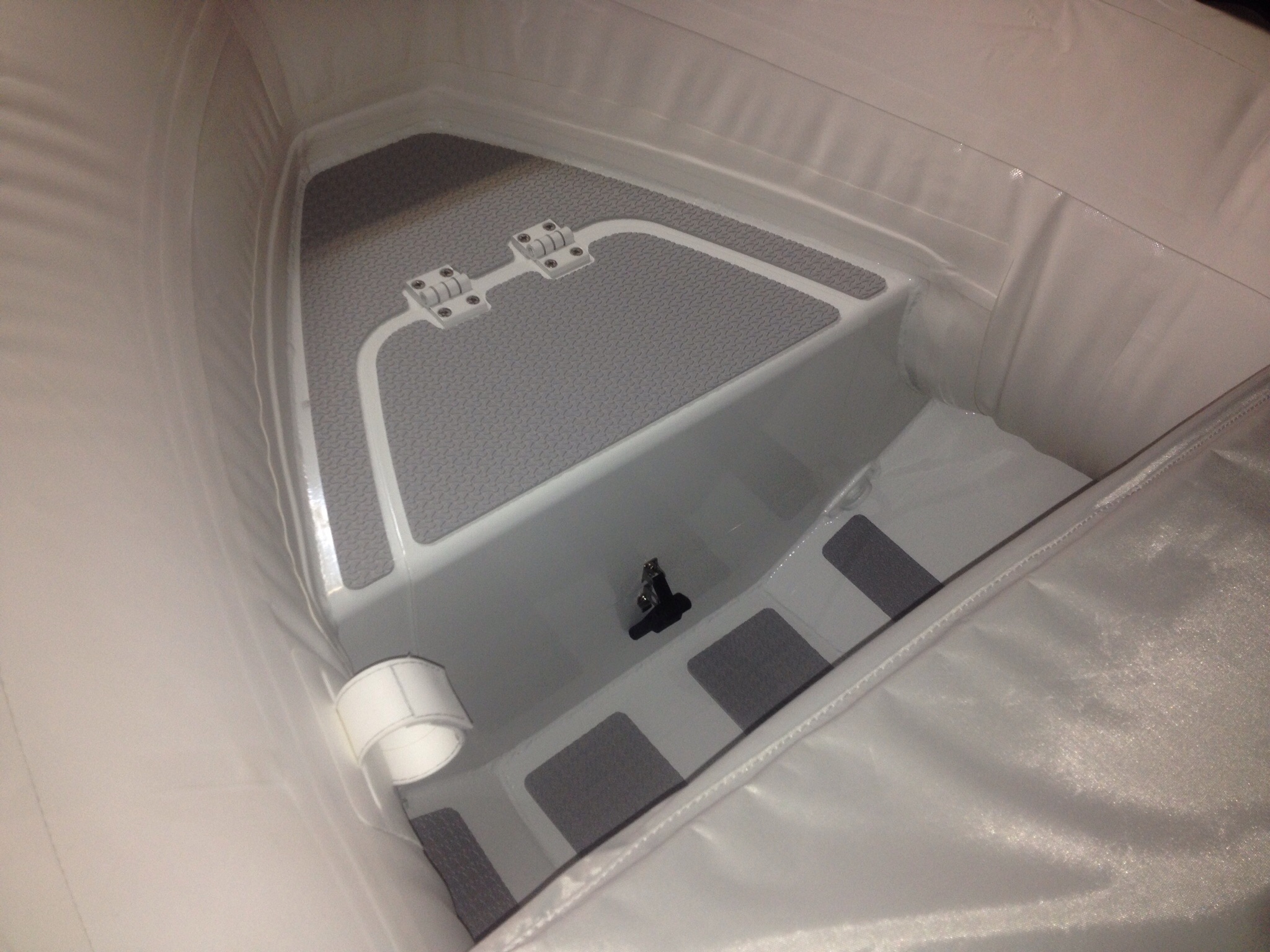

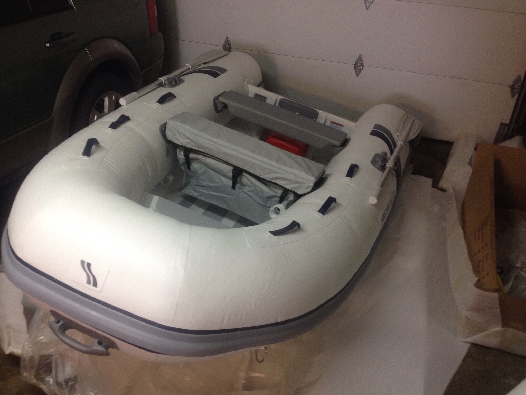

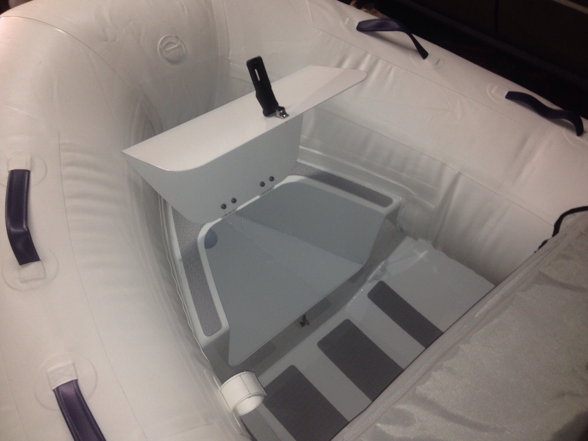

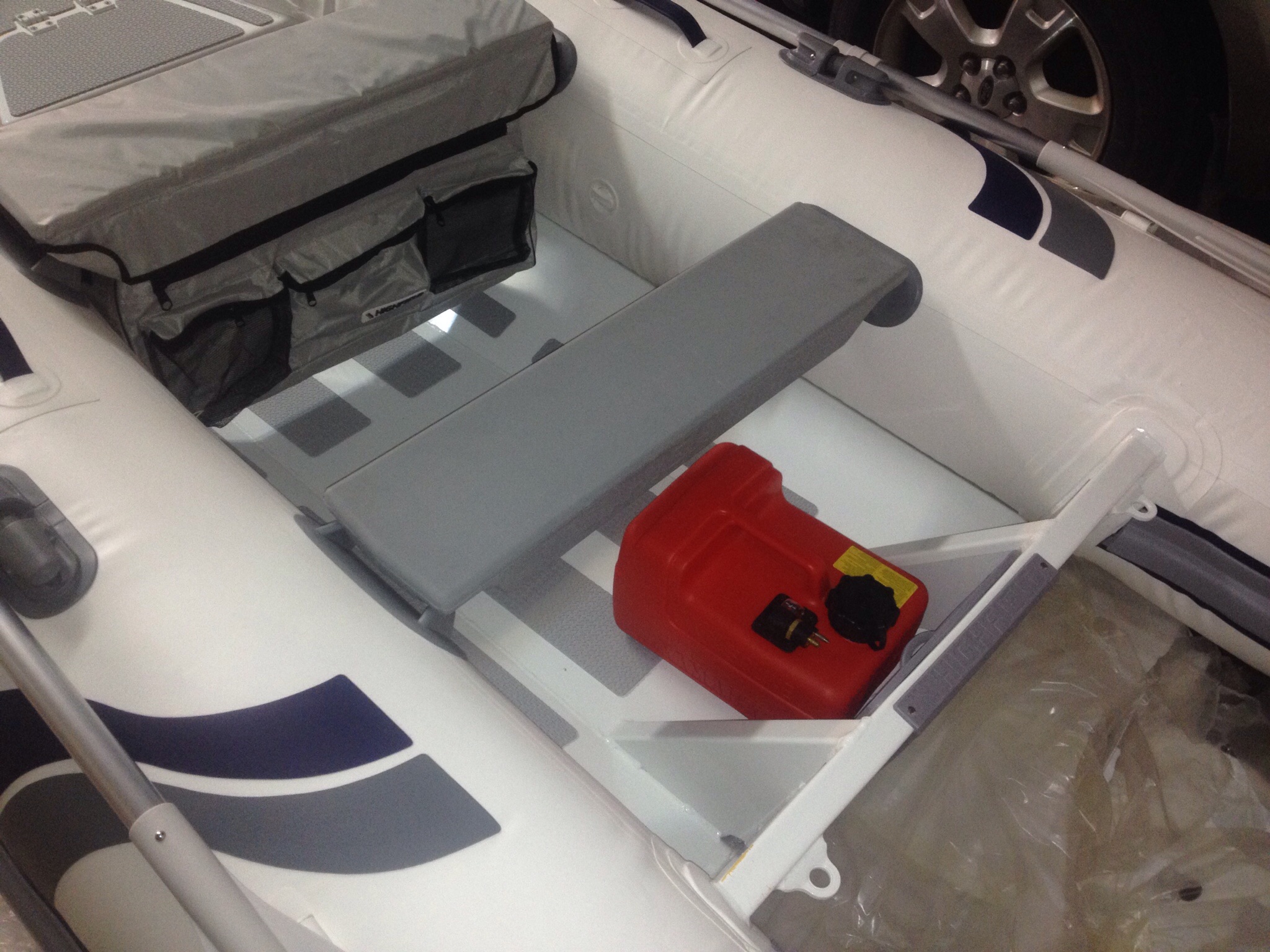

Picked up our new Highfield CL290 BL....Toronto boat show purchase. 123 lbs.
Aluminum hull with raised aluminum flat floor, bow locker, seat bag, boat cover, fuel tank etc.
Fits perfectly on the fore deck for trailering, or while sailing in poor weather.

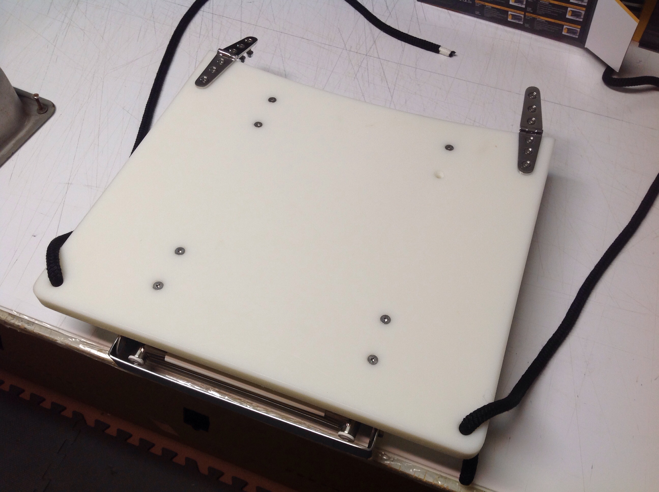

Feb 11, 2012
271

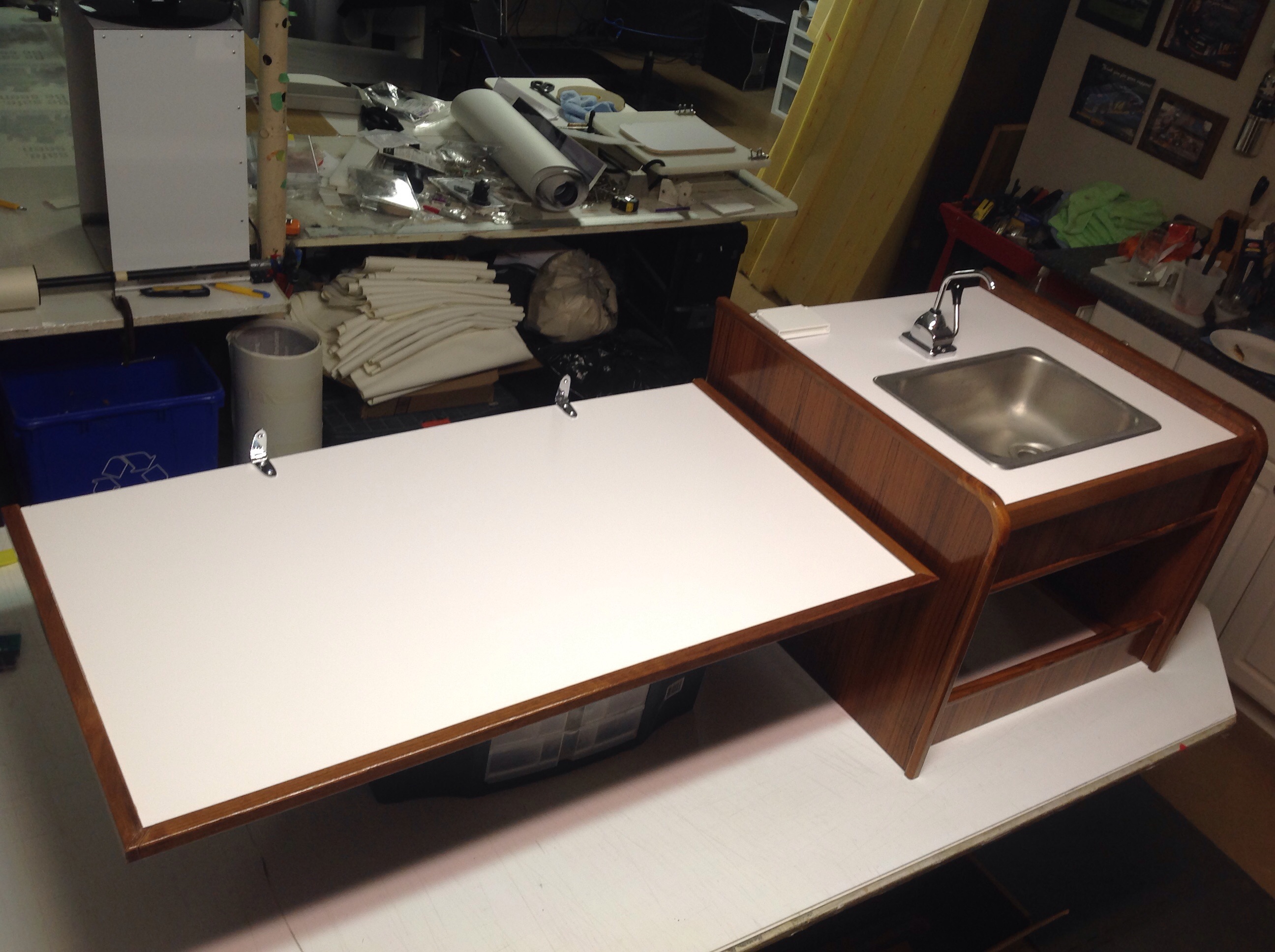

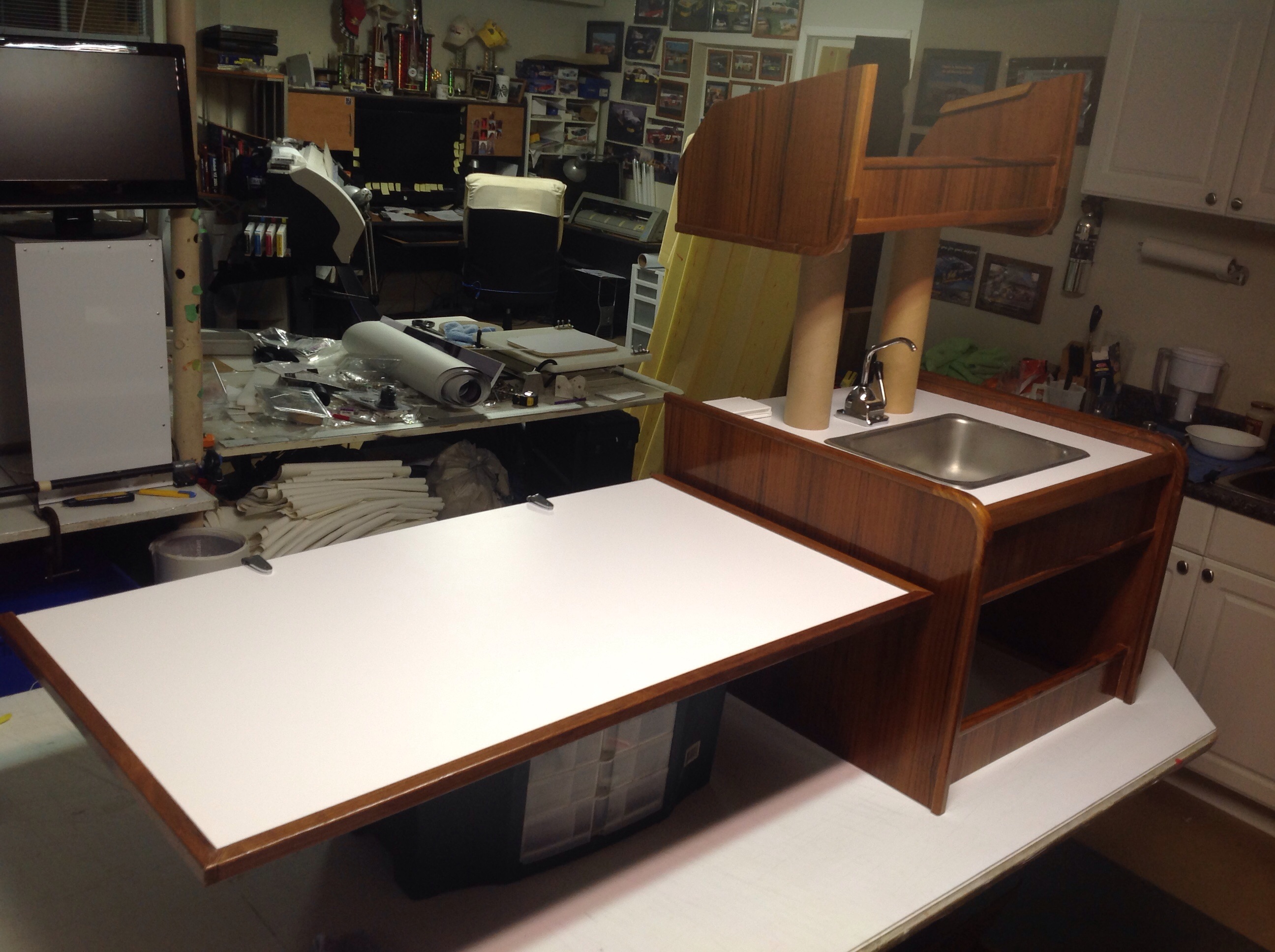

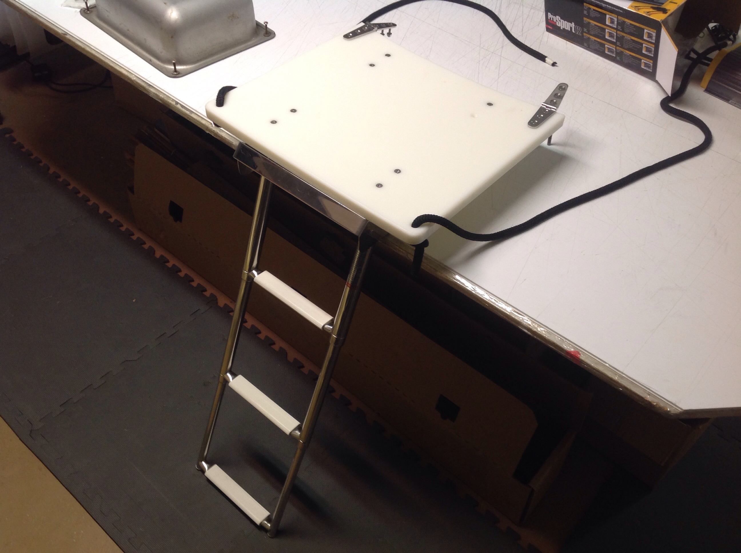

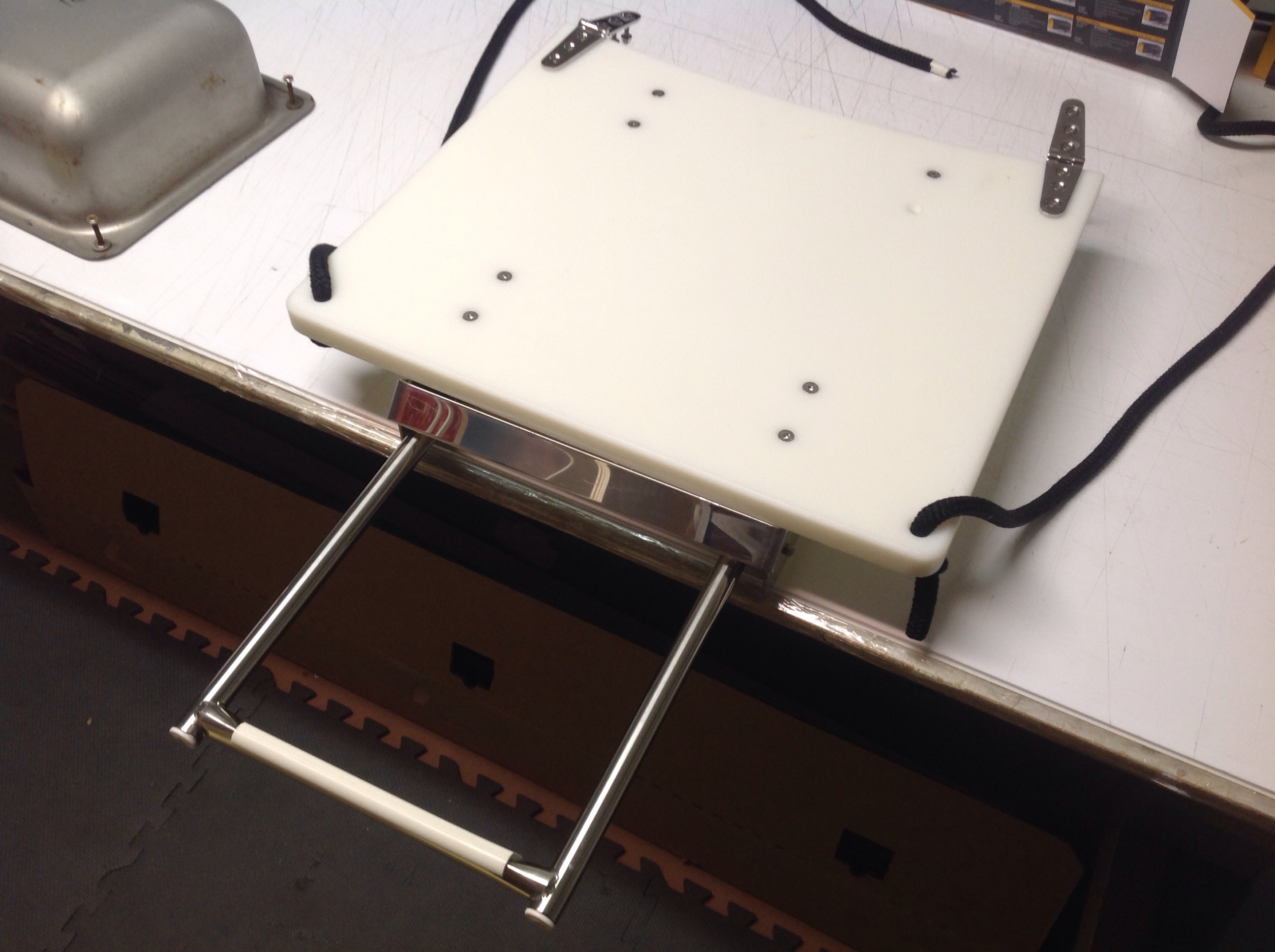

Folding counter top is ready to install with the galley cabinet.
This counter has the same black hull liner on the backside as what I installed in the C&C....when it is flipped upright against the hull it blends in nicely.
The flip up counter, the galley cabinet & the matching shelving unit (minus the cardboard tubes...) is being installed tomorrow.
