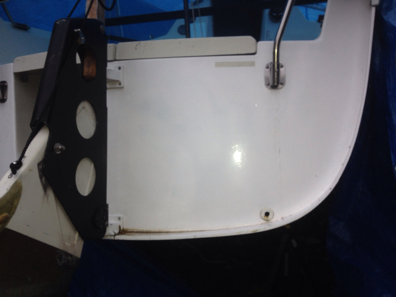

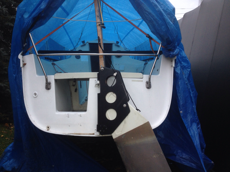

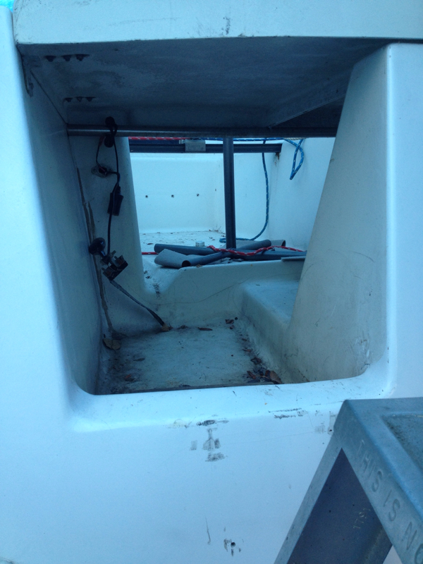

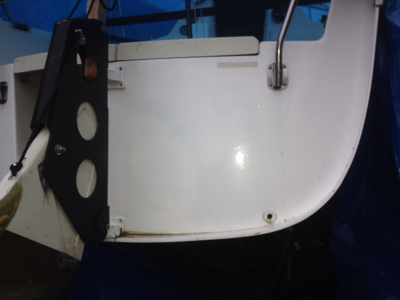

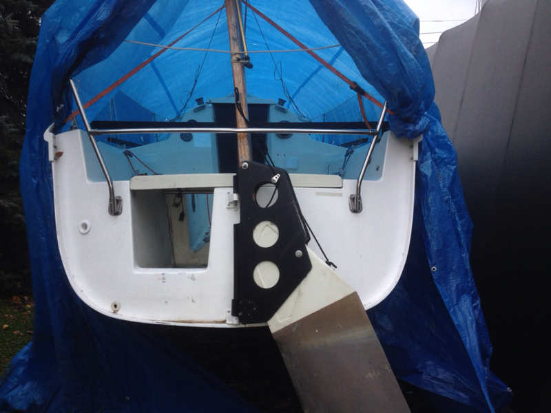

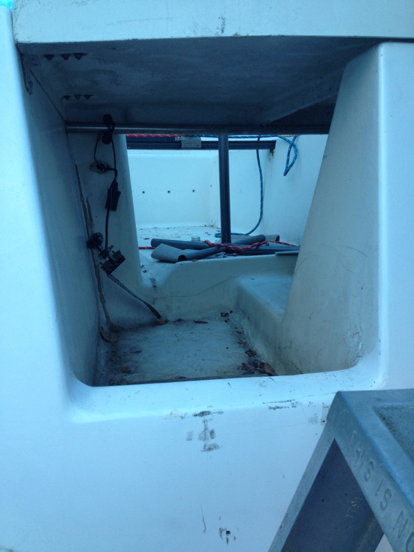

The aft will have the "20 hp" spring loaded lifting engine mounted to Starboard. (We have and will use our 9.9 Merc...just want the stronger mount)
The original outboard transom opening will be used to board the boat via the retractable swim platform with telescoping ladder combo.
The drain tub will have a matching slat teak sub floor (as the cabin sole) installed in a flat horizontal position to step on/ thru when the aft port seat is lifted.
