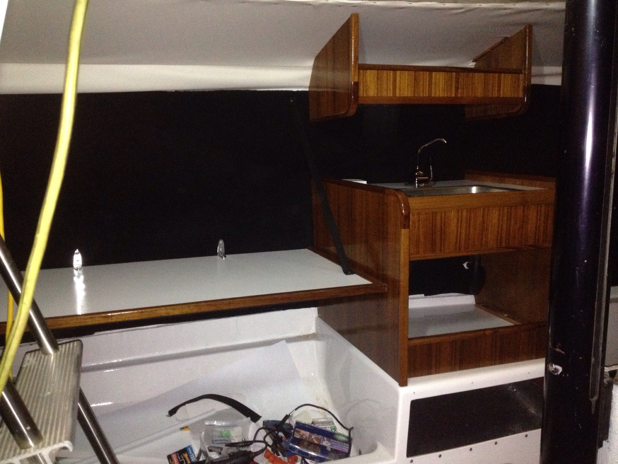

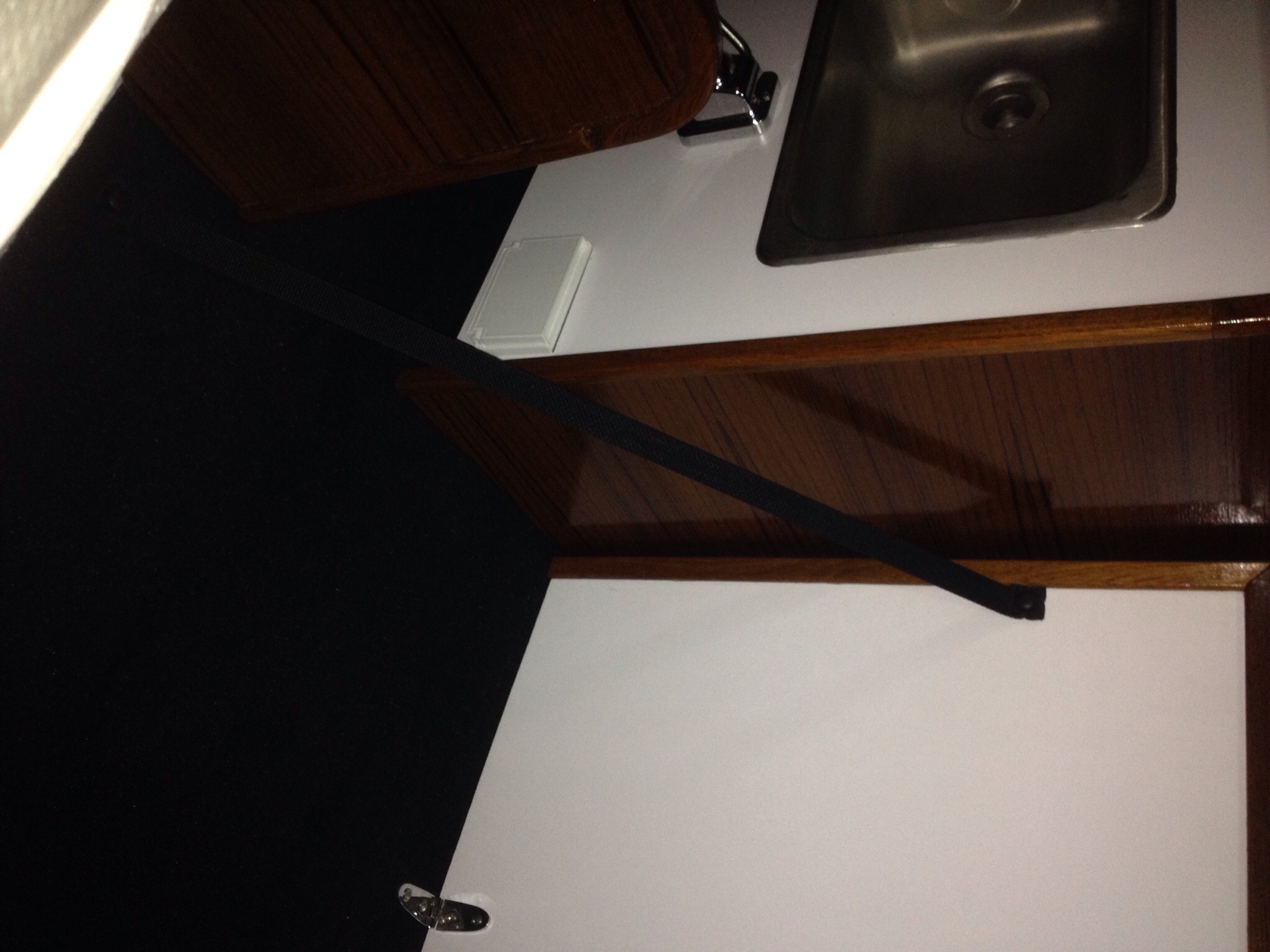

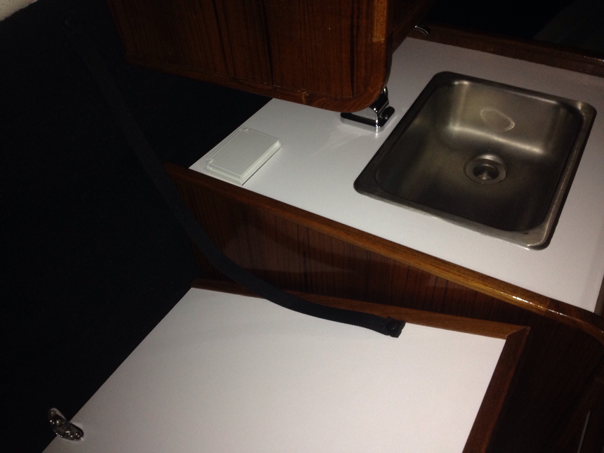

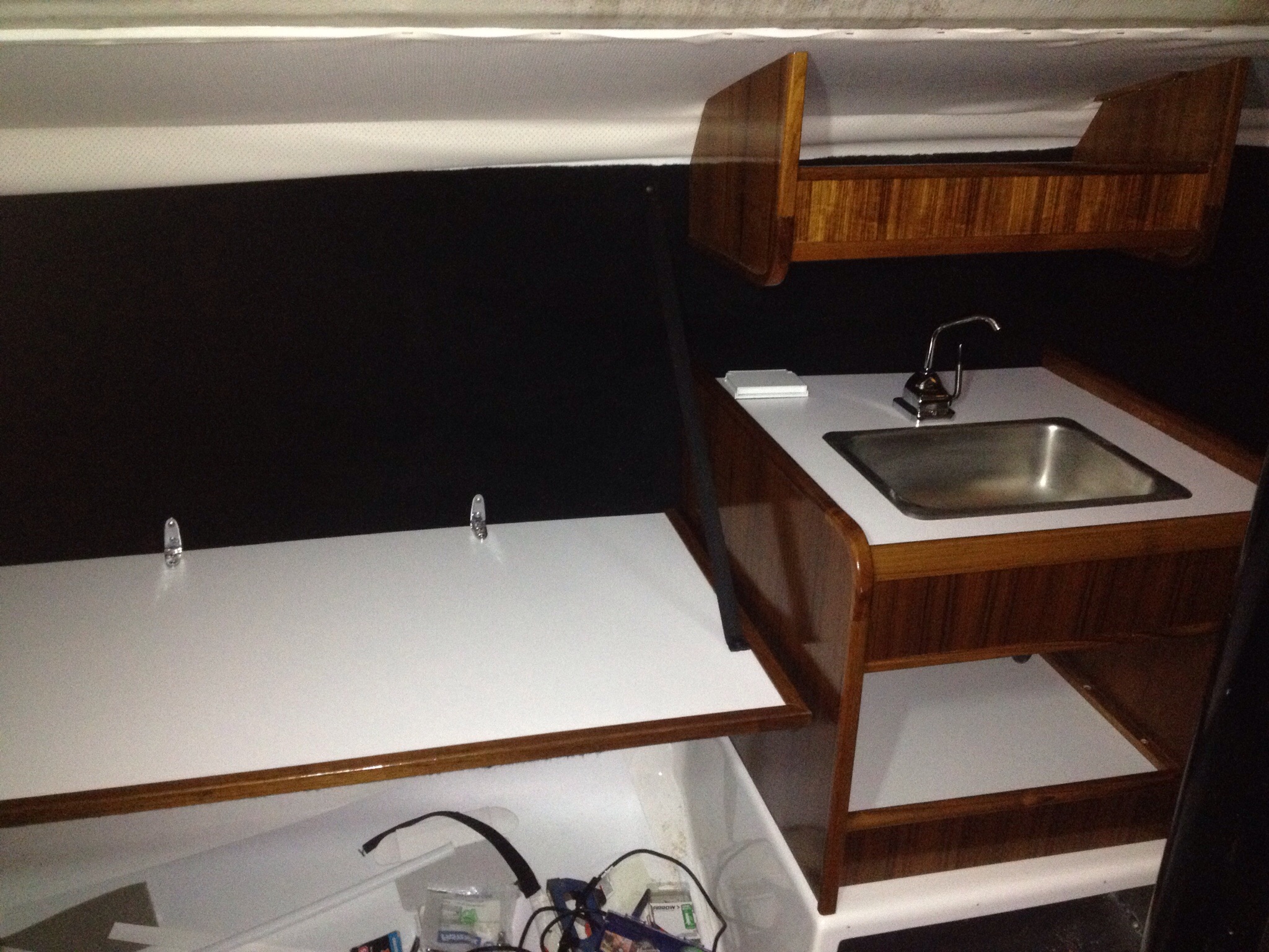

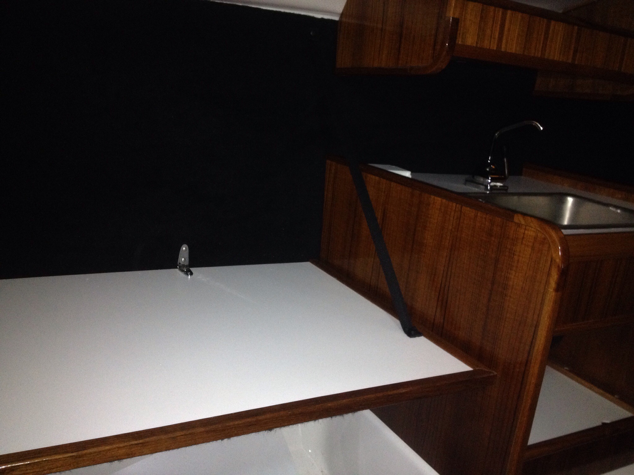

WOW, FANTASTIC cabinetry work SWGIII! Looks like a nice shop setup too.
What is the finish on the cabinets? I am working on an epoxy sealant, then Epiphanes. Seem to sand more off than I put on at times......
Feb 11, 2012
271
C&C Mega 30 Long Point, Lake Erie
Thanks Apex...raw teak with Cetol clear. Two coats. That's it.

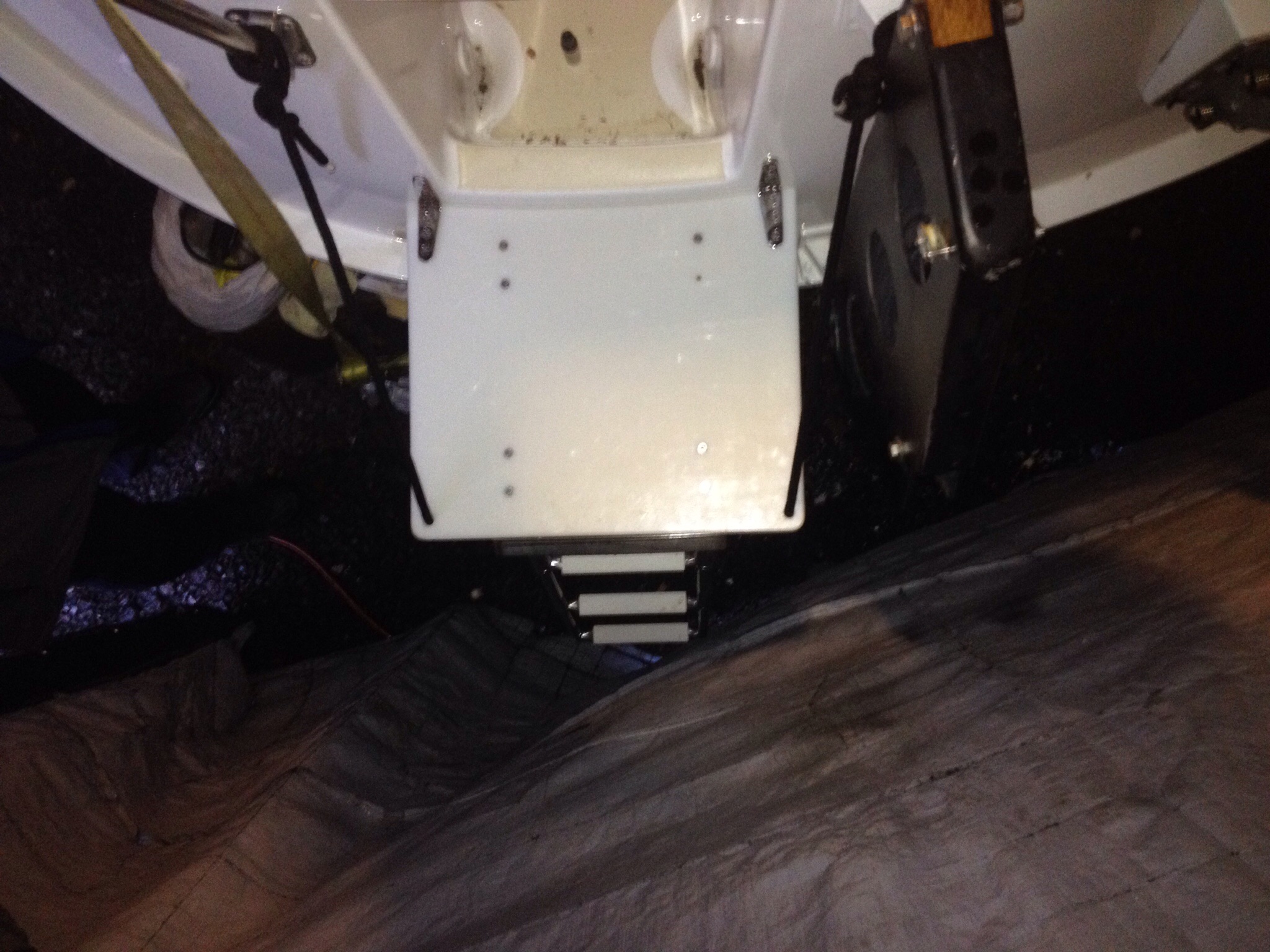

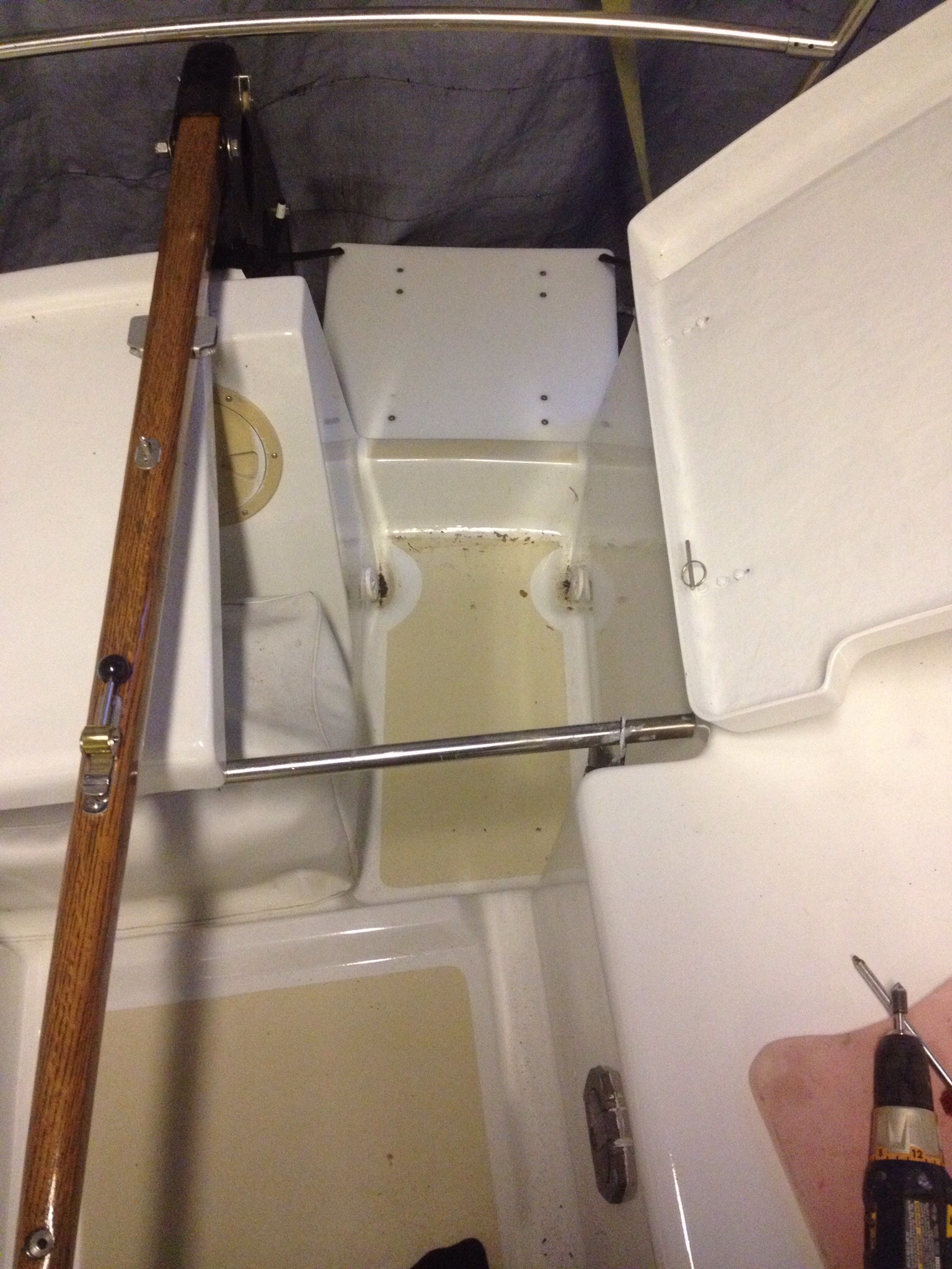

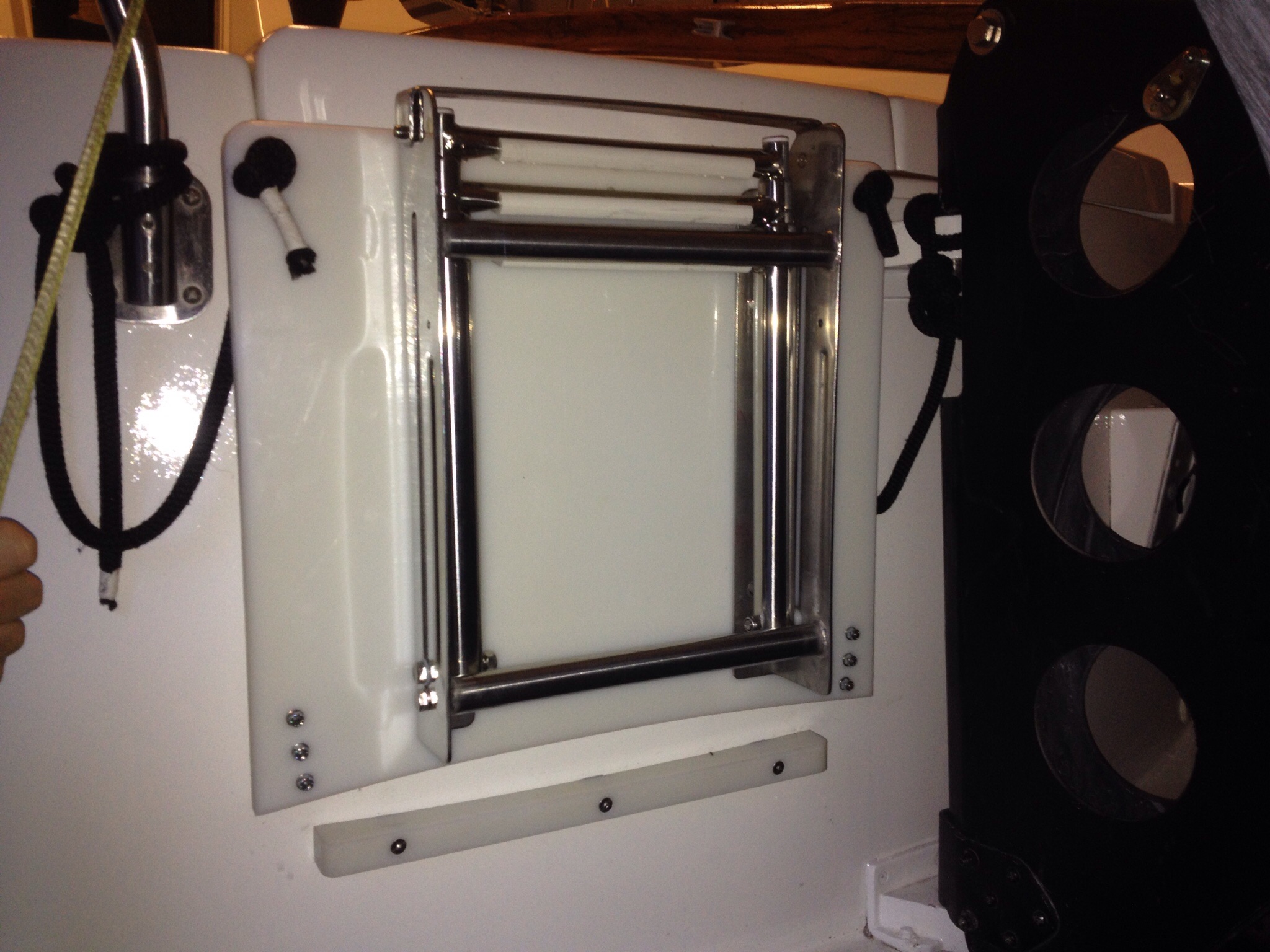

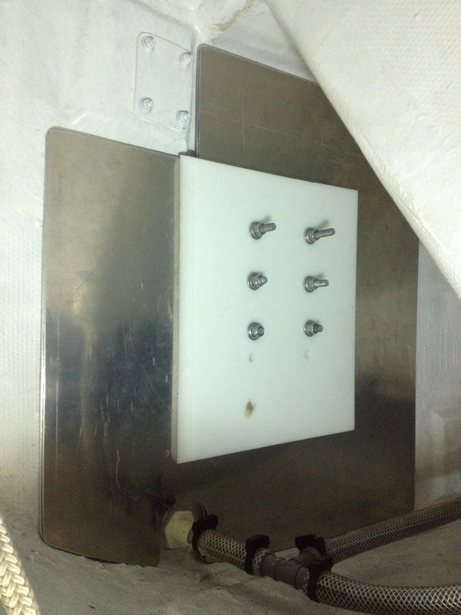

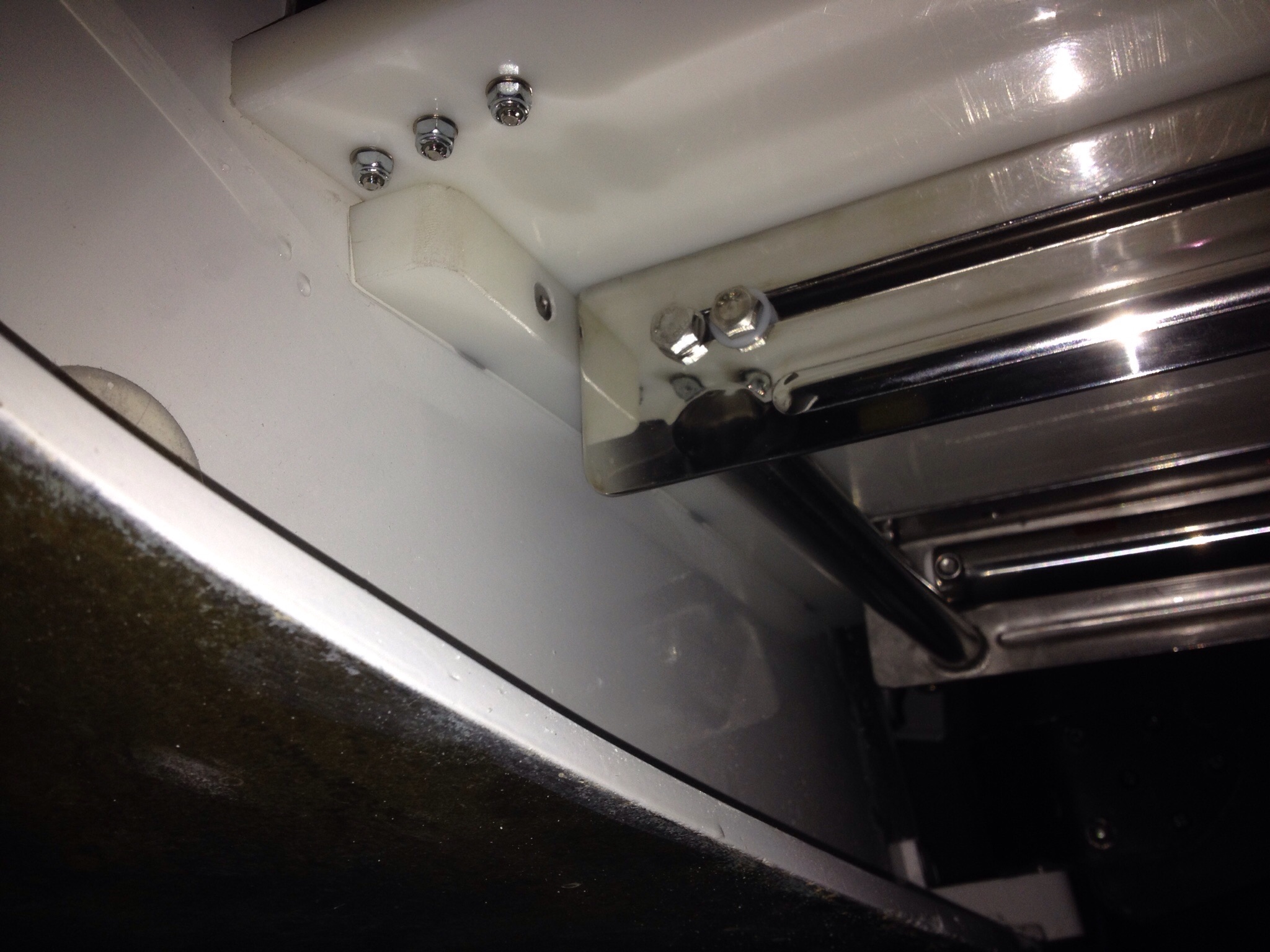

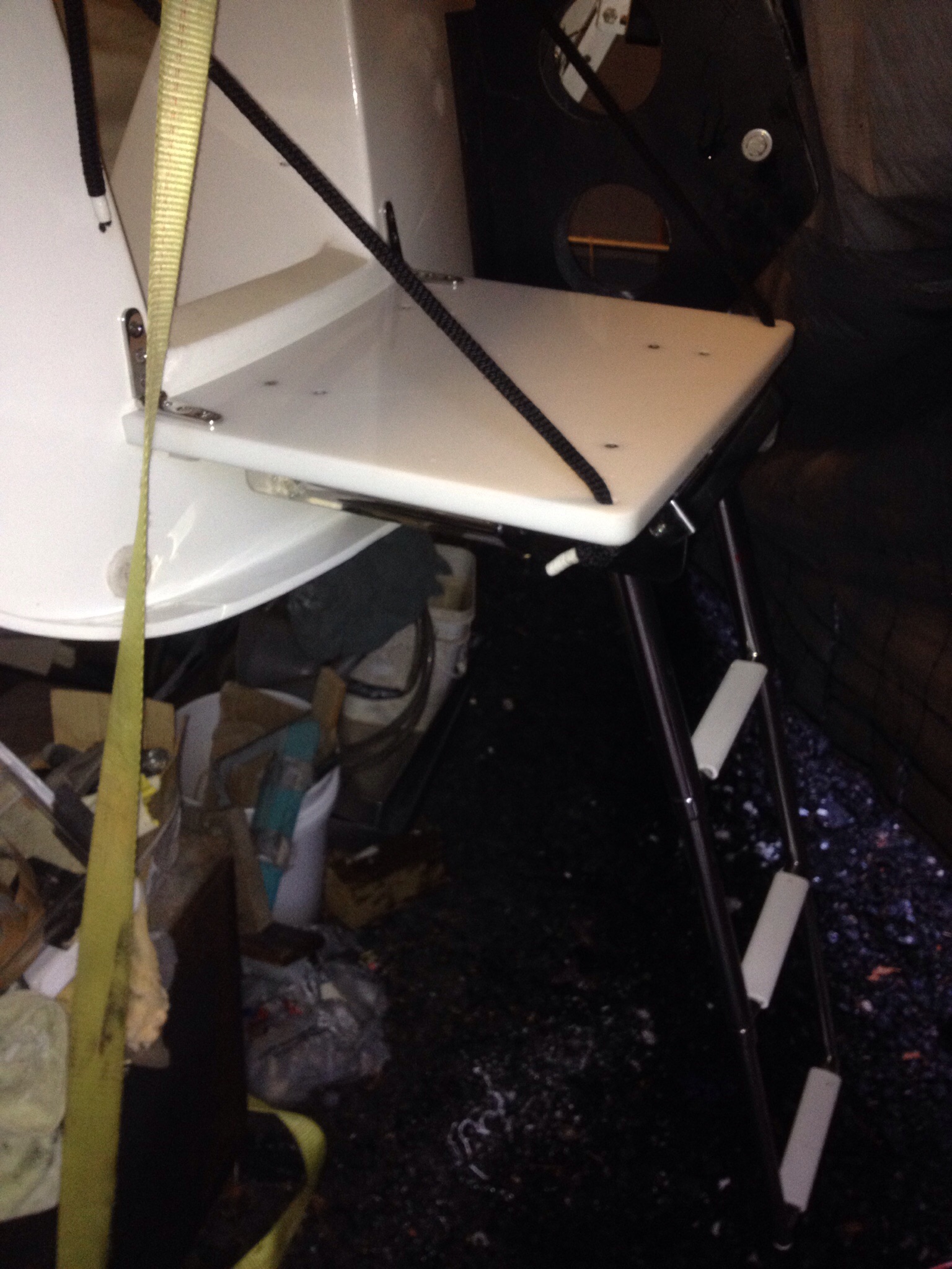

Swim platform installed (except for the support lines into the transom)
1" x 20" HDPE support sculpted and installed beneath the platform at the transom face. Any loads are now transferred to it, rather then the hinges.
Single 3/16" aluminum backing plate that conforms to the transom opening which includes the hinges and support.
The plan is to have each of the 1/2" lines enter the transom, ride over a Schafer cheek block, hang vertically, pass through a strong aluminum angle bracket (stopper) at just the right length for the platform when open.

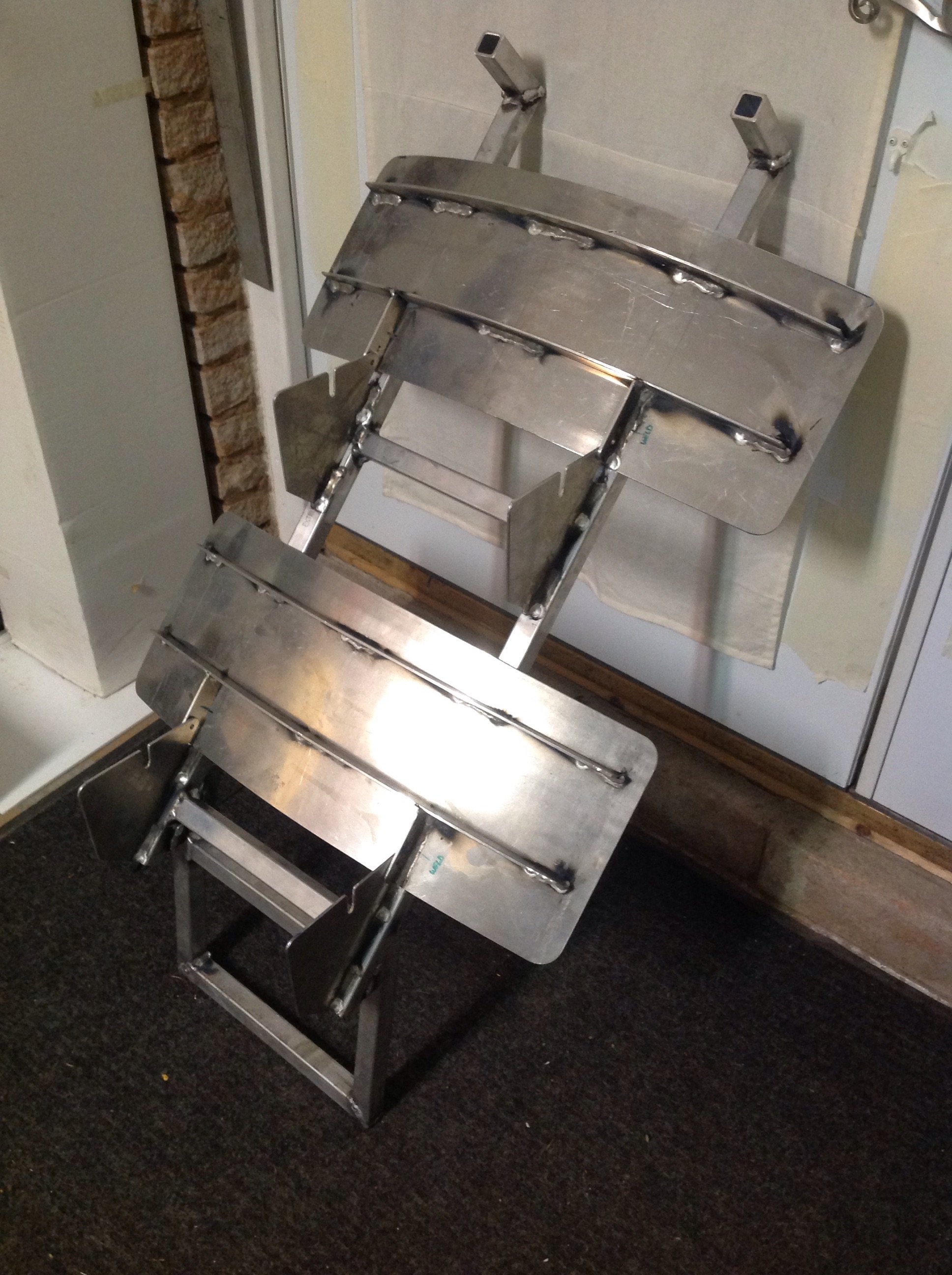

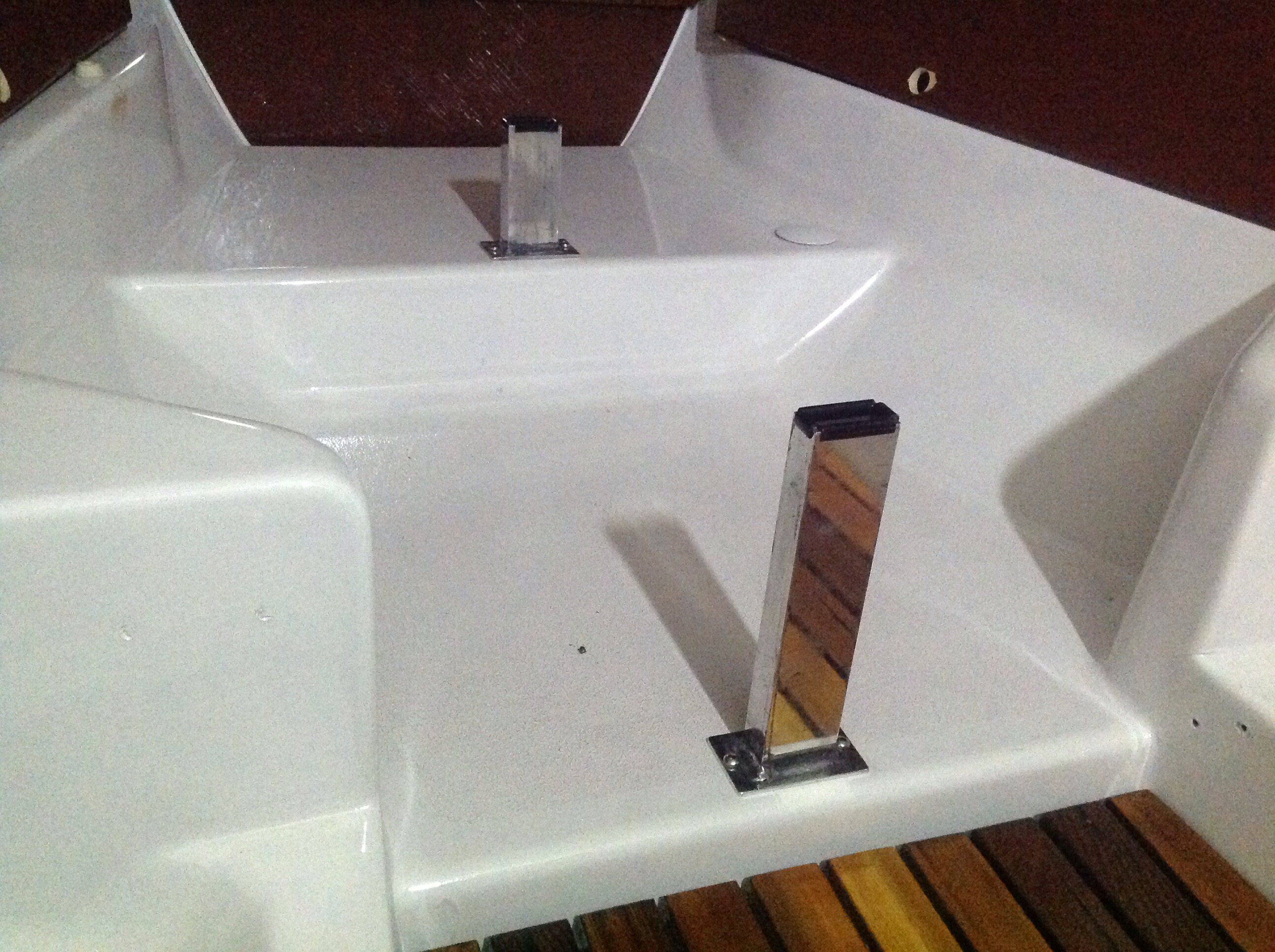

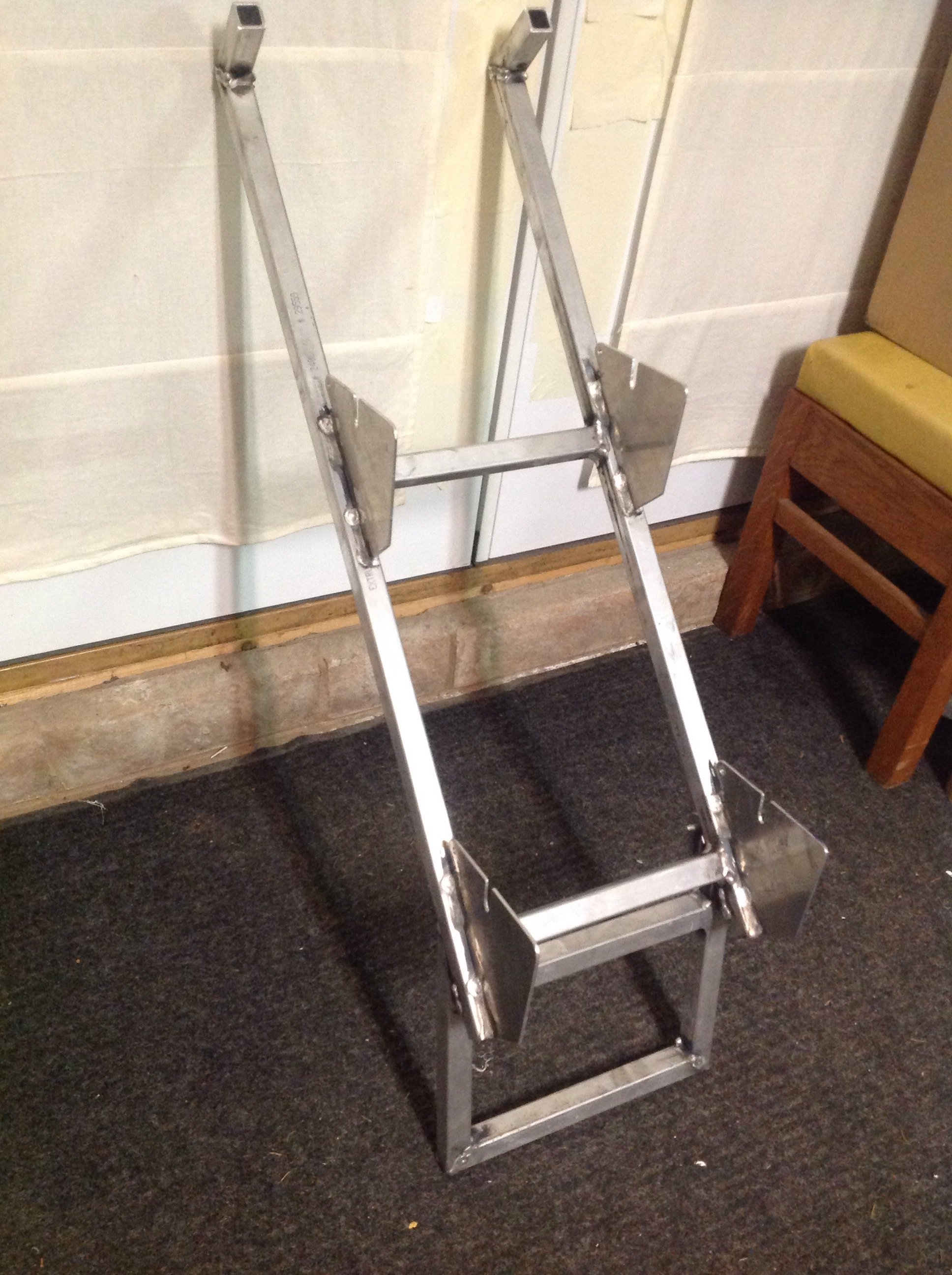

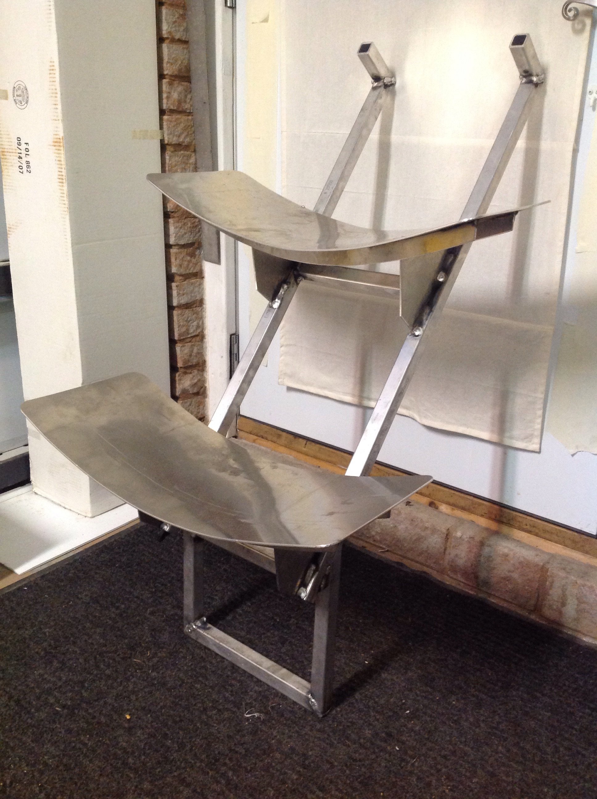

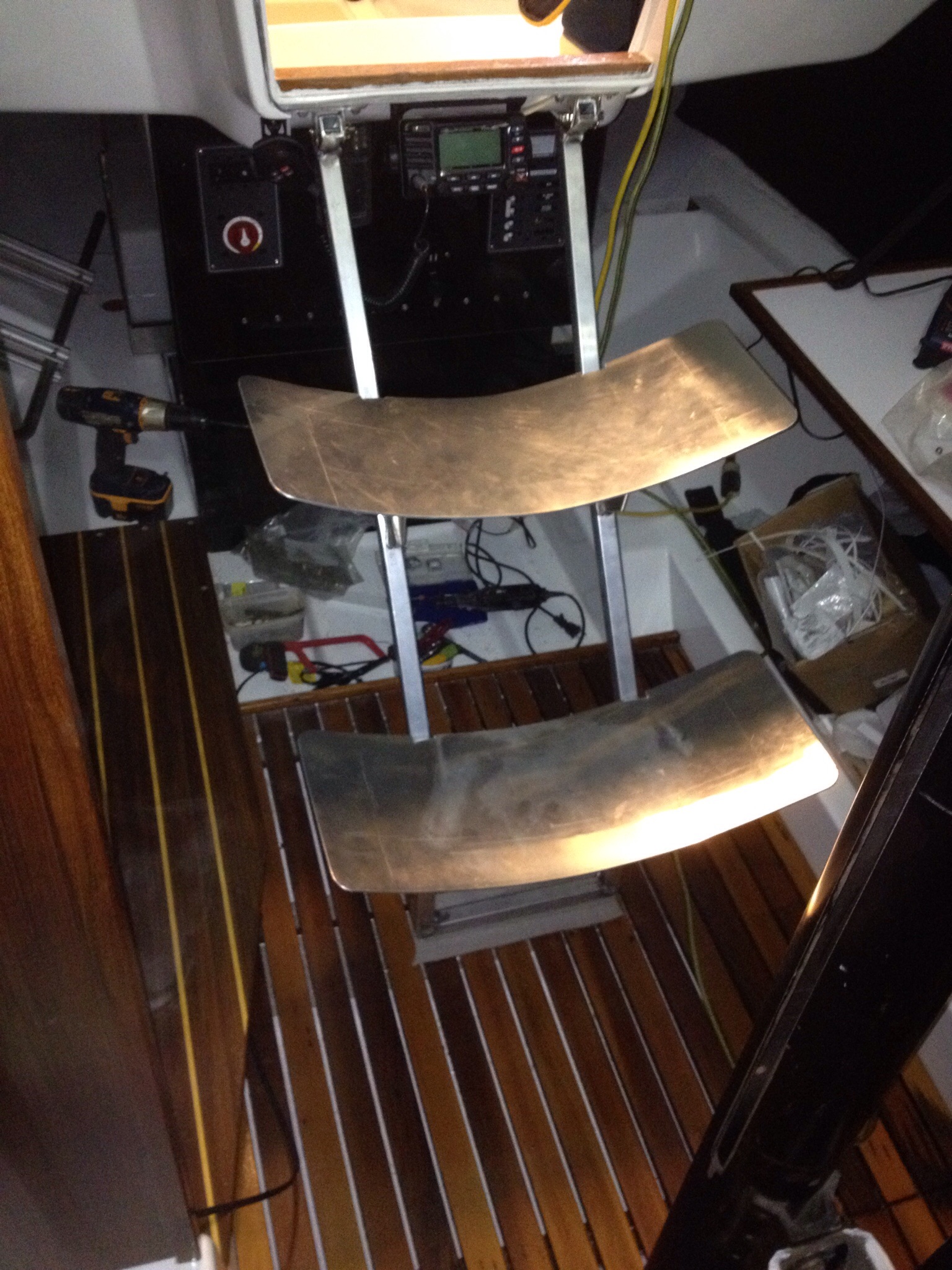

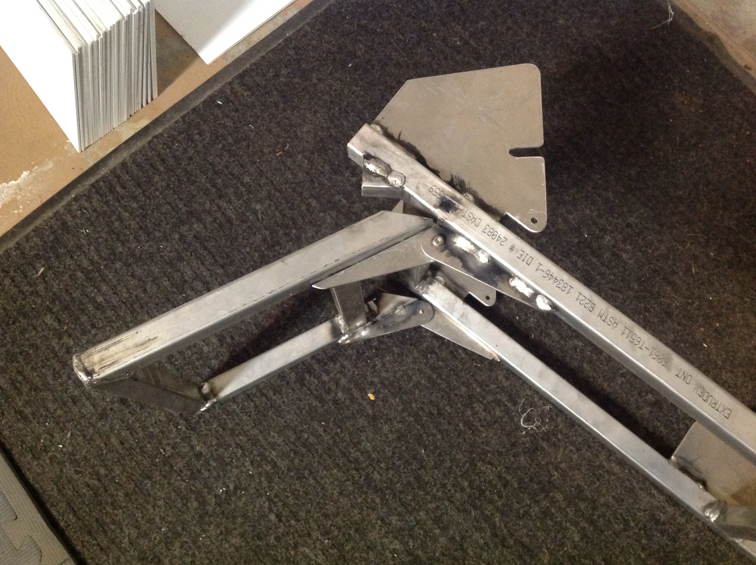

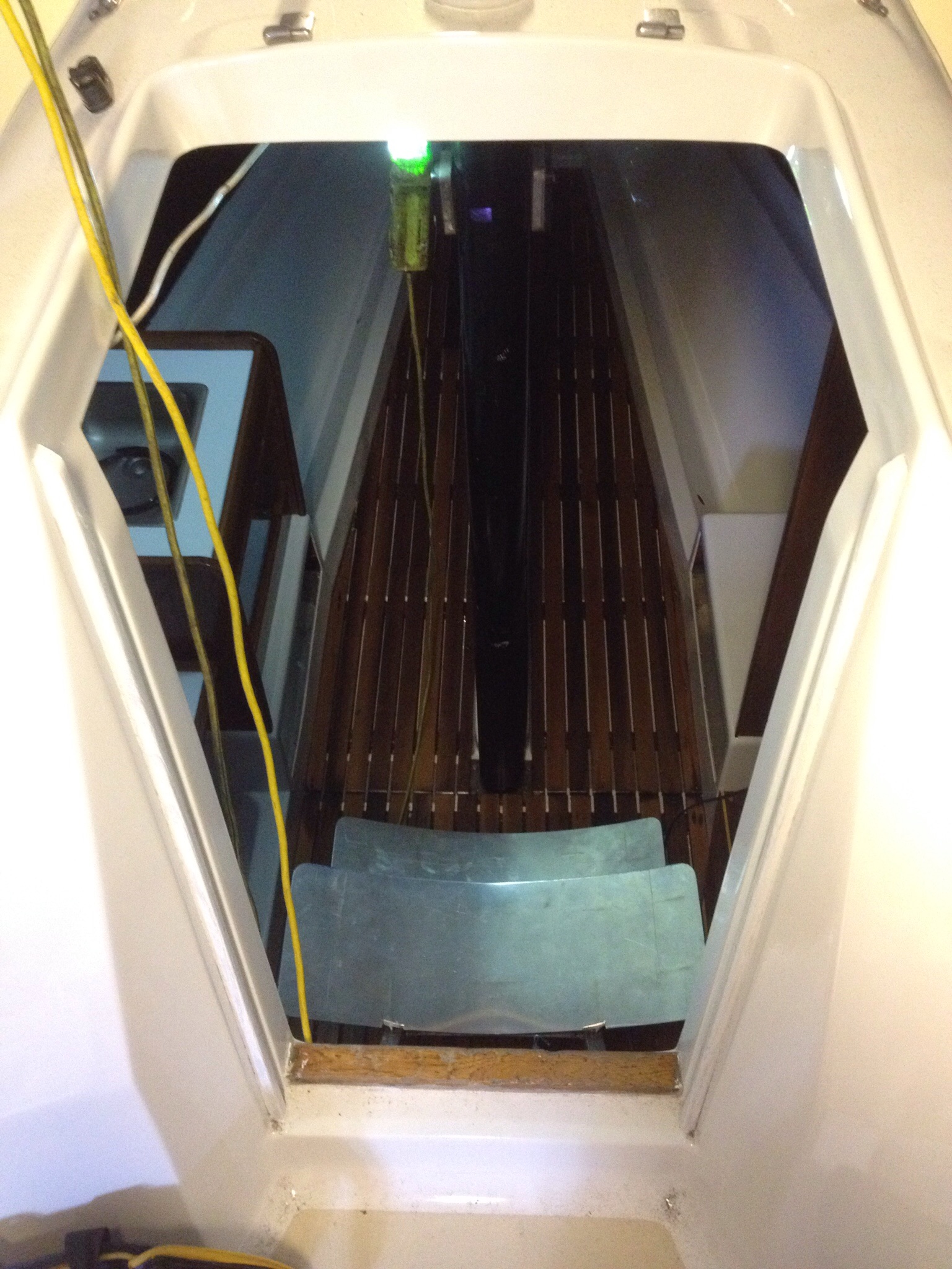

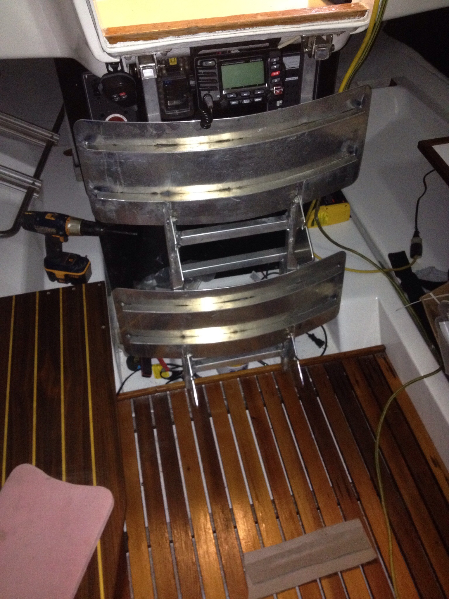

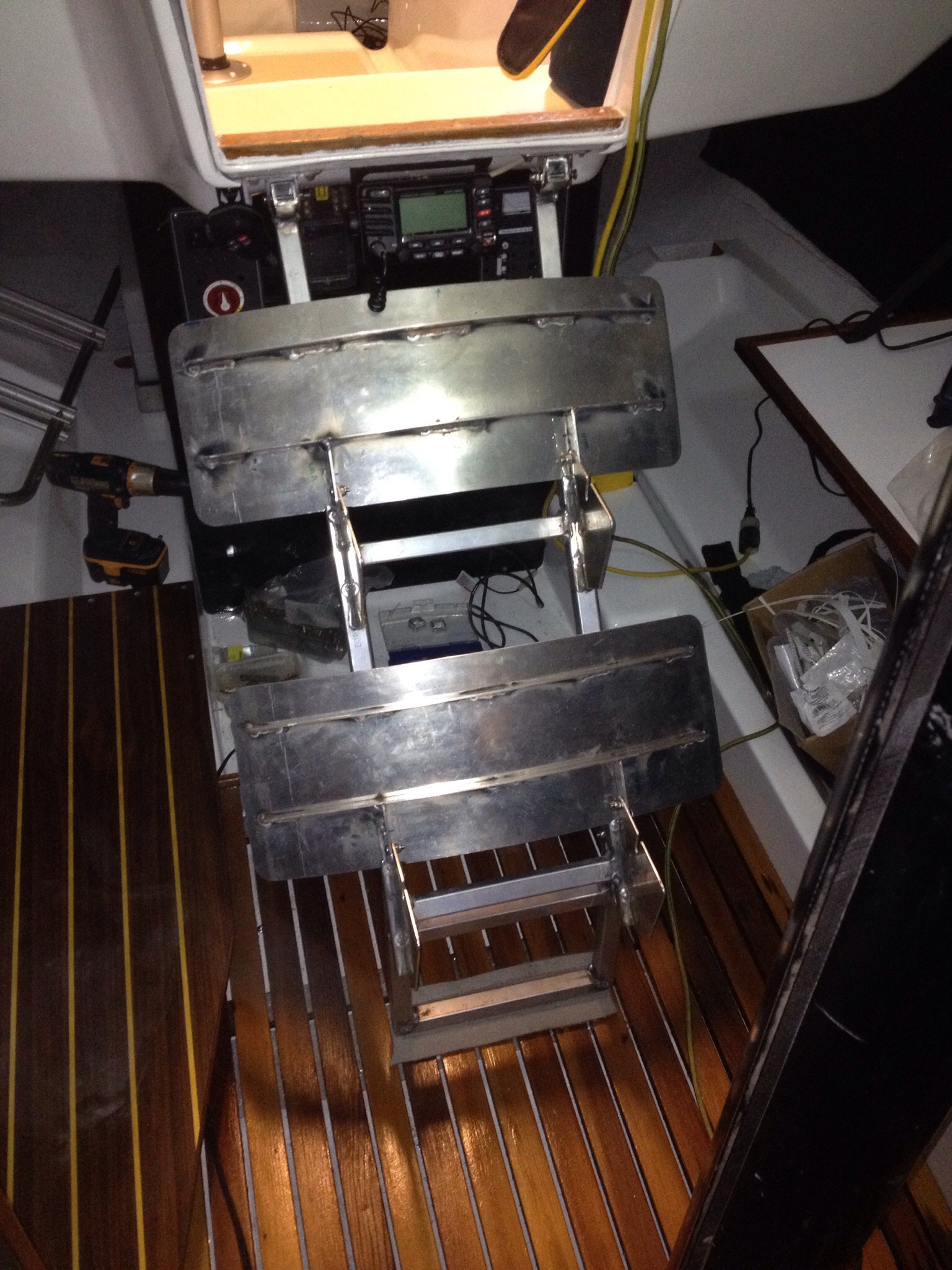

Staircase welded...will be cleaning up the welds, and buffing it up.
Then install the wood slats on the steps to match the cabin sole.

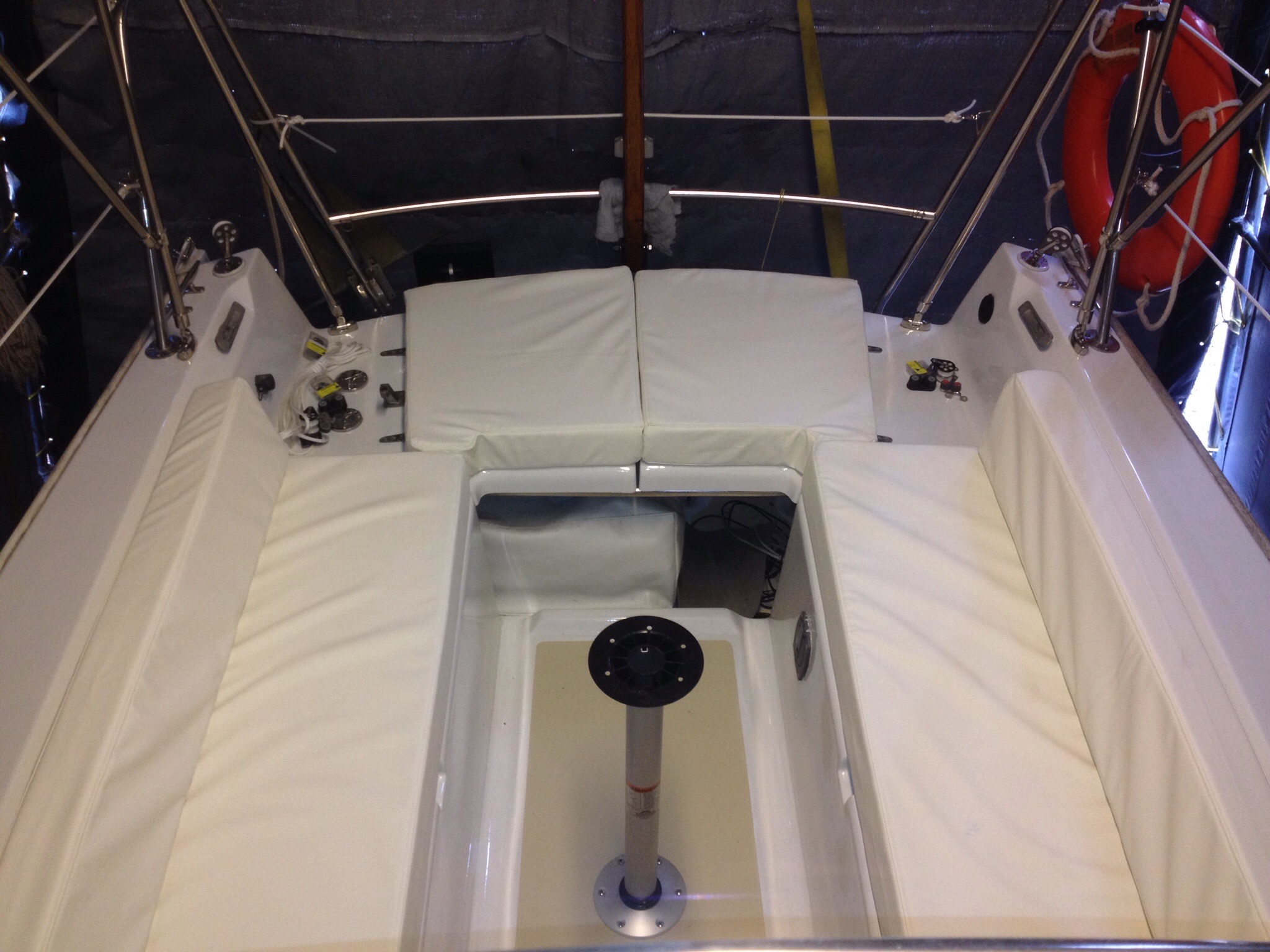

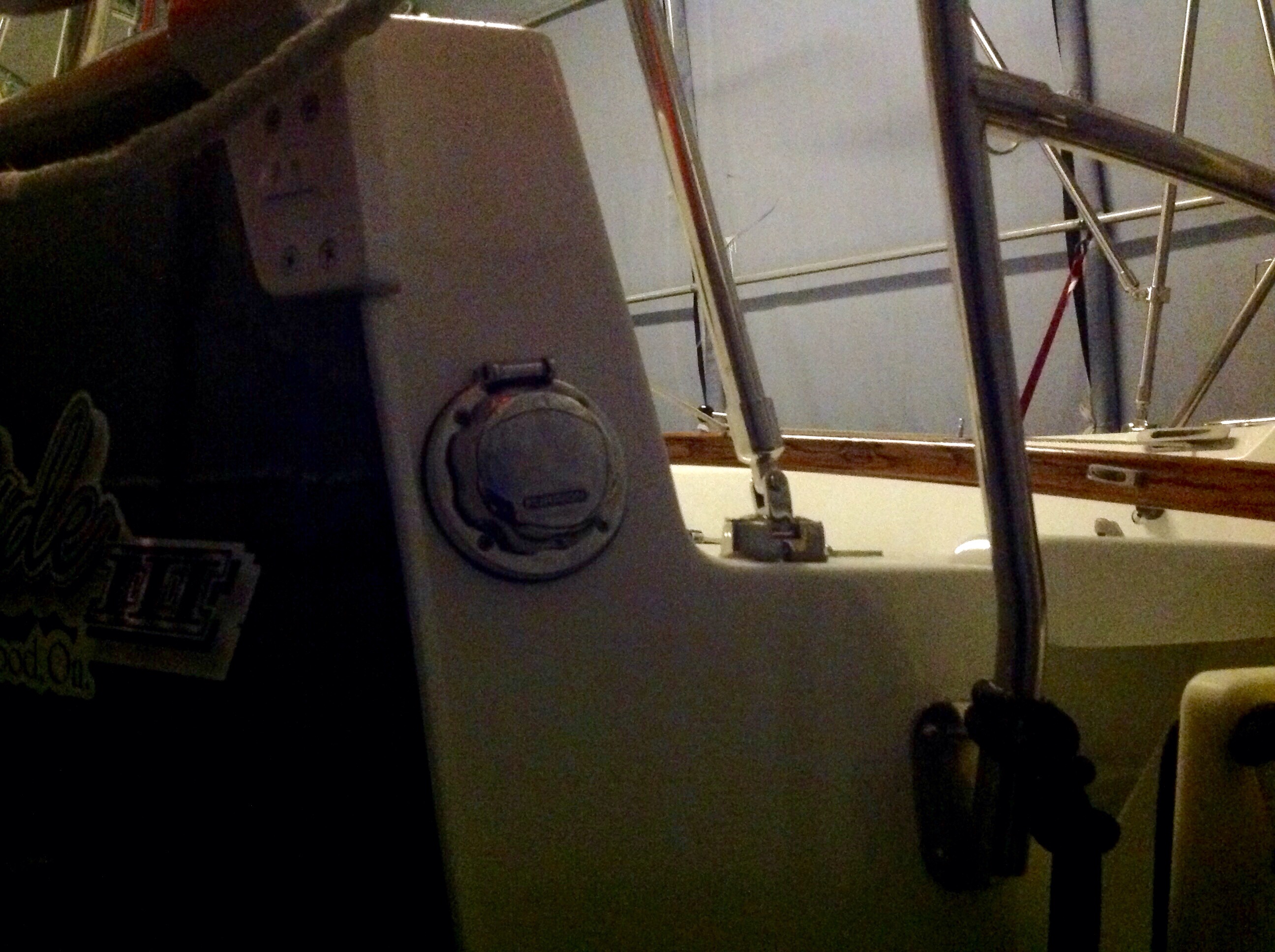

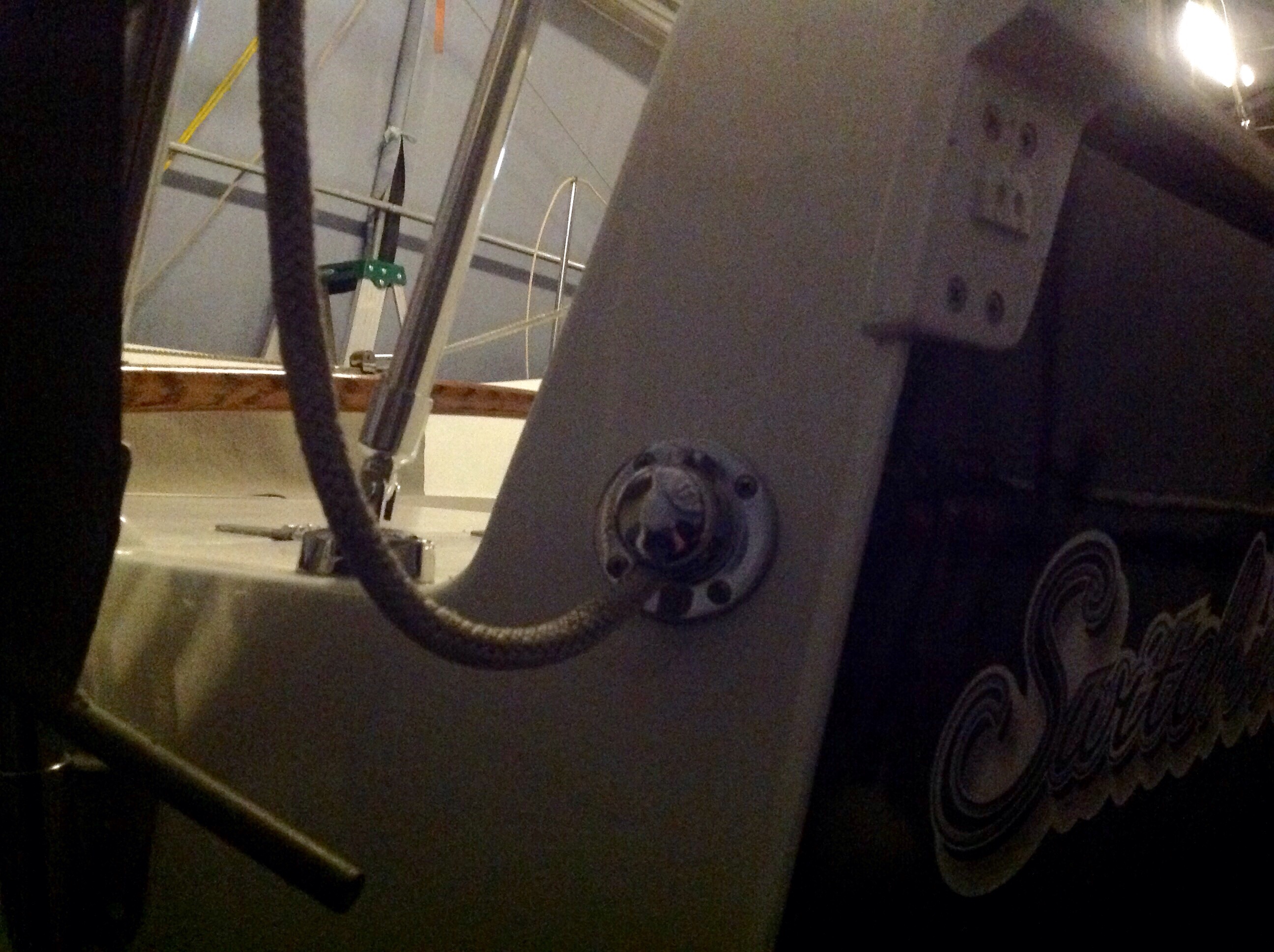

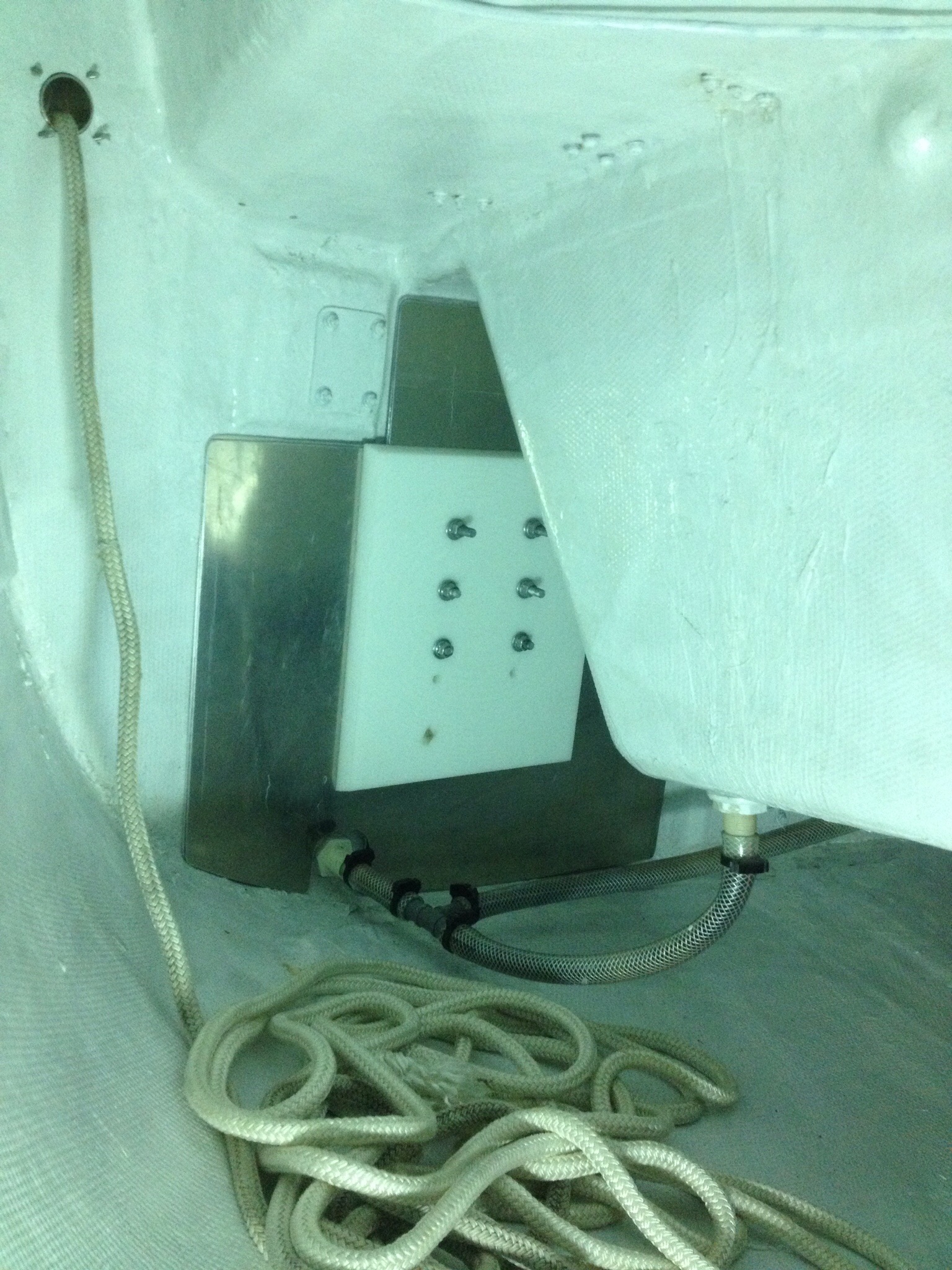

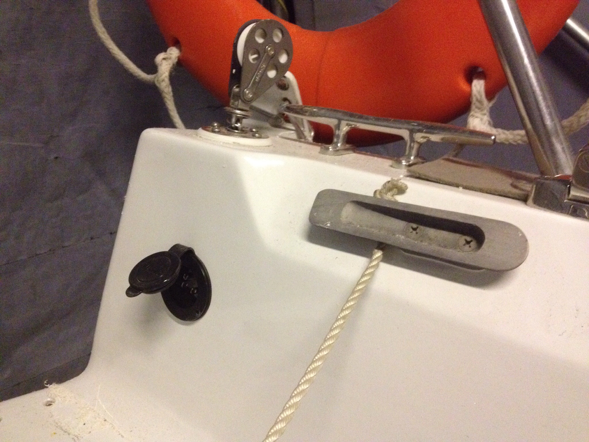

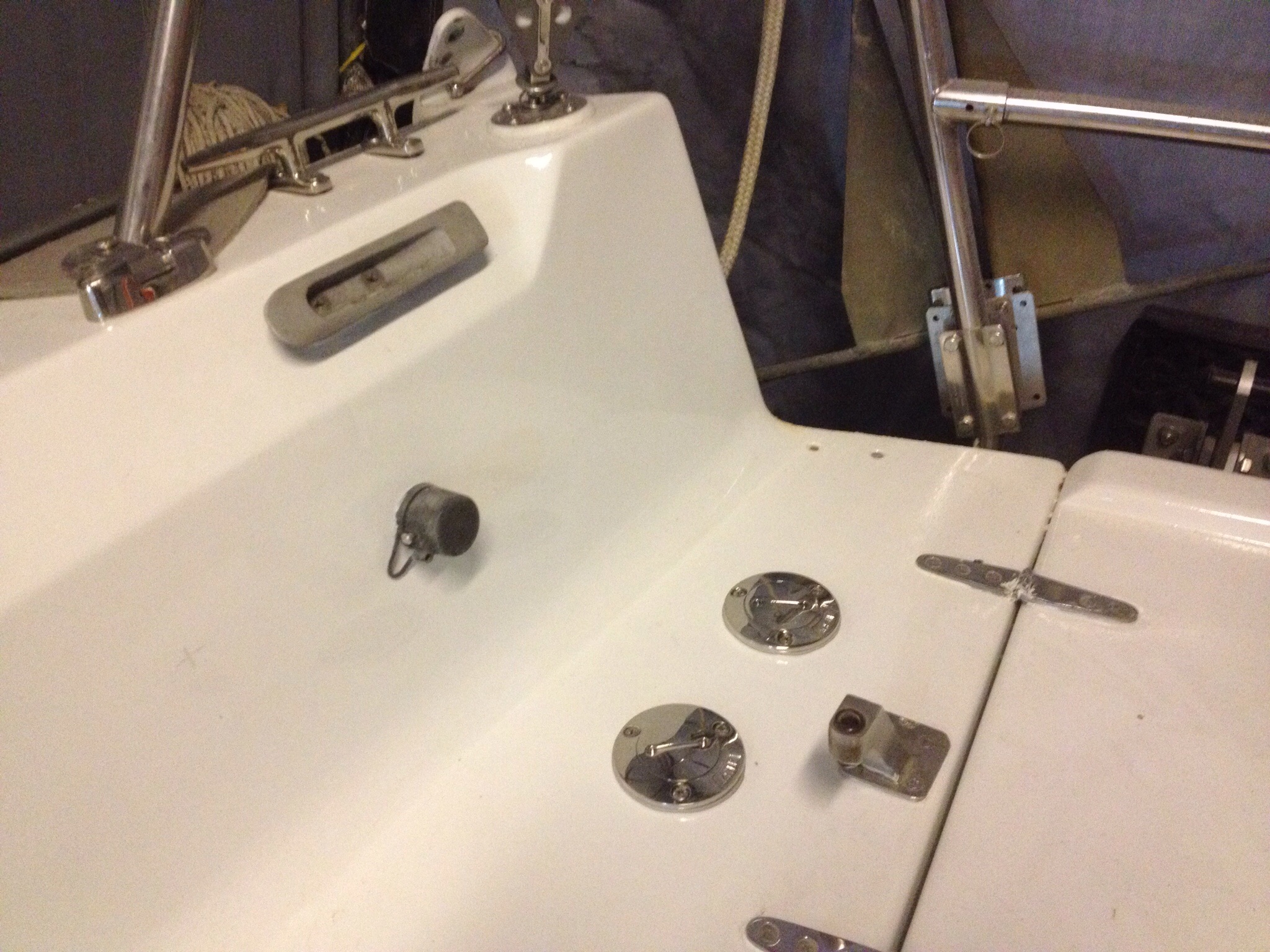

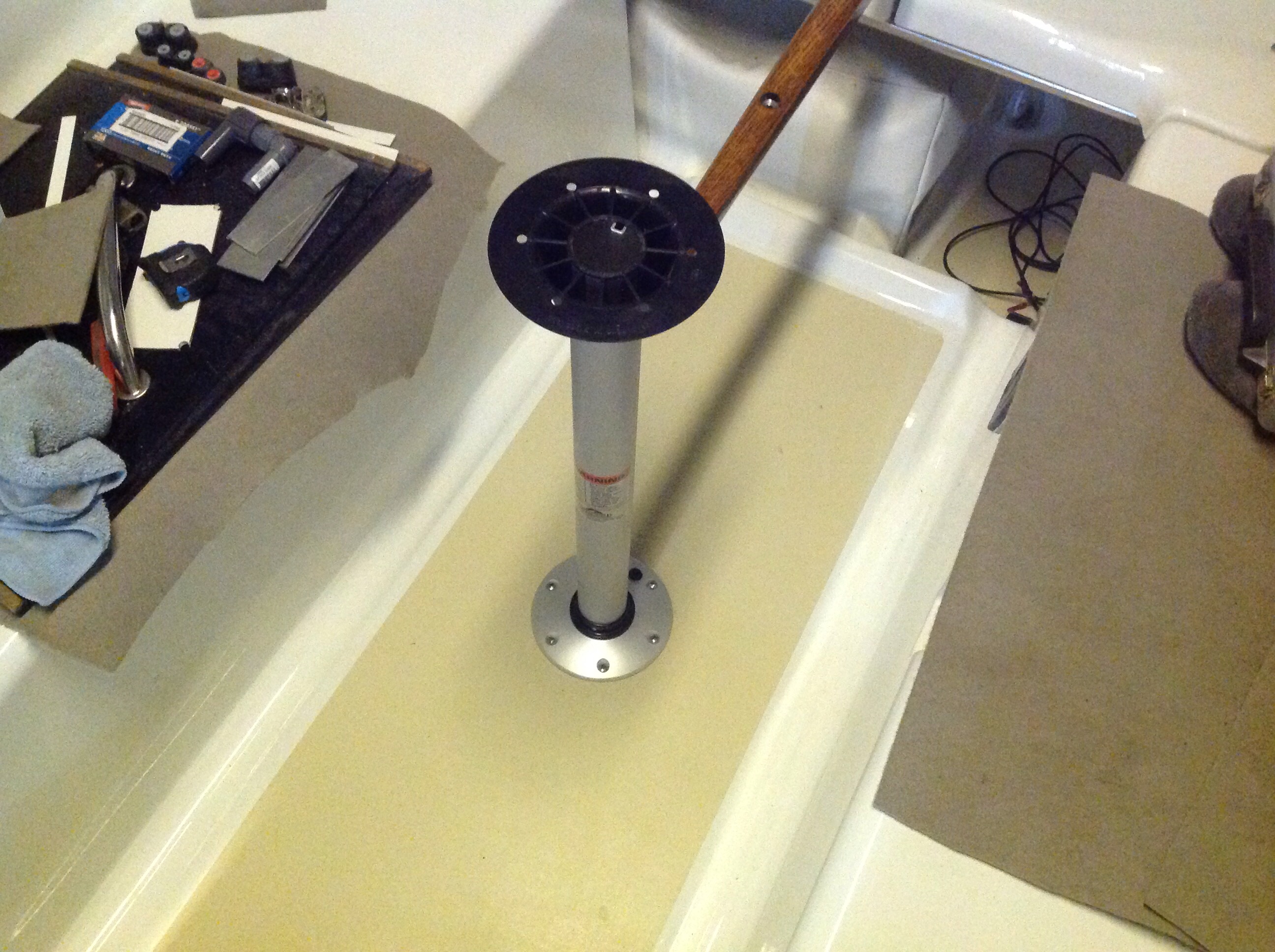

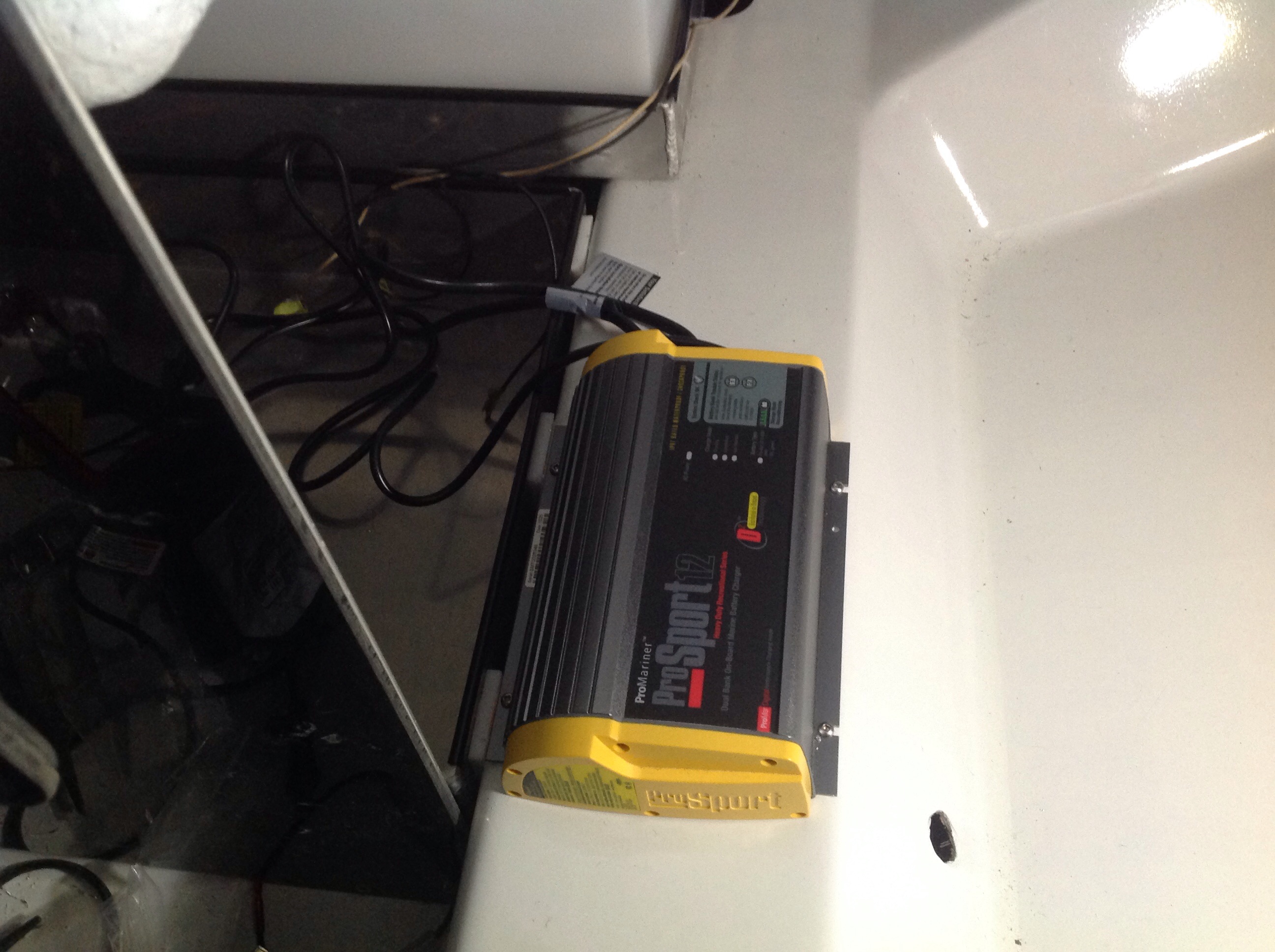

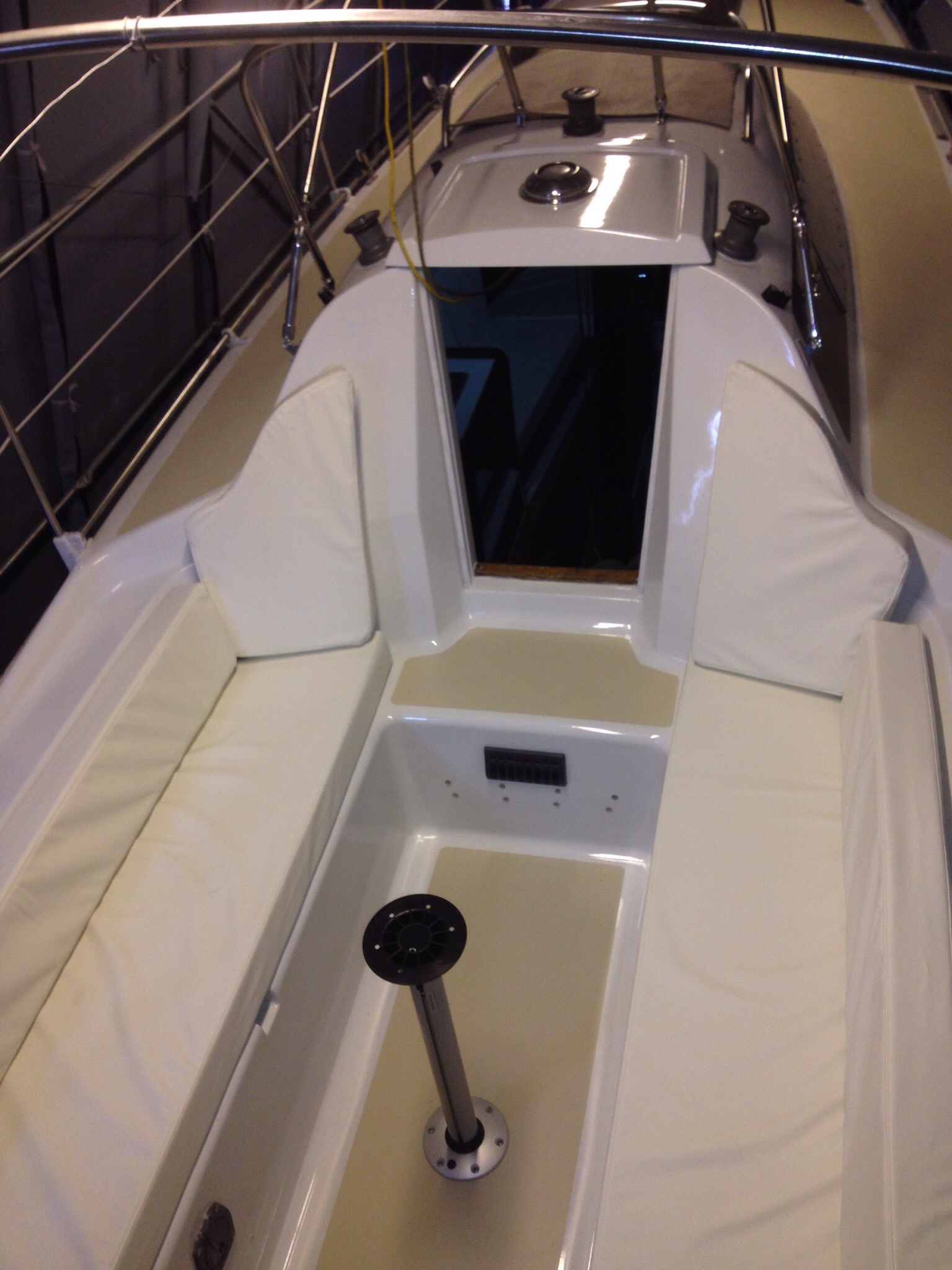

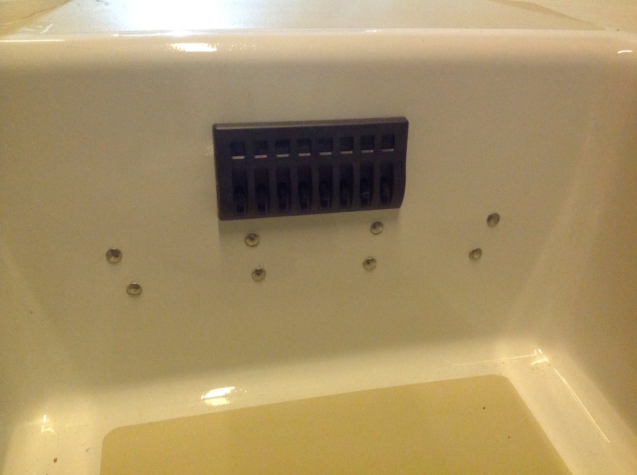

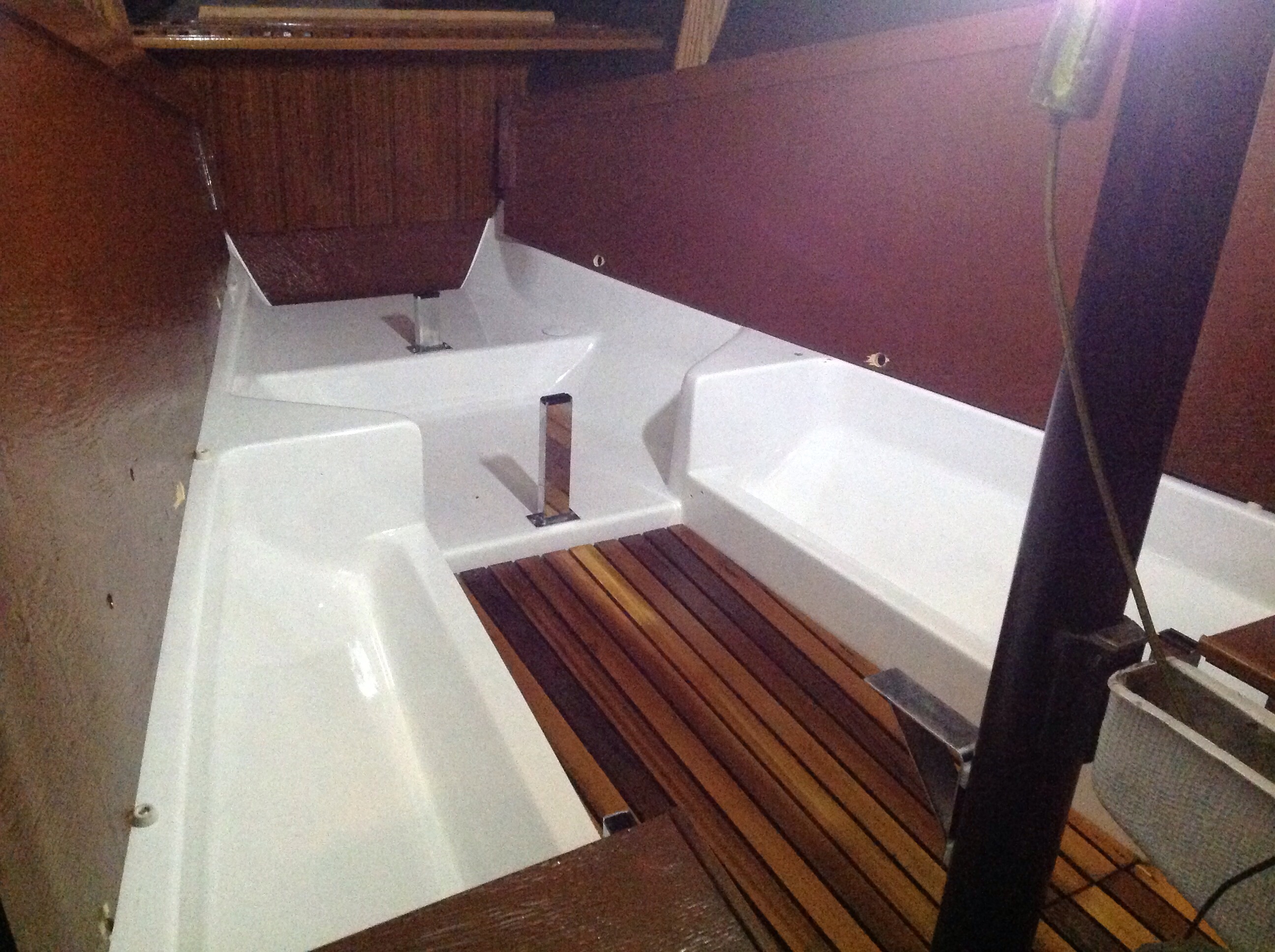

Some cockpit additions. Weatherproof switch panel, cockpit table pedestal (doubling as Nav. Pod - more on that later)...SS waste & water deck fills, 30A Furrion shore power plug, aft anchor rode deck pipe, and a generator plug in for the Pro Sport battery charger.

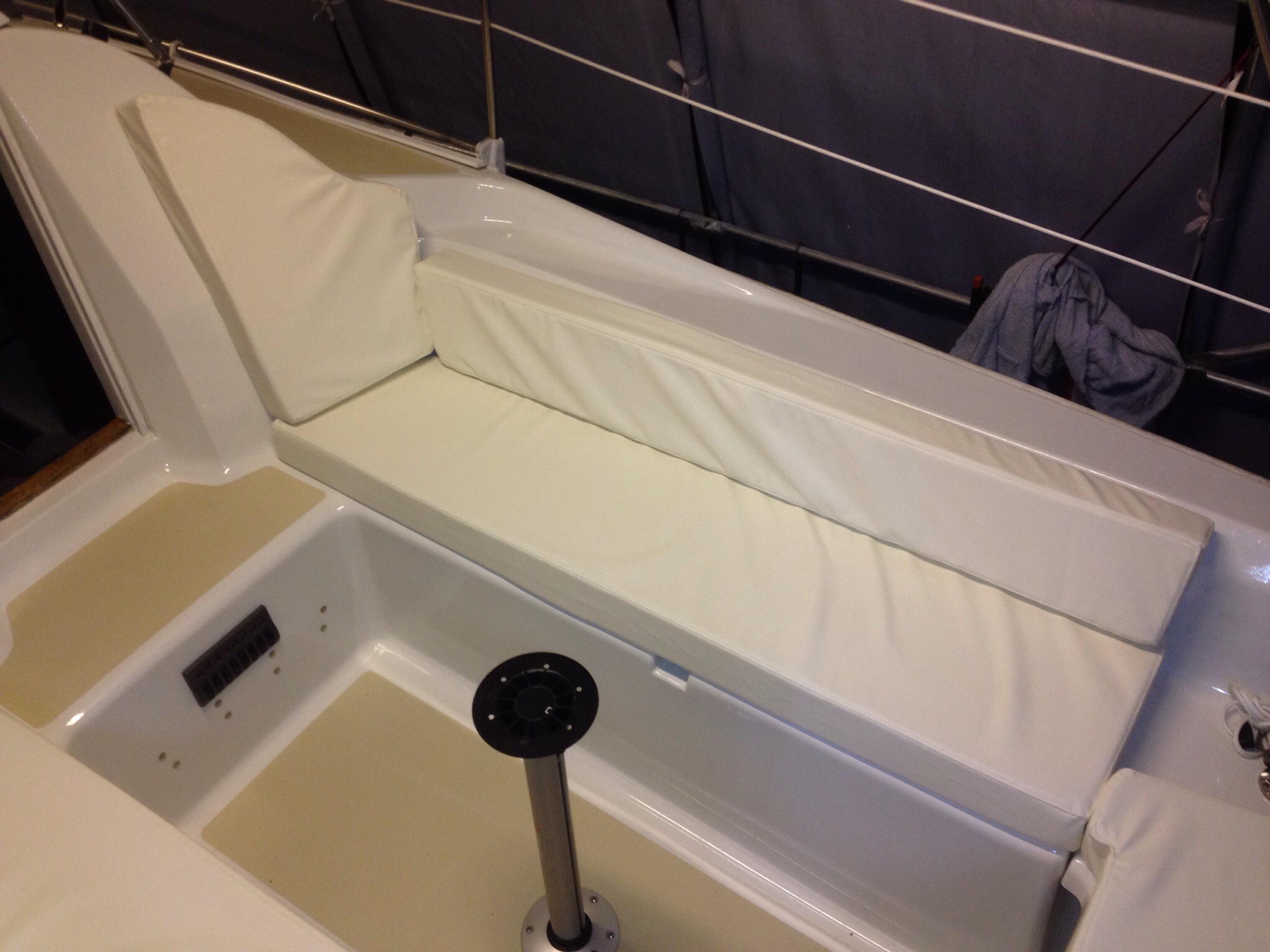

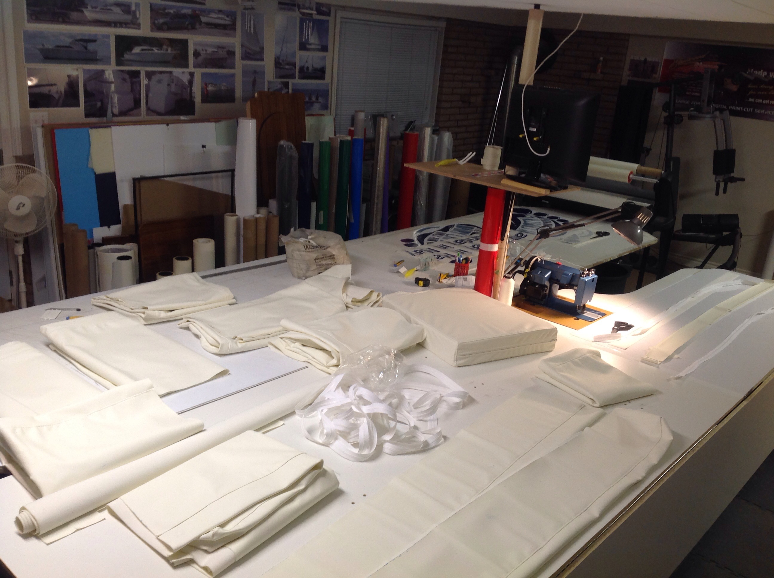

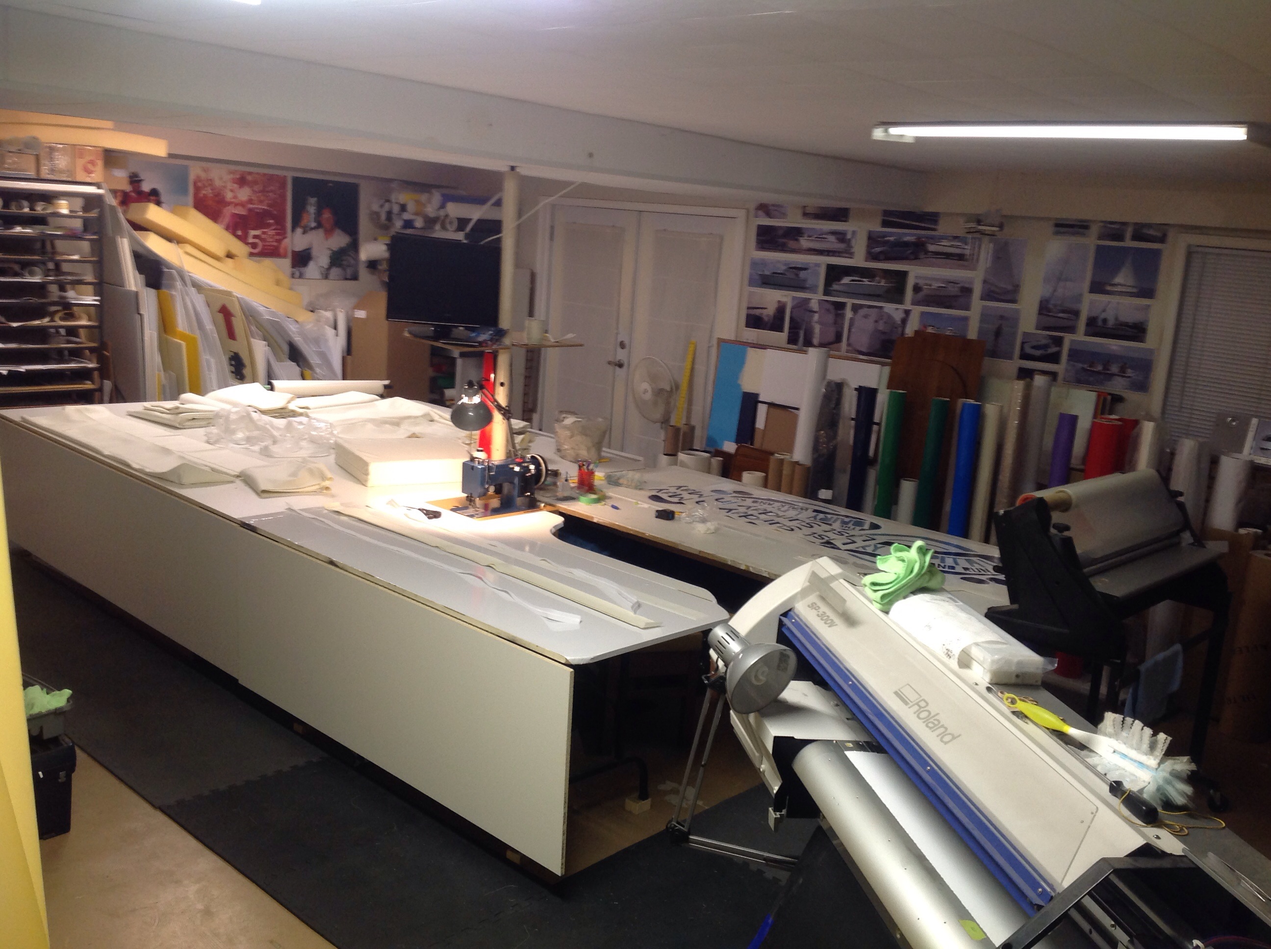

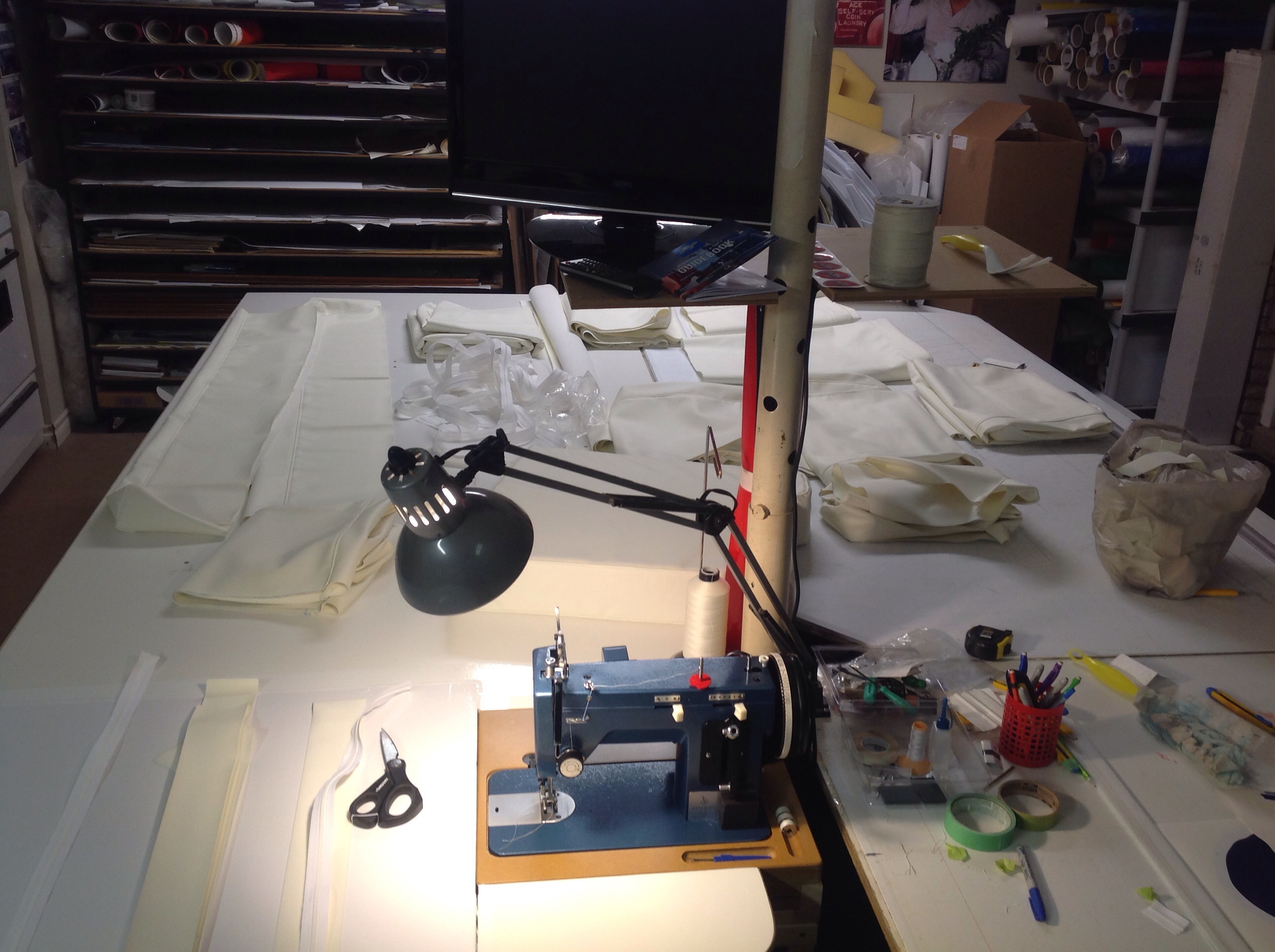

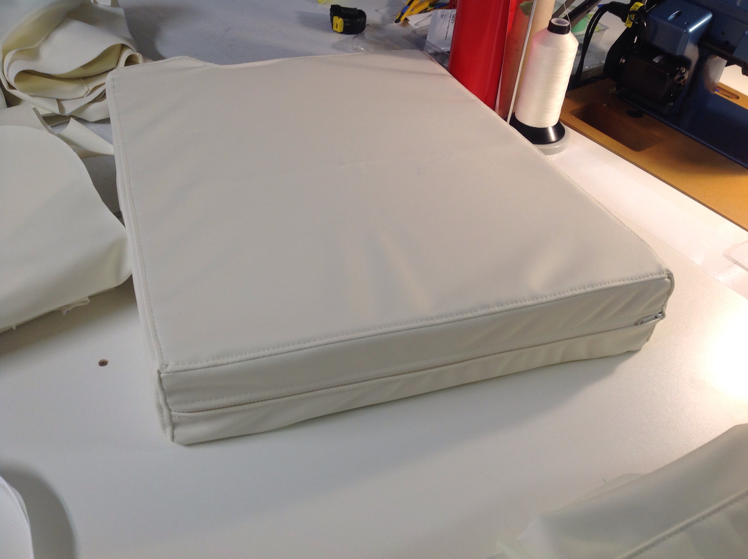

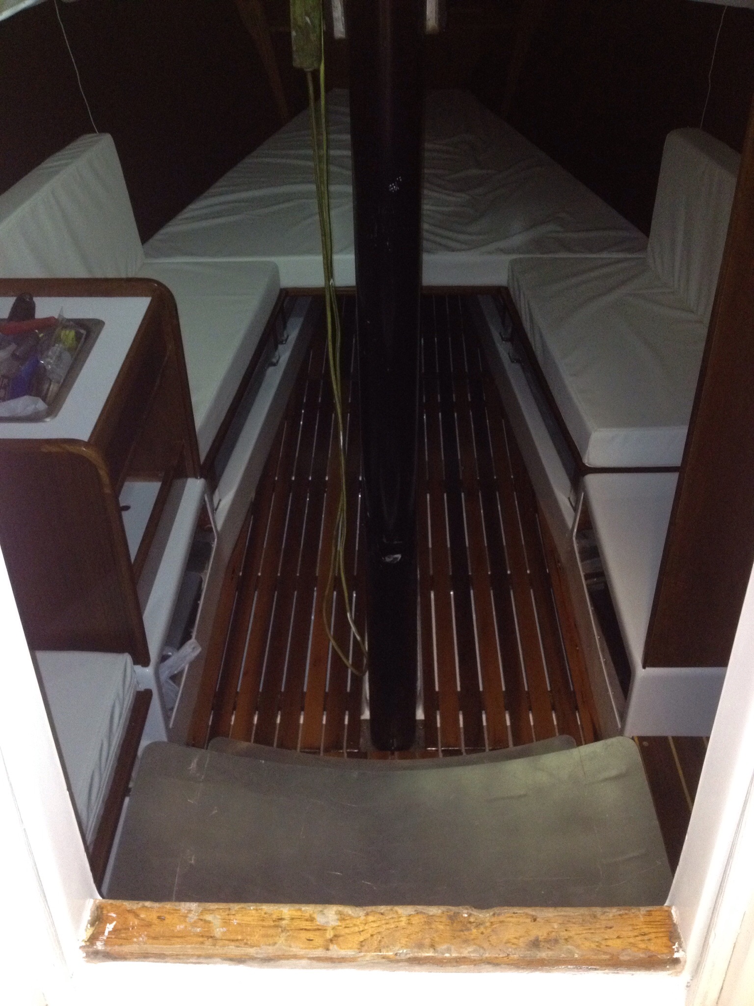

Purchased a new Sailrite Ultrafeed LSZ-1. Built it in my tables (it is still portable though if need be)
Been sewing up a storm...all 4" cushions inside and out covered with NaugiSoft marine.

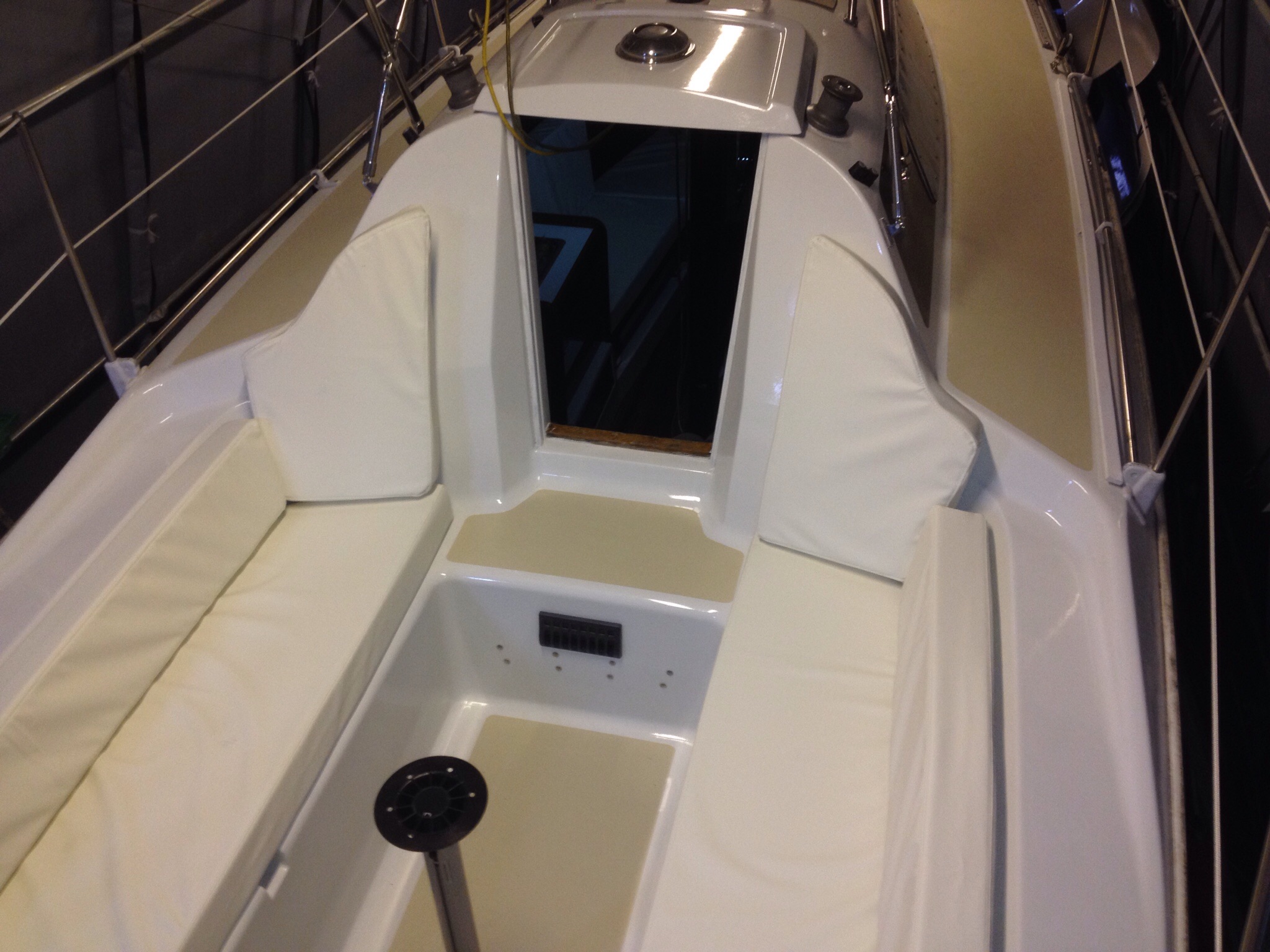

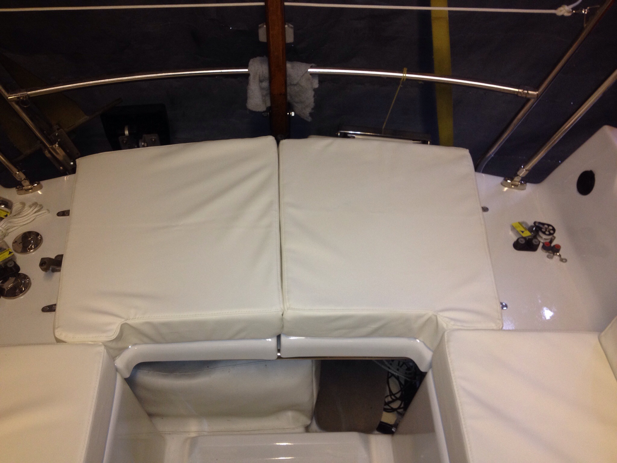

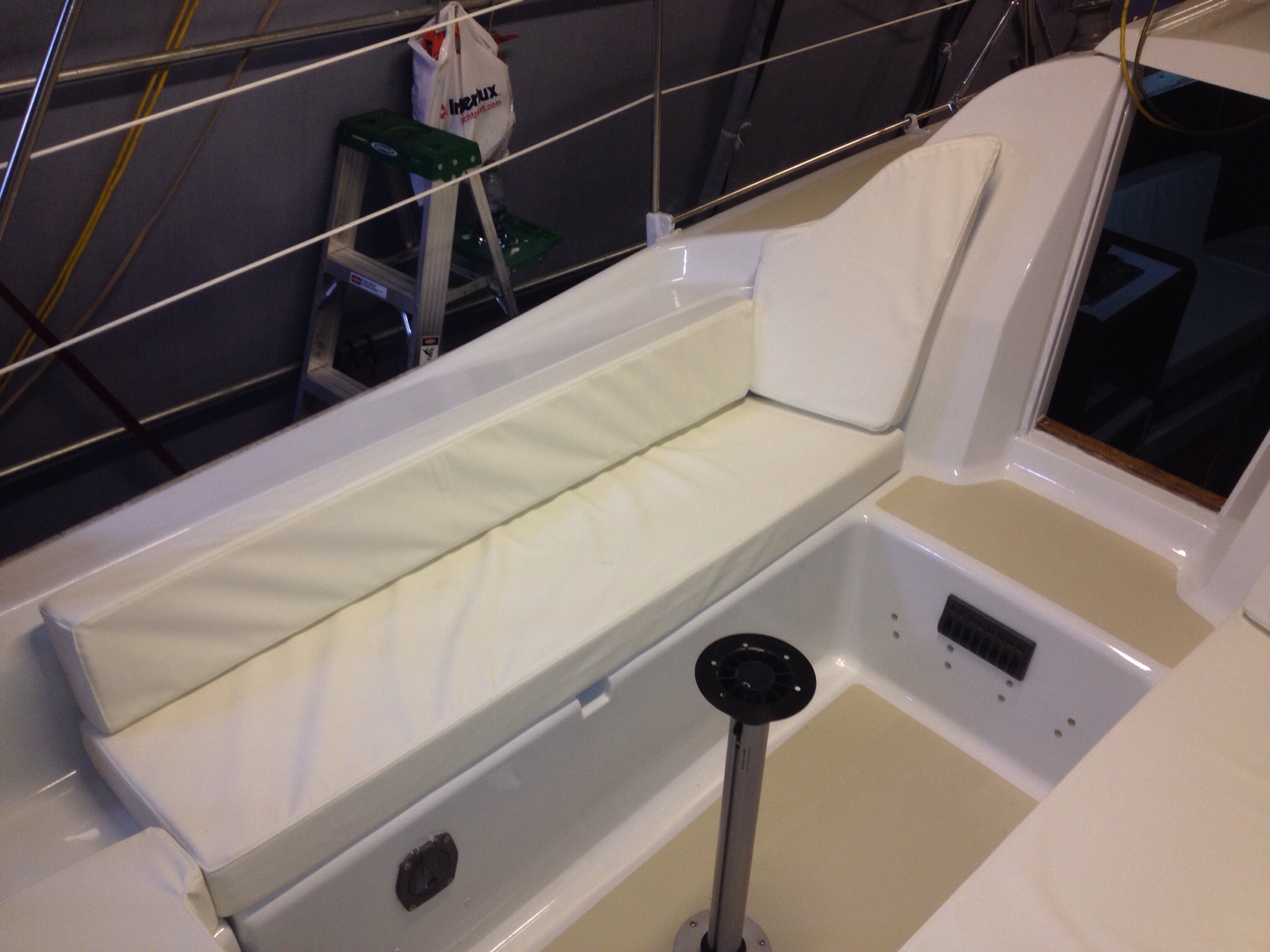

Cushions are done....not perfect but hey, top end 4" high density cushions & top end supple leather like NaugiSoft vinyl, and about a third of the cost of having it professionally done.
In fact, I was able to pay for my new Sailrite Ultrafeed and then some with my savings.
