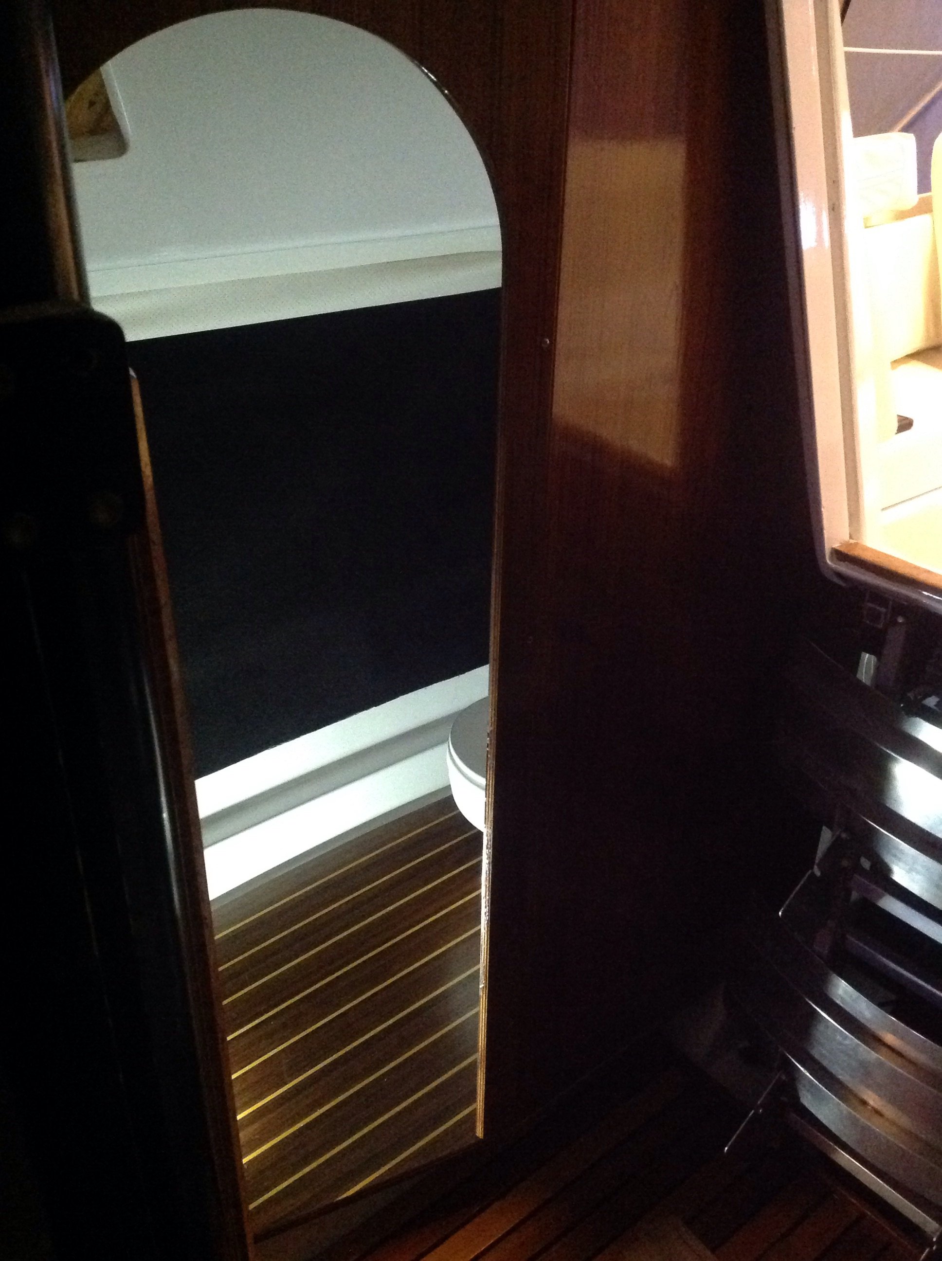

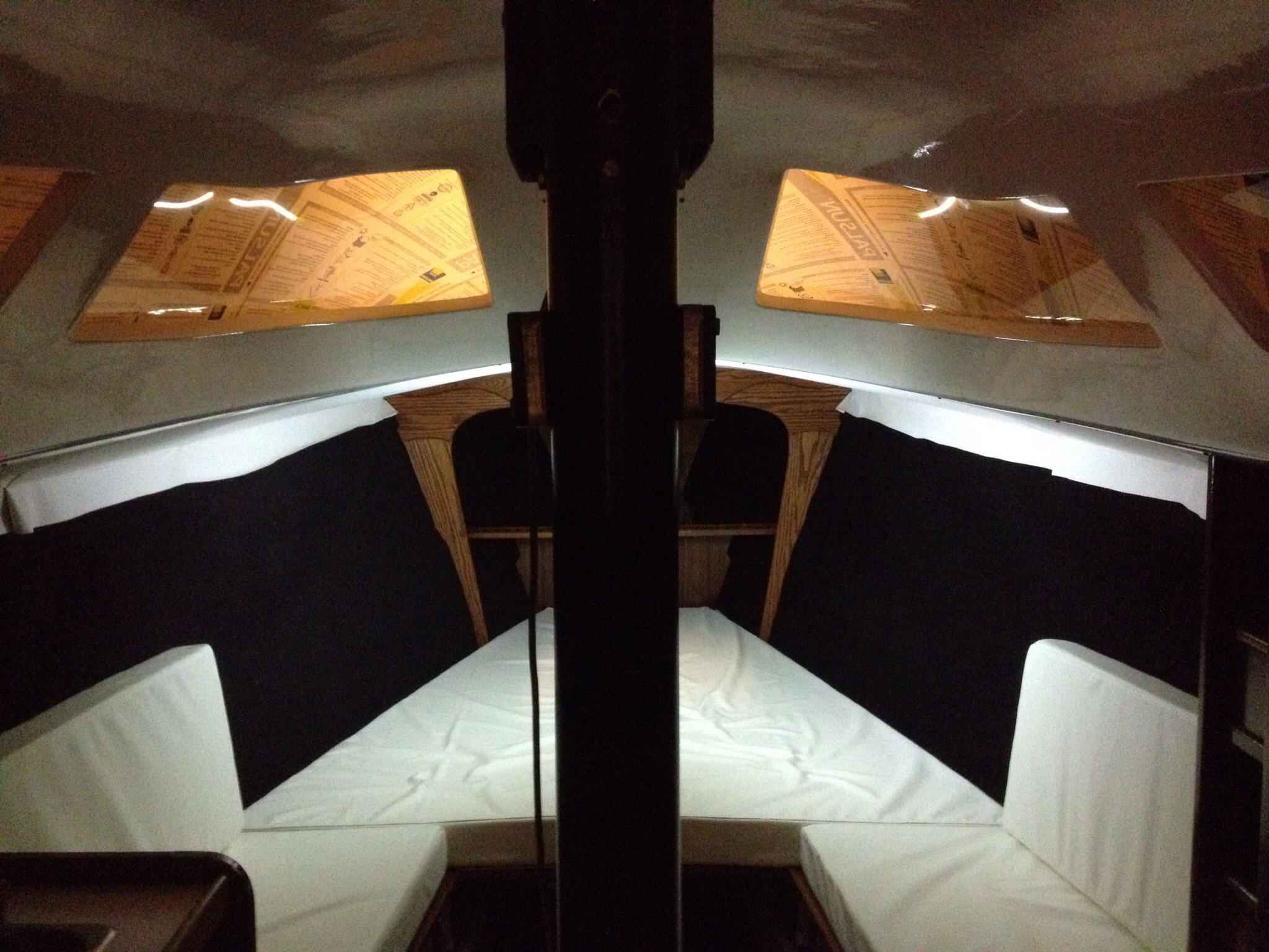

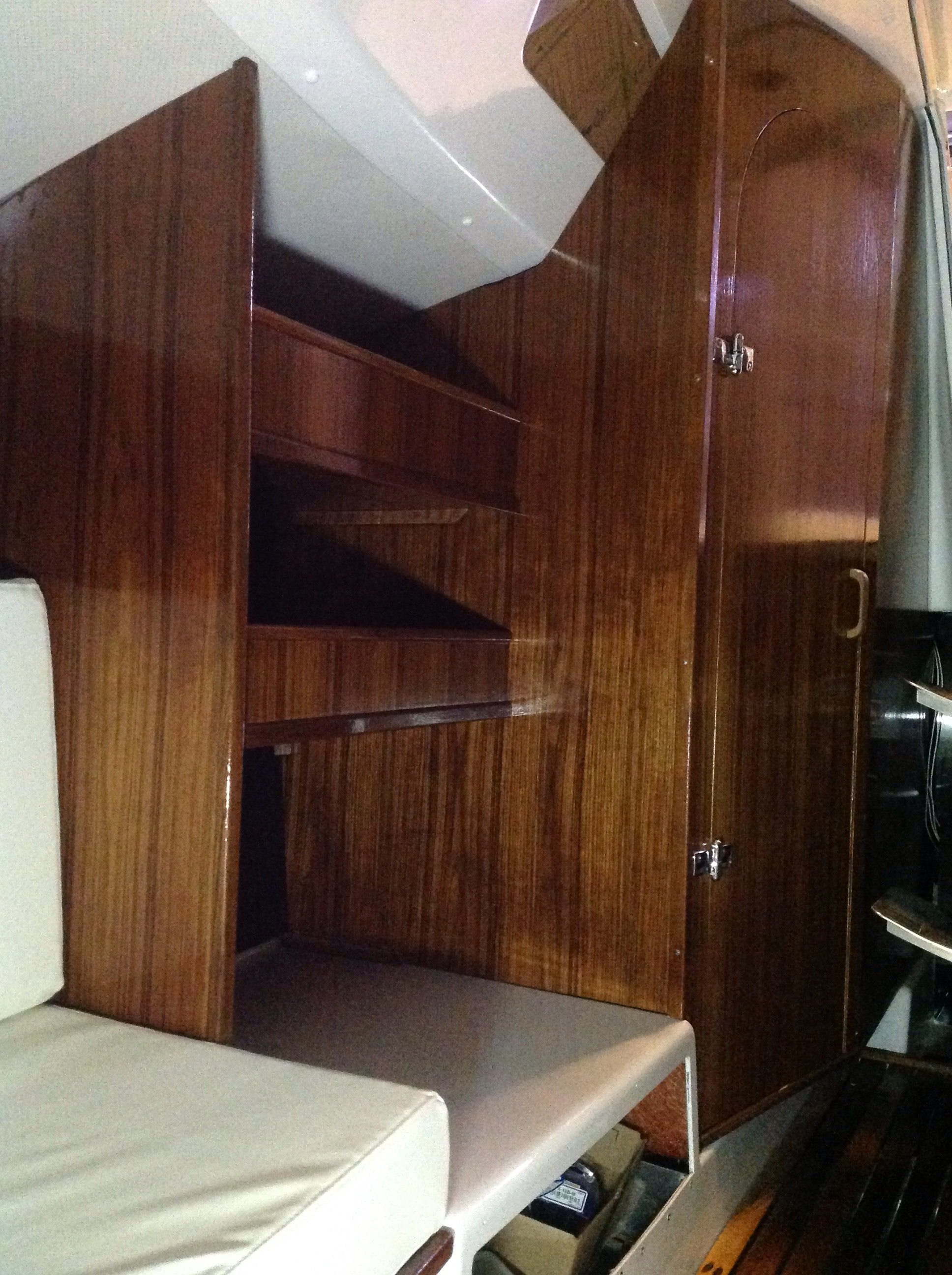

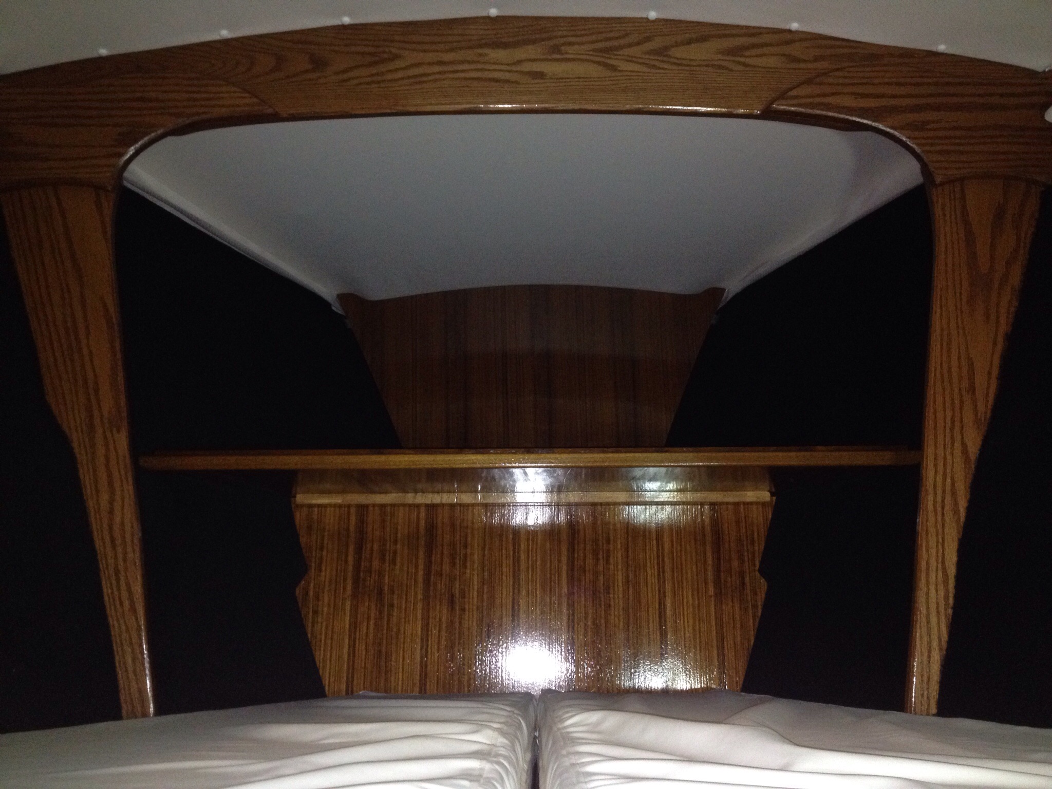

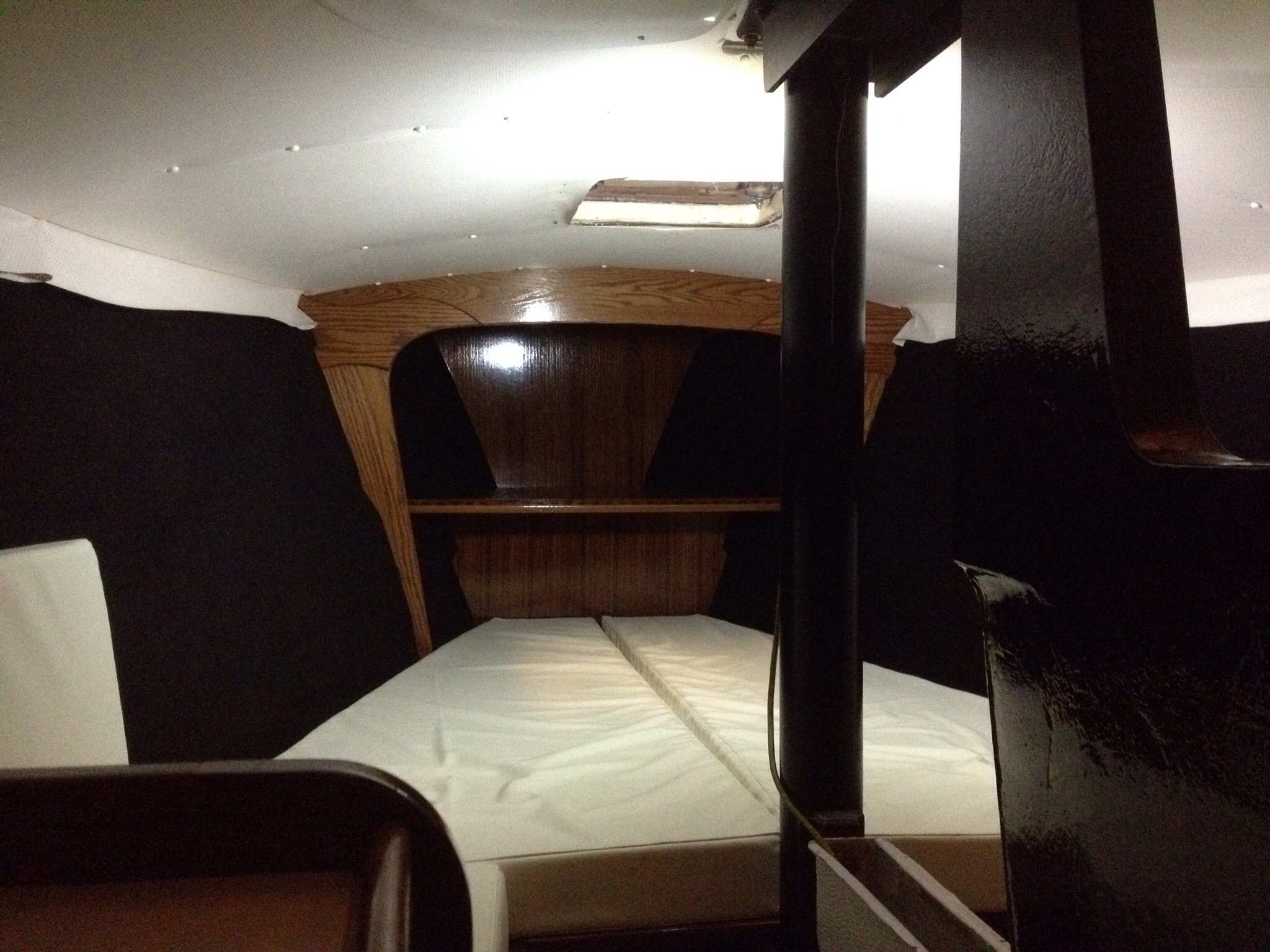

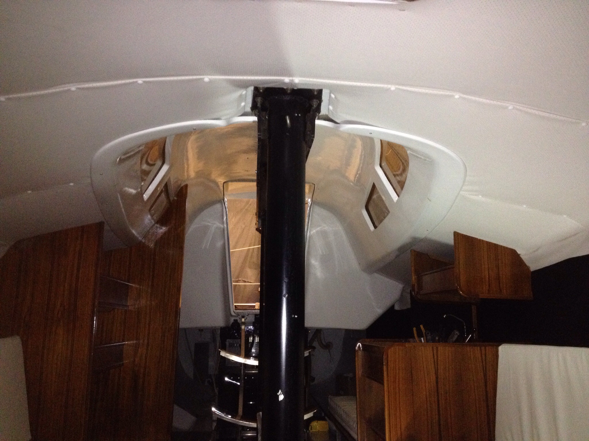

Headliners...soft & hard finally finished.
The outer edges of the soft liner that is hanging over the black hull liner will be fastened down behind teak trim that runs the cabin length at the deck and hull joint.
Have to run all new wiring behind them first.

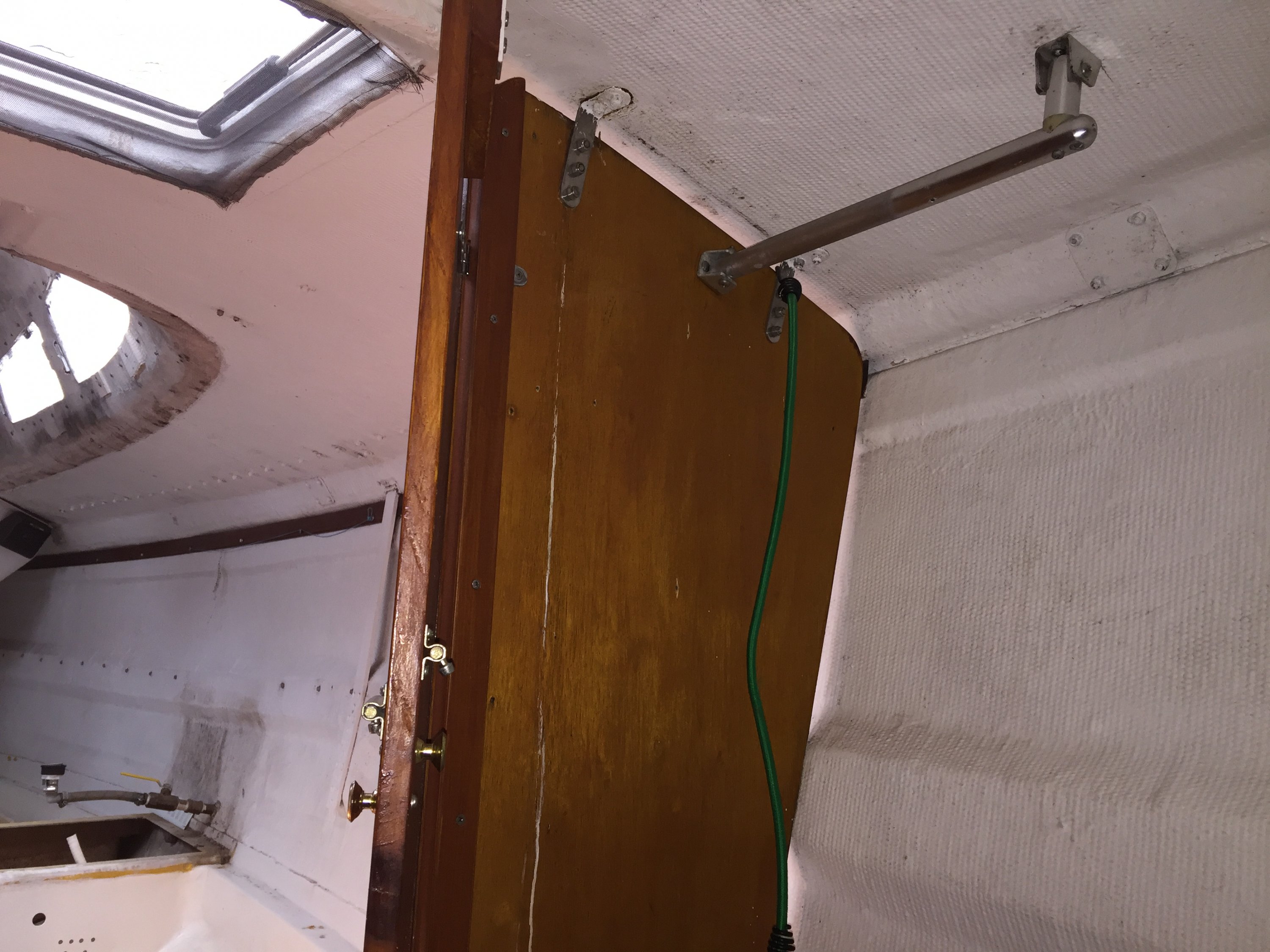

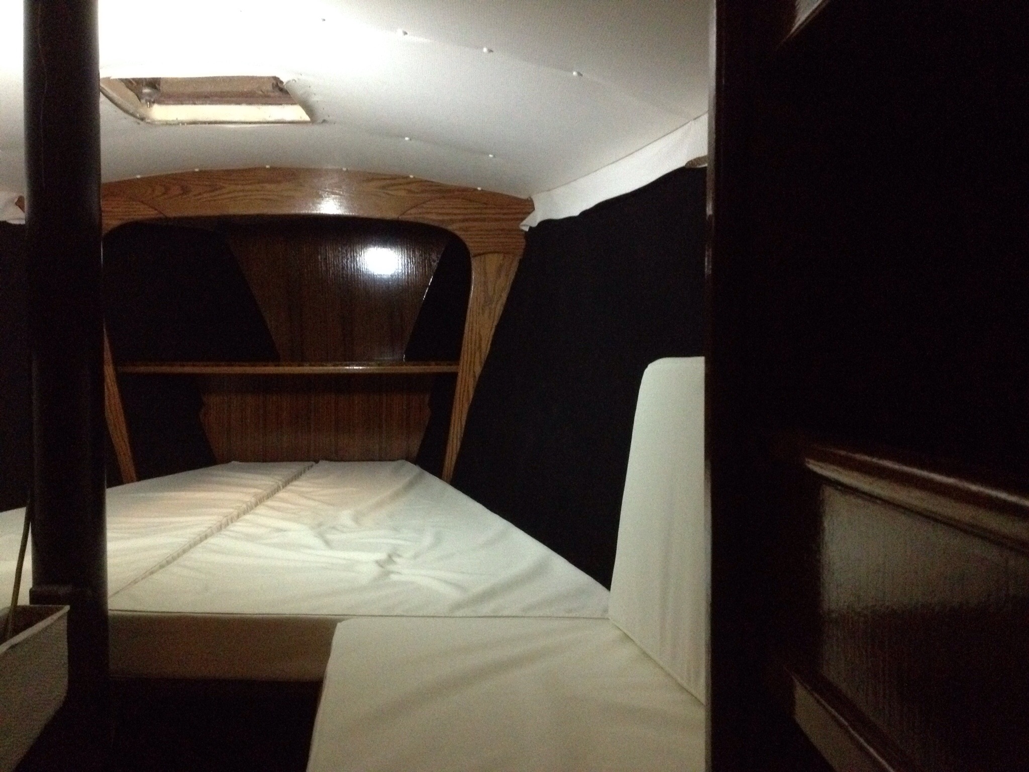

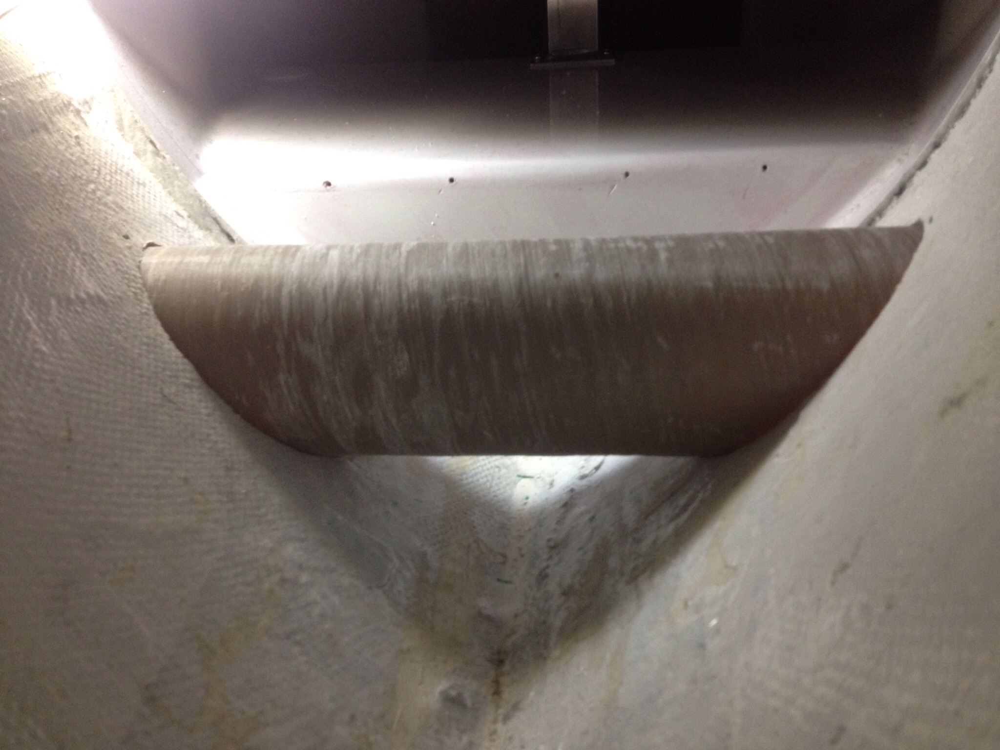

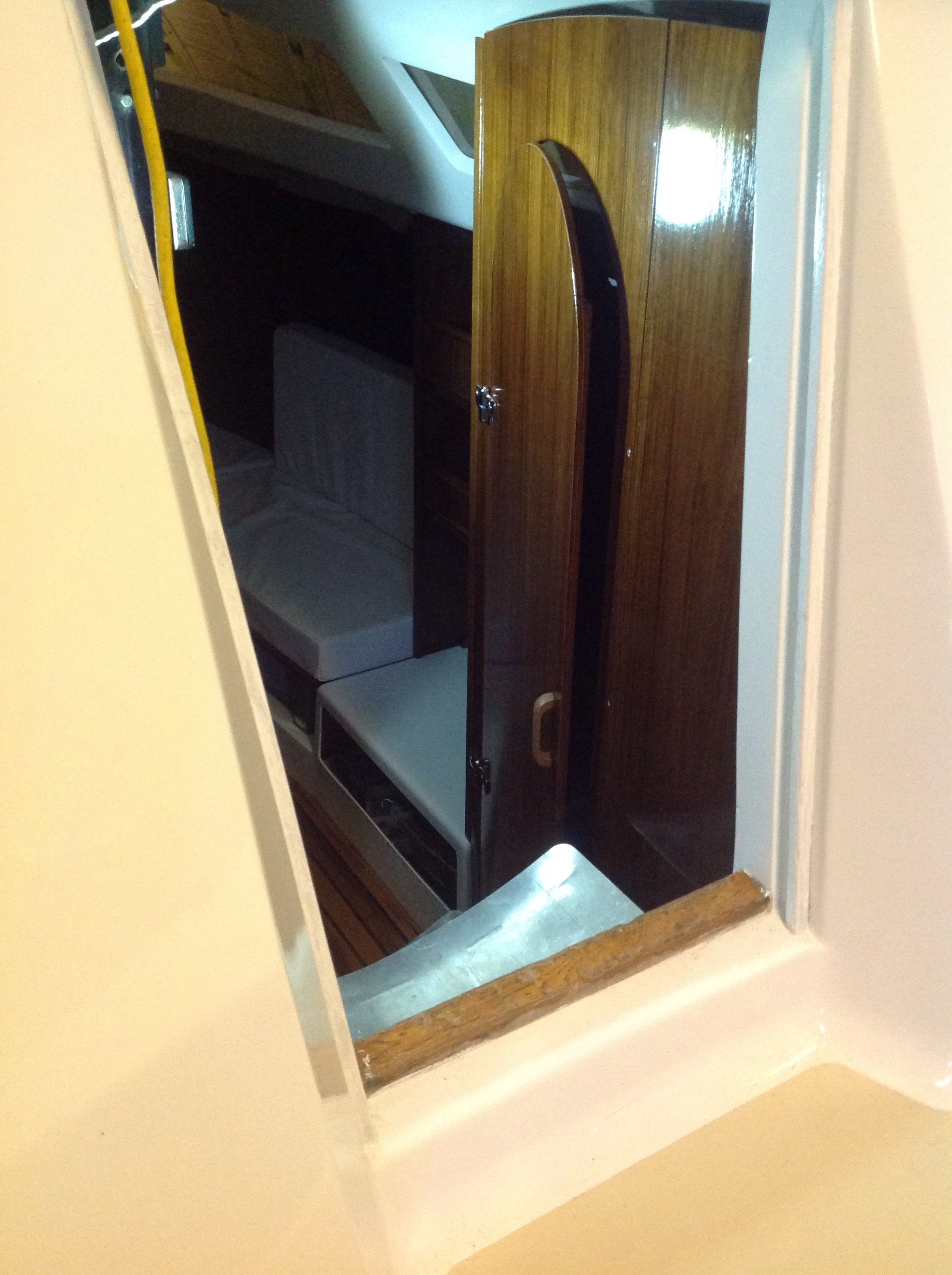

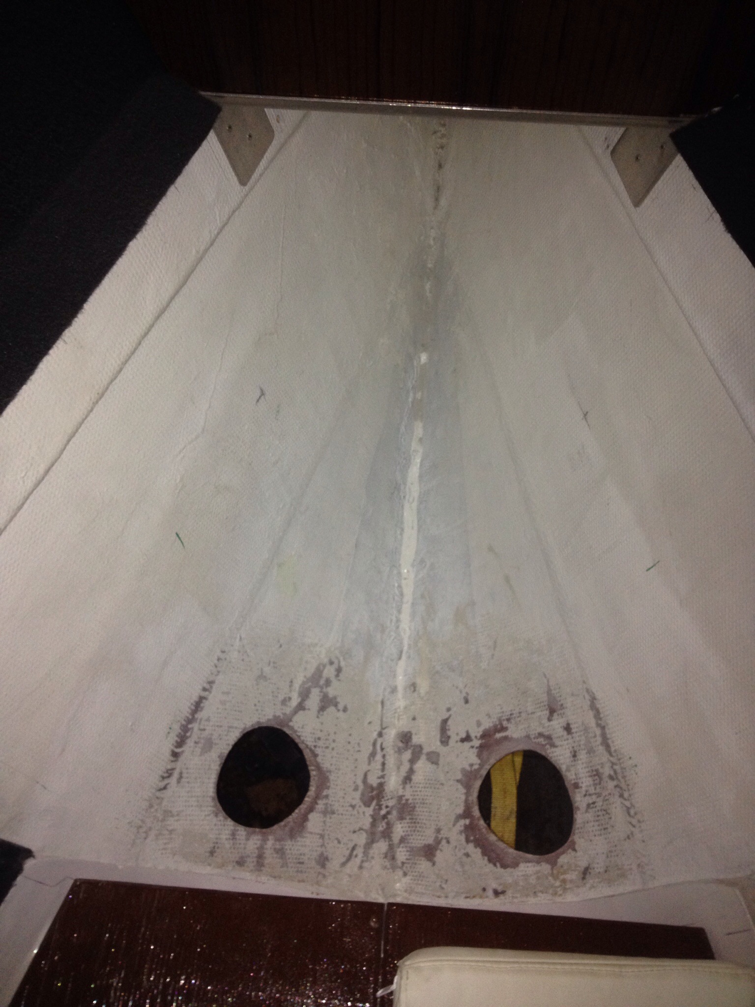

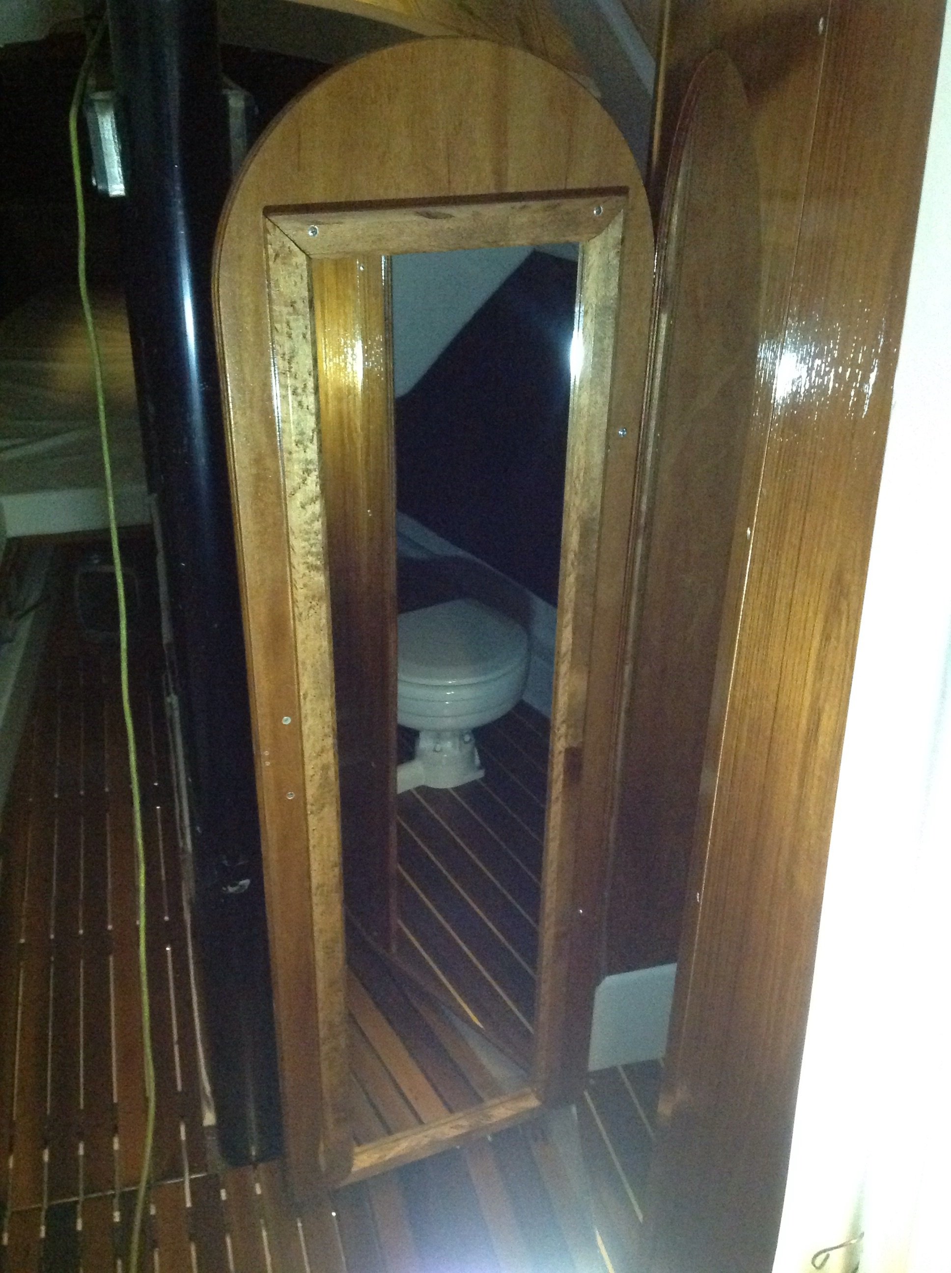

Anyhow, question: I notice you left the forward bulkhead in place. You figure it's structural? What about those handle- looking bars that come forward from the bulkhead? I don't really see a purpose for them... Here's a pic inside mine. Looking aft from where the Head used to be.
I'm asking because I'm going to install a V berth and if that bulkhead isn't necessary at all, more space! If it is I can cut it down and reinforce it, but it would be better and much easier if it were gone!
Thanks!
Feb 11, 2012
271
C&C Mega 30 Long Point, Lake Erie
I did my research before buying my Mega 30, and the "U" word came up quite often in forums. Maybe its kind of like babies? Lol!
Didn't leave "the bulkhead" in place. Took it out and tossed it.
IMO the factory crap pieces did virtually nothing.
Moved the bulkhead support slightly forward and re-designed it out of oak.
Yes, it does support the topside nicely, and it is a noticeable difference.
With regards to those bars....to my knowledge, not a factory application. Likely installed to hang the foul weather gear.

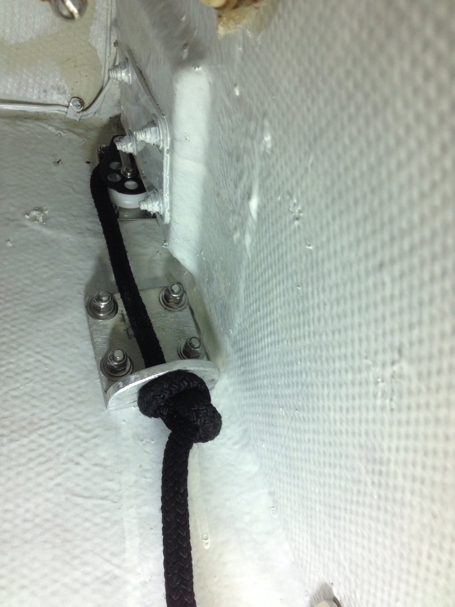

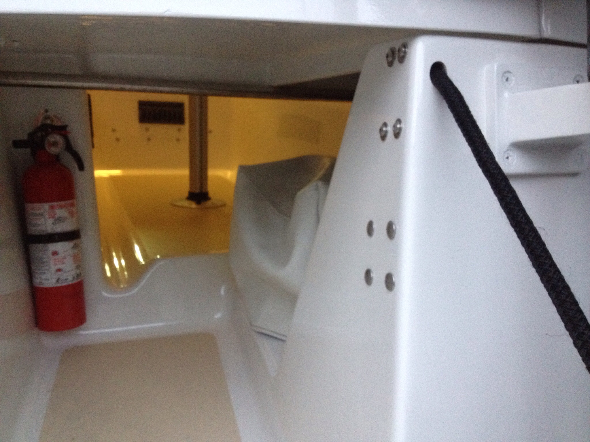

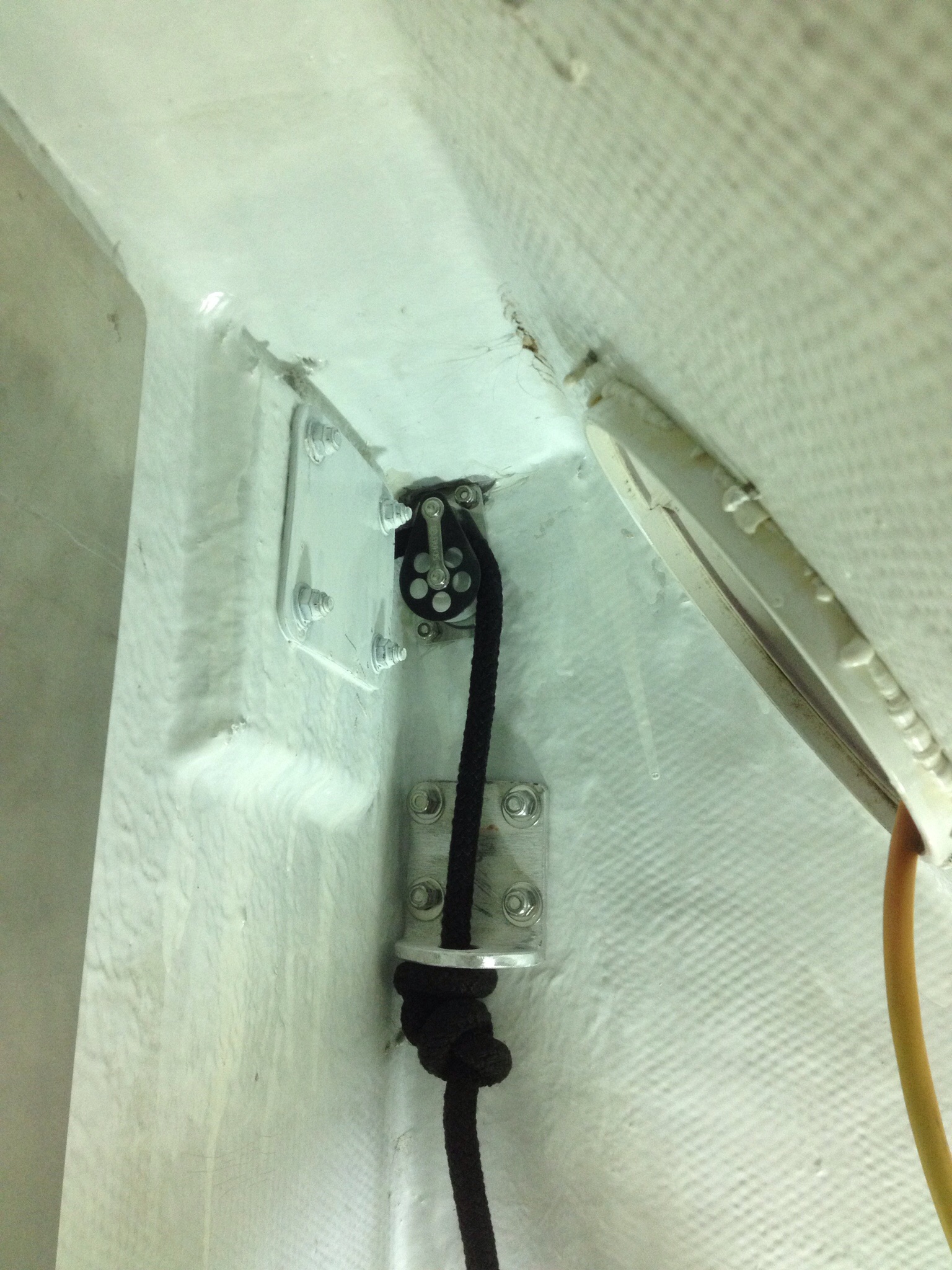

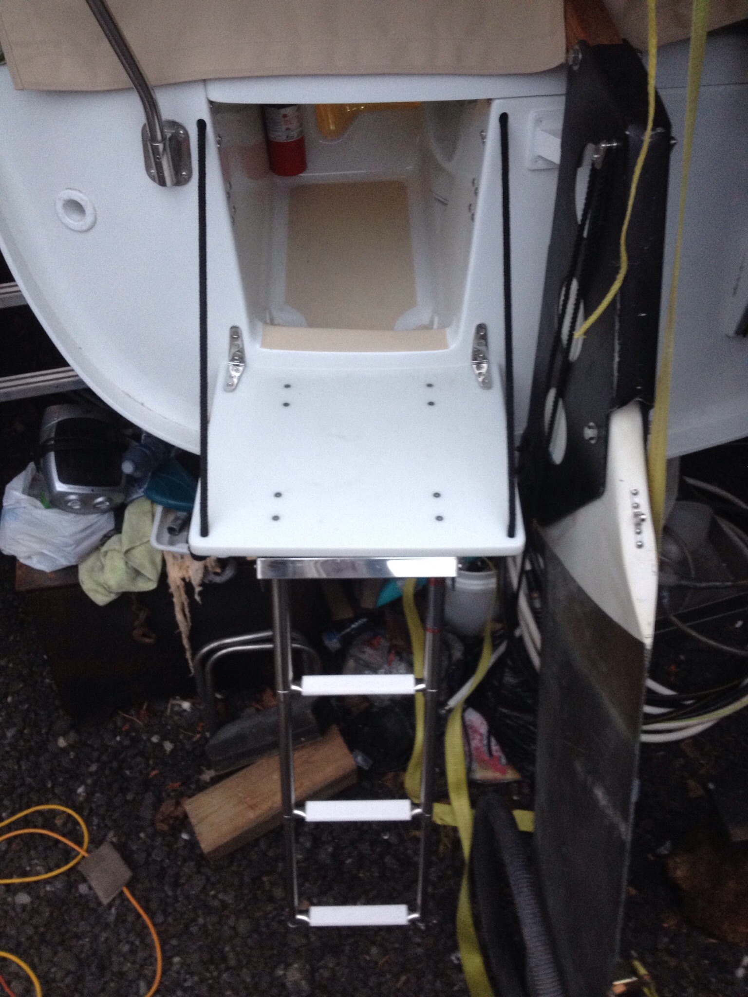

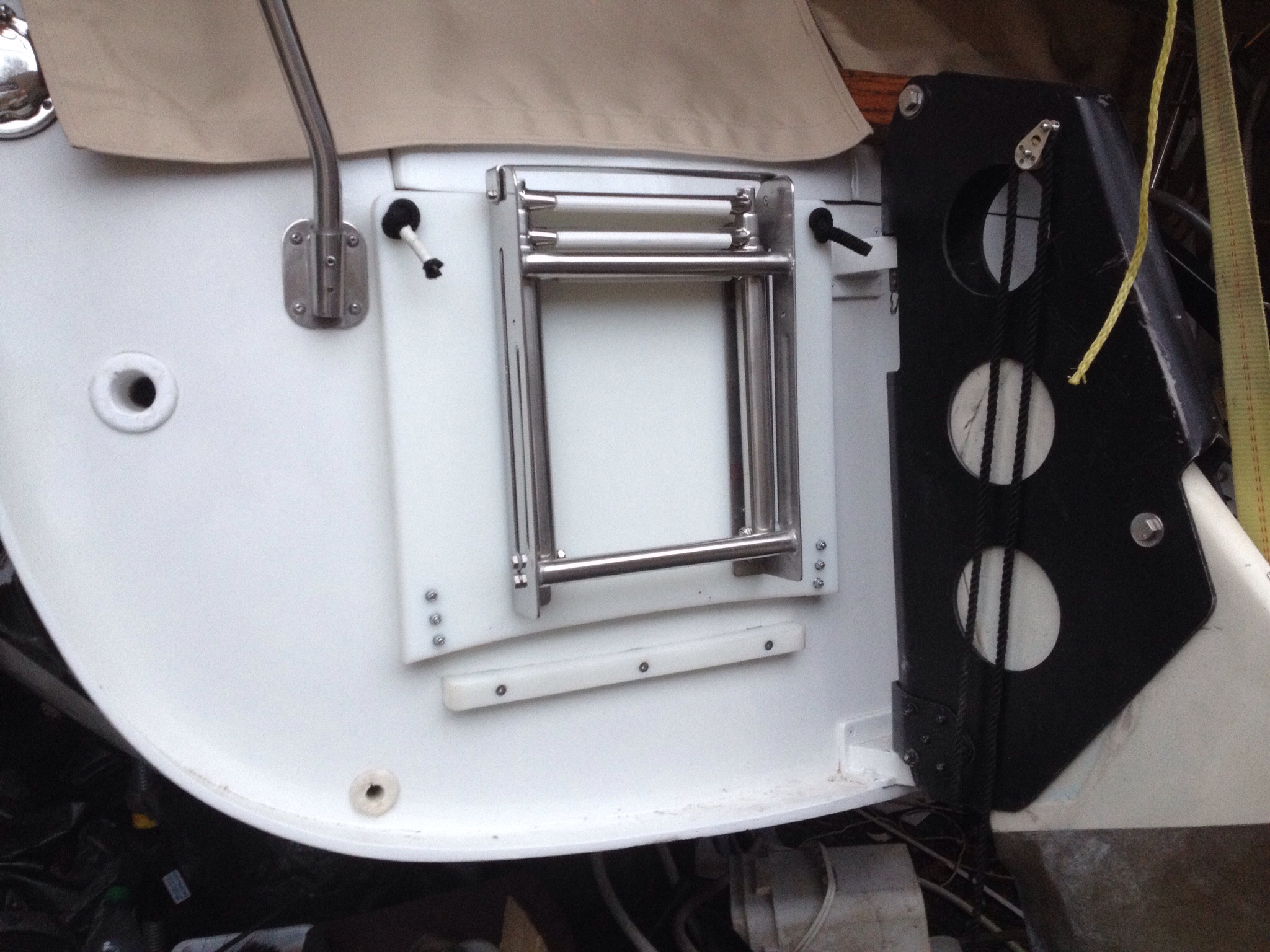

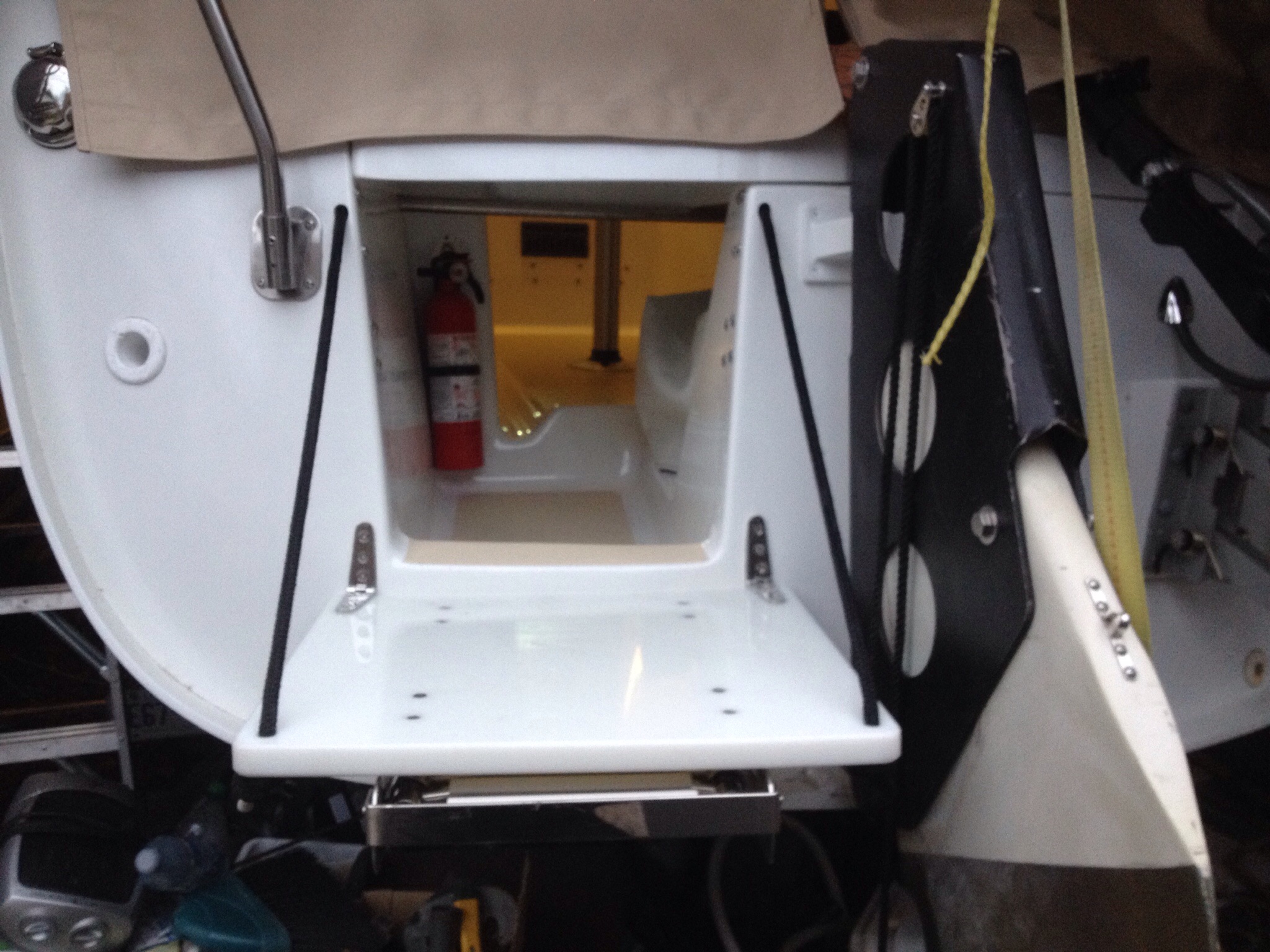

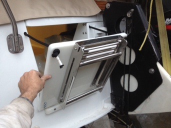

Swim platform...suspension system almost finished.
Springs will be attached to the ends of the lines so they retract on their own.

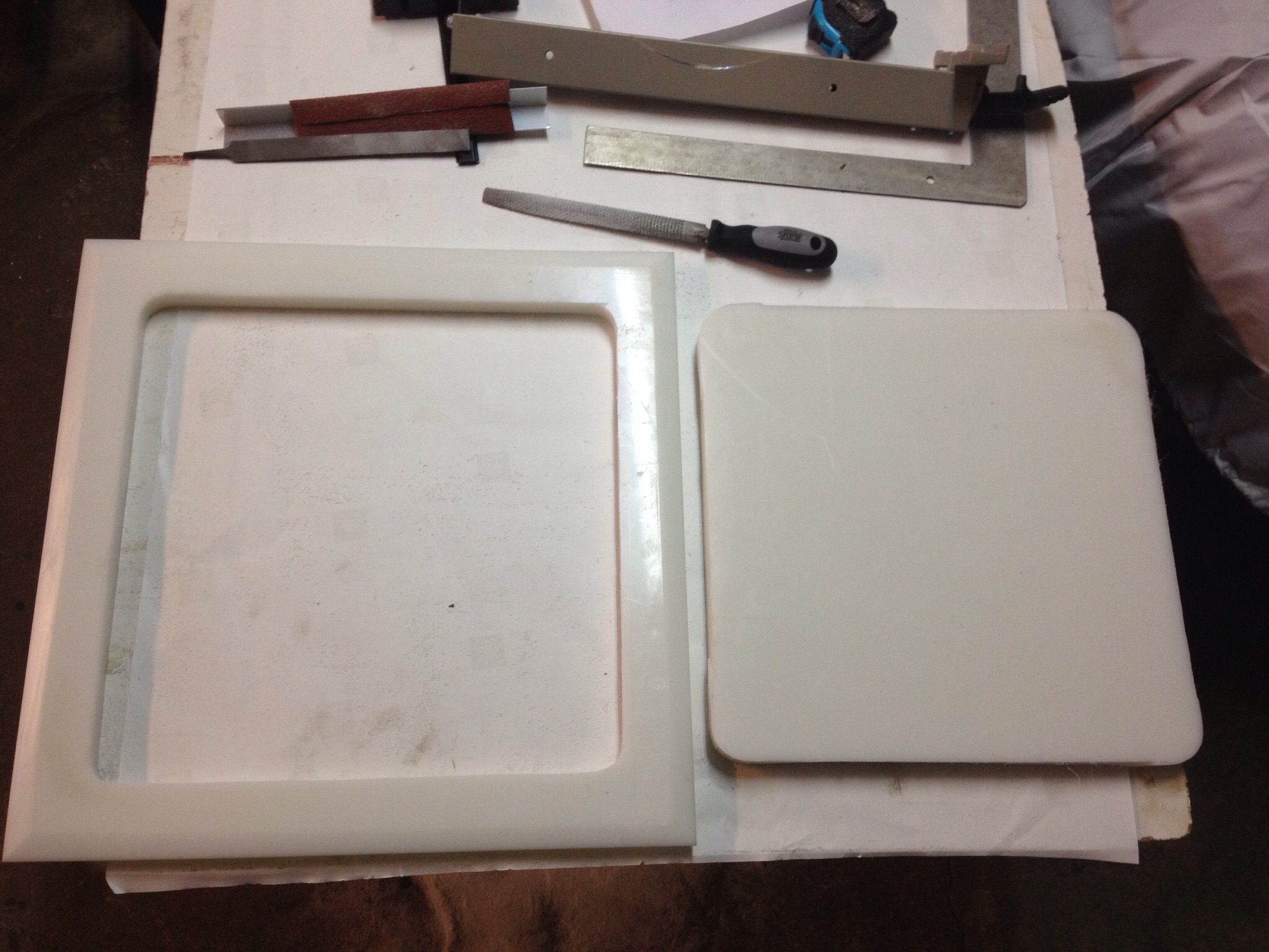

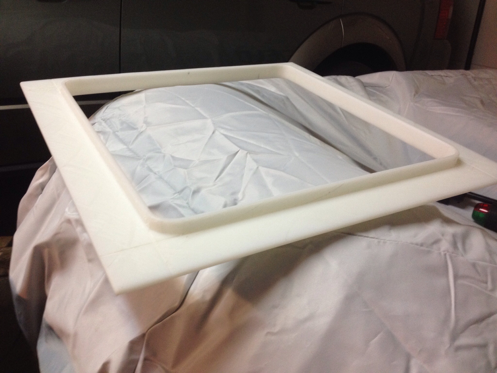

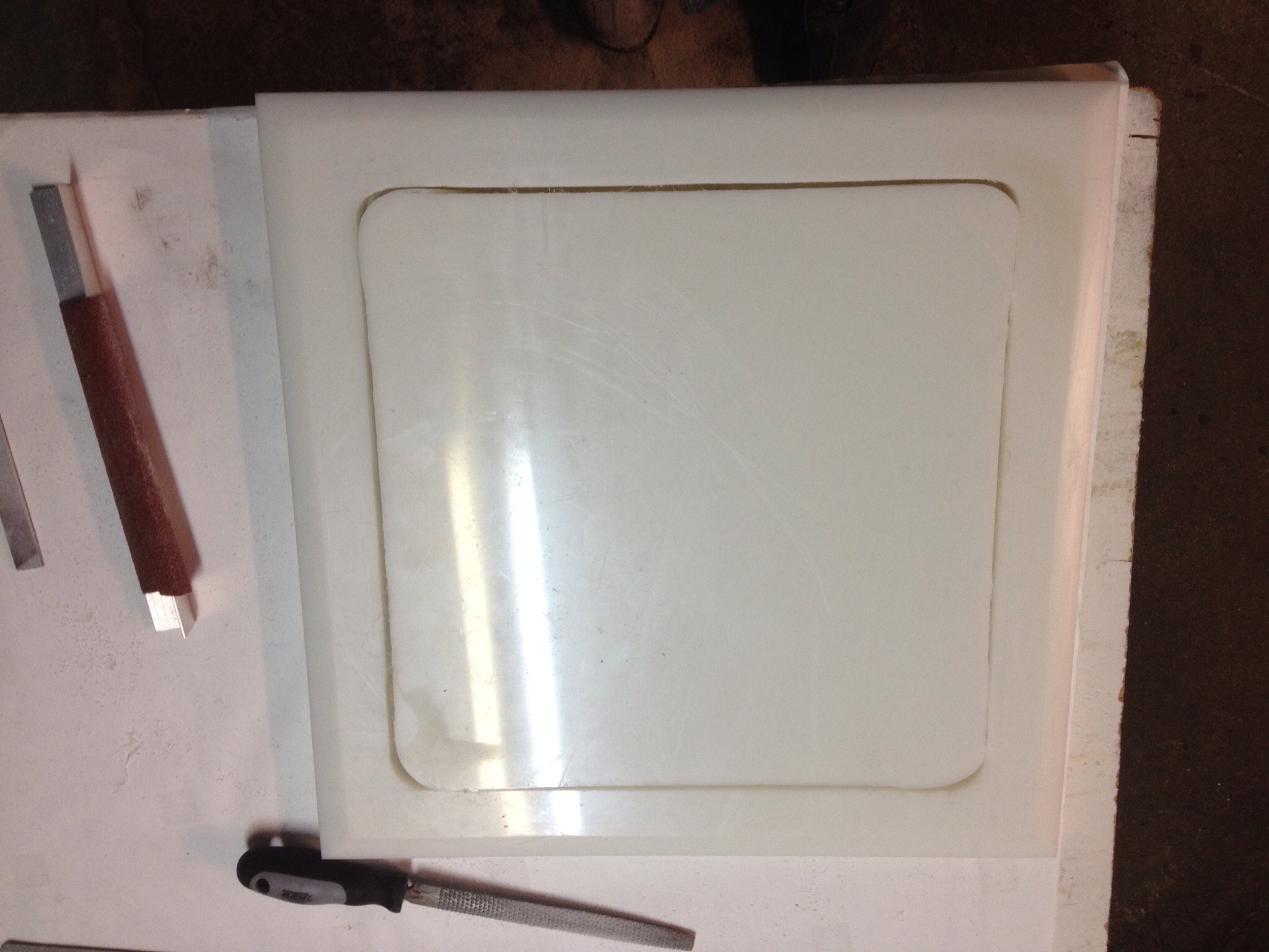

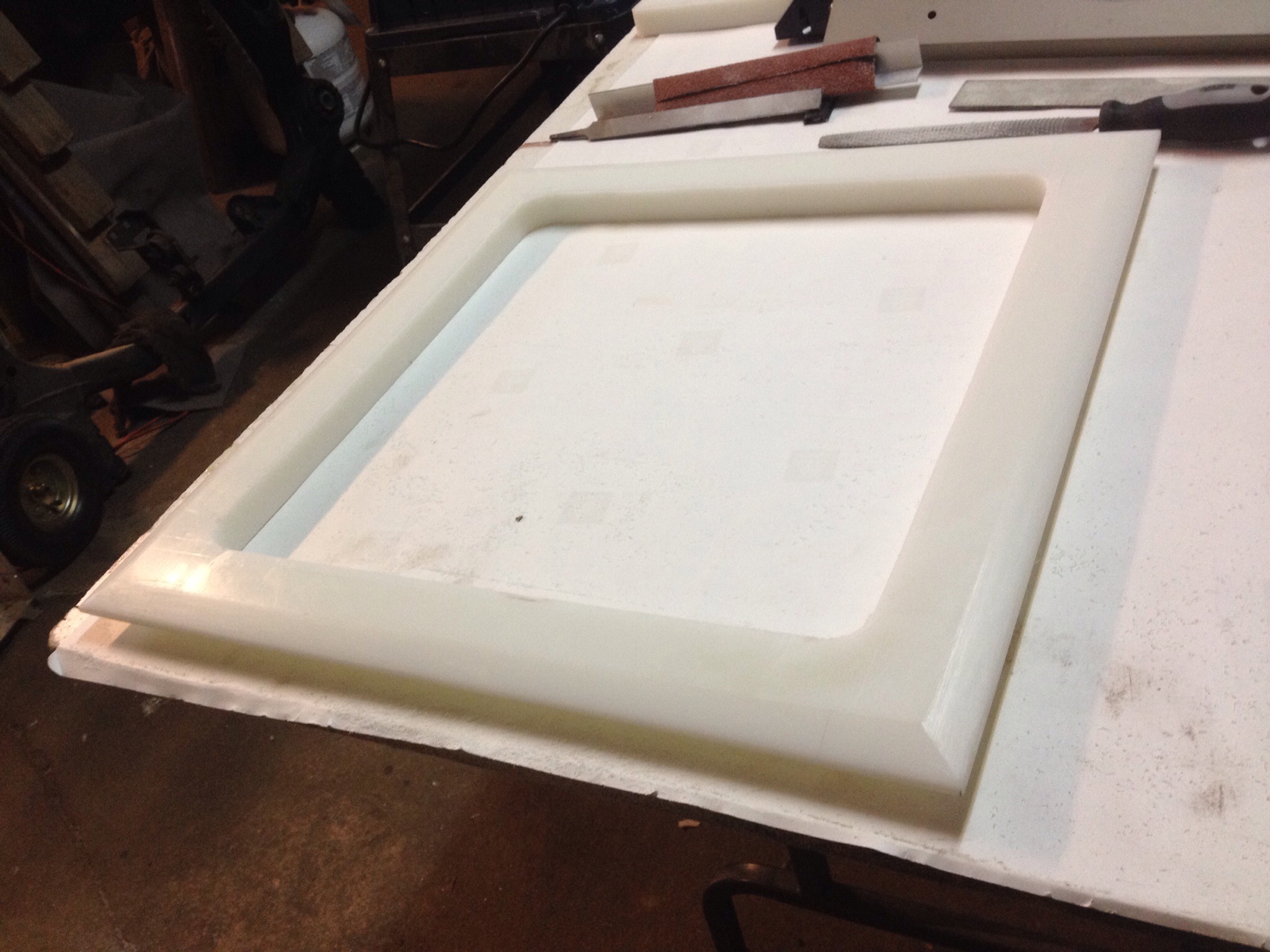

Hatch trim ring....made it from 1" Densitec (Starboard)
C&C never produced these for the Mega that I know of.

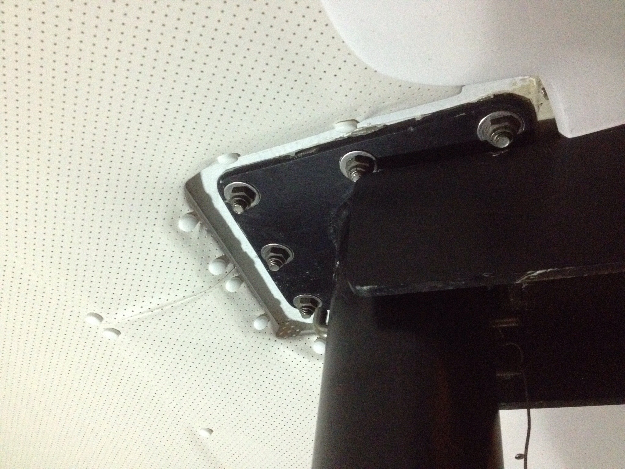

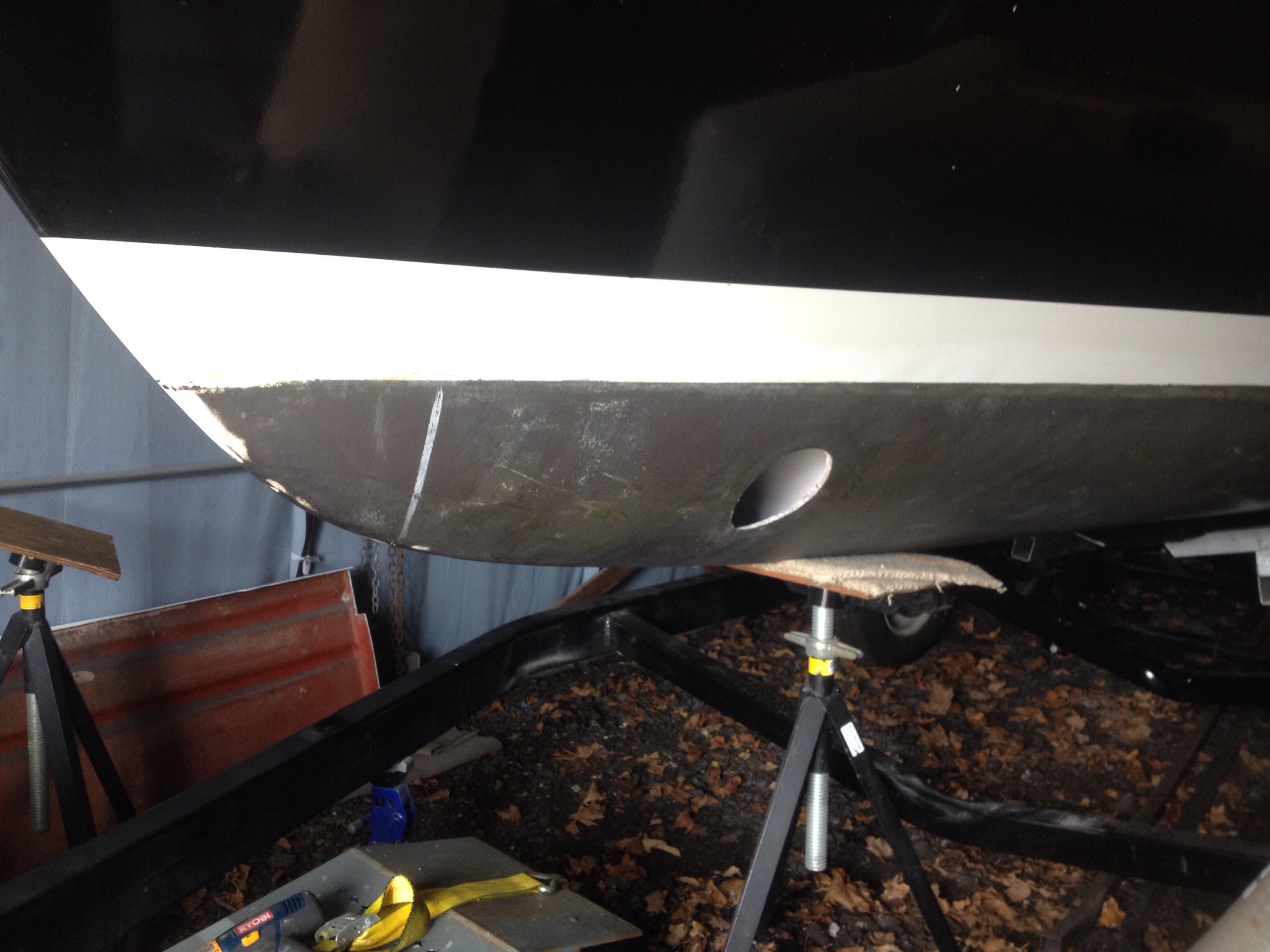

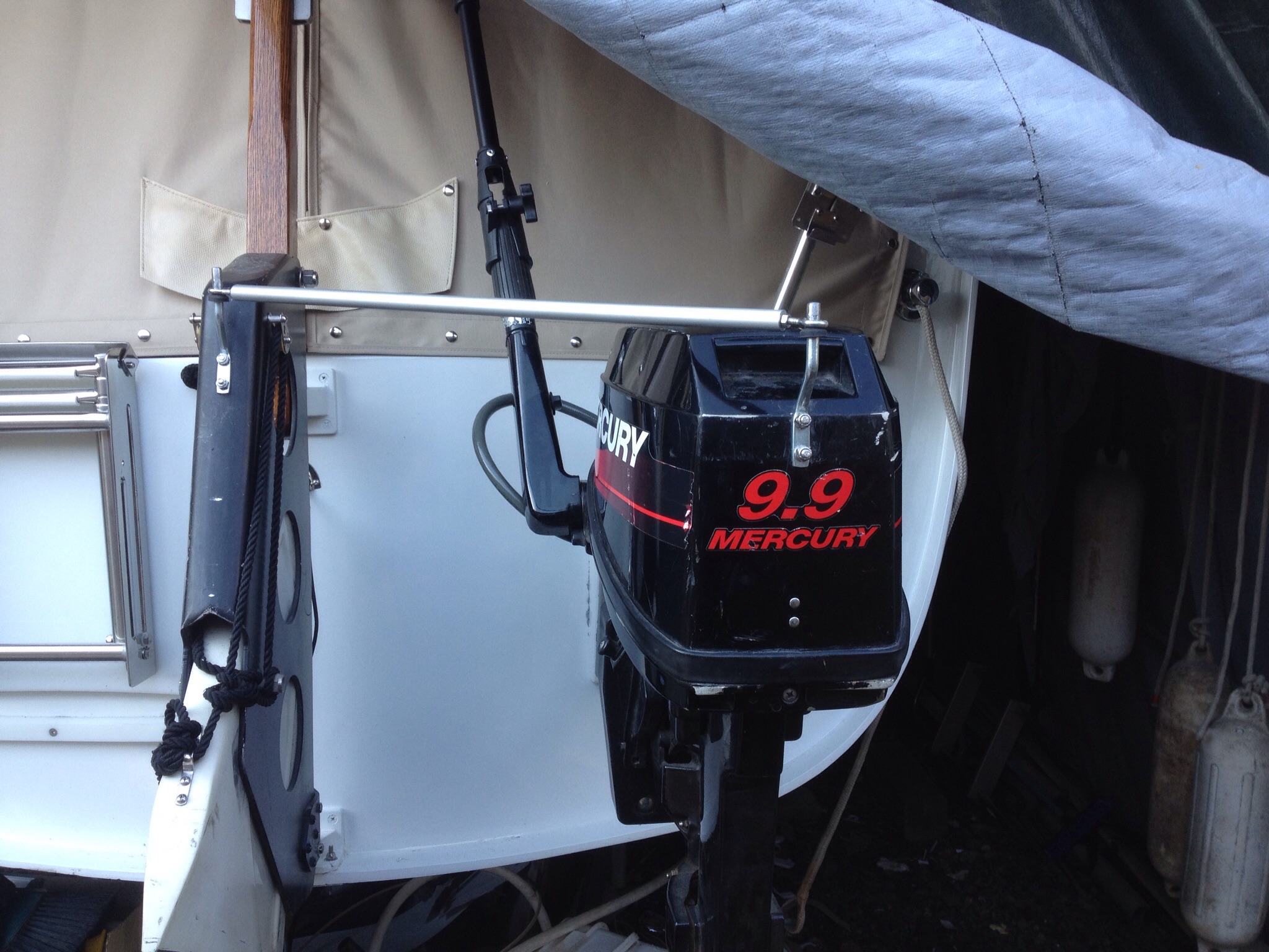

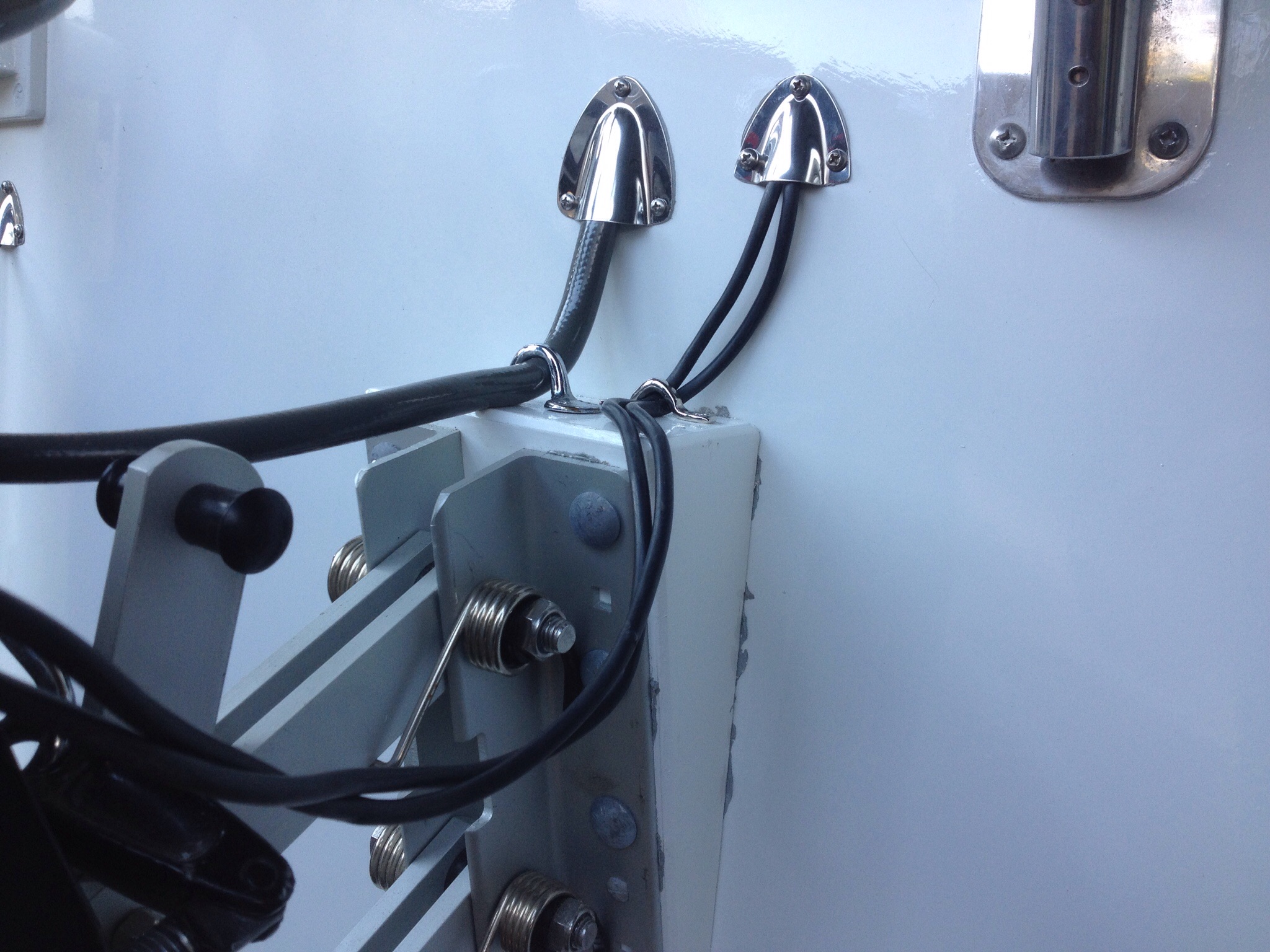

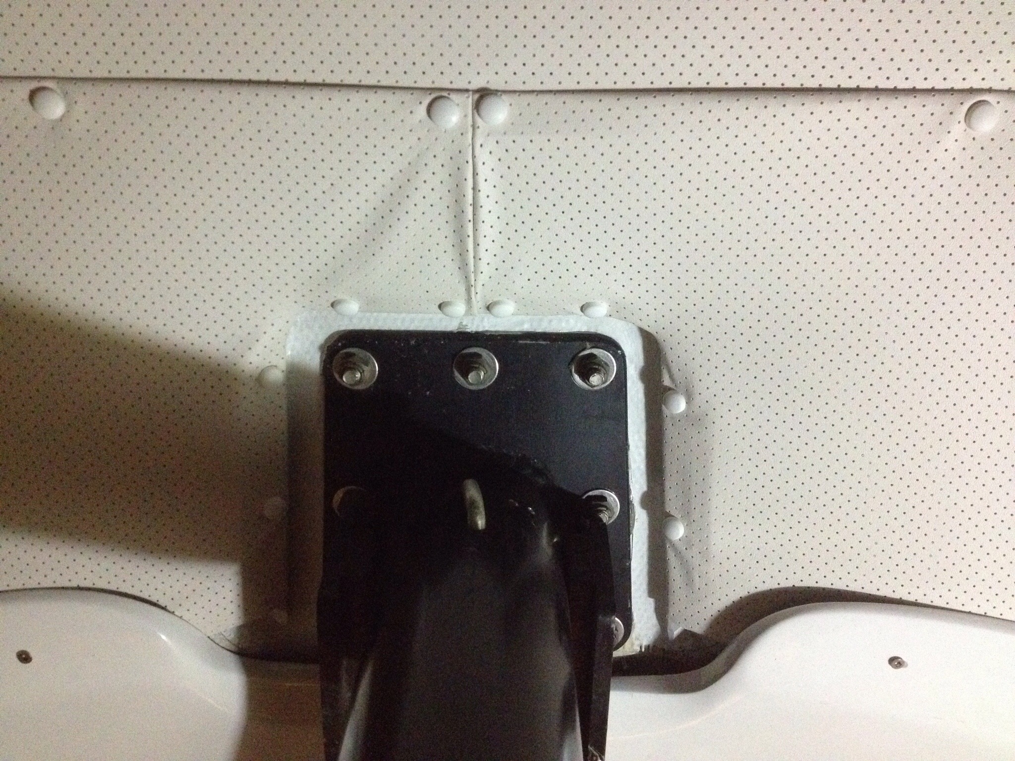

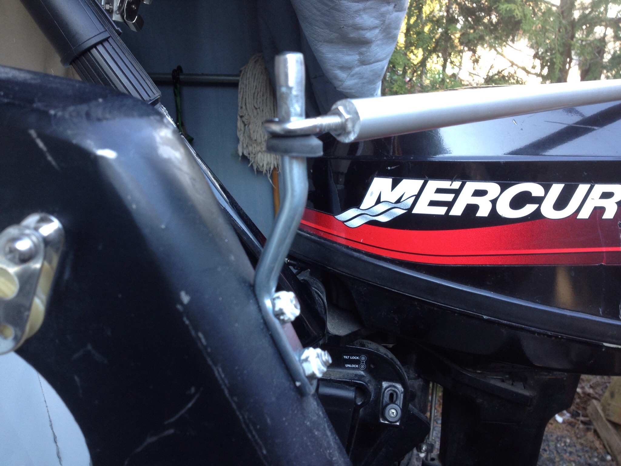

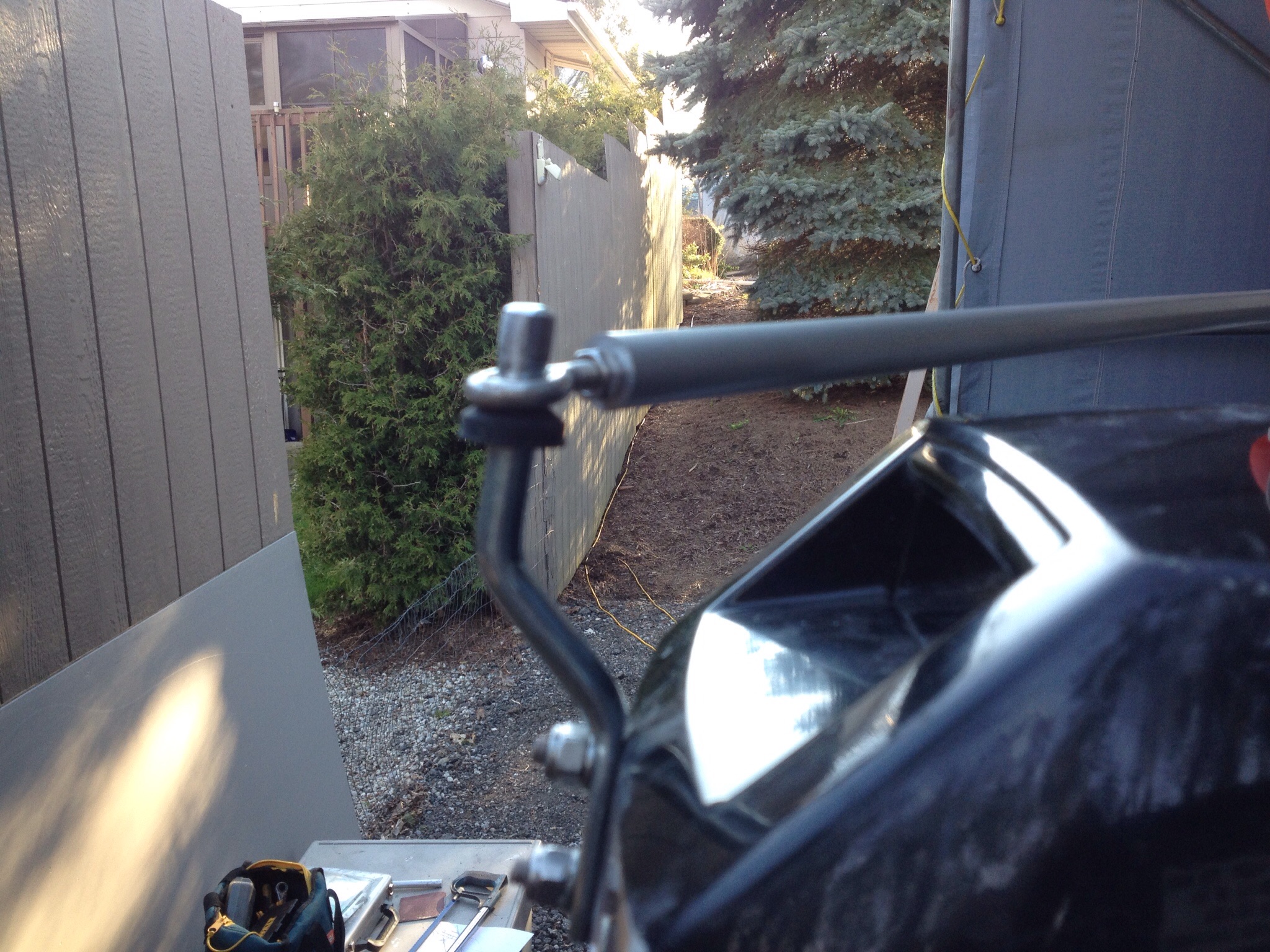

Outboard/ rudder steering connector.
Both rudder & outboard have a 12" pivot point to steering connector rod end. Nearly identical turning radius starboard & port.
Will have it tethered so I don't lose it in the drink.
Still have to install pins...they will be tethered as well.

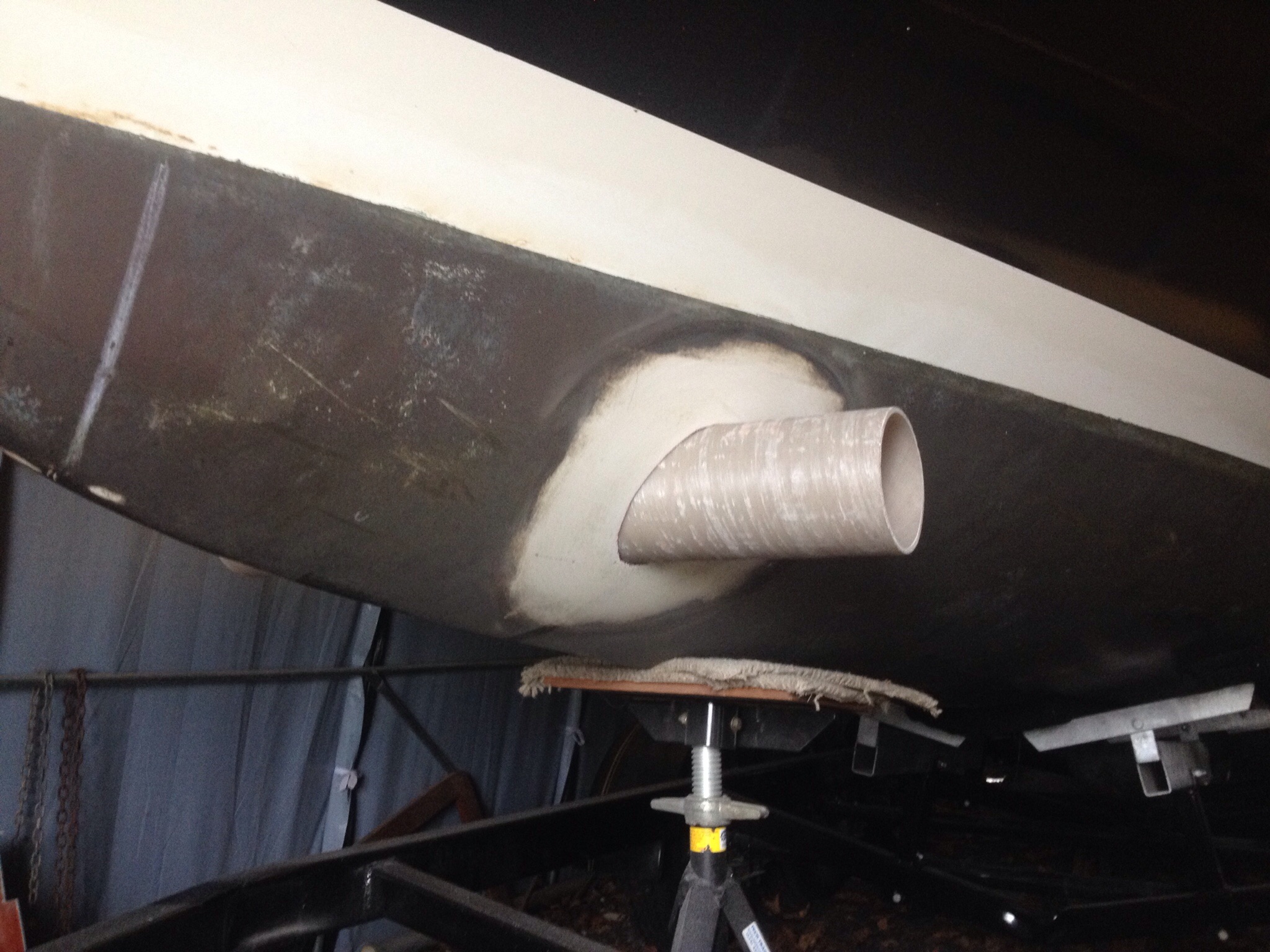

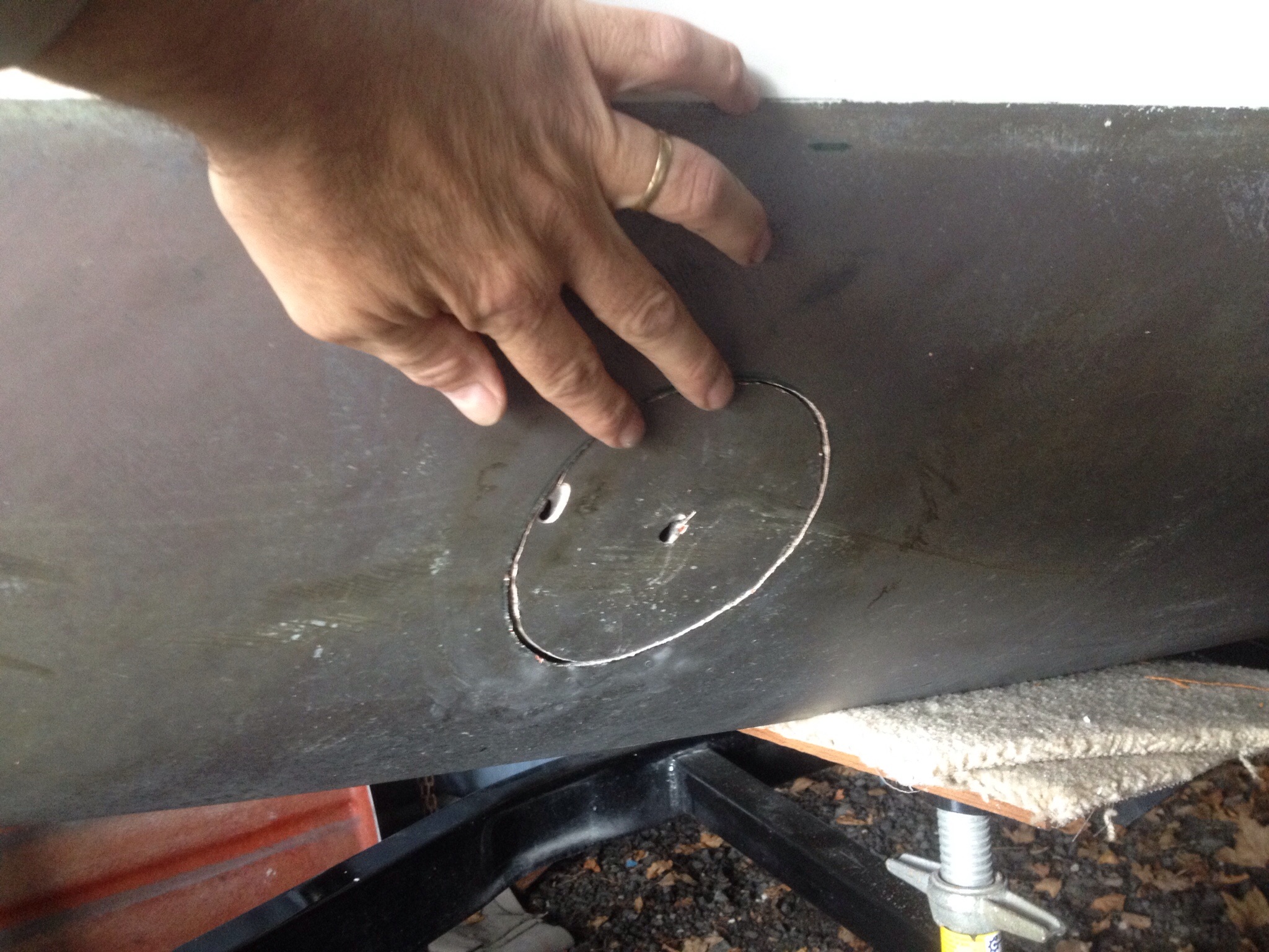

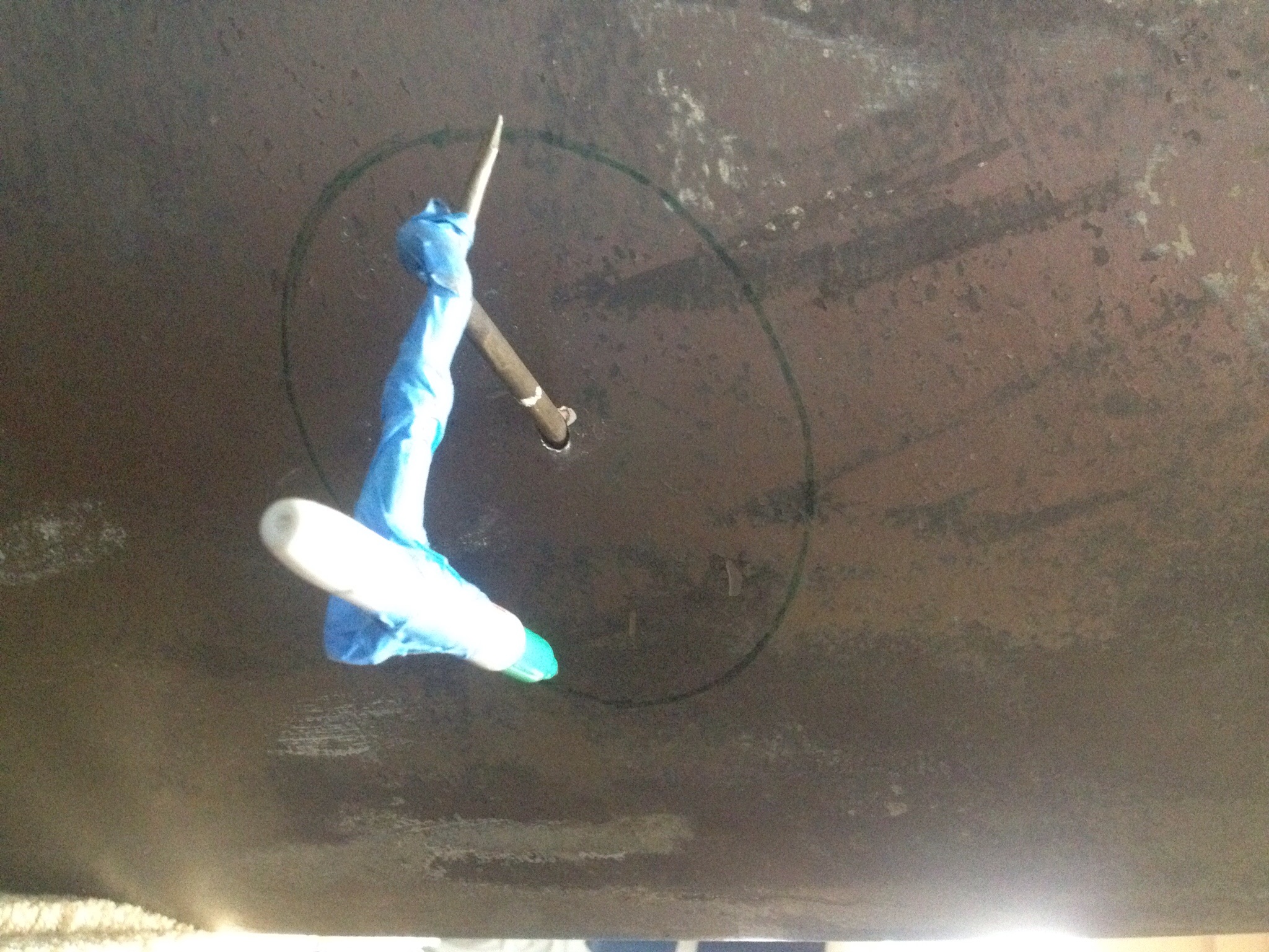

Clam shell vents for fuel line and electric start/ alternator.

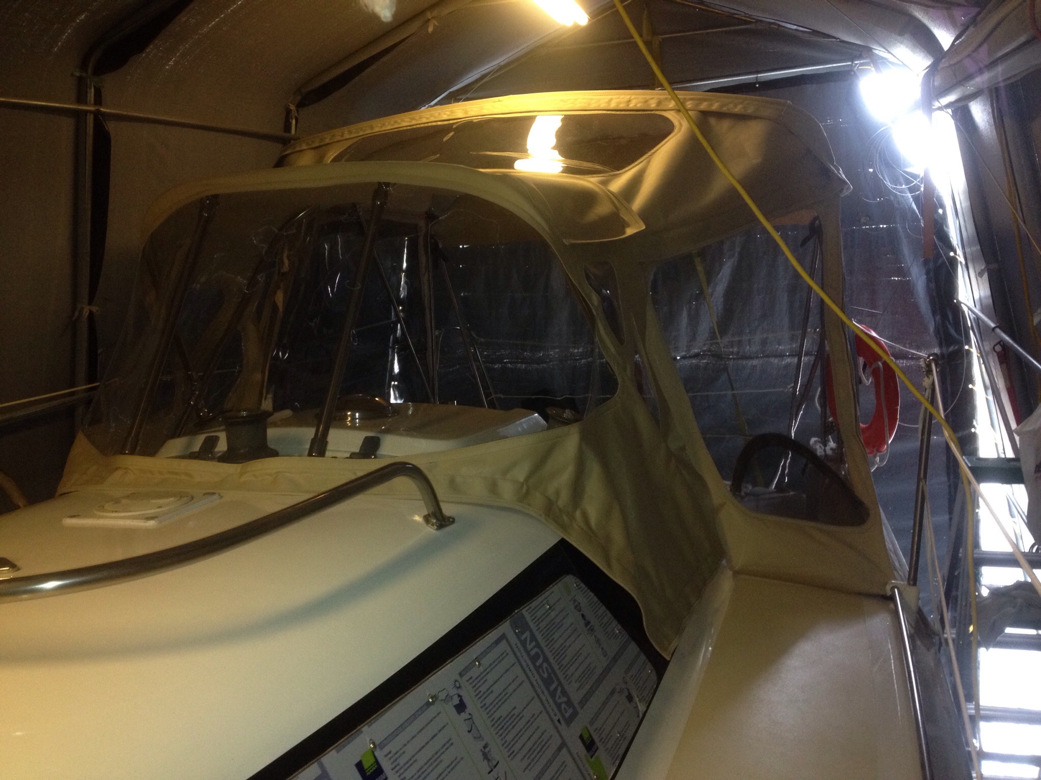

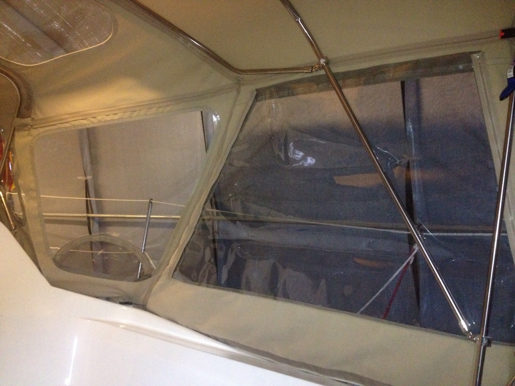

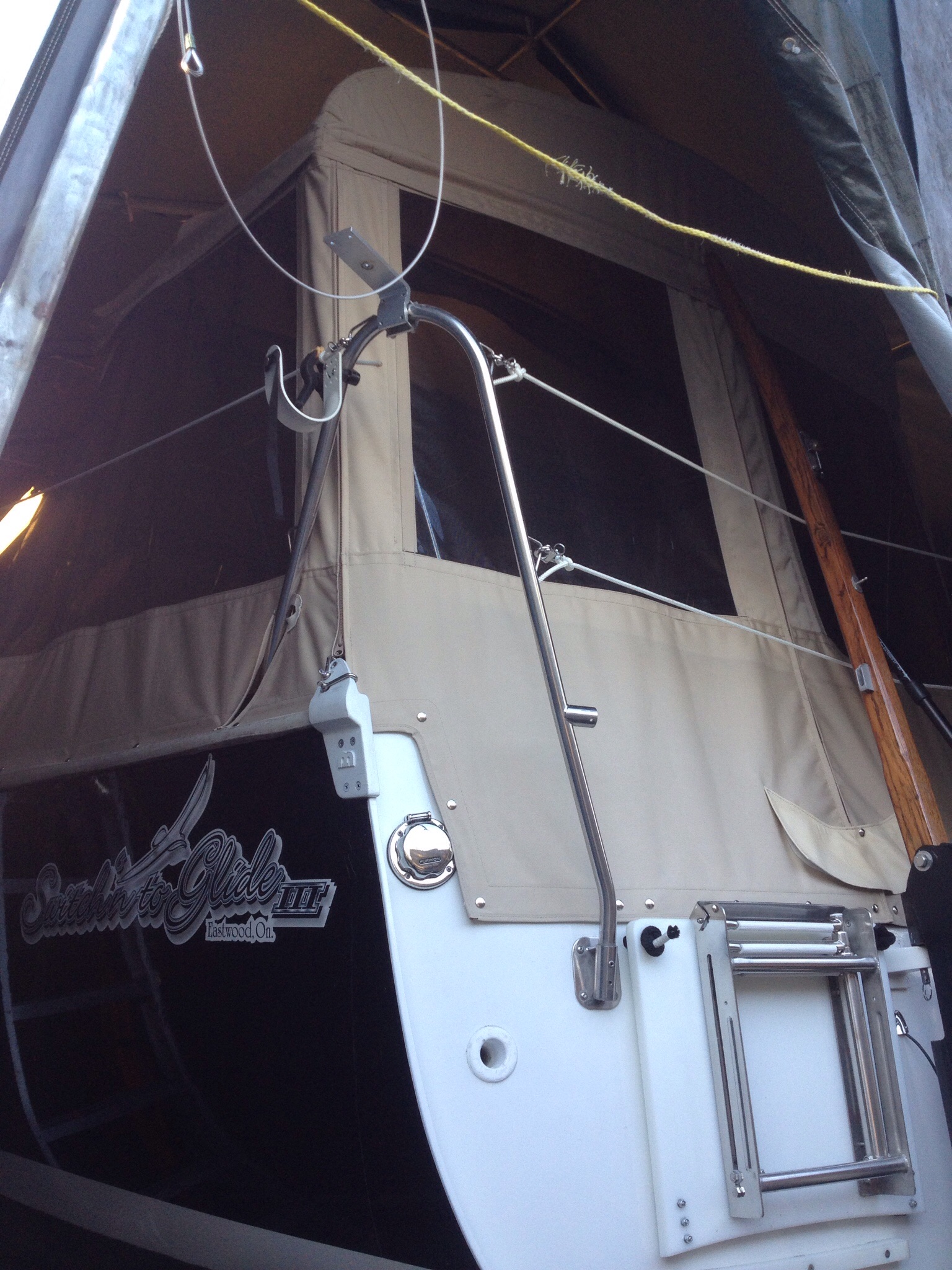

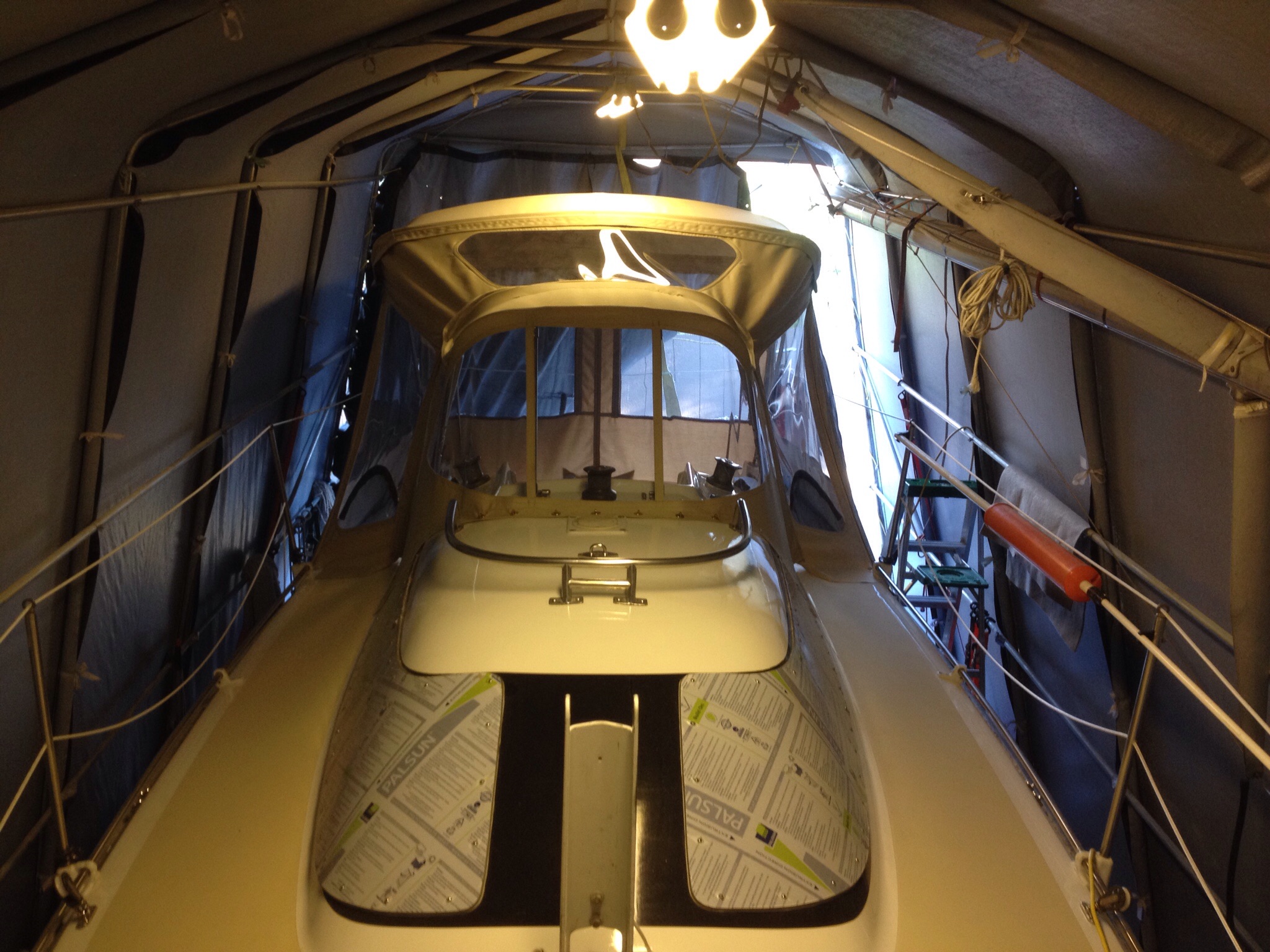

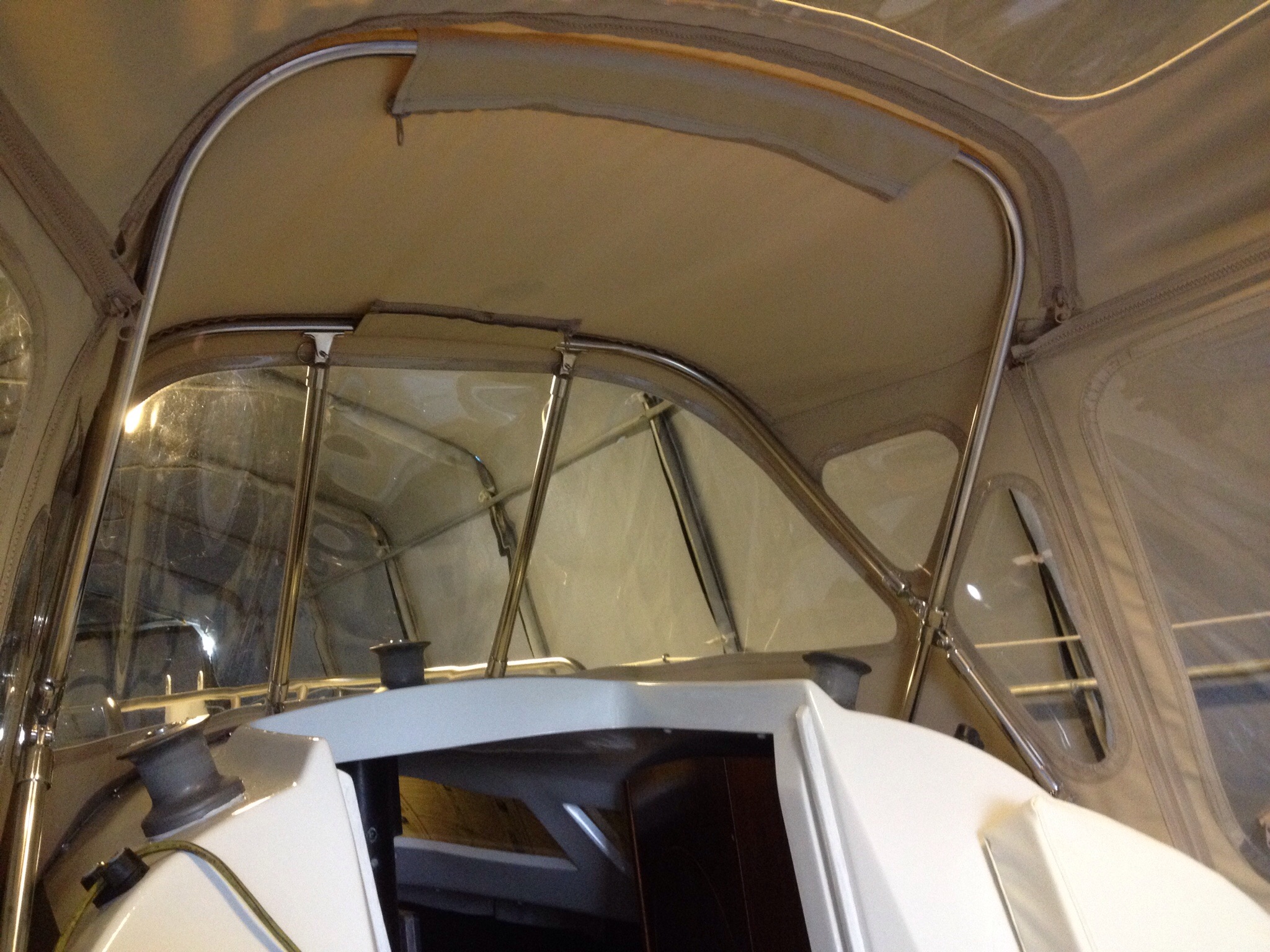

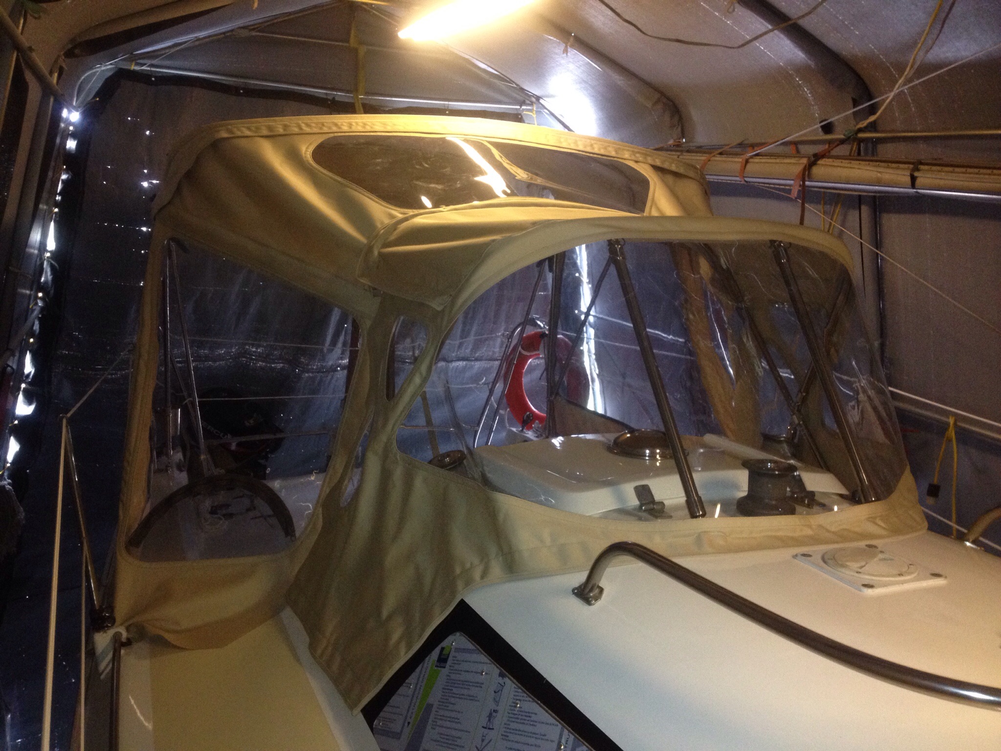

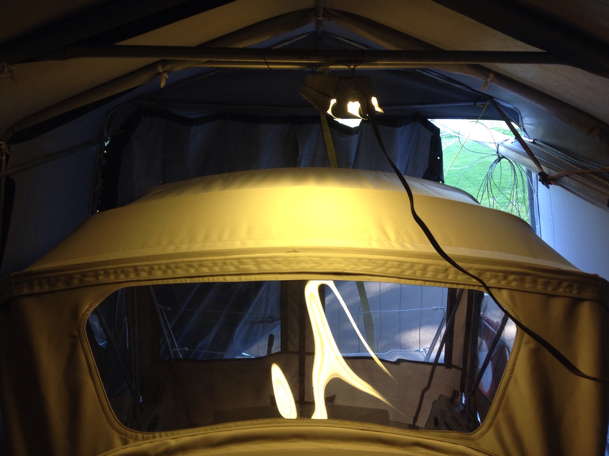

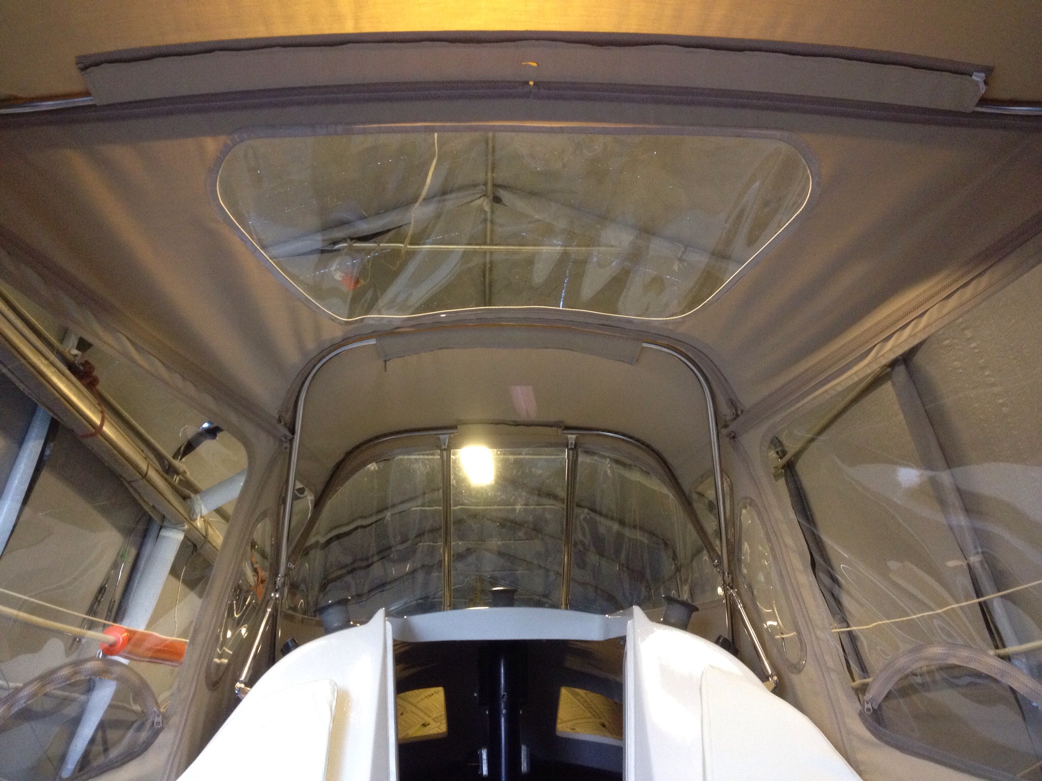

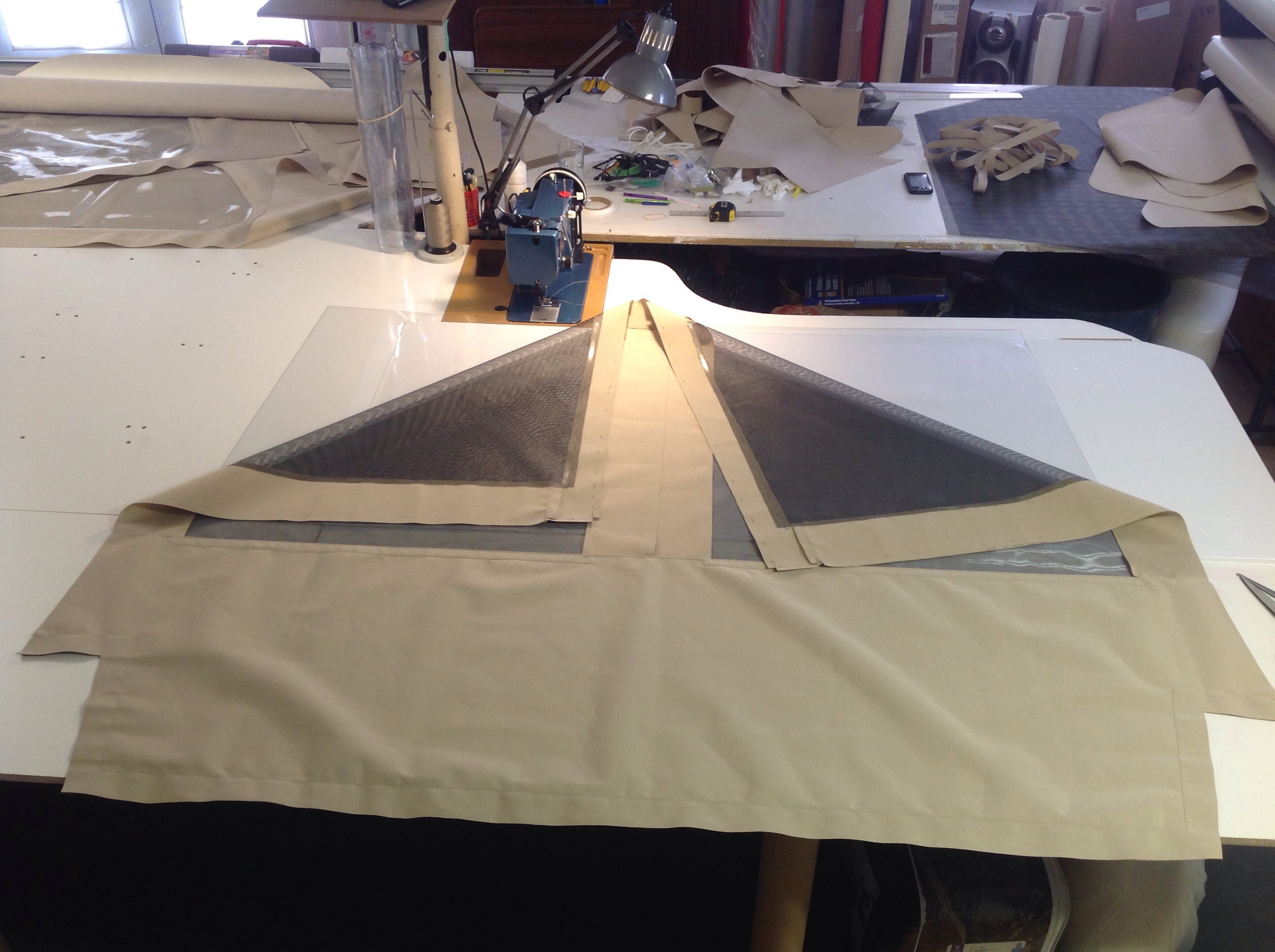

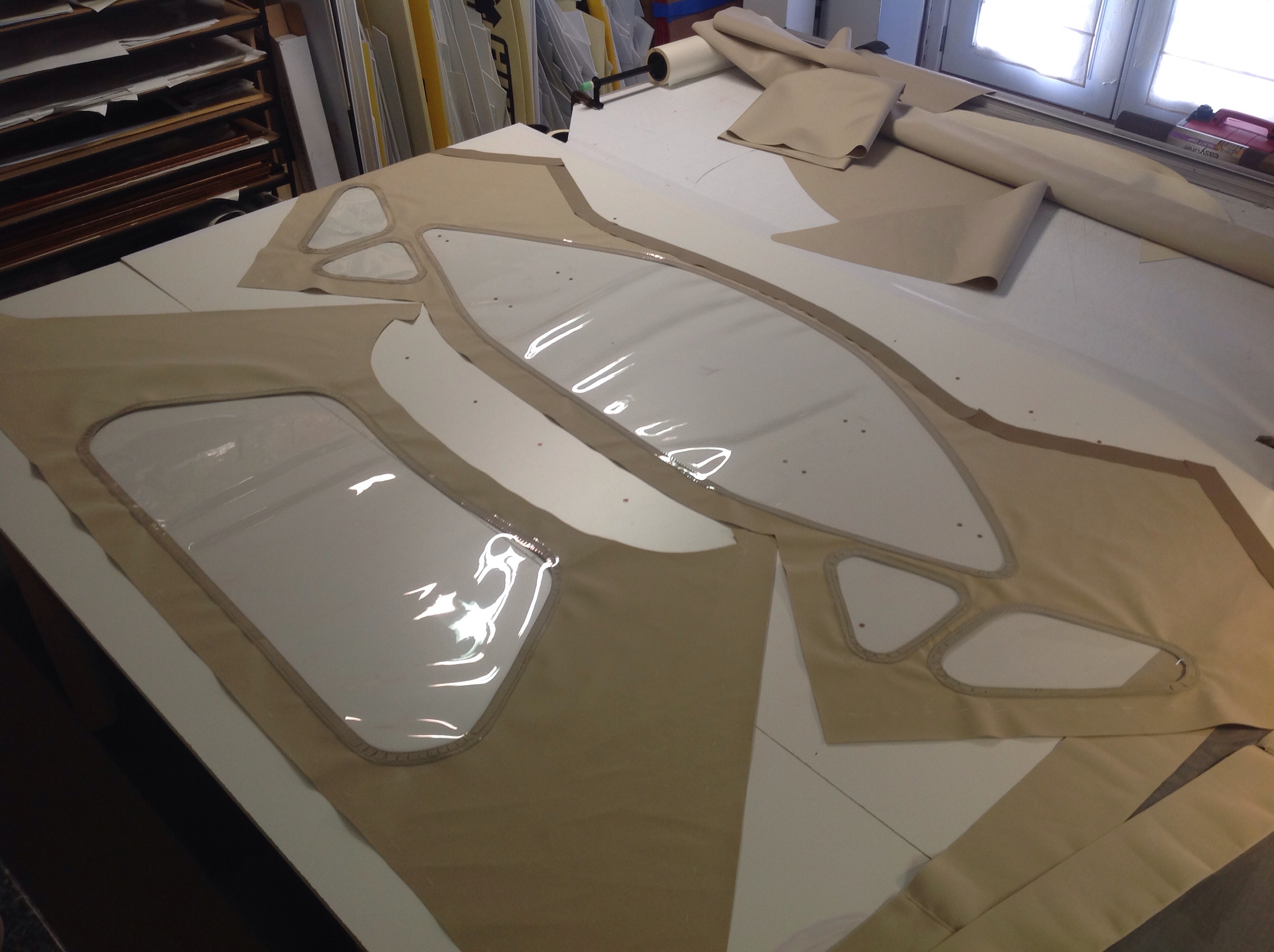

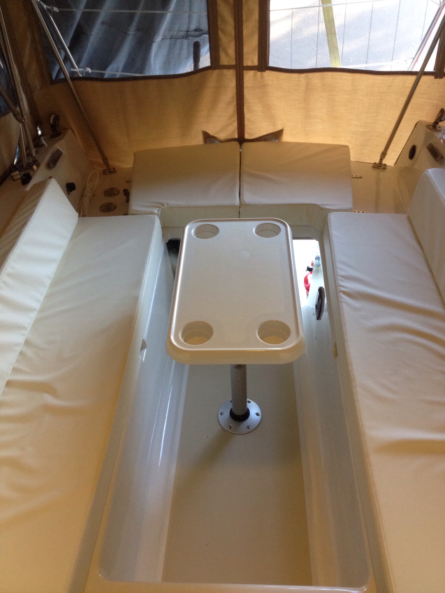

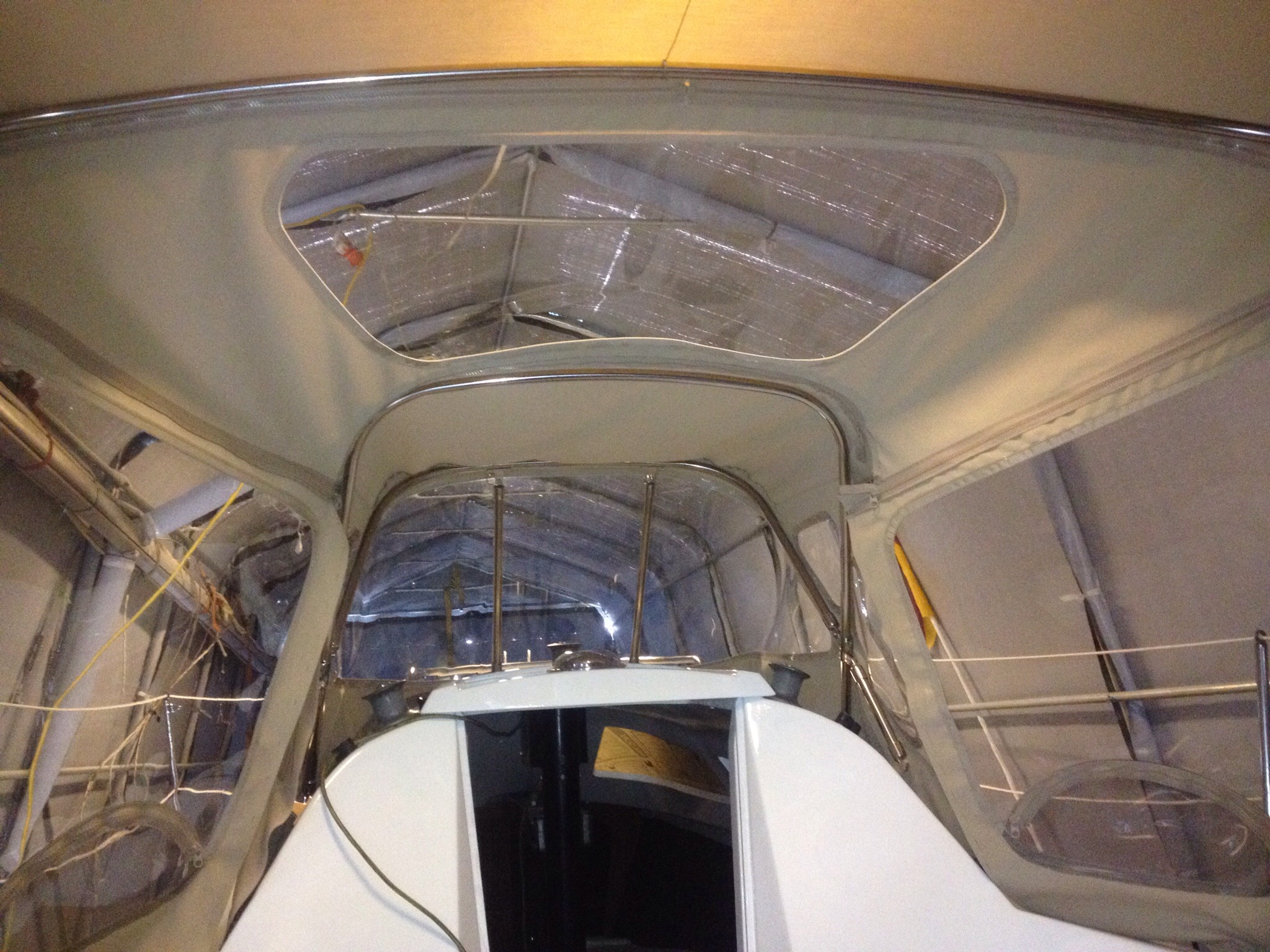

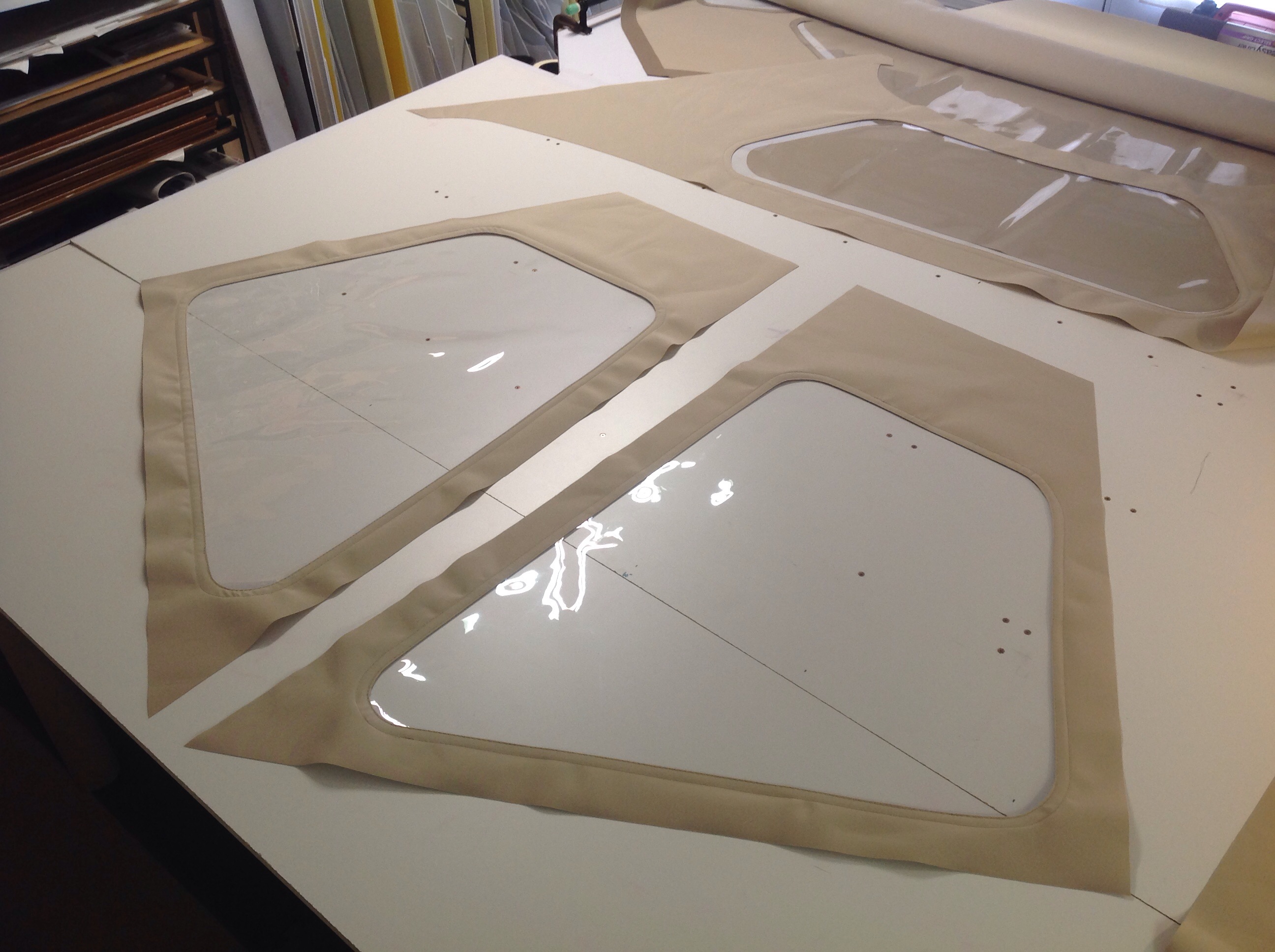

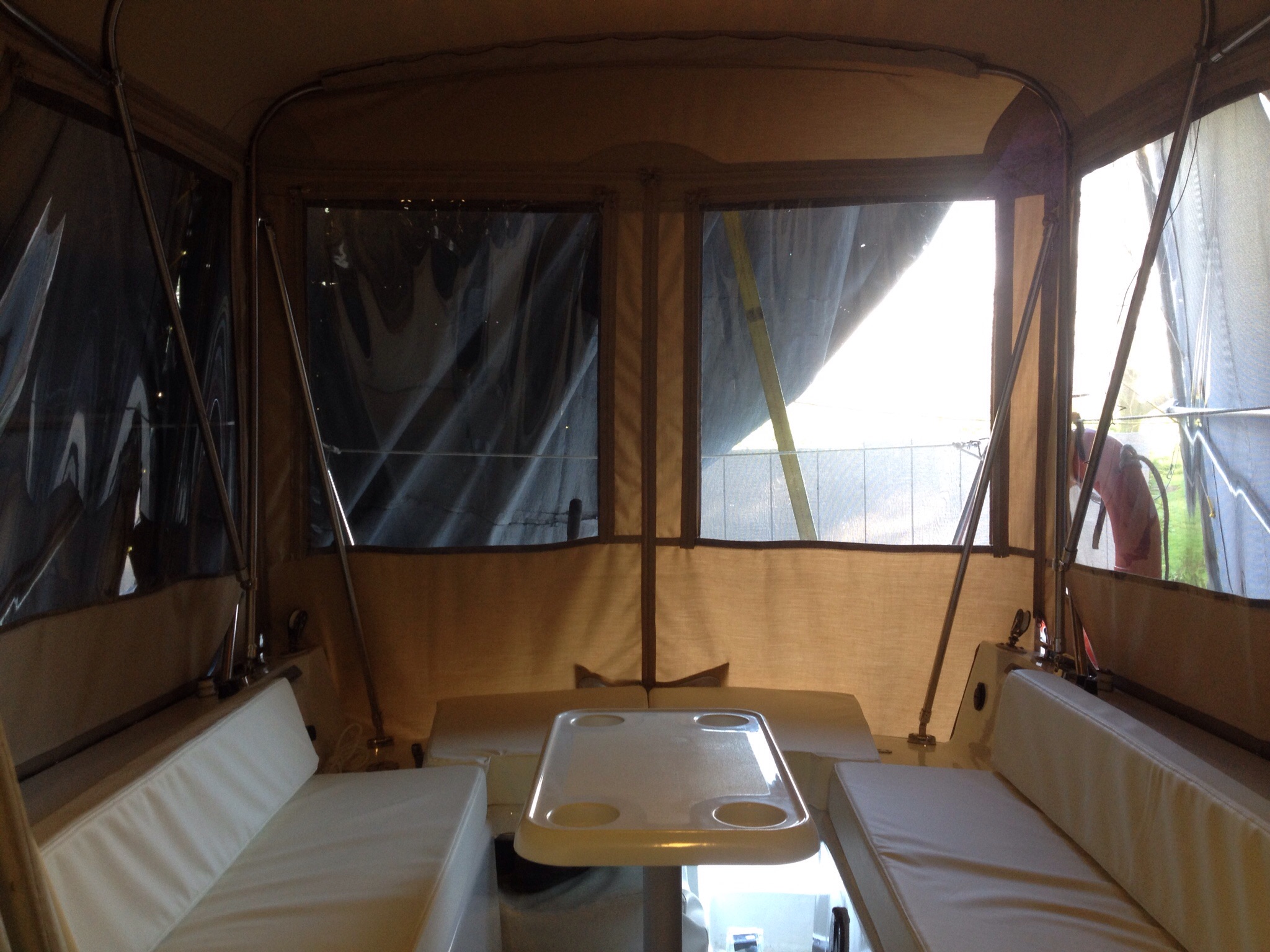

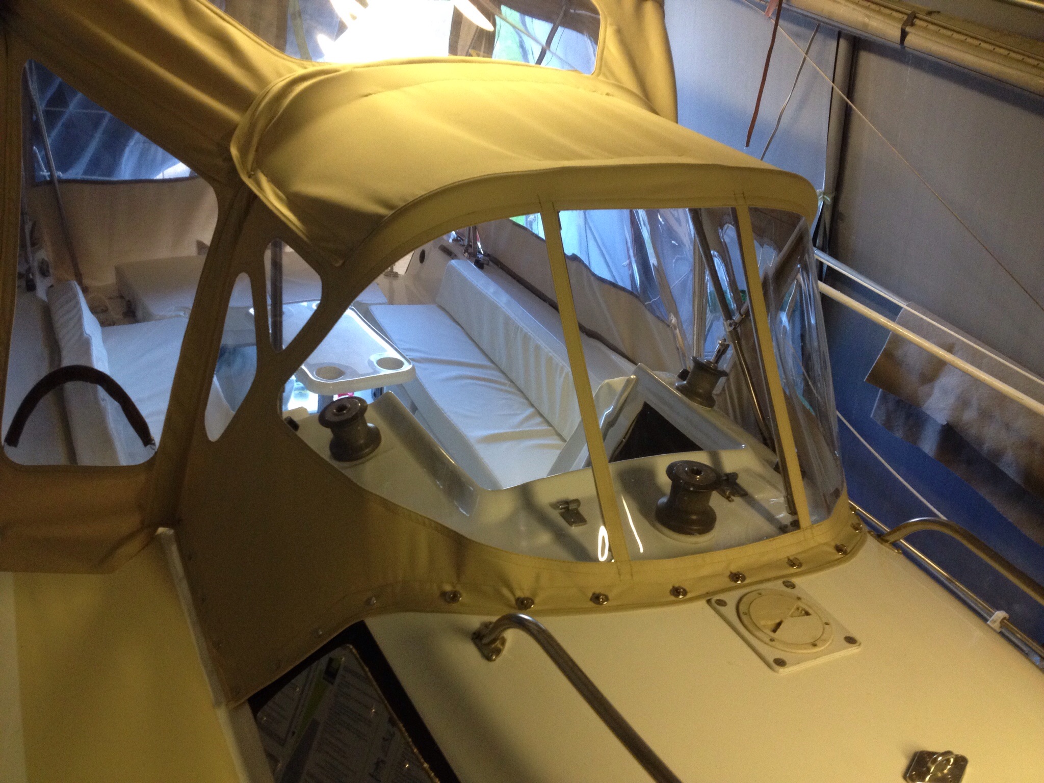

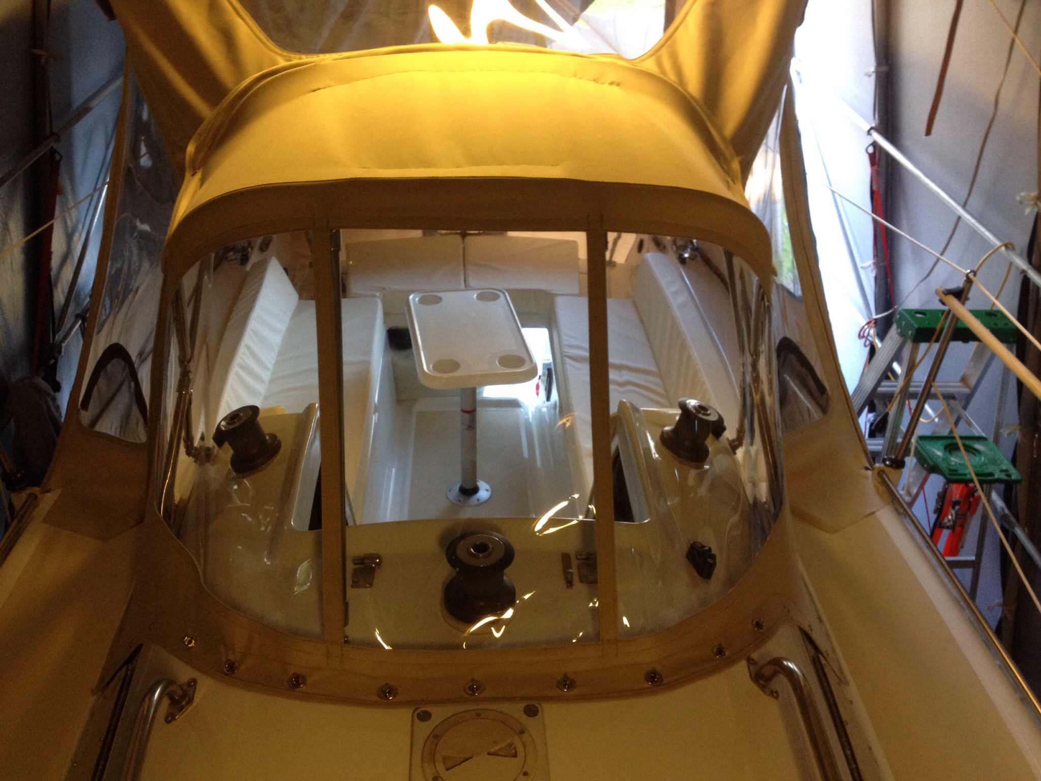

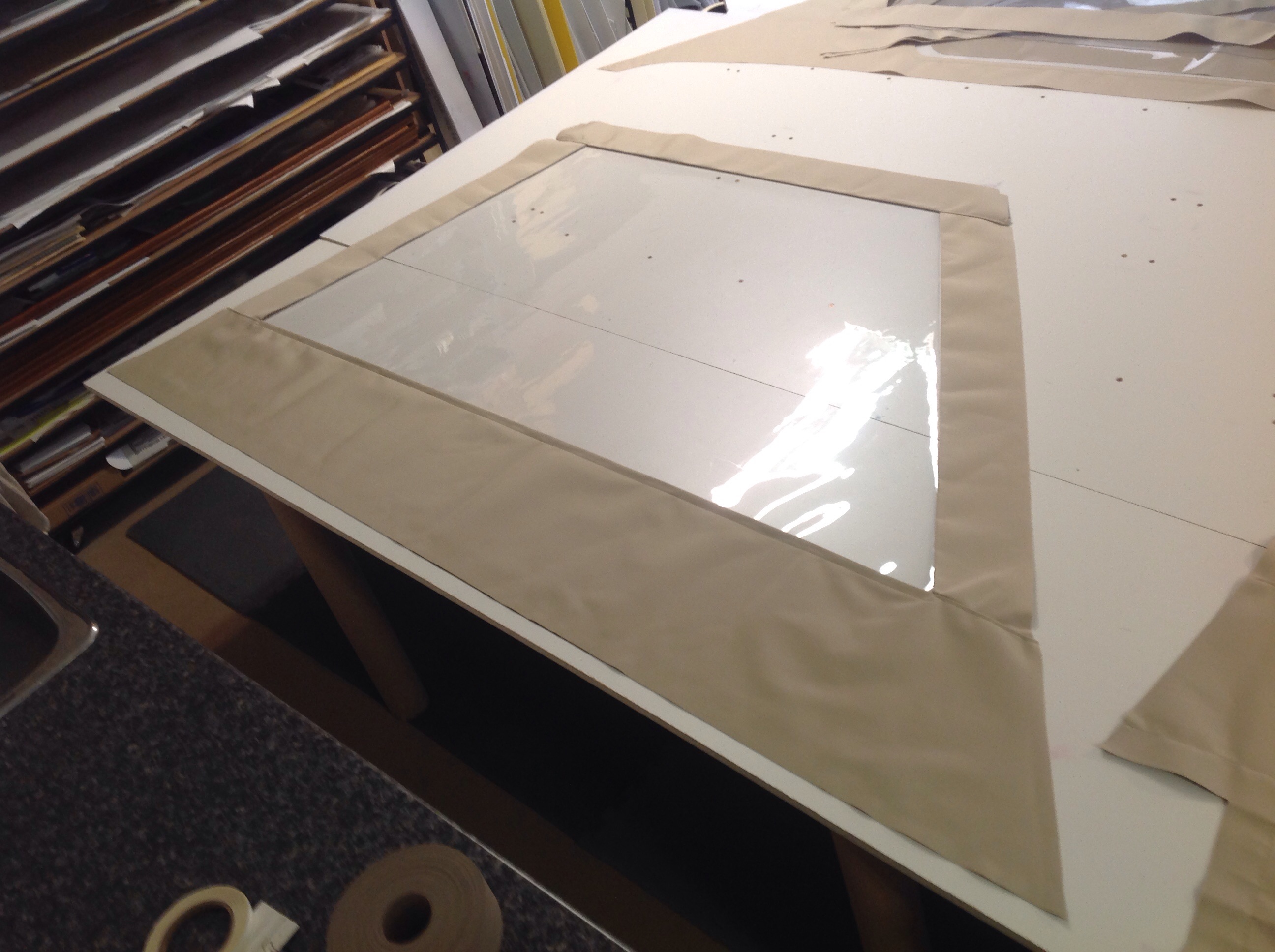

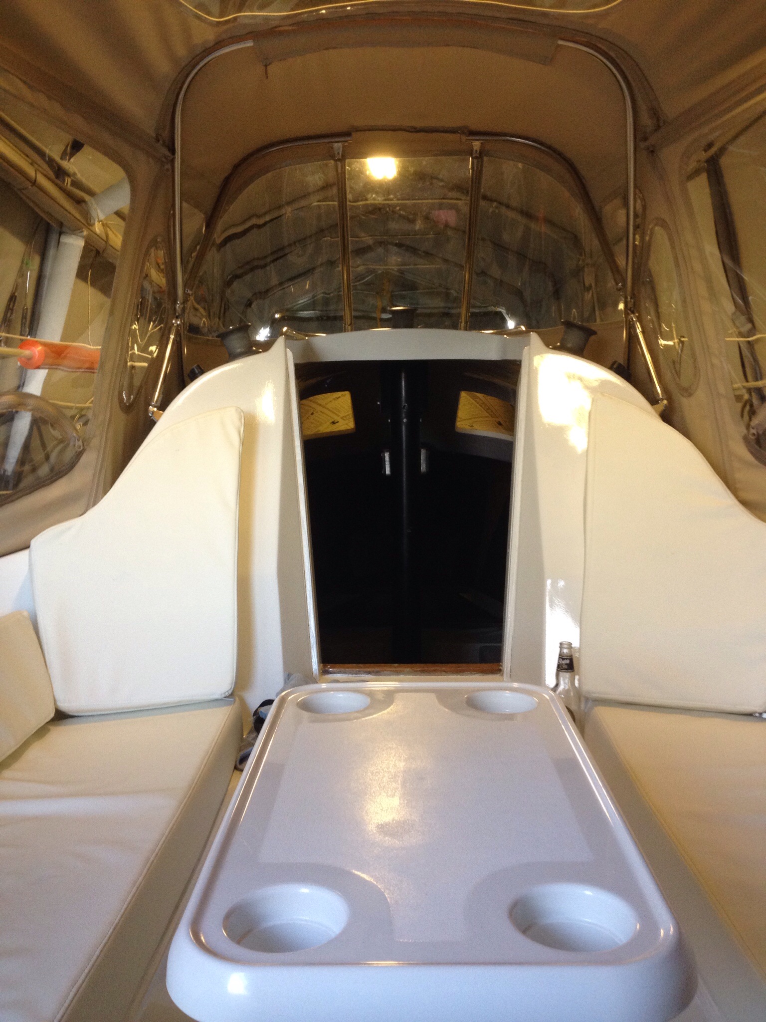

Dodger finished. Cockpit enclosure nearly there.
Really going to enjoy the outdoor living space...very comfy & roomy.

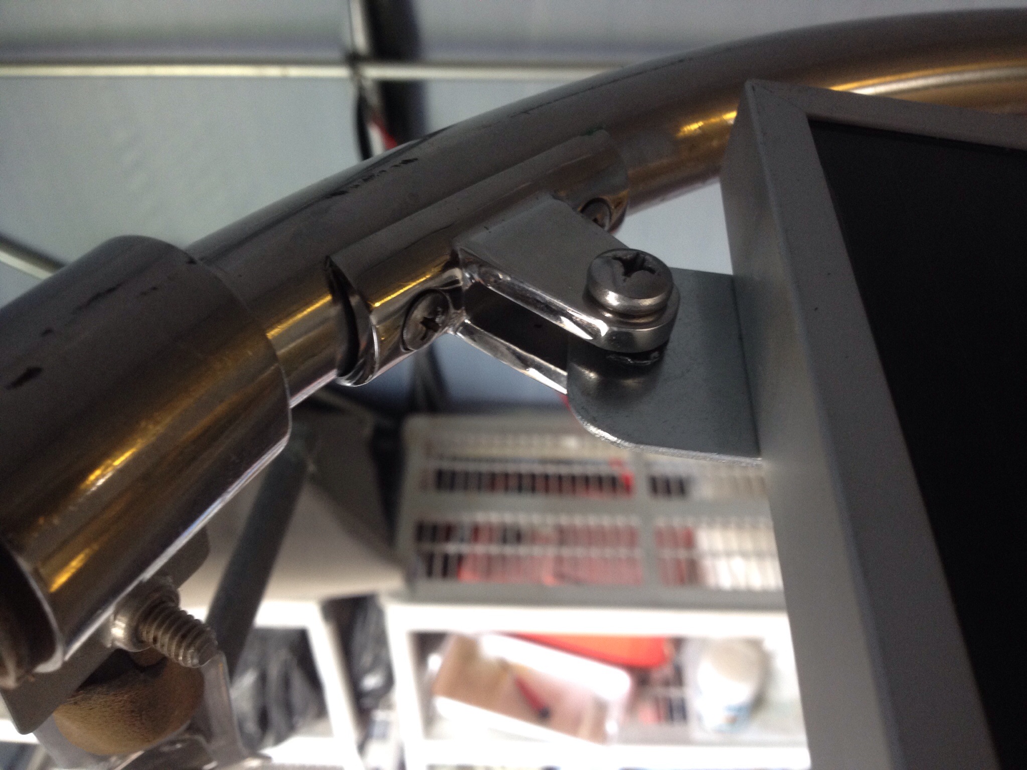

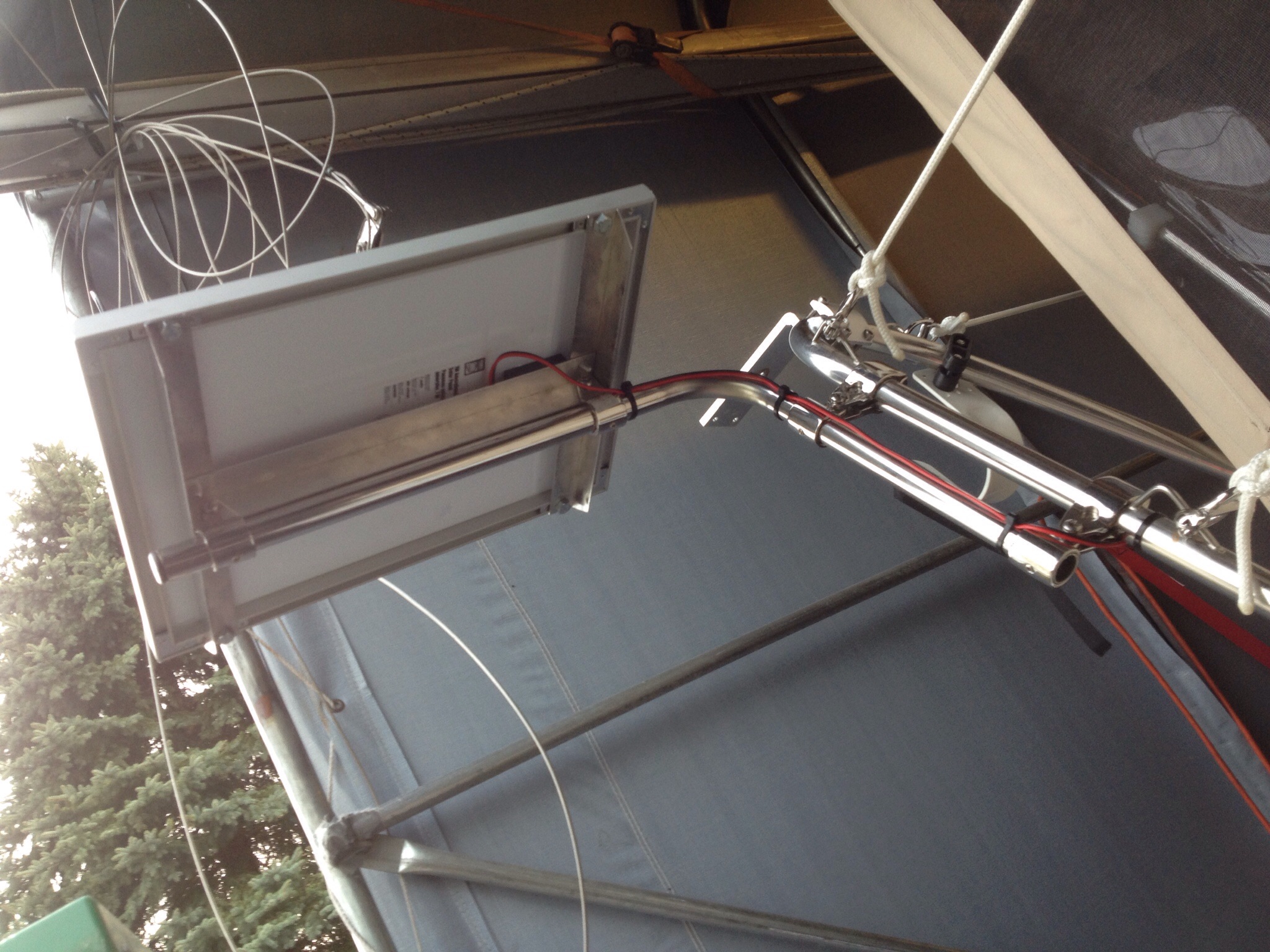

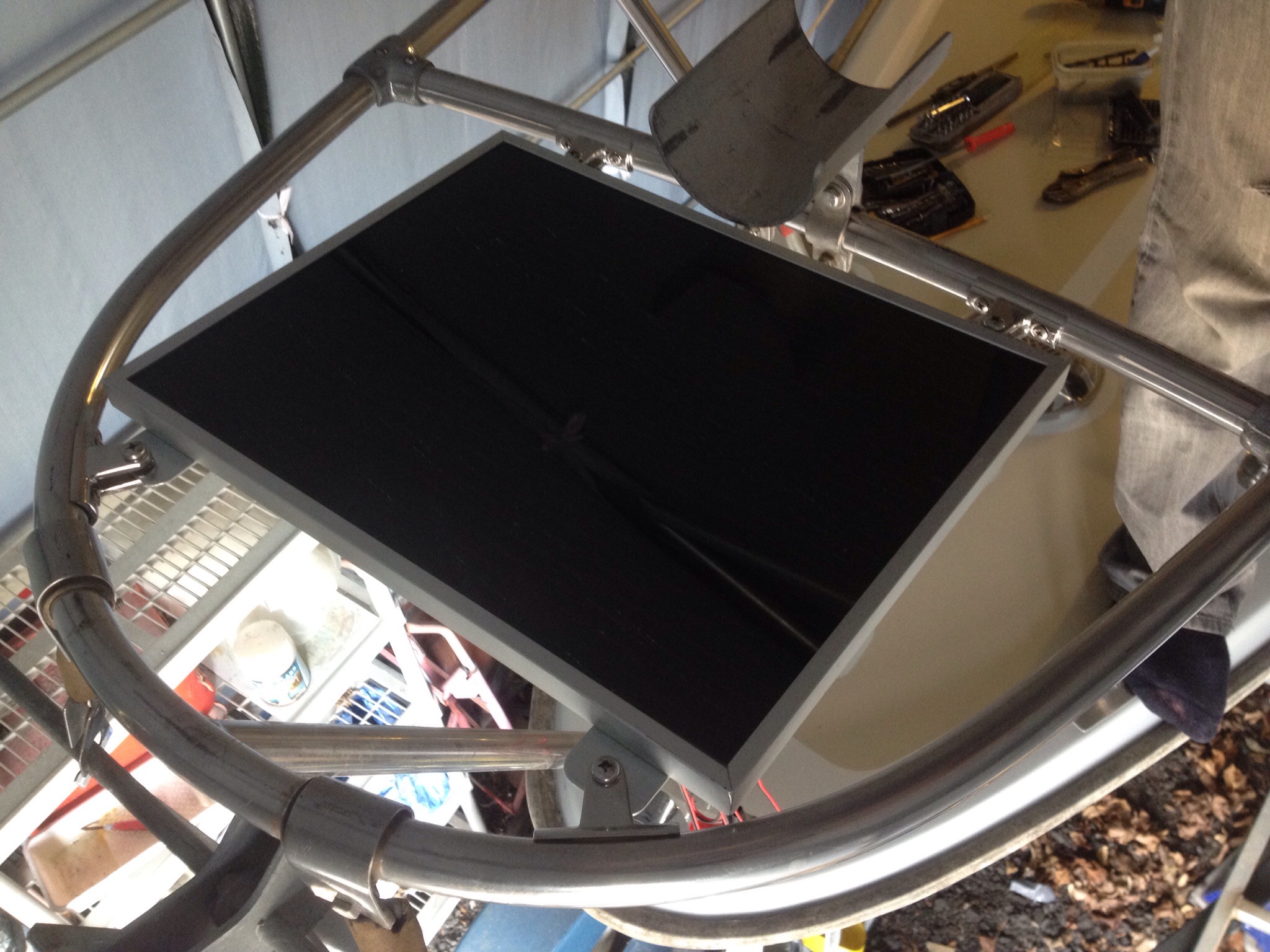

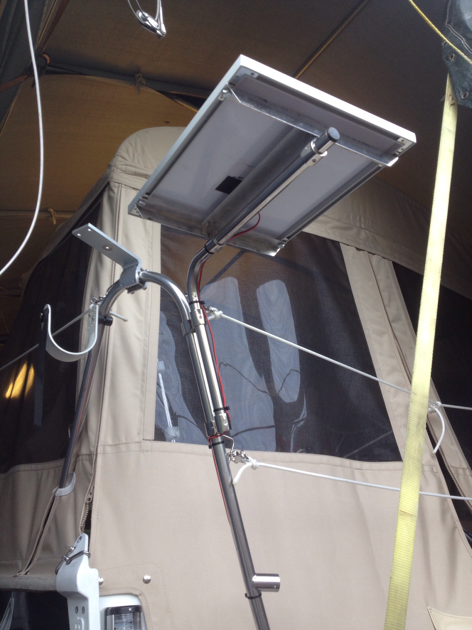

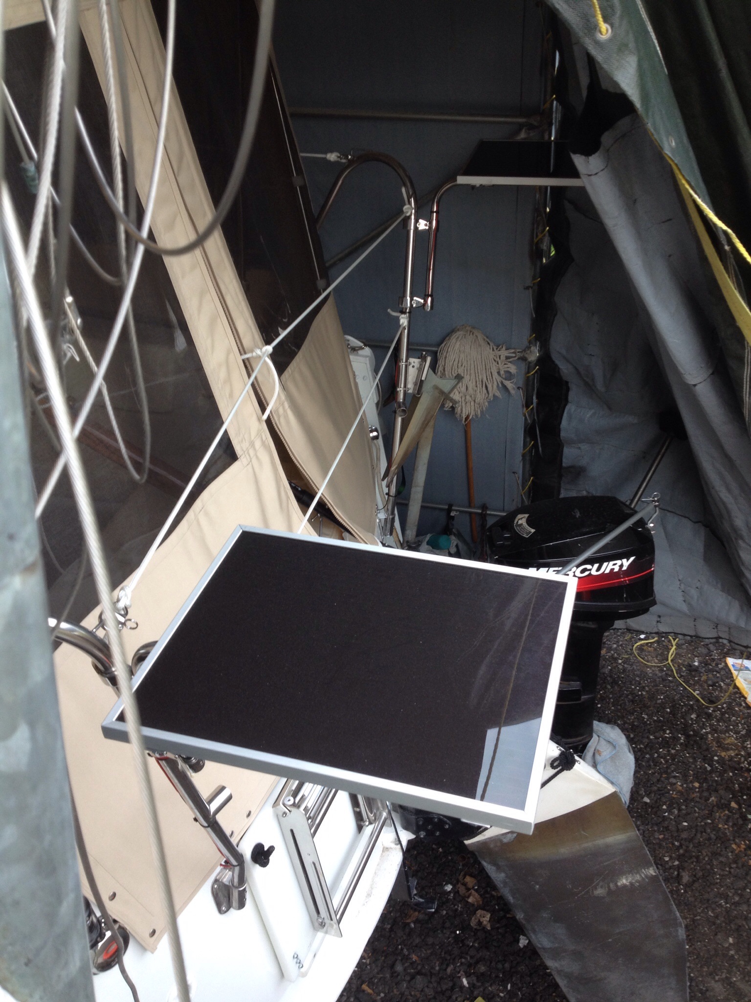

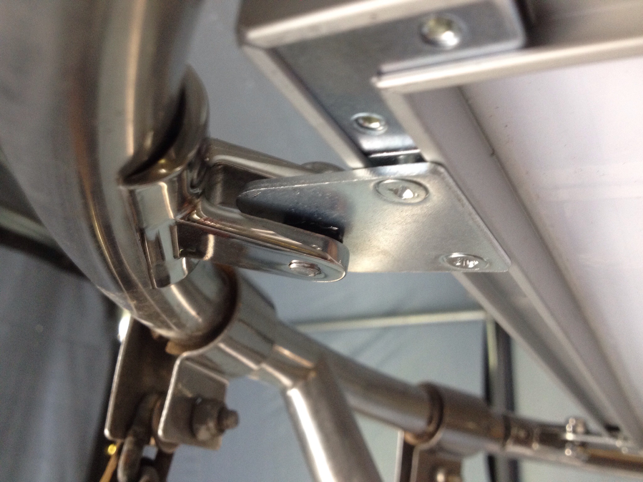

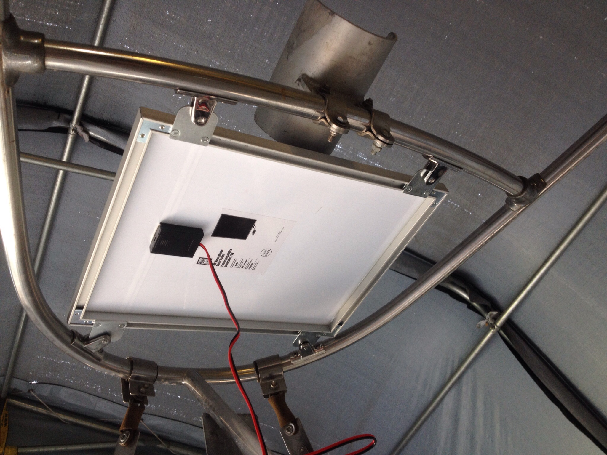

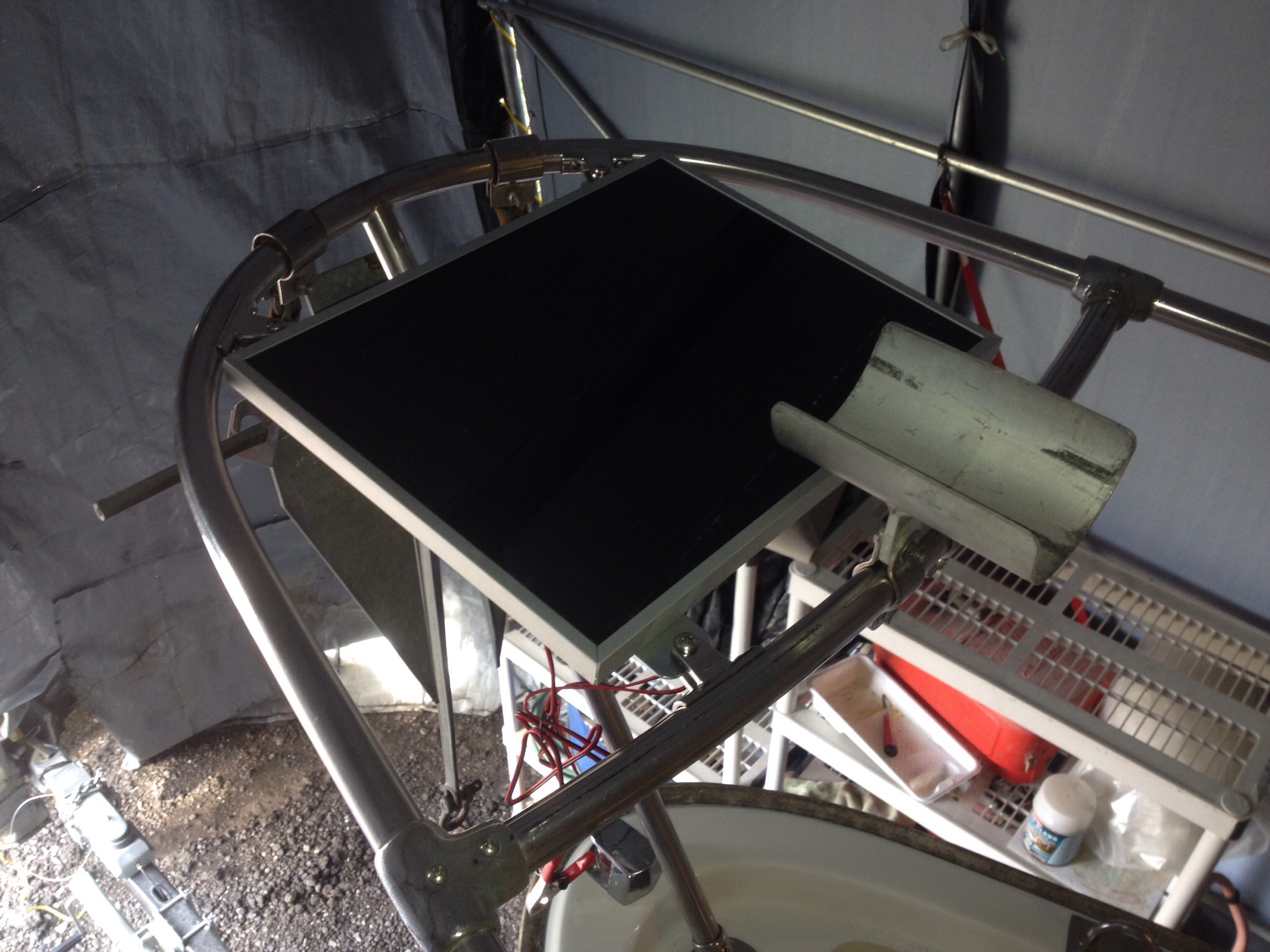

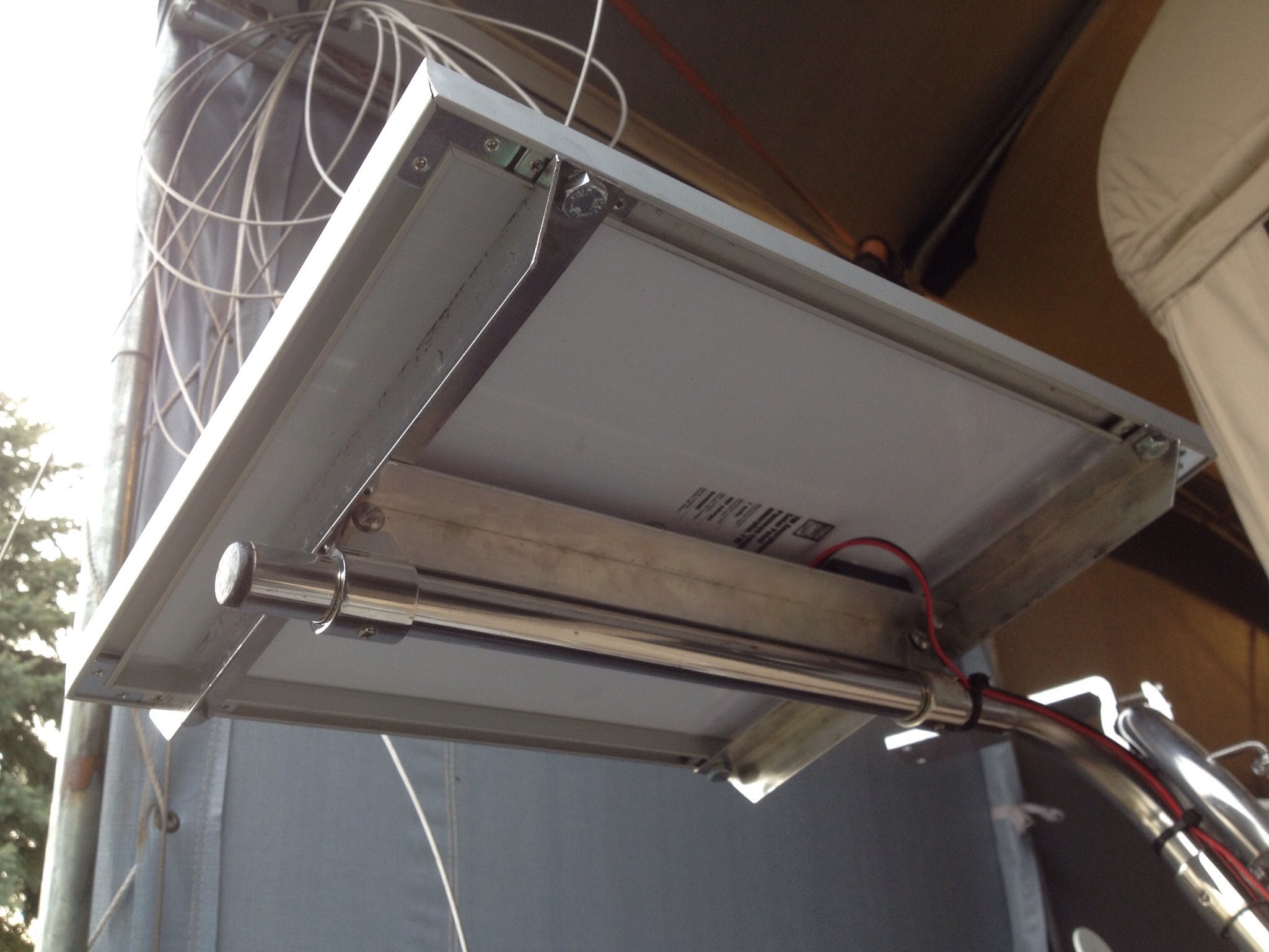

Aft solar panels installed...can basically move them in any direction to follow the sun.
