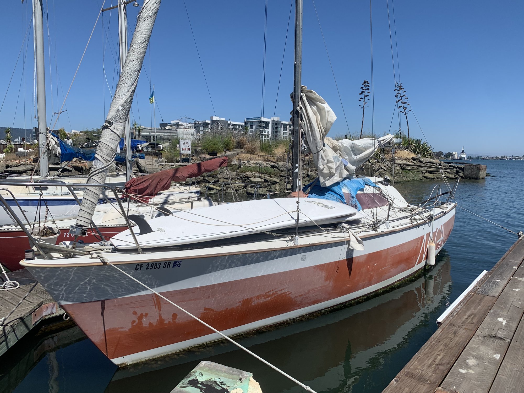

I have inherited a Mega 30 (lift keel version) from a friend of mine. The boat has not been used for a long time and is in poor condition but I’m excited to bring it back to life! I found this forum and the advice and pictures are perfect for the project I have ahead of me. Since every project is different I’m wondering if this forum is still active, or if you have recommendations for other threads/forums on the same topic.

- I would like to take down the mast to check if everything is still in good condition. Has anyone tried using the spinnaker pole with some stabilizing lines to either side as a way of lowering it down? From the handbook I couldn’t figure out how long the recommended construction is. If anyone has information on the weight of the mast, I could calculate the forces from there, too. Alternatively I’m thinking about climbing the mast.
- the electric engine for lifting the keel is gone and so is the winch handle to do it manually. Could someone share a picture for what the winch handle is supposed to look like? I was hoping it would be a normal sailing winch handle but that doesn’t seem to be the case.
- the boat desperately needs a repainting. However, just getting it lifted out and on the dry in the Bay Area seems to be around $2000 plus high daily fees of $250 a day. I assume when you can lift the keel you can trailer the boat out (right?) but I’m not sure if that will be possible (need a winch handle and even then everything seems pretty old and rusty). Some local people recommended beaching it for the sanding and painting but that doesn’t seem to be a great option either (and probably illegal in CA). Any other ideas on how to get her out of the water at a reasonable price?

I'm not sure about the spinnaker pole as a gin pole idea, it might work but you would need to be very careful. A fellow I knew did that with his Mega 30 and the mast fell, bending the mast.
It does look like you need to haul out, the bottom has a lot of growth which would be easier to clean out of the water. The topsides might brighten up with a good polish. Spend some time working on lifting the keel, that will save you some money if you have access to a suitable trailer.

The mast was not intended to be lowered using the spinnaker pole. Estimated weight 150-300 lbs. At 38 ft (approximately) the moment arm would be punishing trying to lower the mast. The safest technique would be a crane lift.
With the reported Bay Area hauling costs you are being exposed to the nature of a free boat. This is just the beginning. You’re going to need to do some searching to find a place lace to haul. I’d suggest looking in the Richmond area or maybe up river near Benicia.

I would get the keel working first, then get a good trailer. One boat here used an UTV winch to replace his dead original. Use the manual winch first until you know the system is working. You don't want to break anything

I’m aware that free boats are often the most expensive ones. However, I do think this boat has good substance and I’m excited for the project. Thank you for the advice with mast and keel. I will focus on getting the keel moving. Once I can get the boat on the dry the rest seems manageable.
