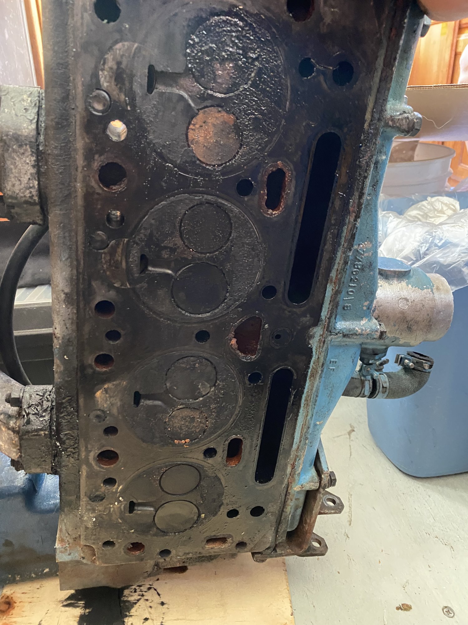

The engine is expected to be removed tomorrow morning. Monday was a visit by the mechanic to assess the engine removal and gage when he could do the work. Wednesday morning was selected.

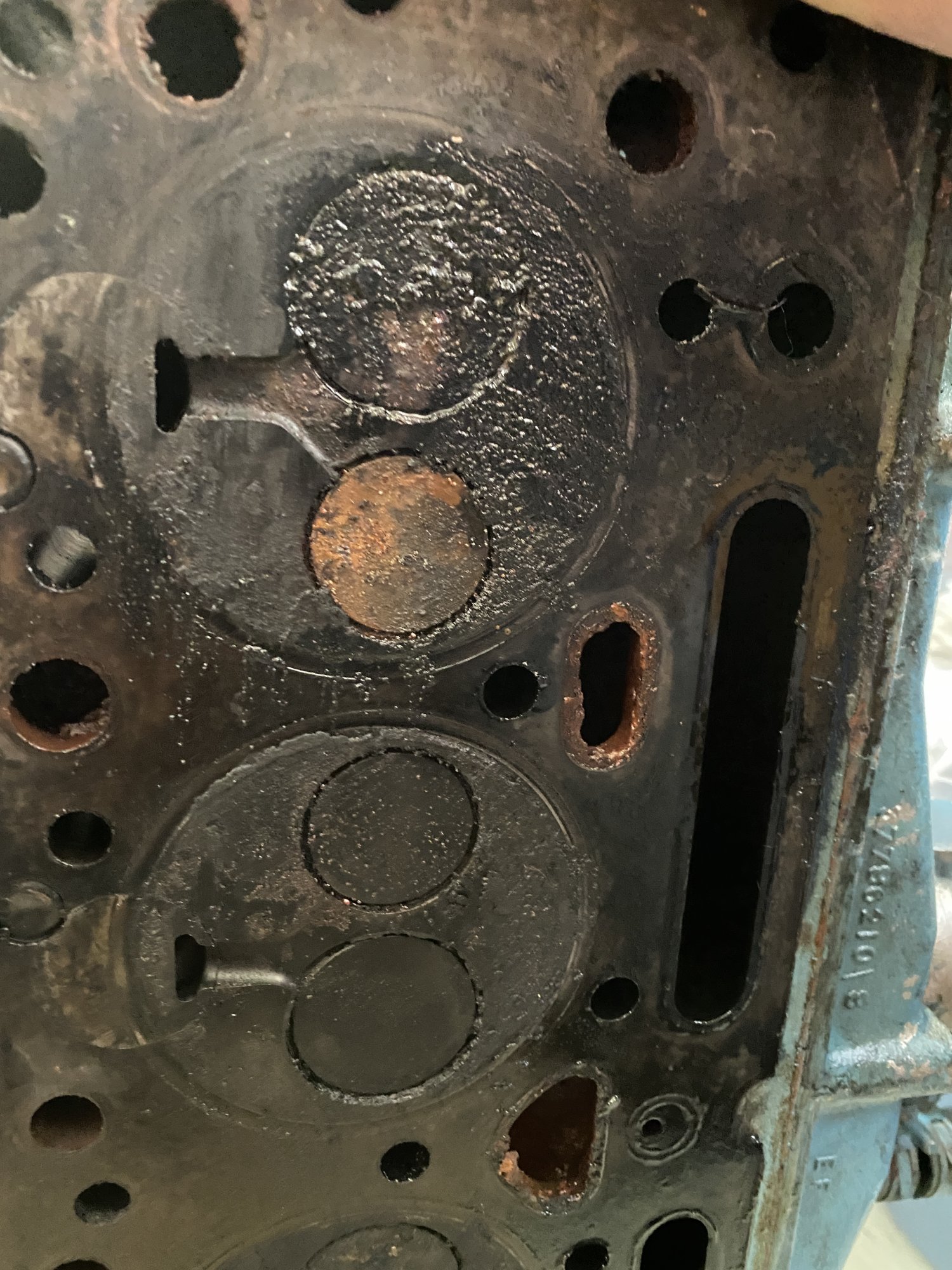

I took some pictures of the head, which Les and I removed on Saturday.

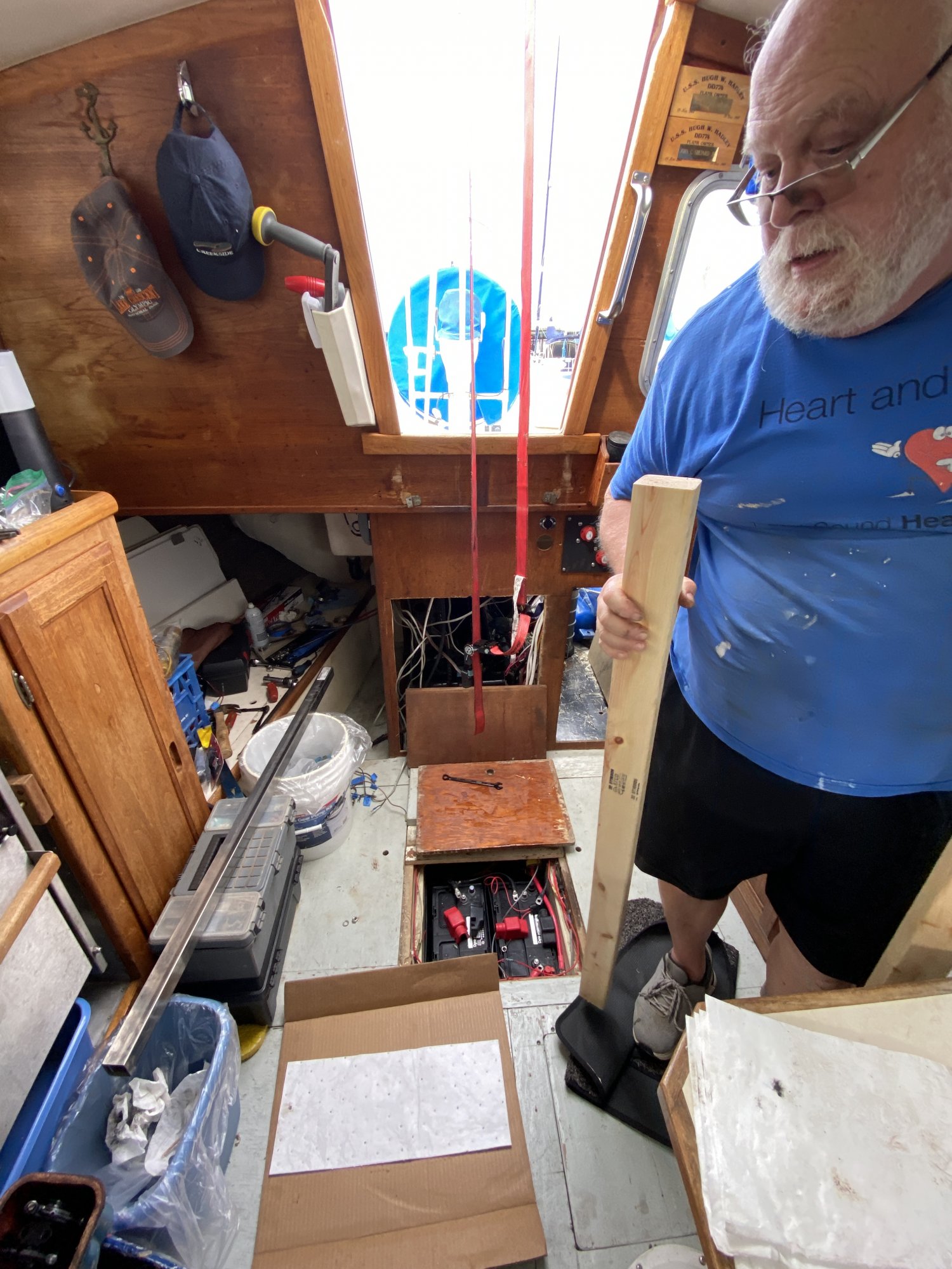

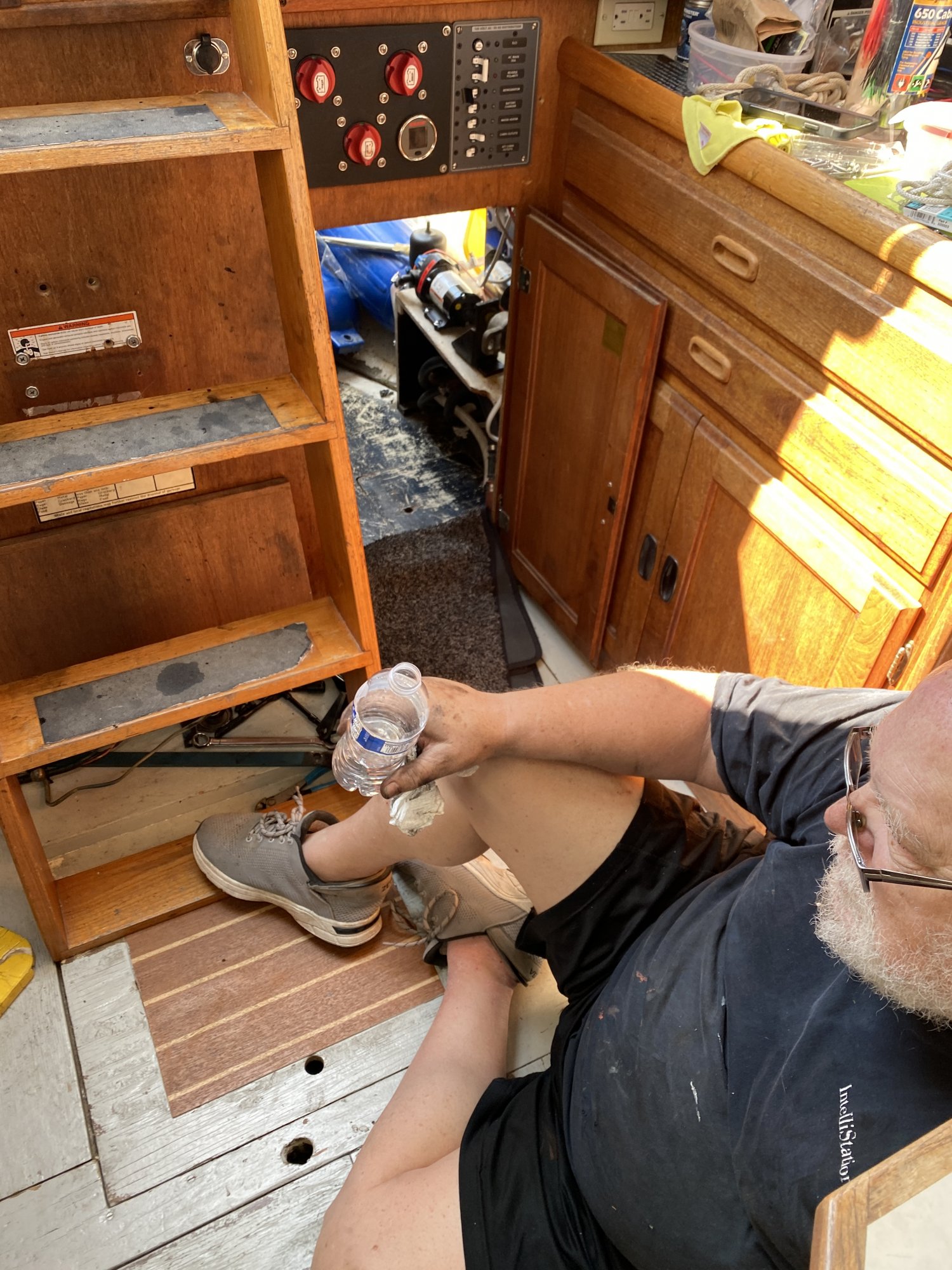

Cabin works space. The second picture you can see where we opened a hole in the bulkhead.

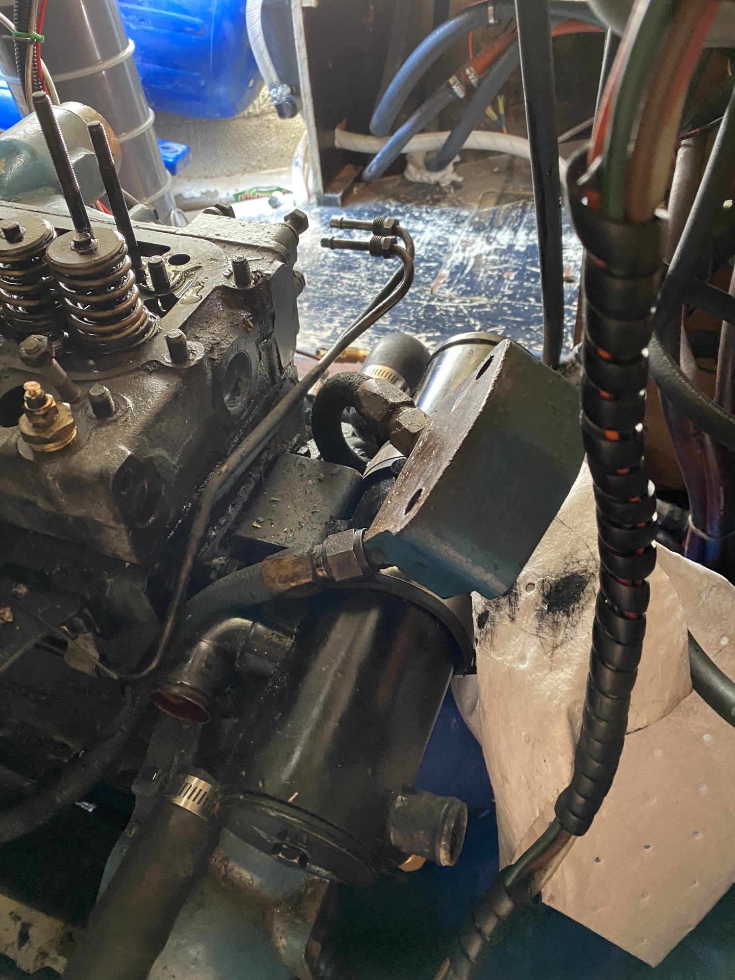

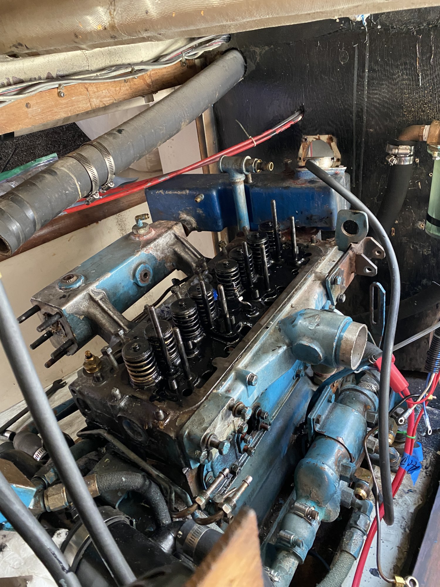

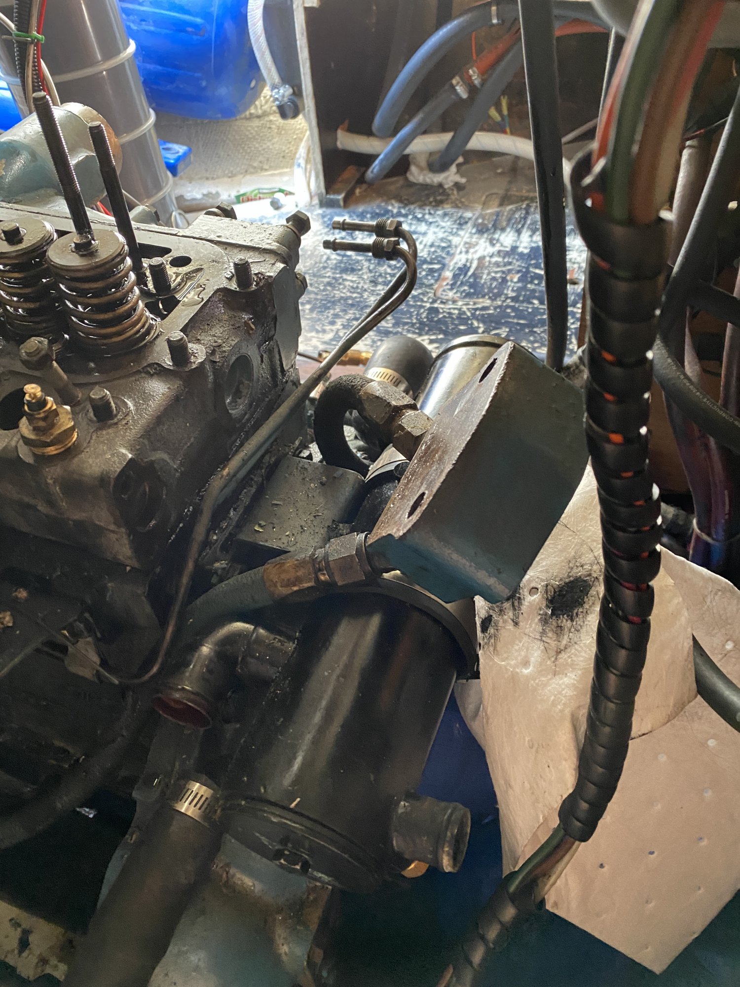

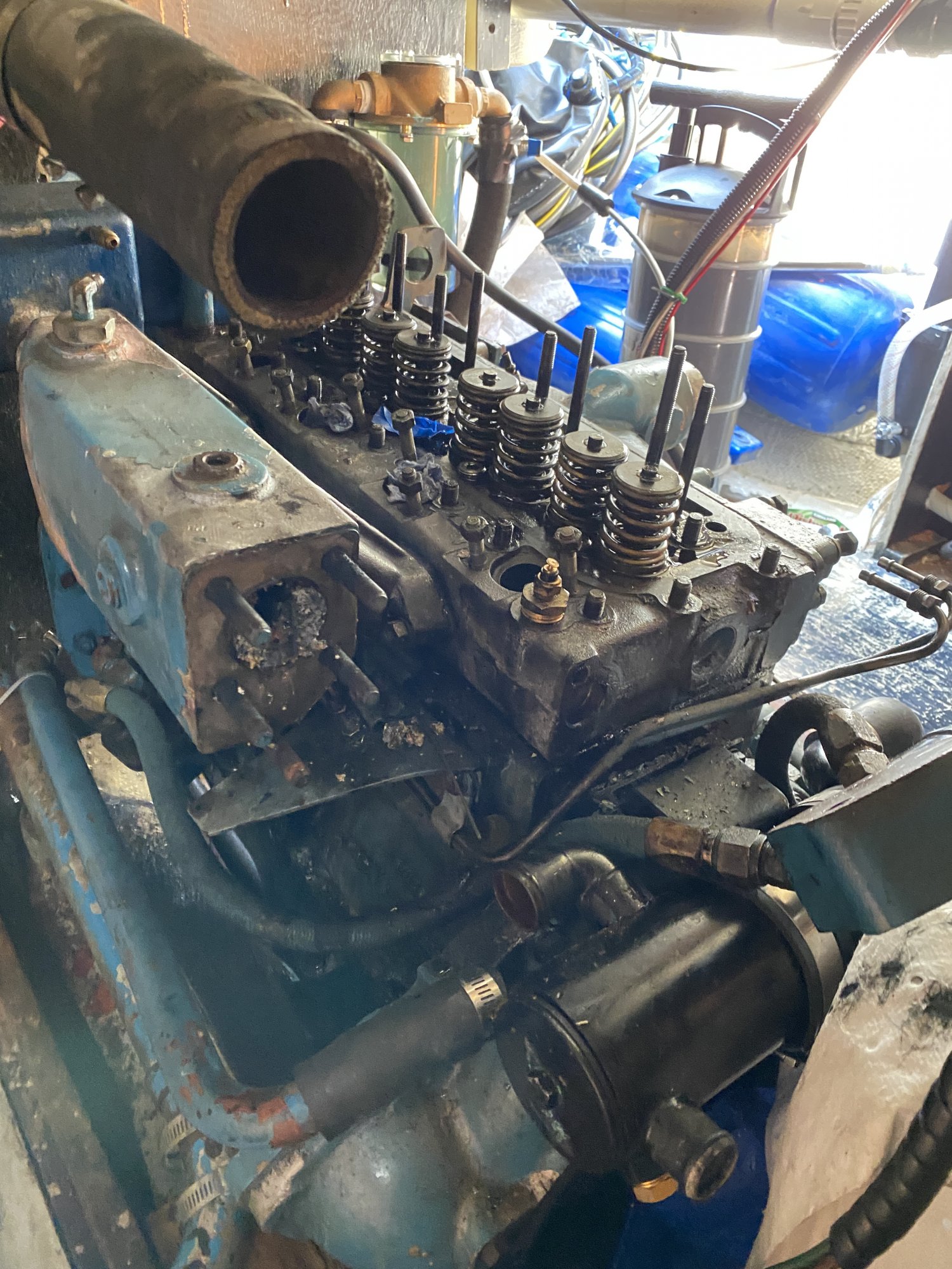

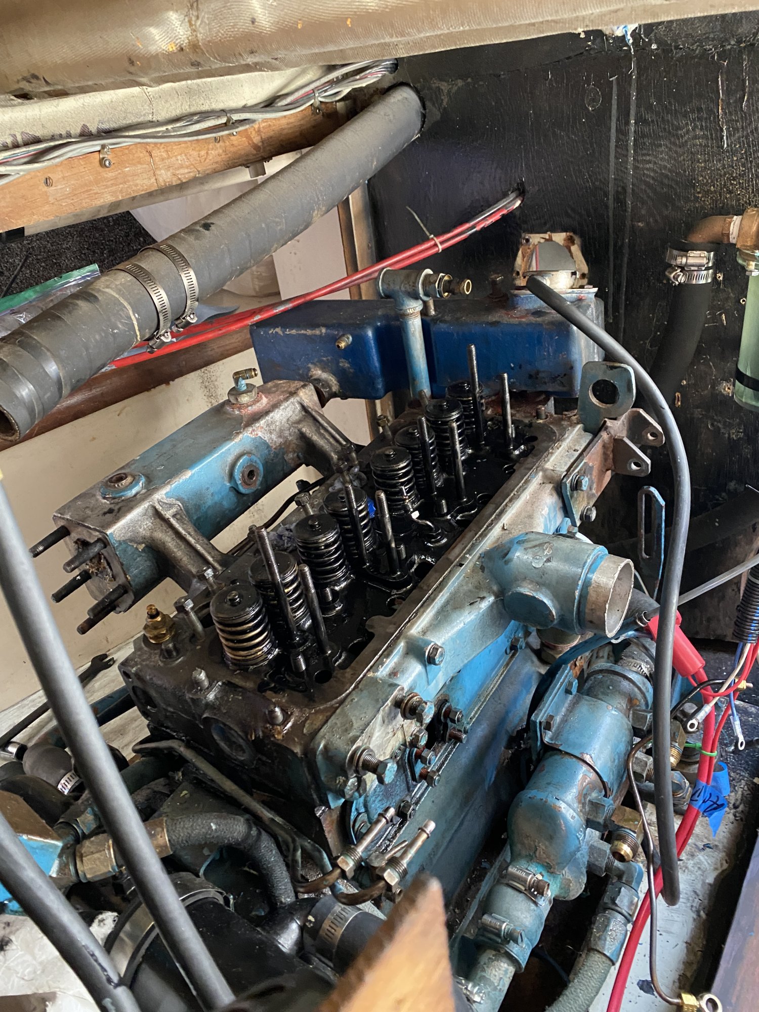

These shots show the engine being disassembled to get at just the head.
View attachment 208347 View attachment 208346 View attachment 208345
The exhaust shows some salt accumulated in the opening. The valves all look normal, to me.

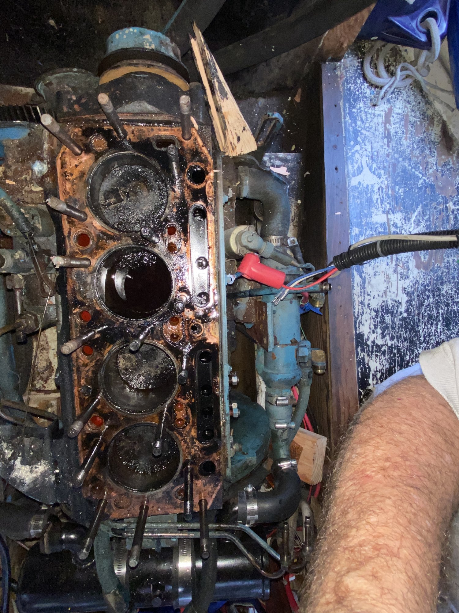

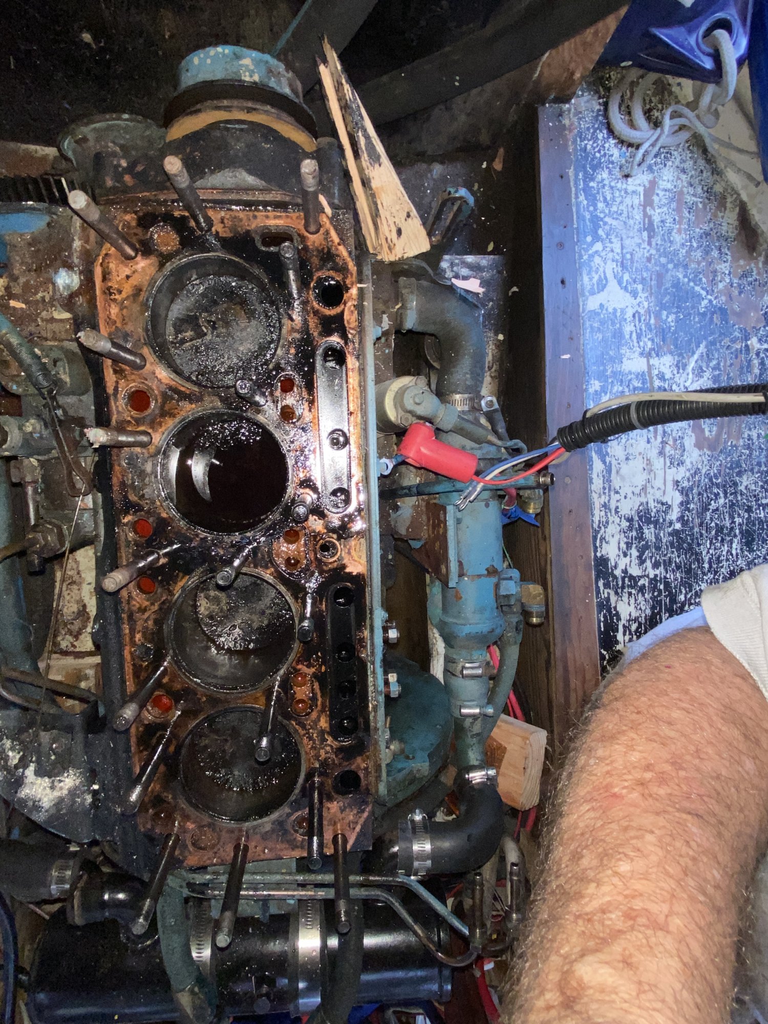

Here is an image looking down on the block just after we removed the head.

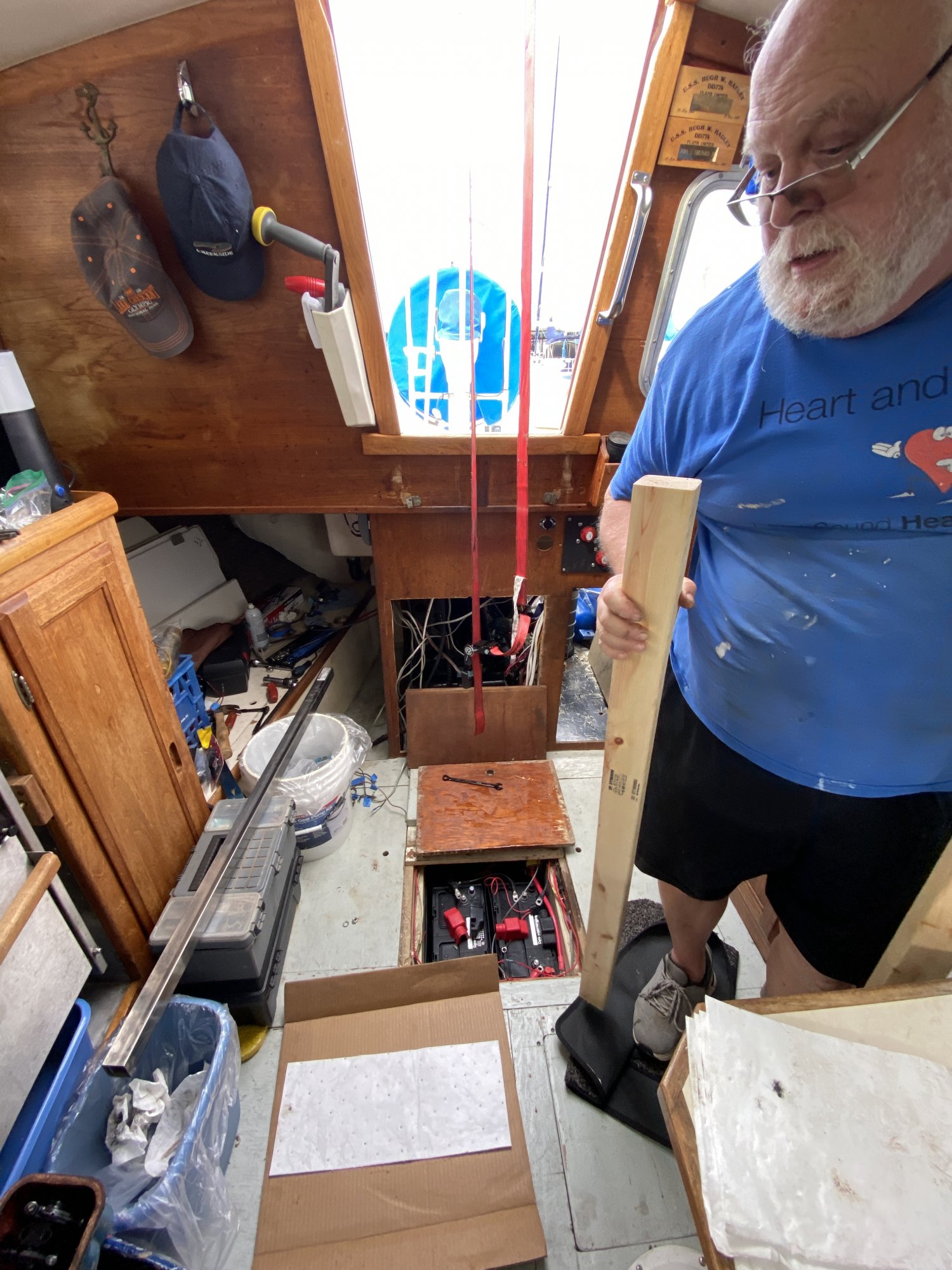

Wednesday AM we arrived at the boat about 8:30. Scott, the Mechanic, was scheduled for 9AM. Got to the boat about 9:30. After surveying the problem Les and I went about setting up the A-frame Bases while the Mechanic went to his shop to get additional blocks of wood to serve as braces.
My boat has a cockpit port over the engine, where the control gauge panel sits. I removed the panel and the port cover. From there we dropped a come-along into space above the engine. This allowed us to vertically lift the engine off the motor mounts.
The mounting brackets were too wide to fit through the bulkhead opening, so I removed them while Les and Scott supported on blocks a 4x4 above the companionway. Attached a come-along to the engine and pulled the engine through the bulkhead while easing the hold through the port. The engine swung gently into the cabin. Once in the cabin, we set the engine down on a pair of 2x4's and rearanged the A-frame to get the engine up and out to the cockpit. From the A-frame in the cockpit Scott positioned an aluminum I-beam to over the engine on a 4x4 across the companionway. Again center lift out of the cabin. This time the come-along pulled the cable loop that was over the over the I-beam along into the cockpit. One last set down and reset of the A-frame. One A-frame in the cockpit and one A-frame on the dock. It was a stretch but the system worked with the boat snug up tight against the dock, we made one final lift and moved the 400lb block to the dock. Did not dump the engine block into the water.

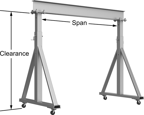

The rig looked something like this. There were no wheels. The unit made from aluminum was managable on the boat.

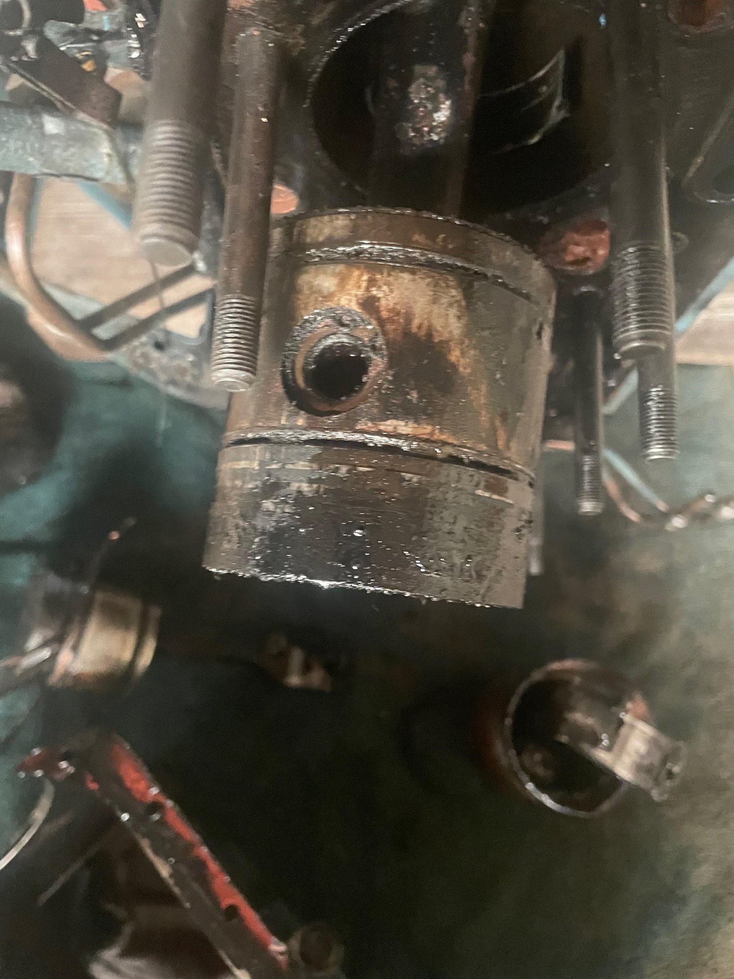

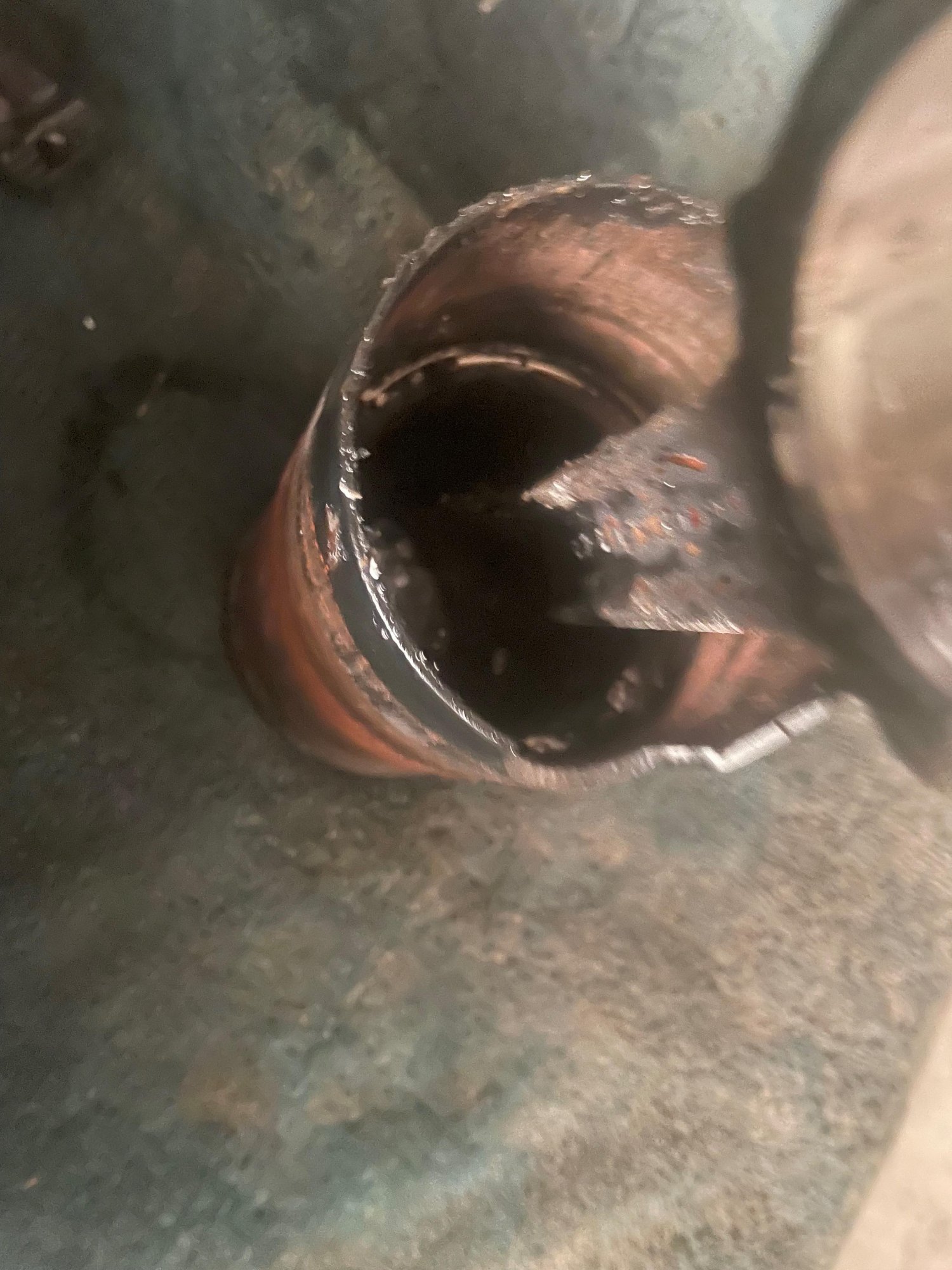

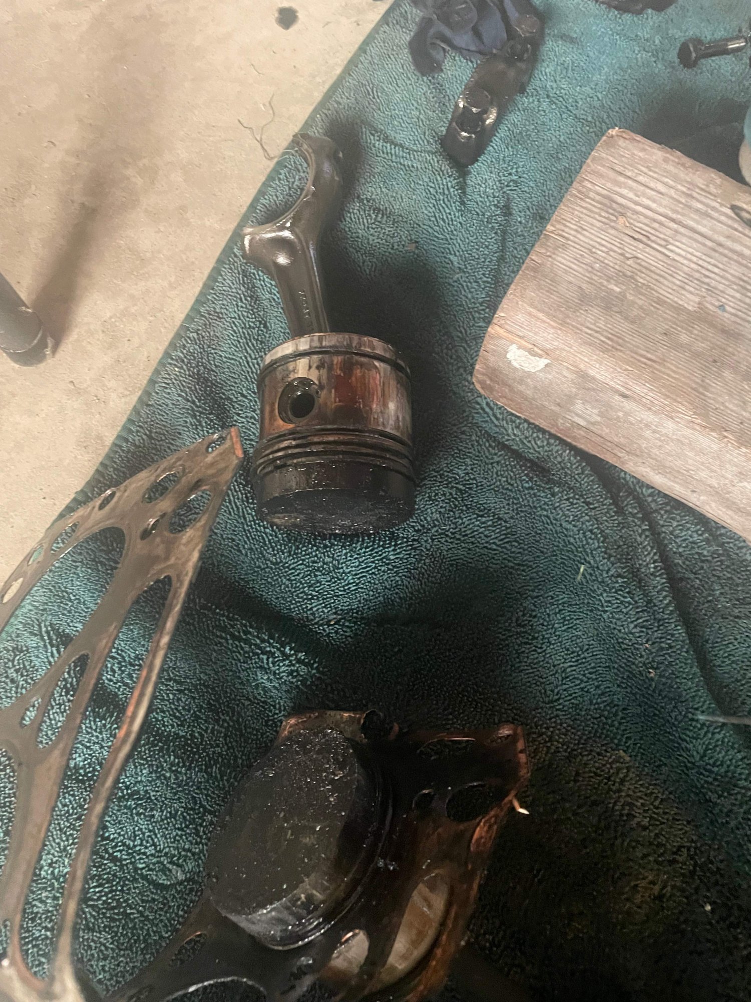

Scott took the engine to his shop and started the process to dislodge the pistons from the block. Here are the images I received Thursday afternoon.
He said cylinders 2 & 4 had a lot of rust. The pistons were frozen in the block. No apparent damage to the block crankshaft or bearings. All still need to be inspected. Unclear where the water entered the block. That is under investigation. He thinks a rebuild is possible. Is putting together a list of parts and will contact me with the news - a quote.

Jon, that is what I thought. My 107 is from 1973. The indication now is that the 107 has a centrifugal cast iron wet type liner. They are pressed into the block. They have 2 rubber seal rings that keep the coolant from the closed system getting into the cylinders. Conjecture on my part, there may have been a seal failure. This may have let water enter the cylinders and thus the rust and water/salt residue showing up in the exhaust.
I found some white looking residue in the heat exchanger. Possibly another source of water. Even though the heat exchanger was recently cleaned and pressure tested With in the past 13 months.
