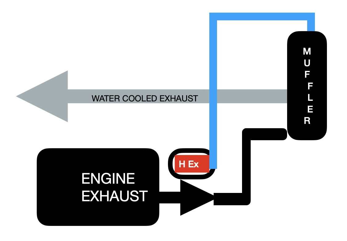

With the cranking that was done, was the seawater thru-hull closed and the water lift muffler drain open?
Understand the issue.The Seacock was closed. I don't really have a water lift muffler like so many Catalina's. The design is a bit different, though similar principals. I'll sketch it out.
Any ideas where the water came from? It is just strange to get water in the engine after many decades of no water.
From the photos seems like it could be a head gasket, could be another seal or a series of seals, or combination of these. But sure looks like a gasket/seal problem. I'd have to have to complete design drawings for that engine which I don't have.

Unclear reason for the rust. I had the through hull closed. Only guess is there was water still in the muffler. I do not have the typical water muffler.
What we did notice that the exhaust manifold had salt at the opening when I removed the muffler.
Could also be a blown gasket. This is conjecture at this point.

Best guess now is that the salt water intrusion came from back flow in the muffler. Still checking. Will be examining the exhaust system before or during reinstall.

John, you have several time alluded to not having a "typical water lift muffler". If this was the cause of your problems this would be a design flaw, which will repeat itself.
Nervous minds wish to know, what is your muffler set up? It seems that while this is all in pieces it would be a good time to change out the muffler. On the other hand it took a long time to cause a problem if the design is actually faulty.
