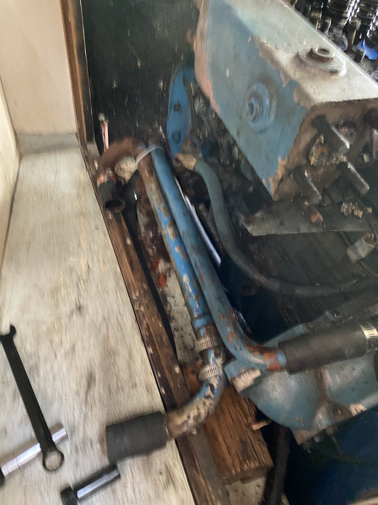

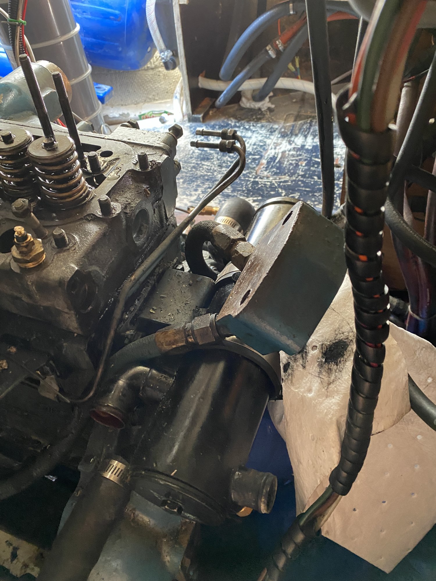

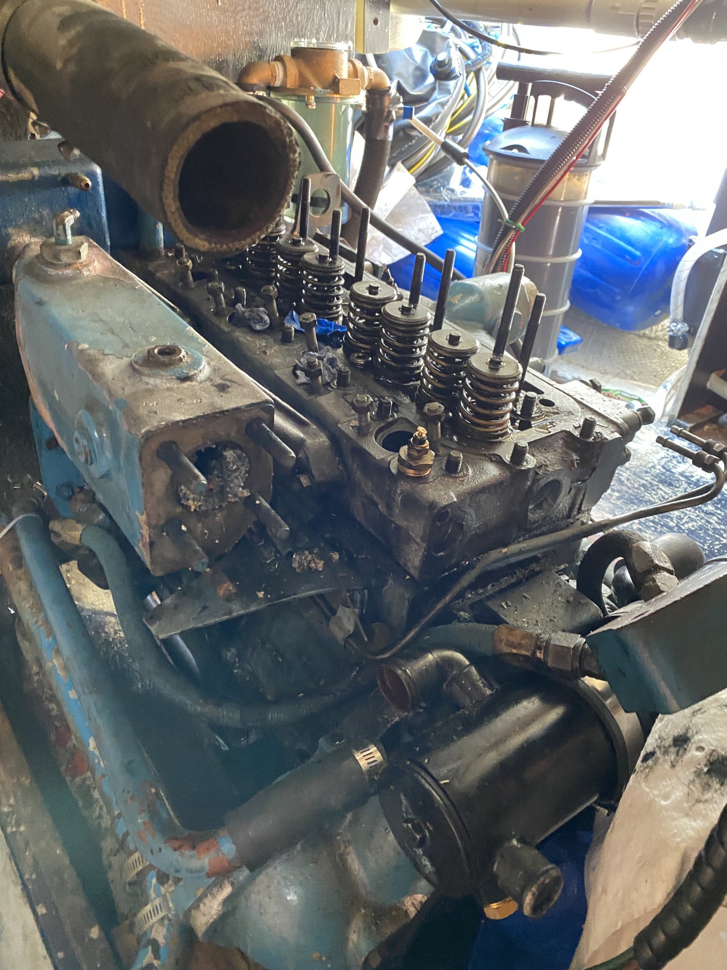

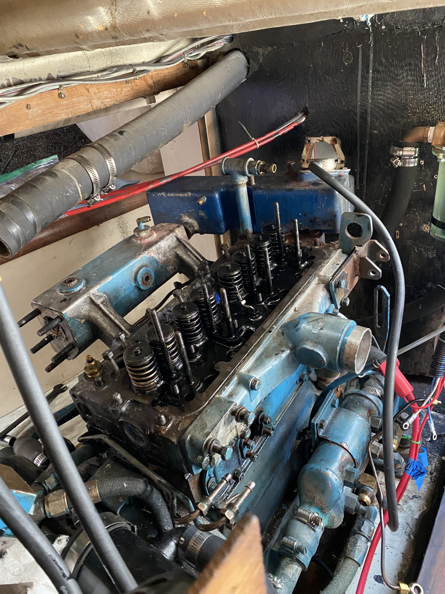

We spent the day in unbolting the many attachments on the engine. Got the muffler/exhaust assembly, the fuel lines and filters the mechanical fuel pump, the valve cover, rocker arm, all the head nuts removed. We were able to wiggle the head, expect it to lift off tomorrow.

It was time to regroup and figure out how we are going to raise the head 4 inches to clear the studs on the block and then float it the 3 ft out to the salon and out of the companion way.
We took a saw to the bulkhead and opened it up so there is room to remove the head and block.
