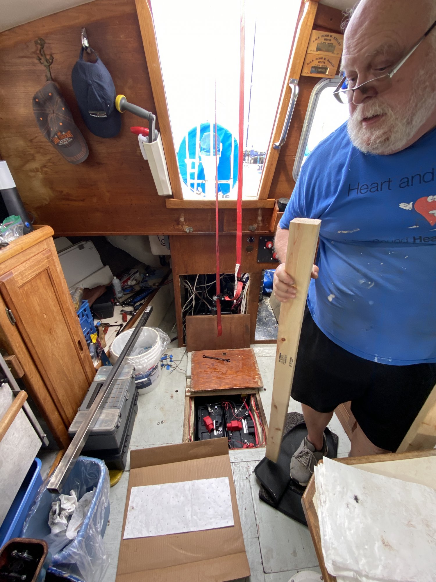

Saturday morning we showed up at the boat.
This "GET THE HEAD OFF" day.
Les jumped aboard ready to help free the Perkins from the boat.
Kept saying... Stand back John. I got this....

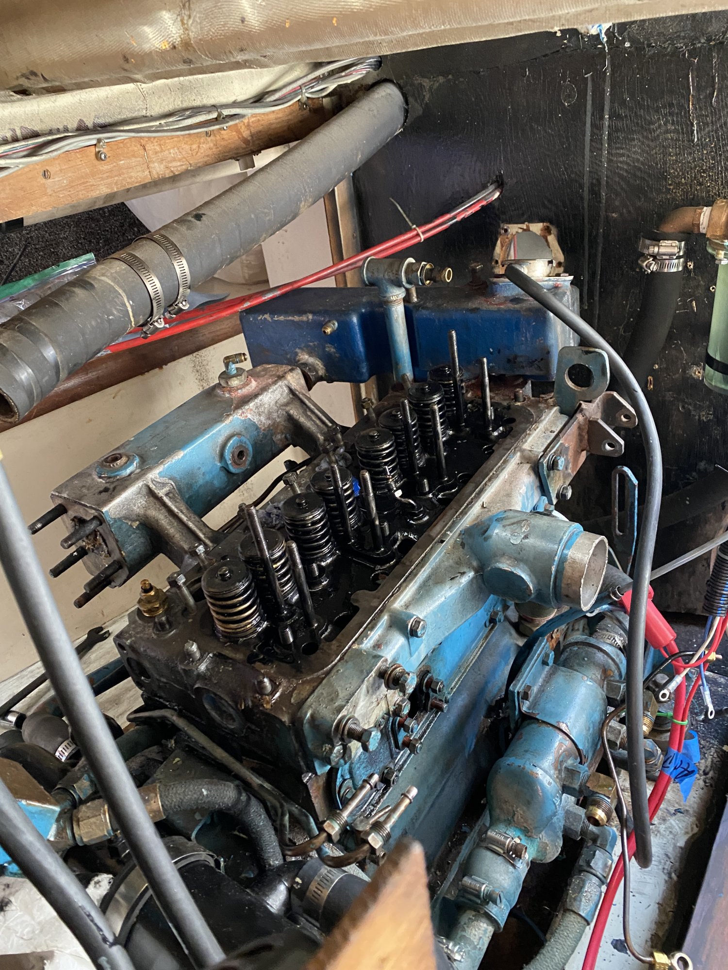

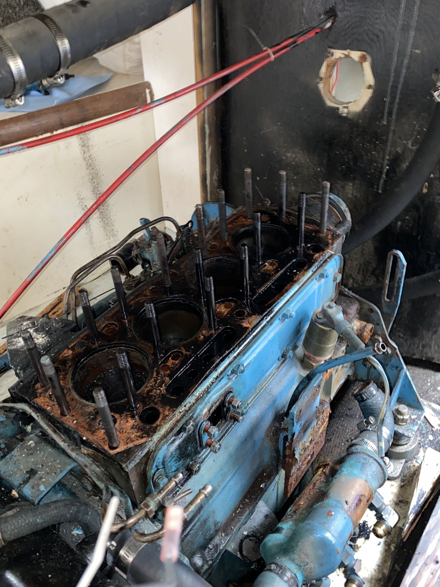

We rigged a lever to lift the head vertically, the designer of the block and head never considered the head would be removed from a boat. With a strap around the boom - slung down the combanion way, we slipped a length of steel tubing through the sling and in above the engine head. There was about 18" of space above the head. We ran a rope diagonally from the aft end of the exhaust manifold to a lifting bracket forward on the head by the alternator.
With the pipe extended into the cabin, Les applied force while I seperated the head from the block and inserted wooden wedges. Les said a few choice words about the 4" studs in the engine block as we worked the head up and off the block. Once free we swung the head through the space opened in the bulkhead, into the cabin. As Les grabbed the head, I positioned a piece of plywood to set the head down.
This was a success.

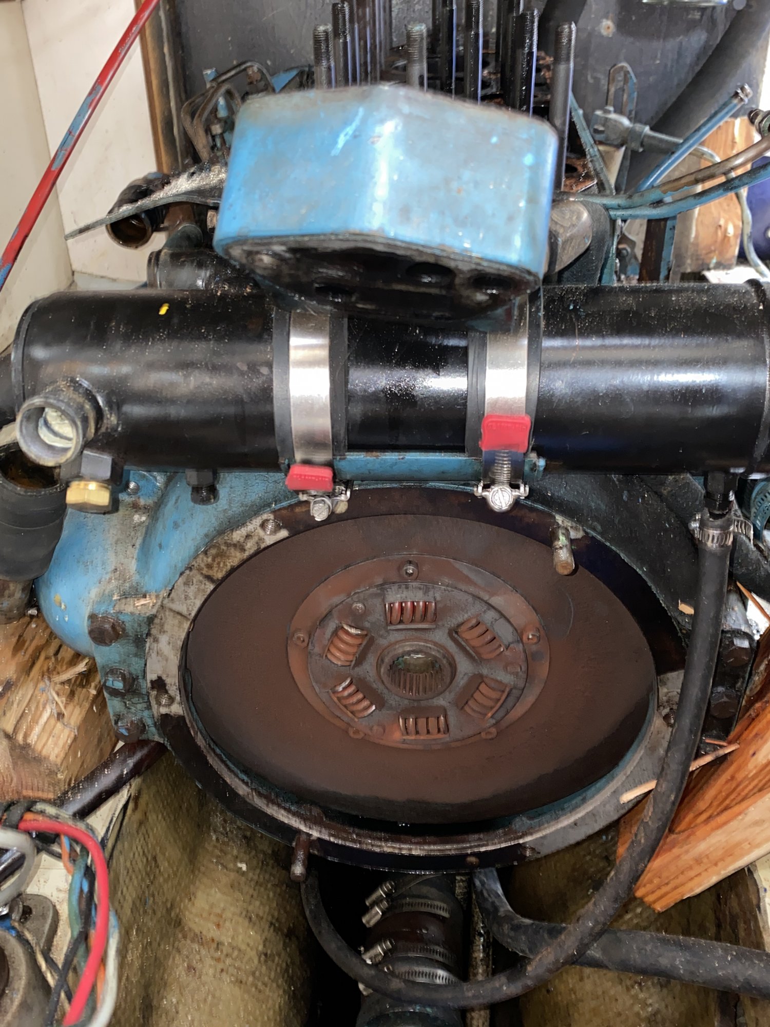

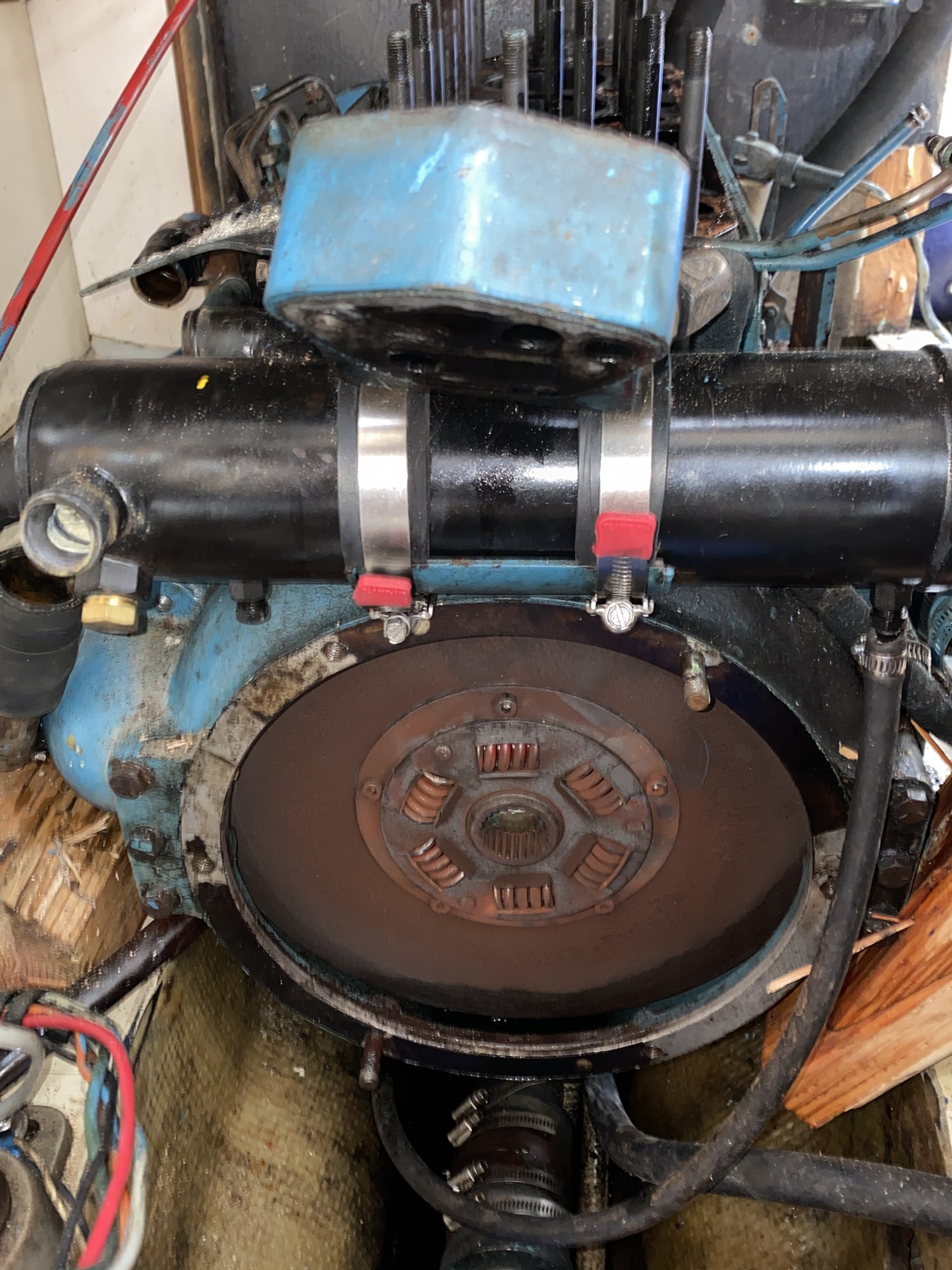

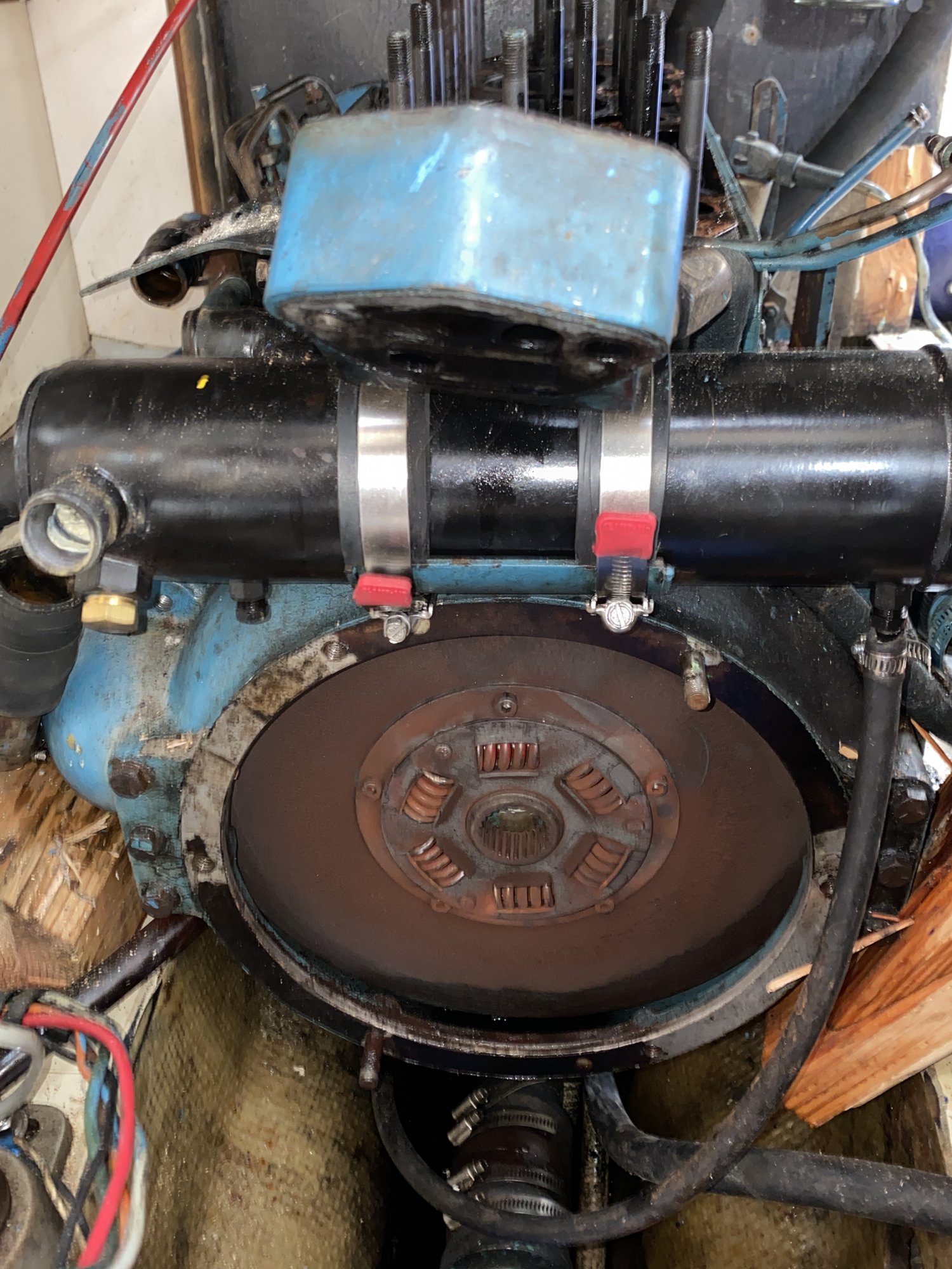

Here is a look at the transmission end - the damper plate.

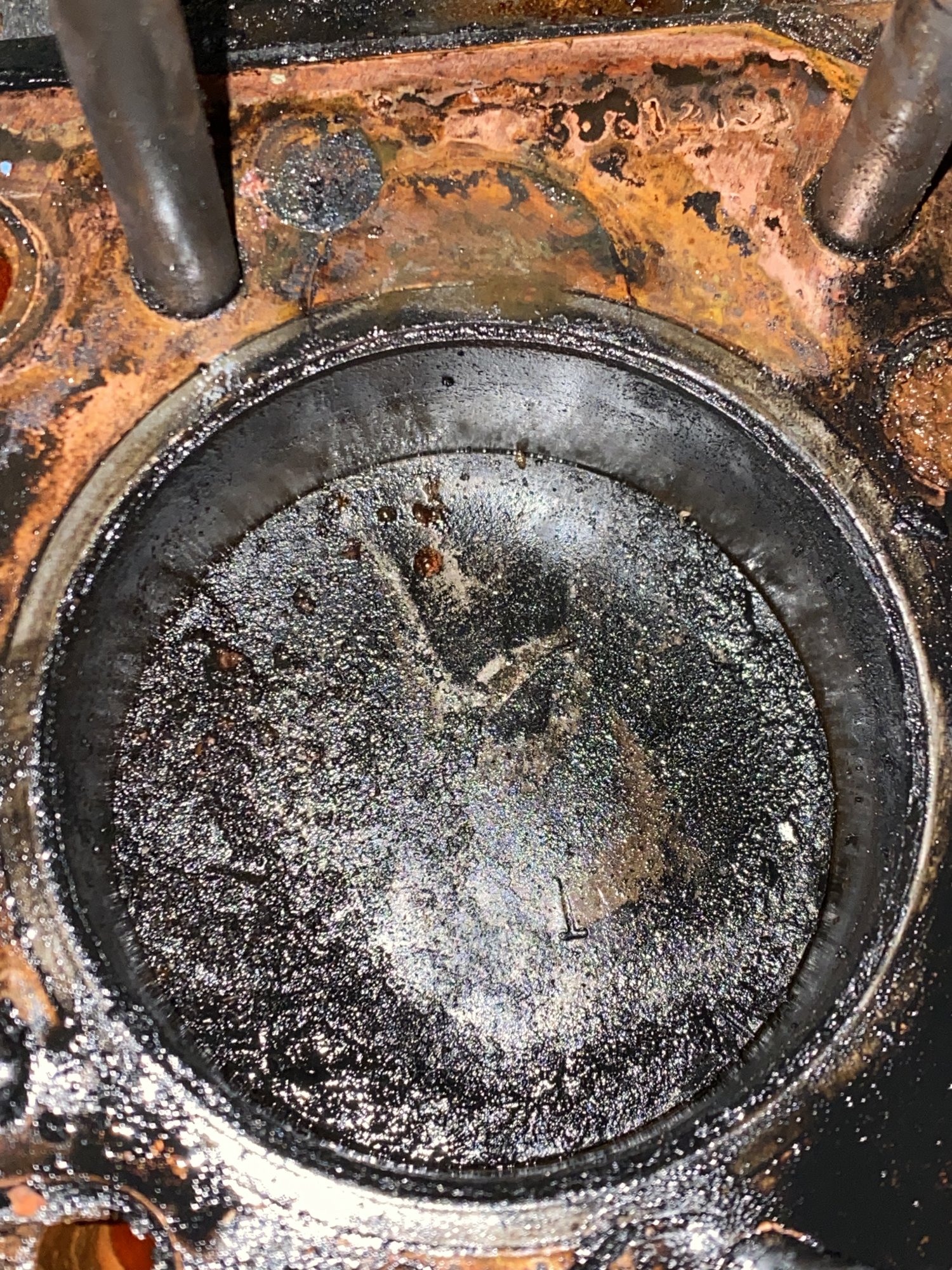

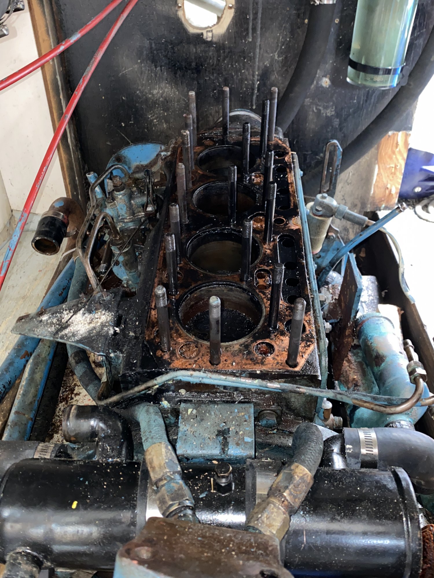

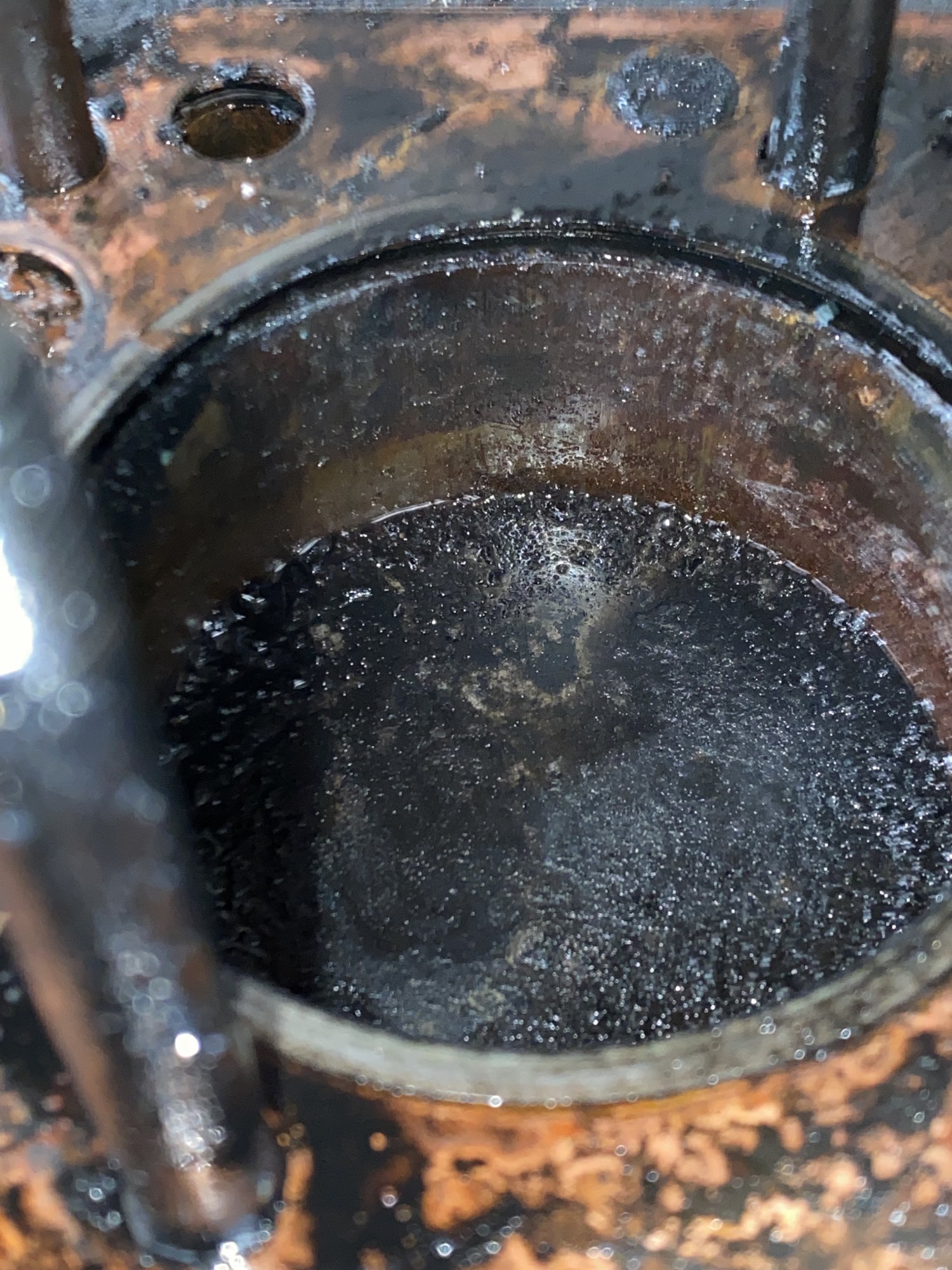

Looking into the block provided circumstantial evidence that there may have been water that entered cylinder 4 from the muffler.

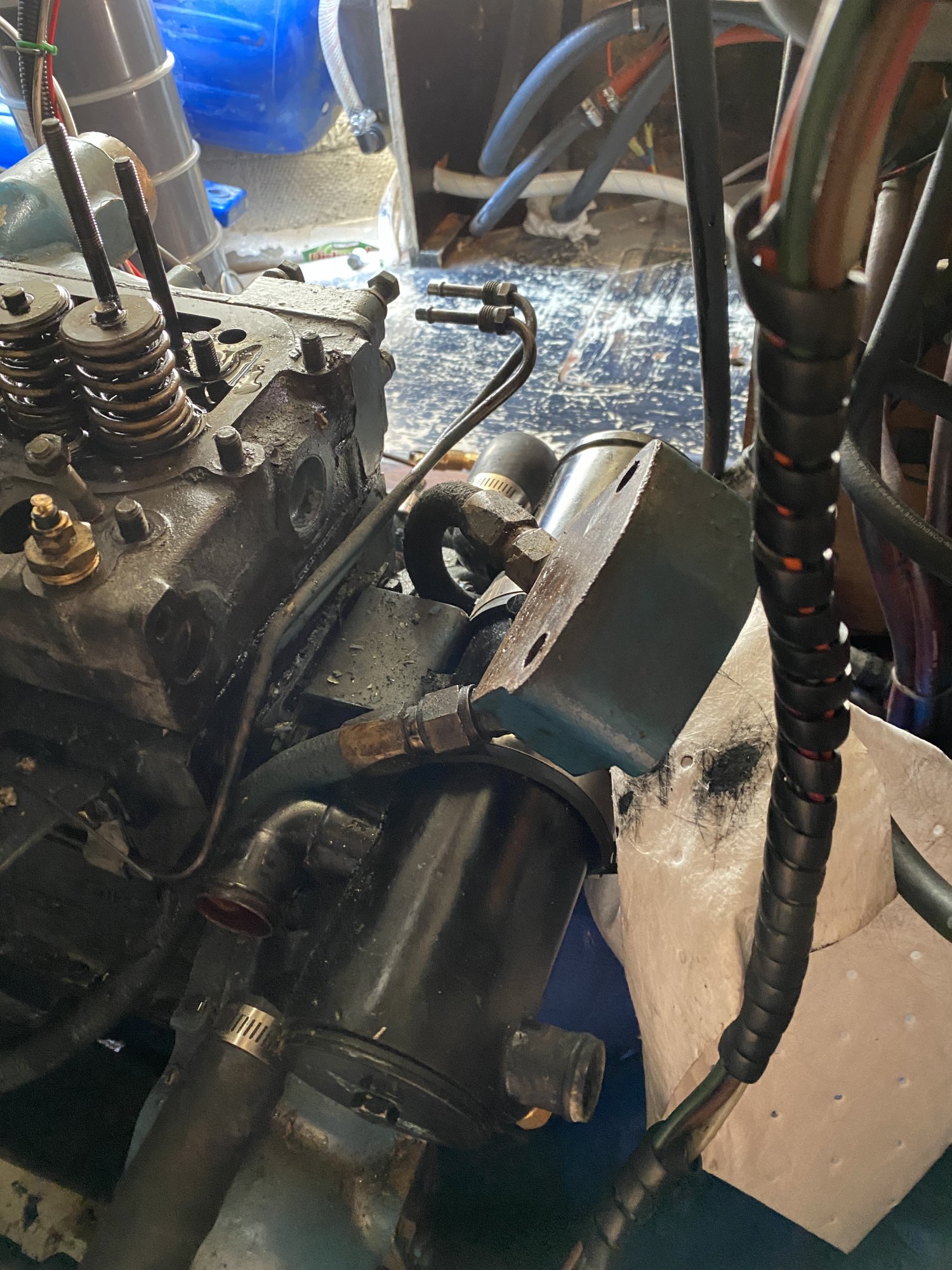

Some more images from the project.

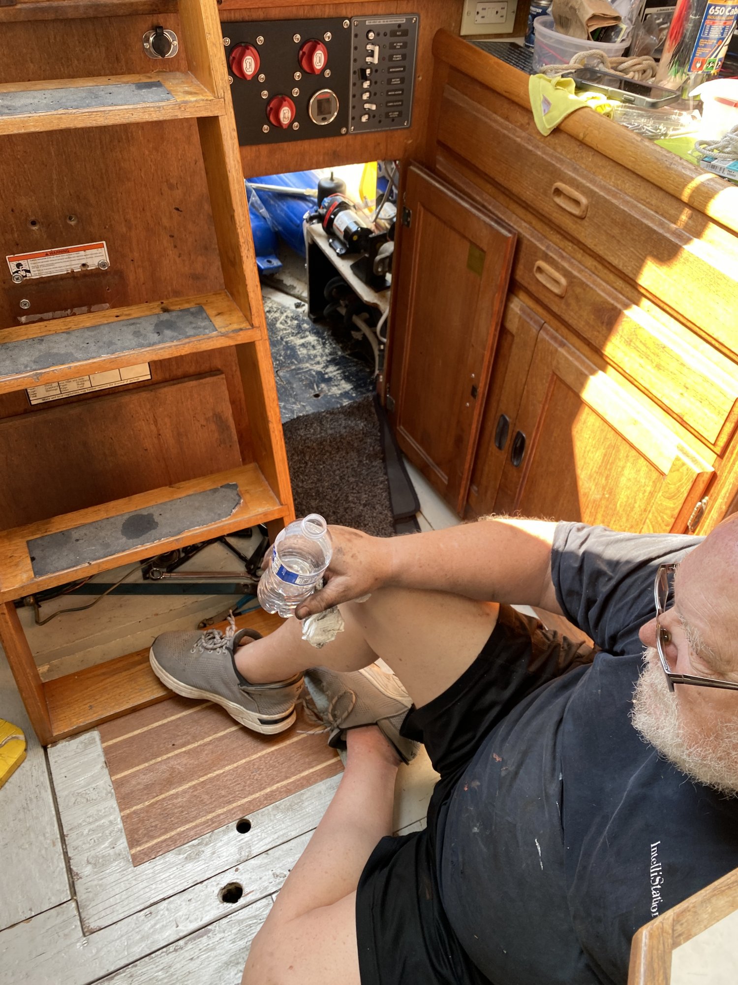

Cabin works space. The second picture you can see where we opened a hole in the bulkhead.

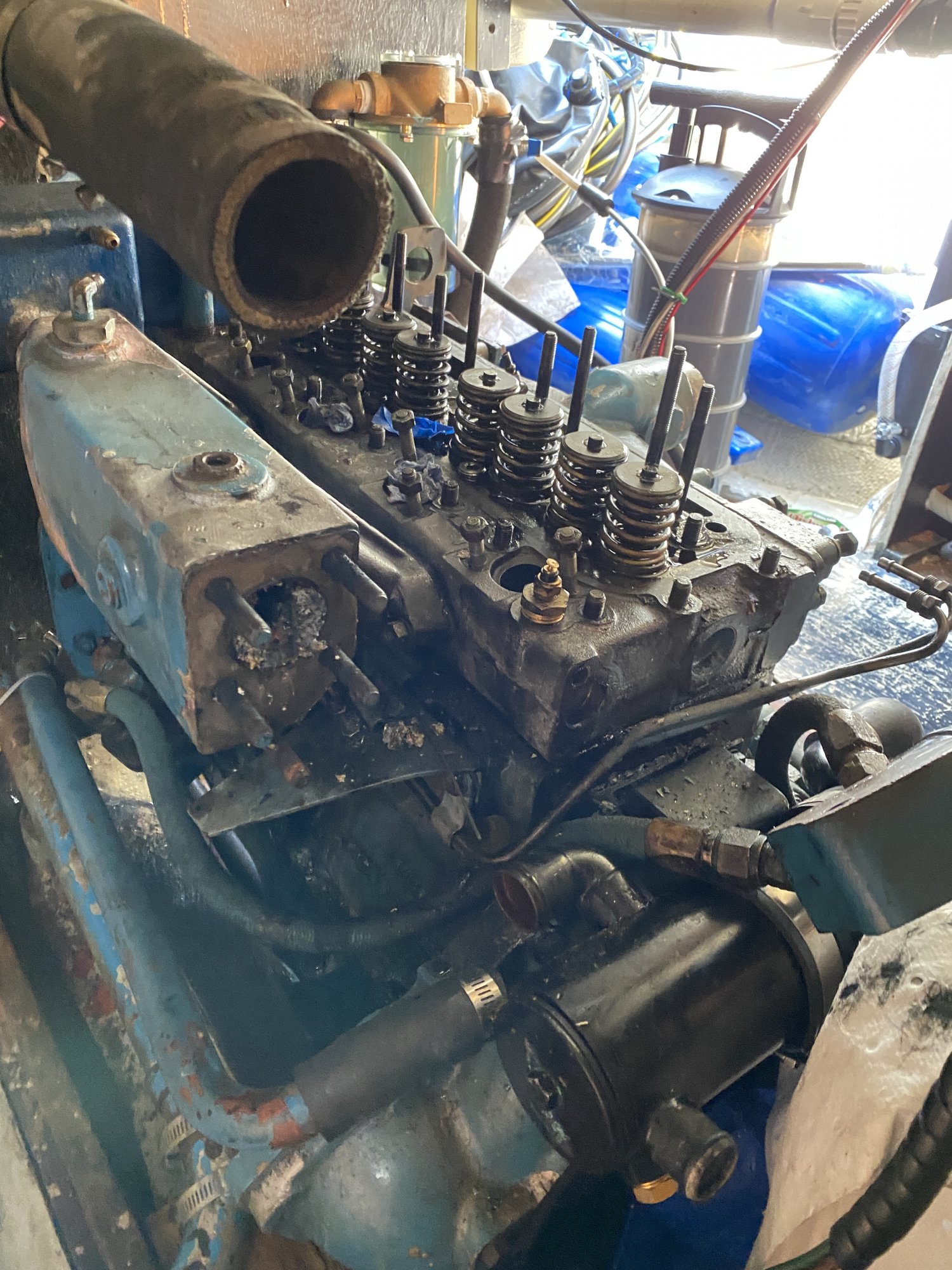

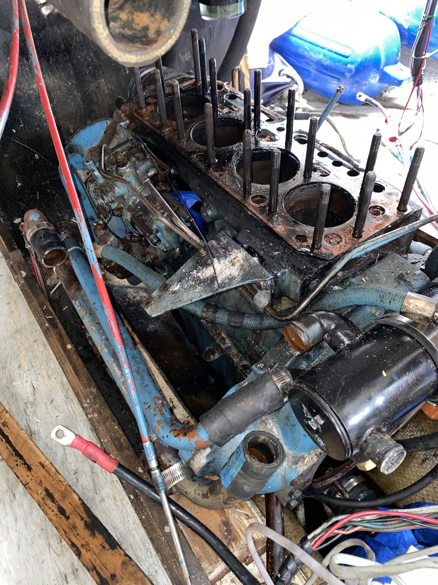

These shots show the engine being disassembled to get at just the head.

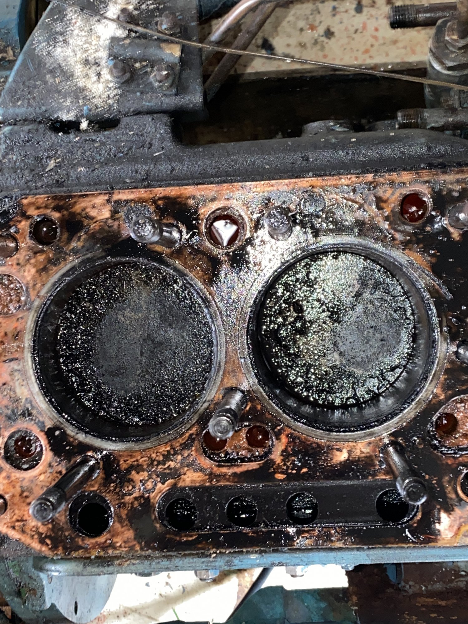

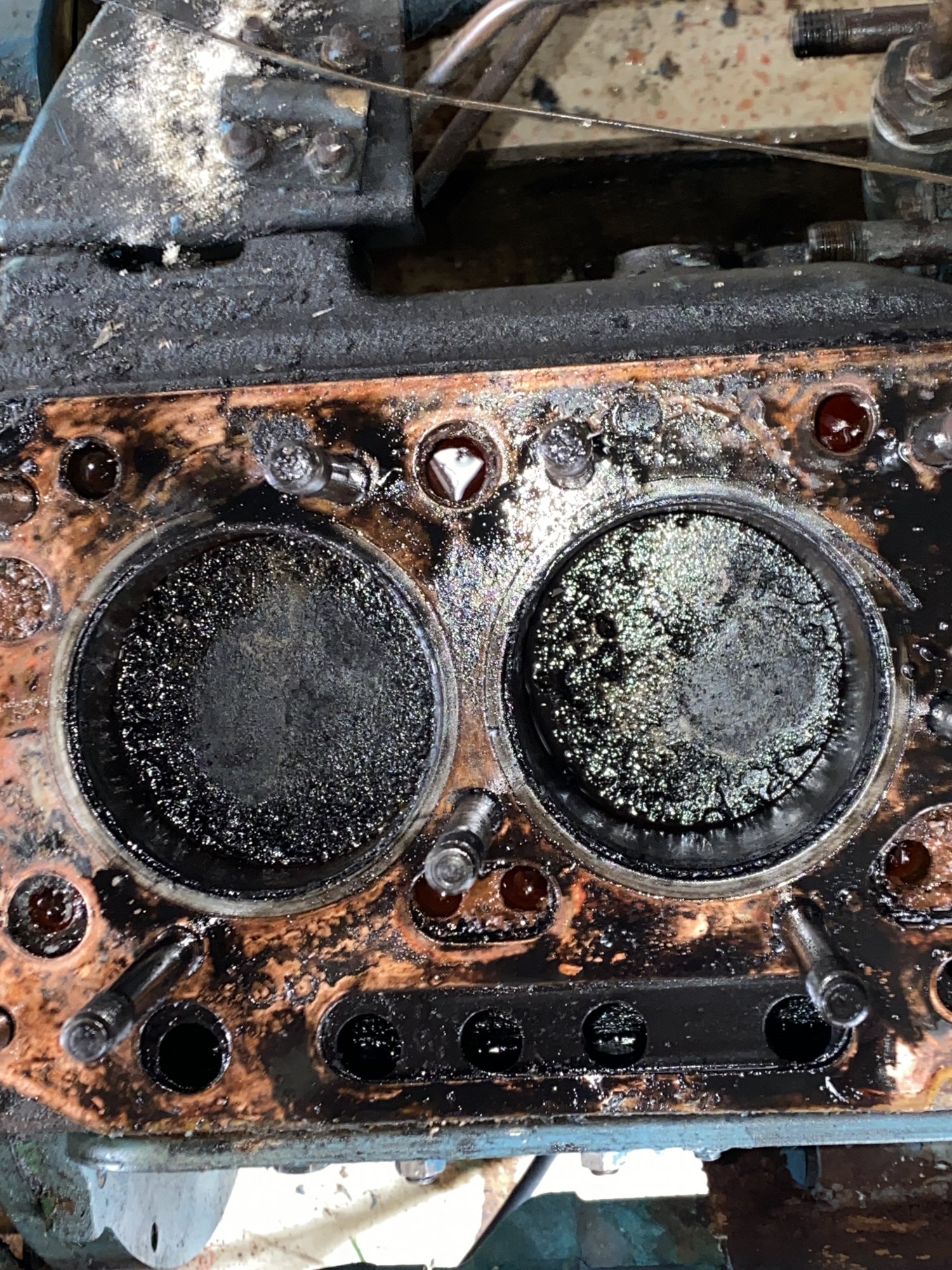

The exhaust shows some salt accumulated in the opening. The valves all look normal, to me.

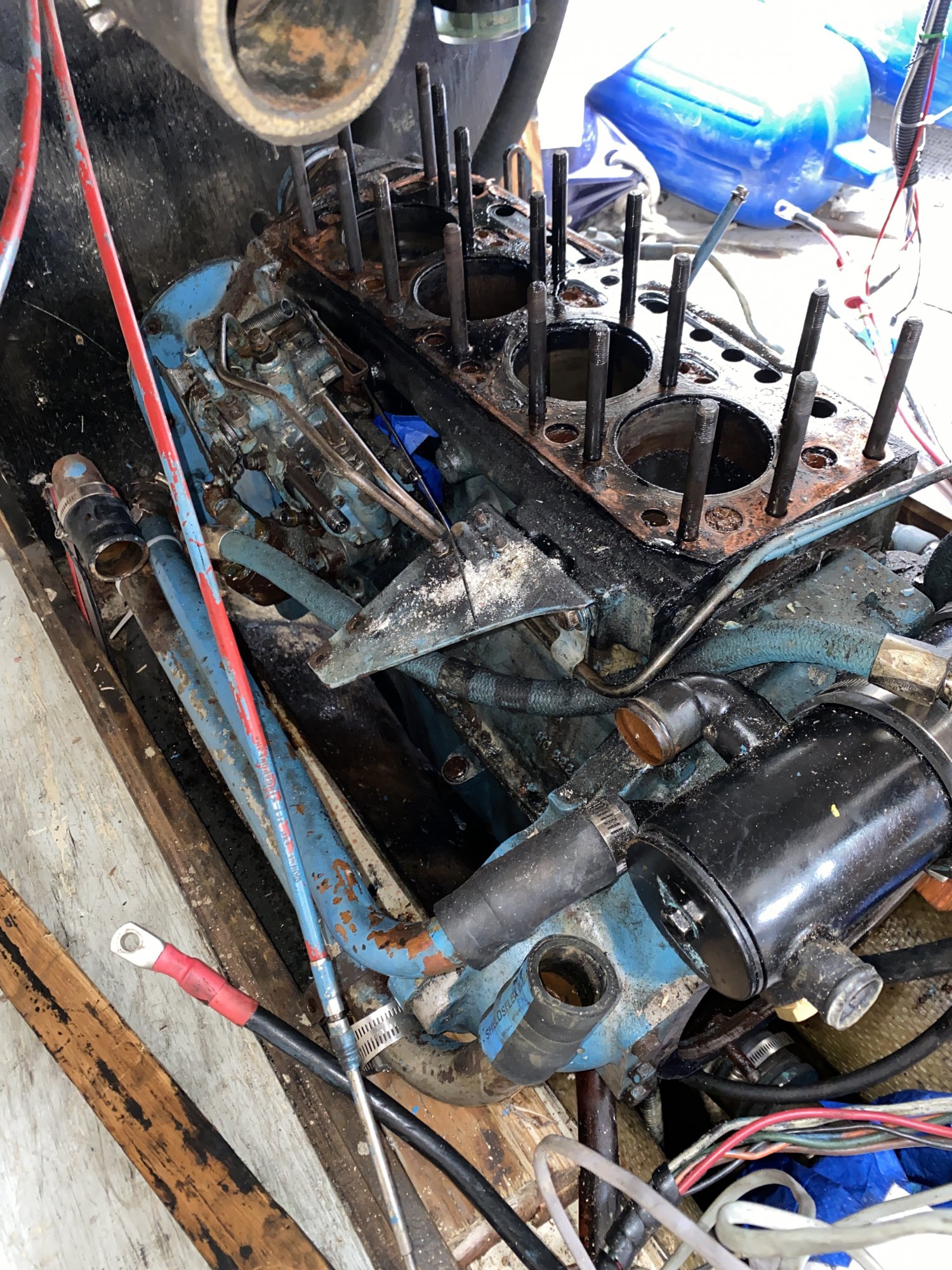

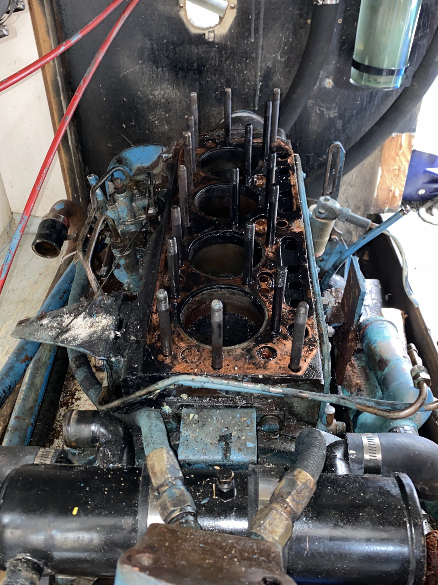

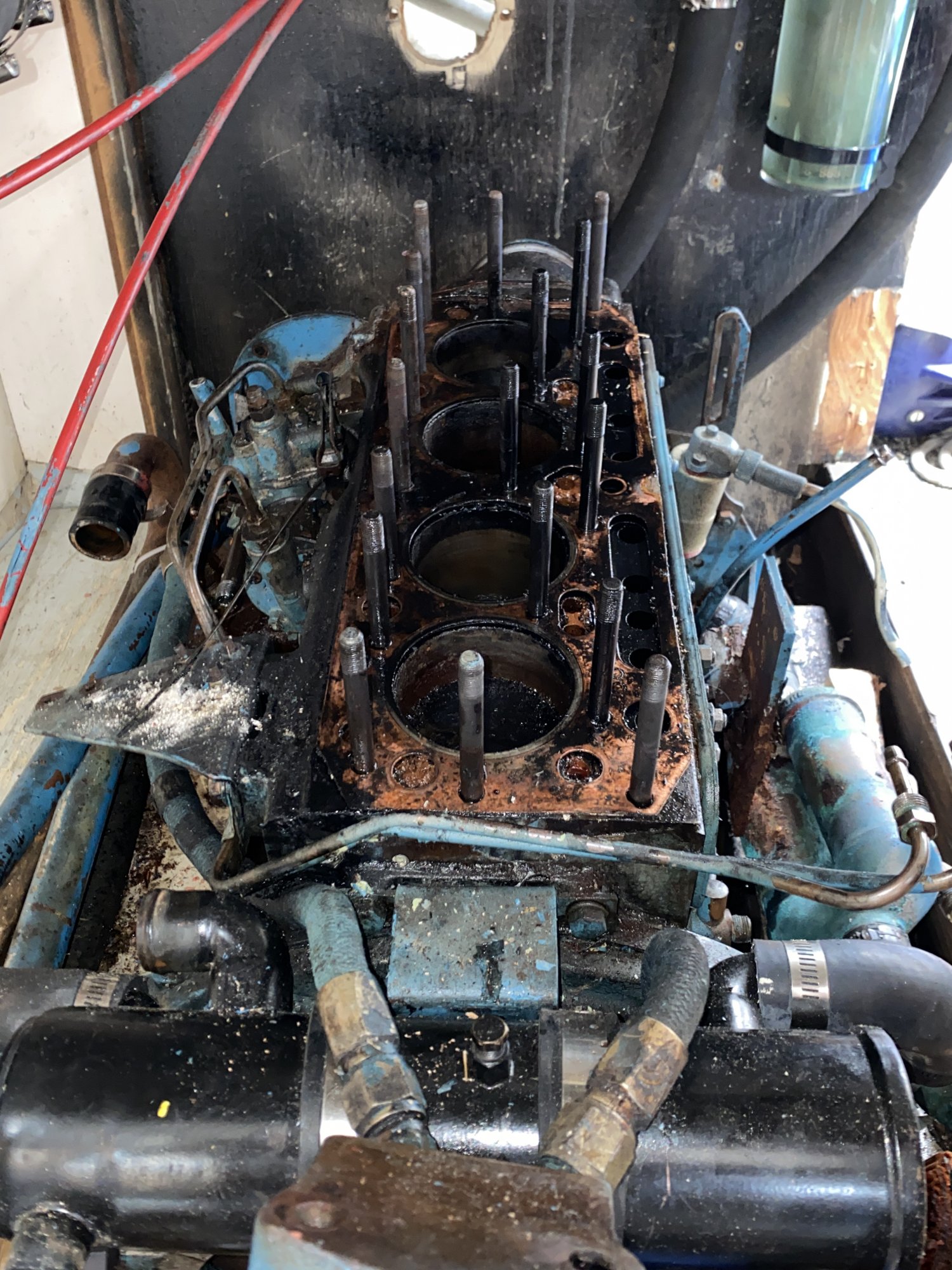

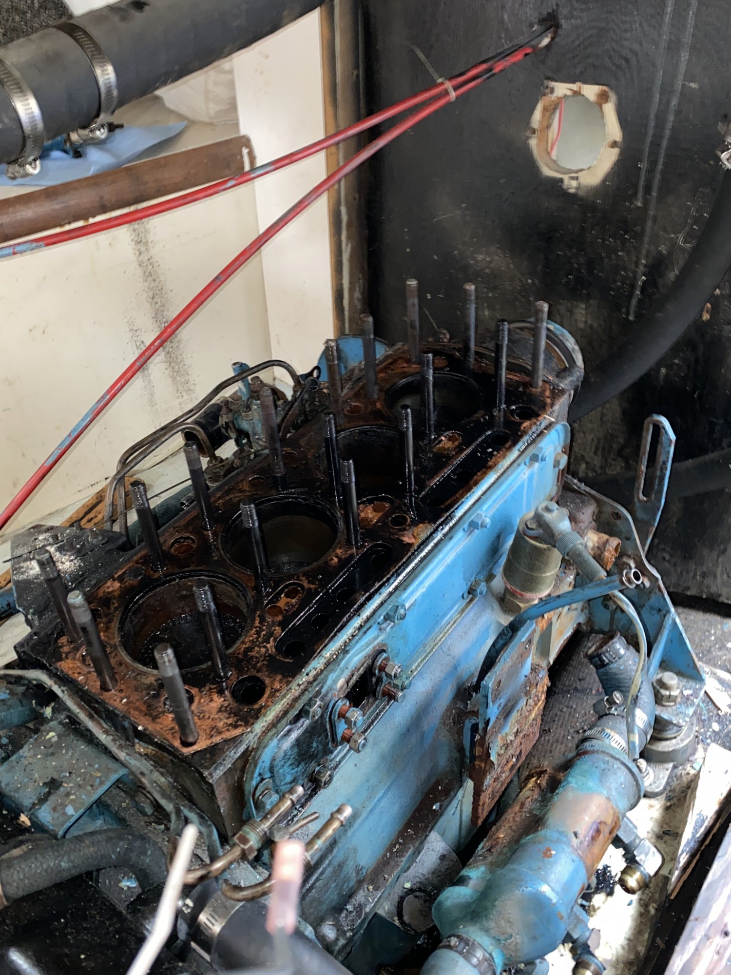

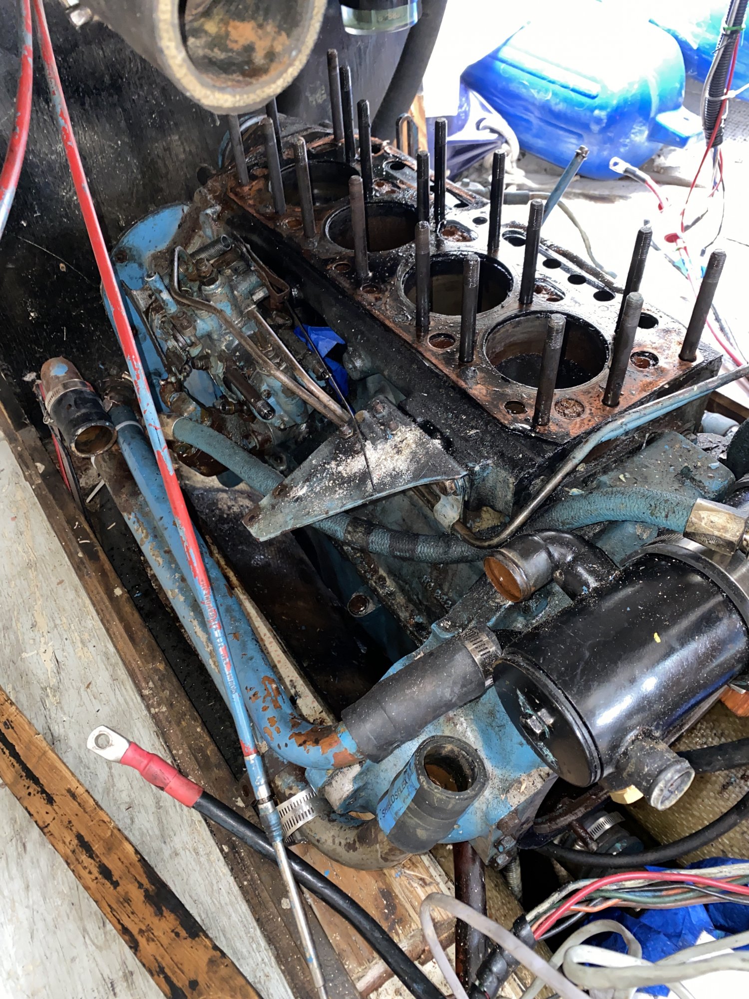

Here is an image looking down on the block just after we removed the head.
Feb 10, 2004
4,232
Hunter 40.5 Warwick, RI
So now that the head is off, is there any visual evidence of the cause of the lock-up? I presume that the crank still won't move; is that correct?

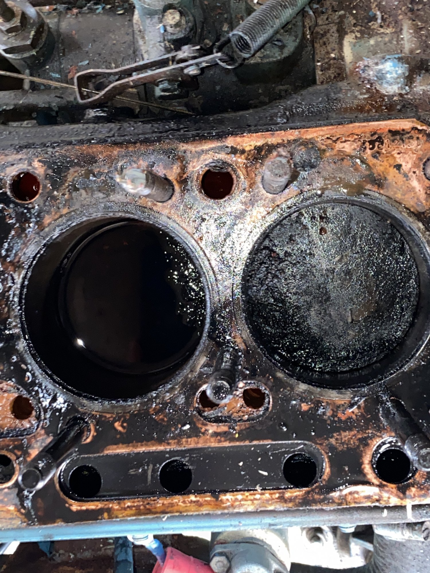

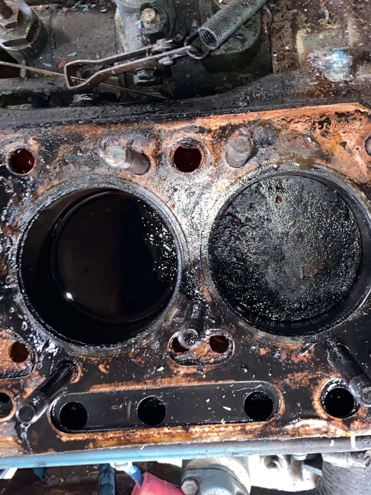

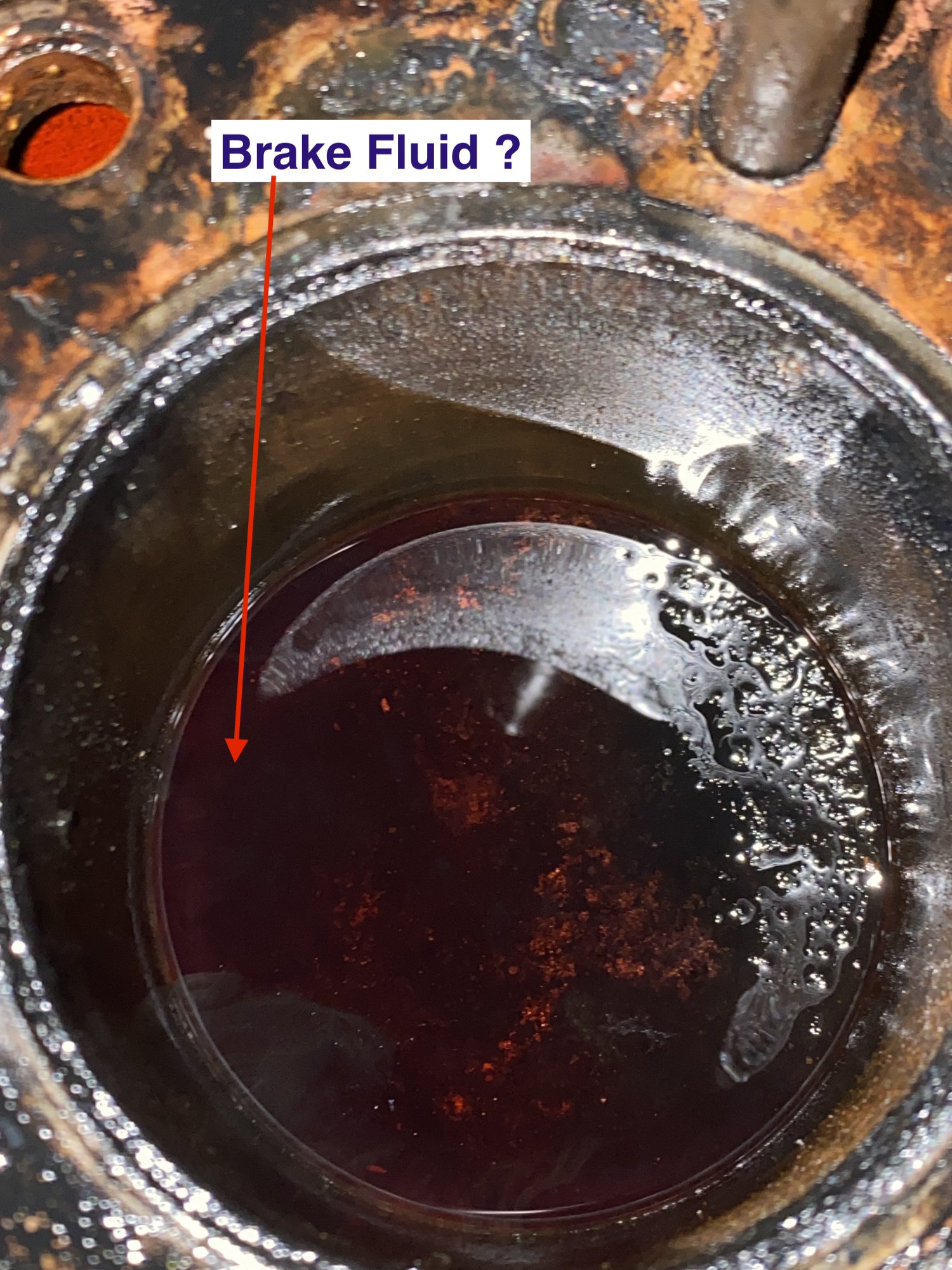

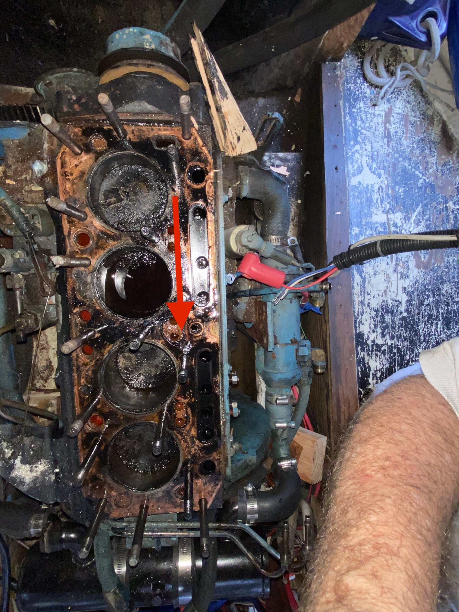

Playing detective a bit...
Note the one full piston and guessing the boat is listing by my Red Arrow direction.

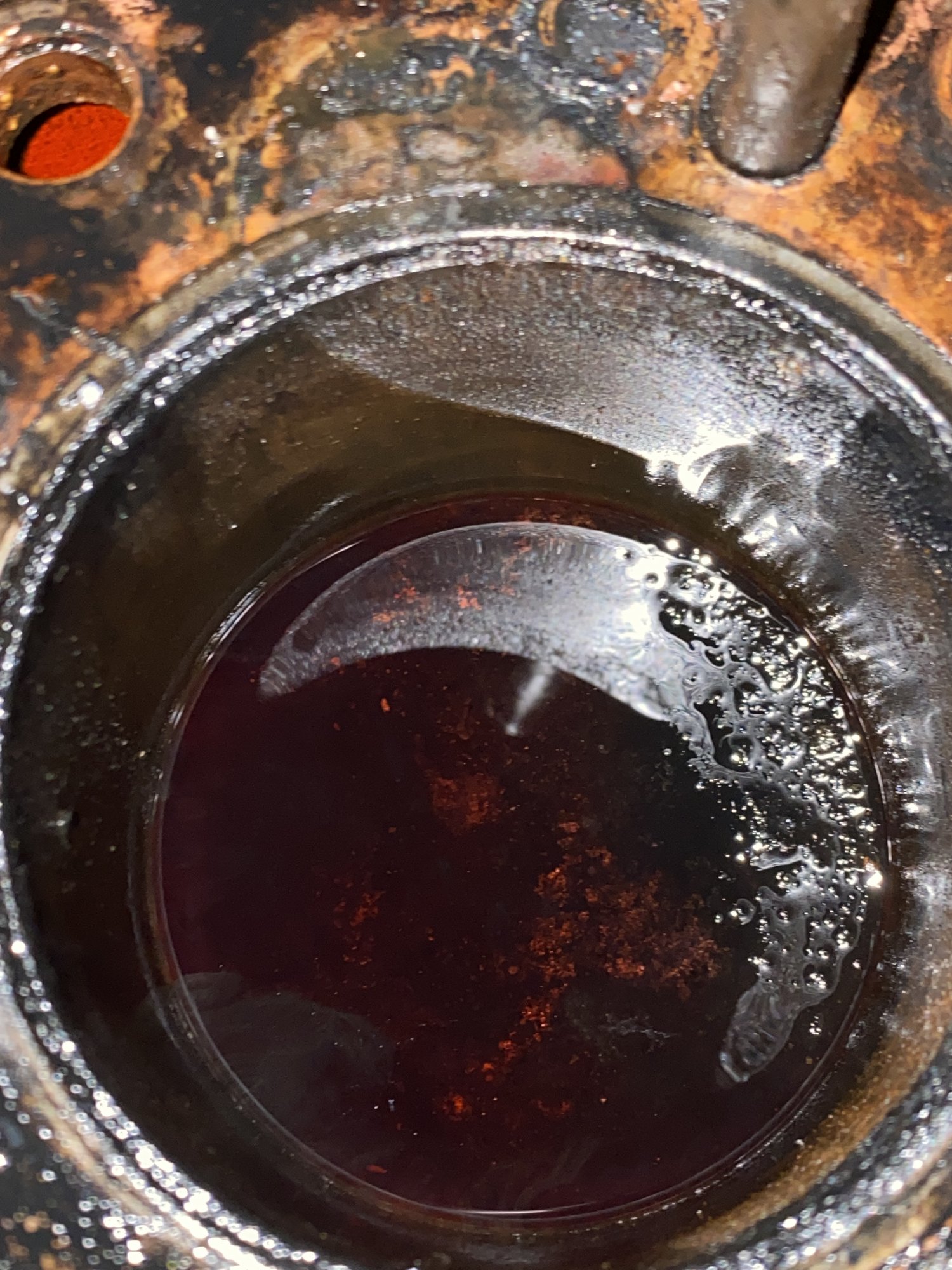

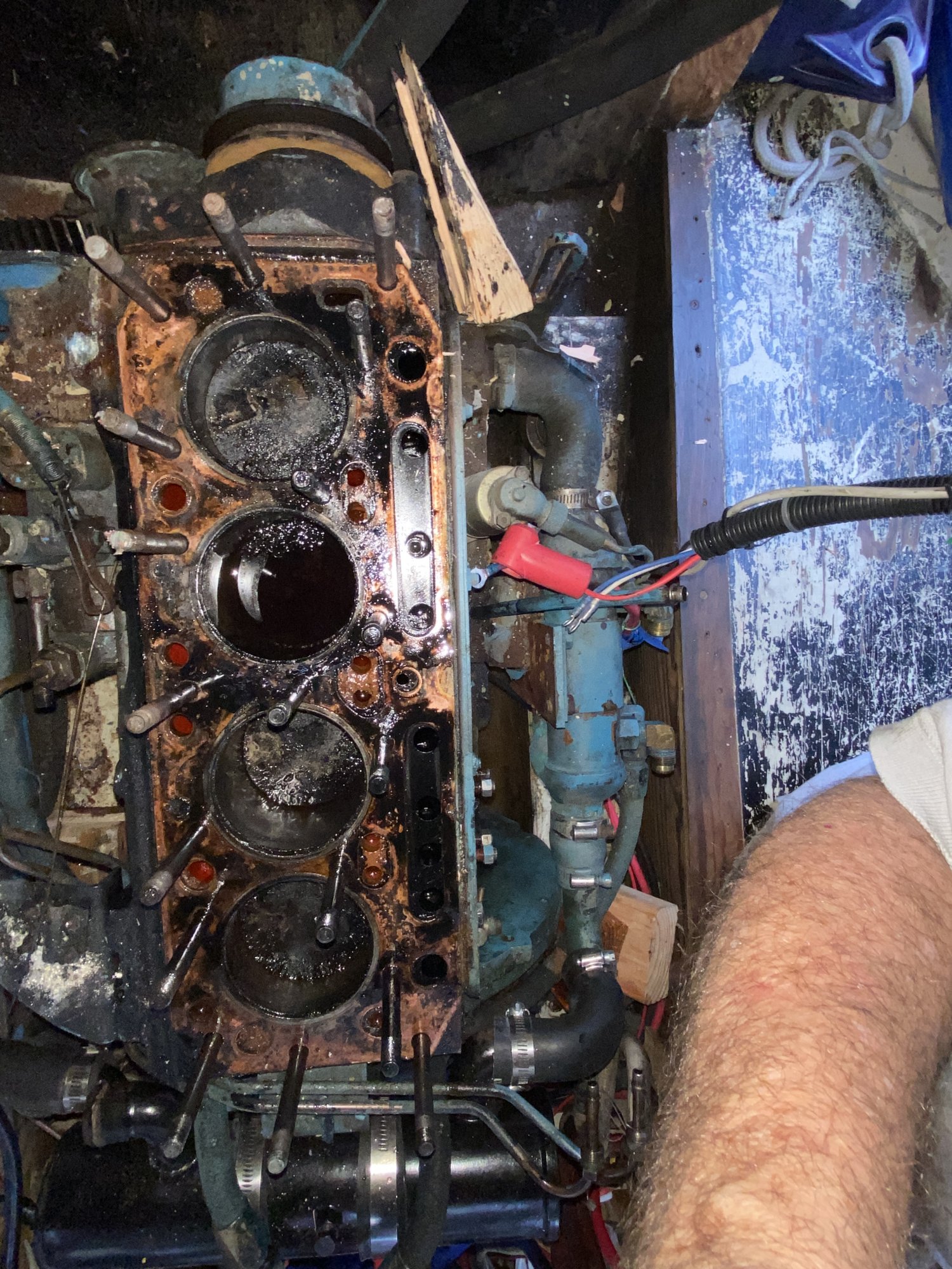

Closer view..
Is that the Brake Fluid you promised me to add?
Funny that one piston did NOT drain.:huh:
Jim...

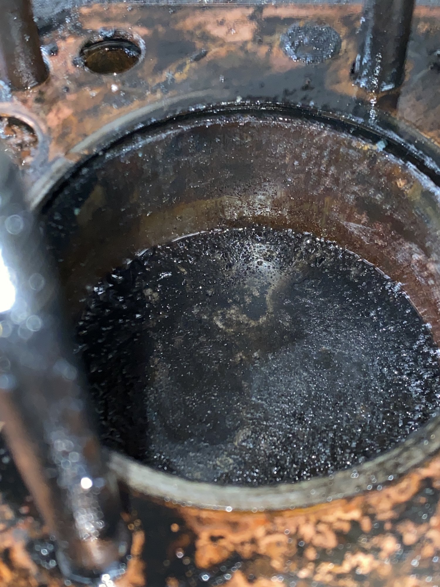

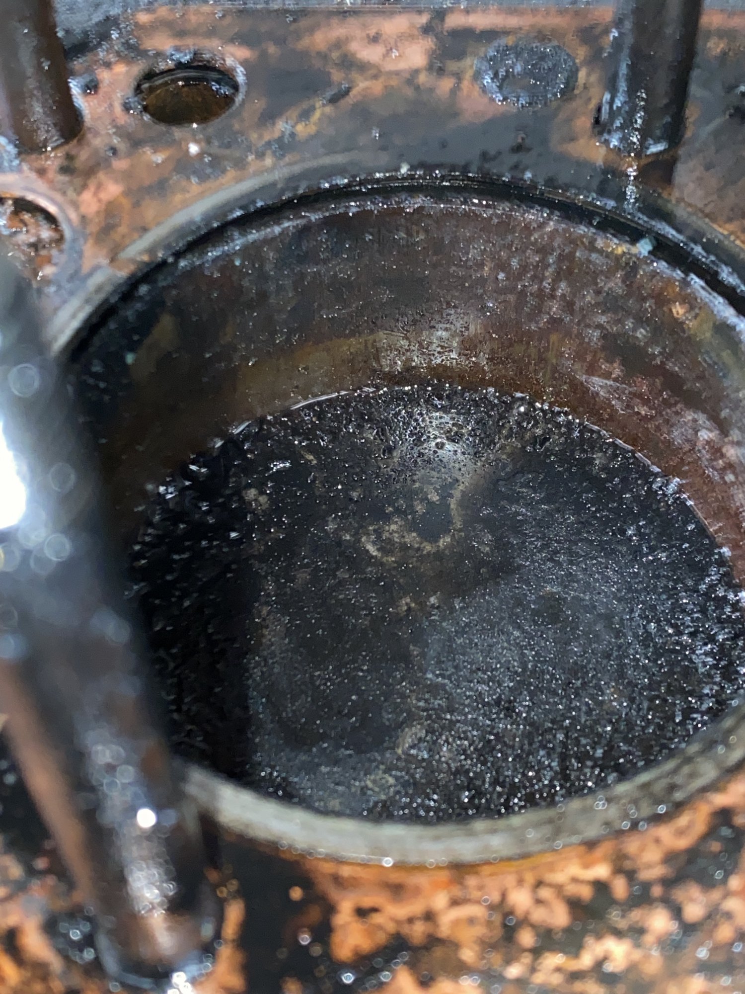

24,511
Looking at the image, pistons are numbered from top to bottom of image 1,2,3,4 front to back of engine.

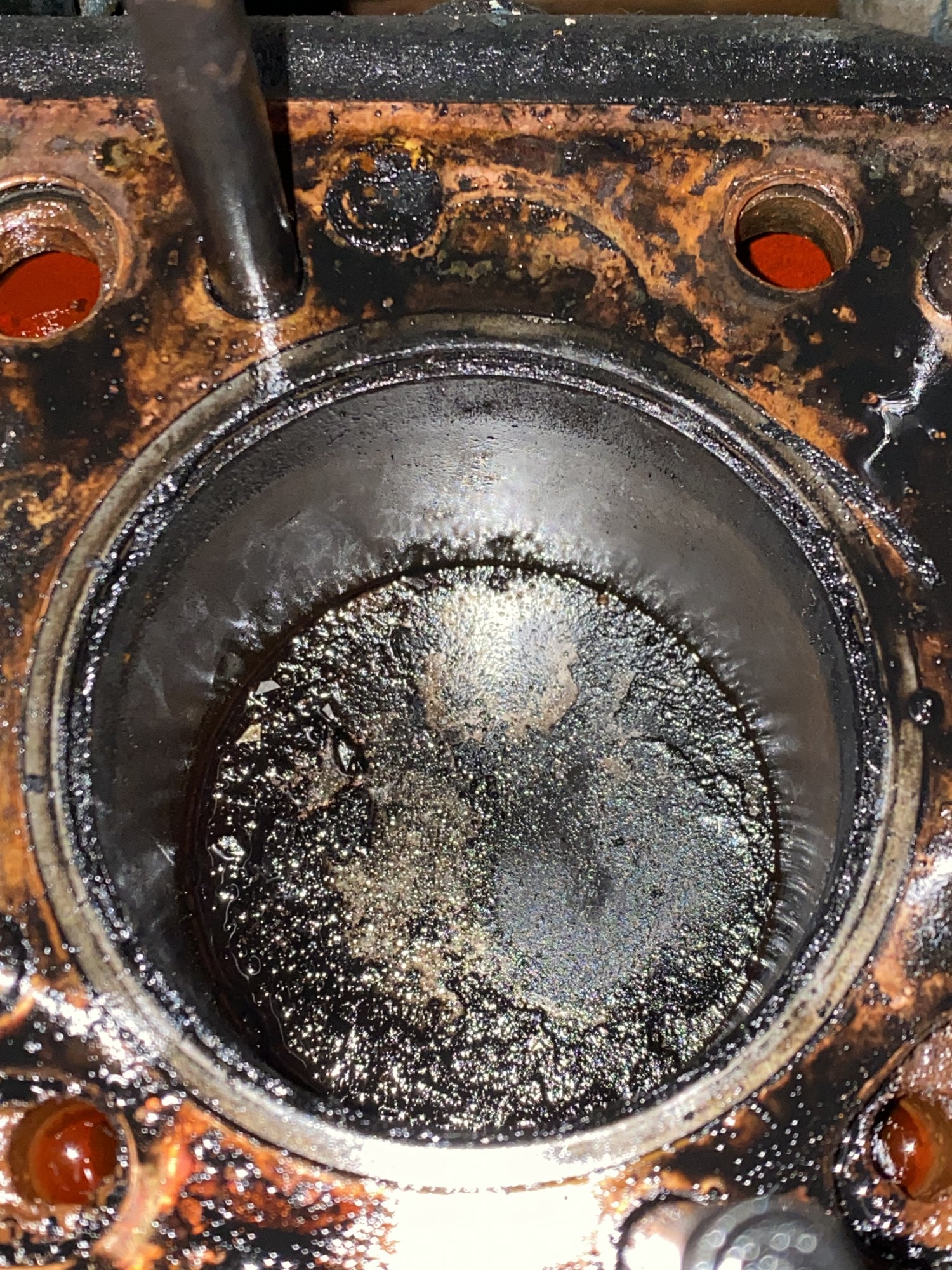

2, and 4 had the Marvel Mystery oil and brake fluid still In them. 1 & 3 drained. I used a oil pad to soak up the excess in 4. Then I could observe the rust on the side of the cylinder.
24,511
Nothing yet. Will know more tomorrow
Aug 19, 2021
511
Hunter 280 White House Cove Marina
What, if anything, did you conclude on the fact 2 Pistons did not drain?
Jim...
I would guess the rings on #1 and #3 are compressed are seized and no longer expand and contract to give a tight seal. Or the other way around the rings on #2 and #4 are seized in the expanded position. Not sure.
John I will buy you an adult beverage someday when we meet if you snap a picture of the valves, valve seat and the other side of the cylinder head.

Possible broken ring? Could cause the seizing too. Although if the engine turned over even a few times after the rings broke I'd expect to see scoring on the cylinder wall, which are not shown on the pictures. Also, kind of odd that it would occur simultaneously on two cylinders at the exact same time so probably not broken rings. Looked like a lot of carbon on the pistons which can lead to broken rings.
Did you notice any blow-by into the crankcase over the last few hours running?
Once you get the block out and the rebuild starts you should know for sure what caused the seized engine. Hope everything goes as planned on the rebuild and you are out on the water sooner, rather than later.
24,511
Will try to add additional photos later today.
Just want to assure those quisitive thinkers, that the engine seized during a controlled cranking. The engine was not running.
I cranked the engine using a starter button in the engine compartment to complete the bleeding of the high pressure pump. The injector fuel lines were loose and I was watching them as I pushed the starter to observe evidence of air bubbles and fuel.
A rotation occured, then everything stopped. Seized. The engine did not combust.

OOOFTA .. pinhole in exhaust manifold cooling jacket or in the mixing ell? I think the bores may hone out, but there is some pitting as you can see. Pistons are probably ok but may have broken ring lands.. bearings are probably OK but are cheap (er) to replace.
