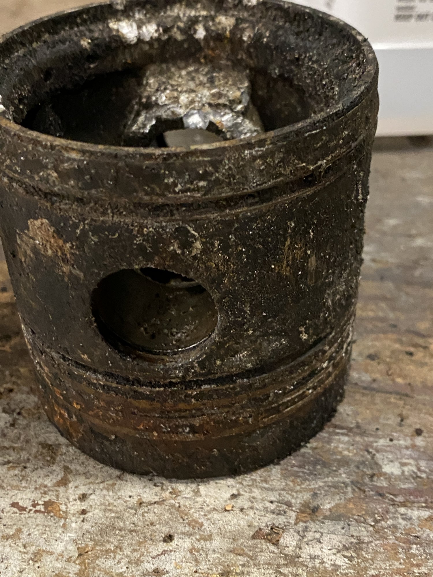

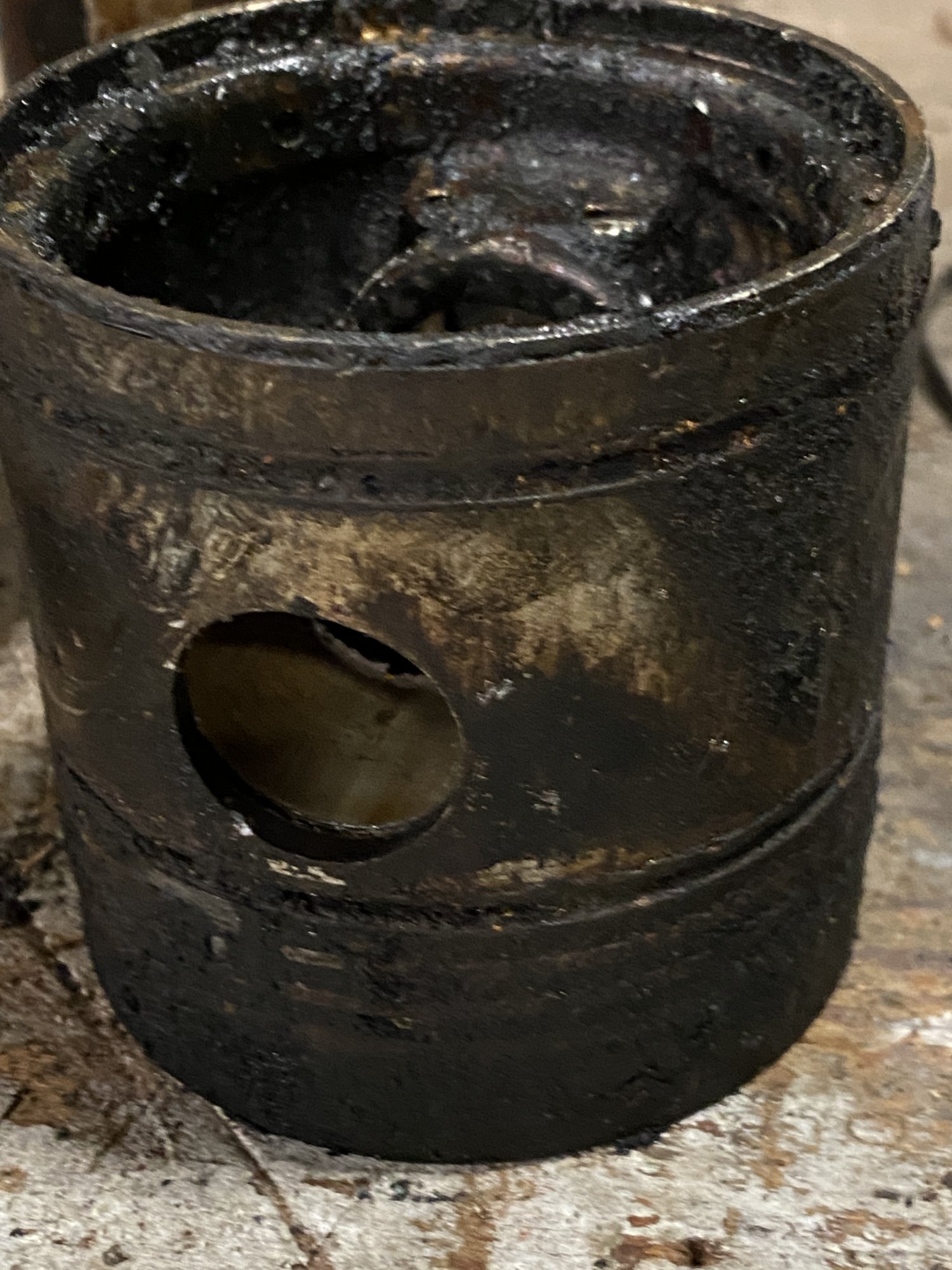

First a look at the old pistons. The bad ones.
:yikes: I wonder how they worked at all

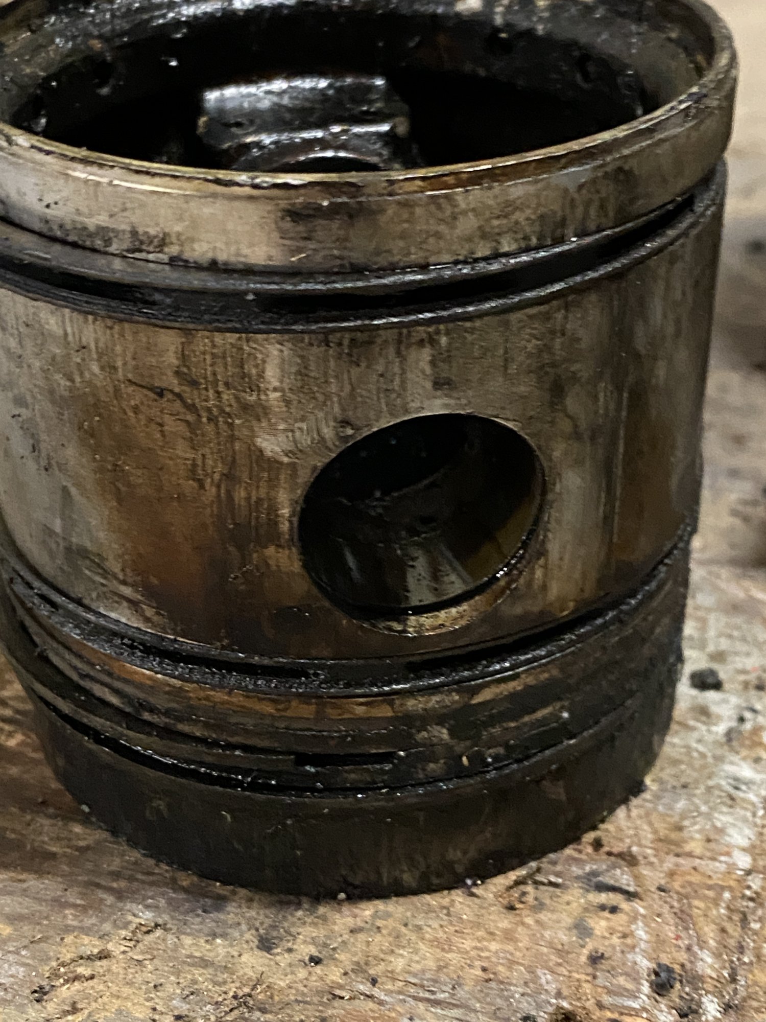

here is the best of the old ones.

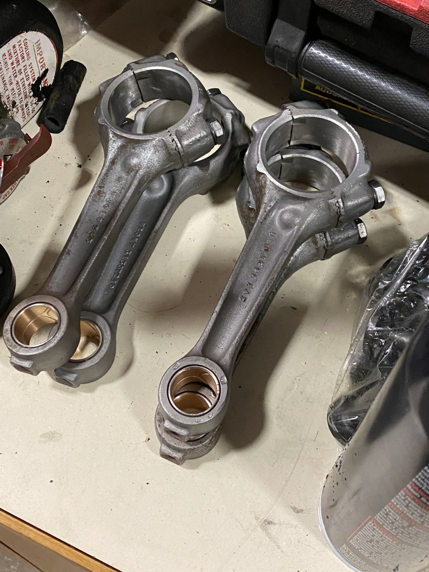

Here are the rods. New bearings and bushings

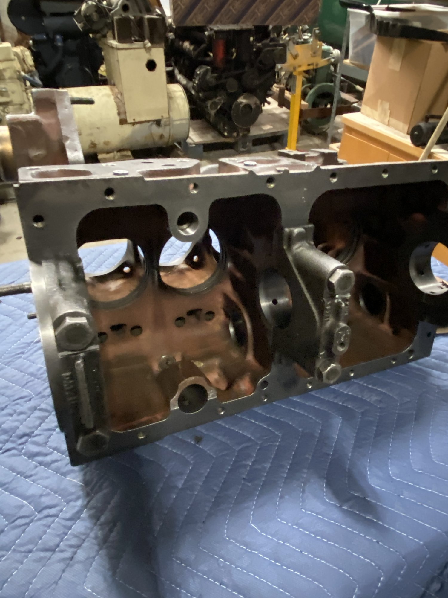

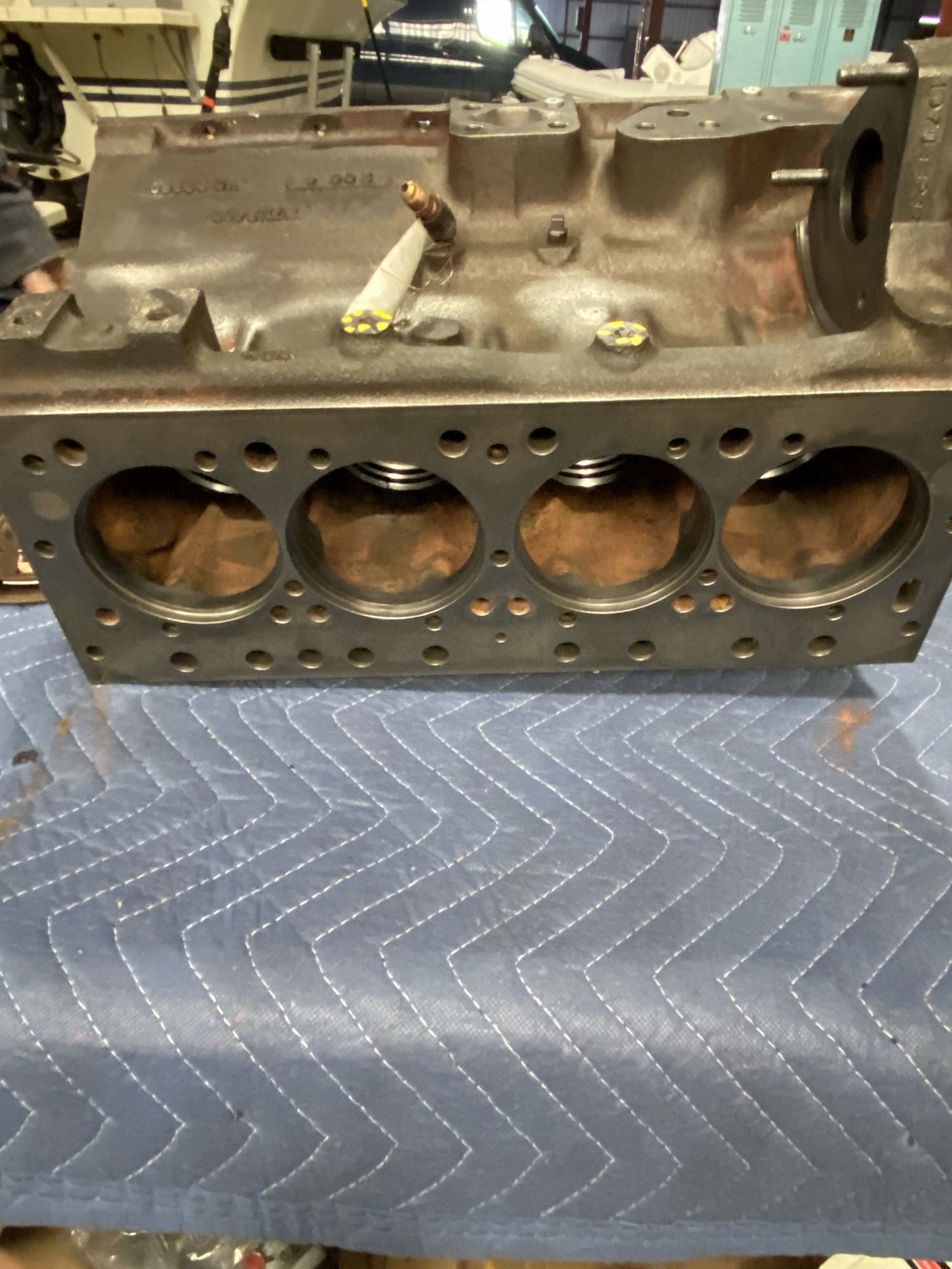

And the block

Those pistons sure look rough!
the cylinder walls were OK? Or did they have to sleeve them?

Yes we have new sleeves with O-rings to be pressed into the block.
