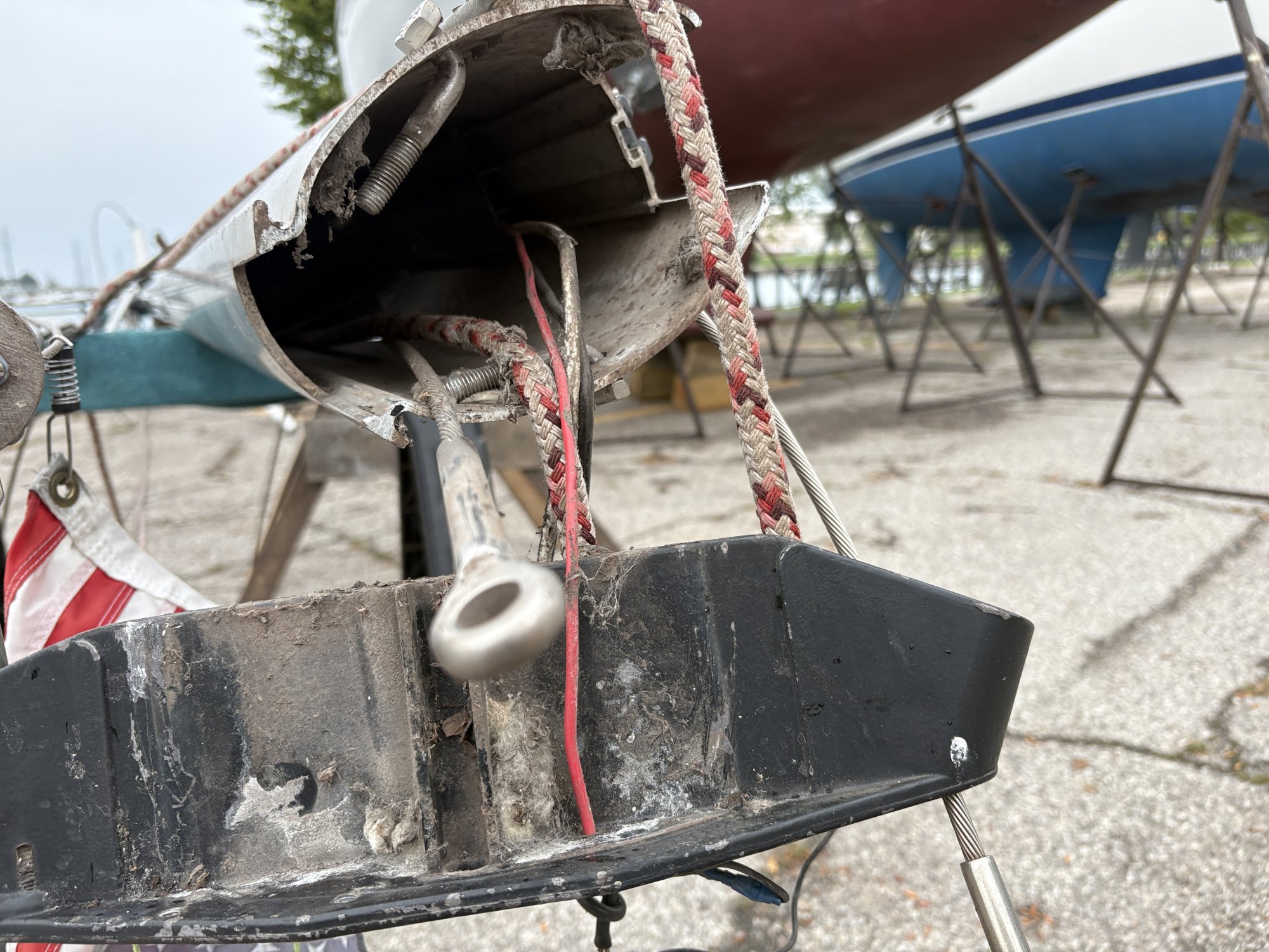

Was I lucky or what? Forestay failure!

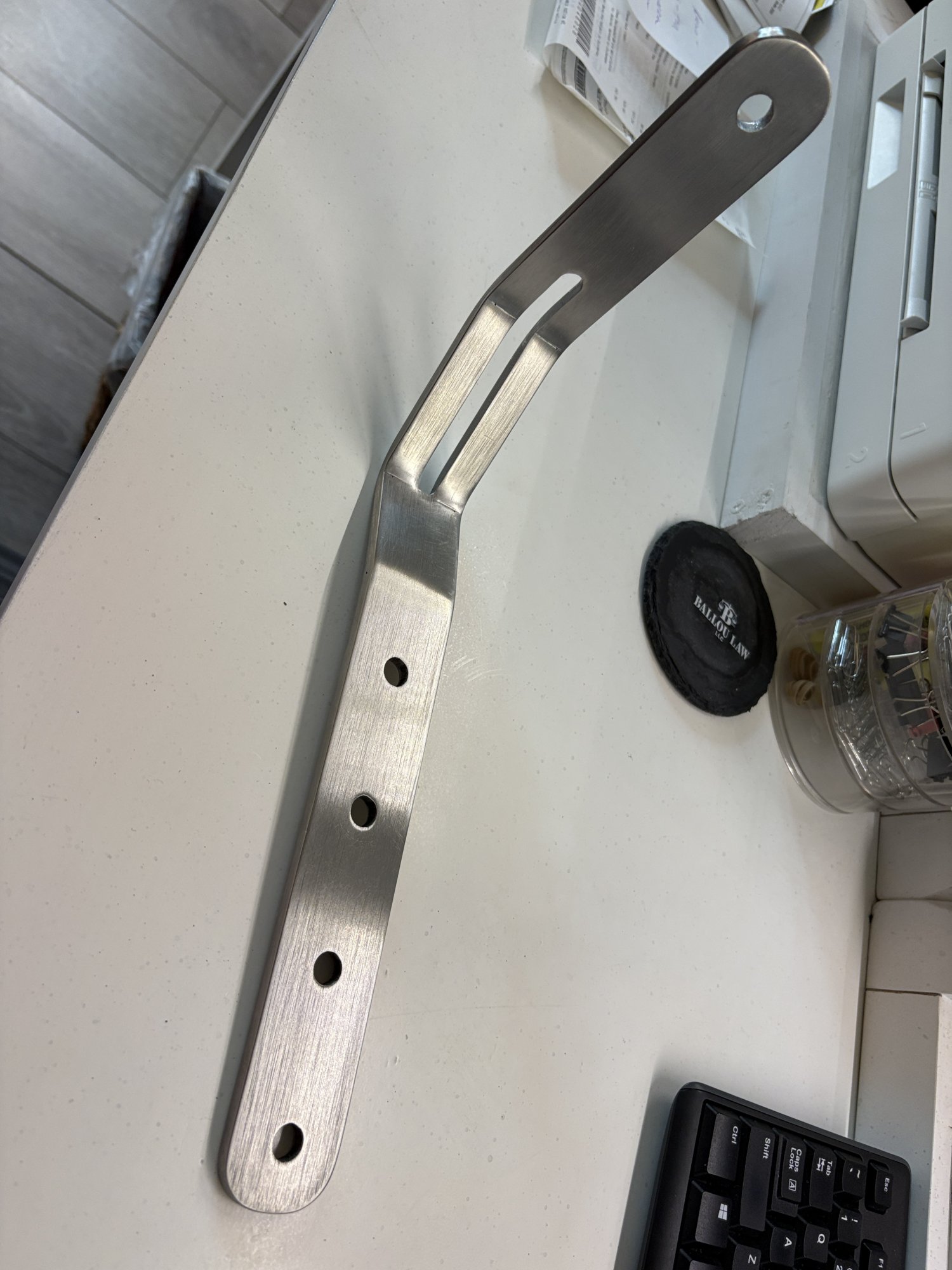

I put the new stem piece in today and it seems to fit perfectly. ...
Good on your fabricated. Out of curiosity did they bend the SS stock? Is there a concern about work hardening? When installing I have some question about torquing the strap down if it's not a passive fit?
They did bend it. I don’t know about work hardening, but there some tool marks at the bends. The old one looked very similar (same tool marks).
I am going to try to send the old parts to @dLj for analysis. Not sure how helpful it will be, but work getting a close up of the break.
But the old one lasted 38 years. I will be dead before it fails the next time ( well, I won’t be sailing anyway).
And now that I know this could be a weak point in the rigging, it will get inspected regularly.

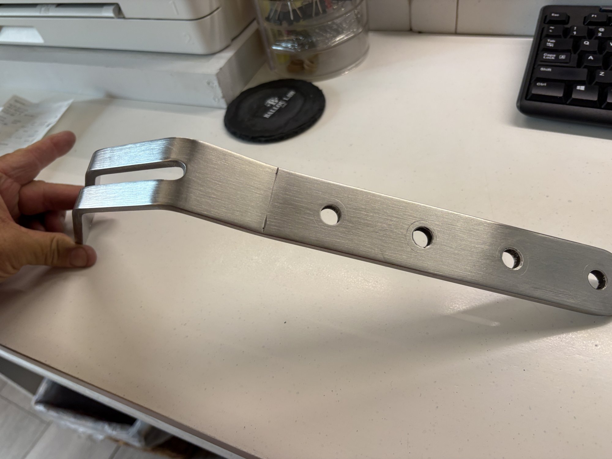

I look forward to getting the parts. I'll give a report back once I get them and see what the best way to manage this design moving forward may be.
The bending of the new part caused a crease along the tension side of the part - Greg sent me pictures. That bend should have been done using a radius mandrel. Apparently the old part has this same crease from original manufacture. Looks like it's the likely cause but I'll know more once I take a look at the actual part that broke.

Hope you (or someone) did a mirror polish on the new SS part.
Not at this point but Greg could still get it polished if he wants to. When I get the old parts I'll look to see what kind of finish the original had - that potentially could be another aspect of the breakage.

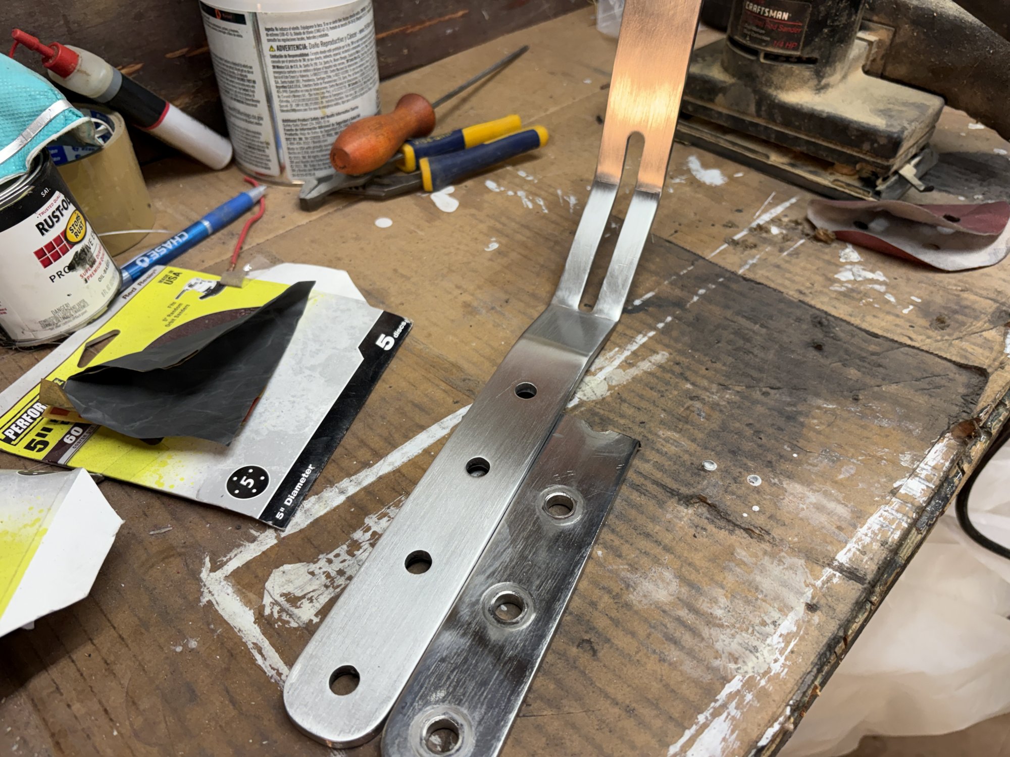

As an update, after getting some comments about the finish on my new bow chainplate, I took it back off the boat this morning to try and polish it up some. I have not found a local company that does polishing, and I have a very limited time to get the thing put back together...
So, in my basement workshop, I did the best I could with it... I will say that it is much easier on the hands, you cannot "feel" the mill finish, and the edges are less sharp than they were. It is certainly not a mirror finish, but I hope it is better than the original "mill finish" that it had when I picked it up. It makes me feel better knowing it is smoother, even if not polished to a mirror finish. If I can find someone to polish it in the next week, I will try to get it done... otherwise, this is as good as it gets.

You might see if a shop can dip the part and passivate it.
I did that after polishing my chain plates.
dLj
Mar 23, 2017
5,255
I had to lookup passivation. This is what I found: Citric Acid Passivation of Stainless Steel
One can buy citric acid powder from a home brew and wine making supply, it may even be on the shelves at WalMart. It sounds easy to do yourself, with minimal skill and time.
-Will
@Will Gilmore that is an excellent article on using citric acid passivation. I actually carry Citrisurf 2210 on my boat. It's a gel rather than an immersion liquido so I can apply it on parts on my boat while being on the boat. For example I've passivated my lifeline stauntions on the boat without having to remove them. If I buy stainless hardware, I'll passivate them before using them.
Citrisurf is an excellent product. I think you can buy it in Amazon. But buying an inexpensive citric acid as you've suggested would work just fine - that article was written more for production type environments. A number of the cautions are aimed more for continuos use baths.
You do have to be sure the parts are very clean before putting them into whatever citric acid bath you are going to use. And you them do not touch them with your hands to put in the bath. Finger prints don't go away in the bath...
dj
24,925
My rationale for utilizing the machine shop? They were already engaged in another project. They had the chemicals, temp controlled tank, and said sure will dip your parts, no problem. Convenience.

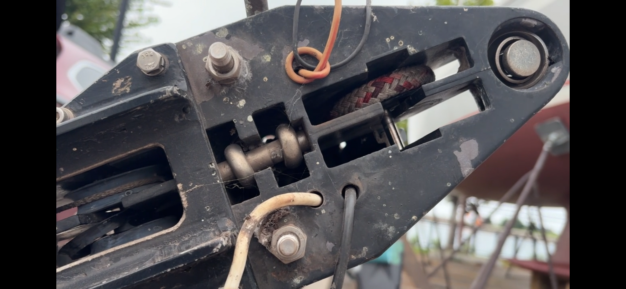

Hauled Tally Ho yesterday, then lowered the mast down to some horses on the ground.
Started determining how the shrouds and stays are connected to the mast. Removed the masthead and confirmed 3 broken sheaves, was able to remove the shroud pin that attaches the 2 shrouds to the mast and got the shrouds loose. Removed one spreader to free the shroud and to remove the pins for the 2 lower shrouds.
A very interesting jigsaw puzzle!
I have the STB shrouds off, coiled and labeled. Will work on the Port side on Friday and will try to get the old furler off so I can get the forestay off. Back stay has a ball stem fitting and should be easy to pull.
I also need to re-install the bow chainplate. Interestingly, I spoke with Bay Sailing Equipment yesterday about new rigging. My inquiry to Rudy at DR Marine came back that DR could not help with the 322 rigging, but that Bay Sailing Equipment provided the rigging for the 322. When I spoke with Dennis at Bay Sailing and explained the chainplate failure, he surmised that the original design had been modified. I sent him some photos of the failure. And will follow up on what the original design looked like.
While I could just have a rigger come out and measure and install the new rigging, I am a bit of a DIYer and enjoy seeing and understanding how this all ties together.
