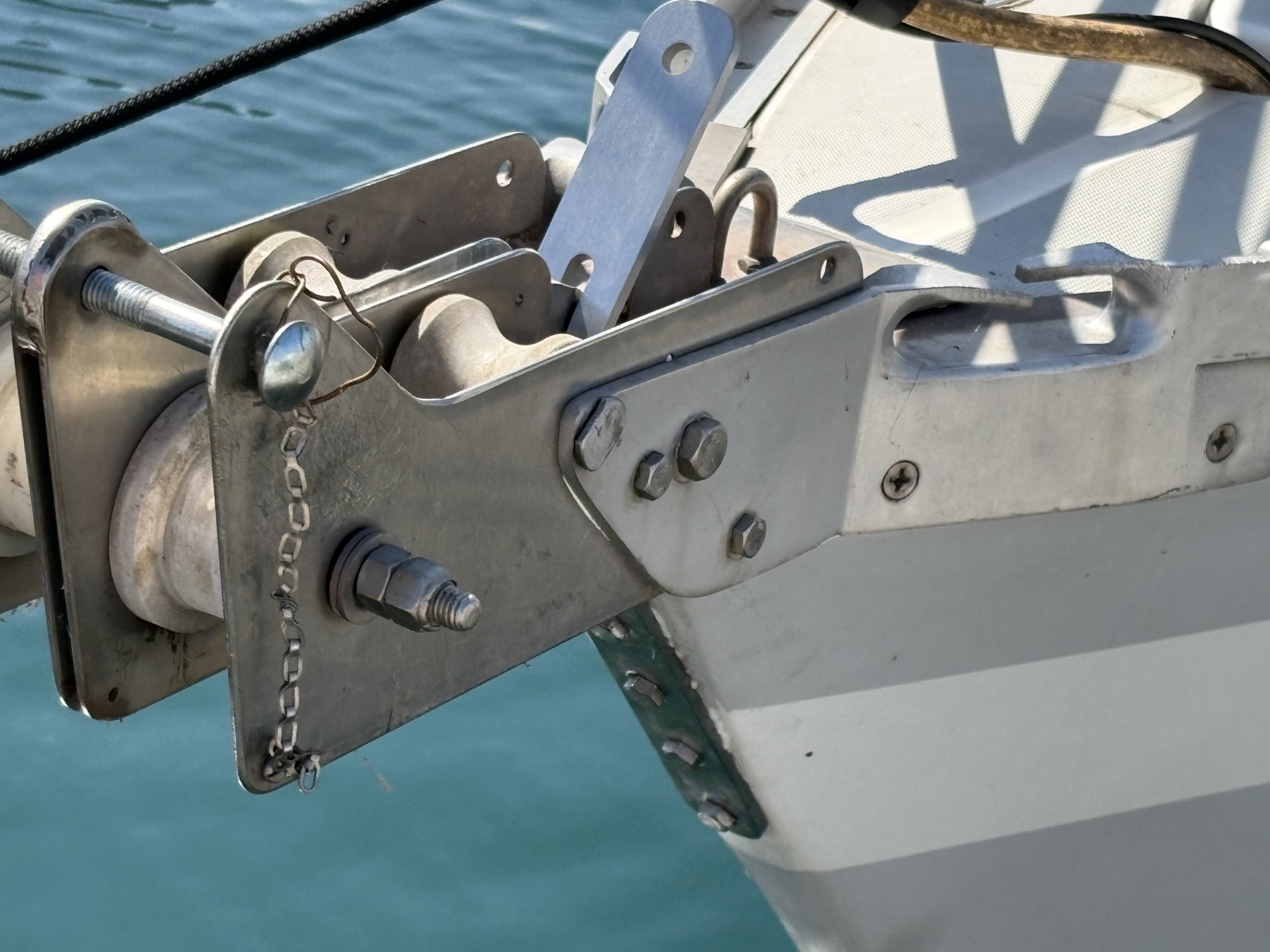

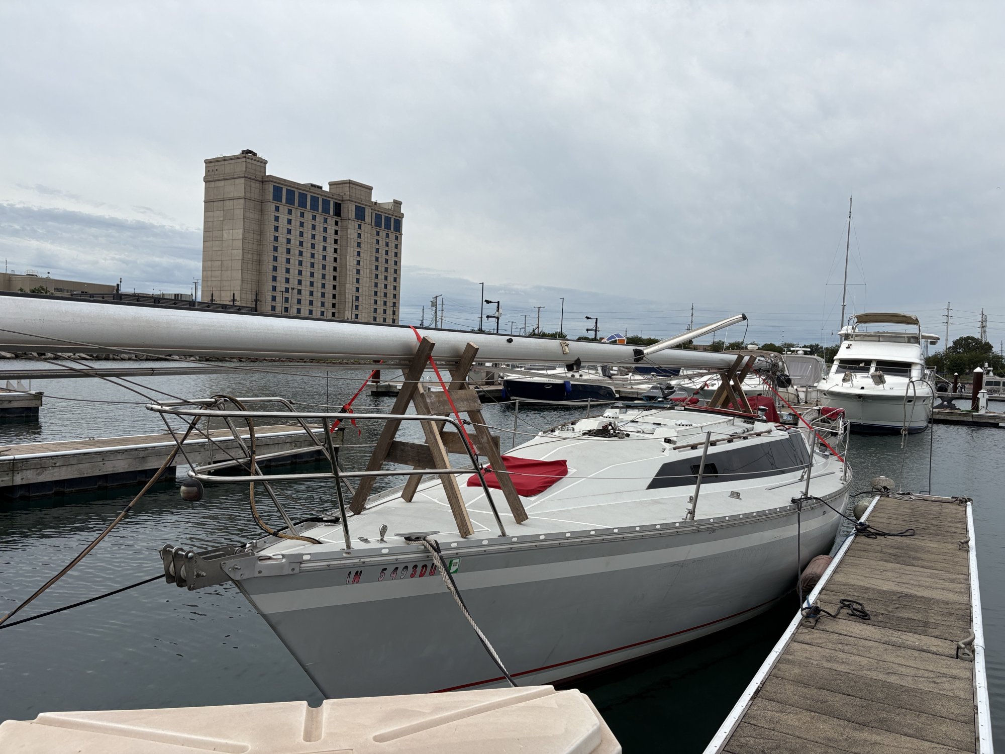

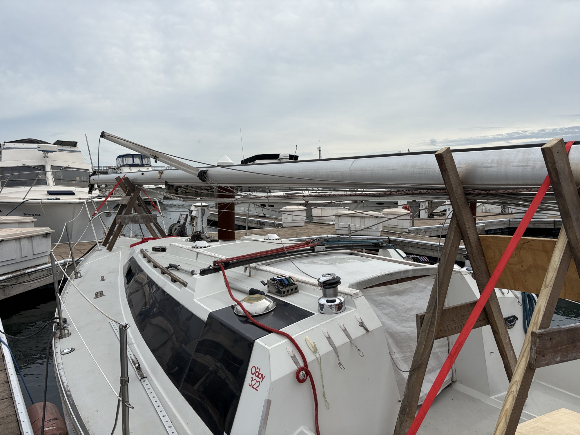

Well, I pulled the mast today. First time I have ever done it…but it went pretty smoothly. A few friends to help and the marina guy with their big forklift got the job done. Tally Ho was in the water and tied up where the big forklift usually puts dry stack boats into the water.
I picked the new stem strap from the fabricator today…$86. Hard to believe.
Tomorrow, I will try to fit the new stem piece back on the boat and re-assemble the bow roller I needed to disassemble to get the stem strap back in place.
Then schedule haul put for next Tuesday, where I will store Tally Ho for the winter and will move the mast down to the ground on horses. I will have lots of work to do on the mast. In addition to the stays and shrouds. The sheaves are all broken, the furler will be replaced, new VHF cable and antennae, etc, etc.

I put the new stem piece in today and it seems to fit perfectly.
There are some tool marks on both the old one and the new one where it was bent. I suppose that could weaken the piece, but not sure it is possible to bend the piece without leaving a tool mark.
So that is done.
Hauling out on Monday and will get the mast lowered down to the ground.

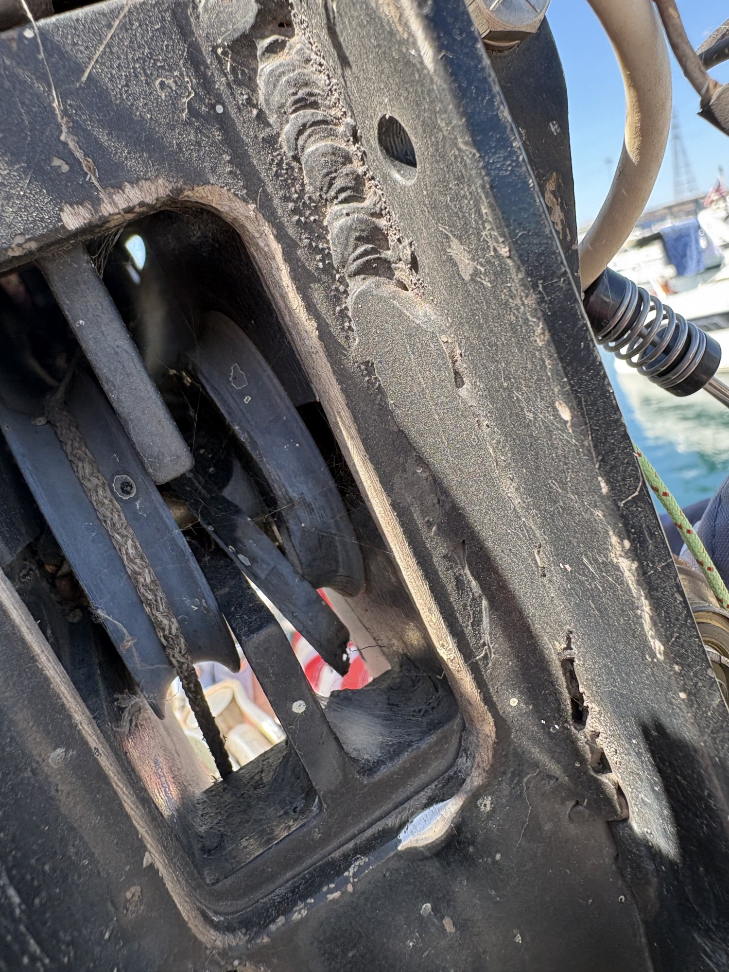

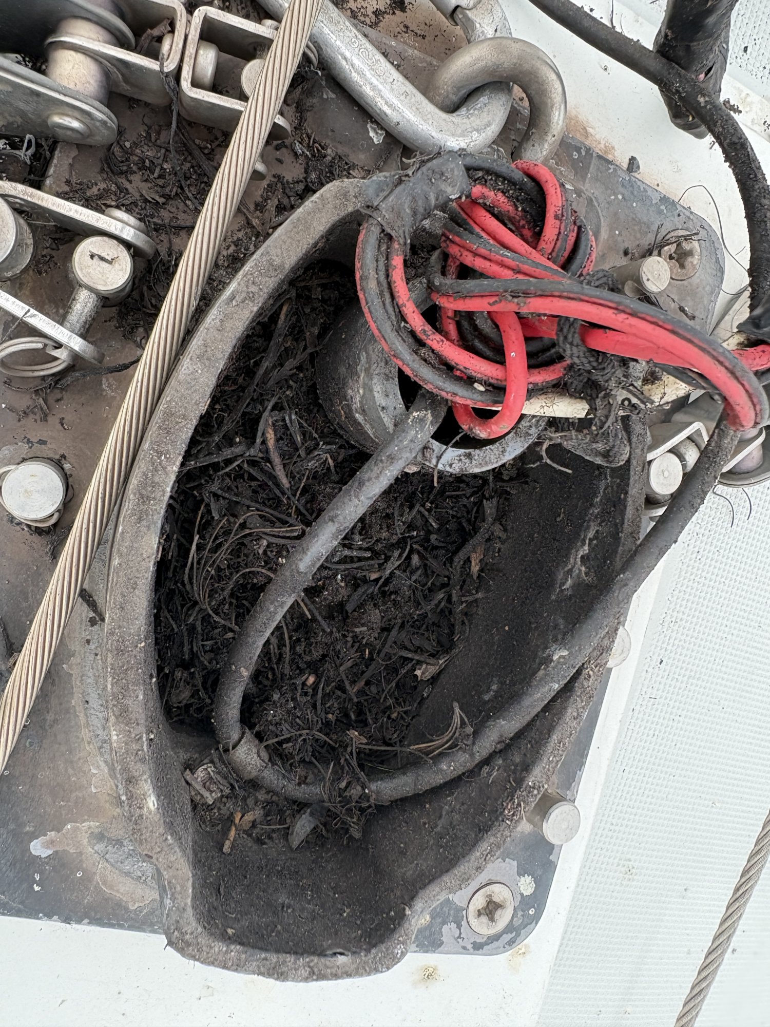

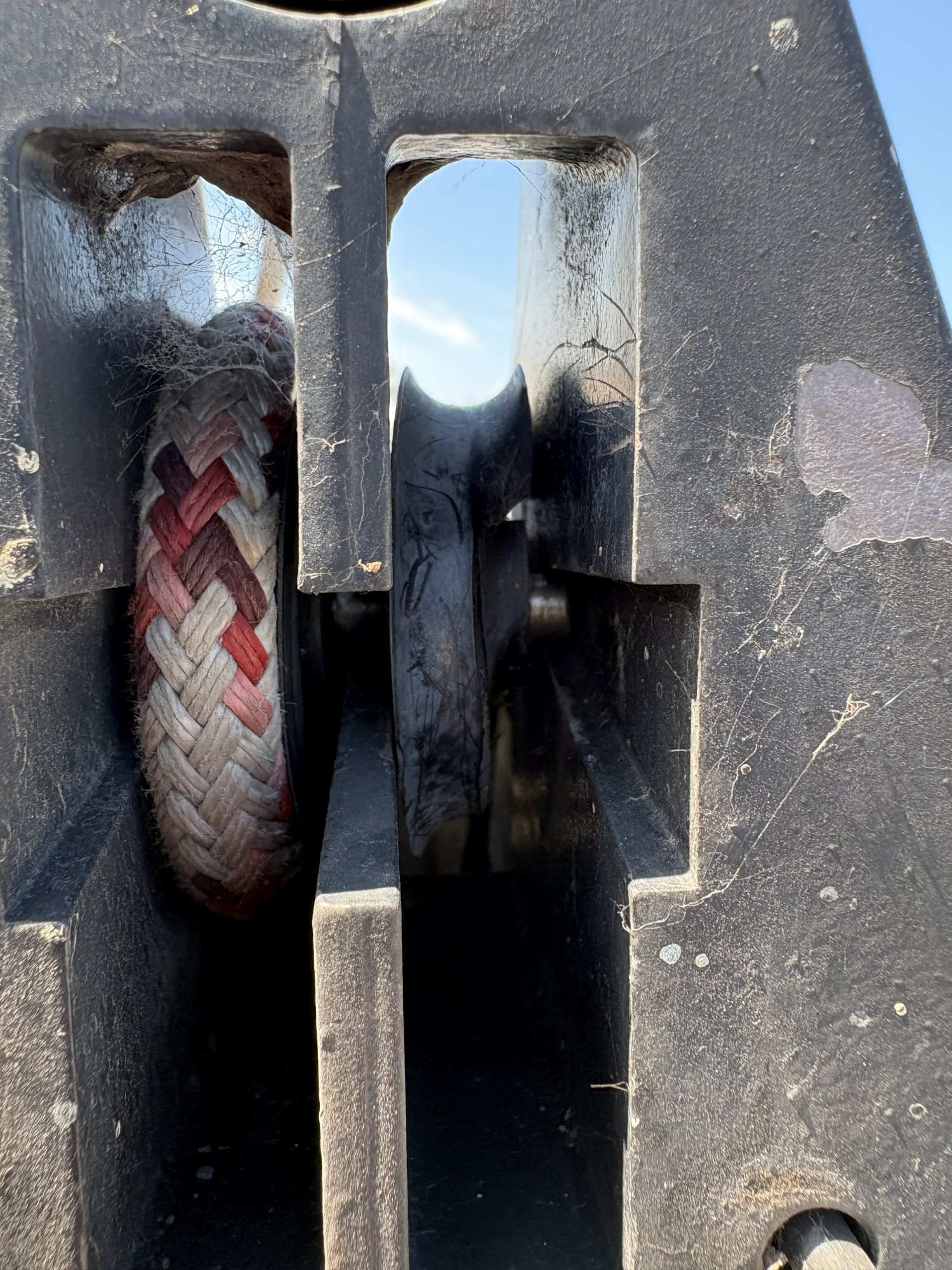

Today I pulled the masthead cap off and found 3 of the 4 sheaves broken (all plastic). No wonder I had such a hard time getting a new topping lift and spin halyard pulled. :banghead:
New ones will be ordered this week.

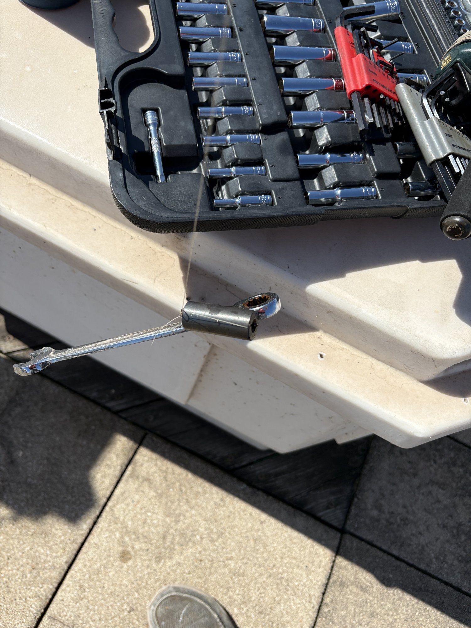

On a really positive note, I was able to retrieve my Kobalt 14mm ratcheting wrench I dropped in the water the other day…fishing with a magnet!
Waiting for a rigging estimate from a rigger I reached out to this week.
Still need to decide on a furler.
Greg
Try ZephyrWerks for the sheaves. He will make them to your specs. I bought one earlier this year.

... On a really positive note, I was able to retrieve my Kobalt 14mm ratcheting wrench I dropped in the water the other day…fishing with a magnet!...
Murphy's Law corollary is that while up the mast a dropped wench will break the Binnacle Compass before falling overboard. At least you were spared that. But you were flirting with the esteemed Murphy.
