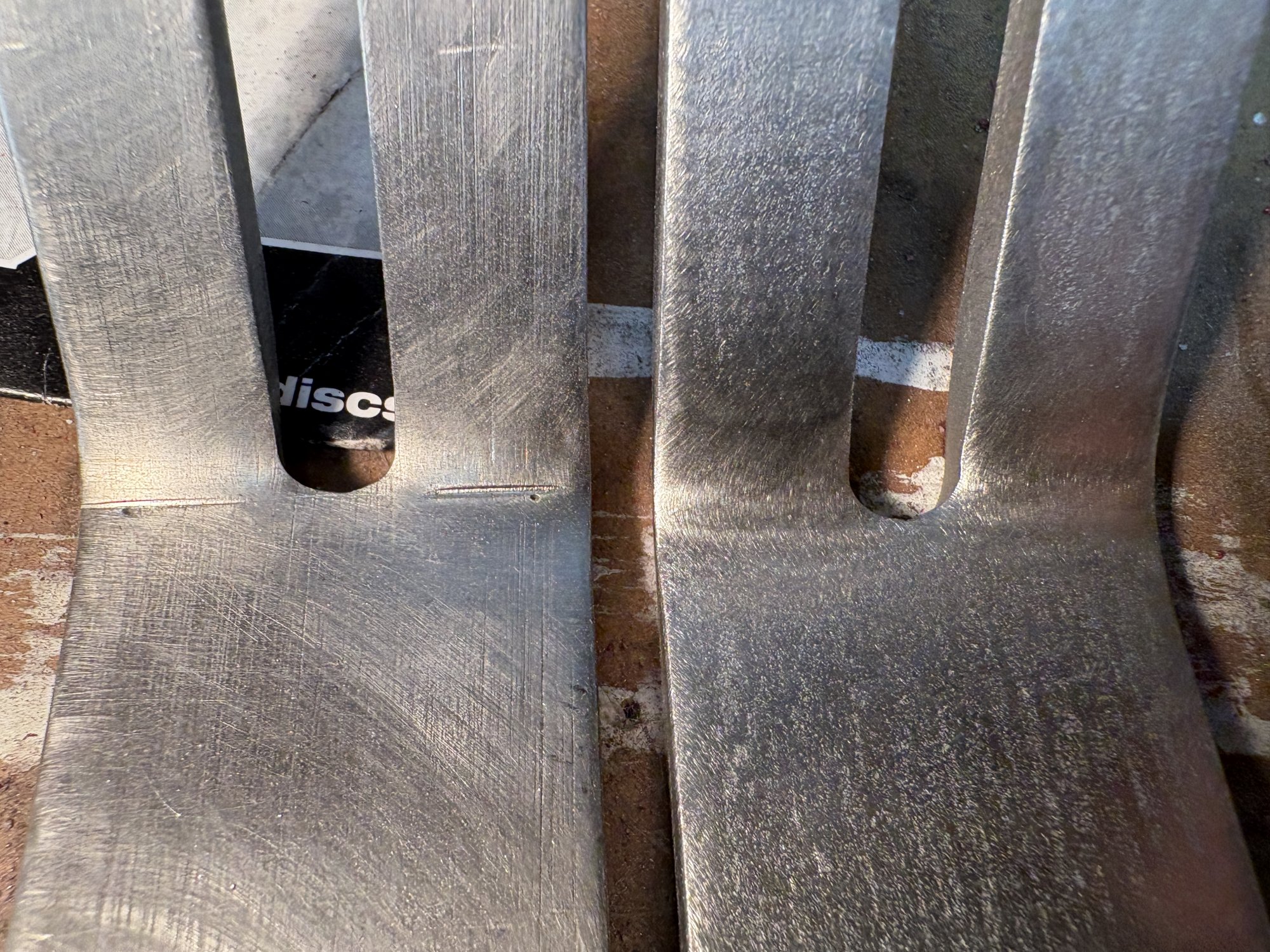

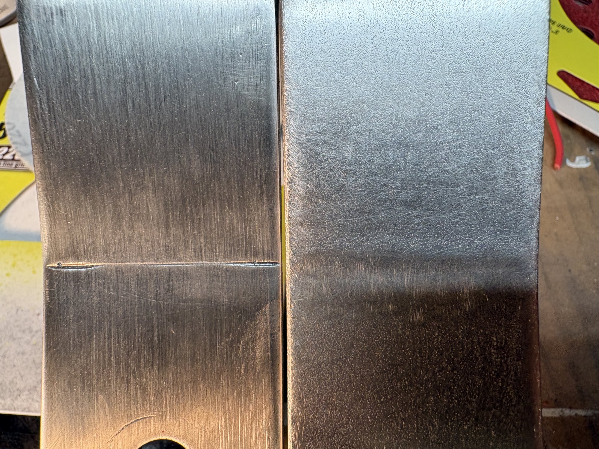

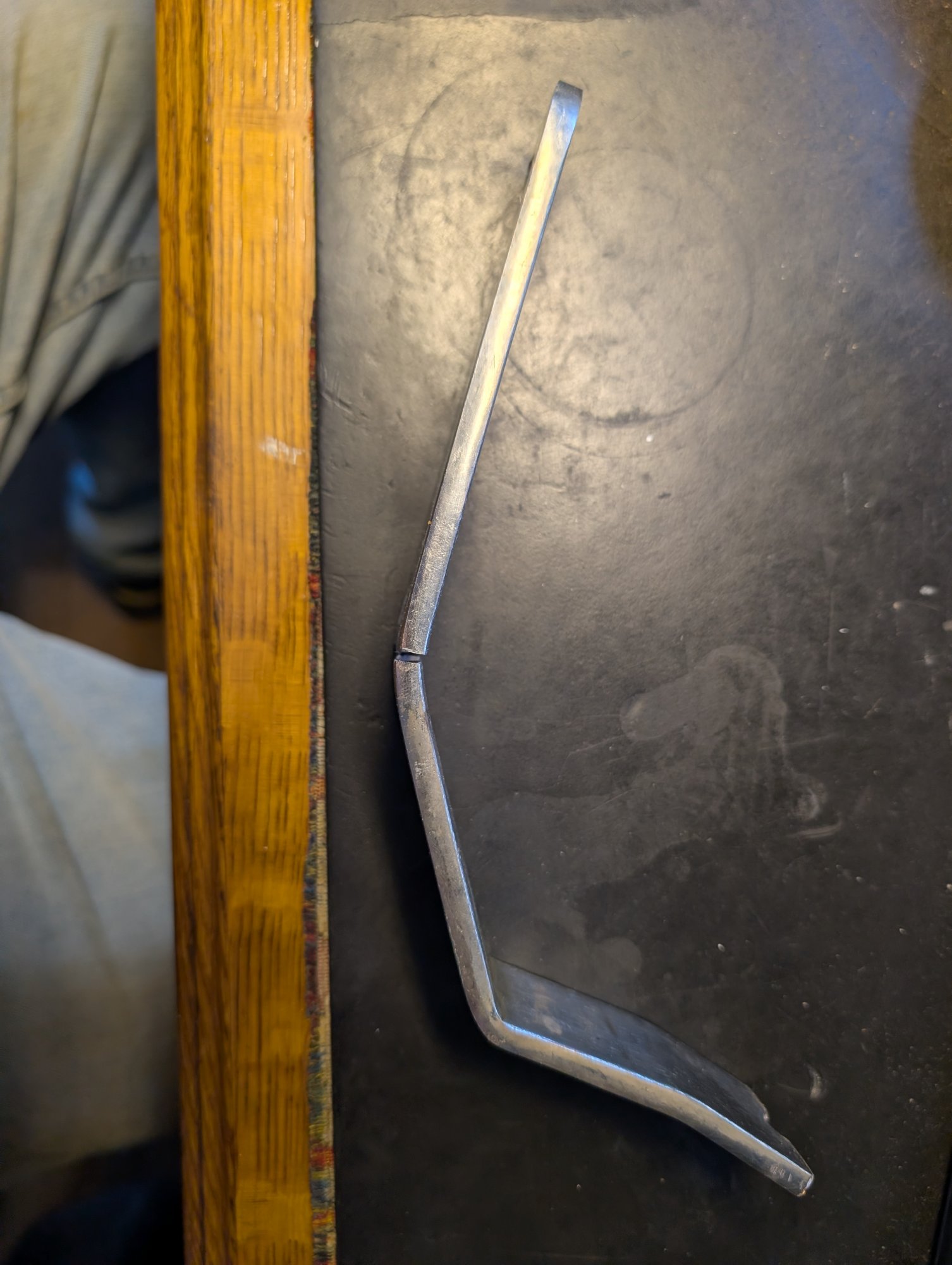

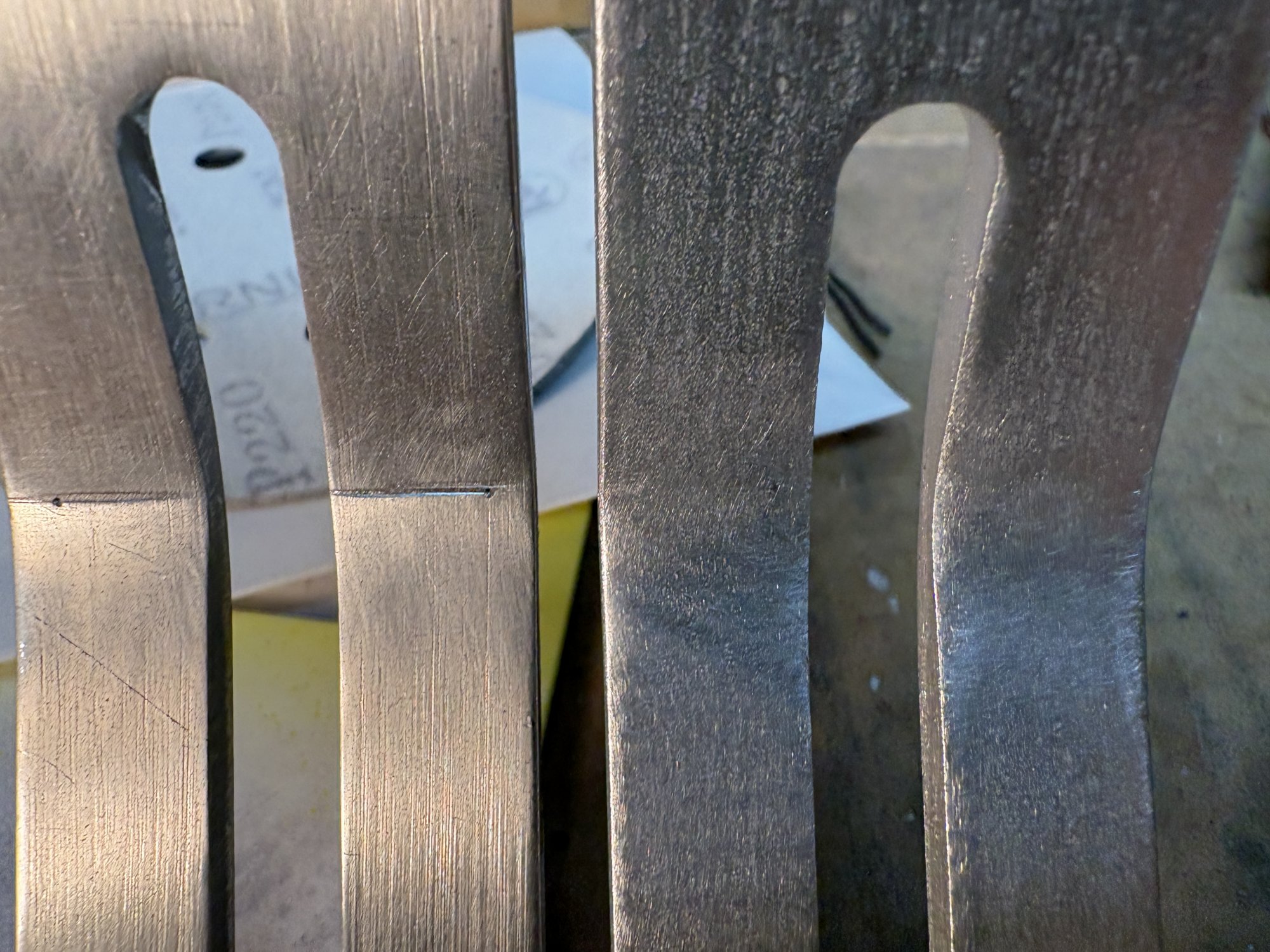

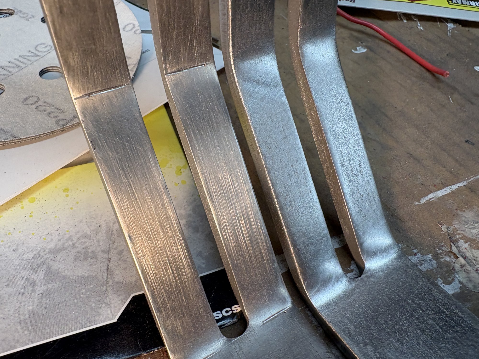

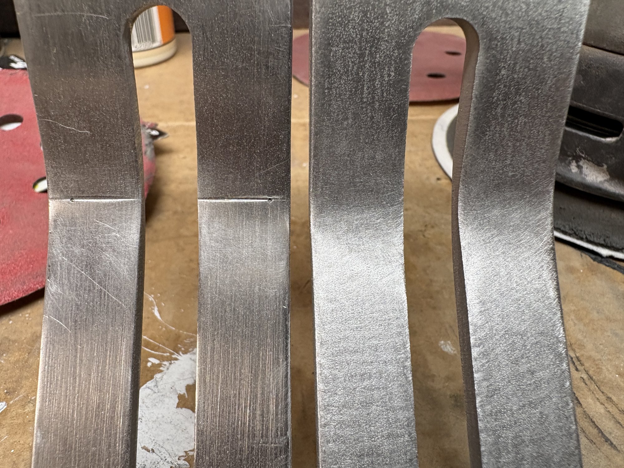

I was going to put the bow chainplate back on today, but an email from dLj that suggested that I should see if the fabricator could bend it with a radius instead of the sharp tool mark bends.
So I called the fabricator, explained the concern and he said he could use a different “top” on the press that would be a little more radiused. So I asked him to make a new one… we will see what it looks like. I appreciate Dave’s looking at the part and suggesting a better way to make it.
Always something on a boat!
