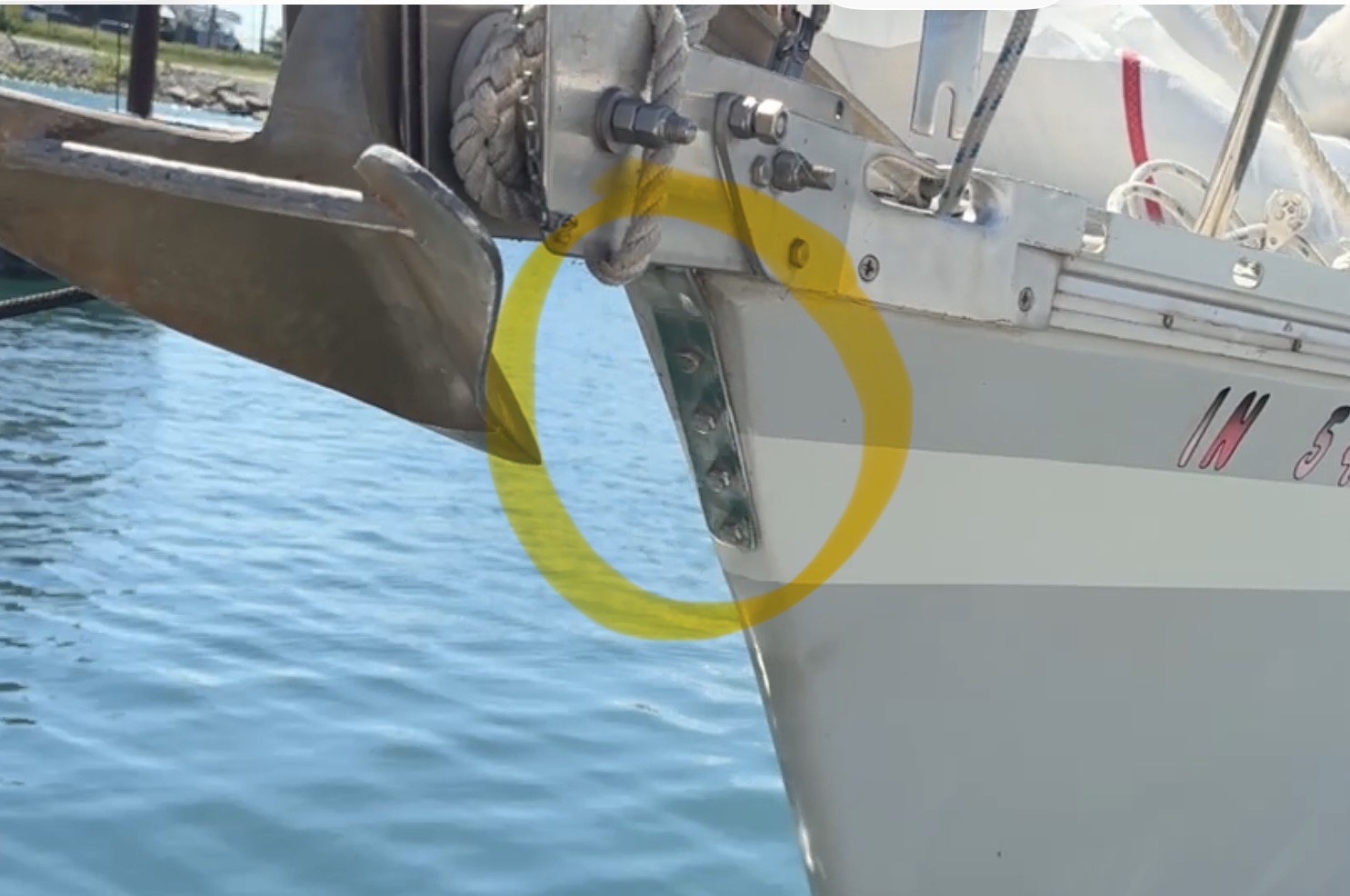

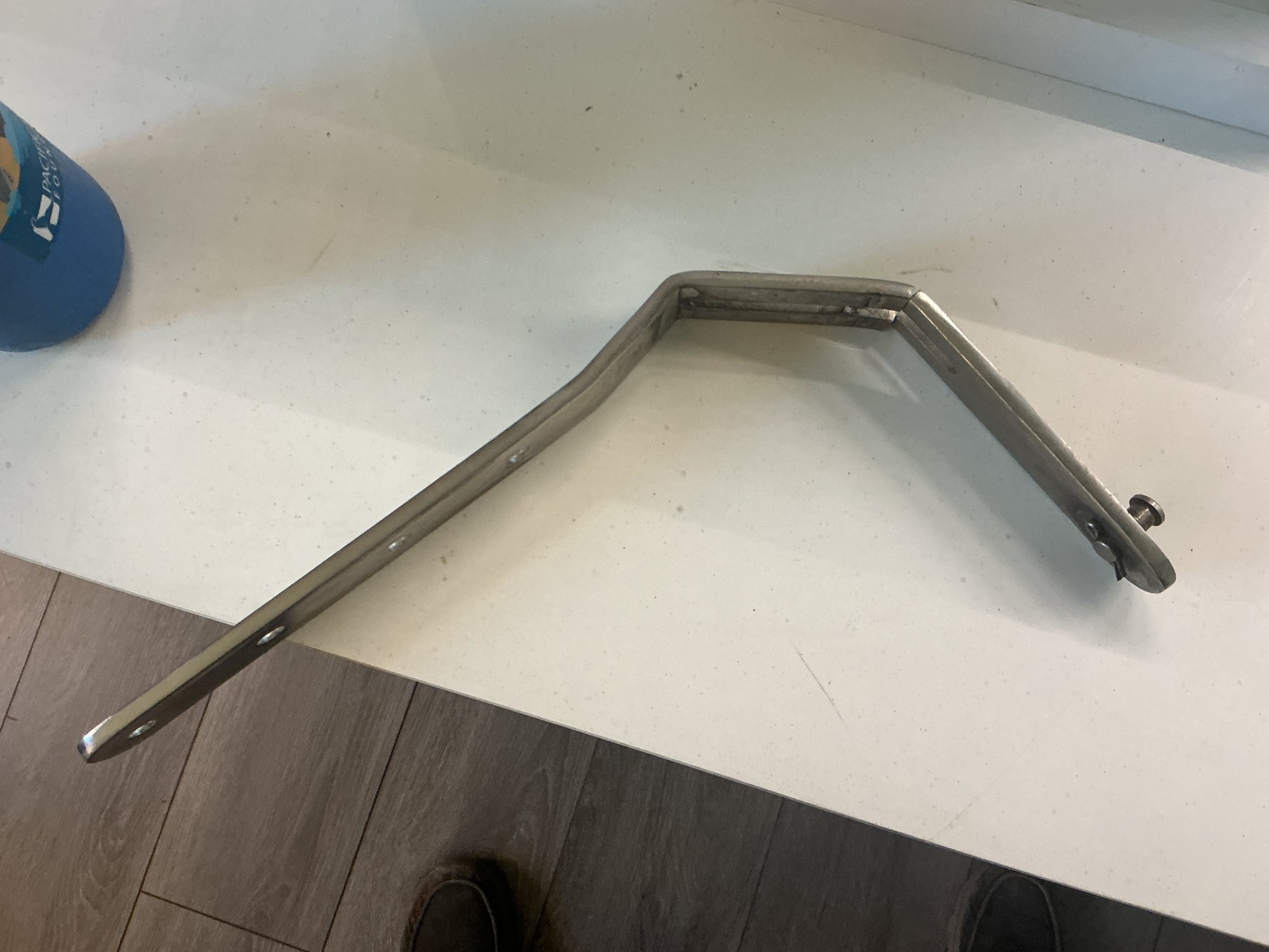

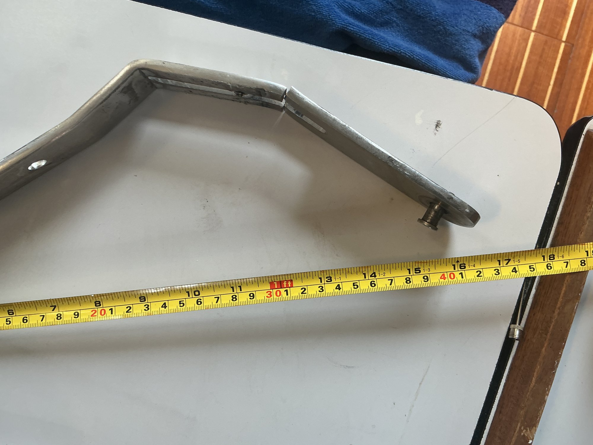

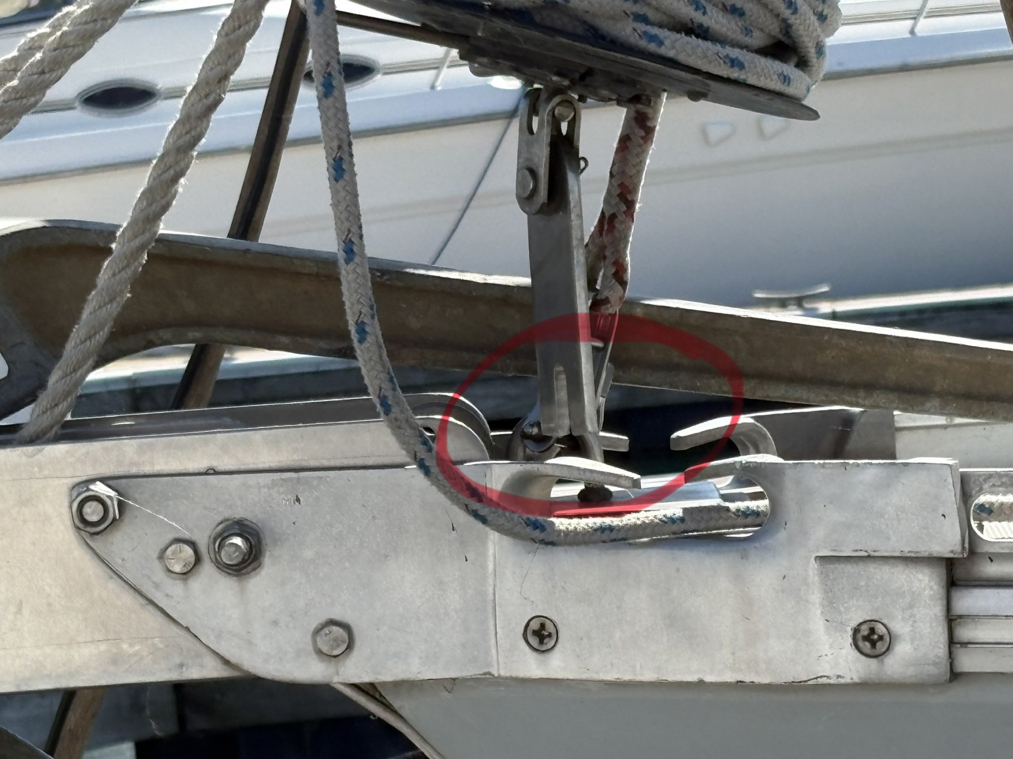

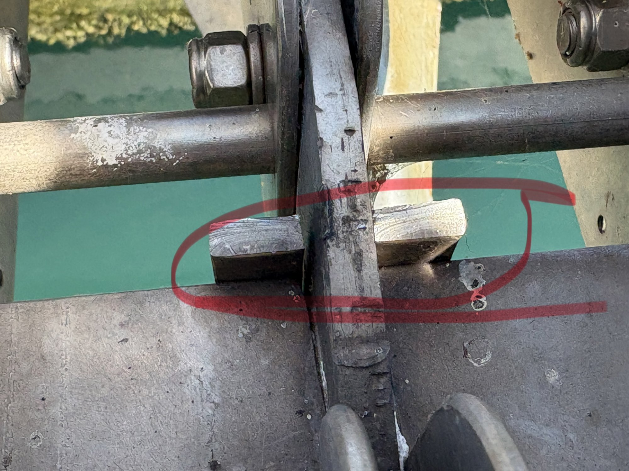

I got Tally Ho back to the marina and got a close look at the failure point…very surprising to me!
I am not sure what this strap is called…
but it continues up and ties into the stay…
but it broke very cleanly…

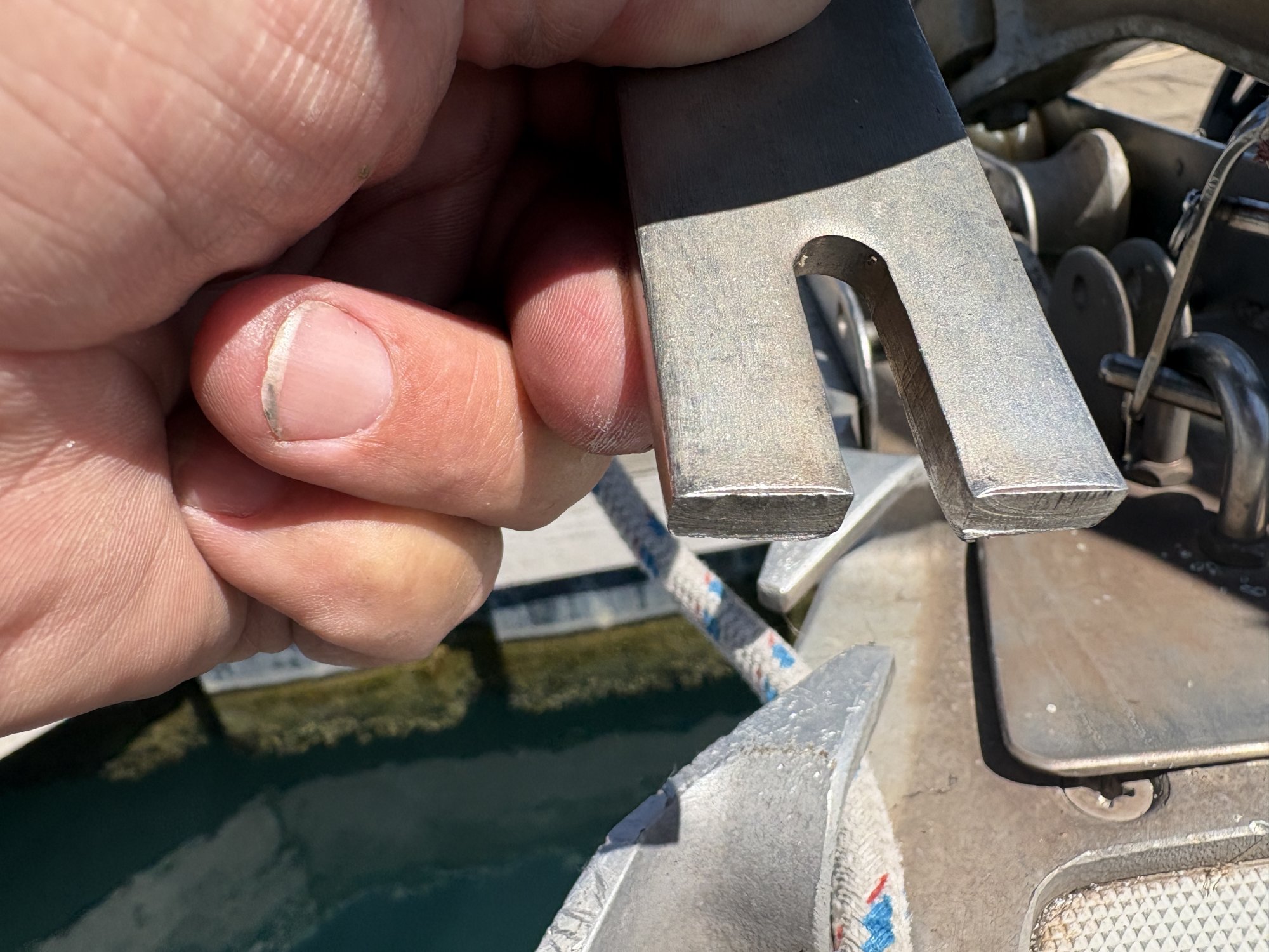

here is where it broke… note that the strap is bent (intentionally) where it broke….

Clean break sounds interesting. (From a fractography point of view).

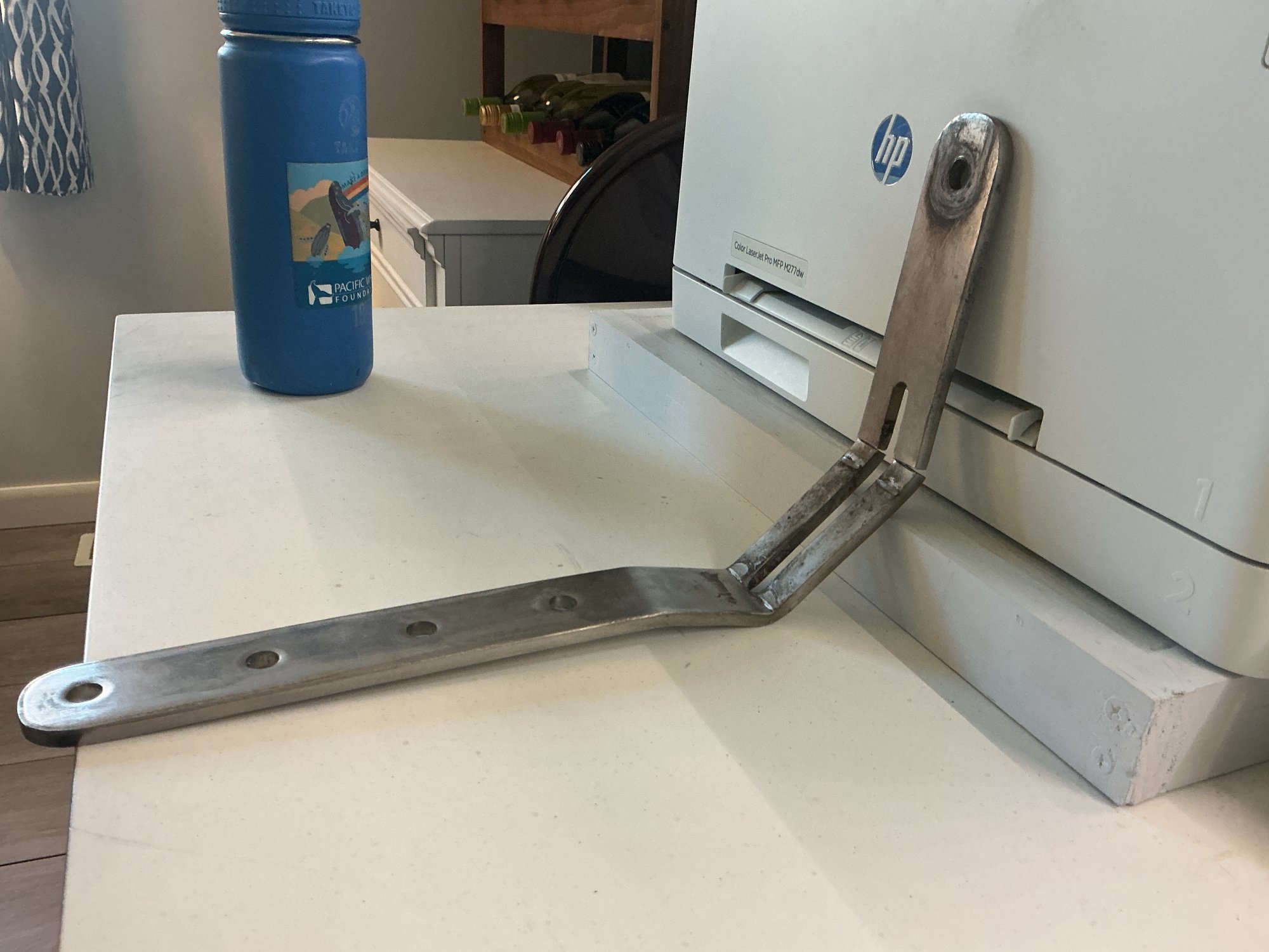

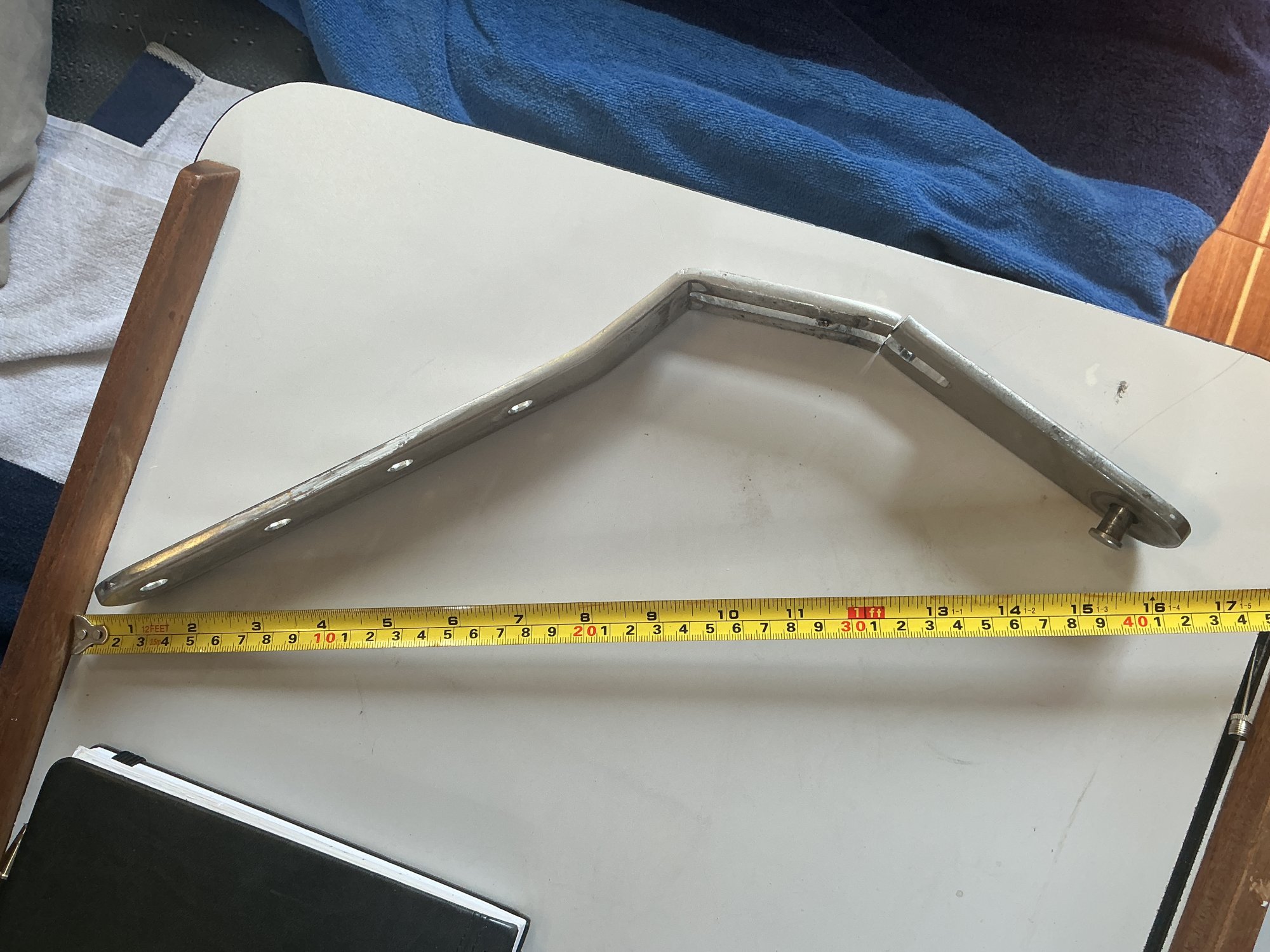

Metal fatigue induced by bending?
It certainly looks like it.

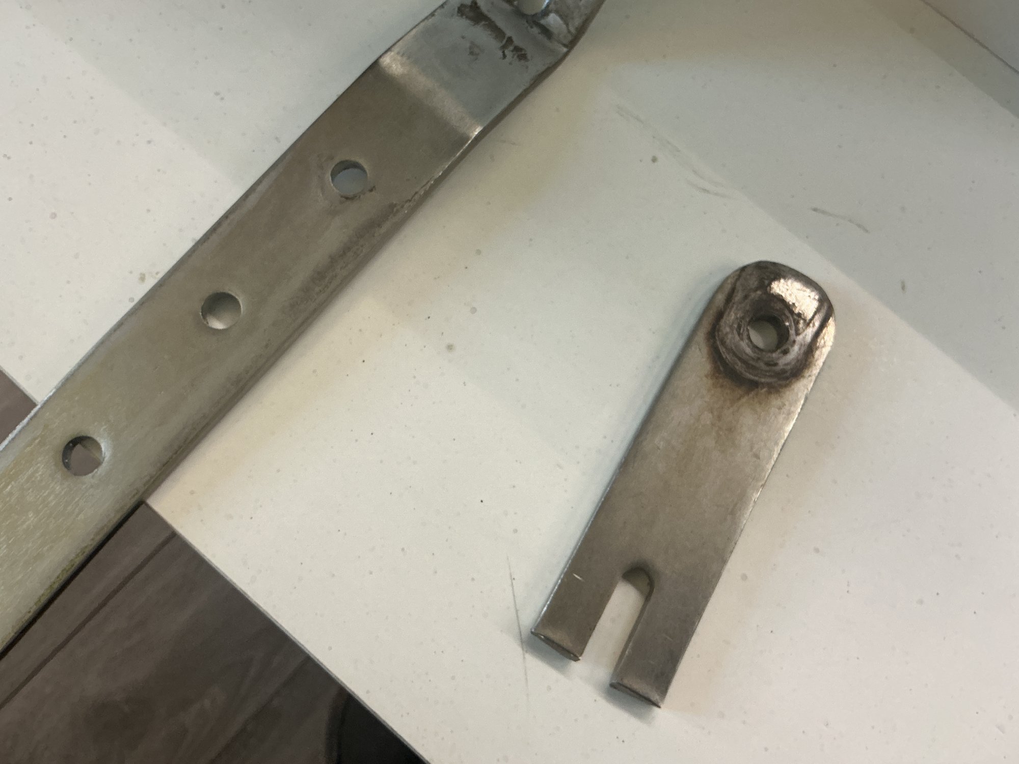

I was able to get the strap unbolted and the top part removed from the toggle.
Called several machine shops today to see who could fabricate one. Have a promising lead that I will go visit tomorrow and take the part so they can see it and take measurements.
Still waiting for our local boat yard (Crowleys) to see what they think.

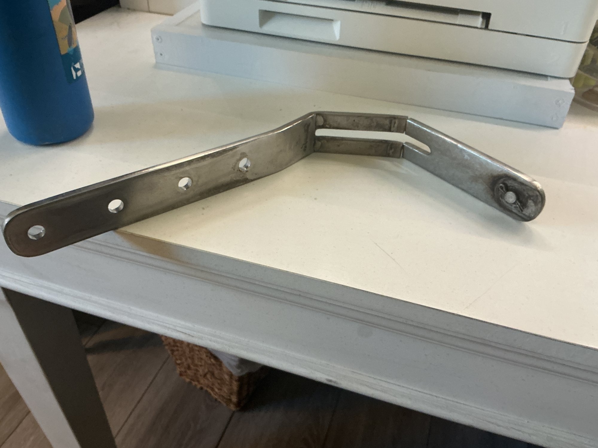

Greg
It could be fatigue but not from bending if manufactured correctly. Without looking at the fracture surface with a microscope the cause can't be determined. Fatigue is typically the propagation zone. It is not commonly the origin. The only thing the propagation zone does is tell you the environmental conditions the part is subjected to during its life span. The reason the fatigue started is found by analyzing the origin zone.
There are three distinct phases in all fractures - origin zone, propagation zone and final fracture zone. Very few boat yards have the expertise or equipment to actually analyze fractures.
The most important zone to analyze is the origin zone. It can't be analyzed by eye. It usually can't even be seen by eye. I have seen literally hundreds of these kinds of failures be in correctly diagnosed.

As an update…I took the broken stem strap to a fabricator that specializes in SS parts. They called to let me know it is ready! $87 or something like that. I am extremely happy about that (but haven’t picked it up yet). Hopefully it is an exact match.

Great job getting back safely with that rig failure! That's an unfortunate fracture location - it looks like it started underneath the tang and would have been very difficult to detect. It looks like the bend in the tang where it came up over the deck edge was a little too acute, and the forestay tension induced a bending moment in the section with the slot, which with varying forestay tension while sailing caused the fatigue fracture. So I would suggest you don't just copy the angles of the original tang for the new one - although it looks like you already have it fabricated......
