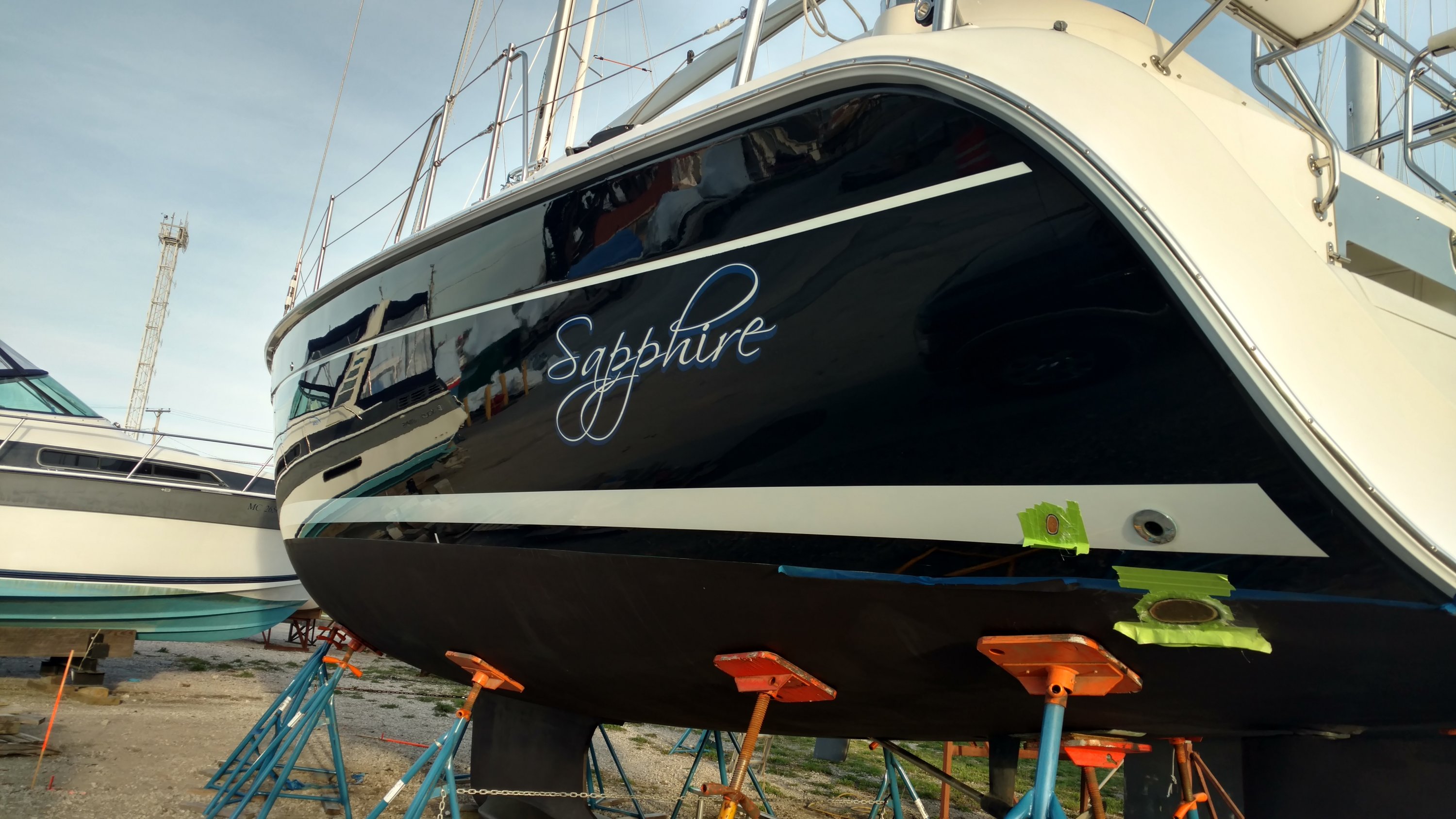

Fours days of buffing and waxing with products and sequencing as recommended by MaineSail to arrive a near perfection, have a couple of repairs going on here which were completed today
