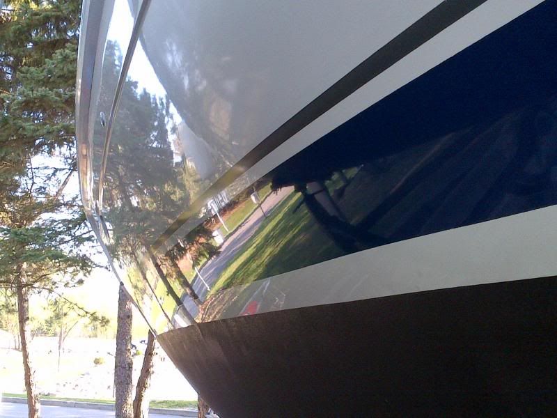

Following Main Sail's tips on a great buff job on my 1990 C&C 34+. Bootstripe still not looking great. I started wet sanding with 1000 grit. Then I tried 600 grit. Should all the oxidation come out with the wet sand? I'm scared to damage the gel coat but I think i need to sand more. Any ideas?
Nov 14, 2013
200
Catalina 50 Seattle
Here's my effort...
Heavily oxidized blue hard dodger (600 grit sand on left, heavily oxidized "before" on right):
[/URL][/IMG]
Sanding & compounding (after 800 & 1000 grit wet sand on left, after compound on right):
After polish (both sides):
After wax (both sides):
After wax (alternate angle):
Sorry some of the photos are crappy, they were taken with wet hands in a hurry!
