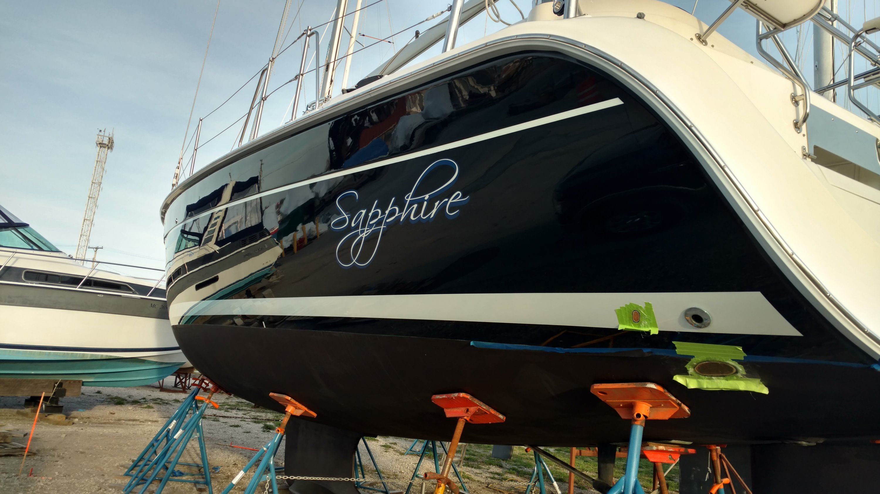

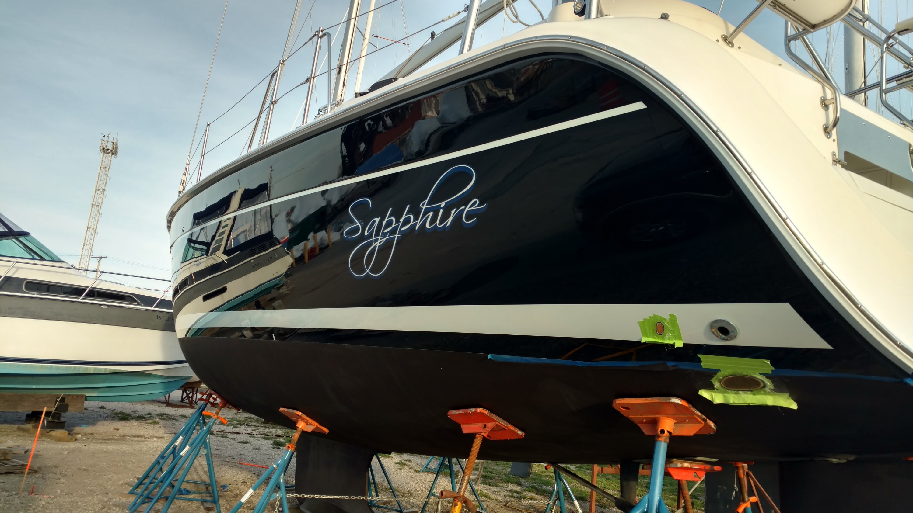

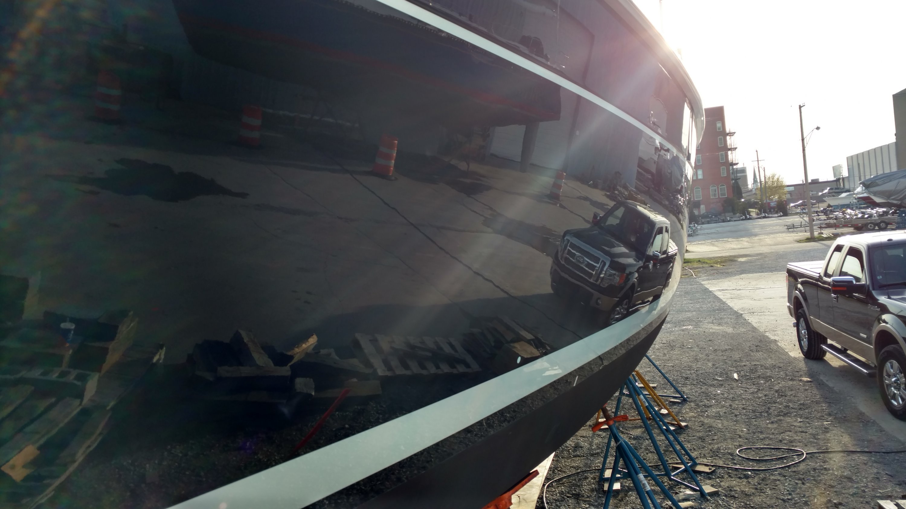

MaineSail, while I will admit the Sapphire is a well kept vessel and was rather shiny before I started with the compound, the effort put into the hull was still well worth the time spent, she really is mirror like, once the polishing step was completed the wax was so easily applied and removed, I am sure due to the extreme smoothness of the Gelcoat.
Oct 29, 2016
1,929
Hunter 41 DS Port Huron
She turned out beautifully I must say, MaineSail certainly knows his stuff the right gear, the right material and a whole lot of effort and imagine that you get results!

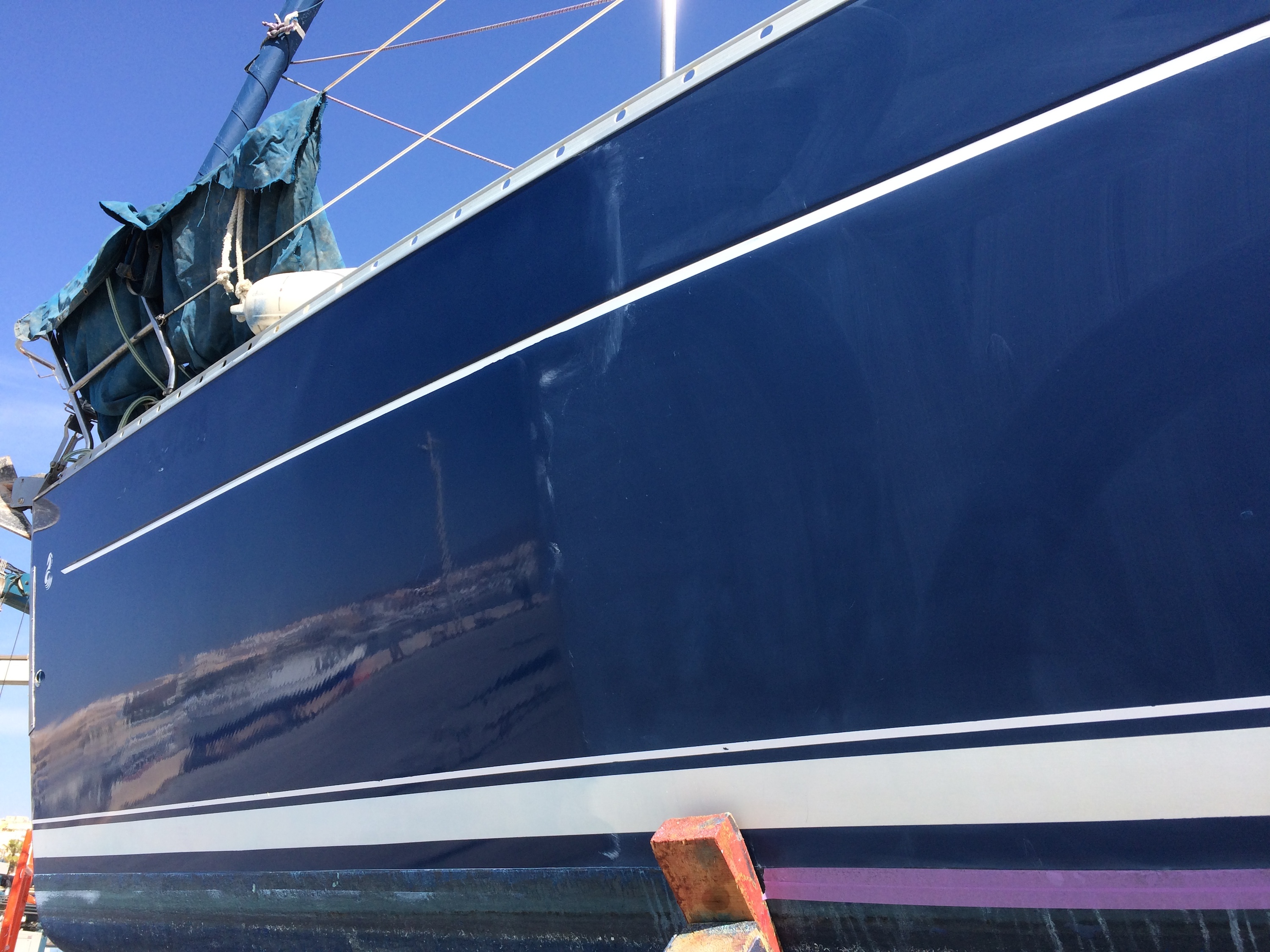

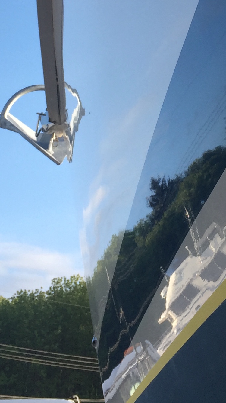

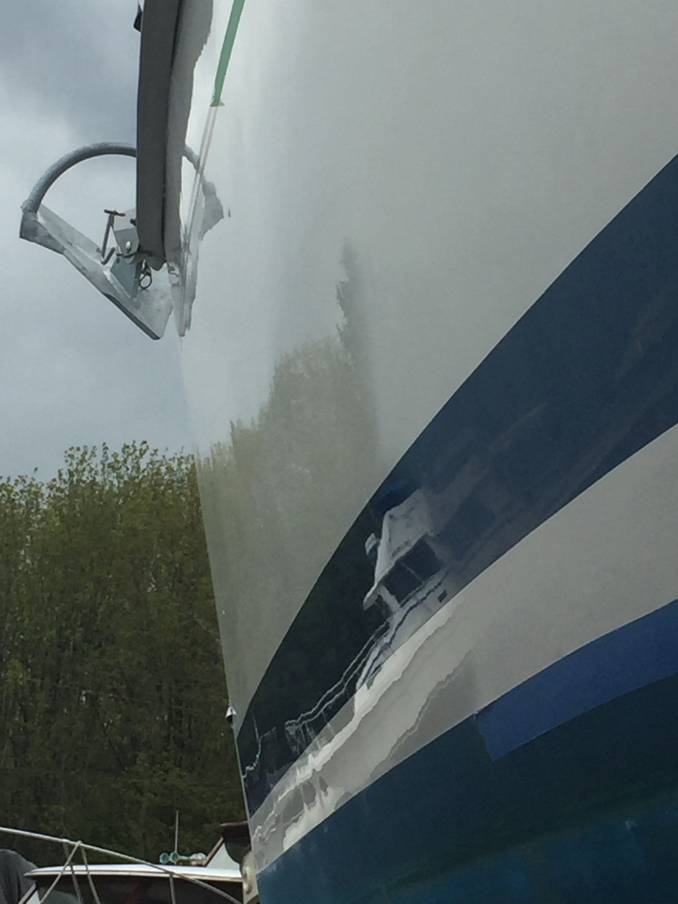

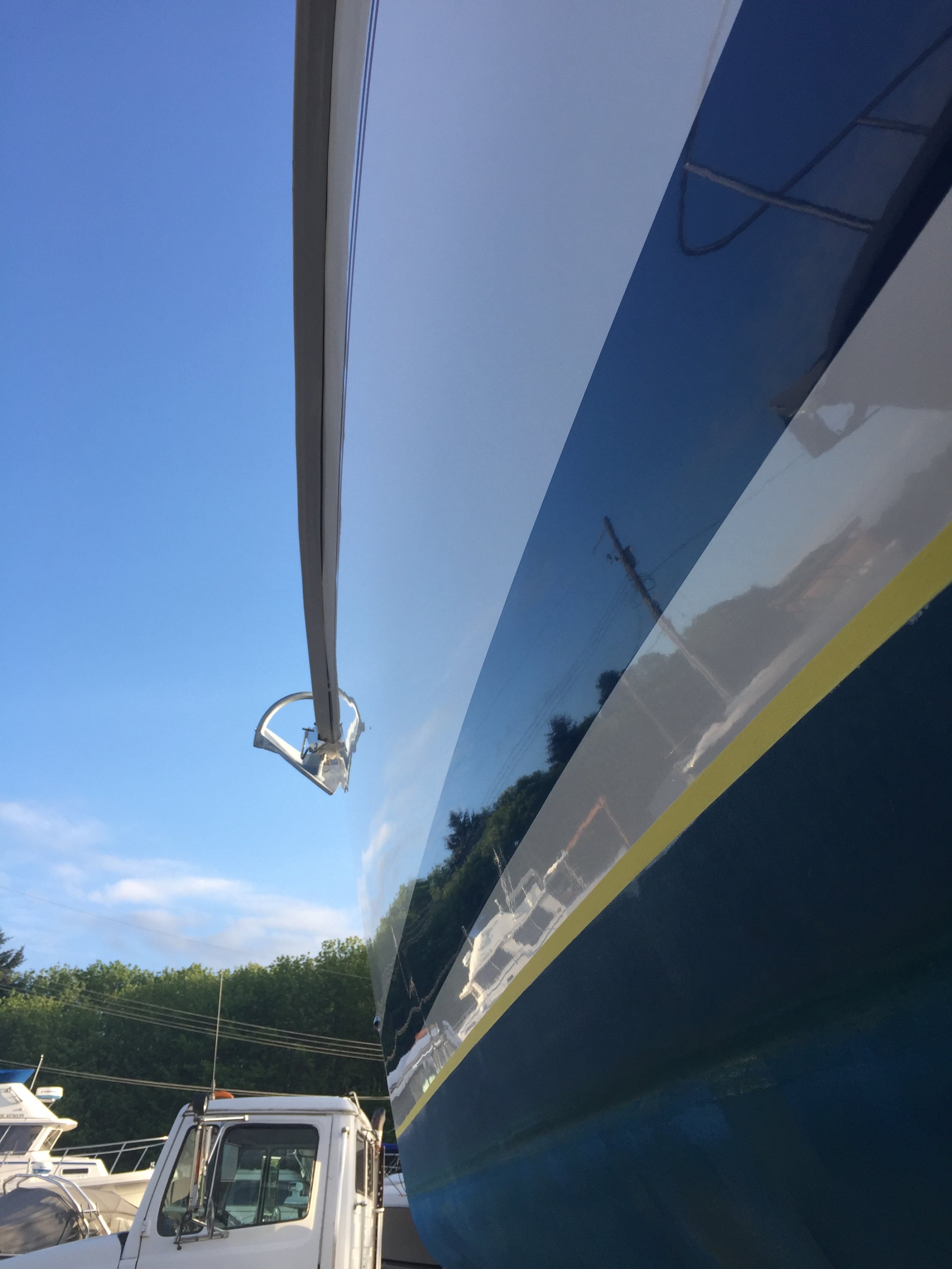

Been slaving away at this all week. 3M products (compound, finesse it II, and compound and polish wool pads). Also been using a small 6" palm buffer from Canadian Tire to apply compound/polish as its nice and light and easy to use. Everything gets removed with my dewalt heavy duty buffer as well as microfiber cloth.
Finesse It II is tricky to work with in the sun, having a spray bottle of water nearby at all times, especially when buffing off has been essential as the material dries out very fast. Tomorrow we're going to wash everything with a gentle soap and start hand waxing with the collinite paste wax. Hope to be back in the water by Monday.
Only regret is that I didn't start with a 1500 wet sand on the dark blue stripe. It came back with compound but it was a lot of work. The boat is from 1998 and hasn't seen much attention to the gelcoat in a long time from what we can see. We've had it just one year.

We did two coats above the blue cove stripe, and three coats on/below the blue cove stripe in the images. Maybe it's overkill but I want it to last at least to the fall if possible.

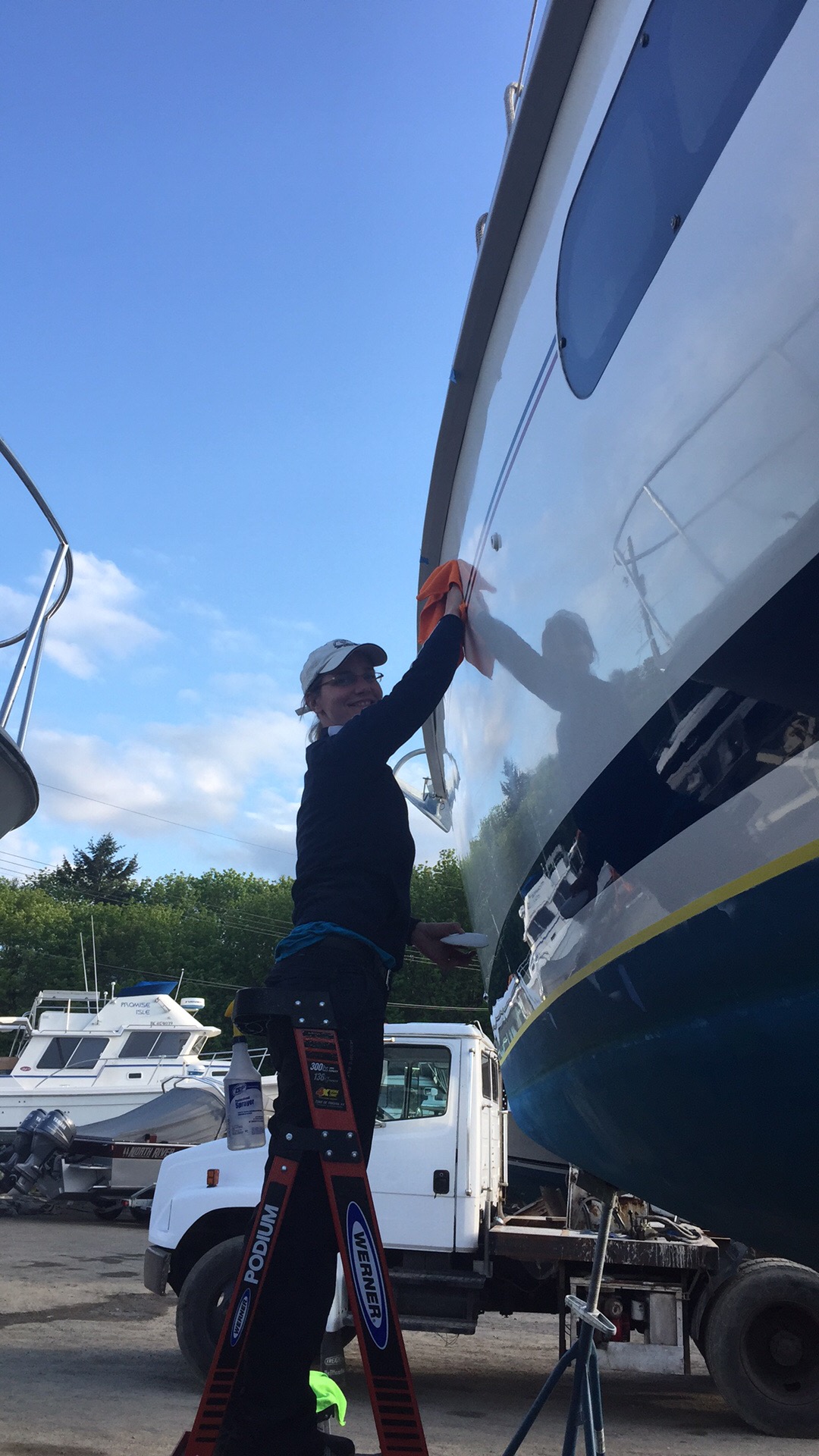

The collinite was applied by hand with a round wax applicator 3" pad, and removed by hand with a microfiber cloth. We misted the glass with water just before application, and changed microfiber cloths frequently. The microfiber cloths load up quickly, as long as you have a clean cloth I found no need for machine removal. All the machine work was only during the compound and polishing phases.

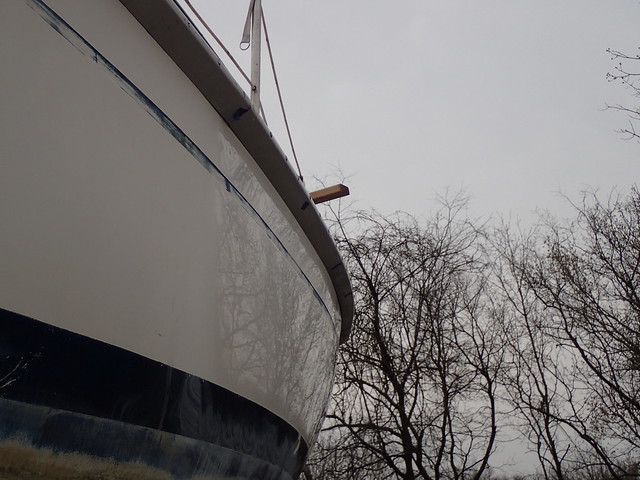

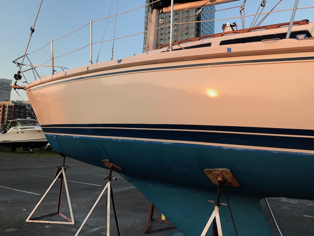

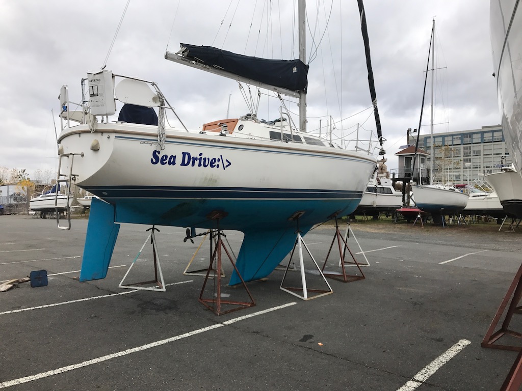

Wanted to post my results. 1990 C30. Started w/ wetsanding @ 800 grit and moved through the process. I am happy I did the swirl remover, I know OP said its a bit overkill but really brings it from 90% to 100%. I cant agree more.
Before:
After:

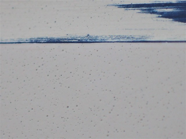

OK. 40 year old boat with less than "adequate" attention paid to the gel coat.
Am I just whizzing in the wind trying to bring this back to at least presentable?
The pic is a 8X magnification from about 4 inches out the partial strip at the top is about an inch wide in normal view.
Wowzers Larry: Looks like a perfect candidate for some topside paint.

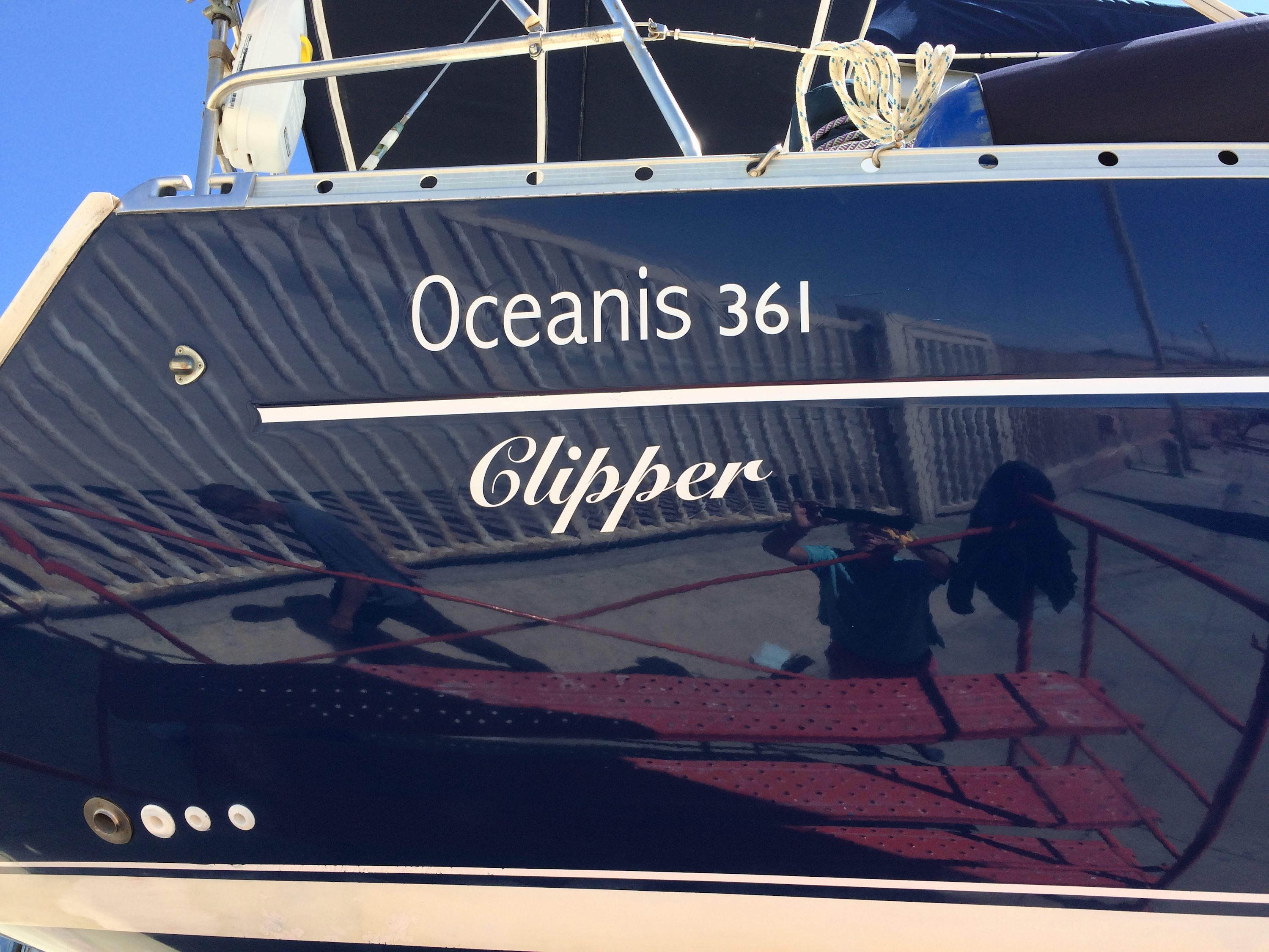

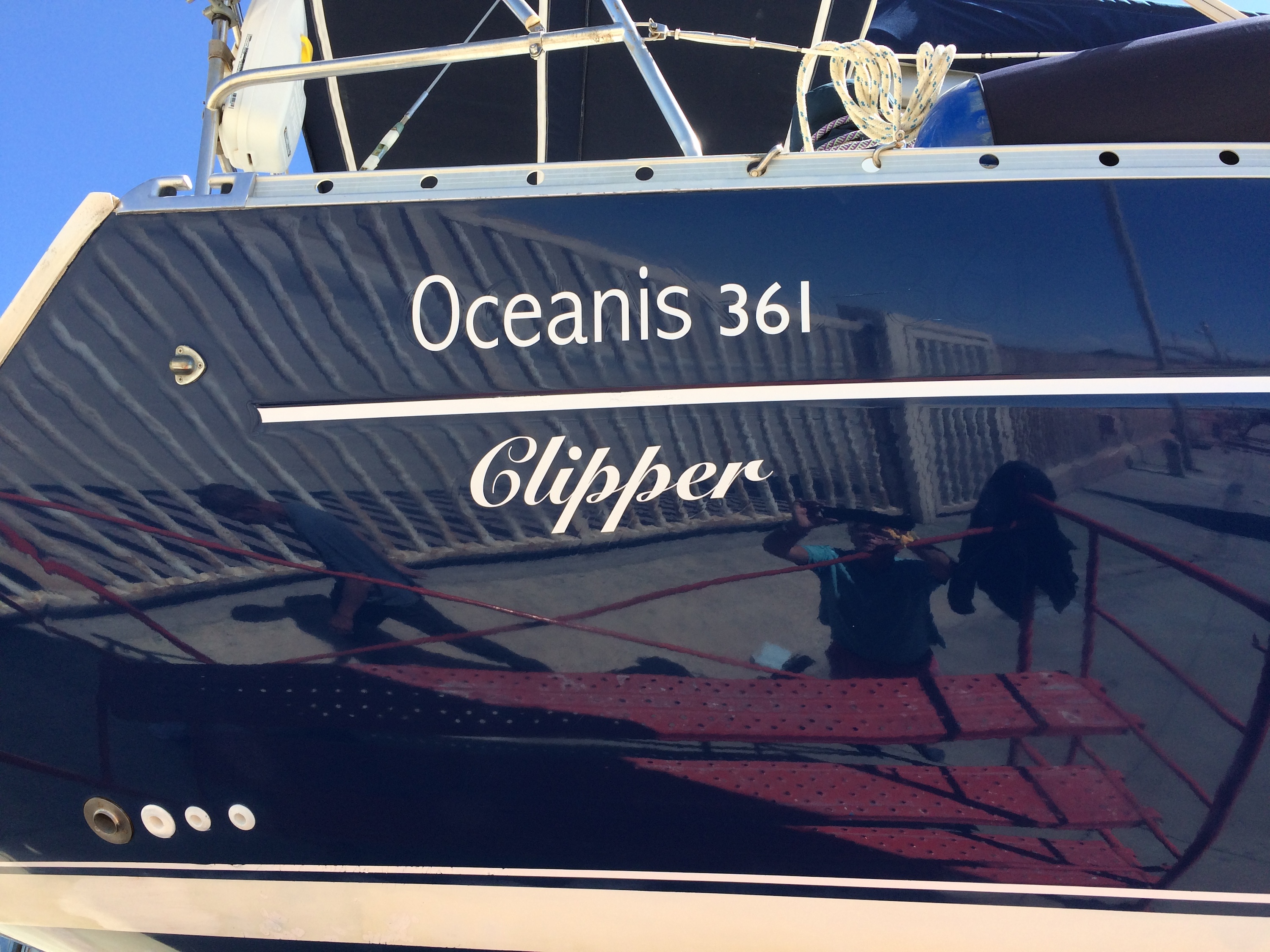

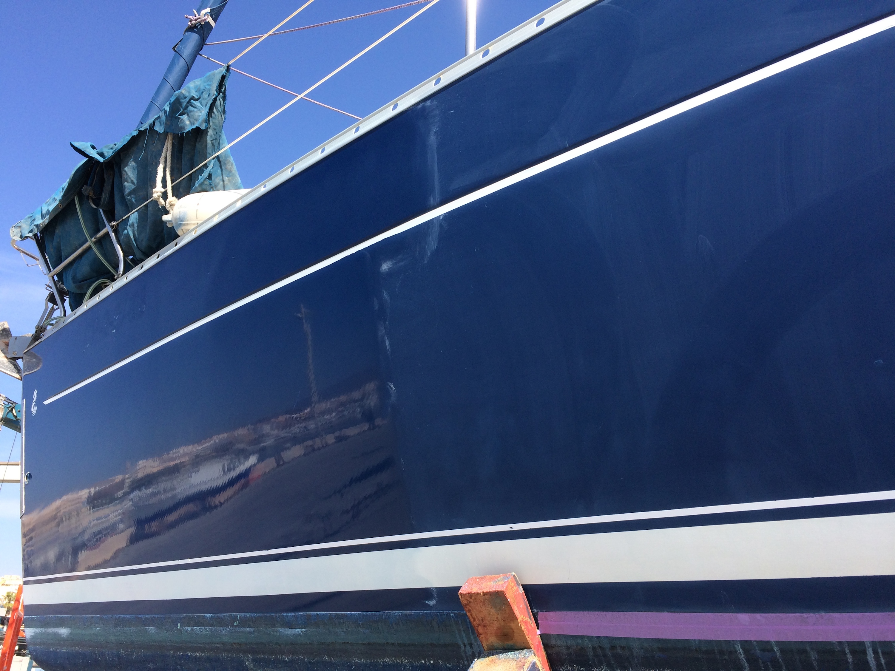

Just wanted to thank Mainsail for giving me the confidence to polish my GelCoat myself. It was hard work but worth the 45 hours I put into it. I bought and used everything recommended, the only thing I tried was I used a machine to wet sand the 2000 grit stage, luckily without damage. I did try a large section with the final 3M hologram & swirl remover but really could not see a difference, even wearing my glasses:) Other yacht owners here were shocked when I told them I was going to take sandpaper to my boat, the same where equally shocked and suitable impressed by the finish I achieved. I can confirm new signage can be applied after final waxing.
Sep 23, 2009
1,480
Very impressive. What was done to bow in the before and after bow shot? Any reason not to put the graphics on before the wax?
Boat looks showroom new.
