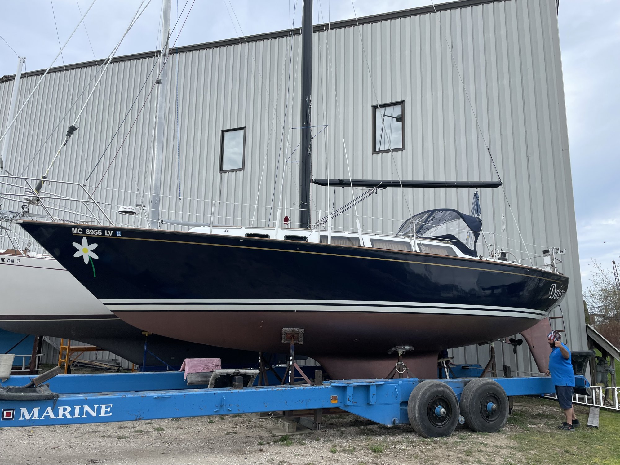

Not a great pic (they are about to sand and put on new bottom paint) but you can see the boat two stalls over next to me.

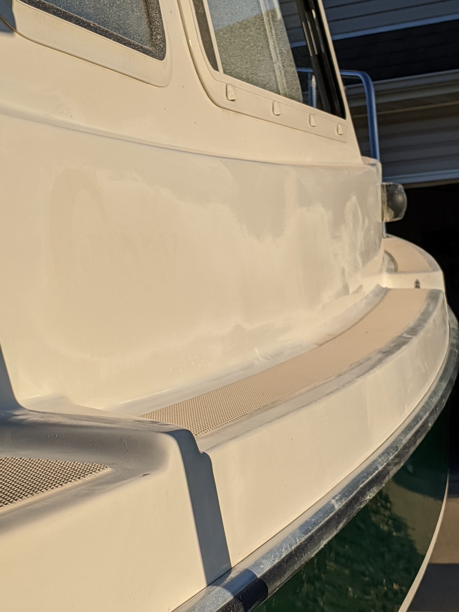

Read the instructions. Used 3M products. Compounded with 3M wool compounding pad, switched to 3M polishing pad. All went well on my green stripe. But on the cabin sides it did not go well. It must be operator error. I read a bunch of posts and can not figure out my mistake. Asking for advice on how to proceed. Thanks in advance for any help.
Mar 22, 2016
3
Seaward 25 Nashville
Answer my own ? I needed to sand first as the oxidation was too much to have the compounding material remove it. After sanding, buffing and polishing it looks good.
