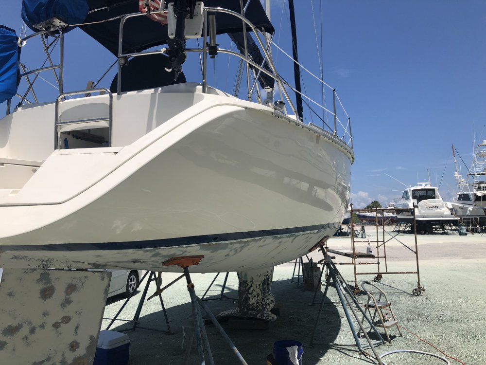

Hi Main Sail,
Thank you so much for your very constructive detailed explanation.

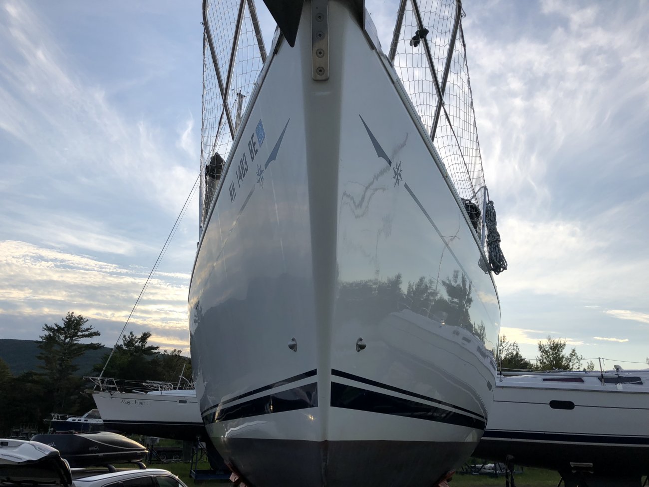

Here’s a picture with one side of the boat done with Presta Cutting creme light.
I used heavier Presta wool pad to start with (yellow) and did a second pass with the green one. Results are excellent.
I ended up with 2 coats of collinite 885.
But I didn’t do the polishing. That was last year.
Now this year, the boat still looks nice but what should I do ? Polishing and wax ?
Because some small area , where water is dripping from the toerail, along the hull, it leaves some “faded” streaks.
I don’t know if I should use Ultra cutting cream or just the Ultra Chrome polishing to get rid of those imperfections.
And also, using the Polishing or Ultra cutting cream.....will it remove my old collinite wax ?
Thanks.
Oct 29, 2016
1,929
Hunter 41 DS Port Huron
I did our hull with this (3) step process spring of 17, this year and last all I did was use polishing cream in areas where there was scuffing from the cover and rewax the entire hull with Collinite. The boat beads water like no tomorrow and I get many comments on the mirror like finish. The process that Maine Sail gave instructions for is absolutely worth the effort. @Final Approach I would just hit the areas of that have marks from the winter with the polish and reapply the Collinite wax to the entire hull.

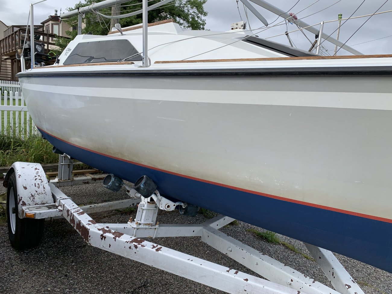

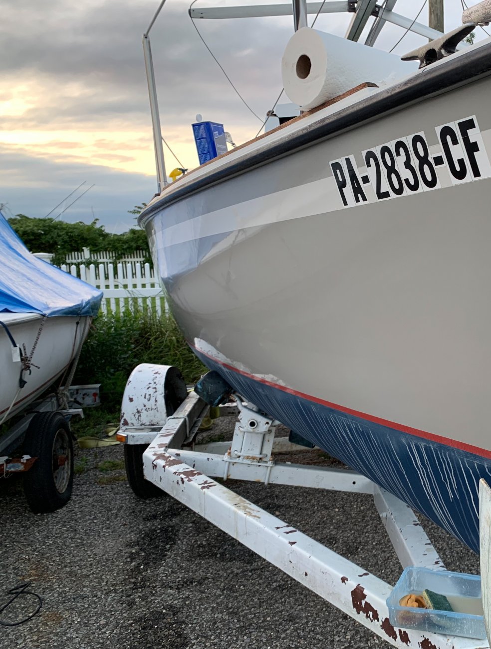

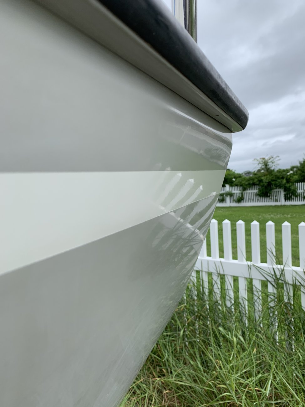

Followed the guide with the added removal of a failed floor wax first.
  • Zep Heavy Duty Floor Stripper
  • Acetone wipe down
  • 1000 Grit Wetsand
  • 3M Heavy Duty Rubbing Compound
  • Presta Polish
  • Colonite Fleetwax Paste
Before:

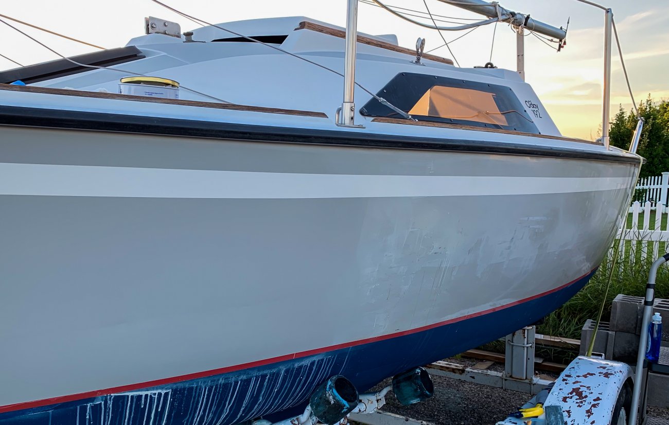

Test spot, no wax on it.
During:
After:
