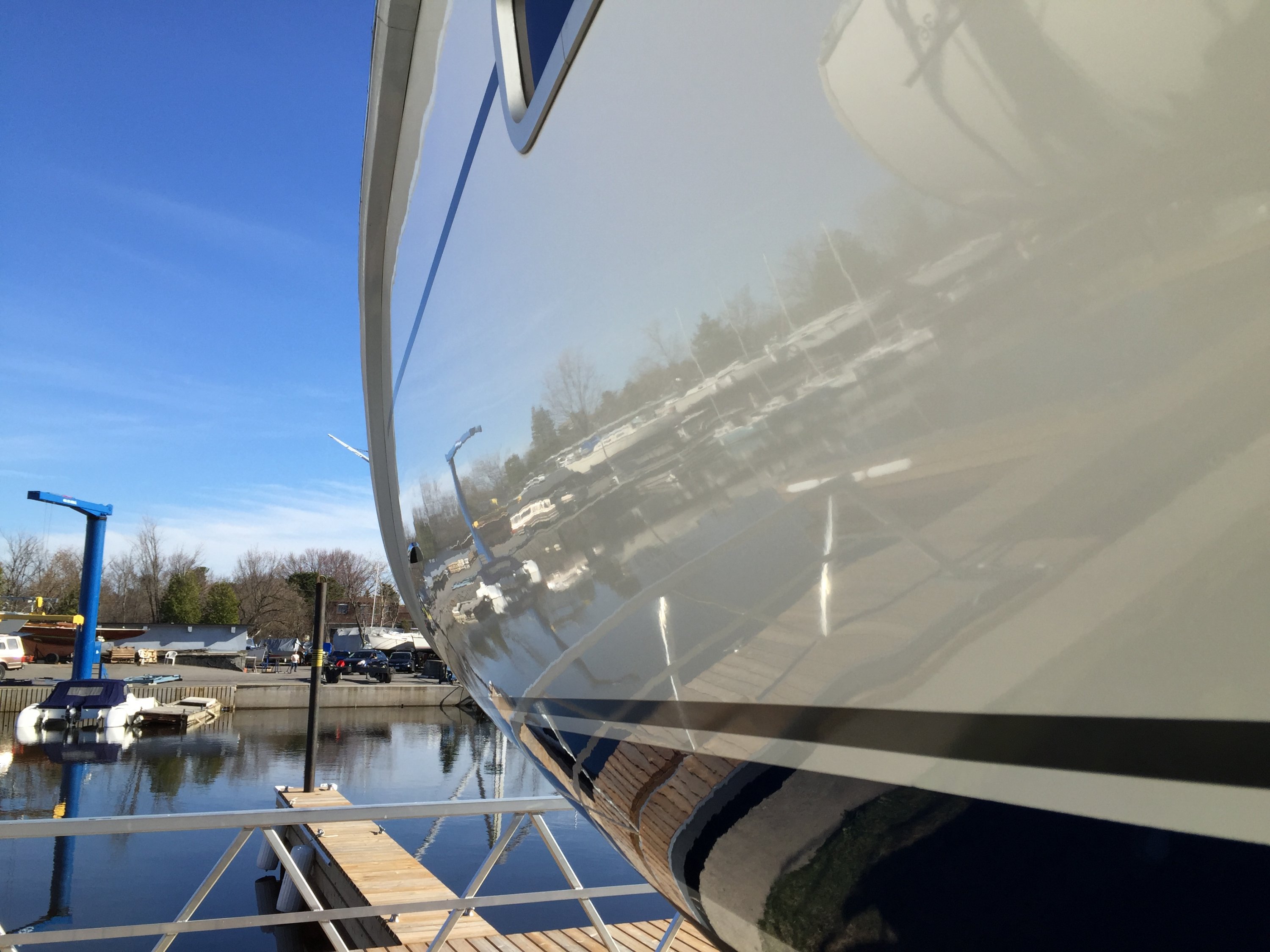

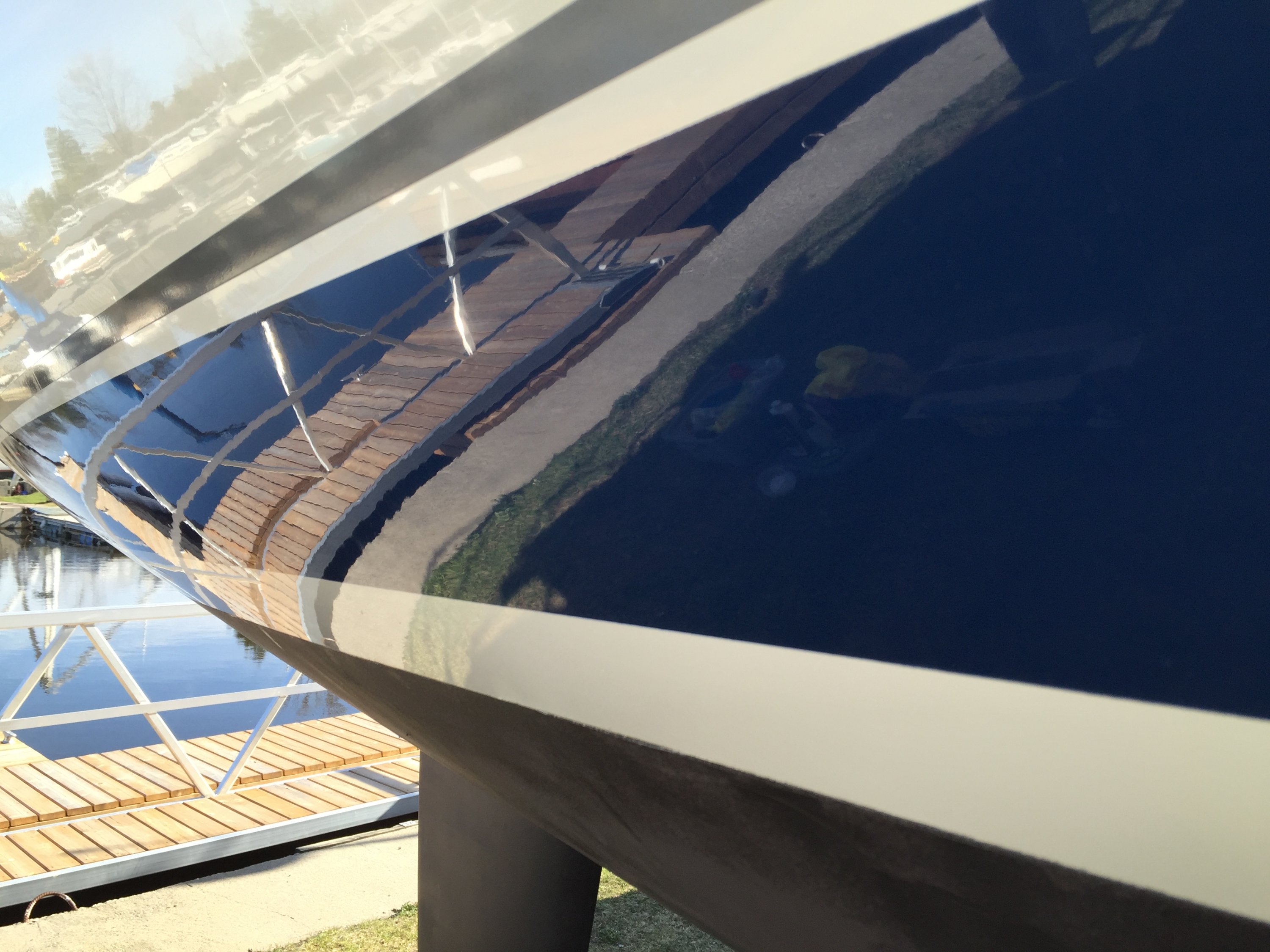

Results using Mainesail's instructions ! (I used ultra cutting crime light as well as presto chroma polish, followed by Fleetwax).
The pix say it all.....

Looks fantastic. Great job. I started from a long way back and stopped after the Cutting Creme so mine is nowhere close - but much better than before.
Now we have to keep waxing to maintain.
Enjoy.

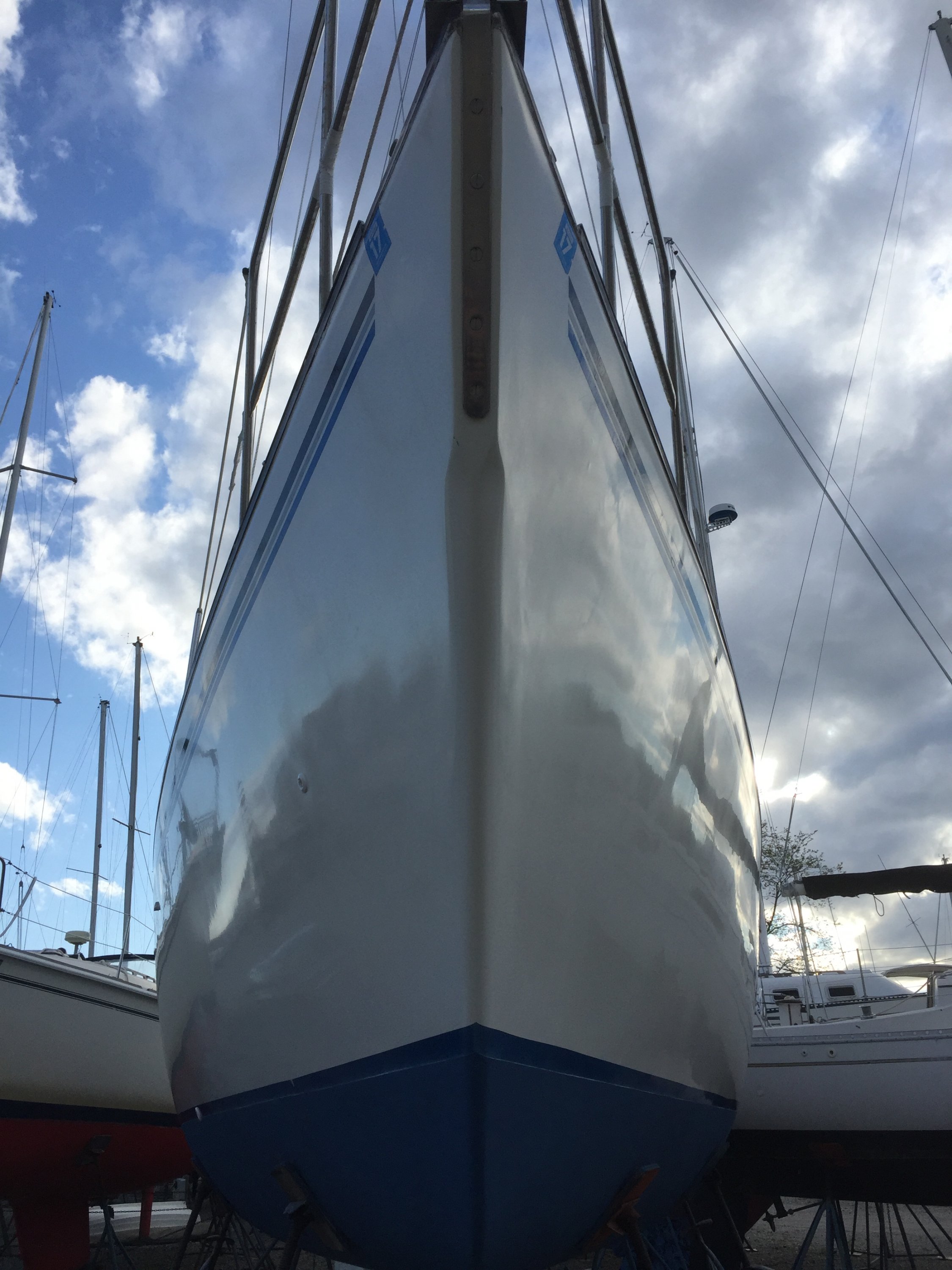

Just finished the bottom paint yesterday. Here's the result (sorry it's do dark):
