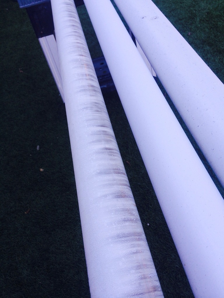

Speaking of my favorite Phosphoric Acid solution (Welding Degreaser and Cleaner), I've been using it to clean up my masts. Masts, yes plural. Discussed in another thread I ended up getting another Mast off Craigslist, the older oval section from a Pre 80's Fin Keel that ended up being scrapped. Well, the guy had another one, so I got that one too! Now I have THREE Masts... Ya'll knew I was crazy anyway. Who in the heck else would do this kind of Resto on a C-22! Just us NUT-JOBS!
So this pic shows the third mast next to the others before cleaning. It gives a pretty good idea of the DECADES of dirt, bird-poop, and other mess this stuff takes off. A pretty nice face lift for $12 a gallon; (please don't spray this $hit in your face, it works on metal, not good for skin!)

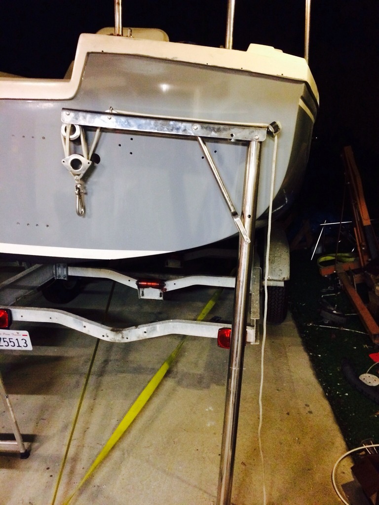

I also finished fixing the stern rail. I'm actually happy I broke it now, the new feet on the inner legs are better than the old ones because I used wider flat stock. In this pic everything is bolted down and fits up perfectly. I'll take it back off tomorrow and finish weld between the tacks. I also have to fabricate the stern light mount and drill the holes fore the wire to snake through. So not really done done, but close.

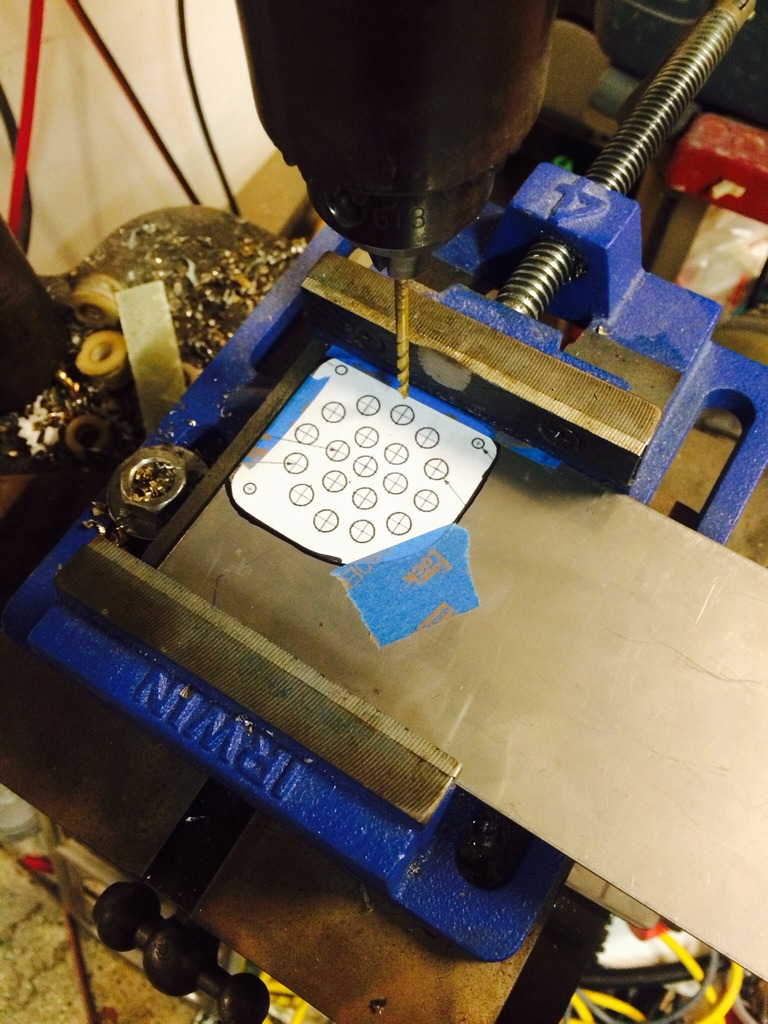

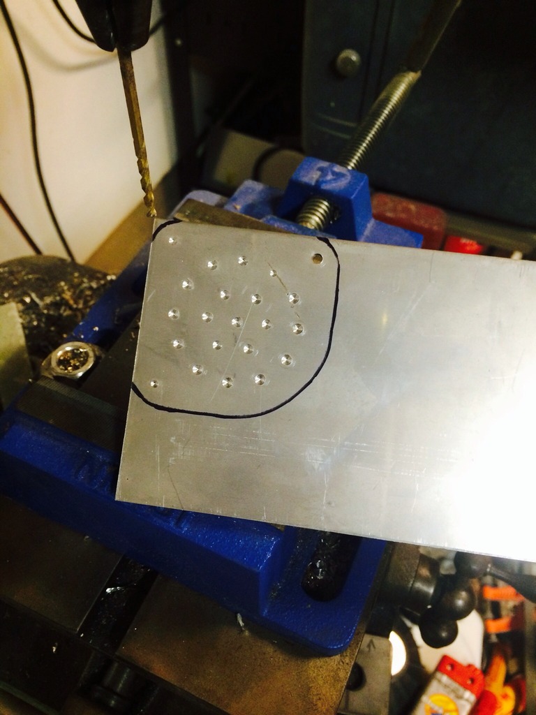

I used his printed template, cut it out and taped it to a piece stainless steel (14 Ga I think). I get these cut-offs for next to nothing at Industrial Metal Supply, months ago I picked up several of these small sheet cut offs knowing I'd be using them for backing plates and such.
I have a vintage Atlas two axis drill press table with a vice bolted on, makes drilling the pattern easy and accurate. Rather than mark all the holes with a center punch I can just use a small bit to accurately pilot all the centers;

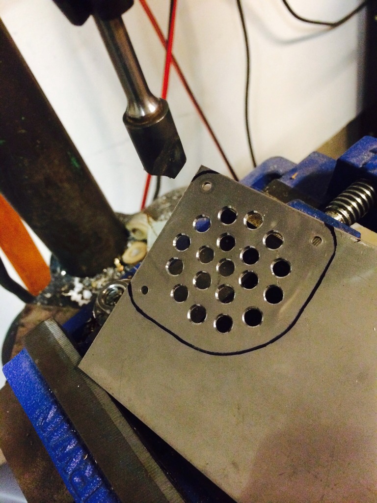

The outside line is marked with a sharpie. I'll cut out the shape with my plasma cutter after drilling the holes. here the template is removed after marking all the hole centers.

Now all the drain holes are drilled out to 15/64", then I use a counter sink bit specifically for metal to chamfer the holes lightly. I made sure to show the counter sink bit in the picture, much cleaner than trying to use a counter sink made for wood.

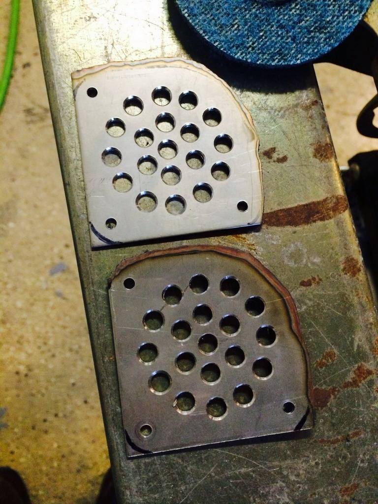

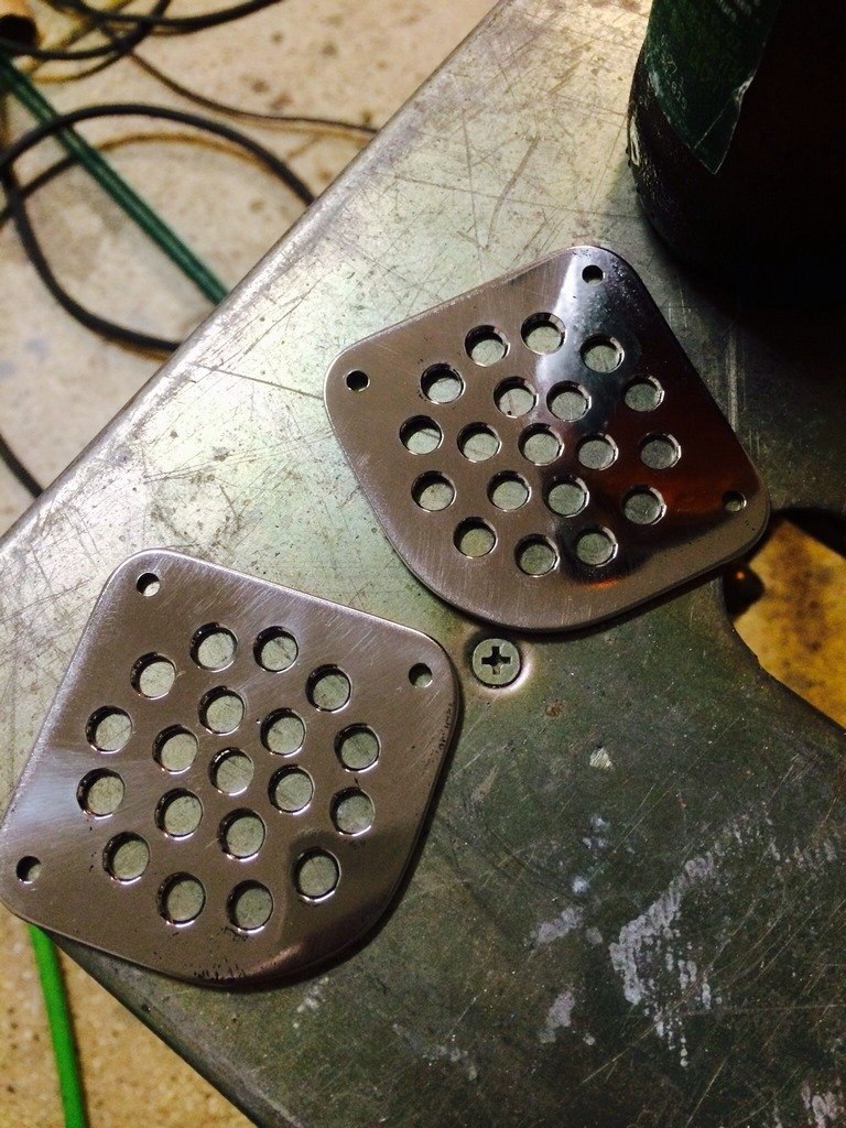

I put them on the stationary sander to clean up the lines. I used a fence to straighten the two sides then round off the corners and the main curve, followed by the scotch bride discs on the die grinder to soften up all the edges. Finally, a couple passes on the sisal wheel and then more on the polishing wheel. There are still some light scratches that should come out with a little more time on the sisal wheel and a re-polish;

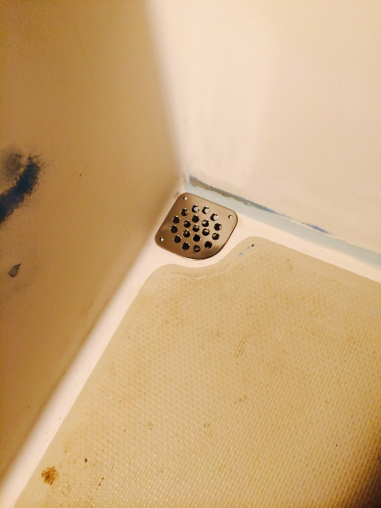

Its dark out, but you get the idea... You can see the blue epoxy filler where I've been grinding out all the spider cracks around the cockpit. Every time I finish one I find a new one!

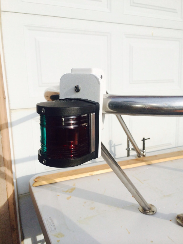

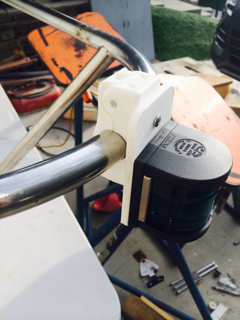

It was crazy hot this weekend so I've been doing quick stuff in the morning on the boat and then going into the garage the rest of the day, mostly cleaning up and organizing the shop along with little projects. I finally solved the problem of mounting the Nav Lights on the bow and stern. I thought I was going to weld a tang on, but that would be a royal pain, difficult to polish, and I didn't want something that could get bent or twisted and probably be really sharp to boot. So I've been looking for plastic rail clamps that I could adapt in some way to mount the AquaSignal series 25 light bodies. The version of those lights AquaSignal made that came with an integrated rail clamp seem to be extinct, besides that they were $60 each! So I remembered a post Capt Don had made about how he mounts his solar panel on his stern rail and he showed a pic of the plastic clamps. Luckily I found the same thing at West Marine for $25 a pair... so $12 for each light isn't bad. They have a pretty beefy feel, very thick marine plastic similar to King Starboard material, like a poly cutting board. I used the left over scrap of 1/4" Starboard I had from when I made the new fold down Electrical Panel to cut some small squares as backing plates for the lights. I had to drill some holes on the inside of the Nav Light body to match up with screw mounts in the clamp, but it was no problem. I just had to use slightly longer stainless machine screws (#12's I think) than the ones that came with the clamp. Turned out really nice and it a pretty easy project.
