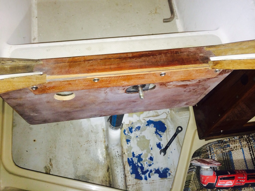

After many sessions of epoxy repair, sanding, and more epoxy coating, I've got this lined up and the threshold meets without and gap. The sharp edge where the threshold meets the inside trim was sanded to a smooth slight bevel so bare feet won't feel a sharp edge. Now I just have to finish sanding the rest of the teak and apply epoxy, followed by varnish. That will probably wait until the future, I need to start making real progress on the decks and cabin top.
I really wanted to leave off the plywood cover over the winch, I just don't feel like I need it. Plus, I like having direct access to the winch without taking things apart. I discovered that having that piece installed is actually critical to everything going back together correctly. You can see I drilled a big hole off to the starboard side of the winch handle. I made this as a sight hole so you can see winch spool and how much cable in on it or if it might be fouled. I'll use a router to bevel the wood from the back side. Another option is to make a new strip of plywood that replaces the top two inches of the panel and acts as a filler under the trim. This way everything goes back together as designed but that stupid cover panel isn't in the way of servicing the winch.

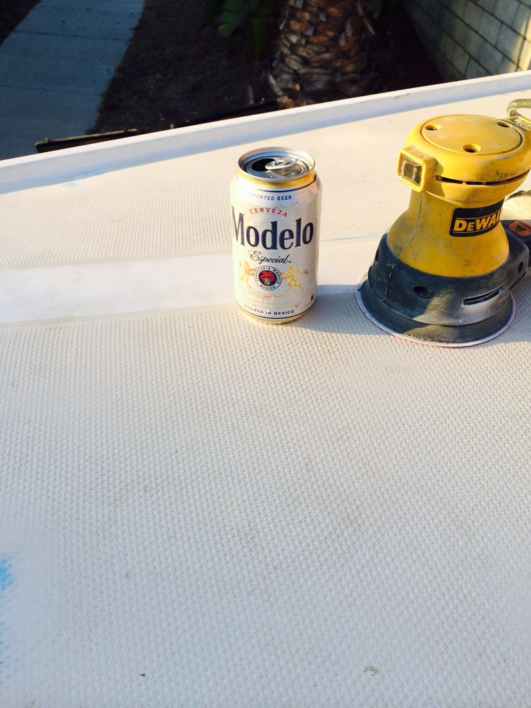

Anyway, the next few posts are the things that I did get done, mostly prep for painting the deck but I did not get to the primer yet.
This is why we can't get anything done in SoCal!

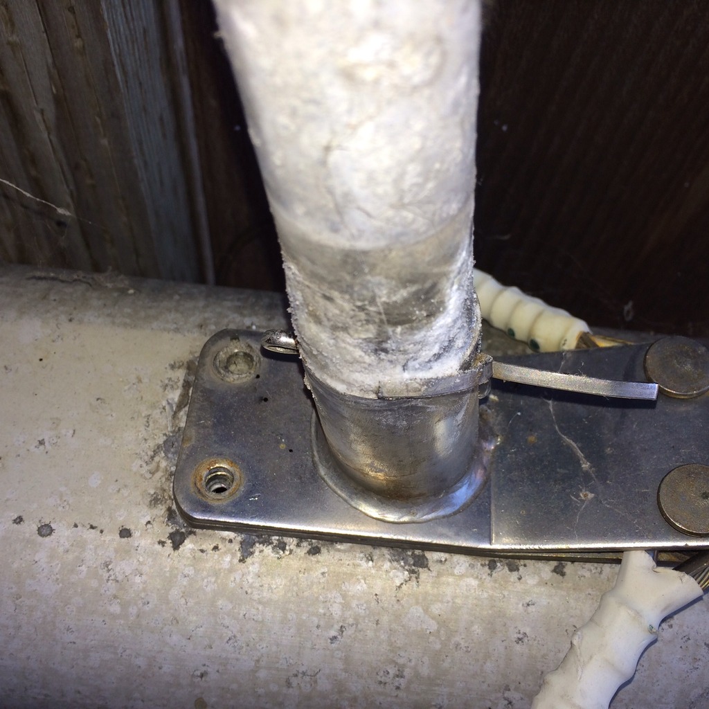

After WEEKS of soaking that dang-gum spreader bracket in phosphoric acid solution I finally got the stupid corroded spreader chunk out of the base. I soaked, rinsed, sprayed in PB Blaster, then repeated many, many, many times. Finally after the acid had eaten away enough of the corrosion and much of the aluminum as well I drilled a big ol hole in it, put it in the vice and ran a large sturdy T handle screwdriver through and finally turned the sucker out. The pic isn't the best but you can see the amount of crap that was built up and where the acid was eating away at it.
This was how it looked when I took it off the Mast;
