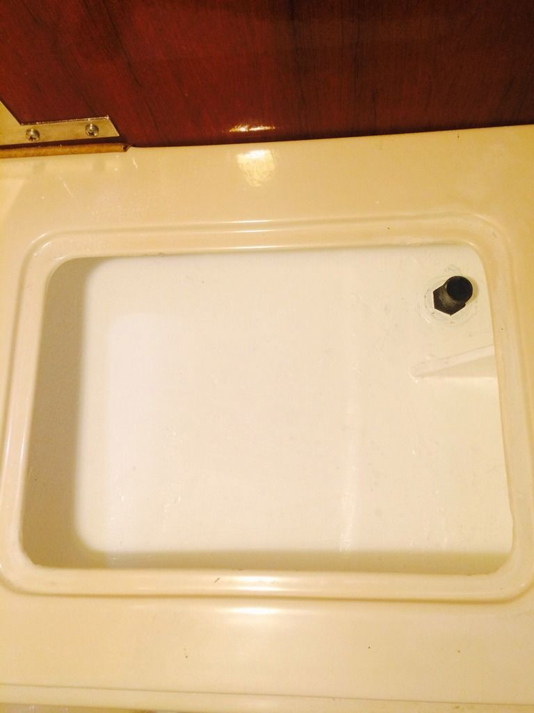

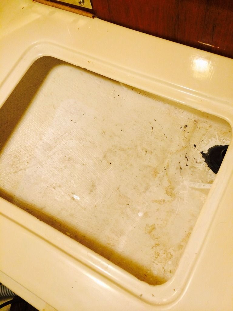

Painted out another bilge/locker... This one is under the port seat where the keel lockdown bolt is. I remembered to take before and after pics for this one;

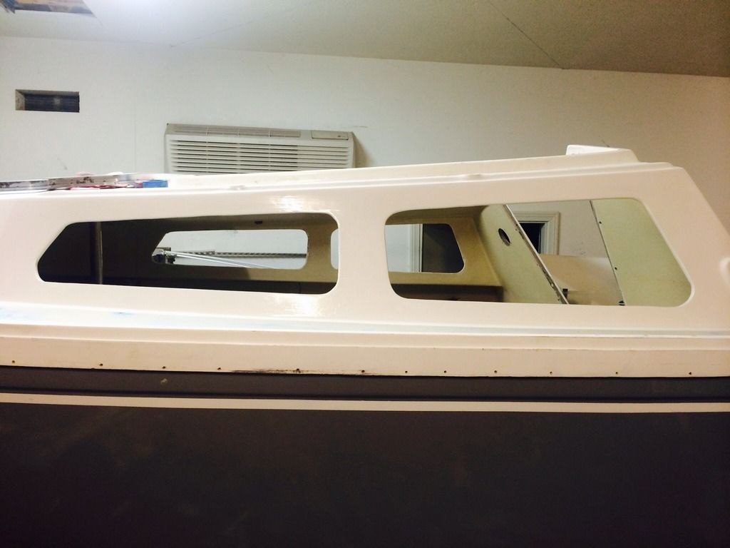

I also finally got around to the window openings. You might recall (and there was a separate thread on this) I filled the gap between the outer cabin and inner liner with plywood strips and epoxy, stiffens everything up nice. I finished out the shape and used a little filler where needed. I double checked the fit of the windows and then brushed on a coating of G-Flex epoxy to any edges of exposed plywood. When that was all set I did the final sanding and then taped off the inside and painted everything with two coats of primer, brushed on pretty thick. I made sure I coated the inside edges as well and they will also get Gloss White Brightsides when I paint the cabin. I want to be sure if there is ever a window leak that no water could get into the plywood or between the fiberglass.
The Prime Kote primer for bright sides is awesome, when you can't afford to be super neat with primer you can just brush it on thick and then it sands out very nice with 220 and then 320. The first sanding will expose any nicks or other junk that needs filling before the Brightsides. I like this pic, makes me feel like I am finally getting somewhere!

What's fitting for, in the port seat photo ?
That's the thru-hull for the old analog wheel knot meter. Now I am really wishing I had removed that and filled the hole, its pretty big. I have 2 plugs for it that came with boat, double O rings and a stainless pin that secures it.

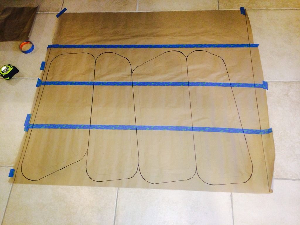

Bingo! Yes, upon further reflection (and making the rough pattern) I've figured that I can get all four windows from a 48 x 48 inch sheet or smoked acrylic from my local plastics supplier. 1/8" is $70 and 3/16" is $105 per 48 x 48 sheet, so I have to decide on thickness.
If I can get a drawing done on a computer I'll have it printed full size at Kinko's and just put on the sheet's paper layer with 3M spray adhesive. I still need to install the fence on my bandsaw but I can also set up cuts with my circular saw, clean up the rounded edges on the stationary sander. I need to find a friend who has a table router to do the bull-noses around the edges or buy one cheap off CL.
I figure the re-seal kit from CD is $80 plus shipping so I'd be spending the same money even if I go with the thicker material. In the rough template pictured I went with 1 & 1/8" overlap around the openings, so I need to figure what is best... I had considered as little as 1 inch or as much as 1.25". I've been reading several posts across the forums about doing these windows and with the correct adhesive (DOW product) which allows for 700% elongation and flex I will put them on without screws or through bolts. Everyone says the screws or through bolts will cause cracks and leaks when the acrylic expands and contracts.
Anyway, I figure this will go really with the modernized look I've got going with the stainless compression post and the new hand-rails. I'm also excited to not have fudge around with cleaning off all the old butyl tape from the old windows, plus paying extra to get them tinted. I might sell the window set to recover some costs, i might hang on to the 'just in case'.
Does it have anything to do with black acrylic? :wink:
