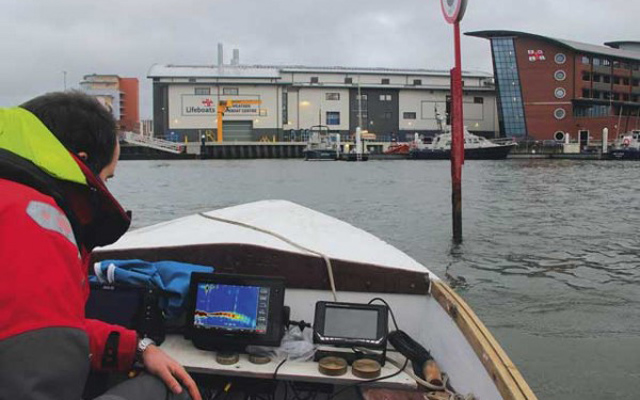

Would that be forward viewing sonar, from what I have read it is not quite there yet, but it is an improvement over just looking downward.
This is the article I was referring to on forward looking sonar evaluated by Practical Boat Owner
I saw an ad for it a few days ago, I think it is just shooting straight down.
Looks like the primary lesson is there's a learning curve to interpreting the readout. I'm leaning towards the Garmin but not the Panoptix setup.
