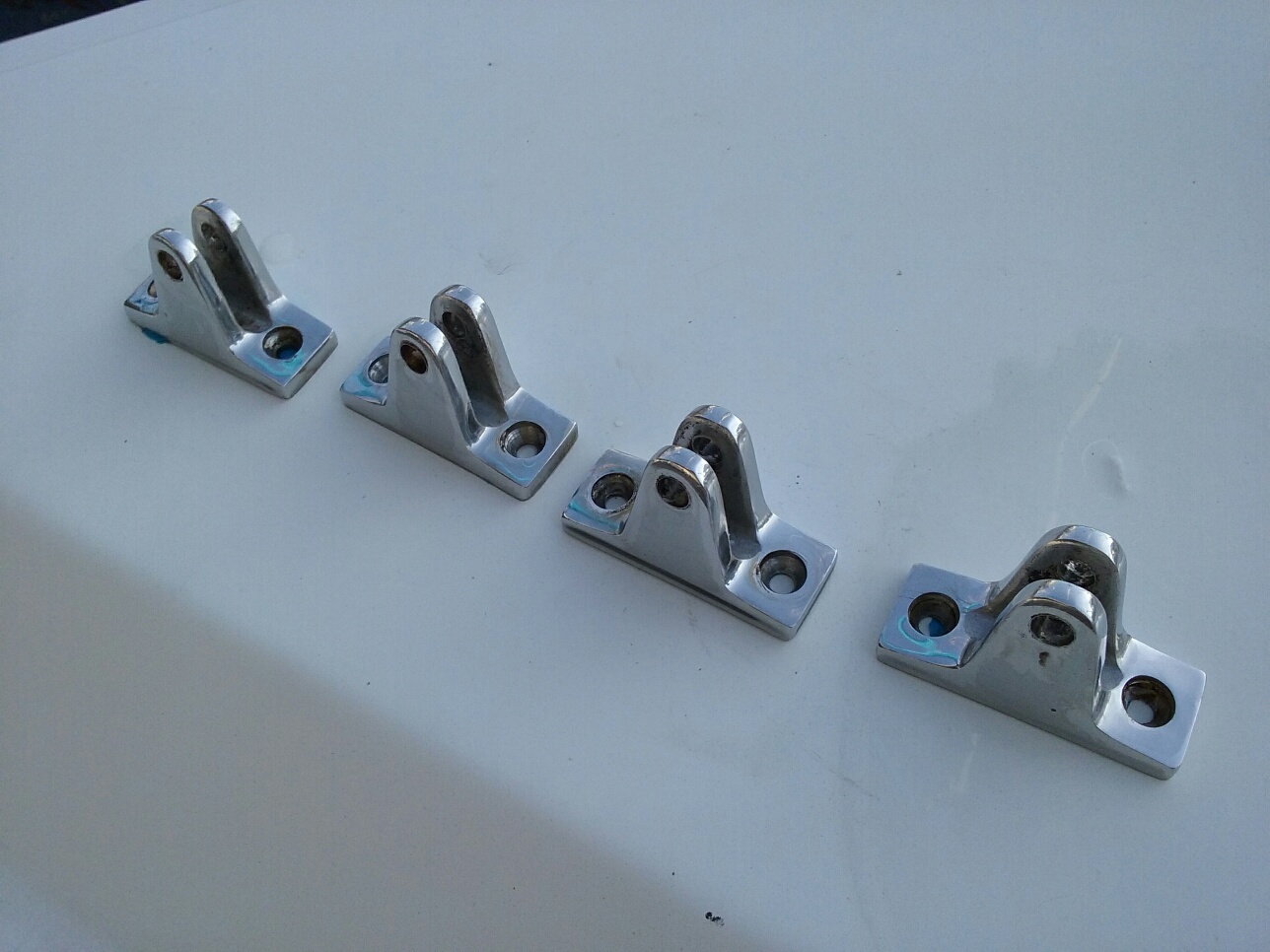

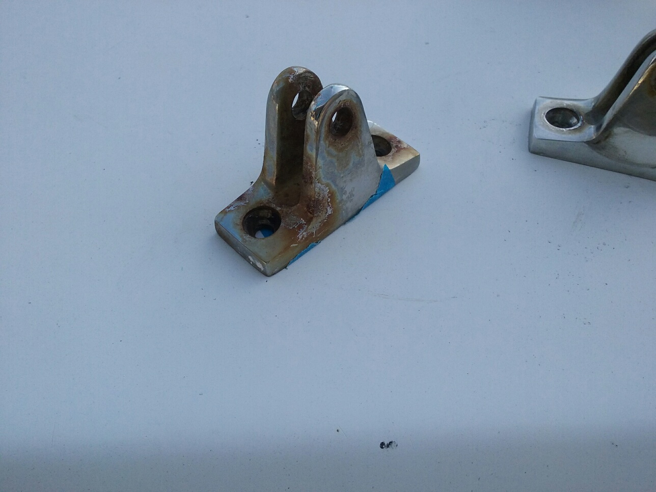

Looking great Mark. As for the stainless, have you ever tried Wichinox Passivation jell?
https://www.fisheriessupply.com/wichard-wichinox-stainless-steel-etcher-cleaner
I use it on all my stainless and have been amazed at the results. here are some before and after photos of the mounts for my dodger. This was done by wiping on with a piece of terry cloth, letting it set for about 20 minutes and rinsing off.
That stuff is very similar to what guys in the beverage industry sometimes call pickling paste. It's an acid that eats the free ferrous molecules out of the surface of the stainless. You need to be a little careful when using it & you will want to wash it off as quickly as possible if you get it on you, but, when properly used, it does greatly improve the corrosion resistance of many grades of stainless. It will probably surprise many people to learn that properly passivated 304 or 18-8 actually rates much higher on the nobility scale compared to unpassivated (active) 316. http://www.duncanbolt.com/images/metalschart.png
I had never heard of this before - intriguing! I went to the link to get some but they are out of stock. I'll search for another source.
Good info on stainless properties. Thanks!
