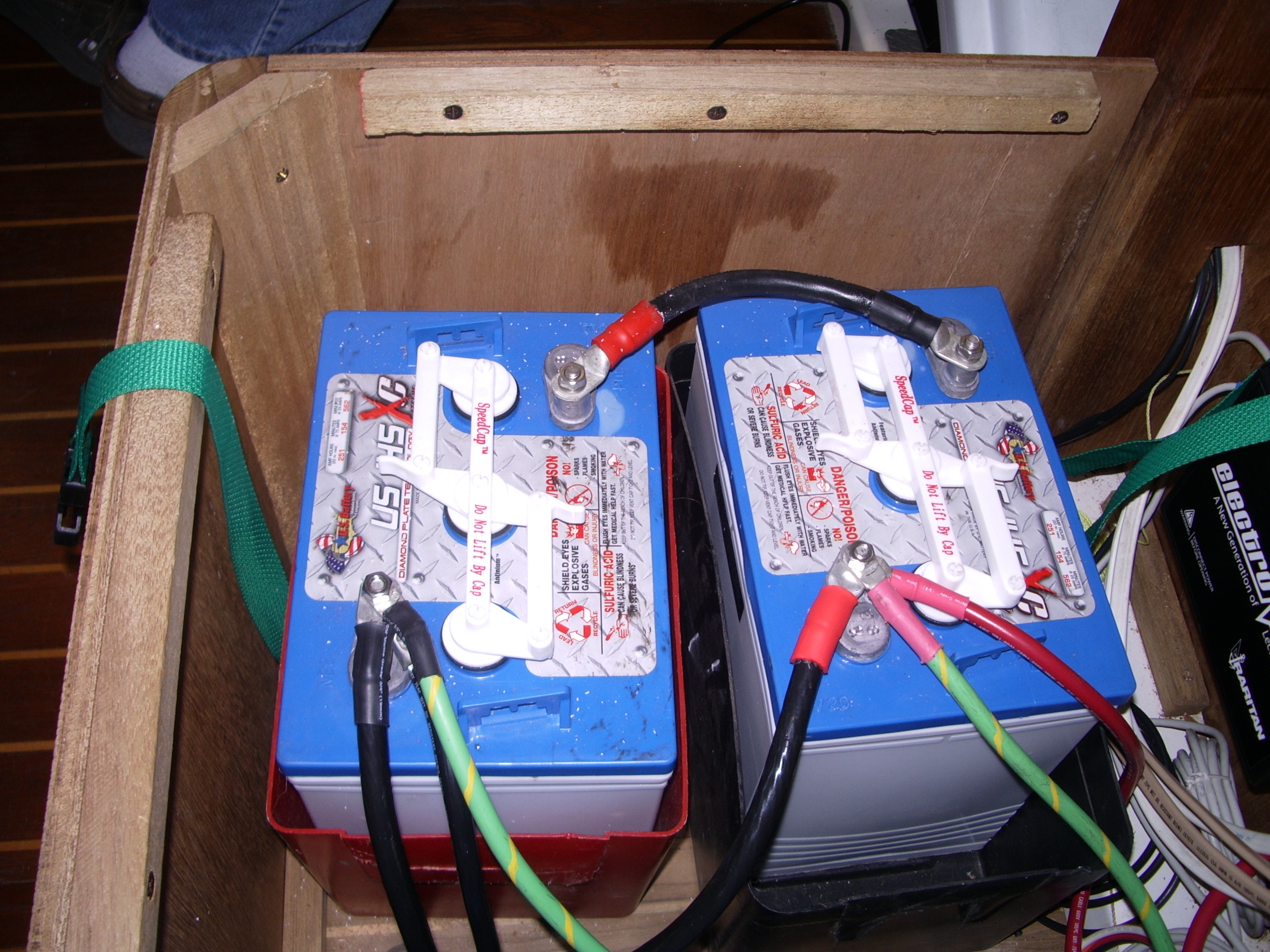

I like Hayden's dimensional analysis of the corner joint. I have a similar vintage H34 and a photo of one of my corner joints. It looks like Hunter only used 1/2" stock for the side panels and backed the corner with a double mitered piece screwed in. I don't know the radius, but just wanted to share the detail I somehow miraculously had a picture of.

i see much thinner plywood in Allan12210 picture. That would be lighter and would also provide for a wider supporting structure on the corner. Great analysis folks. I am positive with the work displayed thus far Mark is already on it.
