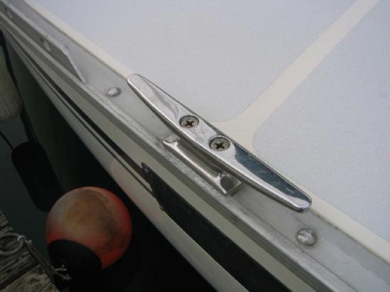

This is what the ones currently on my bow look like.
