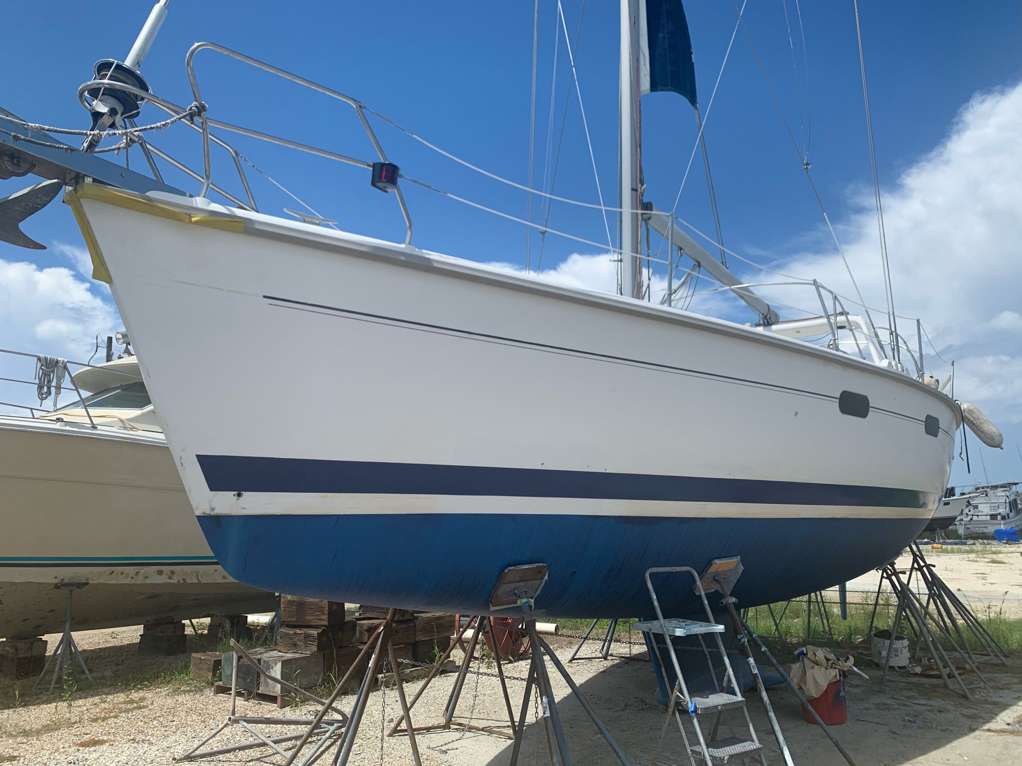

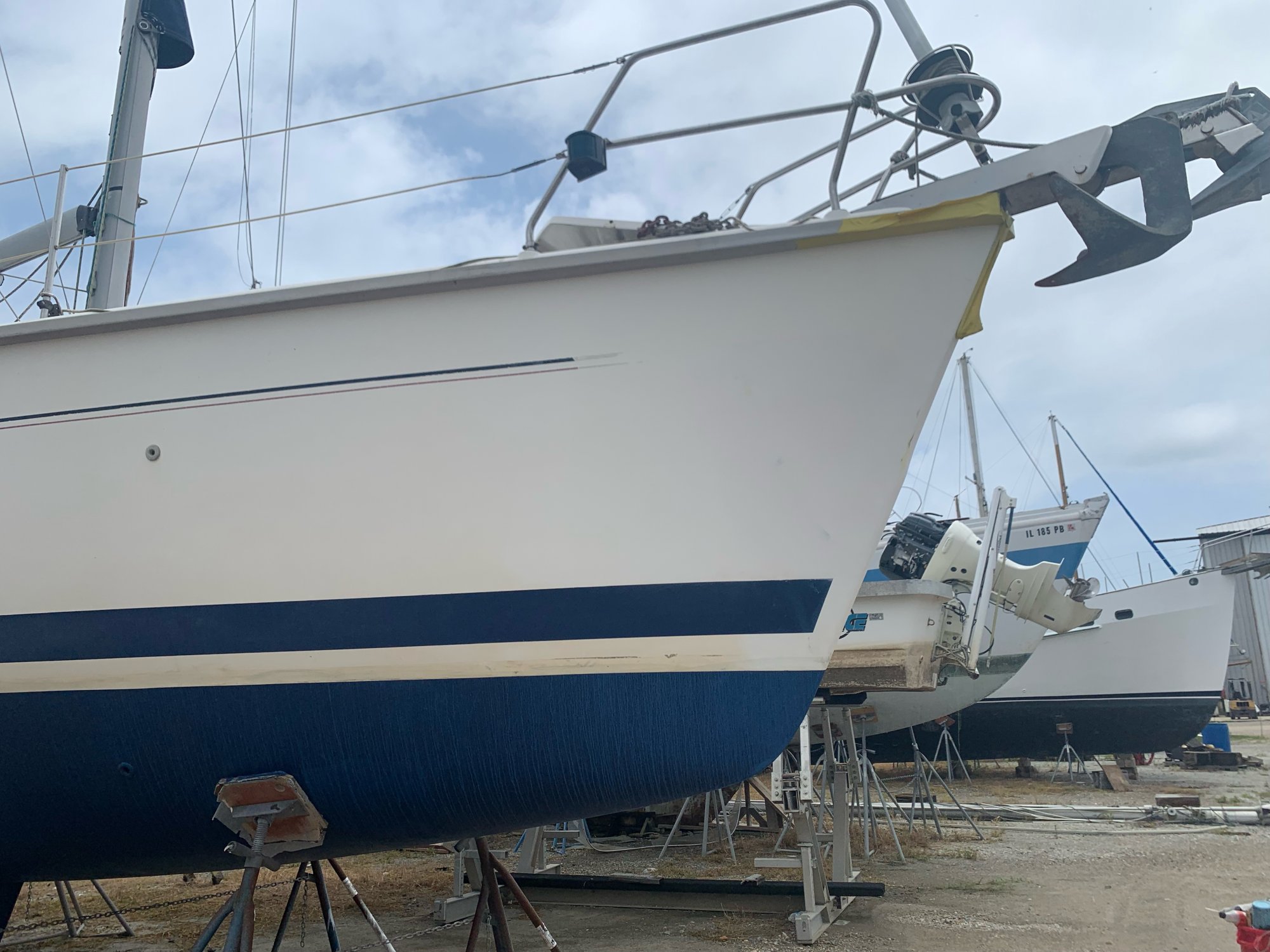

More progress as the second coat of Bottom Paint has been applied and masking tape removed.
Admiral Sue noted the white streaking on the Dark Blue, but I assured her not when finally done.

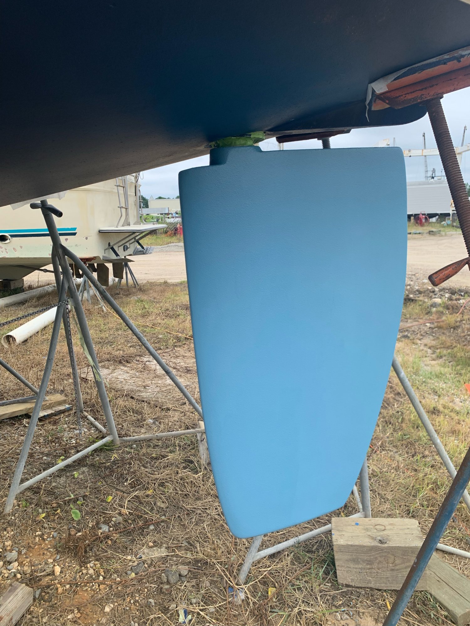

Finally the Rudder got painted too. Per Foss Foam's painting instructions to prevent the foam core from expanding.
Why did we tint White Ablative Paint Light Blue [also 2 coats] ?
The propeller wash will remove that Rudder paint over time, revealing the White Gel coat over time.
When we start seeing a lot of White, it will be a good indicator of needing a new painting [hope 5 years].
We added some of the Dark Blue to tint the White that shade.
The yard is a Pettit dealer and never heard of Vivid Colors so he had to buy it from Amazon. :facepalm:
So good thing I am doing our Research on the boat.:biggrin:

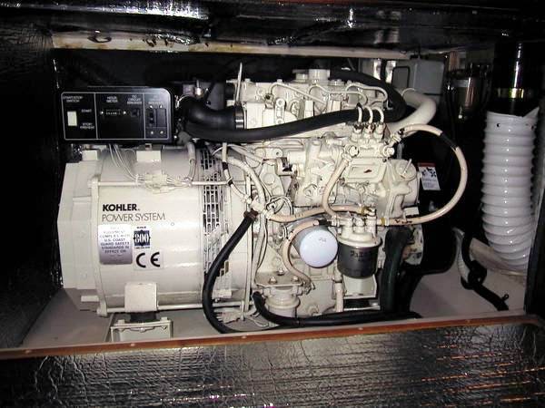

This is what it looked like when we bought our Boat.
Note the Silver insulation that was surrounding it for noise and heat reduction.
Also the White flex tubing on a fan that pulled air to the outside.
Total weight of that unit = 420 lbs on the Starboard Side offsetting the Port side Galley weight.

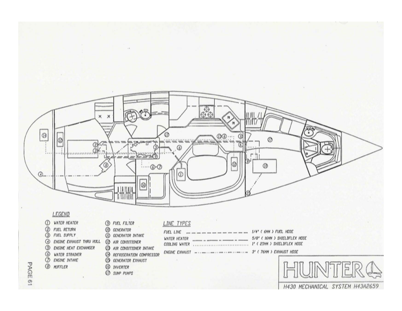

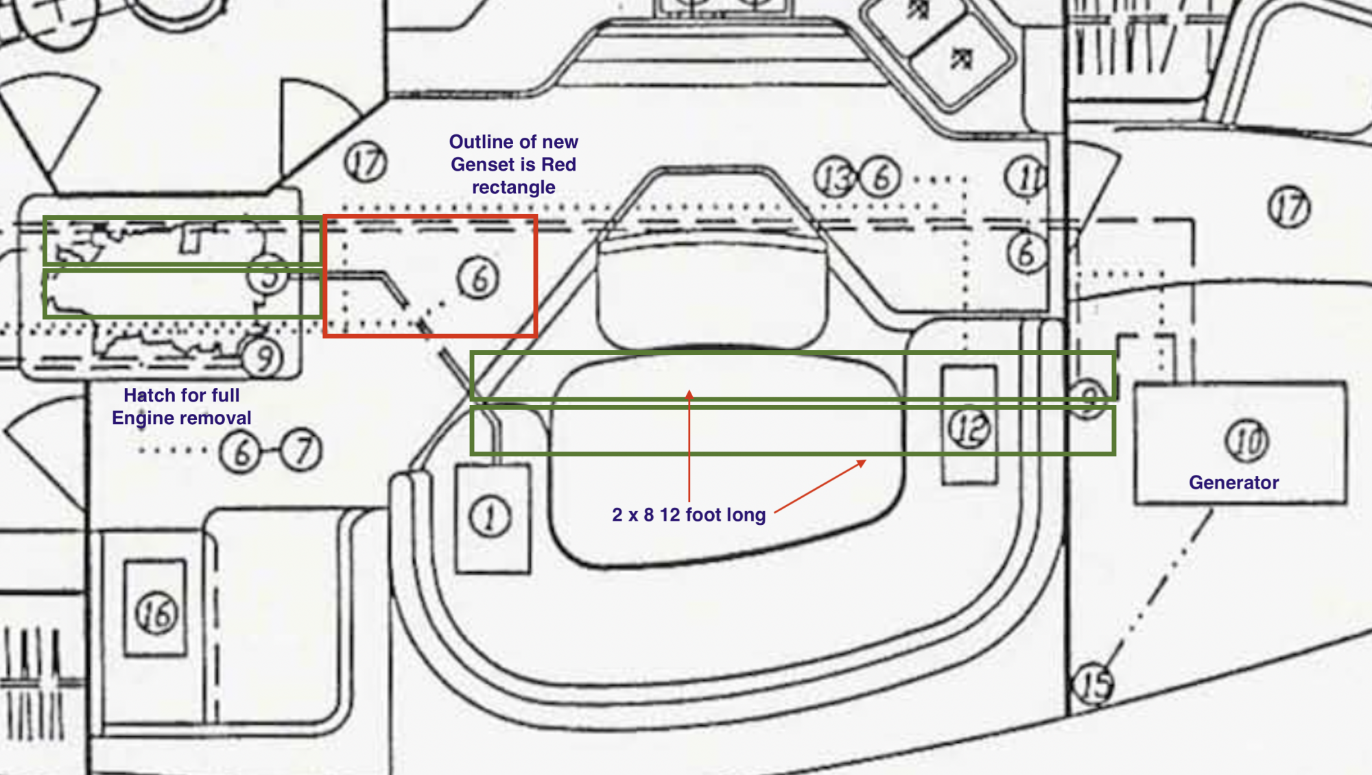

This is the boat layout...
Item 10, which is under the Queen size front Bed in a Private cabin.
Item 3 is the 50 HP Volvo Penta Engine which is important, since the Engine is below the opening to bring a new
Generator inside.
Good Design by Hunter, to remove the Engine by a single direct lift, if needed.:)
This is a sleep 6 boat, two private cabins and the Dining Table slides down for the second not so private berth.

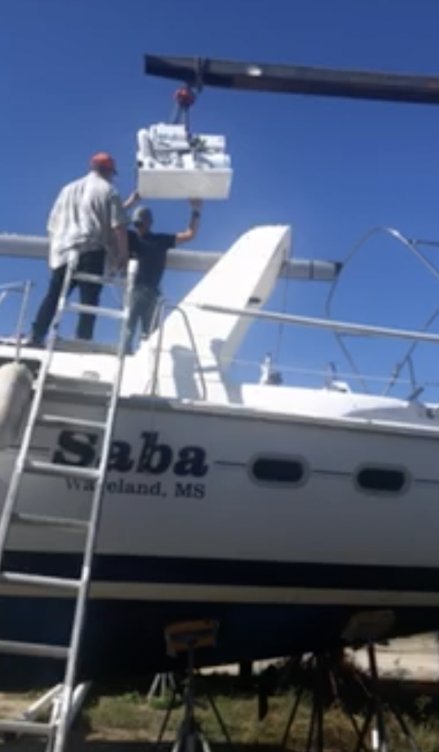

Finally the old 9kW Kohler Genset is off the BOAT!! :biggrin::biggrin:

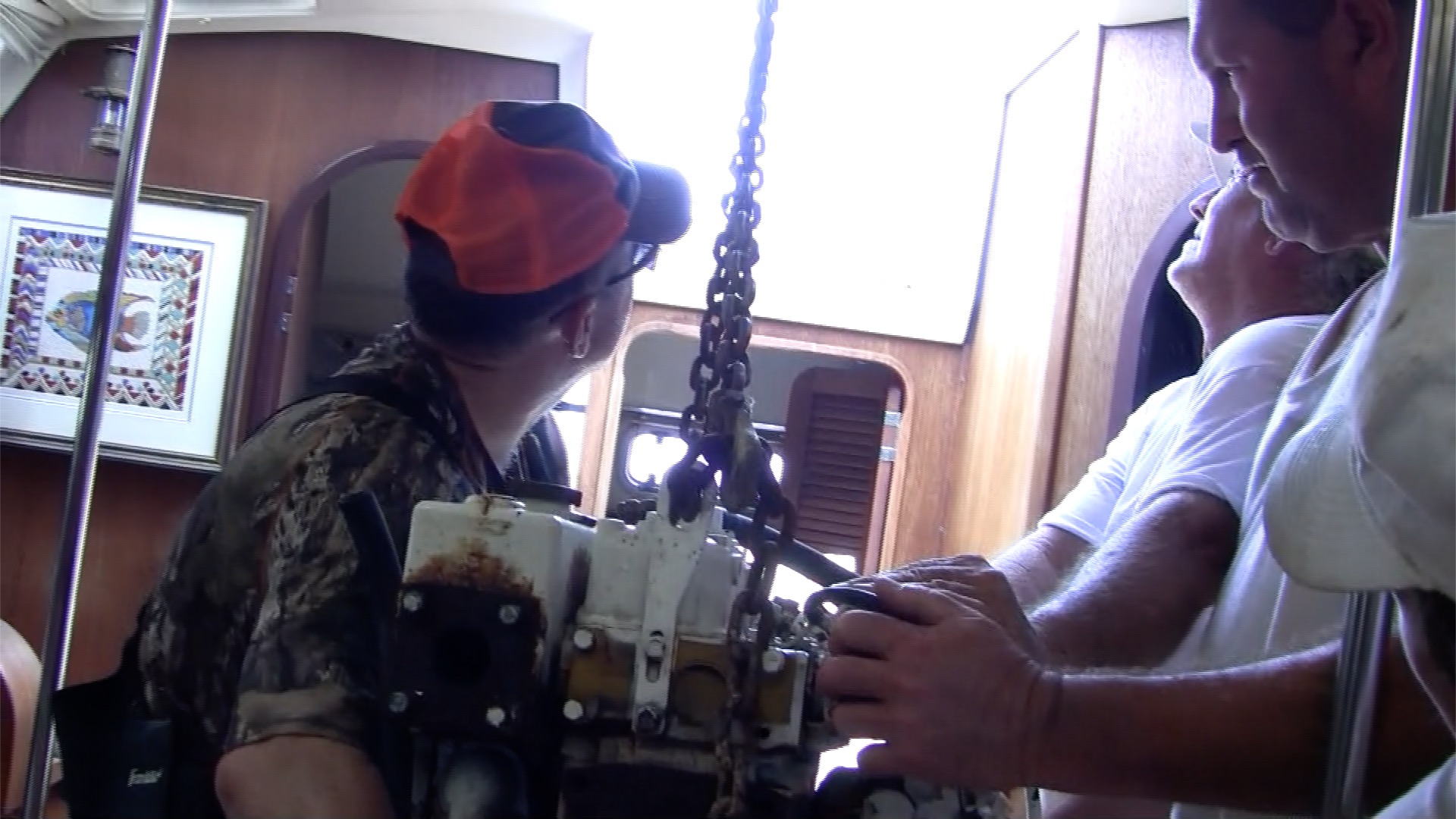

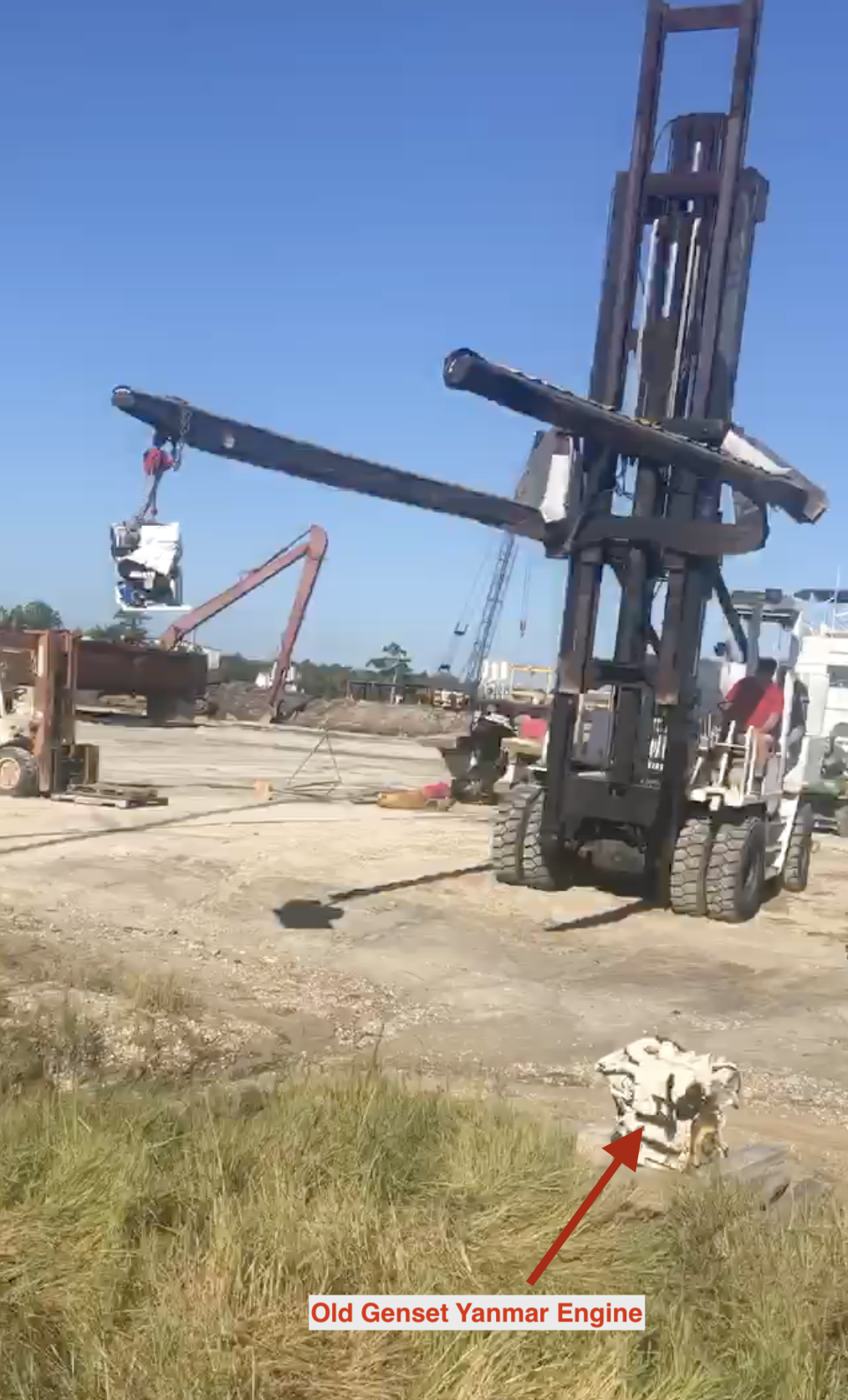

Several people input to the method we used to the move the 16 HP Yanmar engine.
This was the plan.
Move the 220 lb engine to the Hatch for crane lift off the boat.
First of all NO ONE GETS HURT!!!

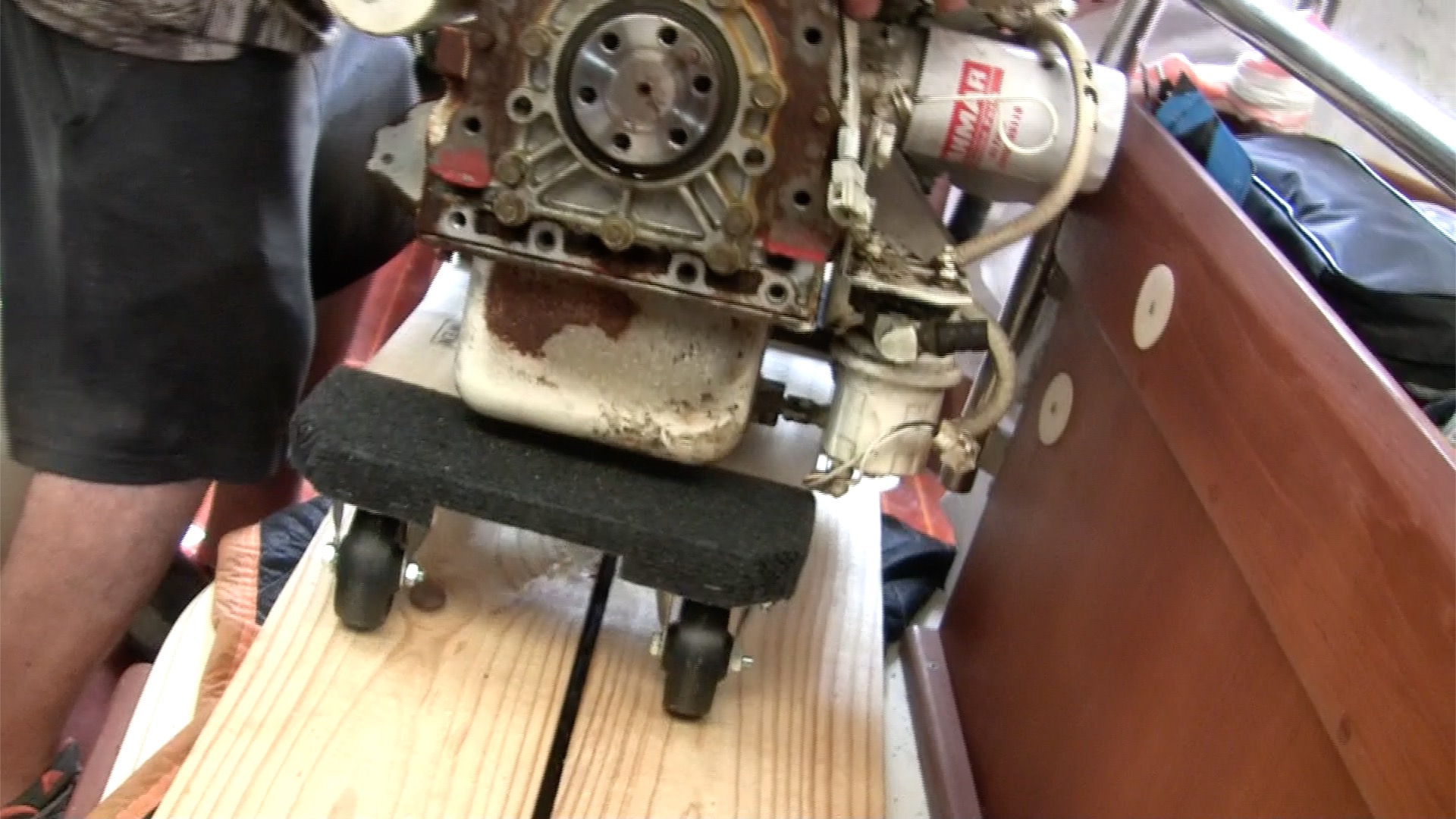

We used a 1000 lb Furniture mover.
Three guys made the hand lift to the Furniture mover and rolled to the Hatch.
I have great Movie of this and may can load it to SBO.
Please note the Captain [me] giving the orders, the Crew working...;)
The Yard provided the lift and the Safety once on the Crane
Hooked chains thru the Lifting Lugs on the engine.
And safely off the Boat.
No damage to boat or people!!:clap::clap:

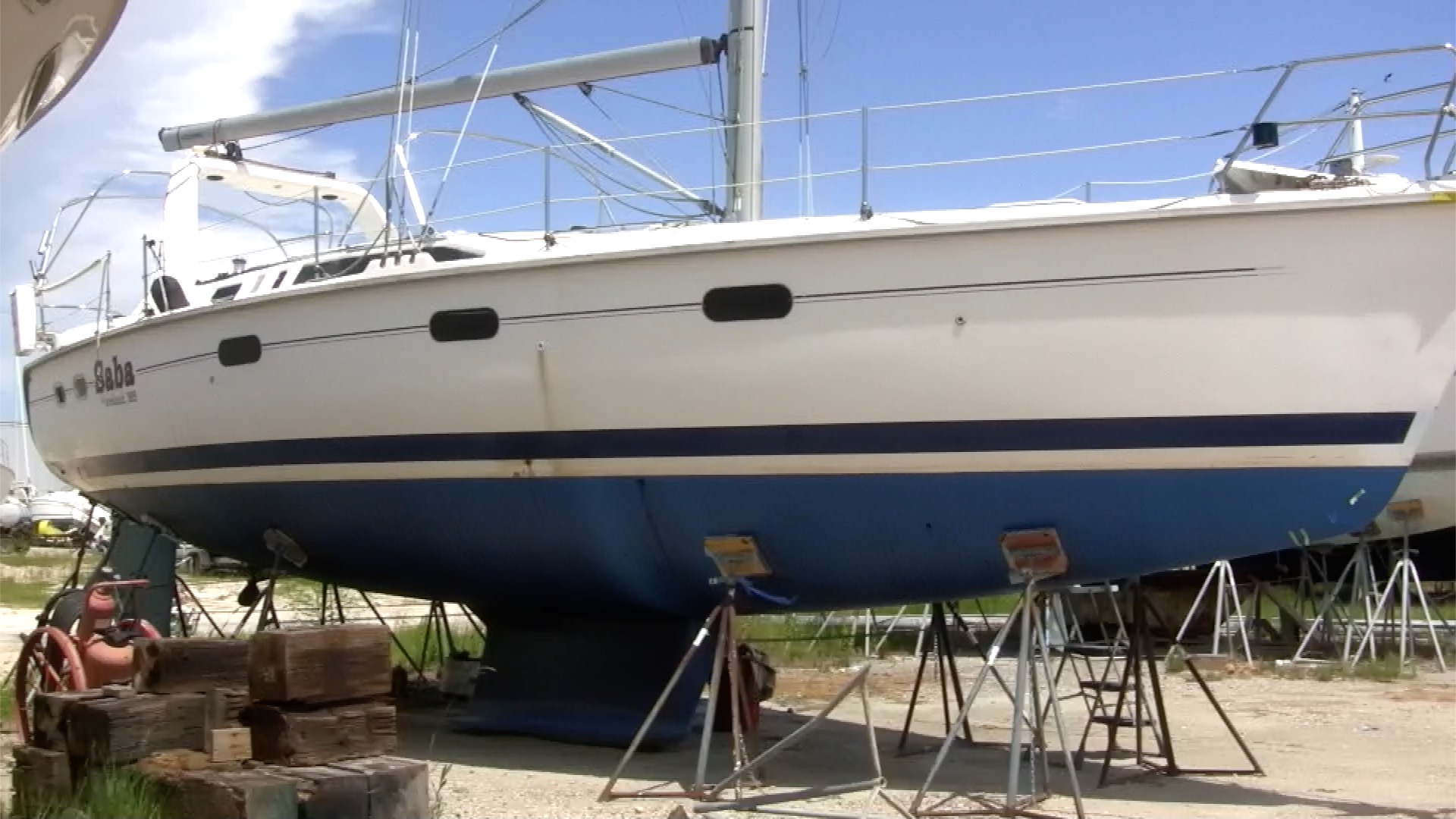

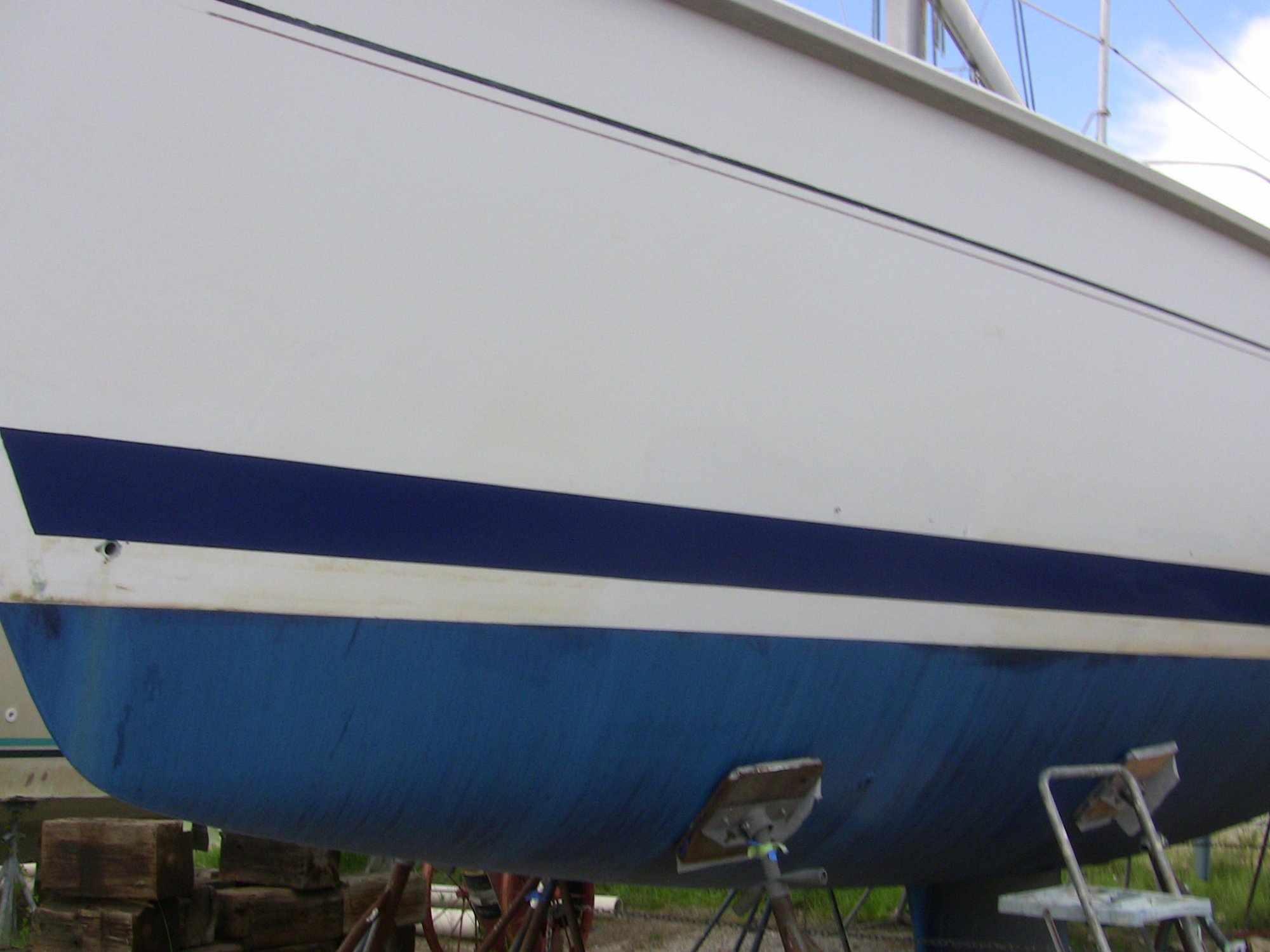

Hull repairs and Gel Coating 98% done!!!!
I wont repeat the pictures of the Port Side Hull damage, but see them on Post#92 [page 5] above!
The white streaking on the new Blue Bottom paint is the Dust from Gel Coat polishing.

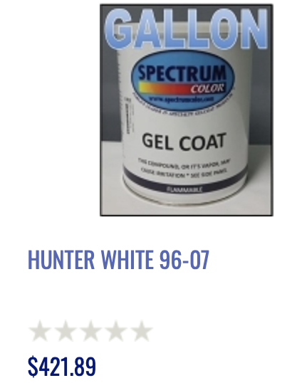

For those wanting to know how Hunter Boats Gel Coats colors were matched
This provider of Gel coats.
Welcome to Spectrum Color - The Worlds Leader in Specialty Gel Coat Products
We selected the boat year for Hunter Blue and White.
"96-04" are the years used by Hunter.
The price per gallon were same for the colors.

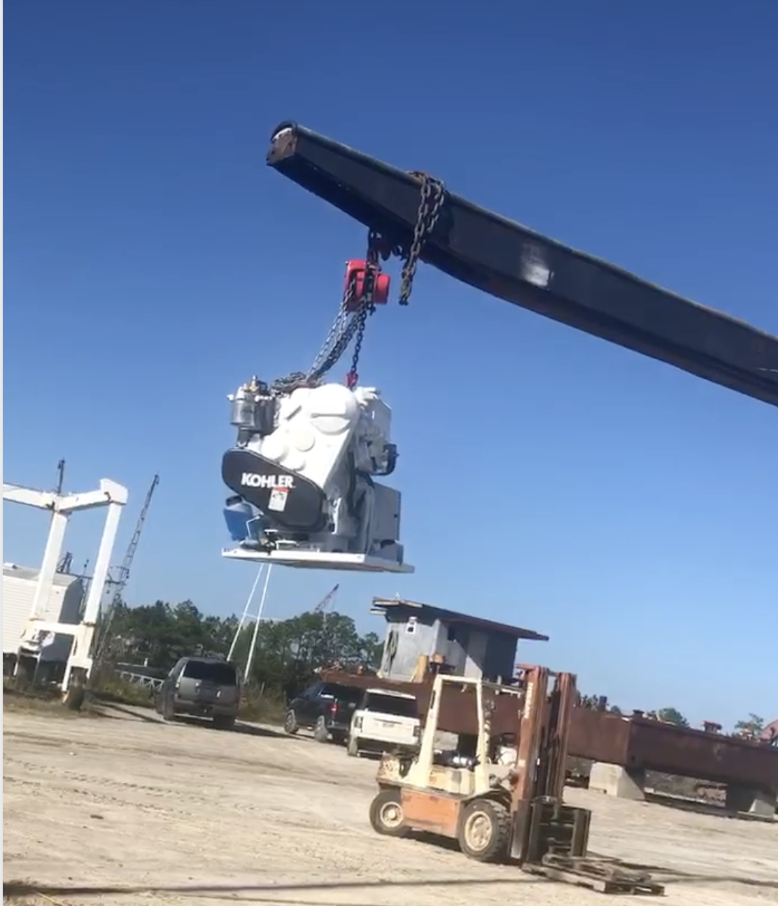

I did a full movie of this and will post to
Rumble
Where I can monetize it $$ :pimp:

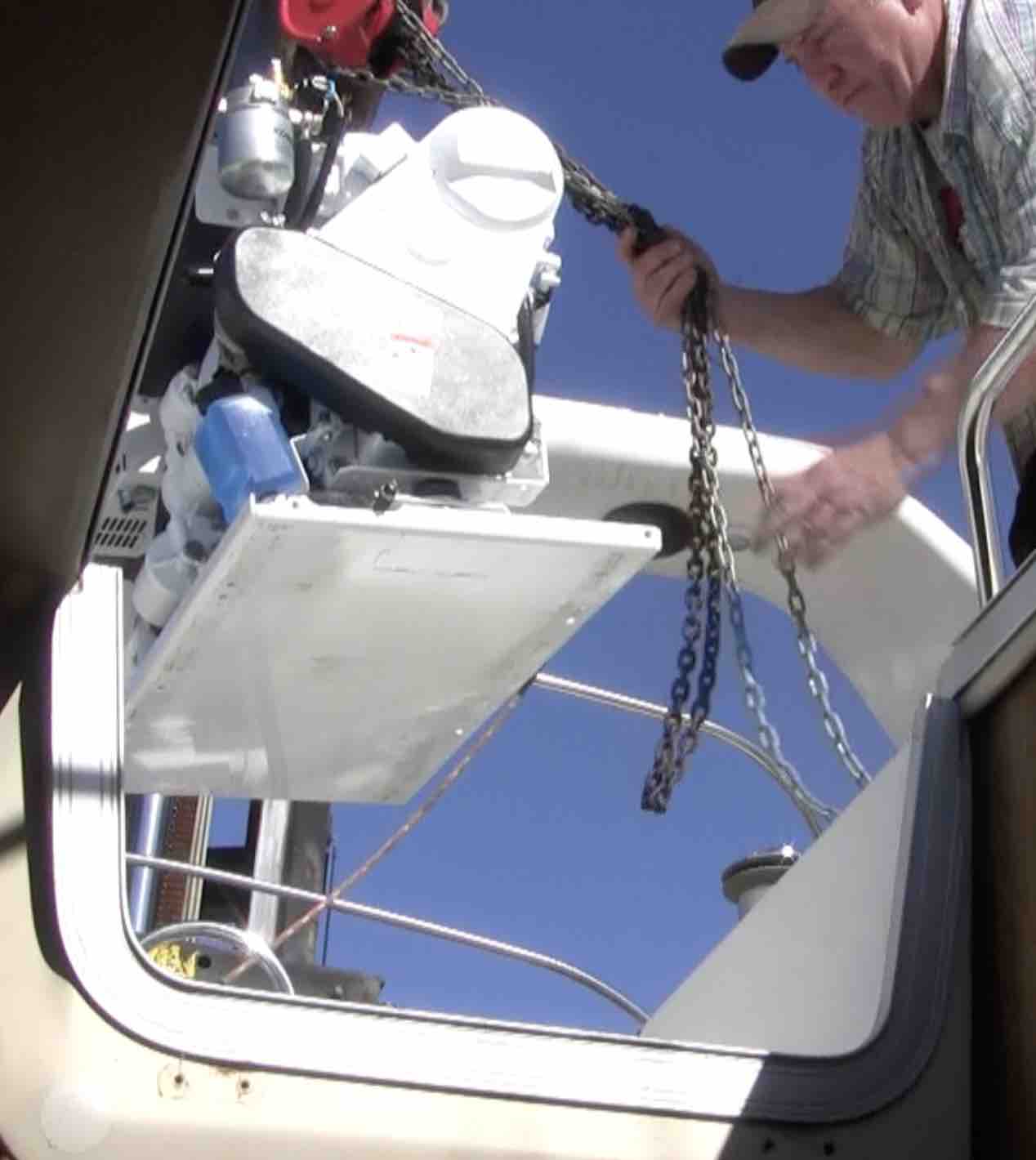

But to start off.
Now the fun begins...
Opps the Yard's lifting fork is too Short for full reach.:facepalm:
The boat opening is directly adjacent to my Helper [Ronnie with Red Hat].
The other guy is part of Yard Crew.

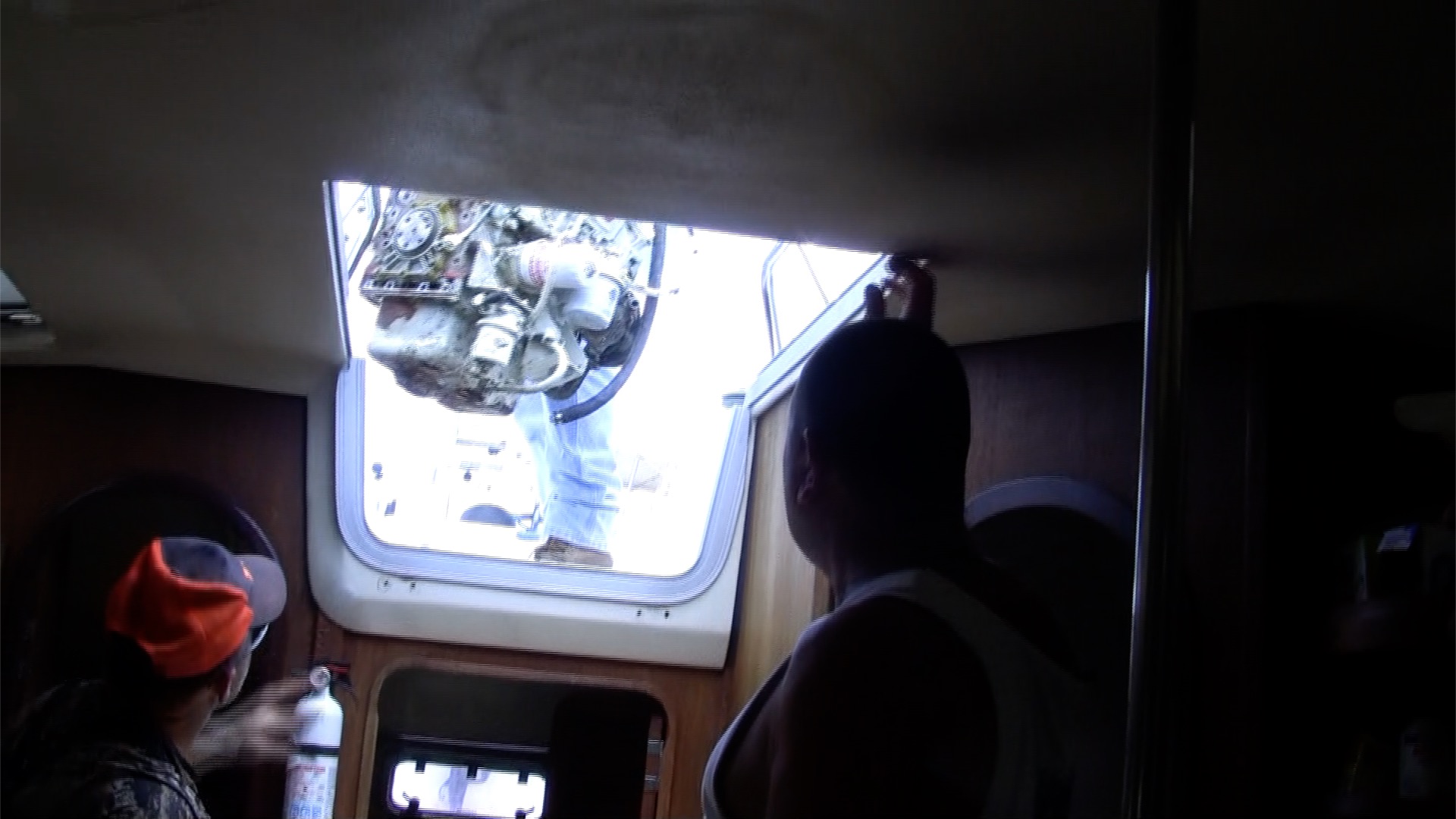

We slowly lowered it to the Companion Way Hatch.
This is my View from Inside the Boat.
The next part is too complicated to explain for now.
But I will not keep you waiting

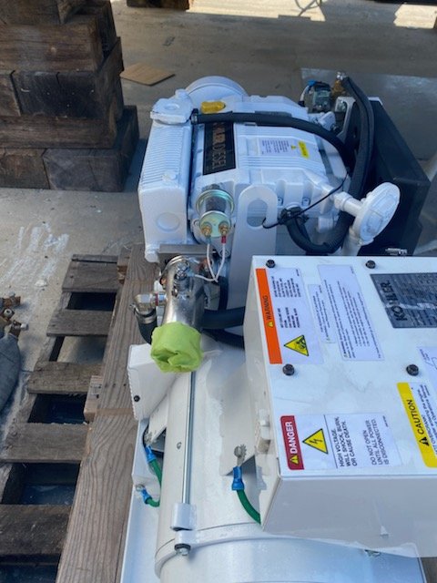

The new Kohler 9KW Generator is on the boat, safely and done.:clap:

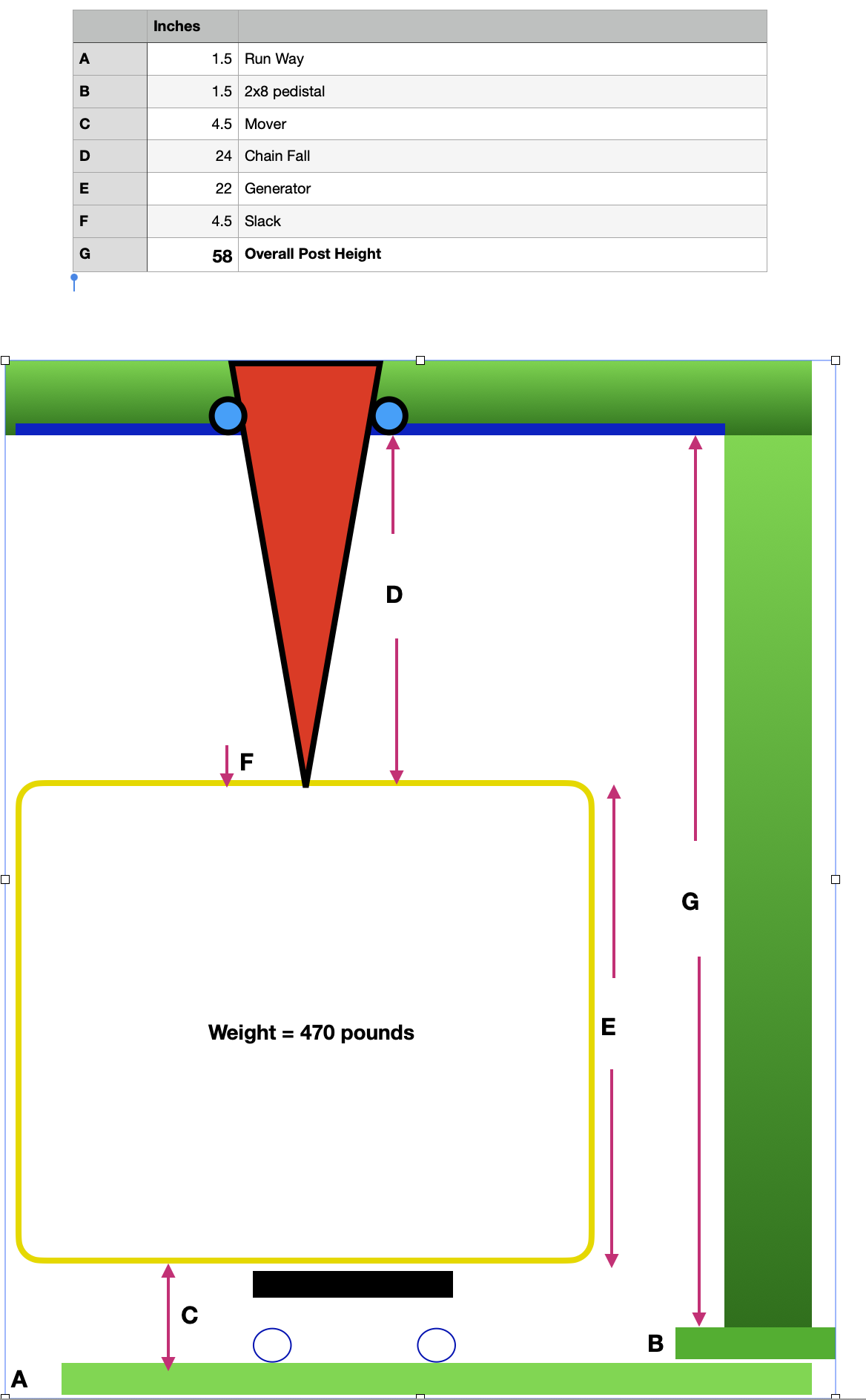

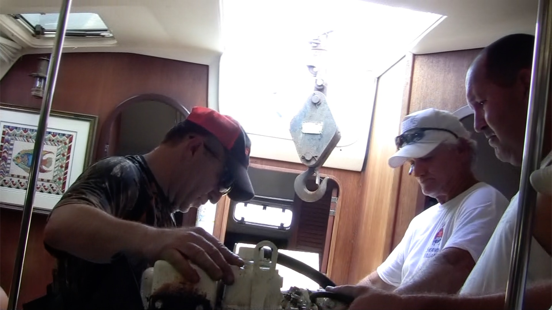

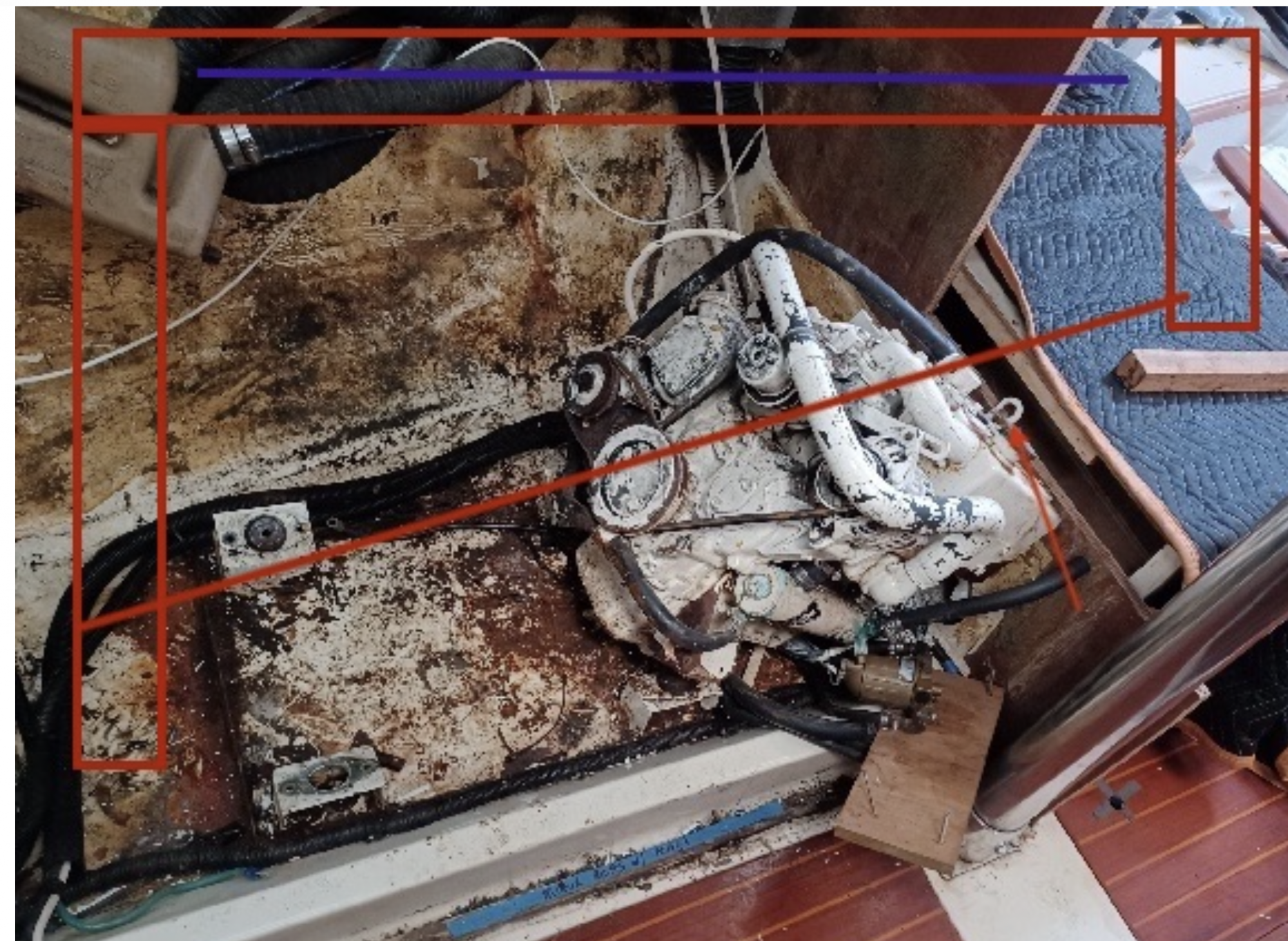

We had many helpers and extra brain power to design the hoist inside the boat.
This was the conceptual design to build a Tram Way.
Horizontal beam with rails[ Purple line]. Two vertical posts of different height, but I eliminated the diagonal brace.
We used the same stuff from the old Generator engine removal. See my Post #148 above.
I did my engineering to calculate the Heights of the aft 4x4 post.
The Bow's 4x4 post had to be measured on the boat.
This Hoist had to be assembled after the Generator was on the Run Way.

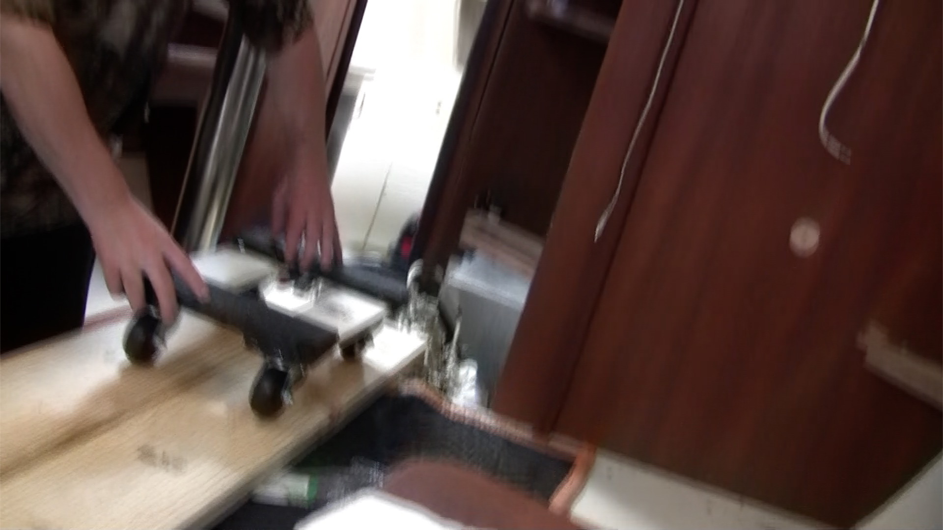

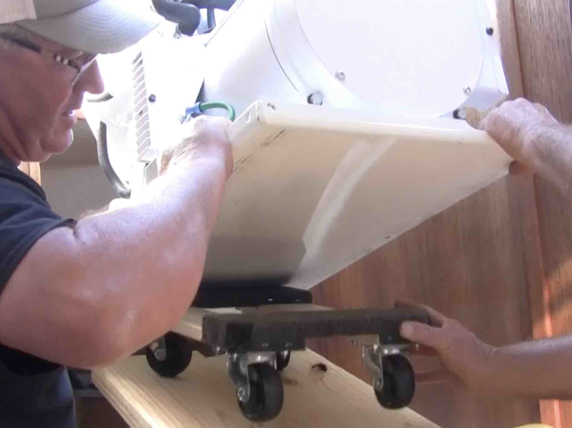

Now a few more pictures of getting it on the boat.
Anthony, my Son-In-Law, on the left , directed the show.
Timmy, on my crew, is on the right and had the sloped ramp concept
Then down to the Run Way....
Everyone applauded that. The Yards Part was done. Now just my team.
But the original design Height was too tall. Opps..

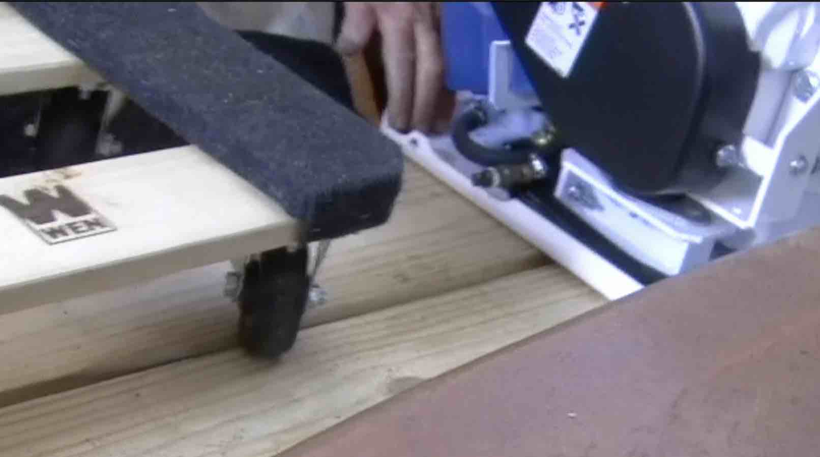

So we have to remove the 4.5 inch Mover. That was not an easy thing. Lucky we had some Muscle Power as Genset wanted to tilt off the Mover.
Ok end of this part.
Next post I will show how we made sure our lift was steady and held the weight without tipping or collapsing.
