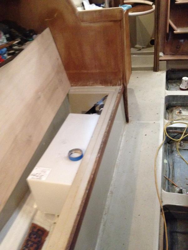

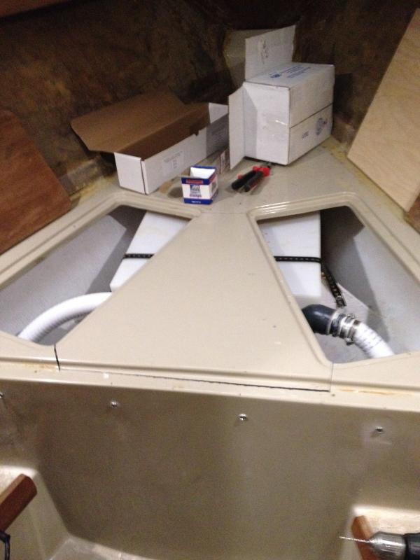

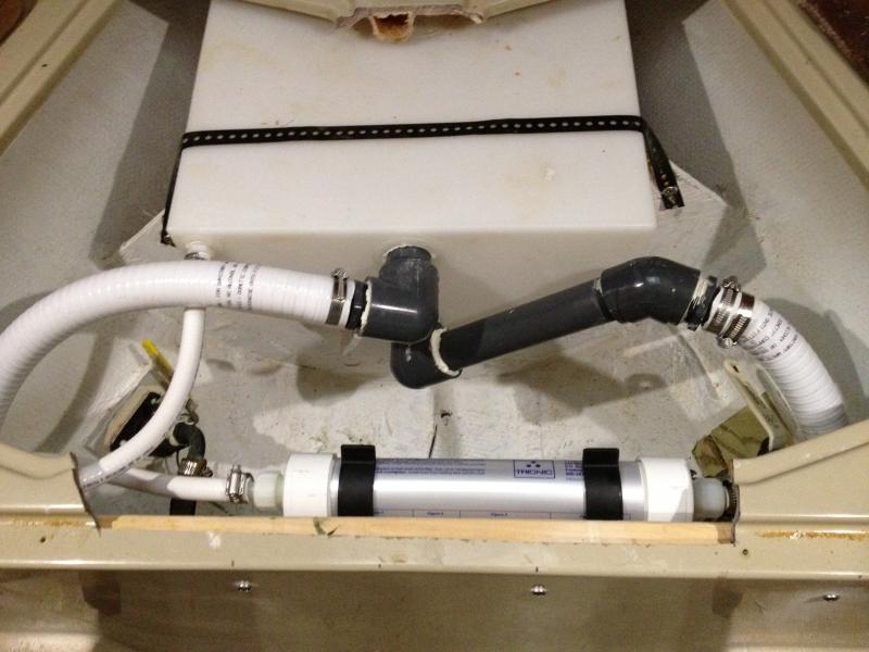

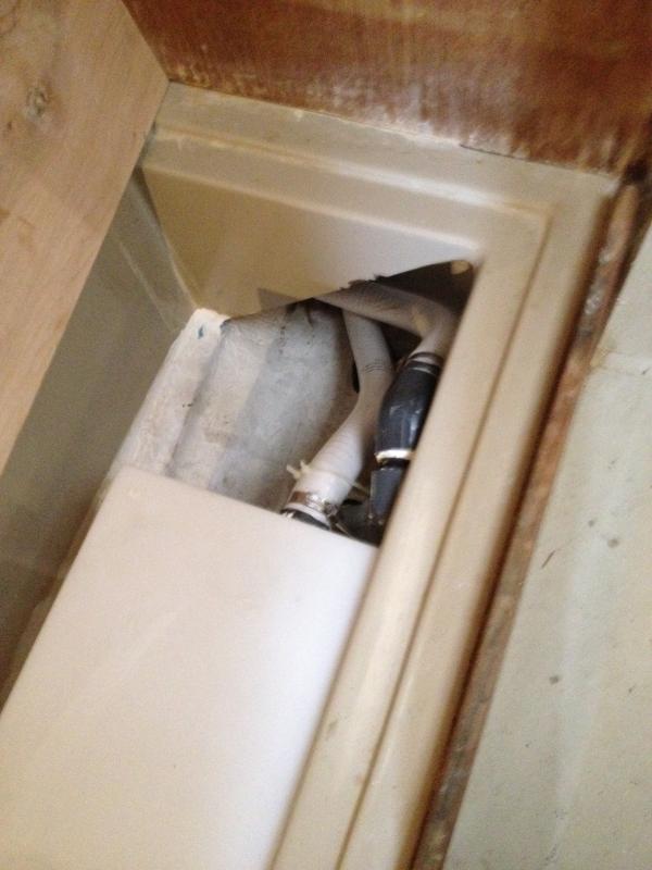

Holding tank install finished
Jibes, where were you and Denise030 the other day? Your suggestion is spot on. The instructions said exactly that but a quick check at the local hardware store and Vincent St. Paul's , the local thrift store, found nothing like an old percolator coffee pot or similar to heat water. I guess heating devices have been replaced by microwaves.
The hose remains very stiff as it is heated, right up to the point when it quickly becomes soft and looses all stiffness. When it is soft, it can easy be kinked. Soaking only the end would prevent this.
Pictures attached show the vent filter precariously close to the forward holding tank with just and inch or two rise. Very dangerous!! but my other choice was in a locker where I want as much storage as possible. This holding tank services the forward head which is in the forward cabin. Only Susan and I will be using it so we can keep a close eye on the level. The aft head will have the filter a few feet over above the tank and will have a line bypassing the filter that will have a water trap to keep gasses from escaping but let waist go out a thru hull if the tank overflows.
One photo shows the v birth floor back in place. I will finish it when I test the system.

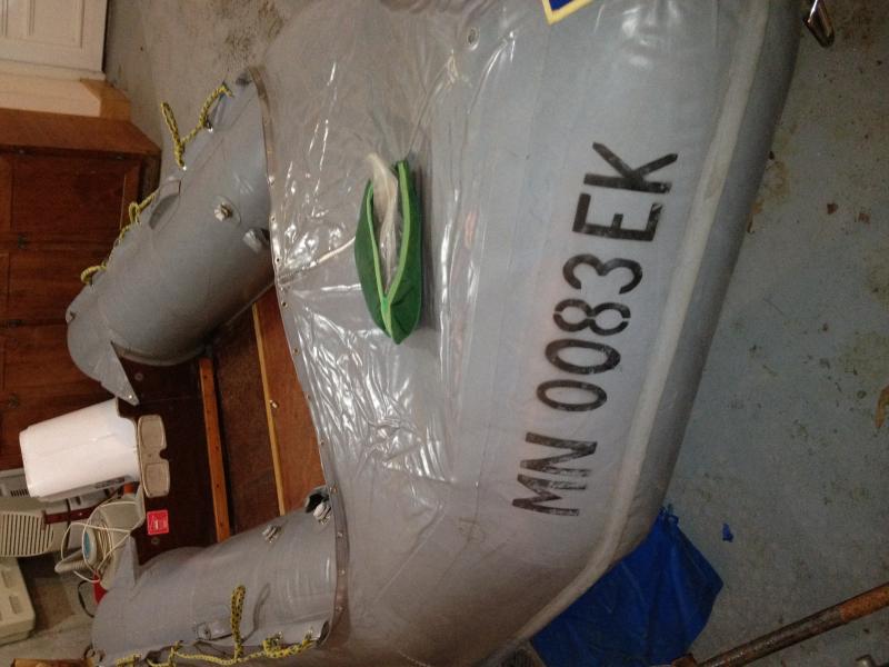

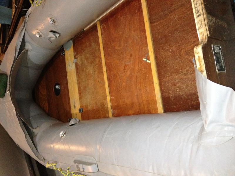

Water tanks rewelded. New Super Dinghy.
Filling the water tanks I noticed that my repair welds (see back a few pages) in my water tanks had a few leaks. I added a bit more filler and was a whole lot more careful to melt everything together. I'll fill the tanks again later this week.
A new project presented it's self. An old buddy game me his zodiac he purchased back in our college days (or about then) It's a great boat. It will need just a few patches. A bit big for a dinghy since it can take a forty HP motor. Same as the 39. I have a 25 hp Yamaha that I plan to use with it. Electric start on a dinghy???
I asked my wife if it was a bit excessive. She said I passed excessive a long time ago.
What do you all think? I still have a small inflatable with a 4 hp on it.

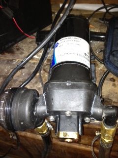

Here is a good example of a good company being ruined by a corporate conglomerate.
My boat has a Jabsco diaphragm pump for the pressure water system. It has a label that identifies it as a 32755. Sensor max vsd 5.0
It began to cycle on and off when no faucet was opened. It's been setting for years so I expected it to have the check valves full of junk. I opened it up and somehow messed up the sensing device that slows down the motor as demand lessens.
I searched the net for Jabsco's web site and saw that they are part of ITW (them and a few hundred companies)
I finally find Jabsco under another company and email them. This pump uses a sensor that reduces the motor speed as a magnet is moved closer to the sensor via a spring loaded diaphragm. Very clever set-up. I write in my email that the motor did not slow as I moved the sensor closer to a magnet (as the instructions tell me to do)
The response from the company (now in England) asks why I would want to slow a motor by placing a magnet next to it and where did I get that part number, no such pump had ever been made.
I replied that I was following the technical guide. The guy was very nice but very much clueless suggesting I contact a distributor. He gave me a list of three. All were in the Ag business likely selling fertilizer pumps. Never bothered to call.
I will use the pump as a washdown pump and by a new one. Check another company off the list. Sure and Johnson look like they are the alternatives.

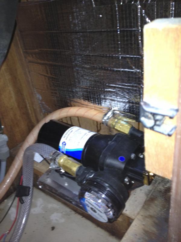

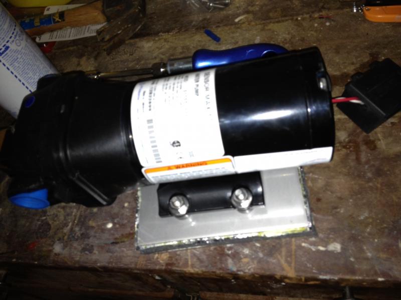

Silencing new water pressure pump.
Looking for alternative pumps I noticed that the Jabsco sensor max pumps are on sale. Likely being phased out. This may have been a very bad decision but I went ahead and ordered one. YES after bashing the company in the previous post above. My reasoning is that most of these pumps are throw away pumps as I found when I finally reached someone that was familiar with the line. I was informed that the warranty center tests and then sends replacement pumps. Very seldom do they repair and return. Certainly not when a motor or controller is involved. They do have simple gasket and wear item replacement kits. I figure why purchase repair kits for the pumps when I can use the old pump as a washdown pump and gut the thing if the new pump fails. This gives me a new pressure pump and an acceptable washdown pump with built in redundancy.

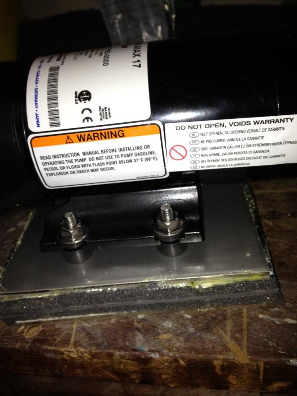

My next project is silencing these diaphragm pumps that seem to be everywhere on this boat. They sound like saber saws. One for the pressure system, and one for each shower sump.
My first experiment will be the pressure pump. This pump sits under the sink hanging over a ledge. Because of the ledge it can not be mounted properly by using hose as a isolator.
I decided to uses two stainless plates with the sound insulation left over from the engine room between the plates. The bottom plate will be screwed to the ledge. The pump is bolted to the top plate. The foam sandwich of foam , heavy rubber sheet, and foam is glued to each stainless plate. Nothing but the foam sandwich folds this pump in place. I will trim it up nicely and use aluminum tape to seal the edges. How it will hold up I am not sure but there is absolutely no vibration transferred.
I will likely use the flexible tubing method to silence at one of the shower pumps. The other will get this same foam sandwich treatment. I'll report back soon with the results.

Pressure pump is installed and running at a noise level less than the sound of the water coming out of the tap. The pump is located under the galley sink. The two doors accessing this area have been removed for finishing so the pump will be nearly silent when the doors are installed. I'm very happy with this arrangement. As I said a few posts back, I'll try the more standard (tubing) approach to sound proofing one of the shower pumps for comparison. You will note that I placed left over sound insulation on the wall next to the pump. This stuff makes everything sound solid. I placed some of this material under the lazzarrette cover. Huge difference!!!

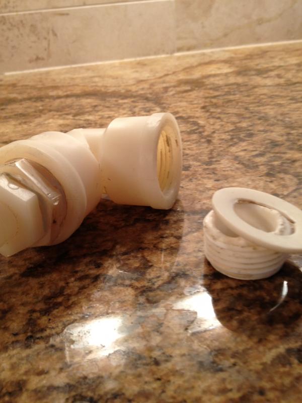

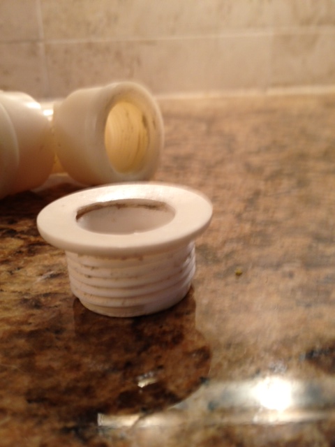

Need some help!!!
Plumbing system is up and running. I found a leak in the aft head sink drain and a clever arrangement to redirect the leak to the bilge. Why any one would make such effort to do something so stupid is beyond me.
Here is the problem... The after head has a very smart fold down sink. Click link for photo
http://www.google.com/imgres?um=1&h...w=127&start=0&ndsp=13&ved=1t:429,r:5,s:0,i:82
Unfortunately either O'day or my suspect "the french" molded the sink with a non standard drain hole. 1 1/4 vs the standard 1 1/2 to 1 5/8.
I'm checking RV stores today but I think I'm in trouble. There are two issues here. The small drain hole and the lack of clearance under the sink, 2 1/2 inches to make the turn. See photos for the the arrangement I had found.
I believe the drain hose broke the drain fitting at some point. I do think it may be possible to repair the drain ring fitting with glue but I'll keep that as last resort.
I'm counting on O'day's use of common parts and hope this drain is used on other O'day's and someone found a source for the part.

:cry: Hey, I'm of french ancestry. Have you tried the big box stores? Standard household plumbing comes in 1-1/4 inch. That looks like the tailpiece type drain.
Nov 3, 2010
564
Oday 39 Lake mills WI
Hi Joe..
It's a bit confusing, a standard drain is 1 1/4" on the inside. The hole in my sink is 1-1/4" not allowing for the thickness of the tailpiece type drain which is considerable because of the threads.
I blamed the french because they made the molds for the boat and I'm an American. I thought we were to always blame the french. Actually, I though they might have had a different standard. I tried to Google French drains but as you can guess I found lots of comments on grey water drains in the back yard. Googling European bathroom drain standard yields 1 1/4" RV stores carry 1 1/4" also.
So I think it may have been an old boating or RV standard. I'm hoping someone has the answer.

That's It!!!!
I owe you one !!!! Do you need any brackets made from stainless? I've got the run of the shop and all the stainless I can scrounge from the scrap bin.
We were planning to weld a washer on a 1" stainless nipple. You saved me a bunch of time and money.
I need the get a new Defender catalog. I keep forgetting about them. I'll need to increase the hole a 1/6" but the sink is all fiberglass. Nothing to it.

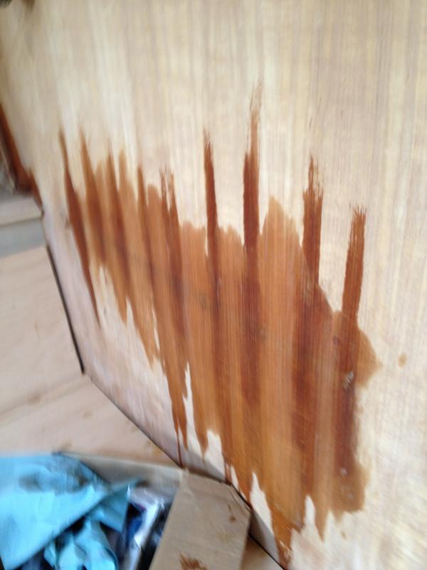

Bleaching teak
I knew I needed the pressure water before I could start cleaning up and finish the teak. The hot water was a real treat this weekend since it was in the 40's.
The years of soil and teak oil were removed last year. It's an easy but messy project using TSP to react with the teak oil (this is called saponifaction) it's how soap is made.
I'm now bleaching the wood since there are spots that were never exposed that are lighter and heavily soiled areas that are much darker. I'm using sodium hydroxide and hydrogen peroxide. This really works as opposed to the single component (Oxalic acid) or two component (hydrochloric acid) products on the market.
It a standard process used in the wood finishing industry. I'm looking for a commercial product I can recommend here. The stuff I use is a bit dangerous.
The photo shows a dark spot in the settee area that I am treating. Iyt was once a dark square. You will also notice a black stain from the velcro used to hold the cushions. I'll most likely have to treat the black stain with a paint stripper. (I think it is adhesive) I'm not using cushions on this wall in an attempt to open up some space. I'm also trying to expose as much wood as possible since O'day used very little. The areas were very dark. I apply the bleach in stripes to match the grain. You'll see the finished product soon.
I have begun the first coats of varnish. I intend to build 3 or 4 coats of clear varnish and then us Epifanes Rubbed Effect for the final coat. I'm using Minwax clear interior for the first few coats since it's inexpensive (one gallon costs the same as a quart of captains) and there is no sense using expensive varnishes on underside and inside cabinets (which is generally 1/3 to 1/2 the project). I'll follow with Captain's ultra clear until it is as smooth as glass. the apply the rubbed effect.
