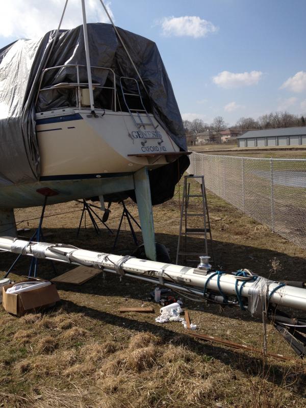

Where we sit…
As of March 1 2012 the boat lies about a mile from my home in the back yard of a stainless steel fabrication company. I cover the boat each winter with a cheap tarp from Menards using ¾ PVC tubing for structure. This holds up well each year.
It’s now seen two winters and is quite dry. Batteries are charged occasionally so I have plenty of power to work with.
I’ve removed the lazarrette covers and propane tank covers to practice the procedures required to refurbish the deck and hull. I’ve got many items ordered so I’m just about ready for spring.
The hull still has a crack at the leading edge of the keel hull joint as nearly every O’day 39 does. I have been following and discussing how others have been repaired. Process seems rather easy.

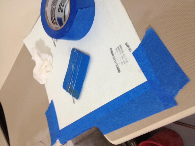

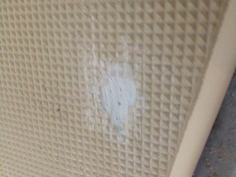

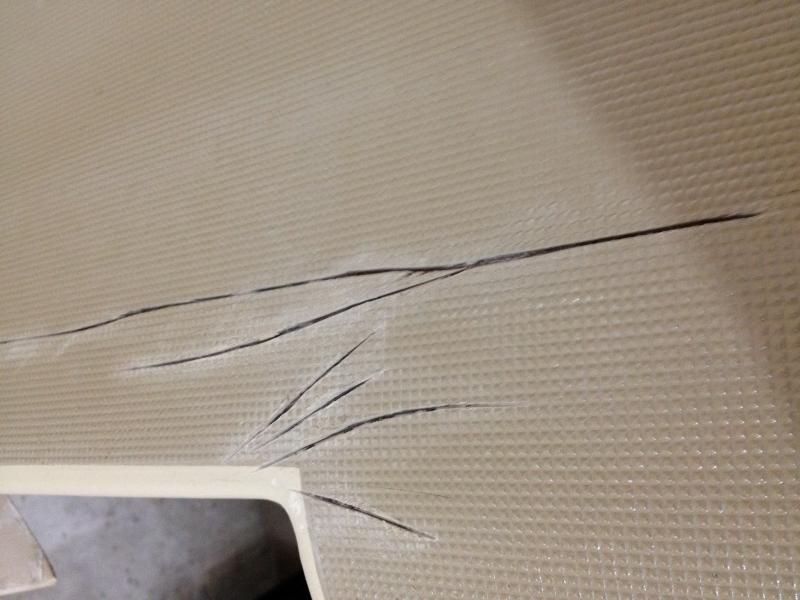

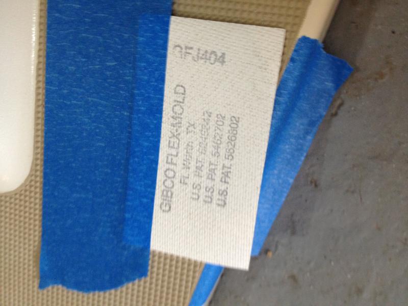

Deck crack repair using flex mold patterns
I'm practicing my deck crack repair. I now realize that practicing with that cockpit lazzarette covers is not the ideal place to start but fortunately you can repeat the process until you get it right.
Joe, I use an aerosol spray on cleaner/wax with carnauba. It allows for a good build-up. A stiff brush lifts up anything on the wax.
Indysailor… The deck process you found looks interesting. But if I could get at the underside , I would simply remove it, replace the core and put the panel back in place with a good amount of glassing to be sure it is sound.
I posted a video of the process a few posts back.
As back ground, here is the step by step
1. Wax the non-skid area , mask any areas outside the non-skid
2. Grind out the dings and deck cracks
3. Blow out the grind areas.
4. Match up the flex mold pattern to the deck and tape it in place
5. Add gelcoat
6. Cover with flexmold patern
7. Squeegee the area
8. Place a weight on it.
The gelcoat I purchased was not color matched well. I had to tint it.
I’m an old paint engineer so I’m very picky about the color match but I recommend that you have your geloat color matched by the company supplying it. Be sure they do a great job. A great color match will hide your imperfections. A poor color match will draw attention to your repairs.

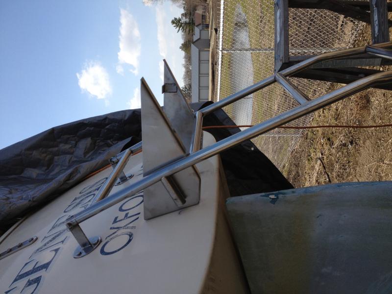

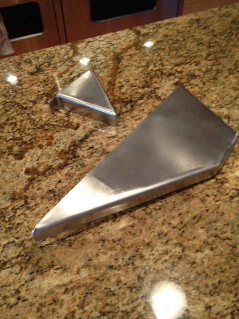

Swim platform brackets
A whole weeek of 70 deg weather. It's actually hot in the boat. The swim platform is ready to install. The photo attached show the brackets. I'm using the ladder to hold them in place. The ladder will be gone and the batckets will be a few inches lower flush with the bottom. The small backet is for the top step. the photos are high res.
Nov 3, 2010
564
Oday 39 Lake mills WI

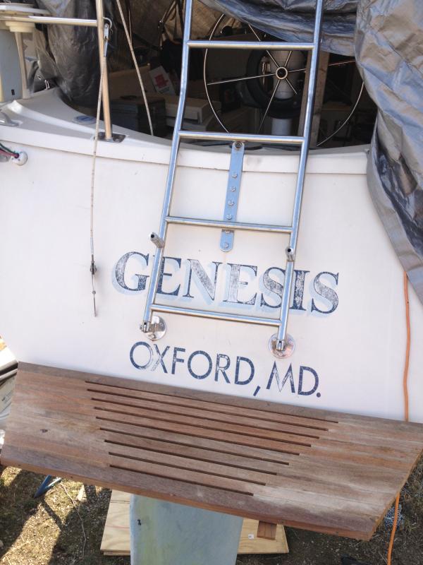

Swim platform installed
The ladder will be mounted on the Swim platform and another smaller step will be added just above Genesis.
This will make it very easy for me to get our 100 lb. Brown lab on board.

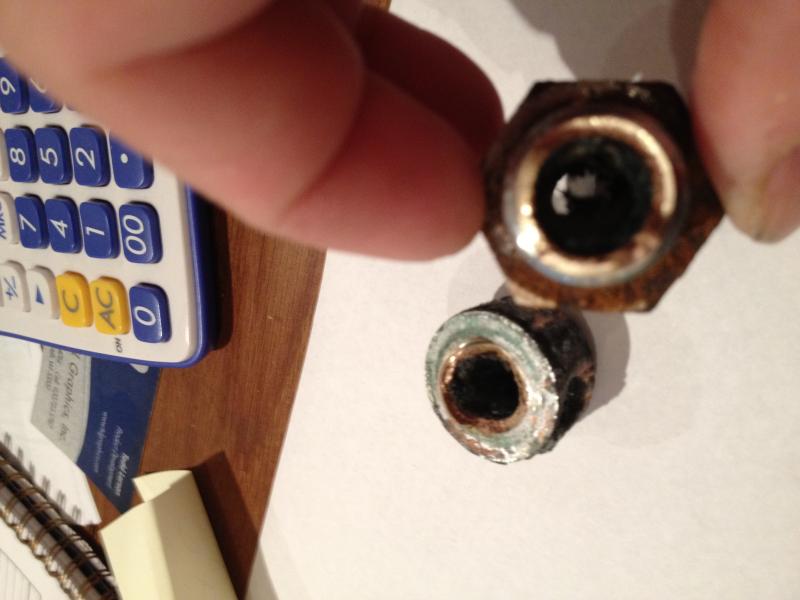

Thru hull pugged
The hoses are attached . Heat gun worked great with one exception when we heated too far down the hose and the hose kinked when we bent it to slide it onto the fitting. Fortunately we had enough hose to cut the kink off and retry. From this experience,I would not suggest heating the hose to bend it. Better deal with the 7 1/2 bend radius and plan accordingly. Photos of the installation in the morning.
The previous owner must have been plagued with this for years. He said his girl friend over filled the tank and popped a seam. It looks like it was just a very solid plug of the vent. Photo take after it was drilled thru.holding tank vent thru hull.jpg

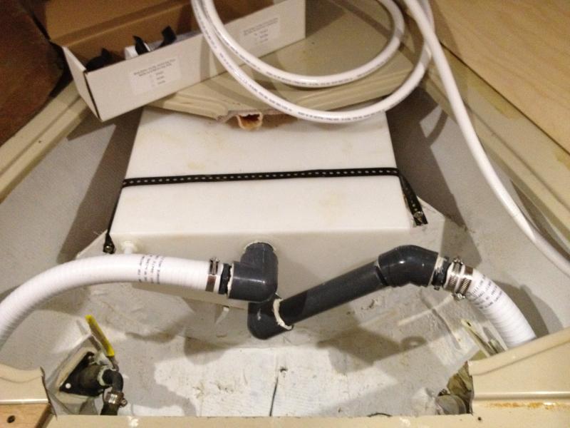

Forward holding tank O'day 39
My phone died as I shot these photos so I'll add more next post. This is the forward holding tank. The line from the head is on the port side. line running to the pump out deck fitting on the starboard side. The pipe fittings were used to keep waist from sitting in the line running to the deck fitting. This should yield the same results as a top mounted dip tube at much less cost. This tank cost $120. Fittings $12.
The v-birth floor had two openings on each side for access. Not enough access for this job. It would have limited the size of the tank (Now 20 gallons) I cut a much larger access hole and will repair the damage after I fill the tank hopefully this weekend. It should be simple to do since I cut only the center support and along the aft edge. Filter an vent line will be added today.
The bottom of the tank is fully supported by two 1/2" plywood bulkheads with support and plywood sheets between them.
