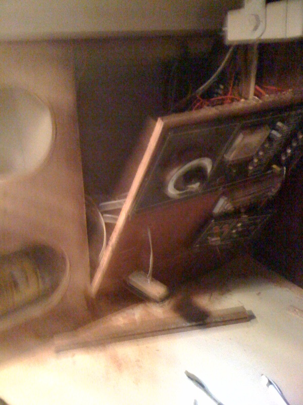

Best O'day upgrade ever.
Thanks for the Tip Mich222

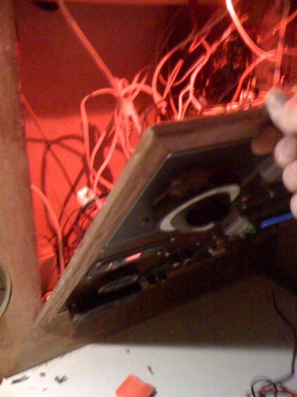

Ted Clucas an east coast Oday 39 guru turned me on to this. I found working on the back side of the circuit breakers nearly impossible. Ted showed me how he cut out the panel and placed a hinge on the bottom. Latches at the top open in a snap and give you all the room you need without extending any wires. This may be obvious to many of you. For me it was God sent.
The photos are really bad since I disconnected shore power and batteries just in case I nicked something. I now can get at this birds nest a get things a bit organized.
My next step is to back the panels out of the wood panel and finish it, install the hinge and latches then snake the electrical panels back into the wood panel.

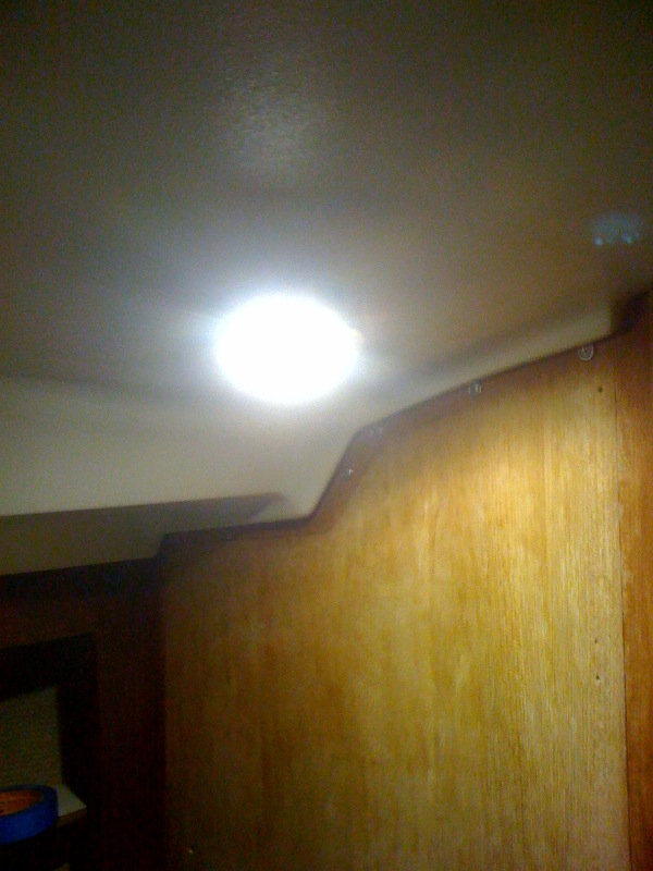

New LED ceiling lights
I replaced the standard surface mounted lights with LED fixtures. I likely could have just replaced the bulbs but the fixtures were tarnished and in my eyes rather dated. I replaced them with http://www.sailorsams.com/mall/star_8507LEDS.asp
which are chromed plastic at $33 each. I could have gone with the
Hatteras units that are metal but look similar for $110 each. I chose to use the money I saved to purchase the better reading lights and wall lights (see photo a few posts up) replacing the plastic O'day supplied units. My thought is that people handle and redirect the reading lights and the stock units were very flimsy. I purchased Warm white lights. I feel they make the boat interior look much better slightly whiter (not as yellow) as incandescent lights but not the blue look of some LED.
I will also be using recessed mounted LED lights in the overhead panels above the table and galley areas. These too are plastic and cost about $30 http://www.sailorsams.com/mall/nova_8778_LED.asp

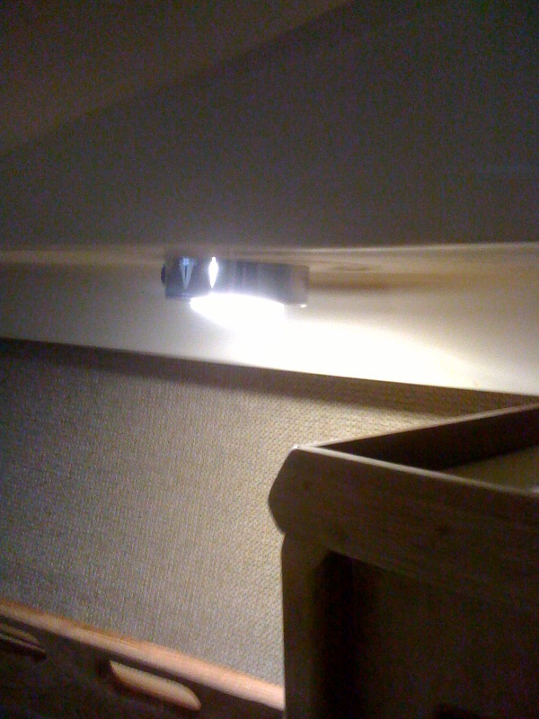

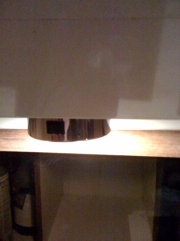

Small indirect lights.

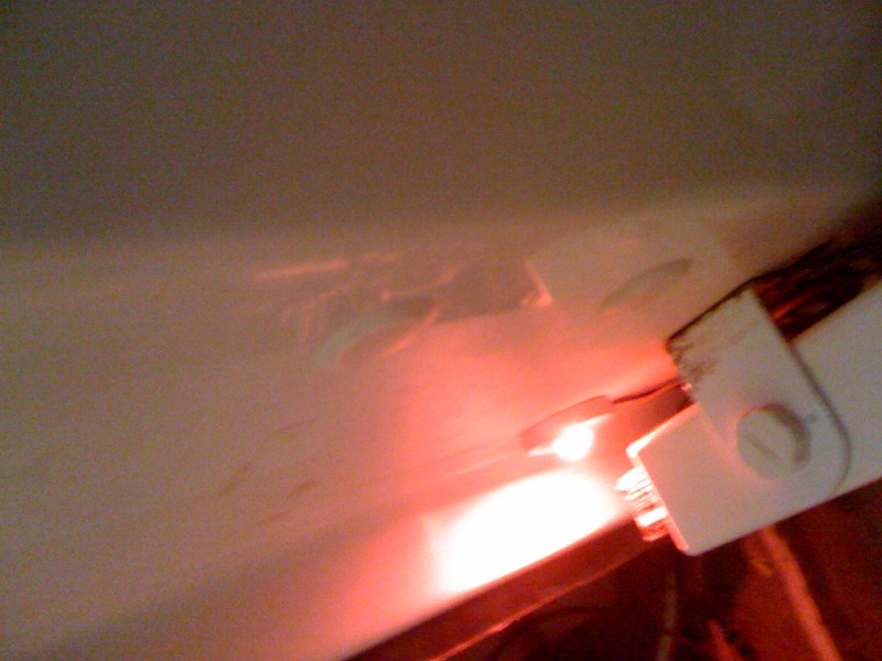

I installed three small LED lights for indirect floor lighting as well as one infrared red over the nav station. See website http://www.magnalight.com/pc-45215-...volts--90ma-draw--courtesy-or-down-light.aspx
They were $27 each. I spent the day working on the boat. Working on the electrical panels, cleaning up some wiring and a lot of sanding of the interior teak. With all the lights now converted to LED the batterys held up all day even with the sander running. I see no need to figure lighting into the battery load.
Photo one is the red one over the Nav station. The third photo is a shot looking down at the galley floor. The light is mounted to the kick board. I have another illuminating the the center isle and another under the settee. At less than one watt each I can leave these on when I am away from the boat so I can return later without stumbling to find the light panel.
These lights produce a very clean white light. A bit whiter than the warm white surface mount overheads I talked about in the previous post.

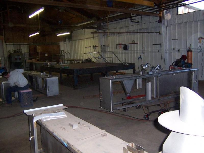

My landlord's stainless fabricating shop has my bow pulpit on their layout table to straighten up a clean-up some welds.

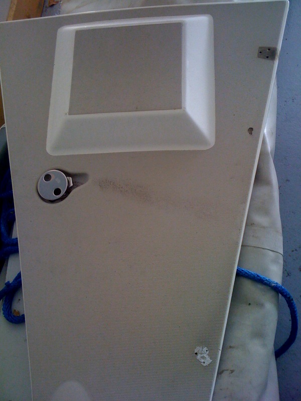

I'm removing the anchor well hatch , lazarrette hatches as well as the propane locker hatches. Theses pieces are all microcosms of the entrire boat with deck cracks, gelcoat chips, in both the non-skid as well as the smooth areas. The gelcaot is badly faded and the non-sikid paint is chalky. Note the chip in the Non-skid and the wonderful work on the hinge mounting holes.
My plan is to remove any traces of the polyglow the previous owner had applied at one time. The cockpit has blotchy areas that I think is remnant of Polyglow. I understand I need to get rid of it before a do any buffing.
I'll then try Joe's (25 year later) recommendations Aquabuff for the gelcoat and and Mas Epoxies flex mold to repair the no-skid. (I have only small areas to repair) and Duraglass to fill the cracks after I open them up.

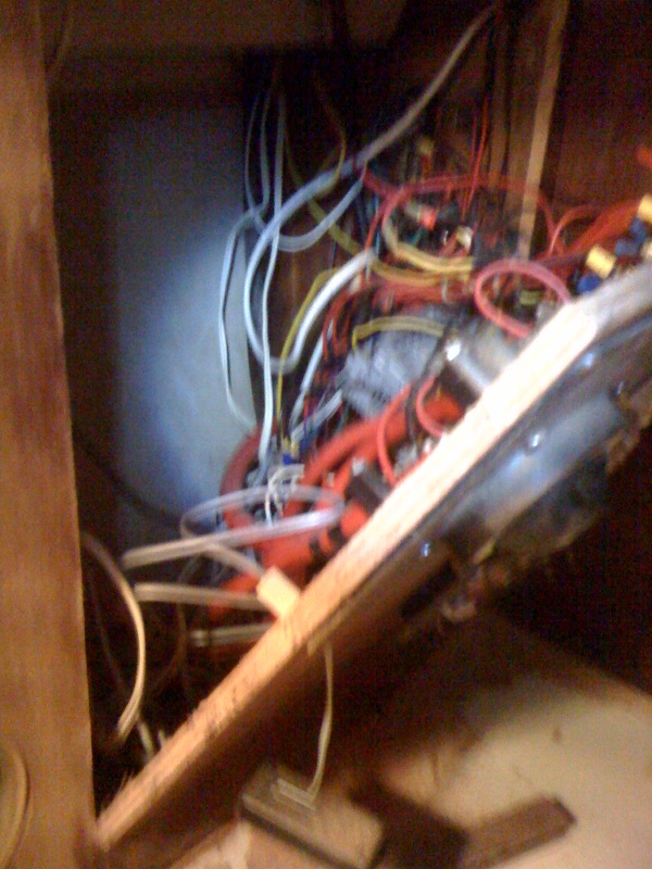

Electrical nearly complete

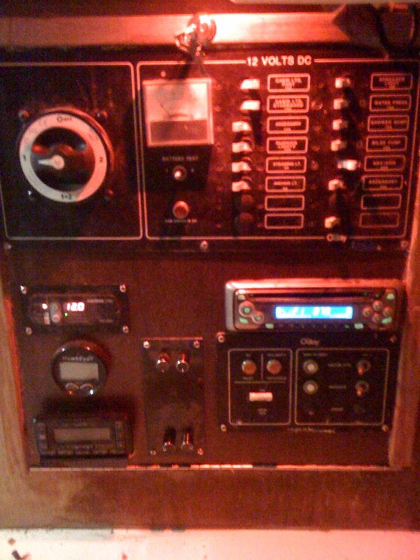

Warm rainy day today so I used it to complete the electrical work. Panel is now hinged at the bottom and has a locking hasp on top. The inverter is fully functional and has a remote display mounted on the main panel under the battery switch.
Also on the electrical panel is a Sirius satellite radio, and old cd player, the four LED Dimmers (in the lower center)and a stand alone depth meter that I came uninstalled with the boat. I replaced the battery switch with a heavey duty model and ran oo cable to and from it.
The wiring is still a bit of a birds nest but it is getting better with every wire I re-route. Many,many loose connections and bad crimps. The electrical panel has been worked on and added to many times. I can tell from the wire and proper strain relief that some work was done professionally. Other work was done with speaker wire or anything they could get their hands on. It makes it easy to spot the stuff that should come out. I soldered all connectors because I don't have a nice crimper and just don't trust the crimps.
The labels will come in next week so that will complete the electrical panel.

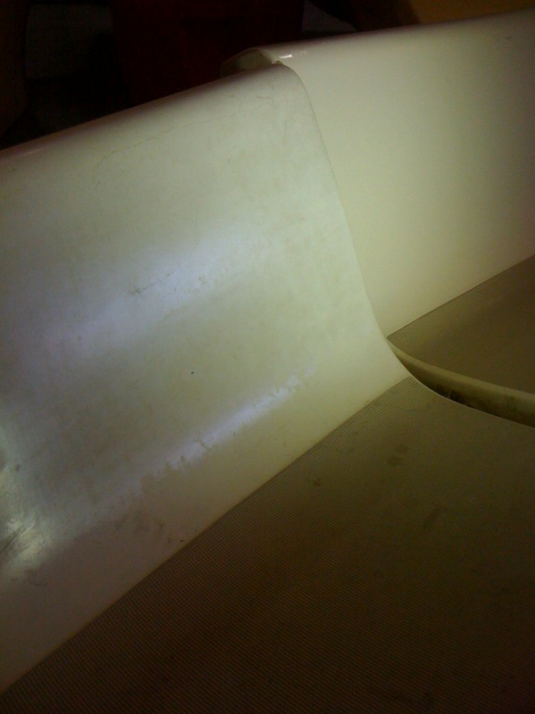

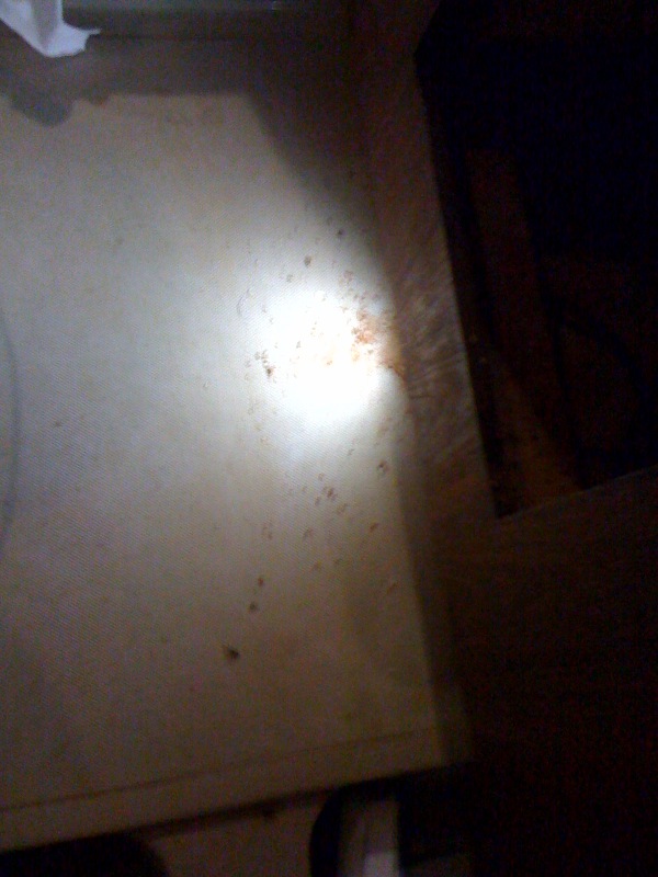

Cleaning up the gelocat

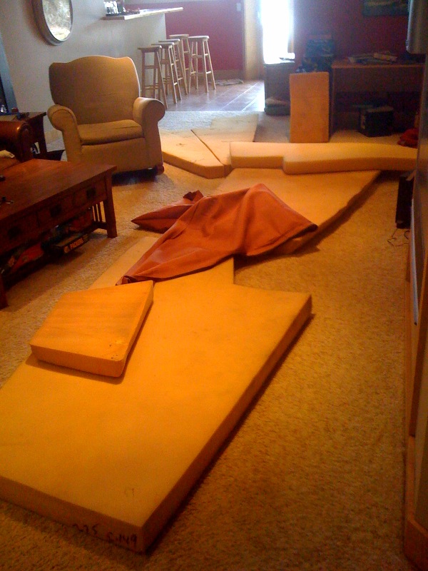

Started the winter project list today. My wife cringed when I backed the cars out of the garage. I promised she'd have here garage back in a few days. She's happy.
I removed the cover from the foam mattresses. The boat was full of mold so I want to be sure the foam is OK. I sumerged them in 2000 ppm Chlorine Dioxide and hung them in the heated garage to air out and to drain. I waited until the heating season to do this. The mattress will add a good deal of moister to the house once I bring them in (tomorrow)
The weather here inn Wiscosnin is in the 40's so I went to the boat and picked up the hatches , lazarette seats and such. I tested a few products to clean them up. You can see in the photo the preveous owner attempted to restore the gelocoat with Polyglow. Note the splochyness in the gelocoat on the one on the left. I used some Crazy Clean that I found in the boat. It is a caustic cleaner very similar (my guess) to acrylic floor wax strippers. (Polyglow is expensive floor wax) The old Polyglow came up quickly.
Contrary to what I have been told, stripping the polyglow is very easy. I'm thinking of using Polyglow in place of compounding and waxing. I see no downside, gloss is better , less work to apply, and stripping is very easy.

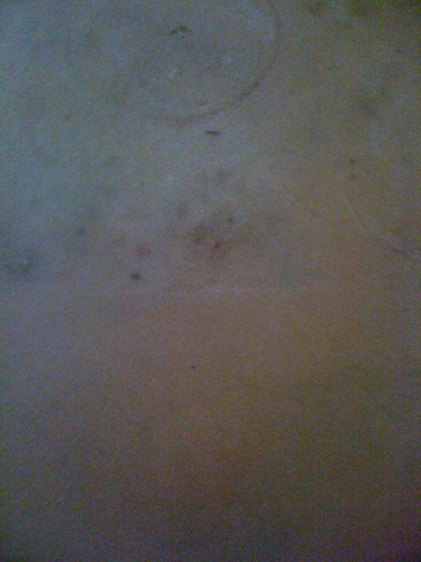

See my previous post. The lazarrette seat looked terrible. It took a minute to clean up using a scouring pad and Krazy Clean. (An alkaline solution with Butyl Celusolve as a solvent)

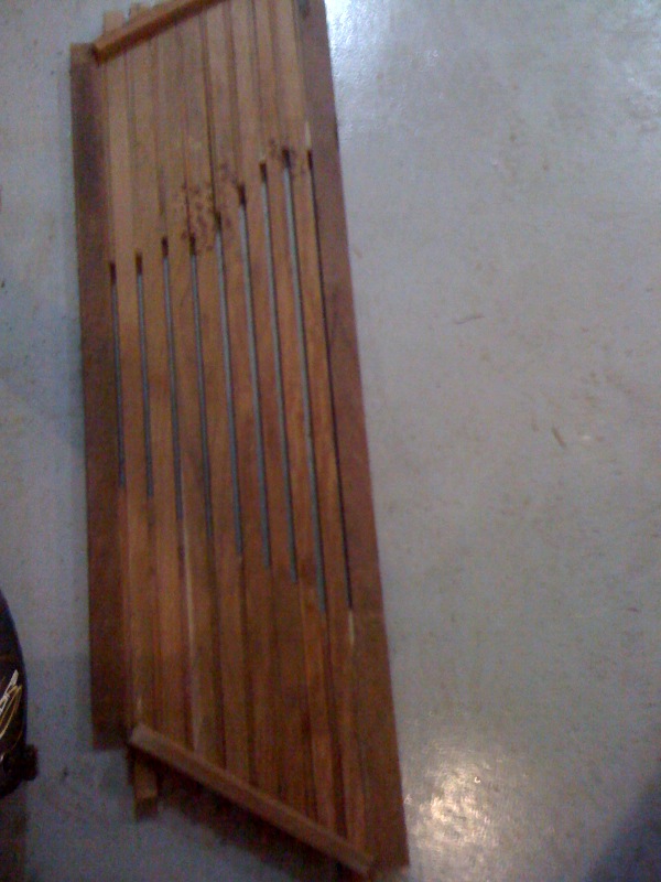

In the mean time I'm building a swim platform out of extra ironwood I have left over from a deck project.
Here is the rough platform ready for glue. It's 4 1/2 feet long. I'll trim it to 4' 3" after the glue sets. My boat's landlord will make four stainless brackets. They will be simple brakeformed pcs. The whole project should cost $100. I'll shear the blanks. I get the run of the place now.

After researching the Polyglow and testing on a few pcs , I have decided to polyglow the entire boat. Hull, deck (smooth Gelcoat) and deck (non-skid).
I made this decision based on the ease of stripping the existing Polyglow on the boat. It's really not very difficult to do and compared to compounding, polishing and waxing it's a snap. I have three different products I'm using. I will wait until I do the entire boat this spring to give you recommendations. For now, polyprep works well but so does nearly all floor strippers. Red Max from Lowes is very inexpensive. SC Johnson Professional Deep Penetrating Floor Stripper works very well. Please let me know if anyone has other suggestions.
I have sent off the Propane locker hatch cover to have the gelcoat matched for both the crean and the darker non-skid. I hope to get back to that project next week or so fixing deck cracks and chips.

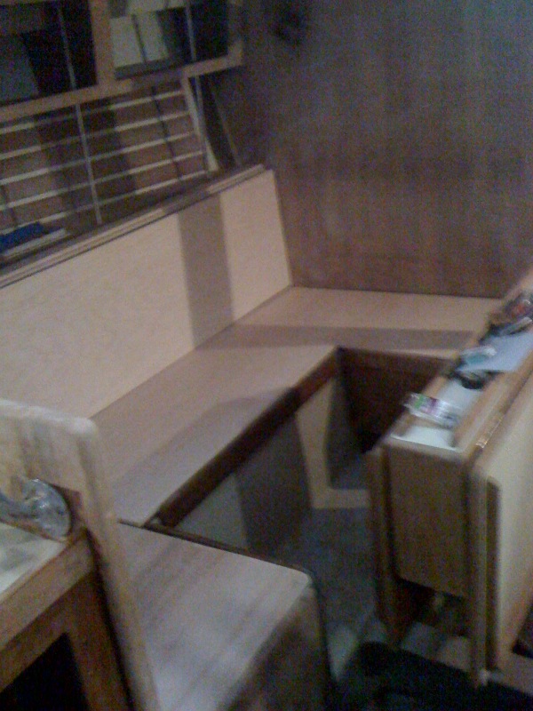

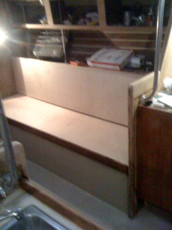

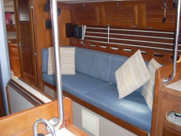

I'm rebuilding the settees replacing the plywood bases foam (some foam was contaminated when the holding tanks burst)and upholstery.
I have removed the hand hold behind the settees. See photos of sister ship that still has the handholds.I think it opens the self up and gives it a bit more modern look. (comments appreciated since I can replace it easily) obviously the shelf will be useless at sea.
I will be using beige Naugahyde.
As a said a few posts back, I soaked the foam mattresses in Chlorine Dioxide. This stuff is great for sterilizing and eliminating odors from just about anything. Chlorine Dioxide can not exist in the atmosphere for more than a day so it's safe for bedding. I used the dry heat in the house to fully dry the foam. (don't do this in the summer time)
I am now using some sport carpet cleaner (Resolve) and lemon Lysol (it was handy) to clean up the foam. I spray the Reslove on the spots and spray the lysolve over everything working a few square feet at a time. I don't let it soak in since water runs through this stuff quickly. I then use my home carpet/upholstery cleaner to such it up. (rental units would work better)
See the before and after photo with the clean section at the bottom of the photo. I'm now comfortable reusing them. There is absolutely now odor other than the lemon sent that should go away in a day or so.

I recieved the color matched gelcaot from Express composites. Great people, I sent in the propane locker cover and they matched it well.
I ordered a #301 flex mold pattern from Mas Epoxies and recieved #118 from Jamestown distributors. Way to many fingers in this pie. I received a confirmation email from yet anouther company. After the mix-up I found that Mas does not make the product. Gibco Flex mold makes it. Mas sells the product through Jamestown and other distributors.
Gibco's website is http://www.gibcoflexmold.com/process.asp
I 'll give them a changce to send the correct patern out but next time I'll try Gibco.
