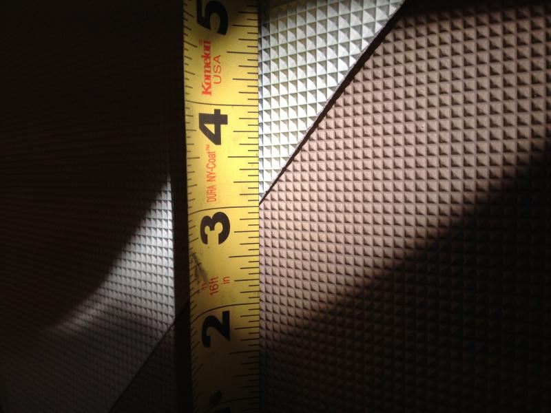

I've had trouble ordering the flex mold patten from Mas epoxies. First they sent the wrong pattern, then sent the one I ordered and selected from their selection guide. This didn't fit either. A word of warning. Call Mass first and request a sample prior to ordering since they consider this a special order and will not accept a return. They say they may make an exception in this case.
See photo . The deck is the darker colored pattern. the lighter is the flex mold pattern #301

So I order the 74-30 RTV which US composites shipped immediately, returned the two Flex mold patterns to Mas epoxy. The Next day I recieve two samples from Gibco Flex-mold requested by Mas. These two patterns do not show up on the Mas listing. One was Beneteau Pyramid the other Jeanneau Pyramid. You can guess which was the correct pattern. Jeanneau for the non (O'day historians)
Lesson learned- before you order flex mold patterns, ALWAYS ask Mas for a small samples which they gladly send at no cost.
