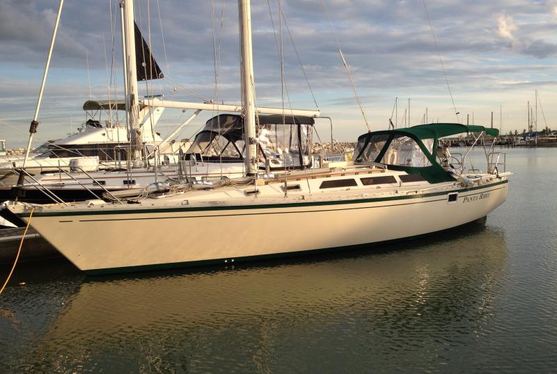

just got the canvas up when the sun popped out of the clouds just before sunset. I stopped work and took this photo.
