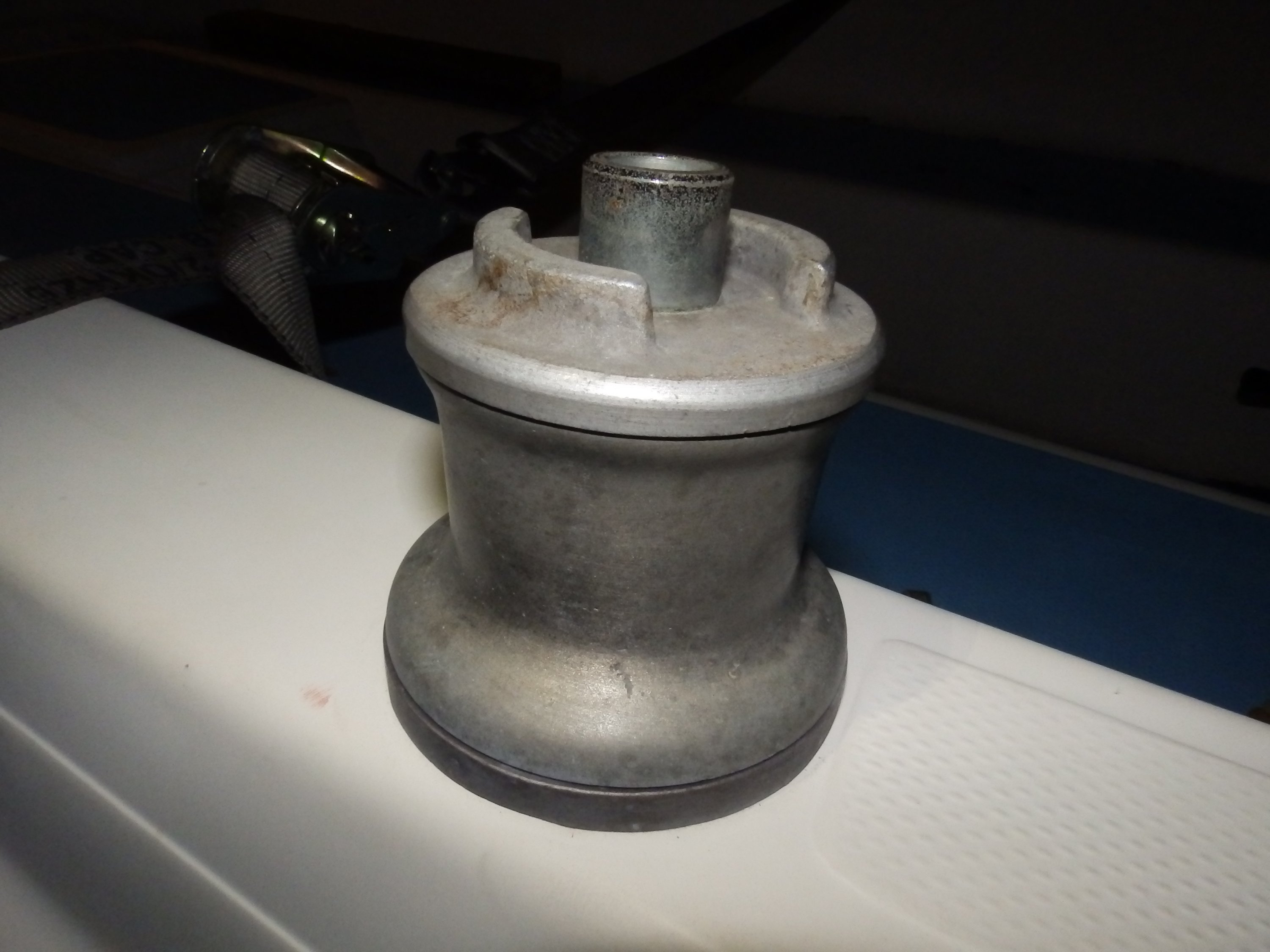

2. Can anyone identify the device in the attached photo? I can't see any manufacturer name or number on it. There are two installed - one each side about two feet aft of the companionway bulkhead. They don't function the way I'd expect a winch to function. There is single-direction ratcheting of the central drum -- turns clockwise viewed from above. The smaller chromed cylinder free spins in either direction around the slotted screw/axle and the outer top does not move. (should it?) The C-shaped castings atop the non-moving "crown" suggest provision for some kind of attachable device like a handle that may be intended to use the free spinning small cylinder as an axle/bearing that might apply torque to the crown. Have run across a device called a snubber / snubbing winch apparently used to assist with controlling release rate of a line and/or provide a holding tension against a line load vs increasing mechanical advantage for pulling -- Is that what these are? Are mine working correctly by my description. I'm hesitant to remove and dismantle these unnecessarily if they're doing all they're supposed to do. Some V21 pics don't show these installed. Is it worth considering substituting conventional winches in place of these?

That is a regular winch that was installed during the boat build or shortly after by a dealer. We have 2 just like it.
I don't suppose you have the original handles do you? Ours are long gone and we are left with a home made aluminum one that a PO had made and promptly bent I'm thinking. Its rare that we use the handle anyway but I do often wrap the winch with a jib line or the main sheet and heave and cleat when the wind is up.
I wouldn't get too wrapped up about "original" Mac/Venture stuff while you outfit. Many many sailboats are very similar in function and layout. A Hunter mast hound for example will work just fine on a Mac mast as long as the dimensions are close.

Thanks folks, So I guess the C-shaped cast protrusions are what engaged the handle? Any Idea who made those winches? Do I understand correctly that with handles (if they're findable/makeable) these do provide some mechanical advantage for pulling? If anybody knows of any handles available, will appreciate the intel. Also, re my parts hunt question if anybody knows of any boat salvage (junkyards) places around the DelMarVa area, will also appreciate that info as well. I agree I don't want to get ahead of myself on bits and pieces that can wait. Keel/bottom is job 1 right now. Just don't want to ignore opportunities that may be here today, gone tomorrow.
