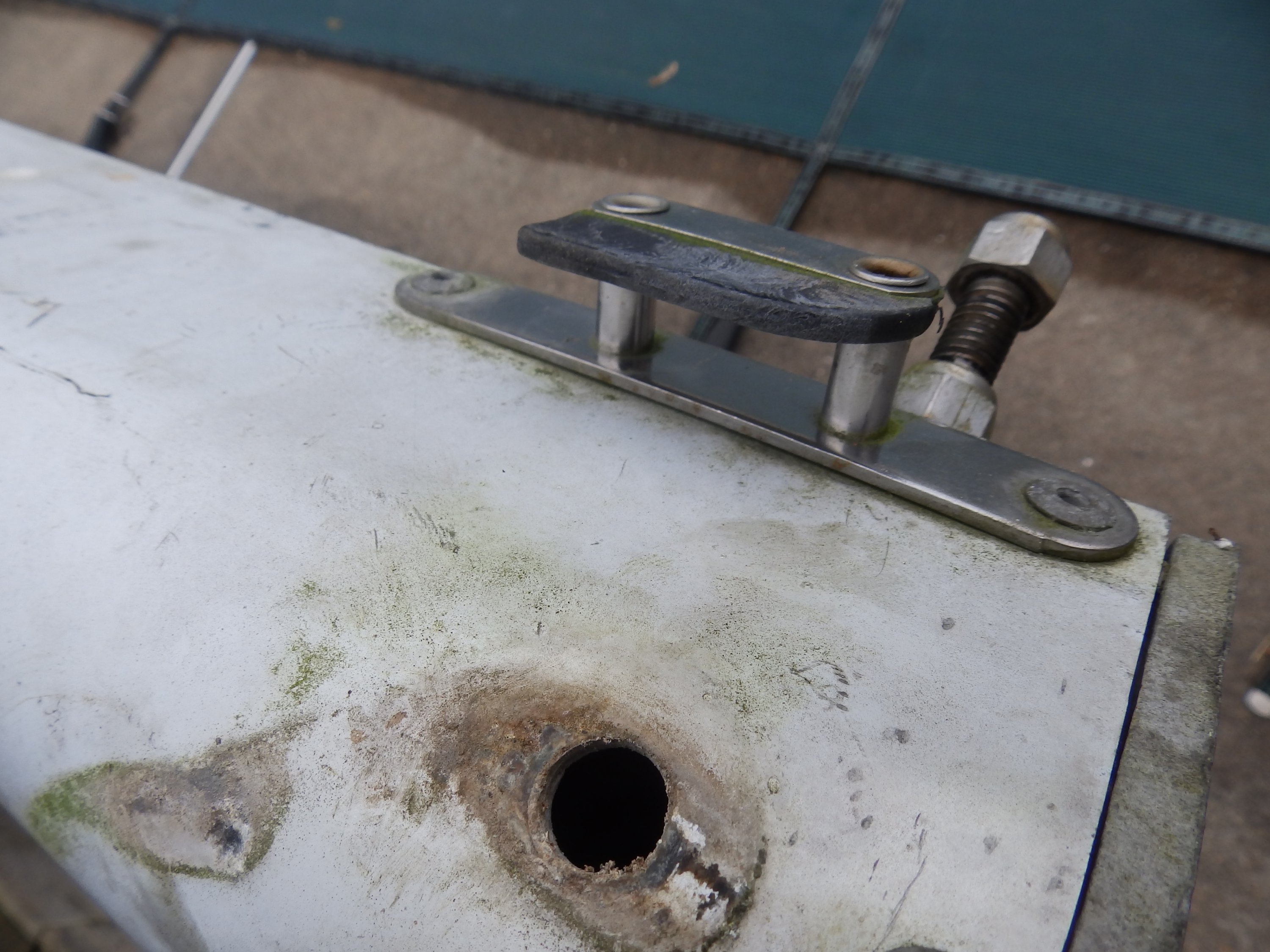

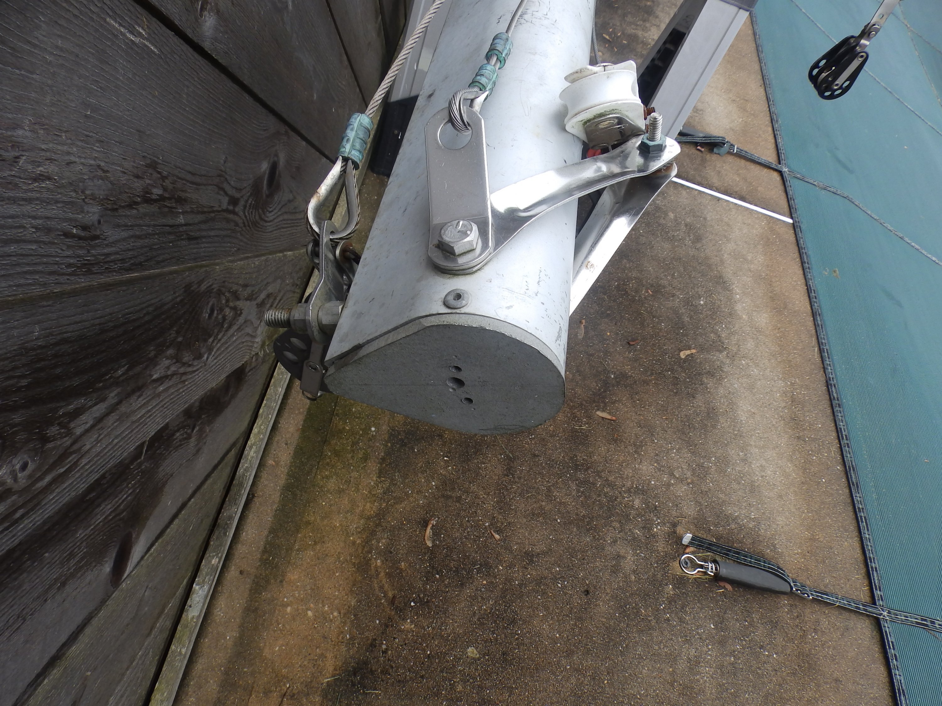

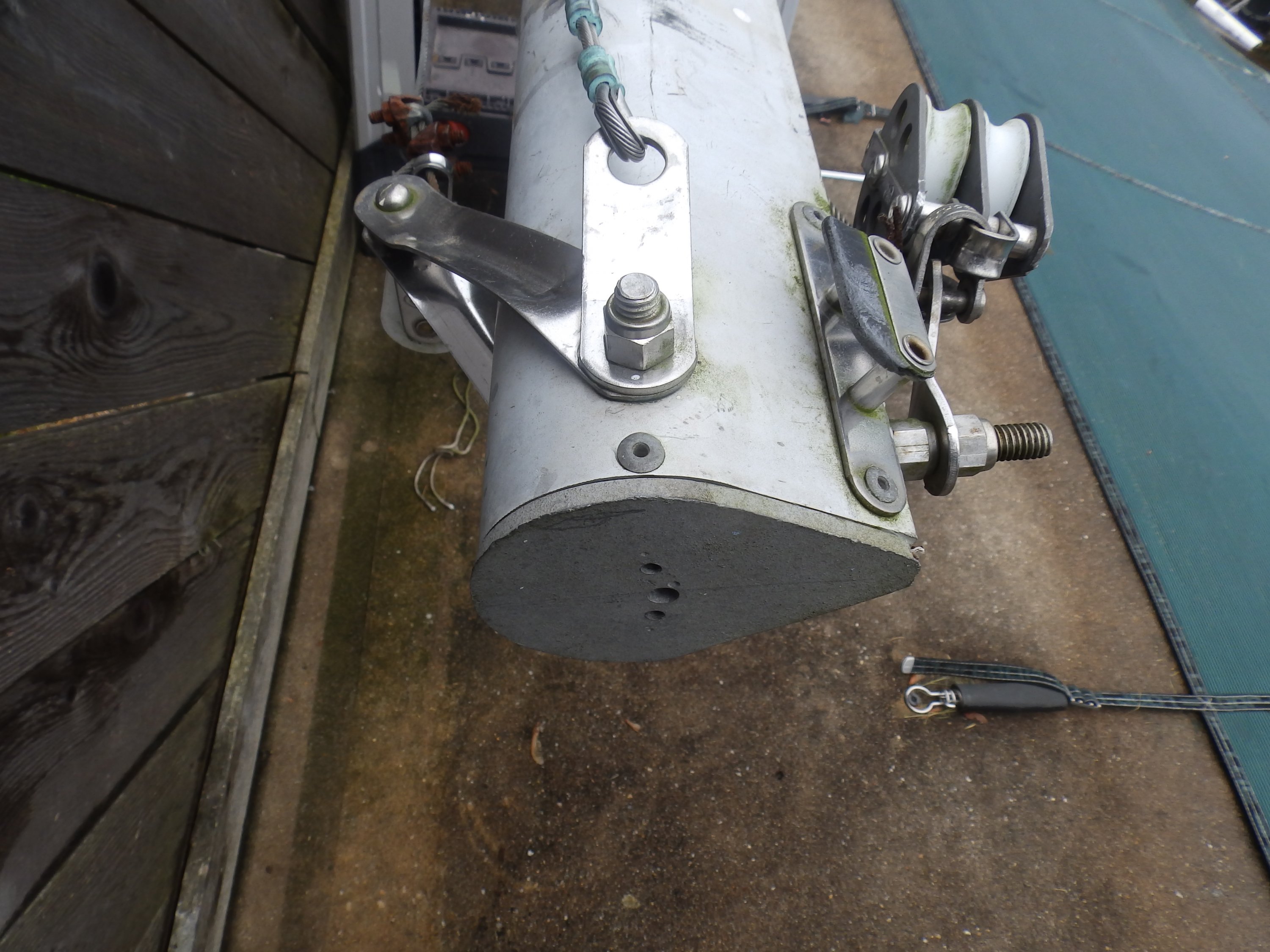

Q3: Can anybody supply me a picture of what a "factory" masthead looks like? I can tell that something at the top of my existing mast has broken but I can't really tell what it was. (See pics attatched)

Q5: Can anybody supply me a picture of what a "factory" masthead looks like? I can tell that something at the top of my existing mast has broken but I can't really tell what it was. (Pics attached in my previous post)

The broken piece are the remains of a cheek block. I use mine for a topping lift, but I believe there was an optional spinnaker as well.

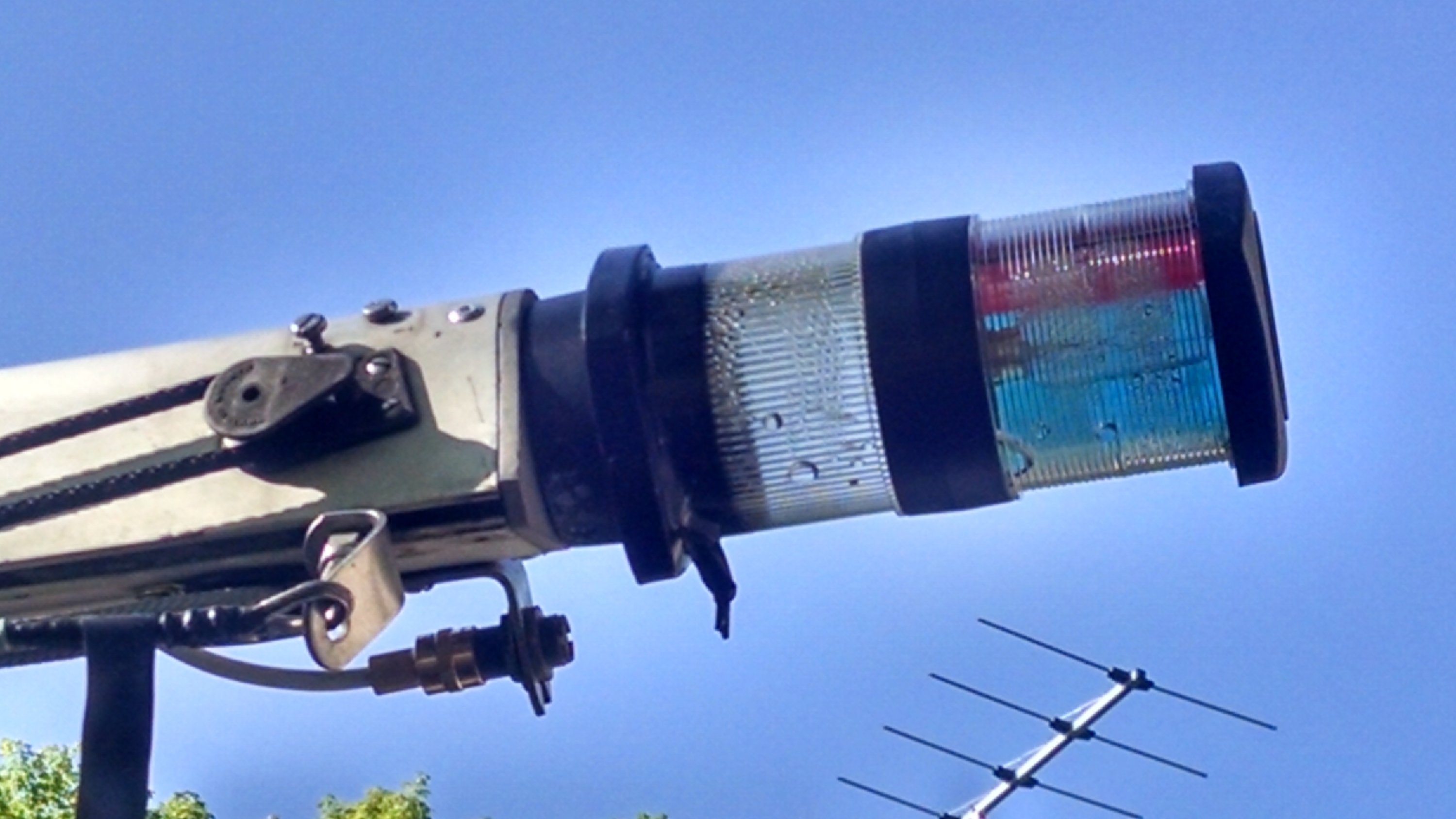

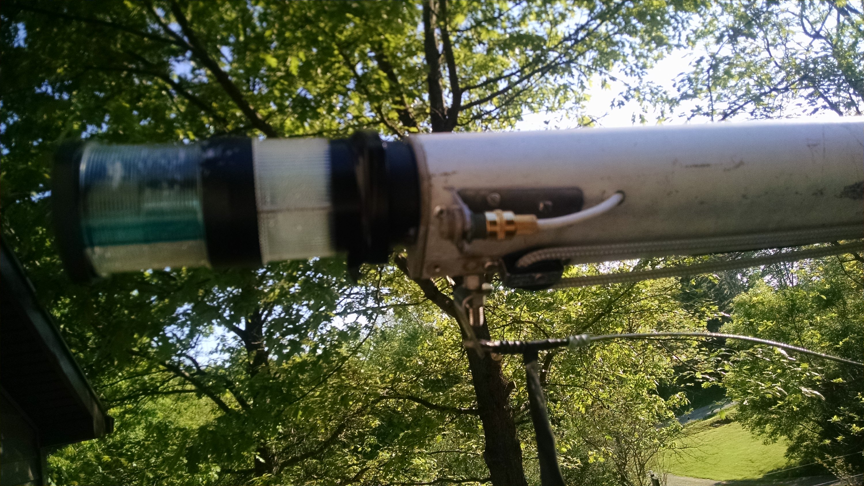

My venture 24 mast top looks exactly as yours does but mine has a light mounted on top of it and the hole looks like where your vhf cable would come out to attach a antenna, as far as shrouds give me an hour and I'll measure mine but I assure you the one with the plastic is not stainless and will rust and break
***Someone with a V21 rigged same as yours would have to post a pic - yours is a masthead rig. V21's were all over the place in types of rig from the factory. The part that looks broken is the original main halyard cheek block - the sheave is gone. That's why someone hung the double block from your backstay tang, Also your Jib block is not original (thats a good thing).****

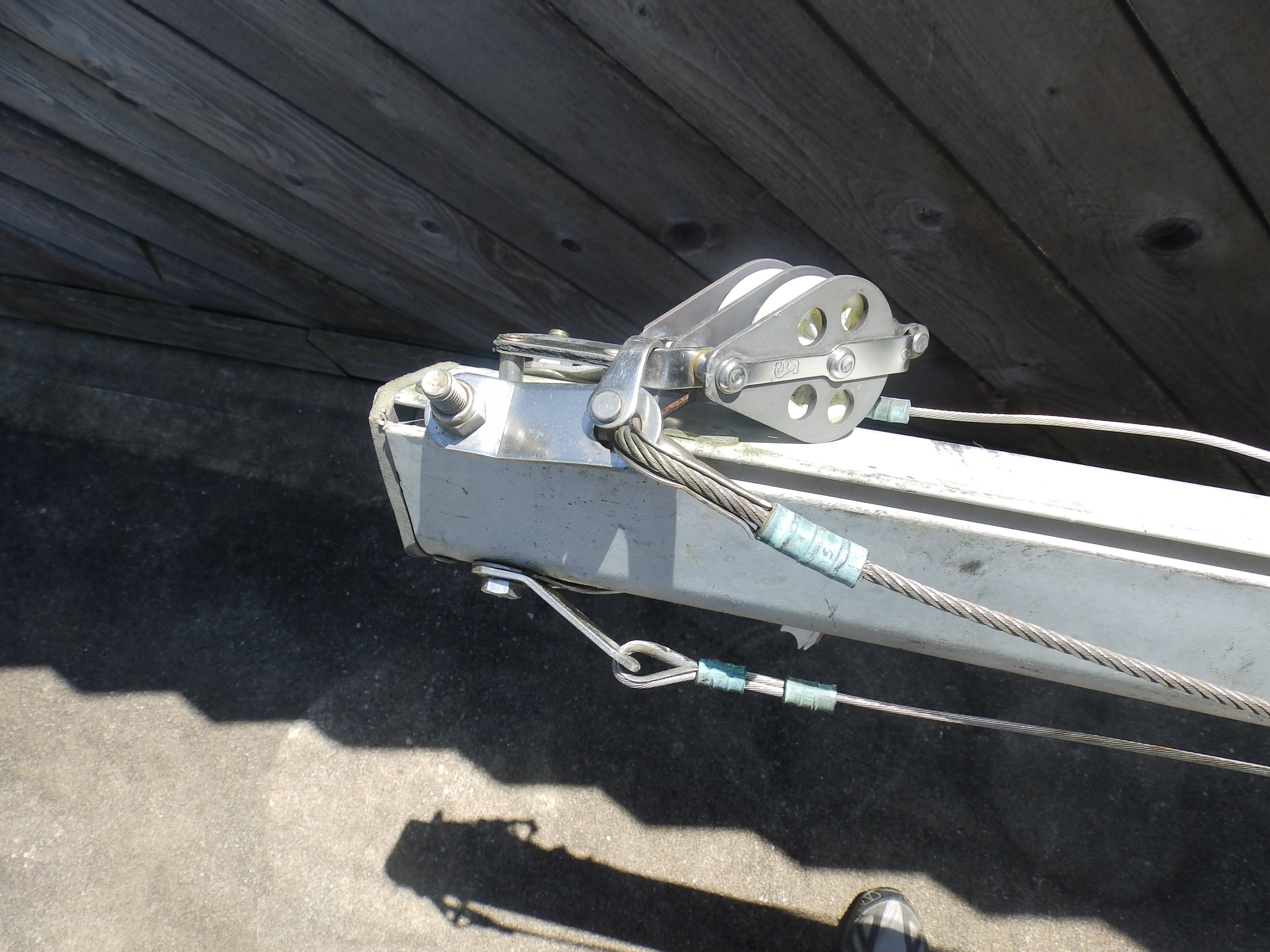

Probably can't tell from my pics but the jib block and the double block are both disintegrating. Is the main halyard cheek block a "standard" size such that I'd be able to readily find a replacement -- maybe something decent that would bolt up without swiss-cheesing the mast with new holes, i.e. could bolt up into existing holes (3-3/4" hole spacing, 4-1/4" mounting foot overall length, pop-riveted ? As for picture of forestay with no turnbuckle -- can't do it -- ain't there. Maybe it was a nice turnbuckle and he wanted a souvenir of the boat? Thanks again.
