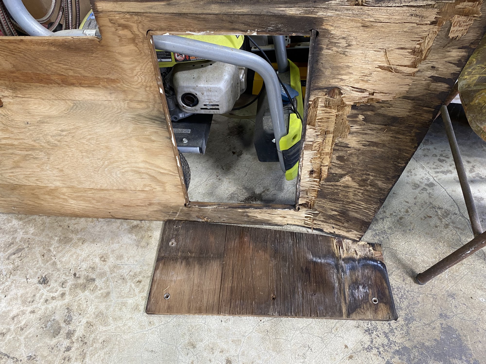

While the weekend was a failure, I was able to get some work done tonight. My friend who used to be a cabinet maker and I were able to get new counter tops cut out and sanded, and they are ready now for laminate. I picked out a white/grey marble pattern. We had to make the aft portion of the counter in 2 pieces, but we used a biscuit joiner to hold the pieces when installed in the boat. This will make installation and future removal of these pieces much easier. I was also able to repair my cupboard and it’s now ready to go back in.
This is the last time we will see my old factory countertops. This is the piece I mentioned before that pretty much turned into powder any time it was touched or even moved.

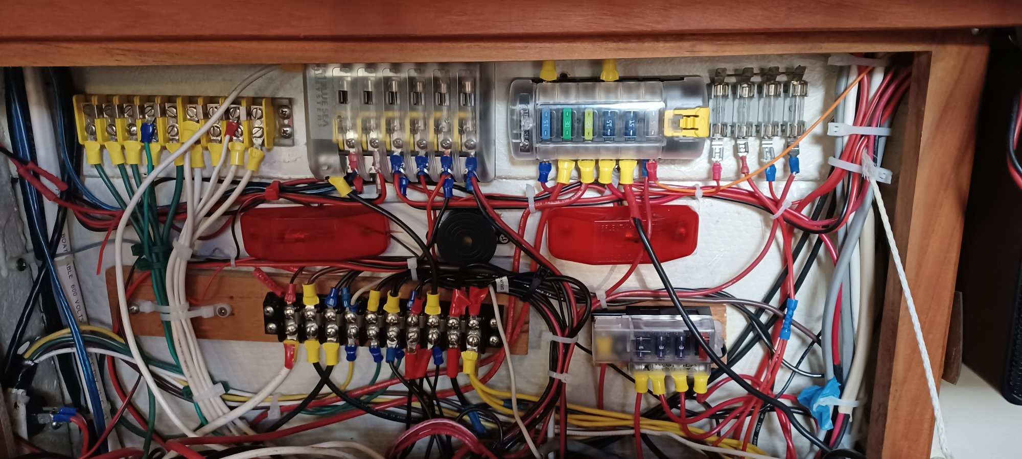

I’m sitting here writing this after waking up from a long night’s sleep. I love waking up to the gentle sway of the boat, but I can’t sit here too long, I have work to do. Last night before hitting the rack, I got the fuse panel mounted where I can be easily accessed for hopefully non existent “issues”. I put it above the house bank in the chart table. It did make putting the batteries in slightly more difficult, but not too horribly bad. Today’s primary goal is to get the engine wired to the panel so that I can start it from the panel. Then if I have time start wiring the main AC so I can get charging to my batteries.

Back in post 133 you showed a very nice Blue Sea breaker panel so I am confused about this fuse panel of which you speak. Can you edify us?
Feb 18, 2022
440
Catalina 36 Port Orchard
So I have both as added protection. the power comes into the panel then through the breaker and then to a fuse and finally off to the device. I was going to use a terminal strip for the transition from the panel to the boat, then the more I was looking into the different systems, I realized I needed a larger variety of safety than just 15a breakers. So I adopted ATO fuse blocks to provide that level of safety. Now I can adjust the needs to each device.

THanks. I have done the same with four fuse blocks, but they are behind my panel.
I have one for my "constant on" (non-switched loads) which are (2) bilge pumps, refridge, freezer, radio channel memory, and hydronic boiler.
O have one connected to "accessory" with fuse drops for heating fans, accessory outlets, charging ports, smoke and CO detectors, WIFI router.
The third is connected to the 15A "Nav/Com" and has fuse drops for NMEA backbone, Chart plotter, auto pilot, and instruments. That way I can switch them all off with a single switch but still have the exact protection each calls for.
The forth one is for radio and communication.
I also have a 200A class-T fuse connected to my 560A LFP bank.

All but 2 of my switched loads will be under the chart table, I will have to put 2 on the “always on“ fuse panel that will live behind the switch panel. I thought about putting everything behind the panel but I didn’t want to make that area too crowded.

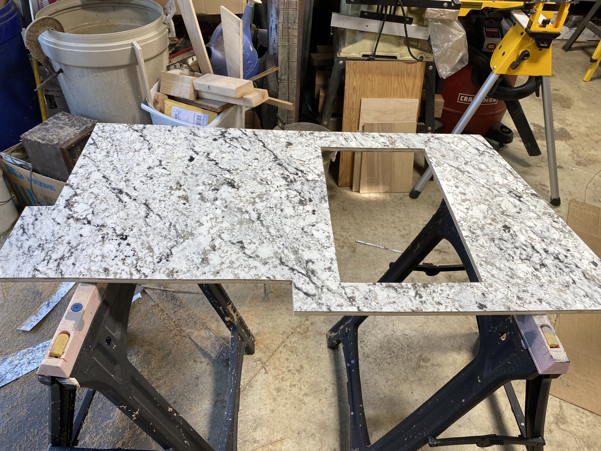

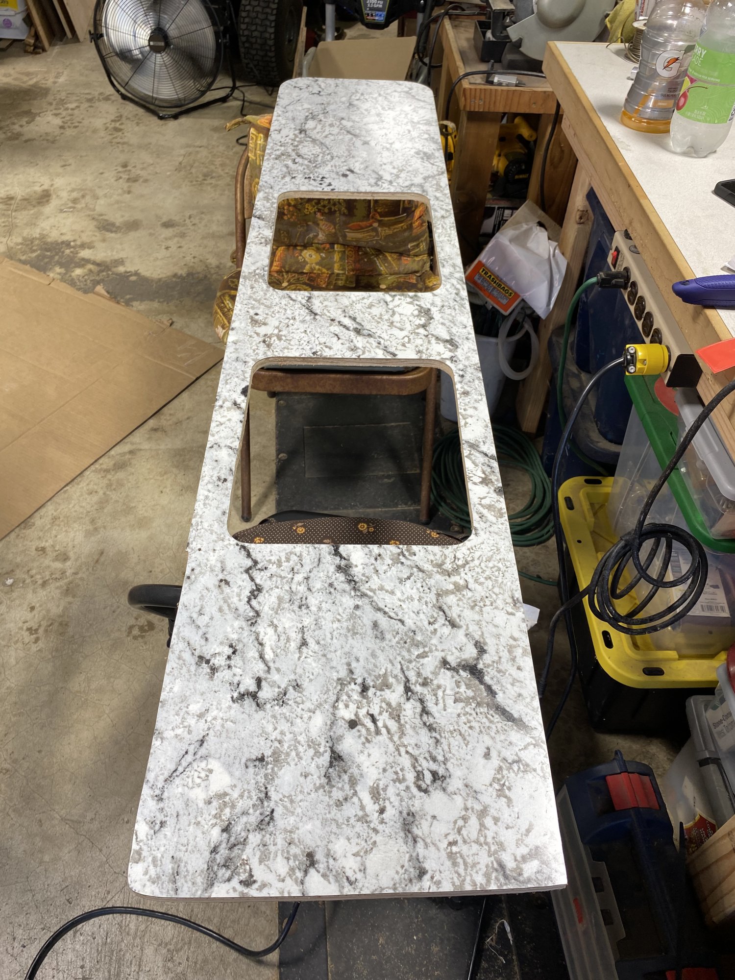

Countertop laminations are done! It didn’t go perfectly but close enough that you will never know unless I point it out so I’m just not gonna say anything… lol. It wasn’t hard to do, and I’m thinking This is going to look so much better than the woodgrain laminate did.
And yes for those with a sharp eye, there is a piece missing from the area behind the stove. 2 reasons it’s not attached. 1. I didn’t have enough wood to cut it out in one piece, and 2. Having it done in 2 pieces will make putting it back in the boat much easier. I will screw down the countertop in 2 additional locations to make up for building it this way. No biggie.

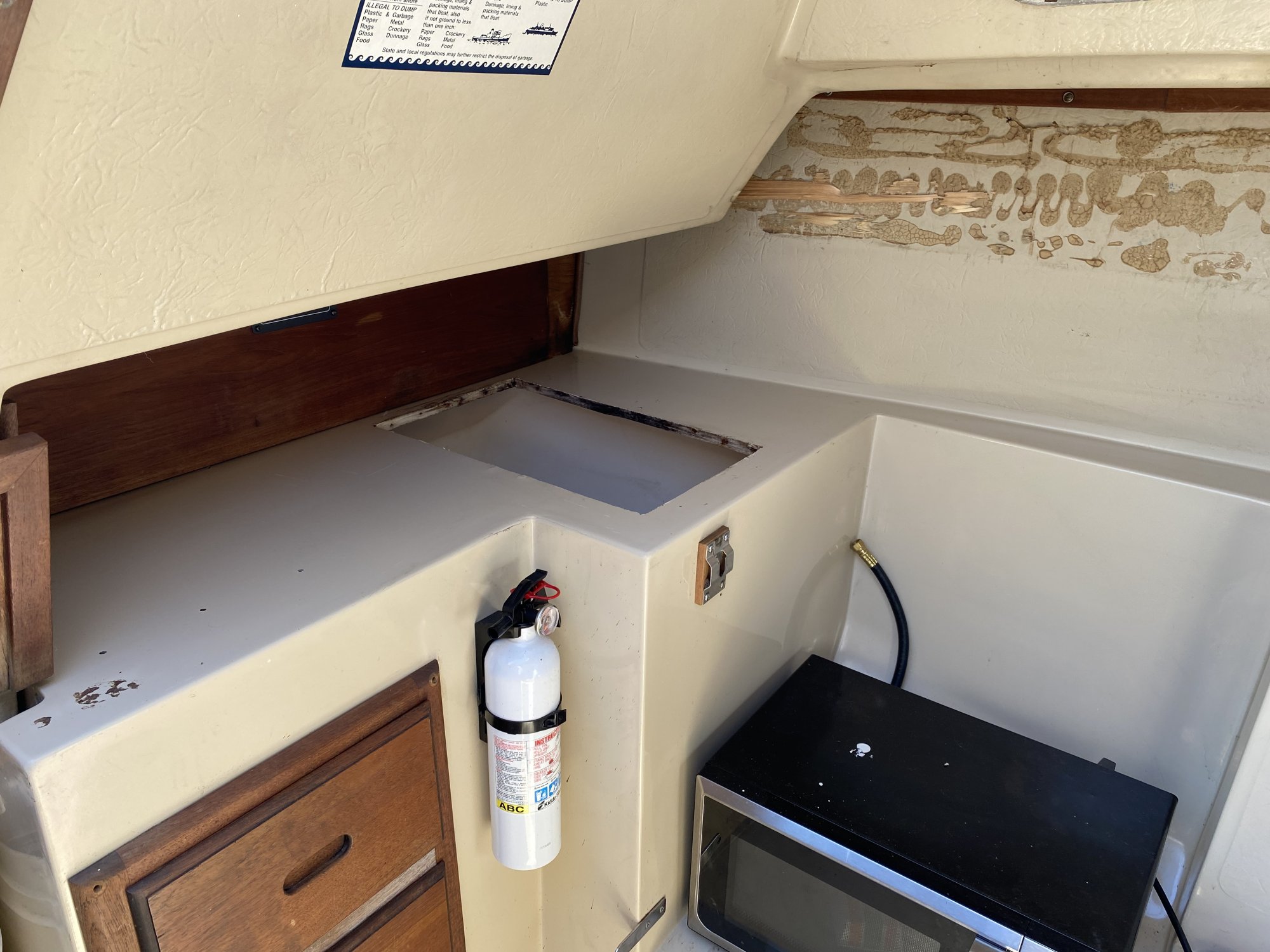

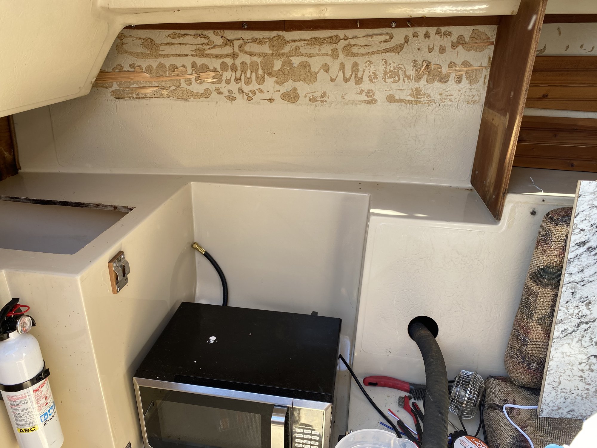

Well done. You are the first C30 owner I have seen that has removed the aft portion of the counter. Can you tell us the details of how it comes out and what you found underneath? Over the years there has been a lot of discussion about improving the icebox insulation and having attempted the same on my previous boat (C25) know that it is not really doable from below. I would love to see some photos of the top of the icebox cabinets without the counter.
Feb 18, 2022
440
There are 4 or 5 screws in the port Lazzarette that hold the aft portion of the counter down, then a couple inside the cupboard. You will need to remove the cupboard to get the counter out. Lastly the drawers beside the ladder hold a couple more screws. Then it’s shimmy it out time. I had to loosen the trim by the ladder bulkhead to free the countertop up. I had to remove mine because of rot
I don’t have any pics of the area around the icebox with the countertop off. Frankly it wasn’t that interesting of a place for a pic, it’s pretty much the same as with the countertop on only made out of fiberglass. Access to the ice chest is about the same as before. When the drawers are out you can easily access 1 side of the icebox and with difficulty the aft side, but it’s all coated in expanding foam. You still can’t get the shelf out of the icebox either.
I got the pics of the counter area with the countertop off for ya. Like I said, there isn’t much going on here, mainly just a fiberglass counter.
