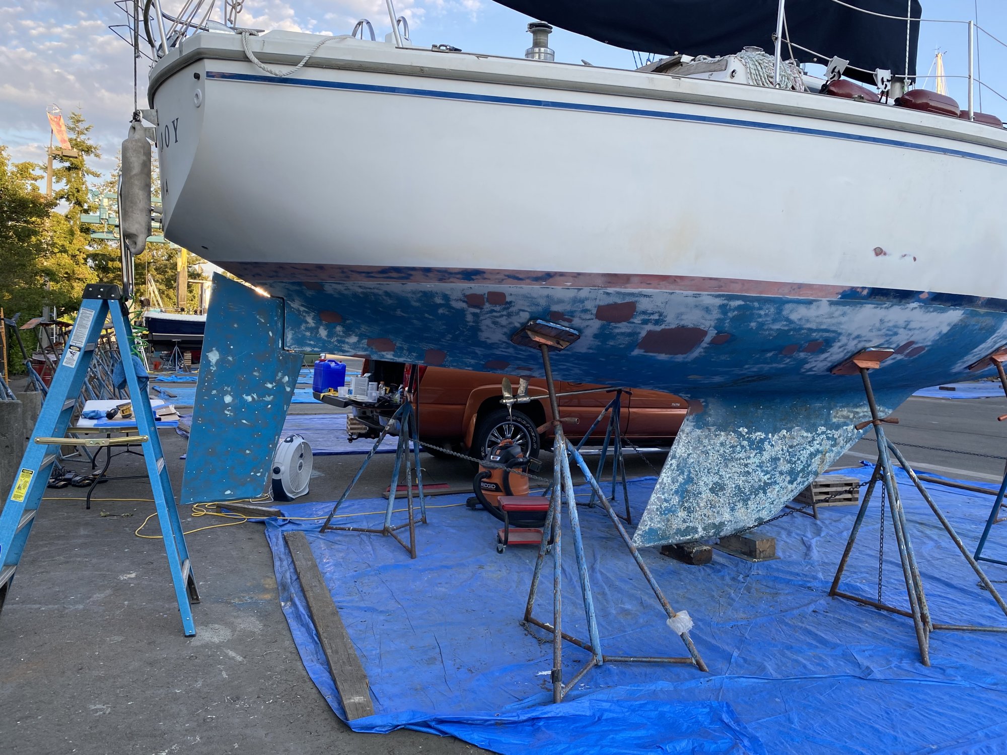

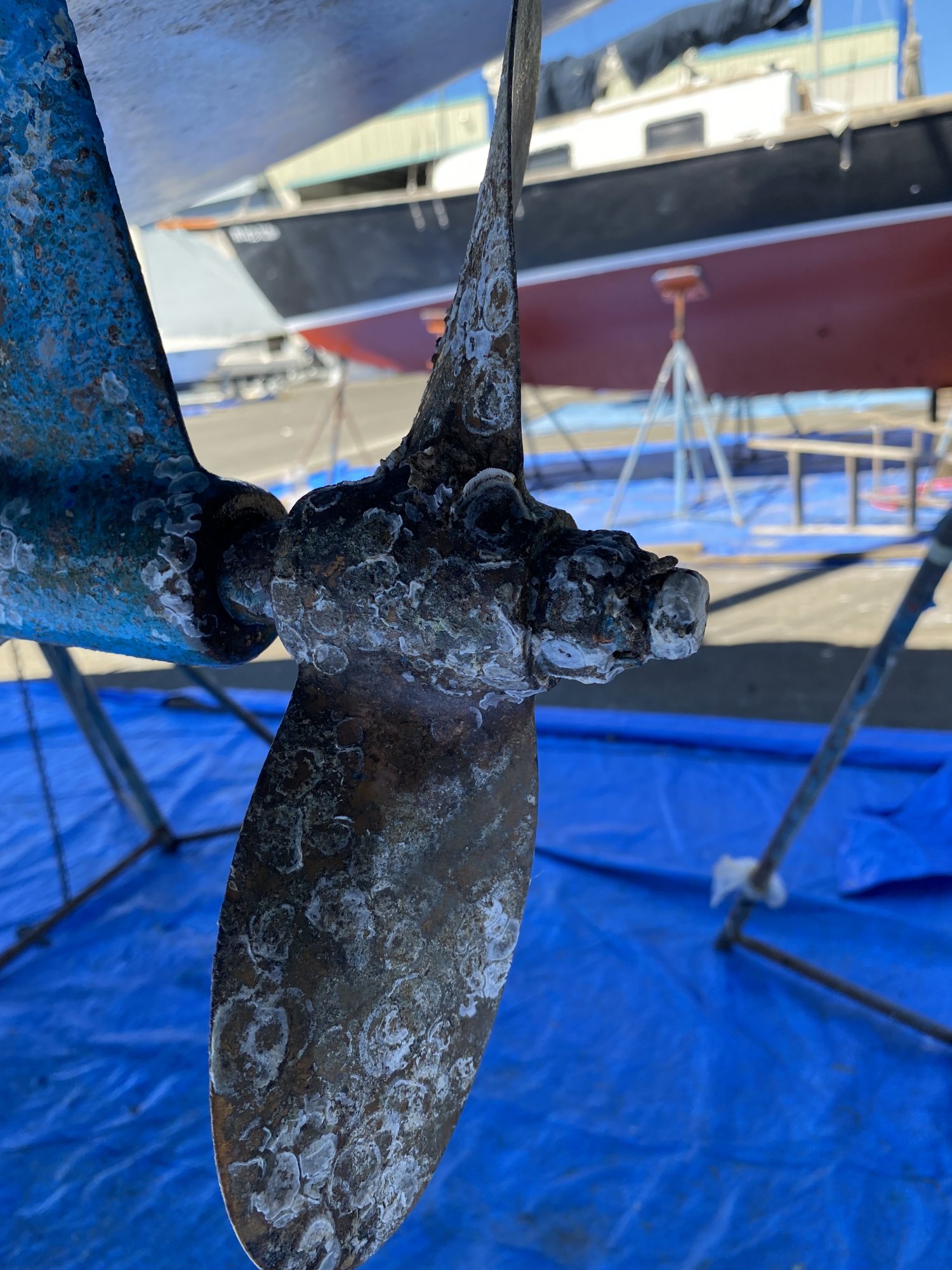

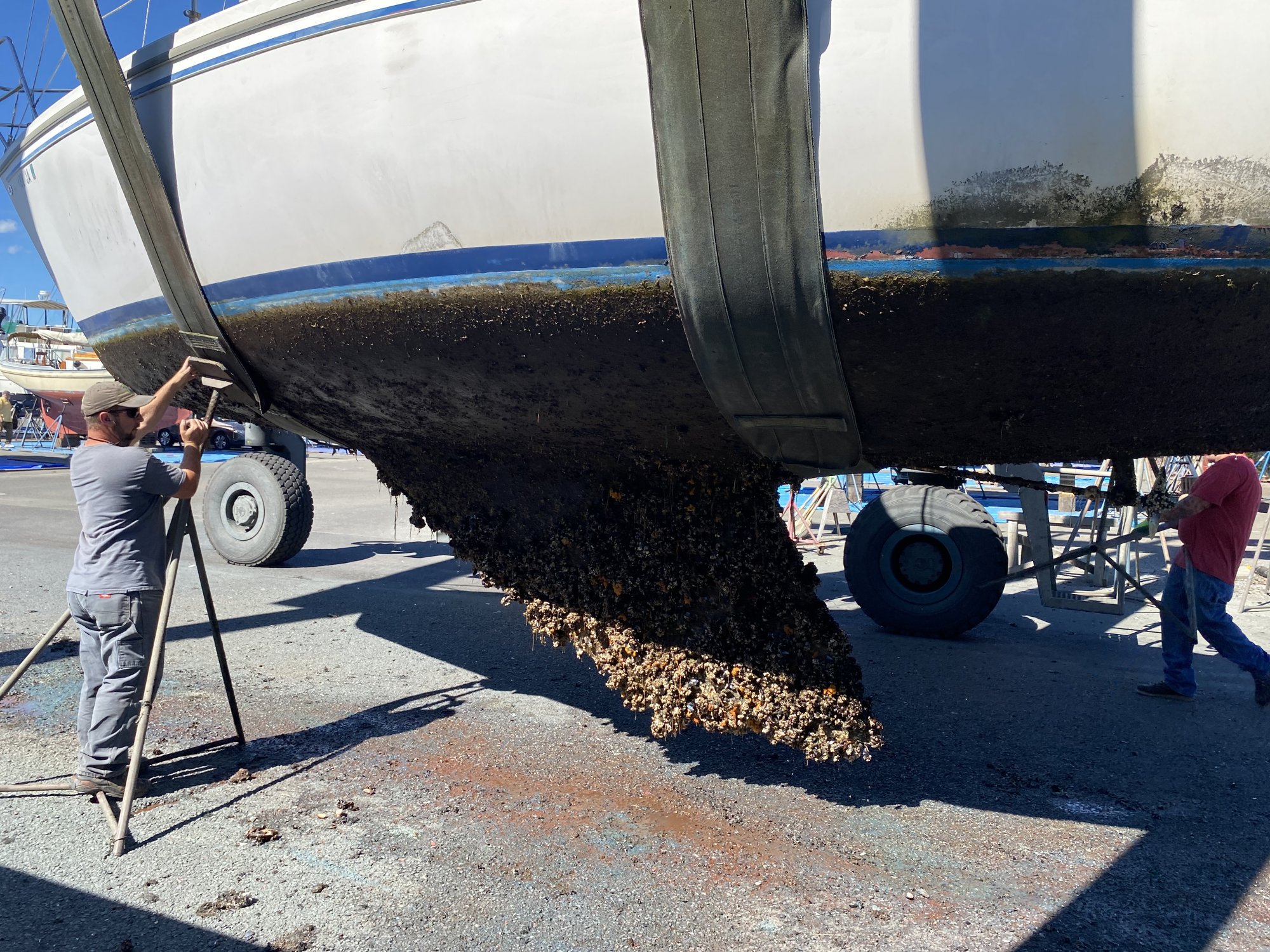

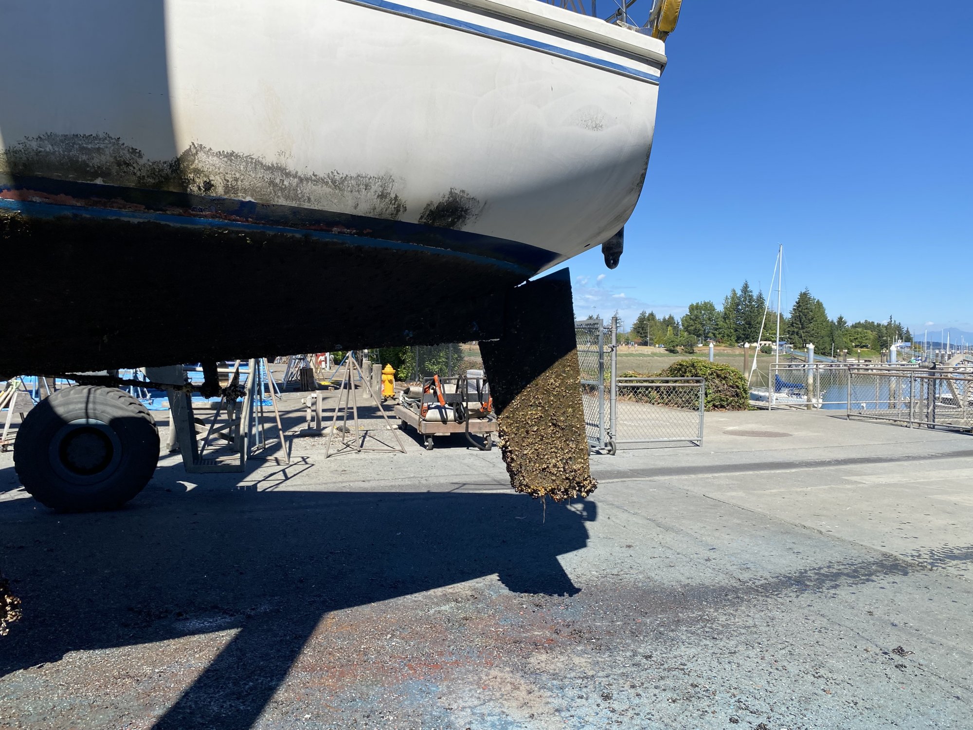

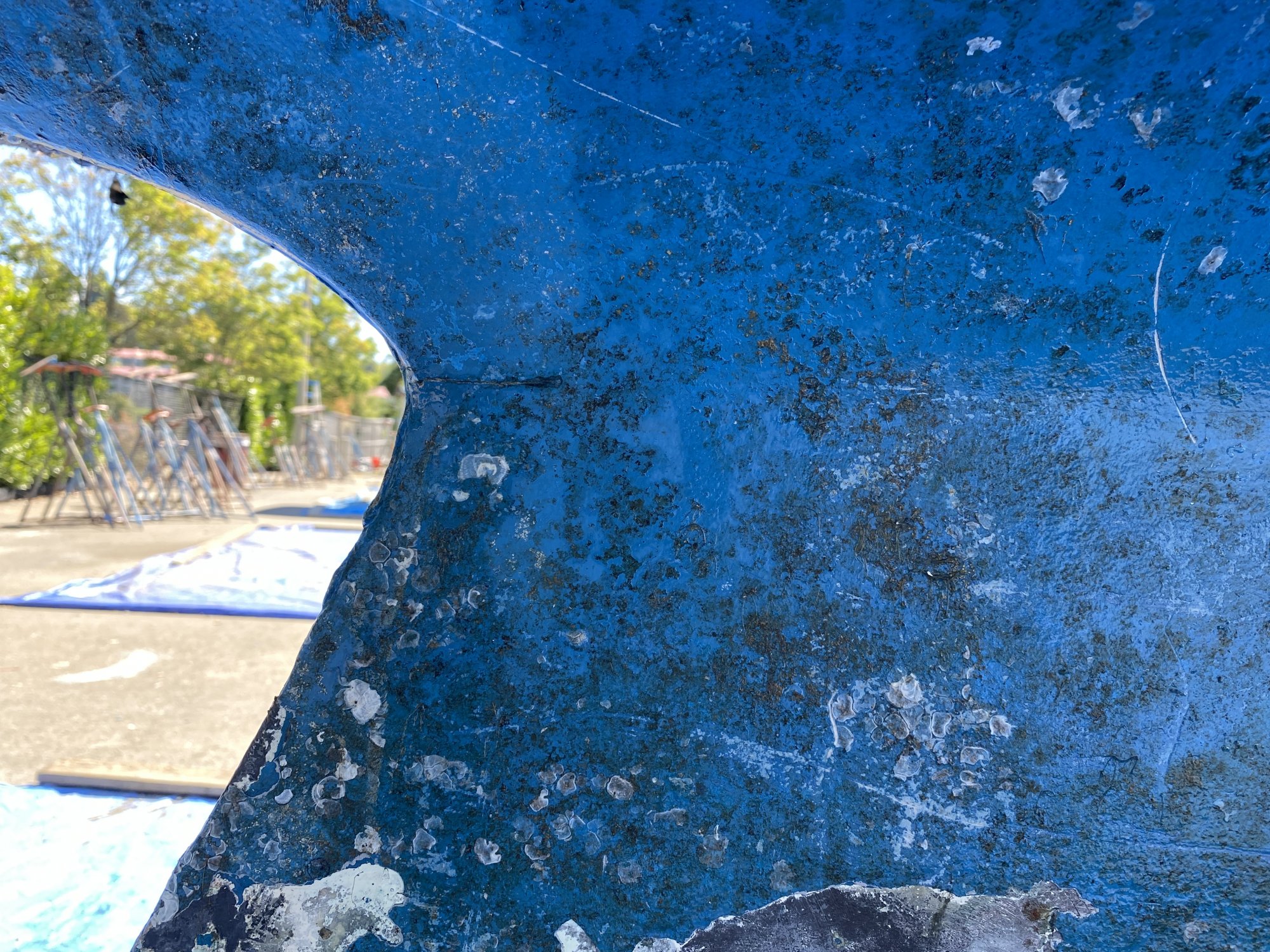

Well I think I figured out why I was only making 2.5kts. There was at least 200lbs so stuffs on my hull. The guys at Swantown cleaned it up all pretty like, and I took over after that.
I started with the water leak on the exhaust flange. Well it turned out the bolt was perfectly fine, but the manifold broke. The bolt only goes in about 1/4 of an inch and that part didn’t wanna hold any more. There is a 3/4 inch deep hole that I’m gonna drop a stud into and attach the flange that way. Problem solved.
Then I went on to the sea cocks for the galley sink and engine. WOW was I lucky here, or Luna was lucky as they pretty much turned to dust when I tried to remove them. I was able to get them off without damaging the threads. Those things are not cheap, but I have 2 new brass ones.
Alternator is out and a new one should be available by Wednesday. My oil pressure switch was also broken so I bought one from a 65 Chevy that operates with similar oil pressures, it should work, and was much cheaper than the Kubota one.

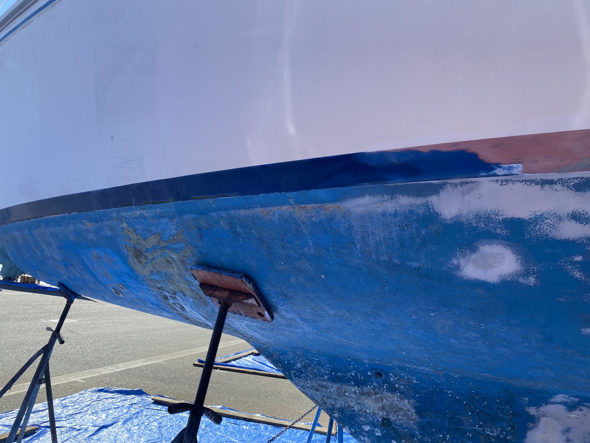

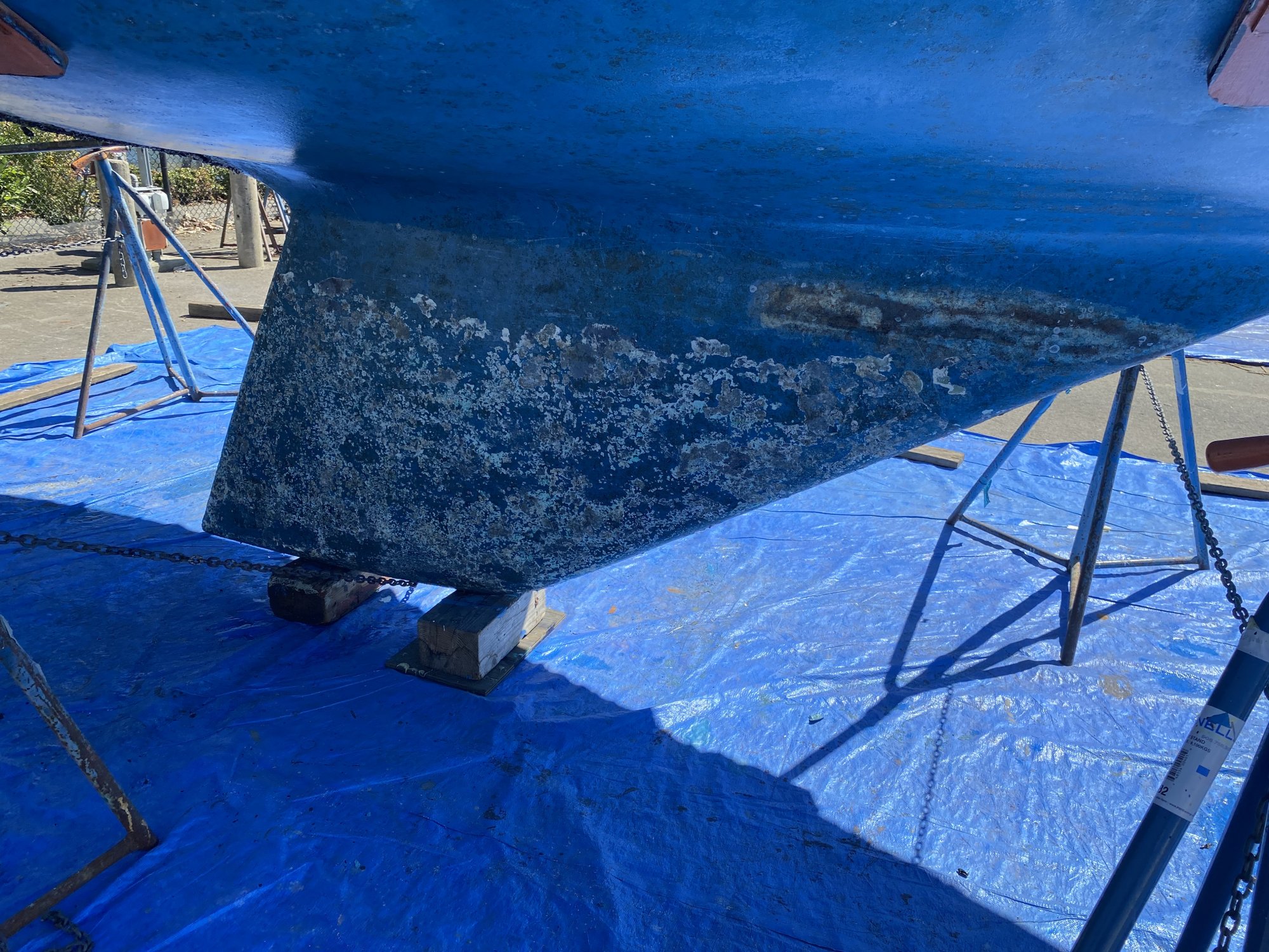

And lastly the sanding. I worked on the shady side of the boat as far as I could with the cord I had in hand. I found a couple blisters that were about 2” or 3“ after I ground out the bad glass, and none are too deep, usually just a single layer. I found a Catalina Frown. You know a ”smile” on the rear of the keel. It looks like it has been repaired before and the epoxy or 5200 (whichever it was) just cracked a little. I dug it out a bit and it doesn’t look like it goes past the fairing compound they used. The front of the keel looks great. Tho I did notice that there is fiberglass on the front of the keel about 4 to 5 inches down, it looks like that was how they repaired the “smile” in the past.

Looks like Luna had been doing her best to support the local marine population.

Yup, that will slow you down, looks like it was due for a cleaning. Glad you made it to the haul out safely.

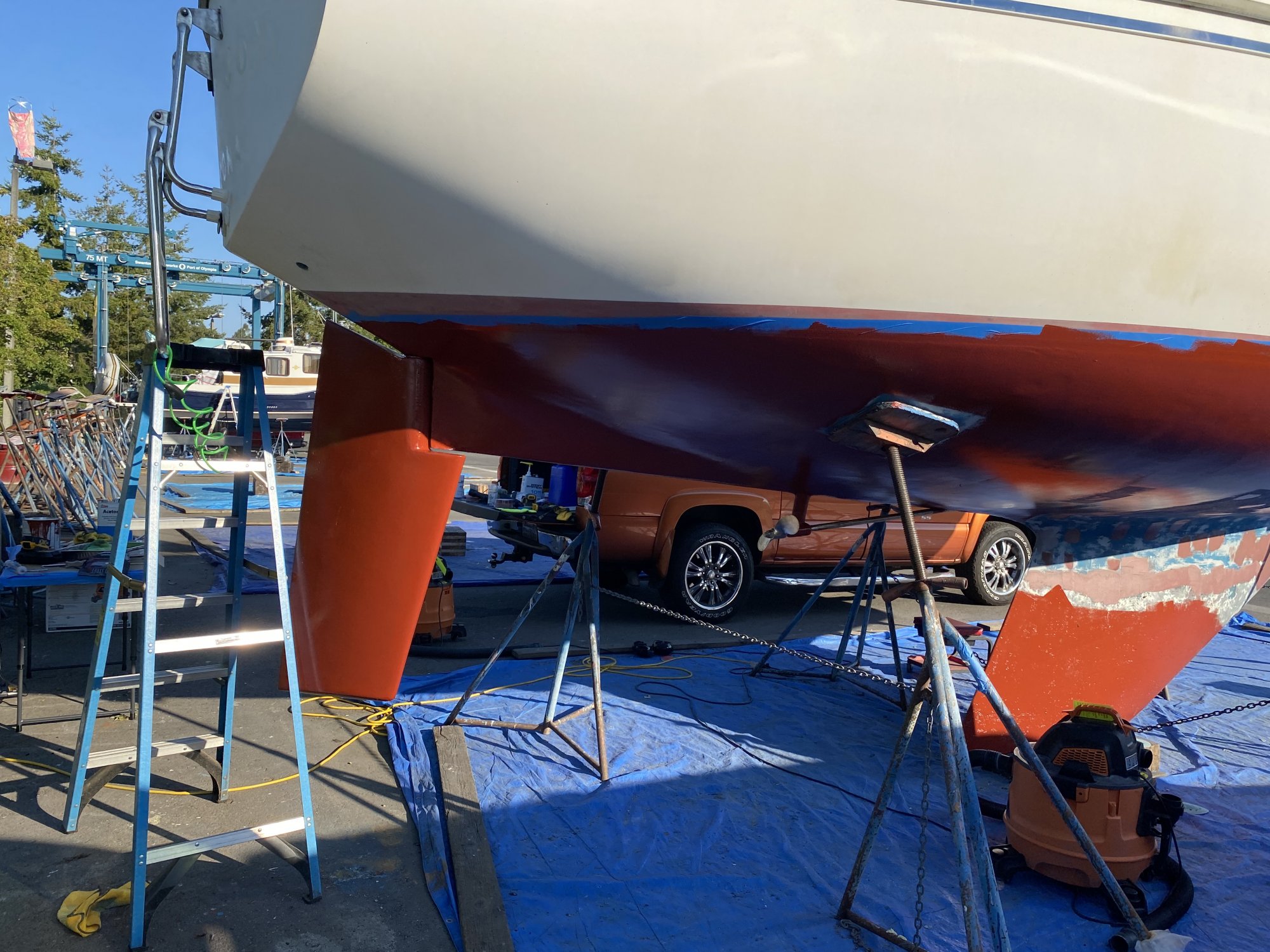

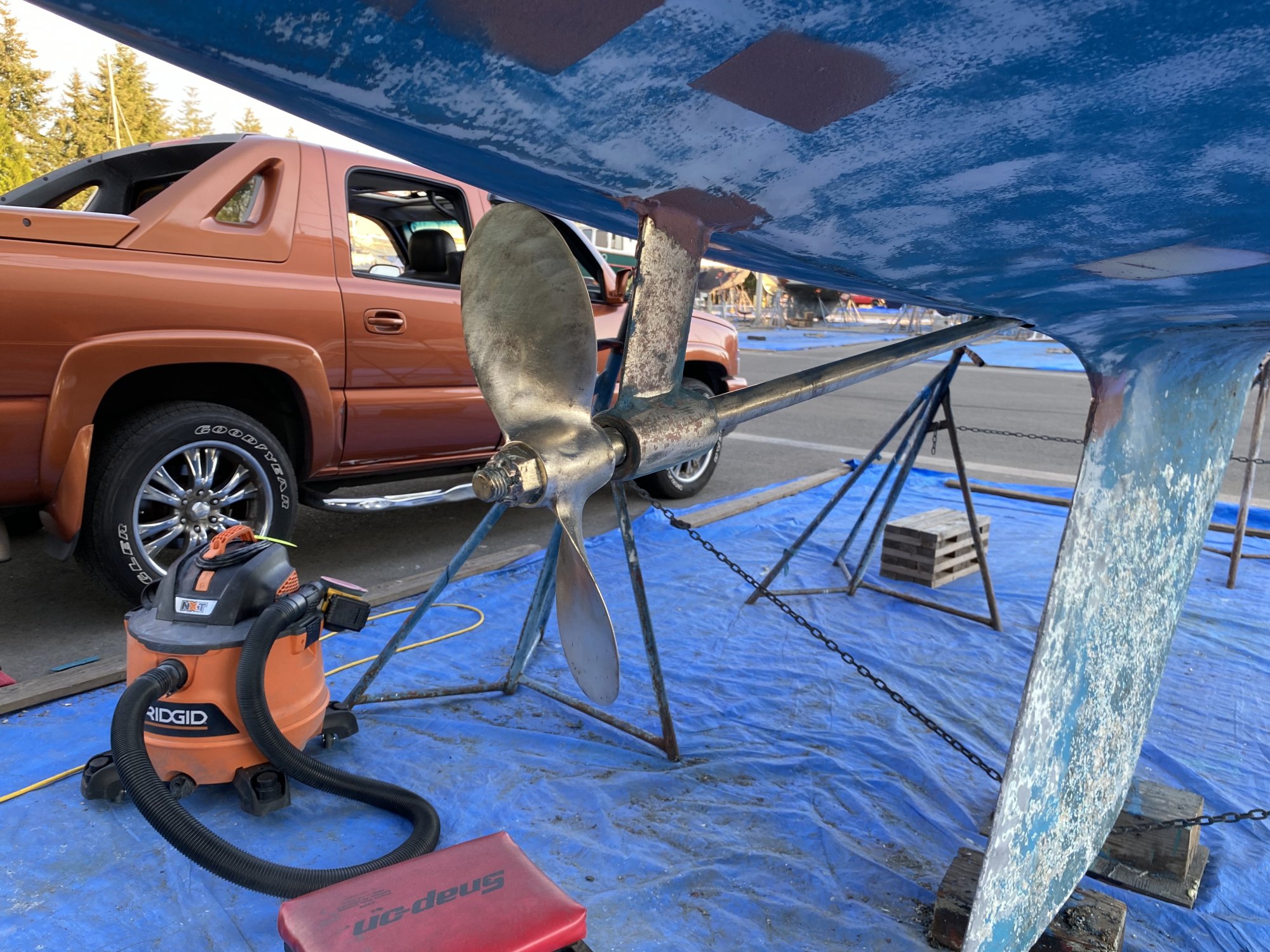

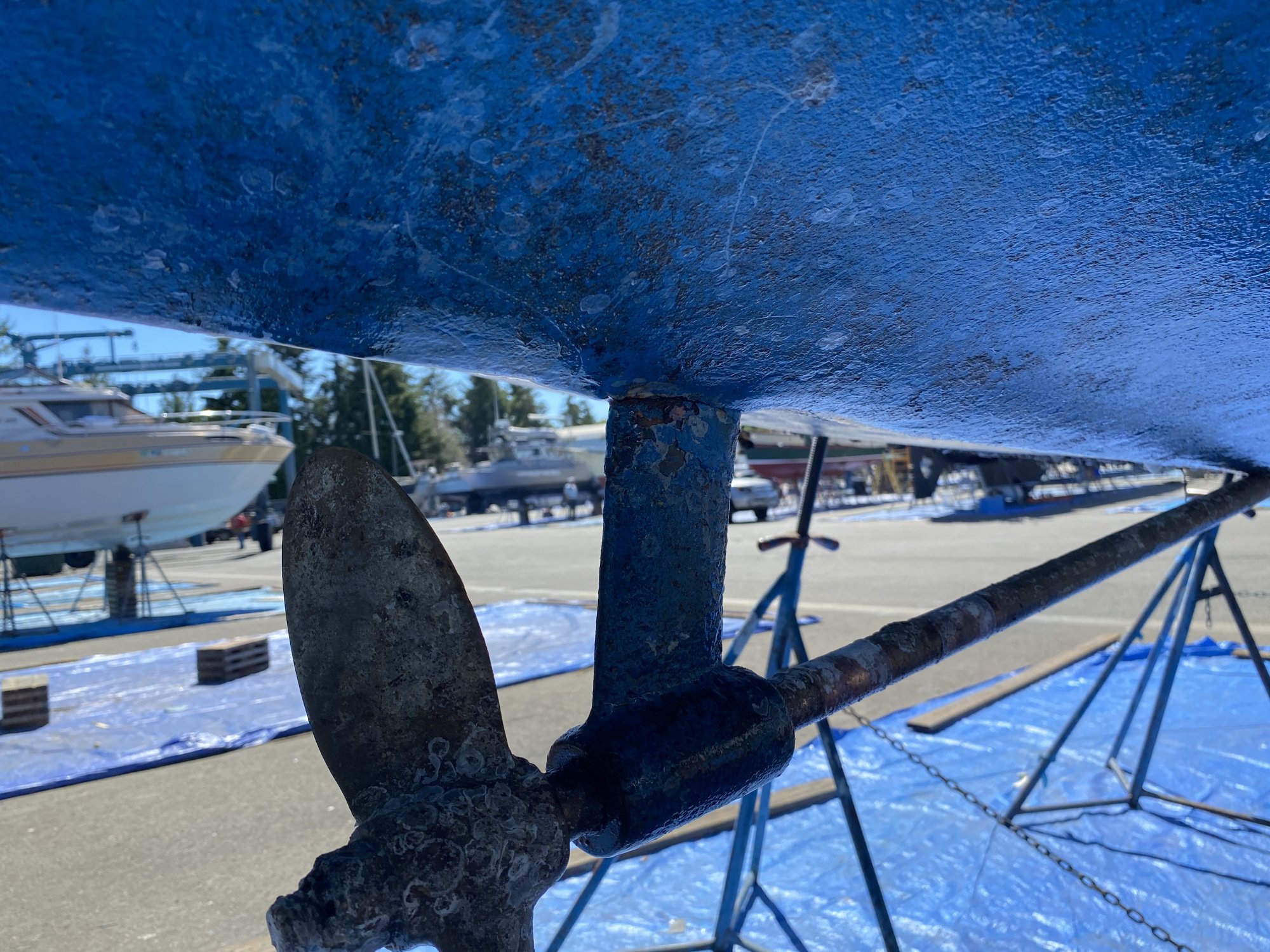

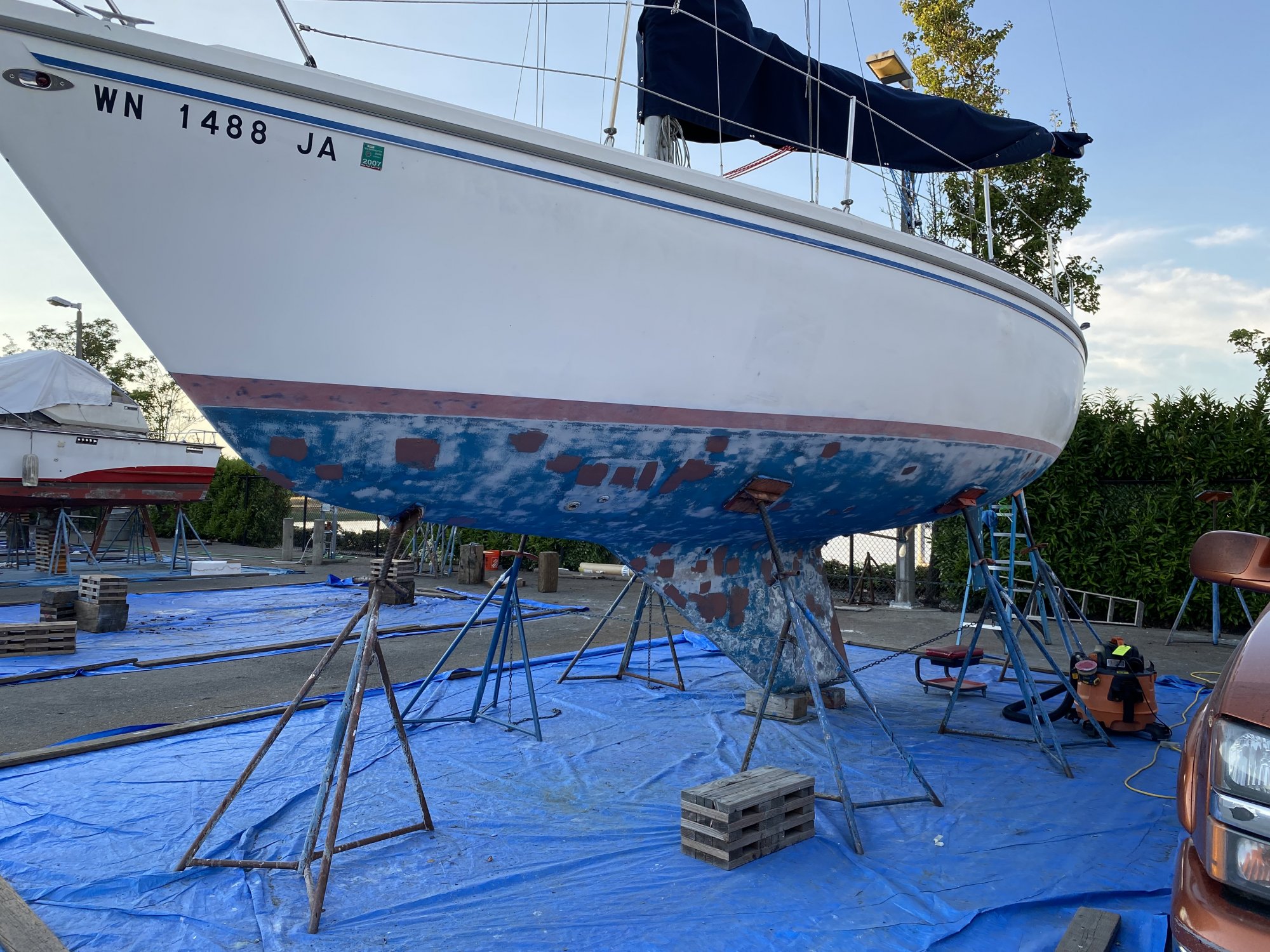

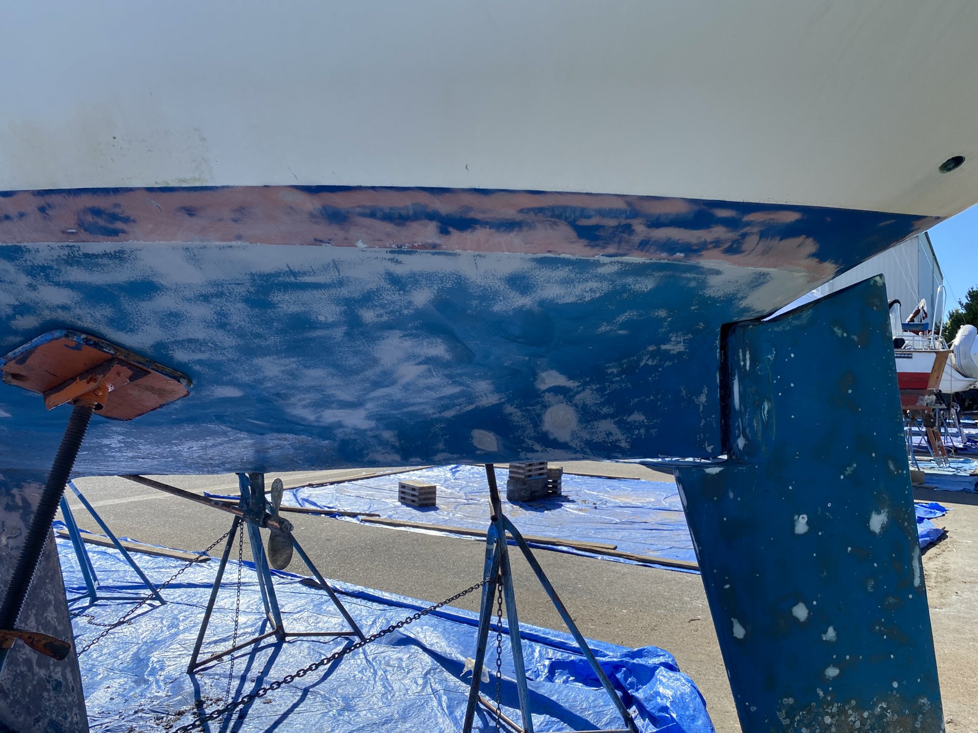

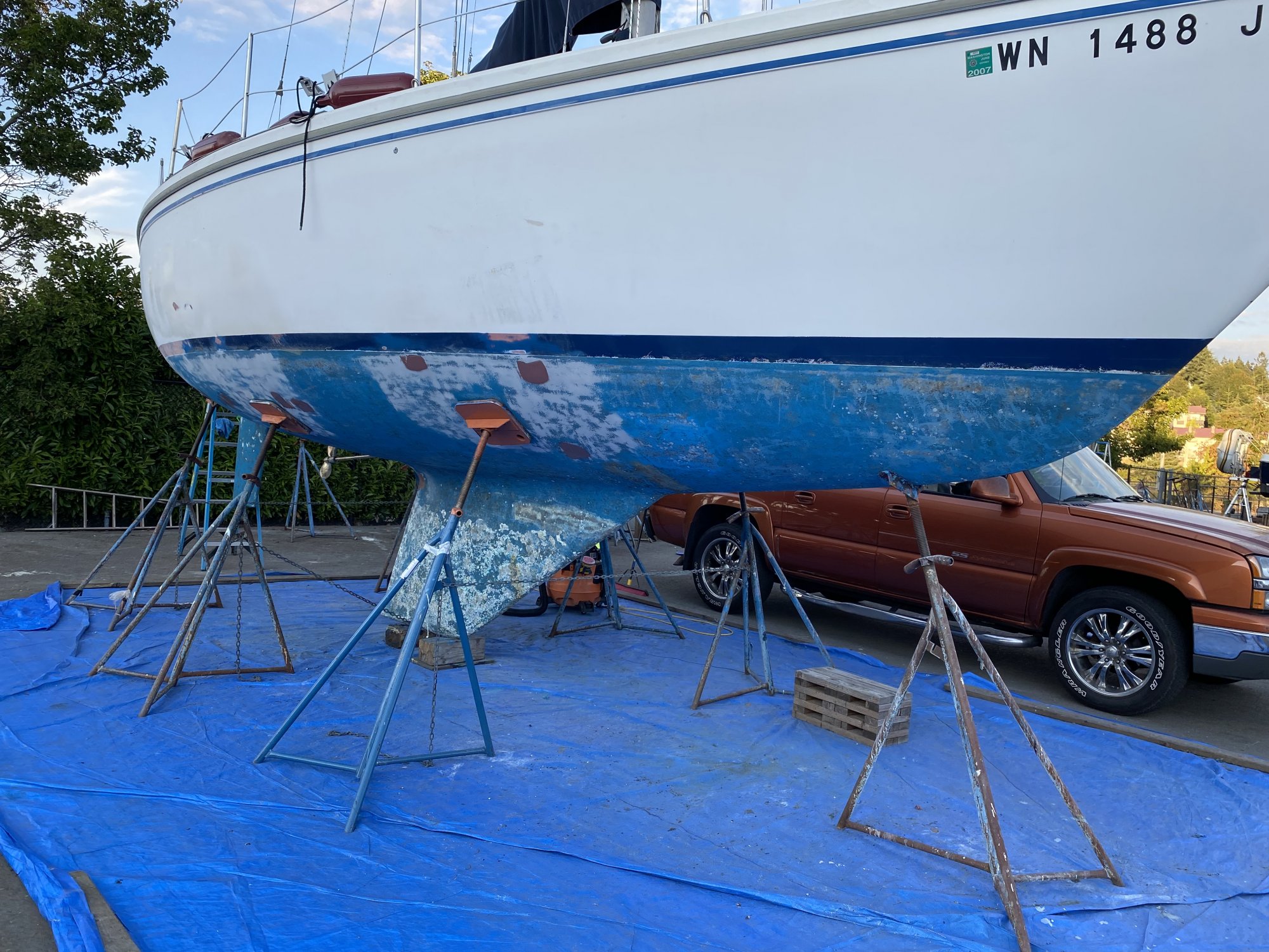

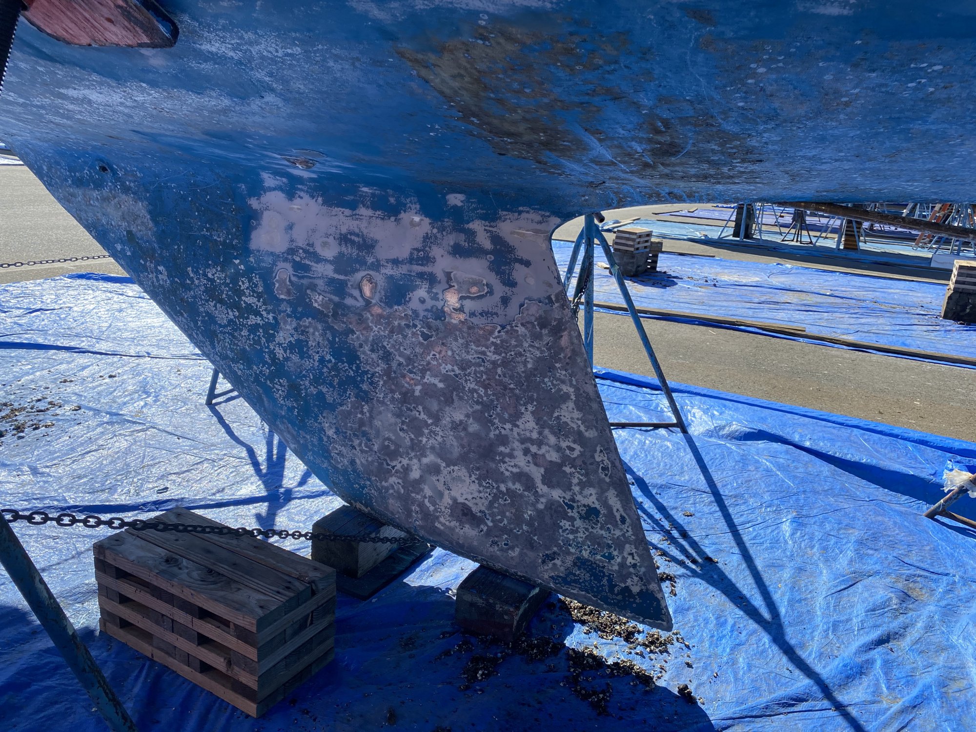

We put in a good solid 8 hours today and we are about 3/4 done sanding. The sun cooked us off the Starbaord side to we moved over to port and finished port sanding and before I left I filled all the blisters with thickened epoxy. Speaking of thick… the area that gets the smile was repaired on my boat in the past and wow did they lay the glass on thick in that area. All is good. The frown area got dig out and epoxied. I also took a wire brush to the prop and shaft I’m happy they are not pink. There was a little pink on the strut but it sanded off easy and wasn’t deep.
Got studs for the exhaust manifold, I had to go fine thread at the top, it’s all they had in grade 8 and the size I needed. Oh well. Lemme see… I’m sore and that’s about it.

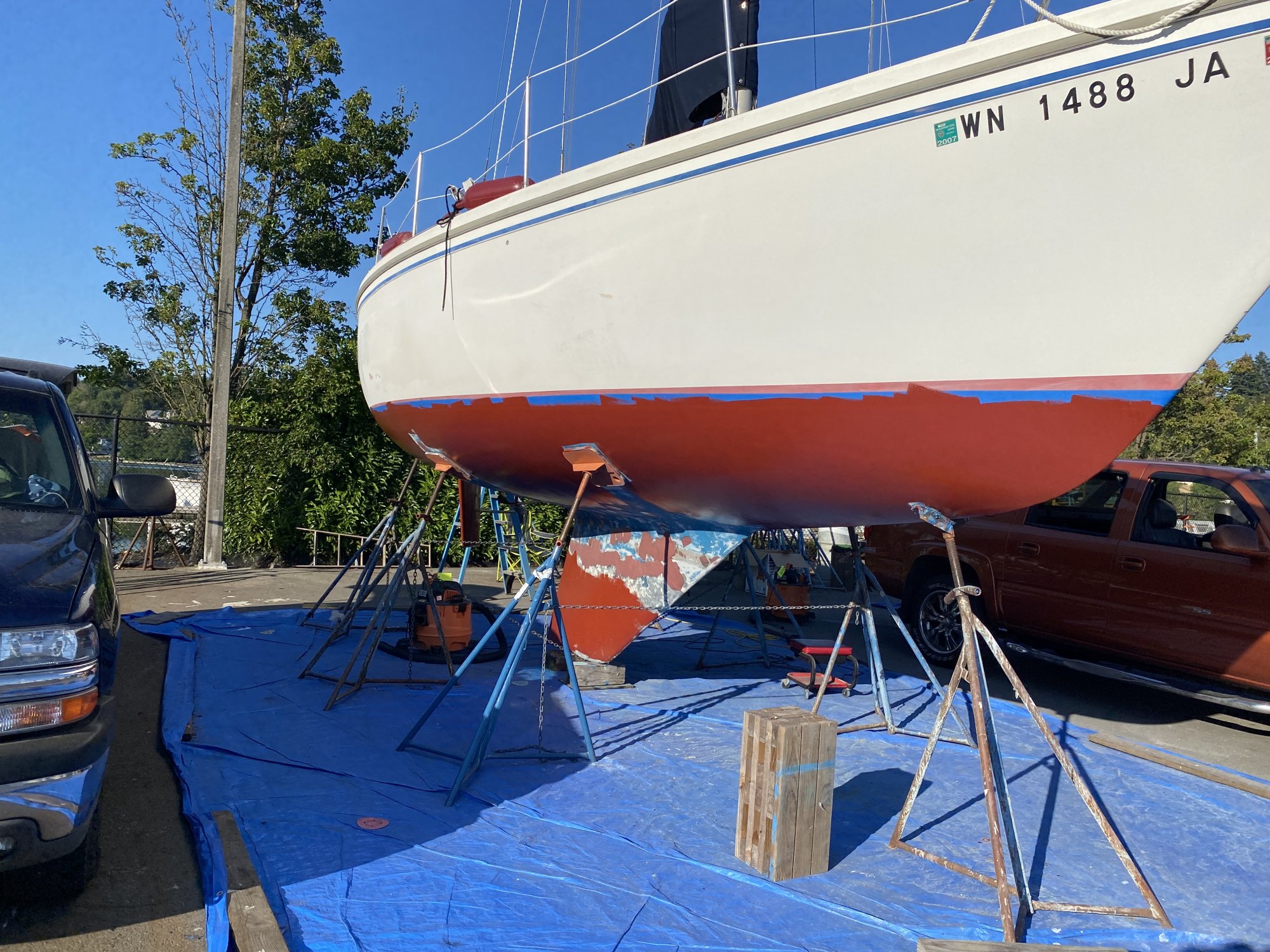

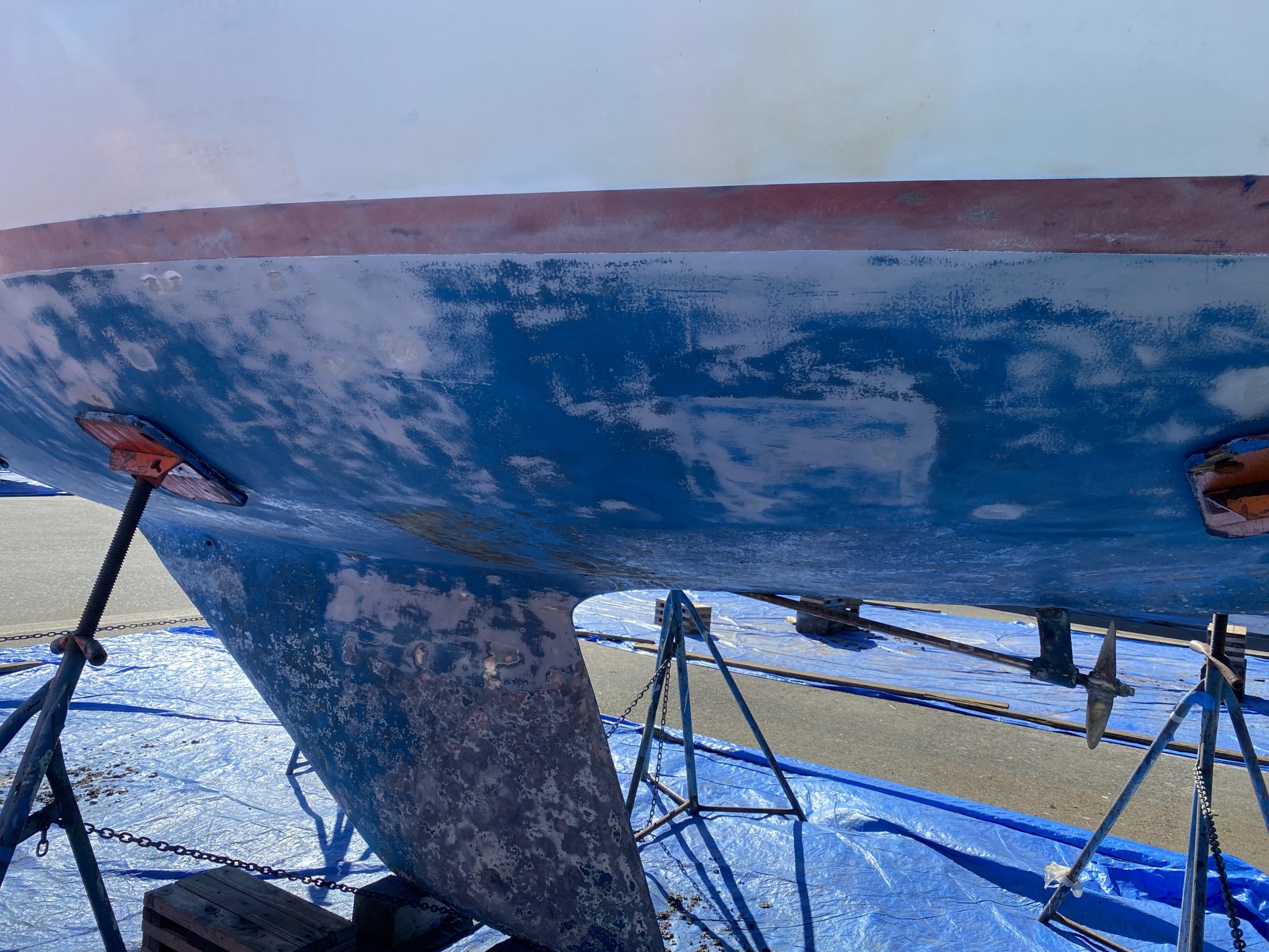

Wow has this been a busy week. My body isn’t used to this kind of labor, but I have been enjoying the process.

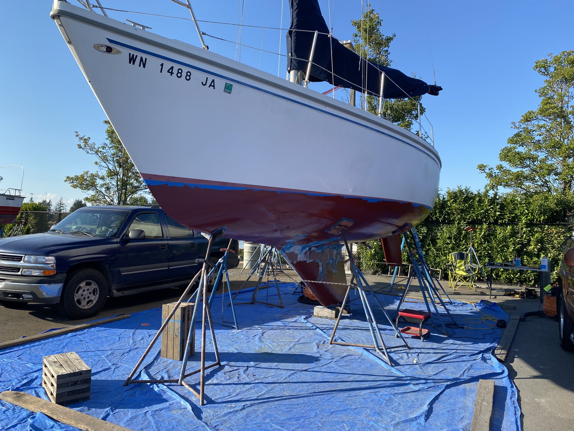

So there were a few more blisters found, and filled, we finished the sanding and faired the keel and did some more sanding. I needed to get a coat of paint on tonight to make my schedule and I got it… well most, the area we faired wasn’t ready to be sanded so we simply didn’t paint there. Maybe an hour or two more sanding and it will be 100%. I didn’t count but I estimate about 40 blisters in total, which surprised me there wasn’t more. Oh and I found a few from the last time it was painted, they just broke them open and painted over them. They didn’t grind them out. I did. I couldn’t just let that go.
My new alternator showed up and wouldn’t ya know… it’s not the same! Great! But good news is it’s a sealed unit, it puts out more power and is physically the same dimensions, so ok! 46a at idle and 63a at 2000 RPM. That beats the 51a the other one put out.
