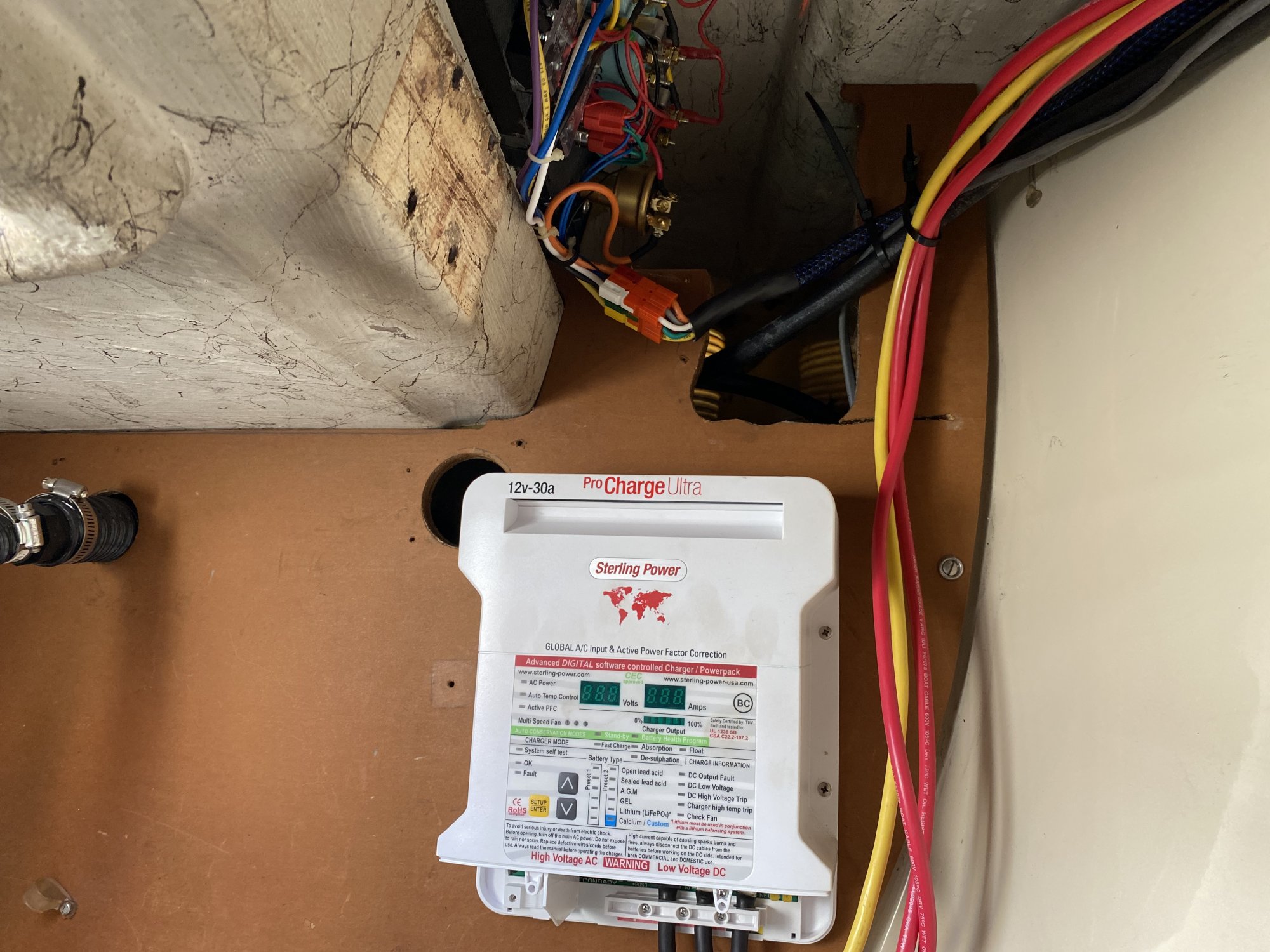

I was so glad for the holiday today. I stayed out on the boat last night and got a few more wires run, and things planned. I used some 5200 Black to glue a piece of teak to the hull so I can mount my ACR but as of 5pm today it was still not cured. How long does that stuff take to cure.

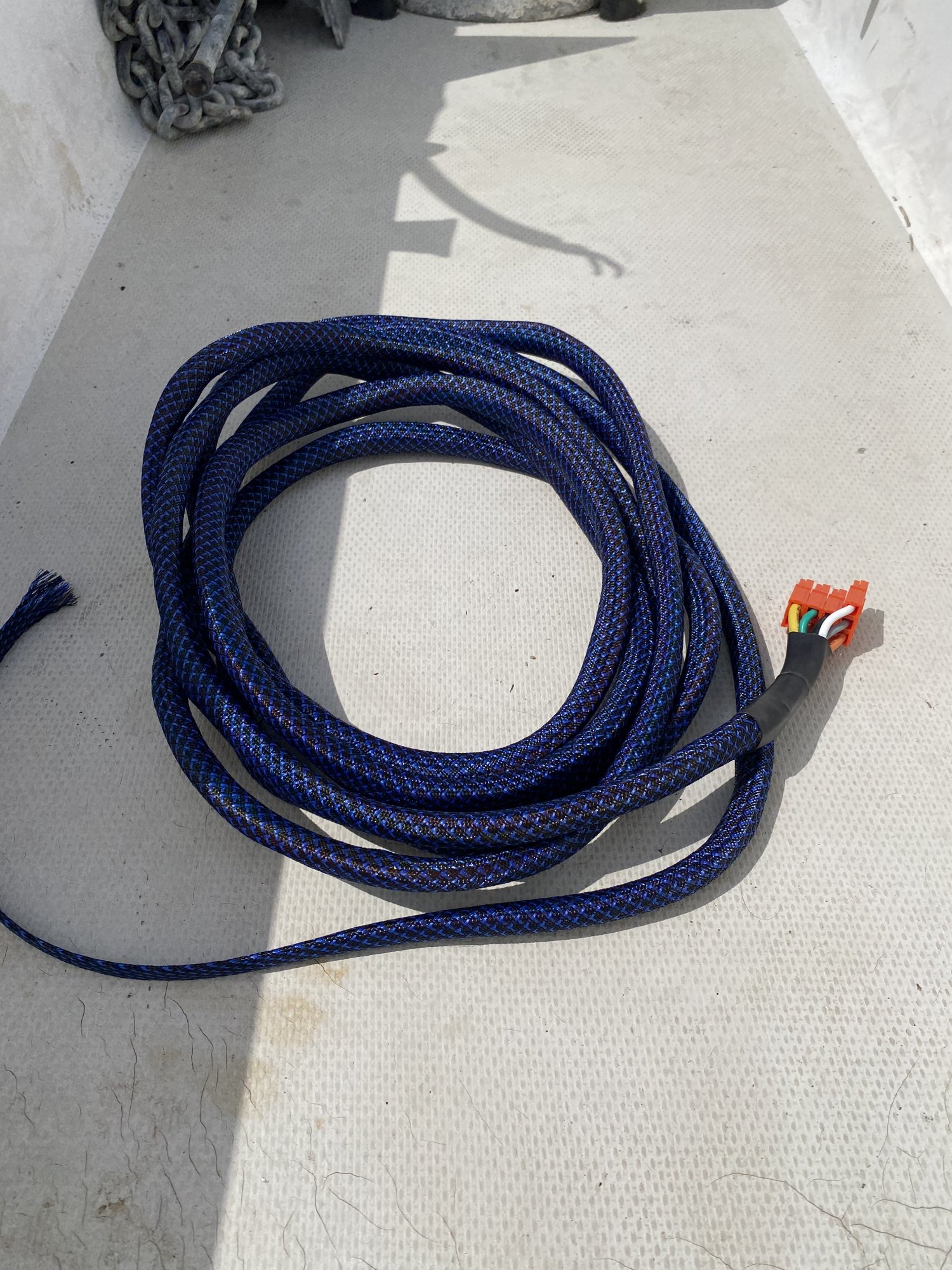

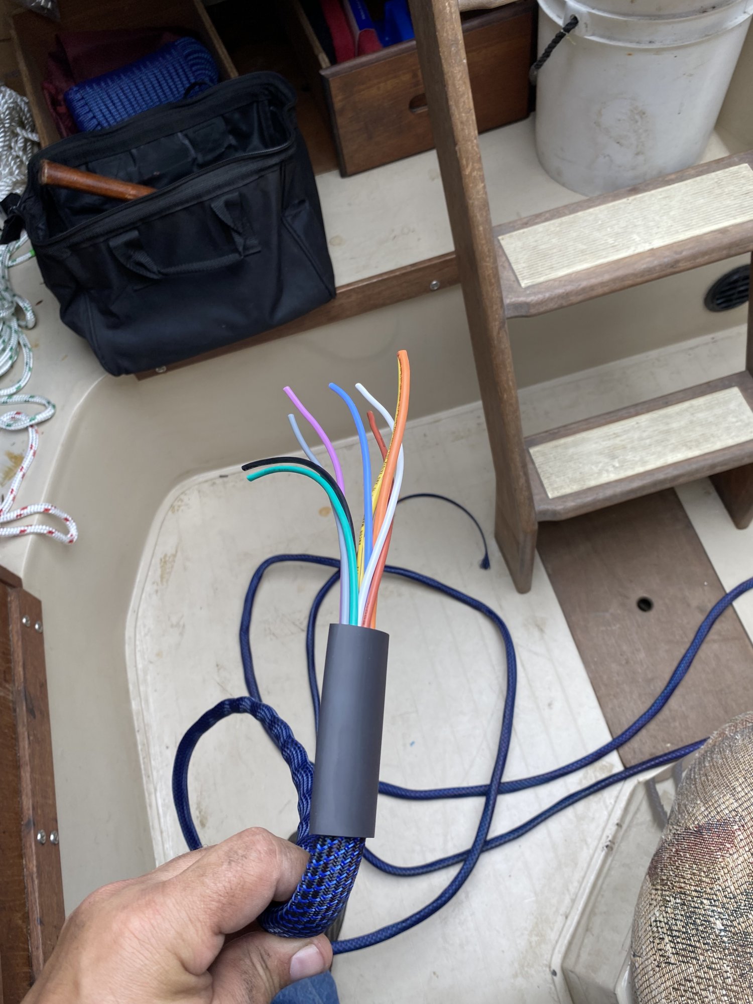

Well I got the panel to engine harness almost finished. Here is the start of the build, I got all the wires cut to length and wrapped in the shield material.

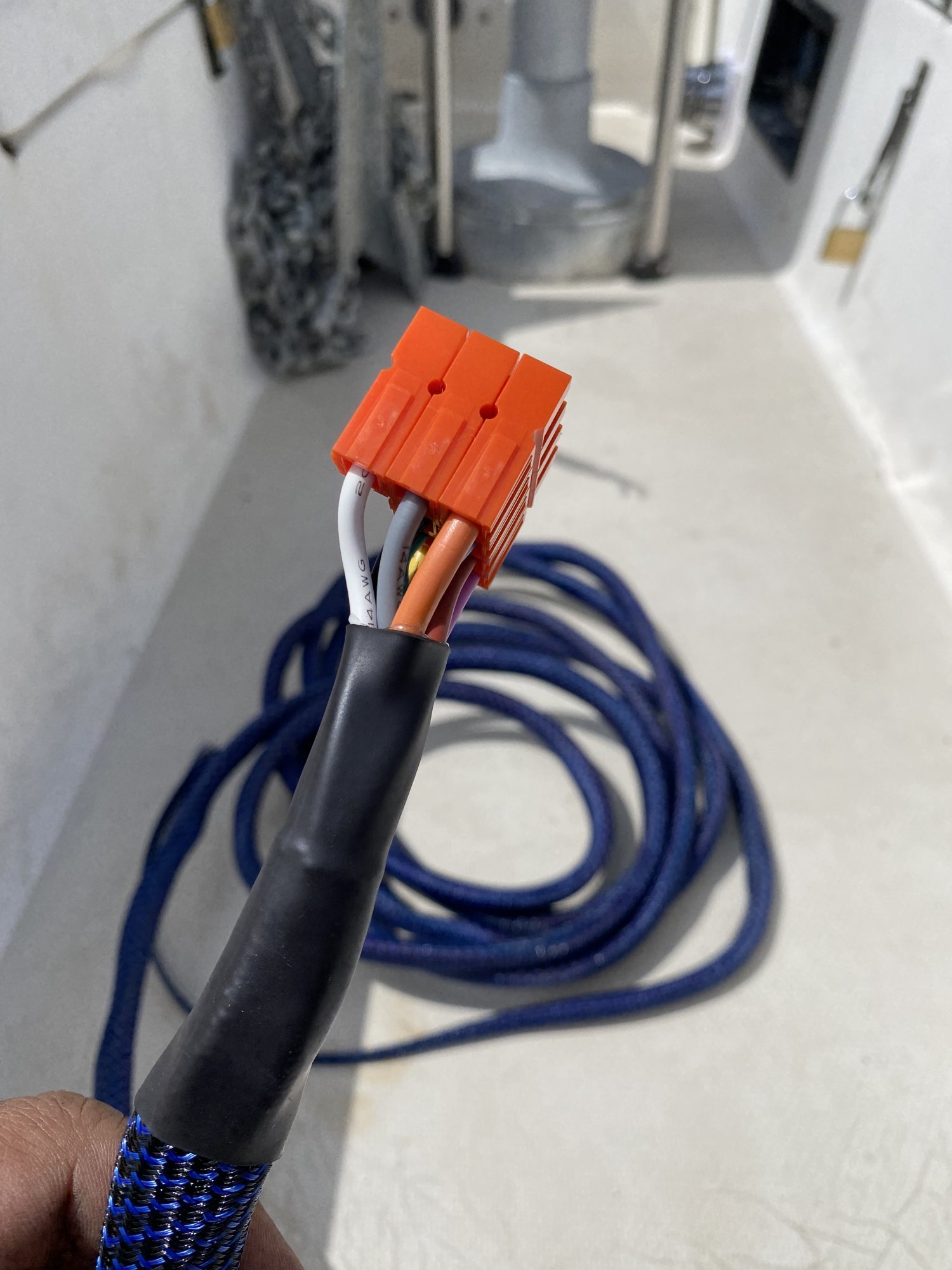

Next up is building the plug assembly and lock it down with the heat shrink.

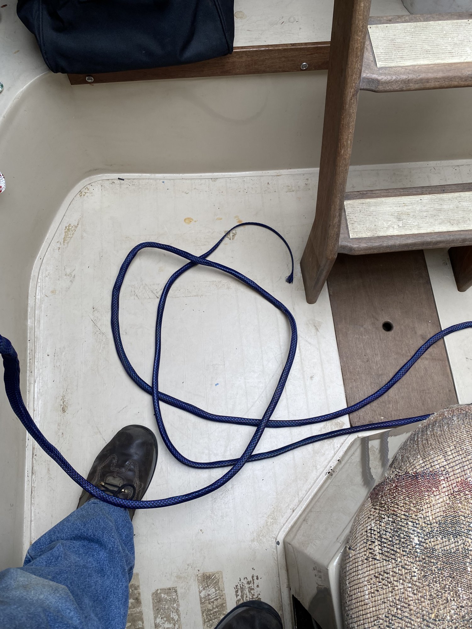

Next you get to fish the wires through the boat to their new home, wherever that may be.
And last is building the plug for the engine end. But there are no pics of that... I haven’t done that part yet. What I did do, was run the charger wires for the batteries, installed a negative bus, and I decided to go with a positive bus on the starting battery, just to make things cleaner. I created the majority of the large cables, and laid them out nice and neat. I found out that the fluorescent light in the salon actually works, and it’s a DC light. Next up is mount the ACR if the 5200 ever dries, and finish the large cables. Then move onto the various systems and get them squared away! I’m close!

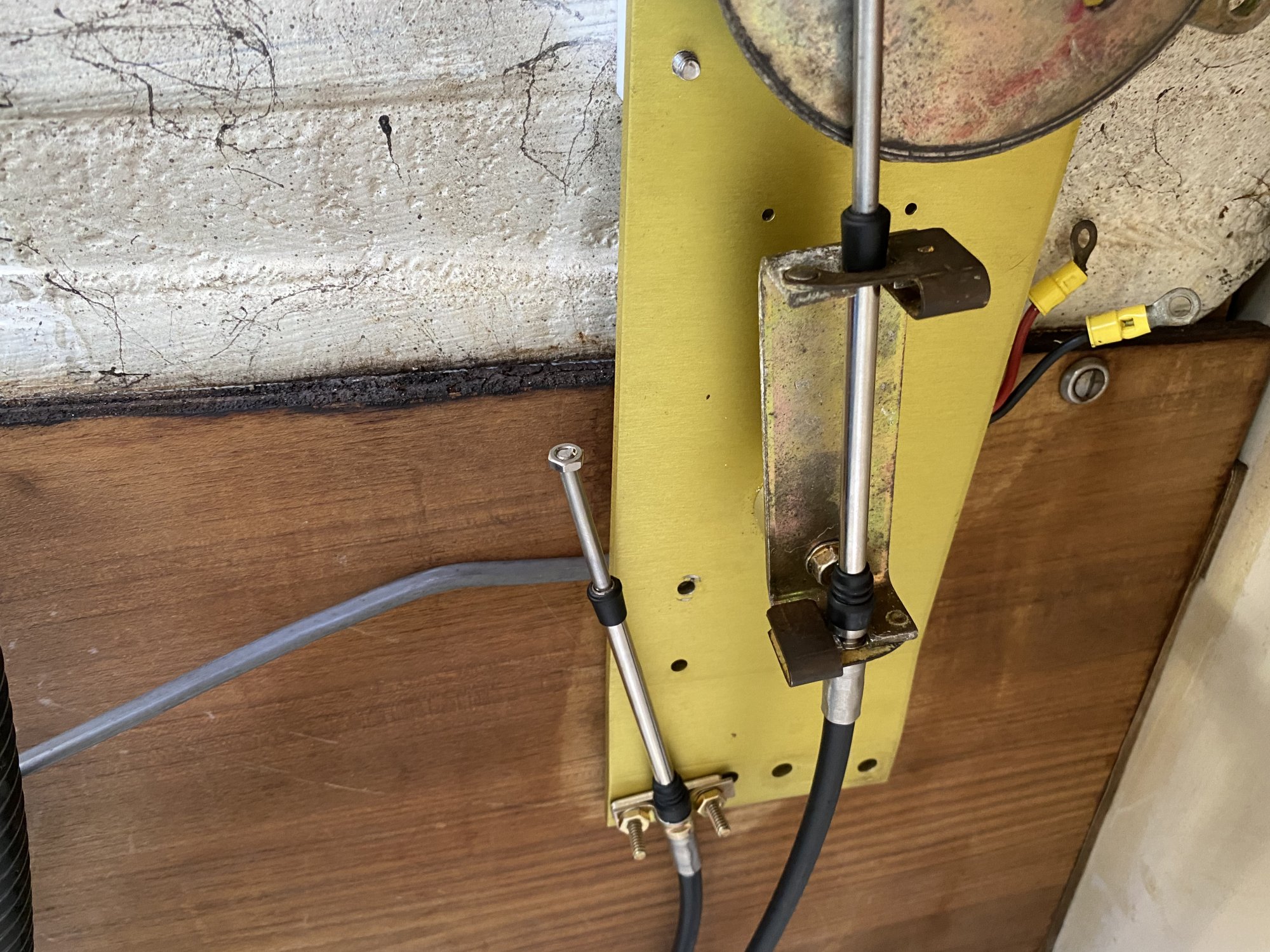

Speaking of close… I almost moved the boat out into the bay tonight… almost… I got the throttle cable installed and adjusted, then I moved onto the transmission cable, and as I was testing the throw and motion on it, the cable broke! Grrr… It broke right as the base of the clevis. I was not pushing all that hard on it, and I had not overtightened the nut, it was still just finger tight, but it snapped. Lucky me the piece inside the clevis came right out. I called CD to see what type of warranty these have, but they asked that I call the owner to find out… I will call tomorrow.
here is the broken cable.

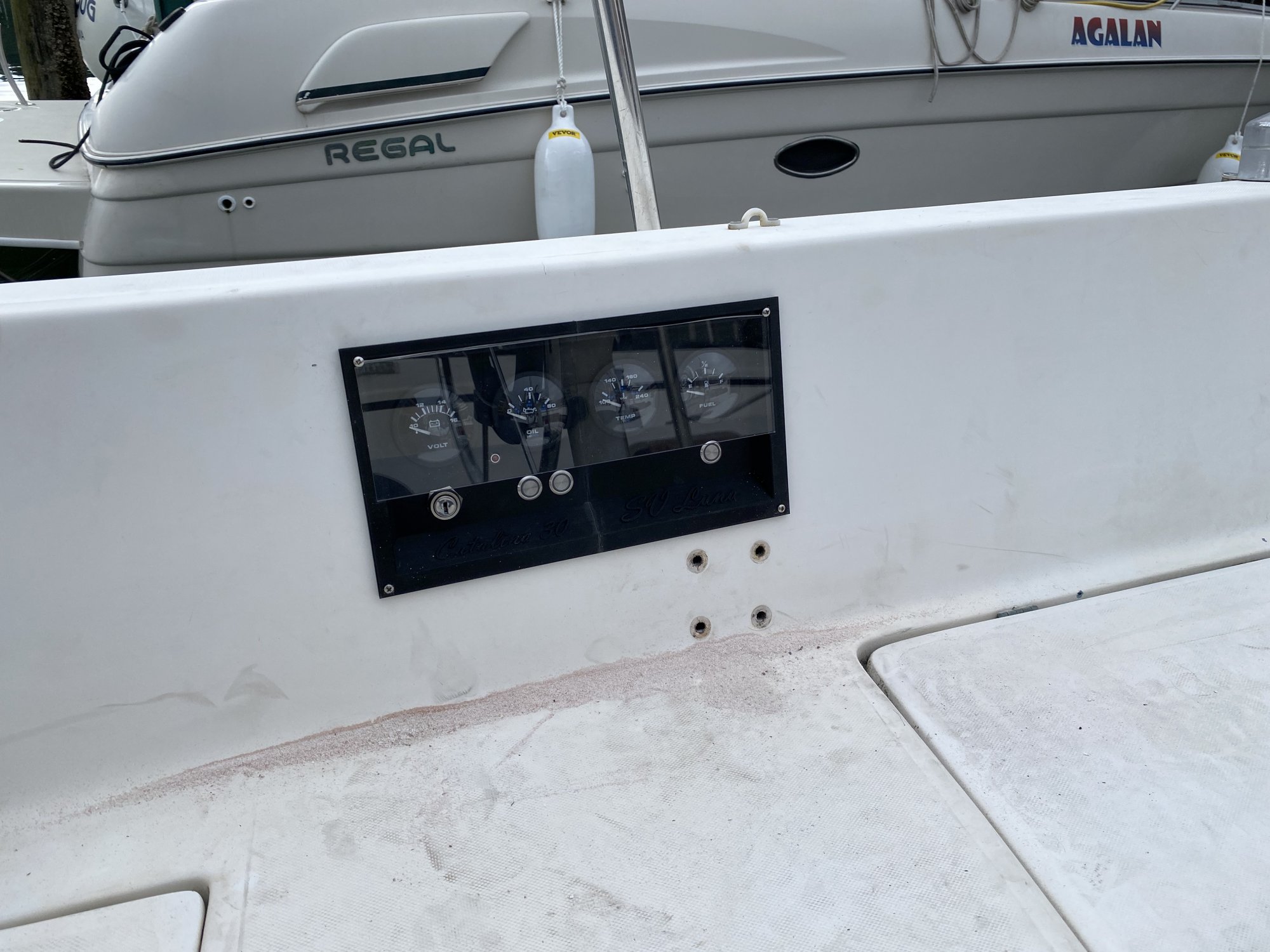

Lastly let’s see just how nice the wiring is now for the panel. I will try to get a better pic next time I shove myself inside the lazzarett.

I like that shield material much better than split loom. What is it and where do you get it?
Feb 18, 2022
440
Catalina 36 Port Orchard
Yes it’s much better and looks way better than split loom, but it’s difficult to get the wires in. It’s like a Chinese finger trap so you need to compress it to get the wires inside, then stretch it out to move it down the wires. I taped the ends all together to use as a bullet to help everything go together. If you are building a new harness it is well worth the effort. The biggest drawback is you can’t add wires later, you are stuck with what you got.
Here is the exact stuff I used.
They also make this in split form too, but it doesn’t hold the wires as well. I like the non split stuff personally.
