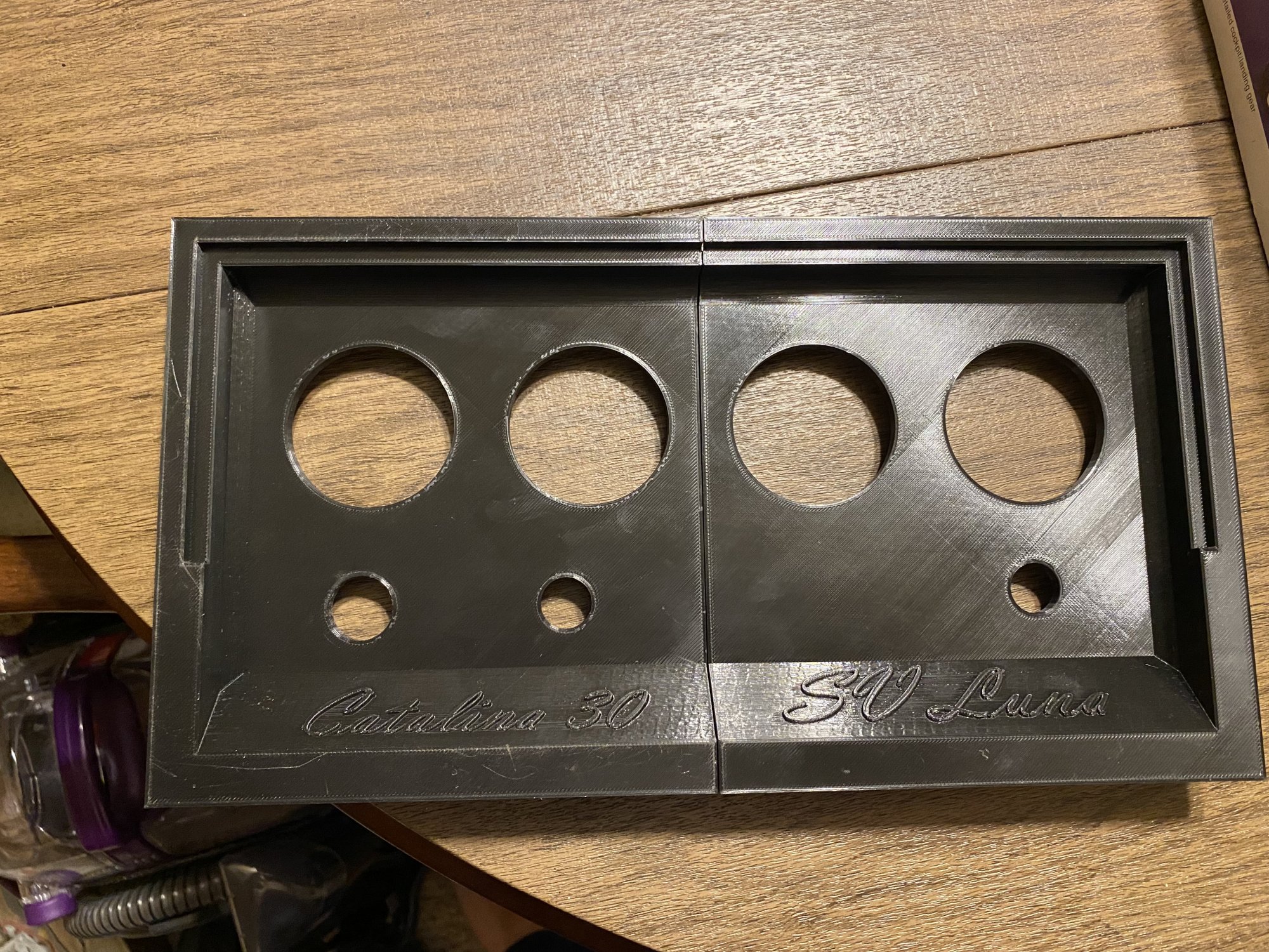

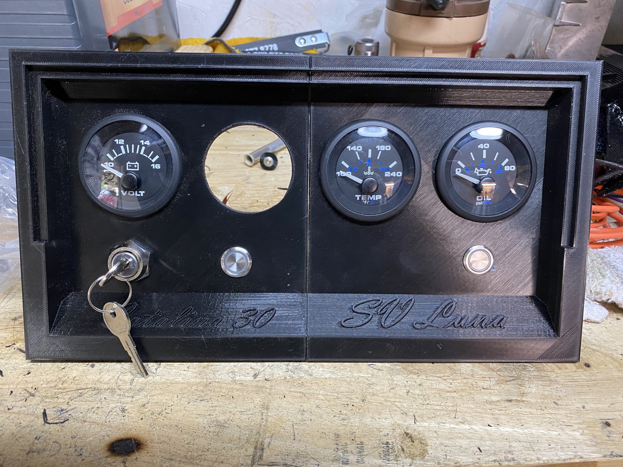

I got 1/2 of the new version 4 panel printed. This time it is black and the print turned out perfectly. IT still lifted as before but I made an allowance for that to happen and not ruin the part. I also added a 4mm groove for a sheet of plexi to help protect the gauges, and I decided to try letting the printer make the holes for the switches. That turned out pretty good. The ignition switch fits perfectly, and with a slight bit of sanding the other 2 will fit as well. I will post pics of it tomorrow after I chip away the risers... I didn't really feel like going out in the rain tonight to do this.
Well that's about all the important stuff for tonight... oh I got the right hand part printing now as well. I took off the glass to see if I could see anything that may cause a temp difference which would cause the lifting. The only thing I found was some fingerprints in the exact areas that I have problems with parts sticking. hmm... Well I cleaned off the prints, and made sure it was completely free of any oil or dust. I wouldn't think that fingerprints on the bottom of the glass would have caused any issues, but there are 2 spots that lift, and both had fingerprints. Yea I'm running with that until I see what the new part does. It's still too soon in the print to tell if it is going to lift or not. That usually happens at layer 3 or 4.
Like I have said, I do not have any real experience with 3d printing other than as an observer. One thing that I noticed is that he was very anal about cleaning and prepping the table in addition to having the insulated box closed as much as possible. Before every print, he wiped the whole surface down with a cleaning project and a clean micro-fiber rag. He then had some type of spray that he said was a bonding adjacent that made the part stick better. Apparently he used to have a lot of problems with lifting of the parts during printing and this process had mostly eliminated that issue. Next time I talk to him I will try to remember to ask for some specifics.

Well I didn't think that fingerprints on the bottom side of the glass would matter, but the print has been going on for 2 and a half hours now, and that side is still well planted on the platter. Each print I do I clean the glass on the top, but it looks like the bottom had a lot to do with it as well. Keeping fingers crossed that the rest of the print goes well. I will use up almost all the roll I have left on this print so if it fails, I am ordering more filament.

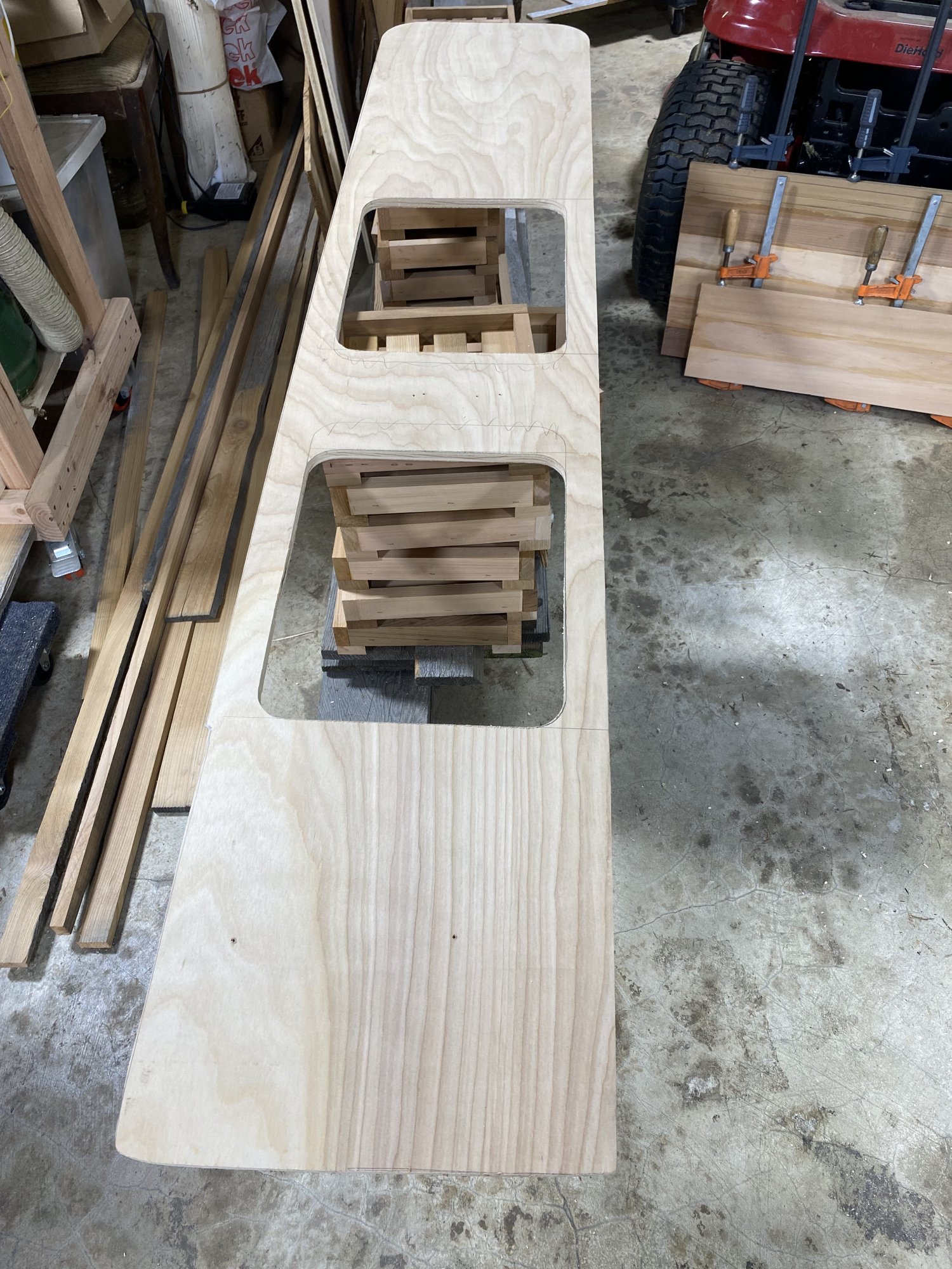

And lastly the best part of the day. I got the new countertop cut out. I moved each sink slightly outward to fit a conventional faucet, and next week I will get the Formica to finish the top. I’m also going to be making the other piece, don’t worry, I just need to get it out of the boat so it can be reproduced.

Speaking of the panel, I got the risers off the pieces and it looks great. A bit of massaging around the holes for the gauges and switches and we will be good to go.
You can see the improvements I made along the way. There is a recess for a sheet plexiglass and had the printer make 3 of the needed holes. I should have made a 4th hole, I have decided to use the small one on the left for a start button, and will make a new hole on the right side for the glow plug switch. The existing hole on the right side if for the night lights on the gauges.

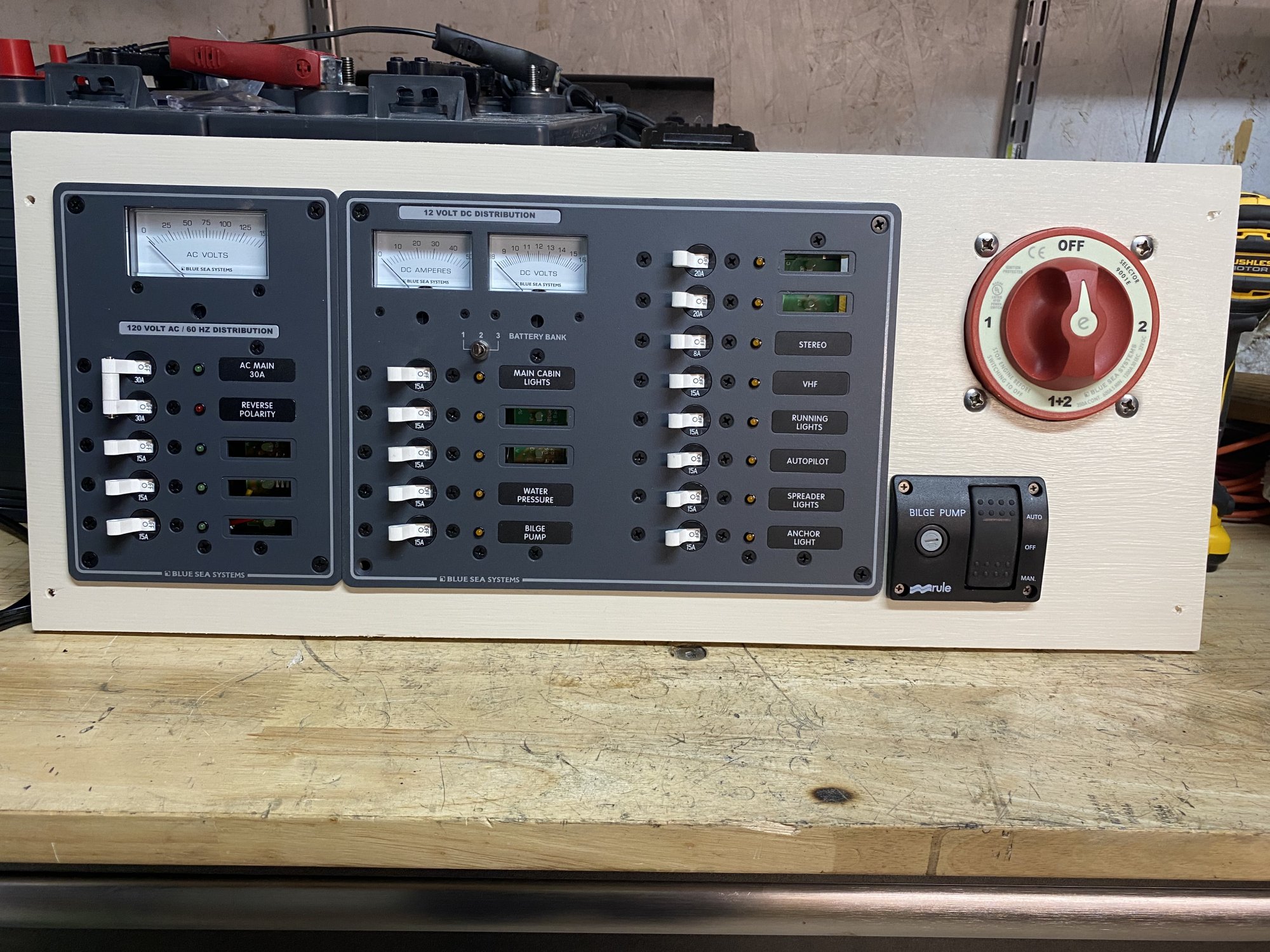

Today was a kinda big day for Luna. I got the trimming done on the new panel pieces, and they are just about ready. I need to get some plexi so I can make the shield. The stuff I have on hand is either dark tinted (but the right thickness) too thick or too thin. Oh well, next Friday I will order a new piece of clear. The empty hole is for the fuel gauge which is on back order. It should be here soon… I hope.

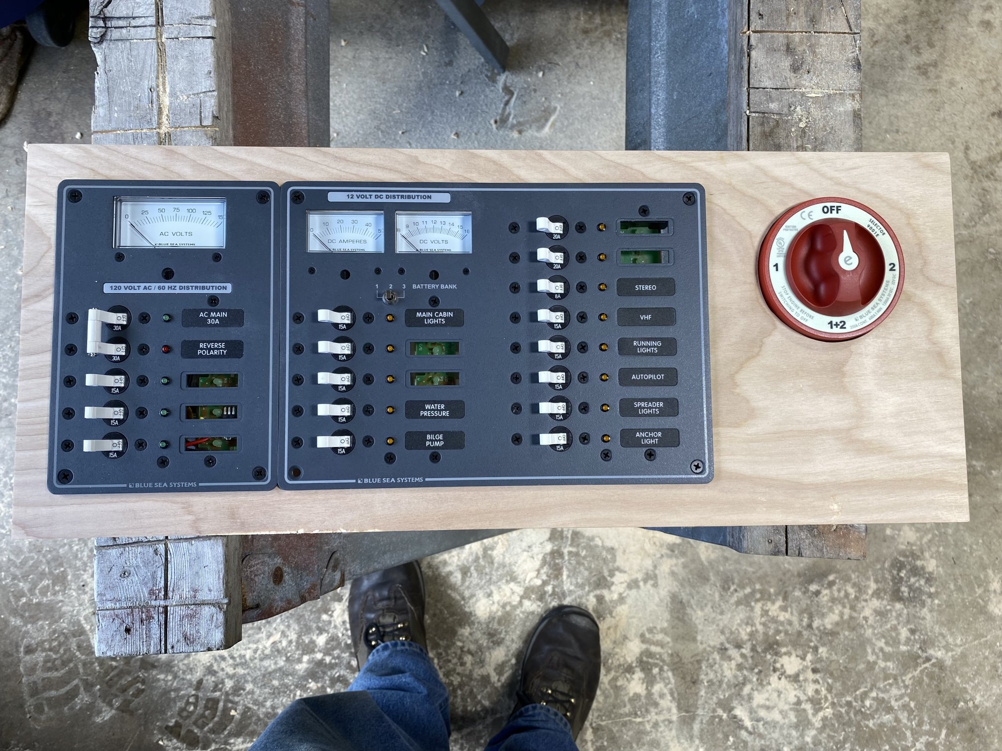

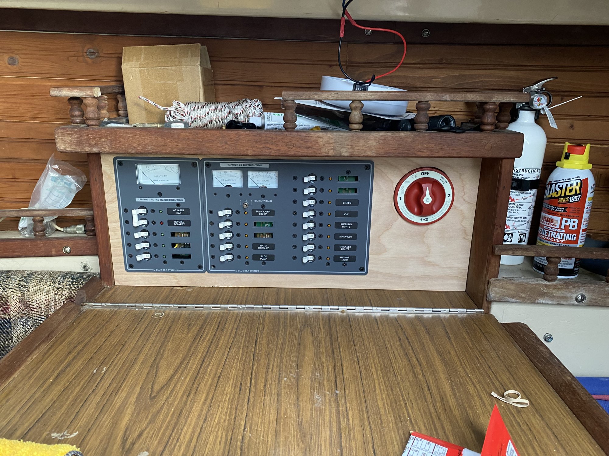

Next I went over to a friends place… he has much better woodworking tools than I do. And I built a new electrical panel. I still need to make the hole for the bilge pump control, and maybe a charging port.
And here it is test fitted into it’s home. I still need to drill mounting holes for the crews and the B12 switch.
So there ya have it. And as you can tell my refit is starting to move to the electrical systems.

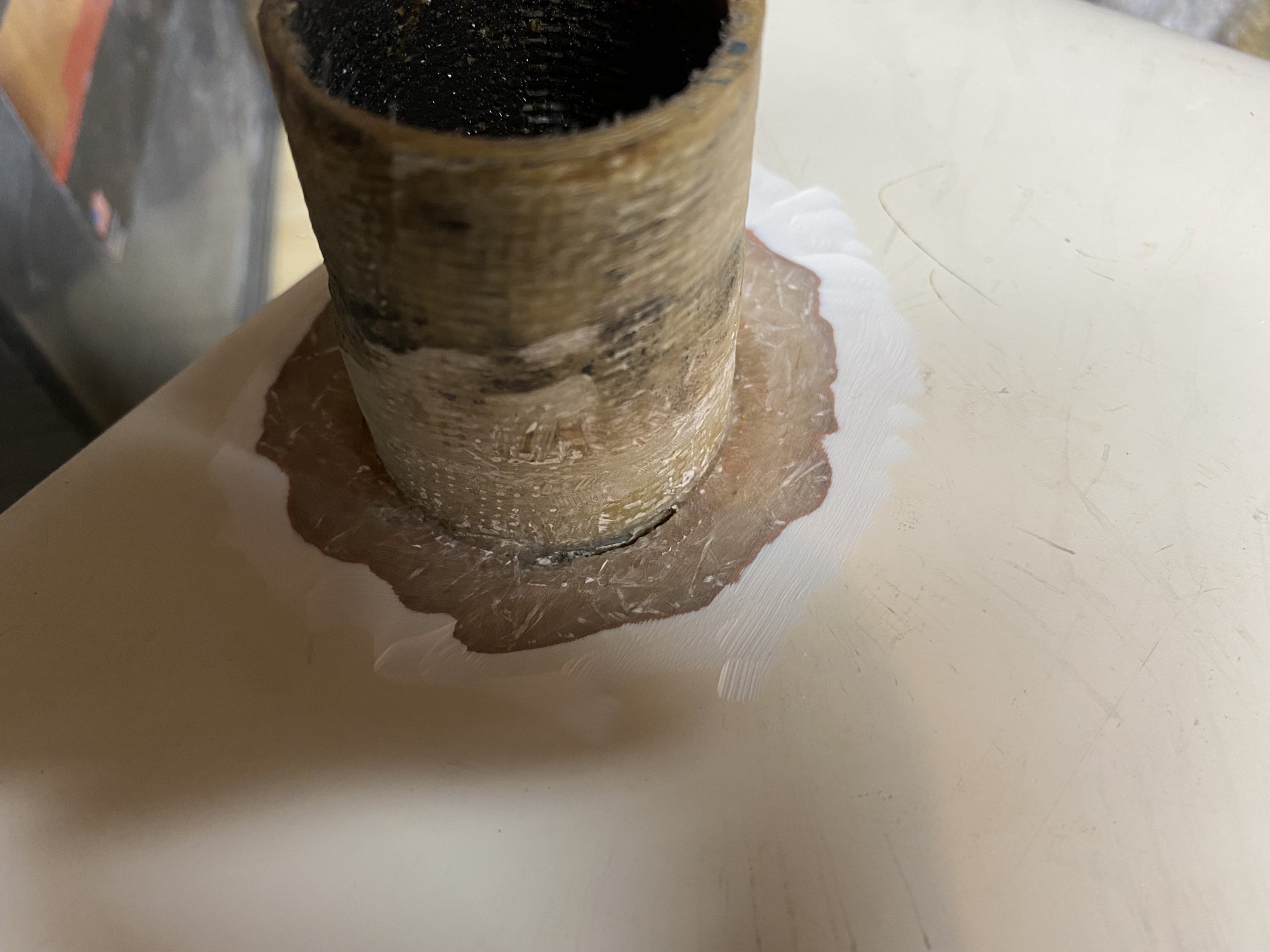

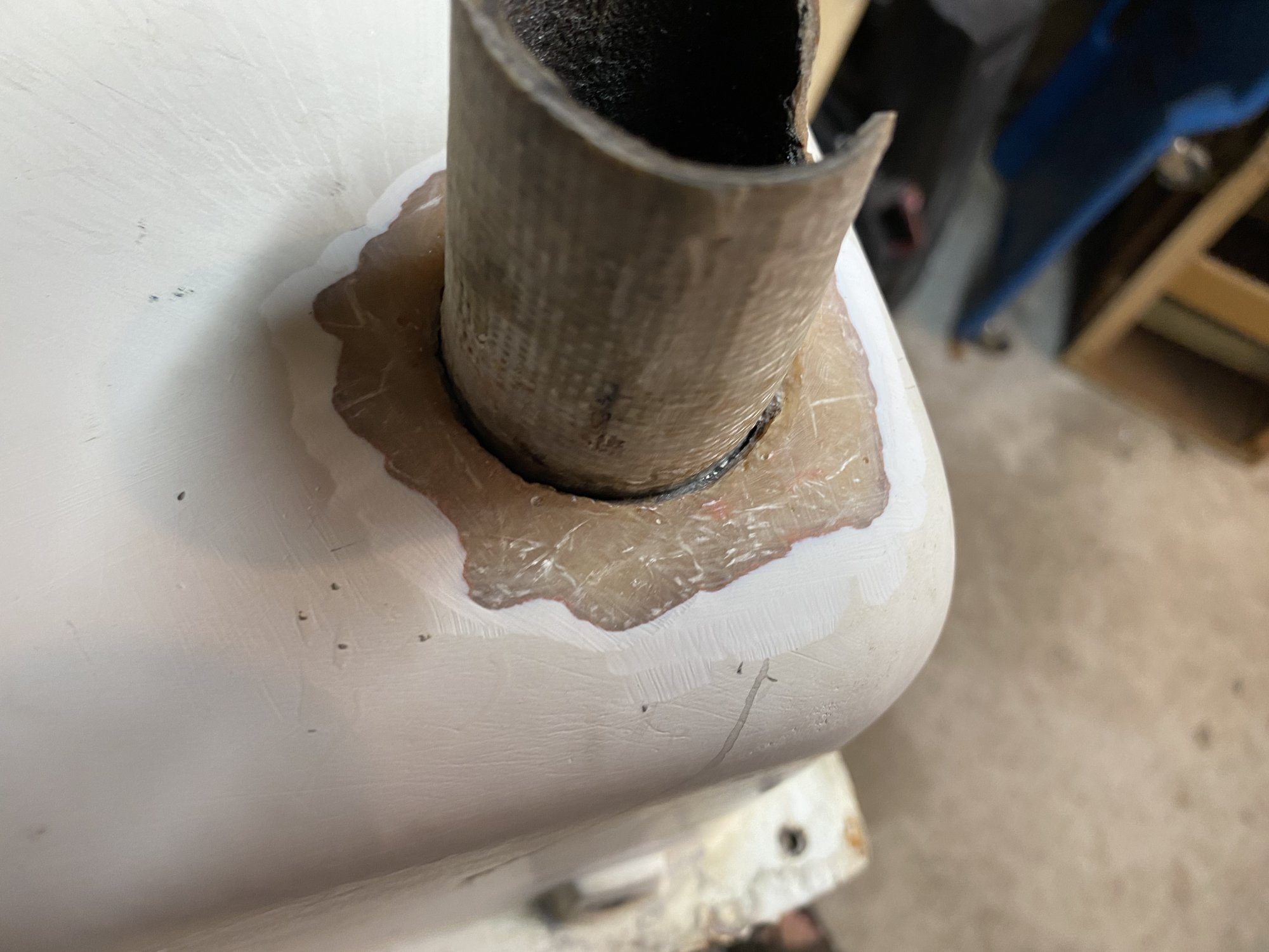

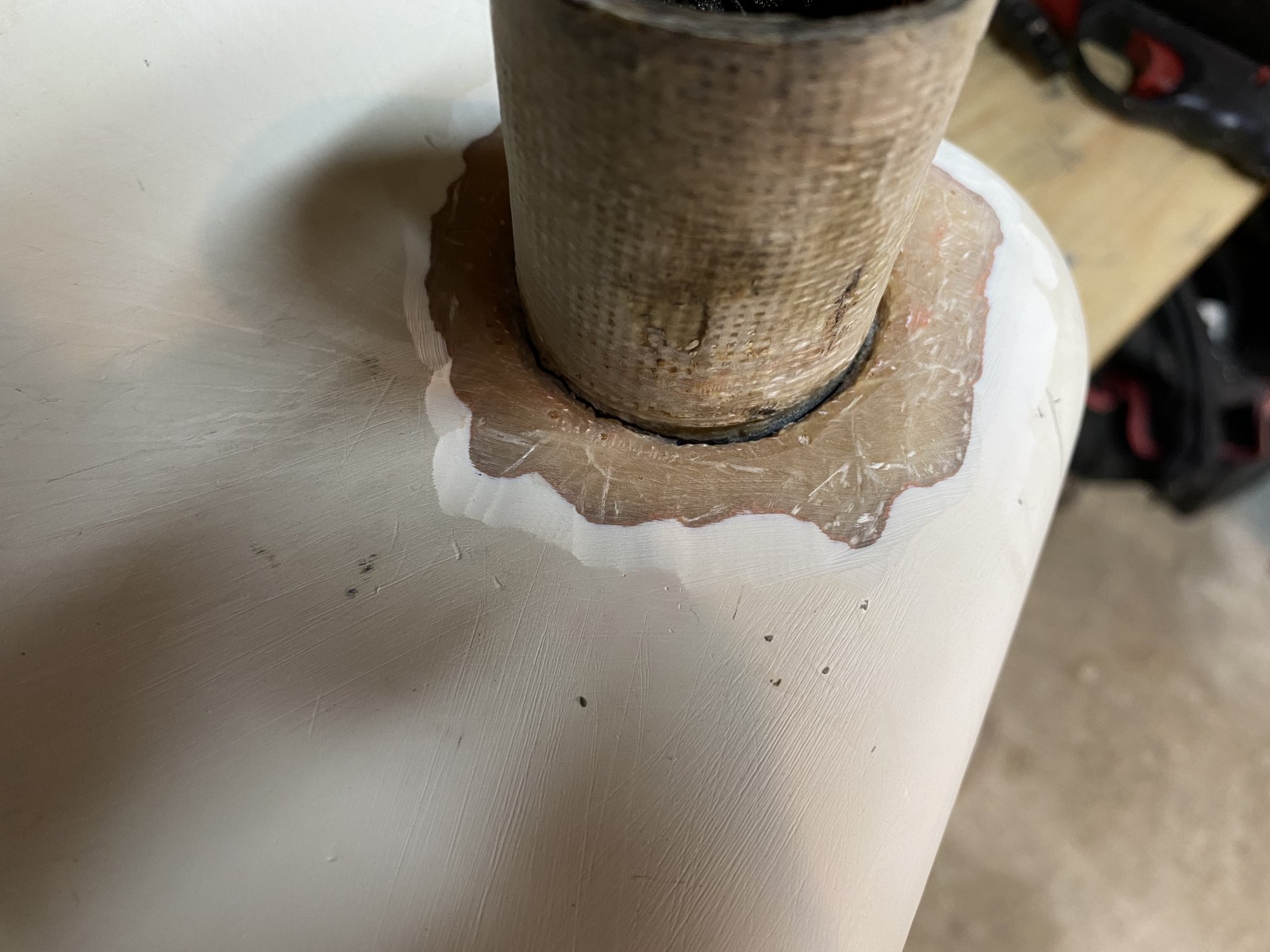

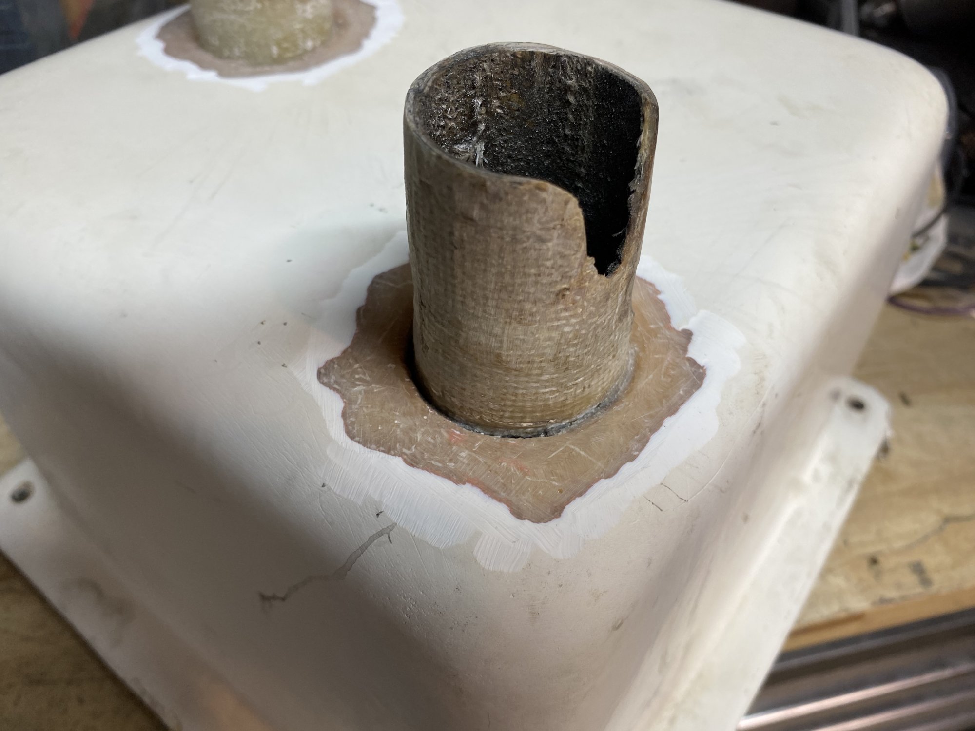

So I mentioned before that my muffler needed some repairs. I gave it a good bath then I dug out the original epoxy that is supposed to form the seal from the inlet/outlet tubes to the body. The inlet was really bad. Some pieces were already missing and I could see bubbles out of the seam when I used a garden hose on one end and held my hand over the other. I used a bit akin to a dentist drill and my dremmel and dug out the old to prep for the new. I also did the rear to prevent it from failing and I’m glad I did, as some of that epoxy was about to come off on its own. I also cut out a damaged area on the inlet that I will need to glass back into place… that’s not gonna be fun :mad:.
Inlet with damage cut out.
You can see the holes in this pic. This is what they were trying to use silicone to repair.
And here is the outlet with the hole. Like I said, it was just starting to happen.

Good catch and the prep looks great.
For repairing the section of missing tube you might consider building from the outside inward. The important part is the outside diameter. I would feather edge the inside of the tube and leave the outside alone. I would make a form out of sheet metal that is covered some 6-mil plastic sheeting for a bond breaker and then layup glass on the inside of the tube so that I did not get the OD out of round.
That was the exact basic plan I was going to use… except I was going to wrap some waxed paper around a wooden dowel for the inside form. Waxing the waxed paper will allow it to come off the glass without tearing.
If I was doing it, I would be worried about forming the inside and needing to come up with a perfect layup on the outside were it needs to fit into a reinforced hose. That was why I would look at doing the layup on the inside. given that you have sanded off all of the gelcoat, you might layout one full wrap of 6oz to bring it back to design diameter.
There never was any gel coat on the pipes… at least not on this one. The main issue I am going to have is getting the glass to stick on the inside. The glass in there is contaminated with theDiesel exhaust pretty badly, and my best cleaning efforts couldn’t get everything off and back to solid good glass. I have been tossing around the idea of just making a new pipe, and setting it in with epoxy, instead of repairing the current pipe.

There never was any gel coat on the pipes… at least not on this one. The main issue I am going to have is getting the glass to stick on the inside. The glass in there is contaminated with the Diesel exhaust pretty badly, and my best cleaning efforts couldn’t get everything off and back to solid good glass. I have been tossing around the idea of just making a new pipe, and setting it in with epoxy, instead of repairing the current pipe.
Not a bad idea. If you go that way, you can get fiberglass or carbon fiber tubes in many different sizes that could be installed. You have probably noticed that the inlet tube is short and ends just below the top of the box but the outlet tube goes almost to the bottom with the end cut at an angle to expel the water.

I have been waiting on parts so there hasn’t been much going on with Luna’s refit. But today I got some JB Weld Marine for the muffler, and filled the seams. I will try to get the tube fixed here really soon. Next up I worked on the engine panel and got all the switches in place, all but the fuel gauge installed and the power busses are epoxied in place. I will get pics of the progress tomorrow as the epoxy was still drying and I couldn’t really move it much or they would slide off. I finished the work on my house battery box as well. I painted the bare fiberglass underneath as it would give me slivers if I touched it just right, and I got new straps, attached them to the box. Now the batteries will be nice and secure when the boat heels over.
And lastly I got the electrical panel sanded and painted then reassembled. I installed the bilge pump switch since the last pic, and all is well. This will go to Luna the next time I go to her and live there from this point on!

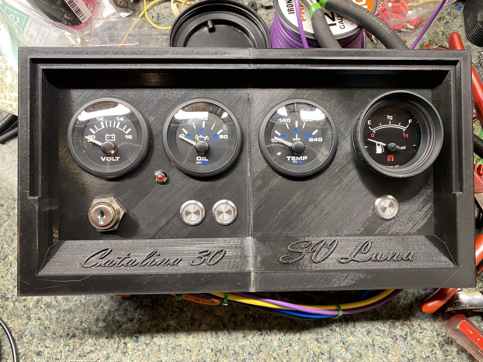

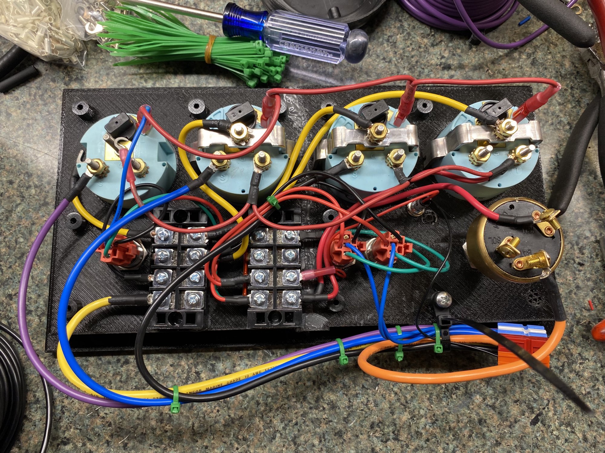

And here is the long awaited finished engine panel. I was able to get it wired up and everything is golden! The fuel gauge is just a stand in, but as a stand in it is the same form factor in the back, just a different face. The actual gauge will be the same style as the others.
